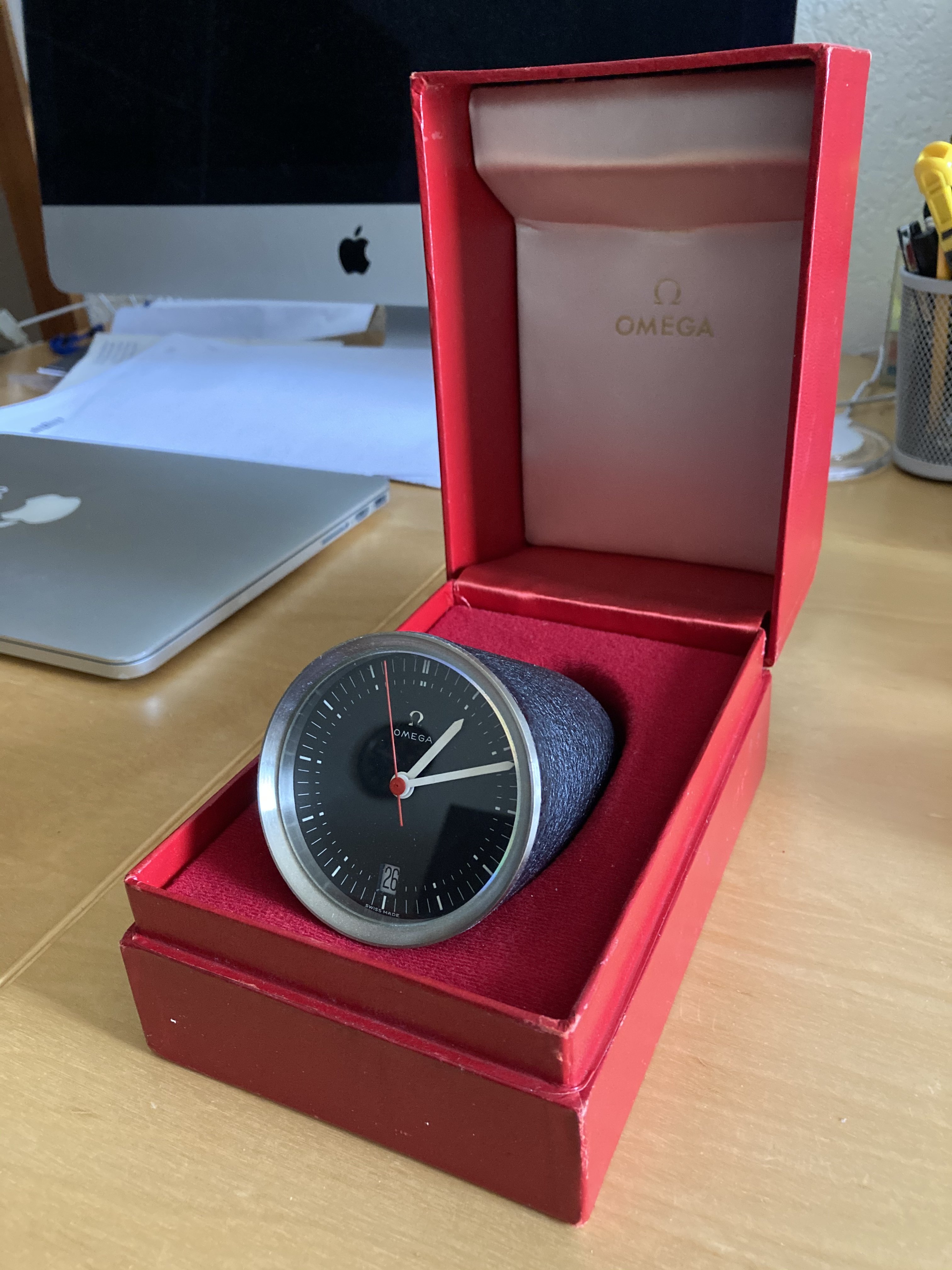

A new addition to the collection here, new old stock set, as I love them 🥰 :
::psy::
where the hell do you find em like this?
great find
