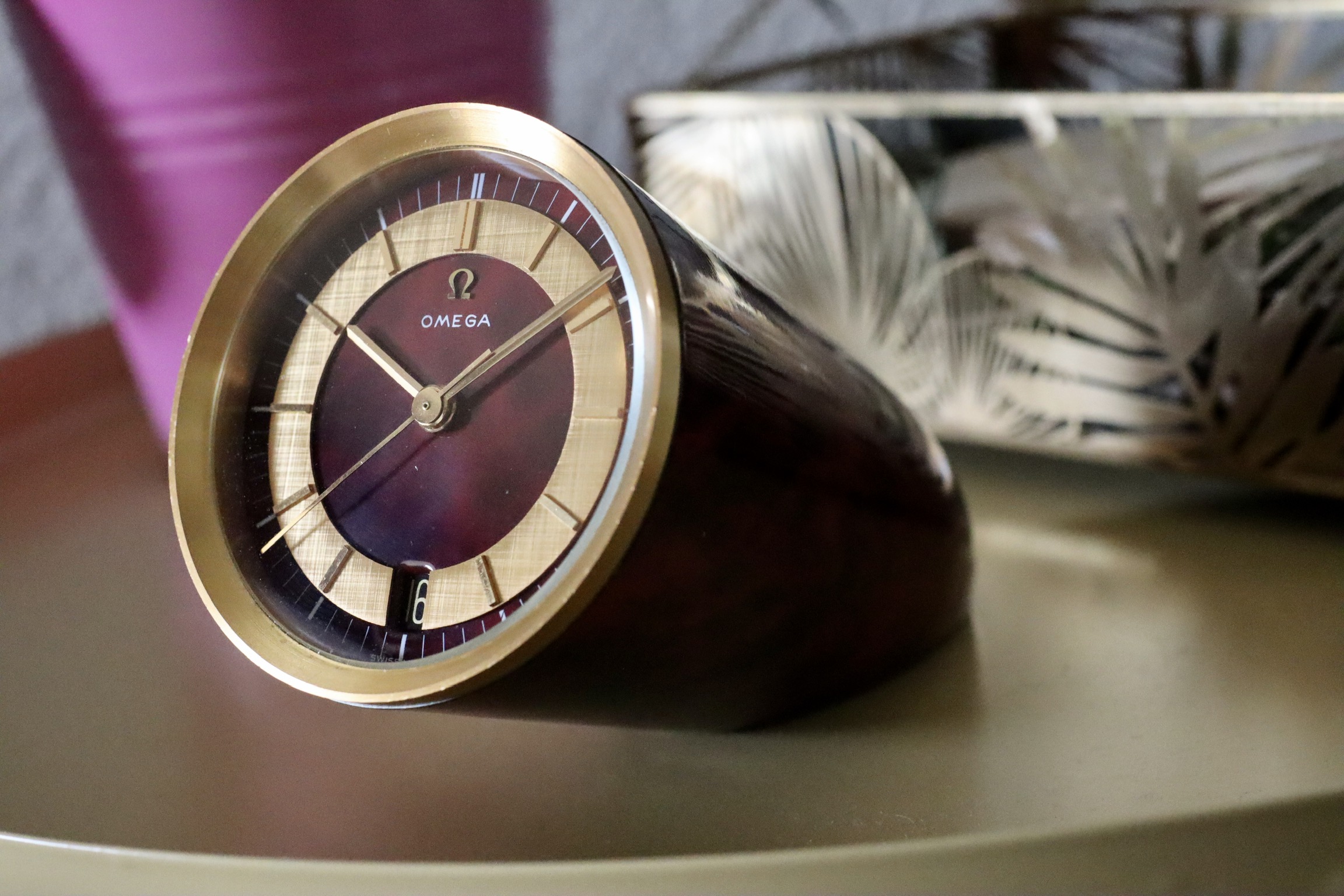

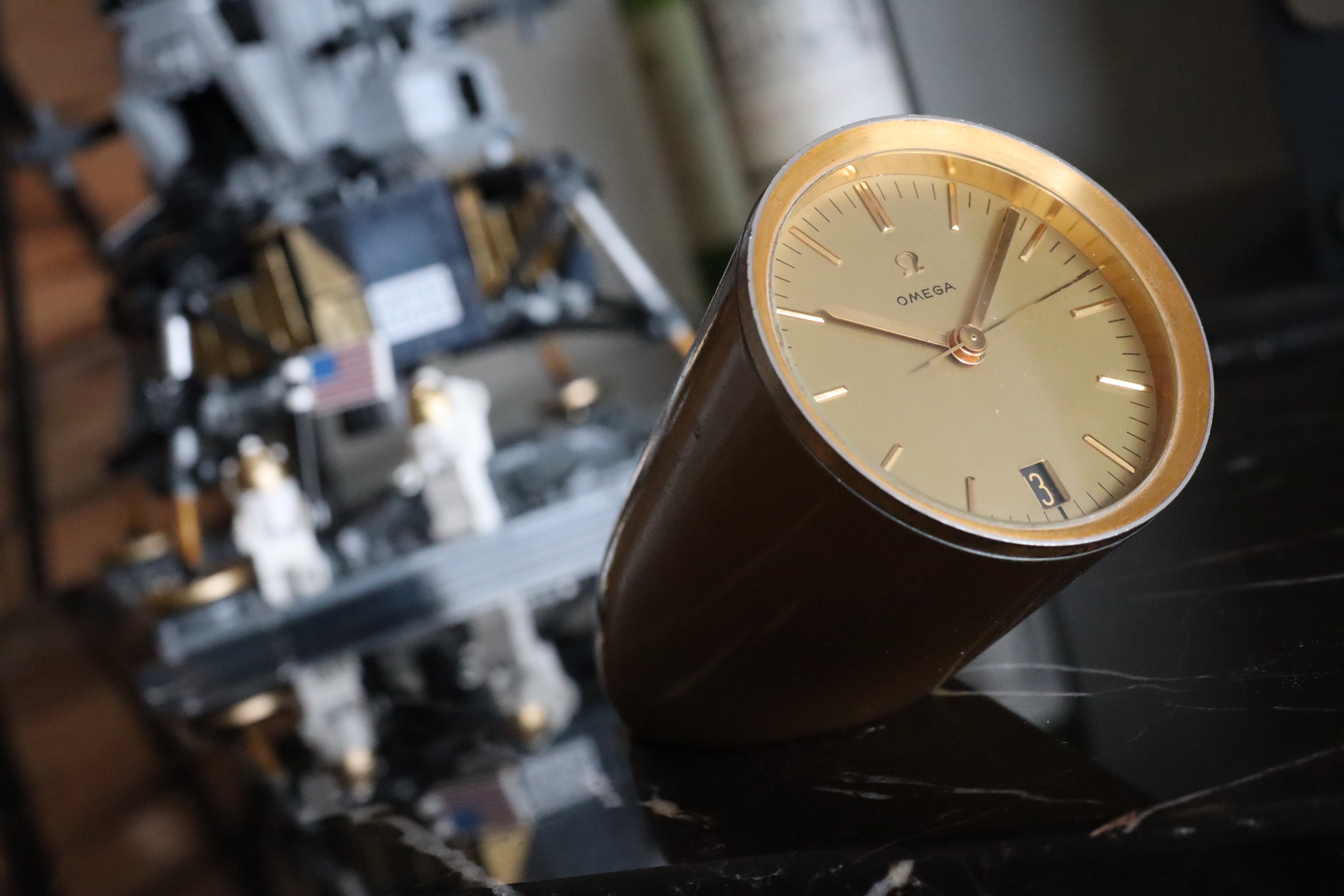

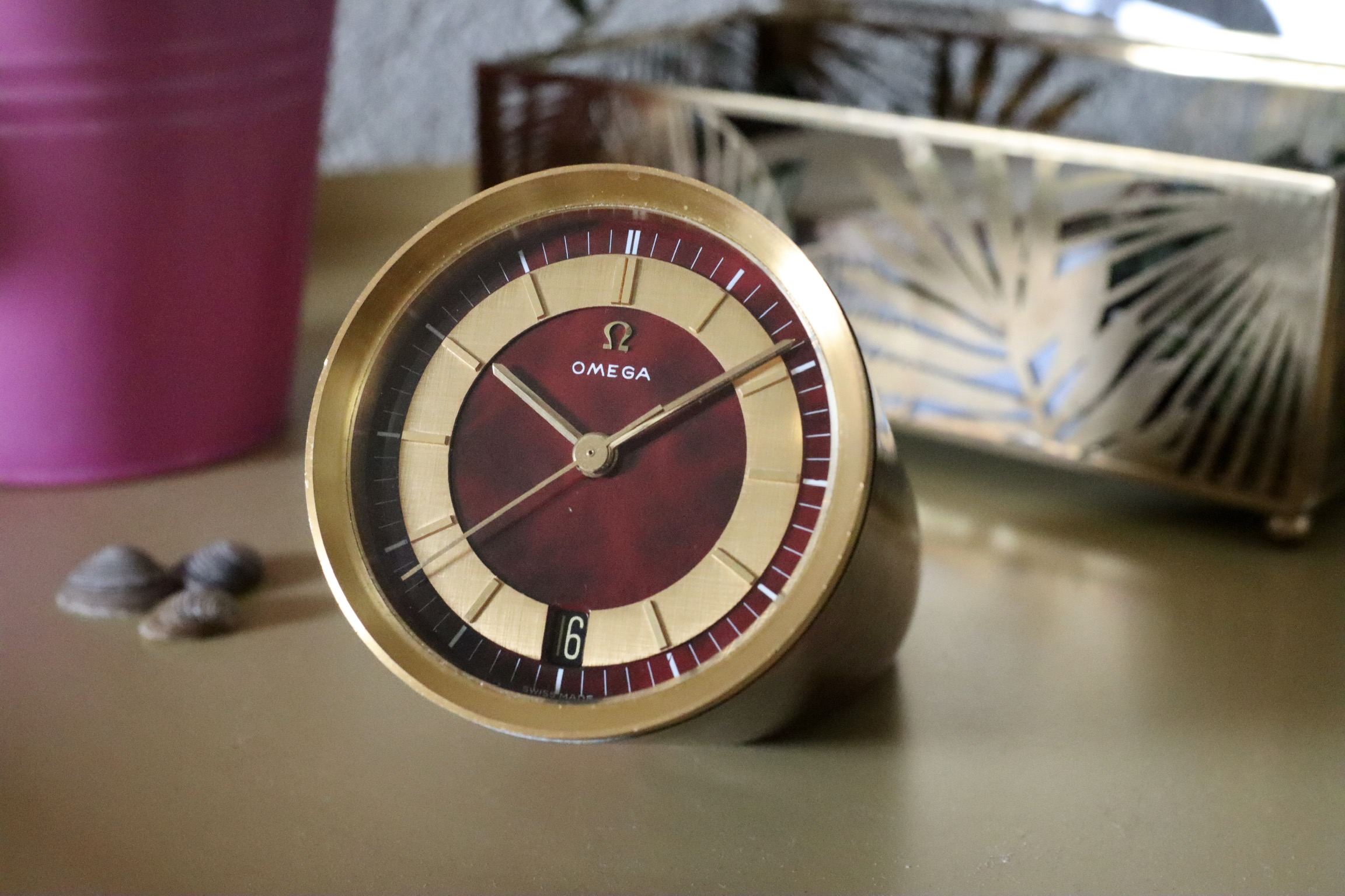

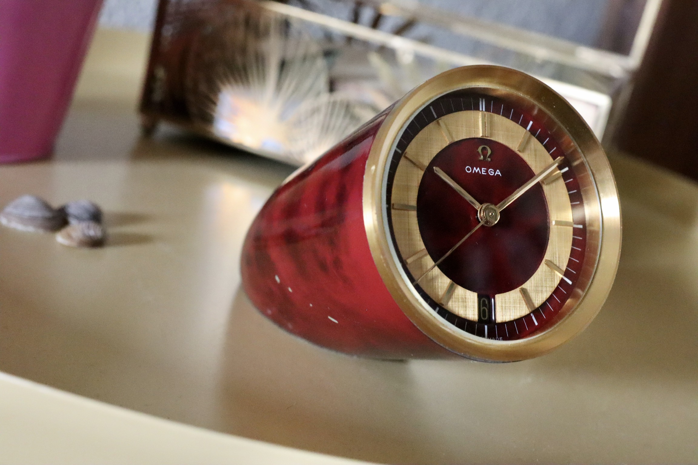

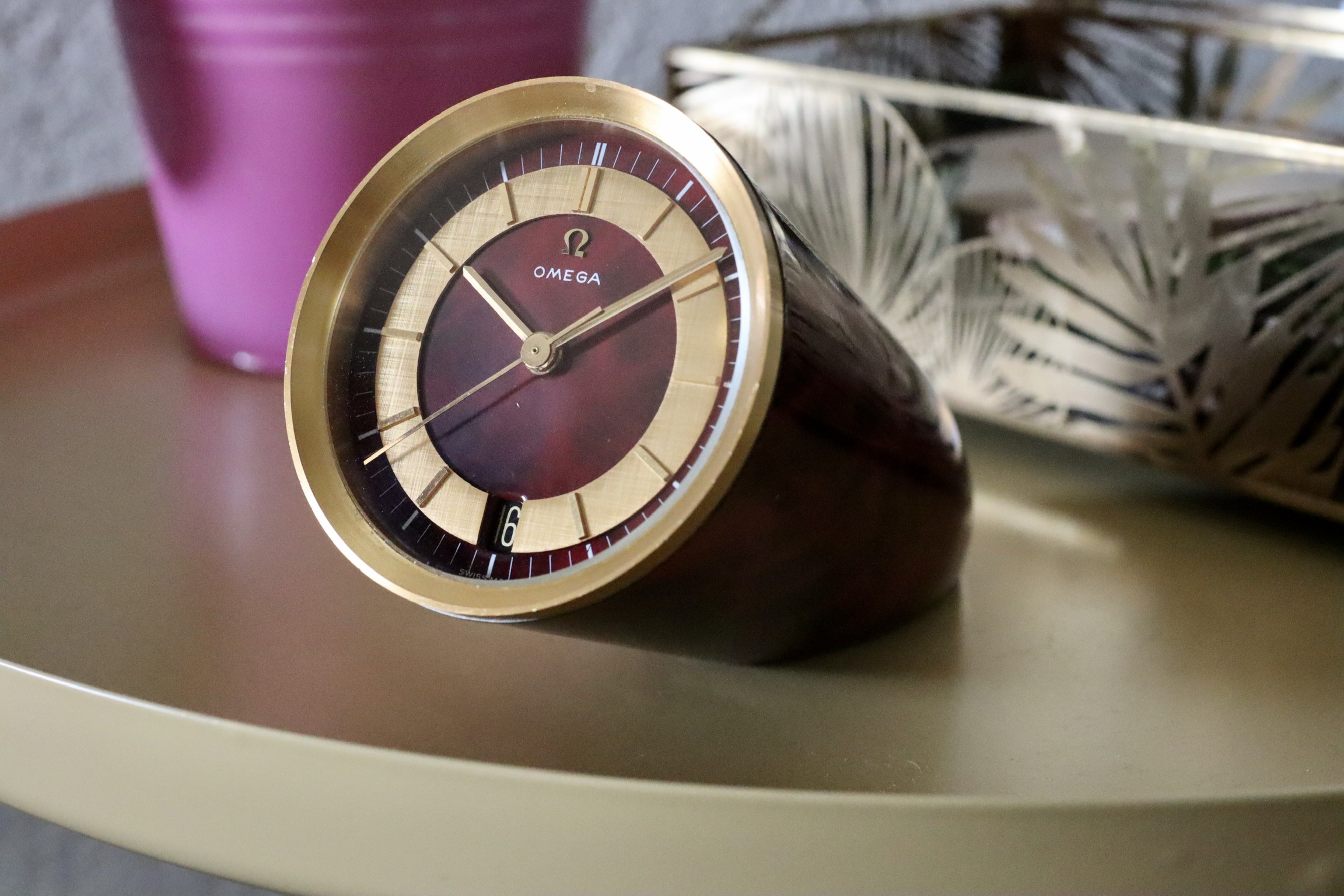

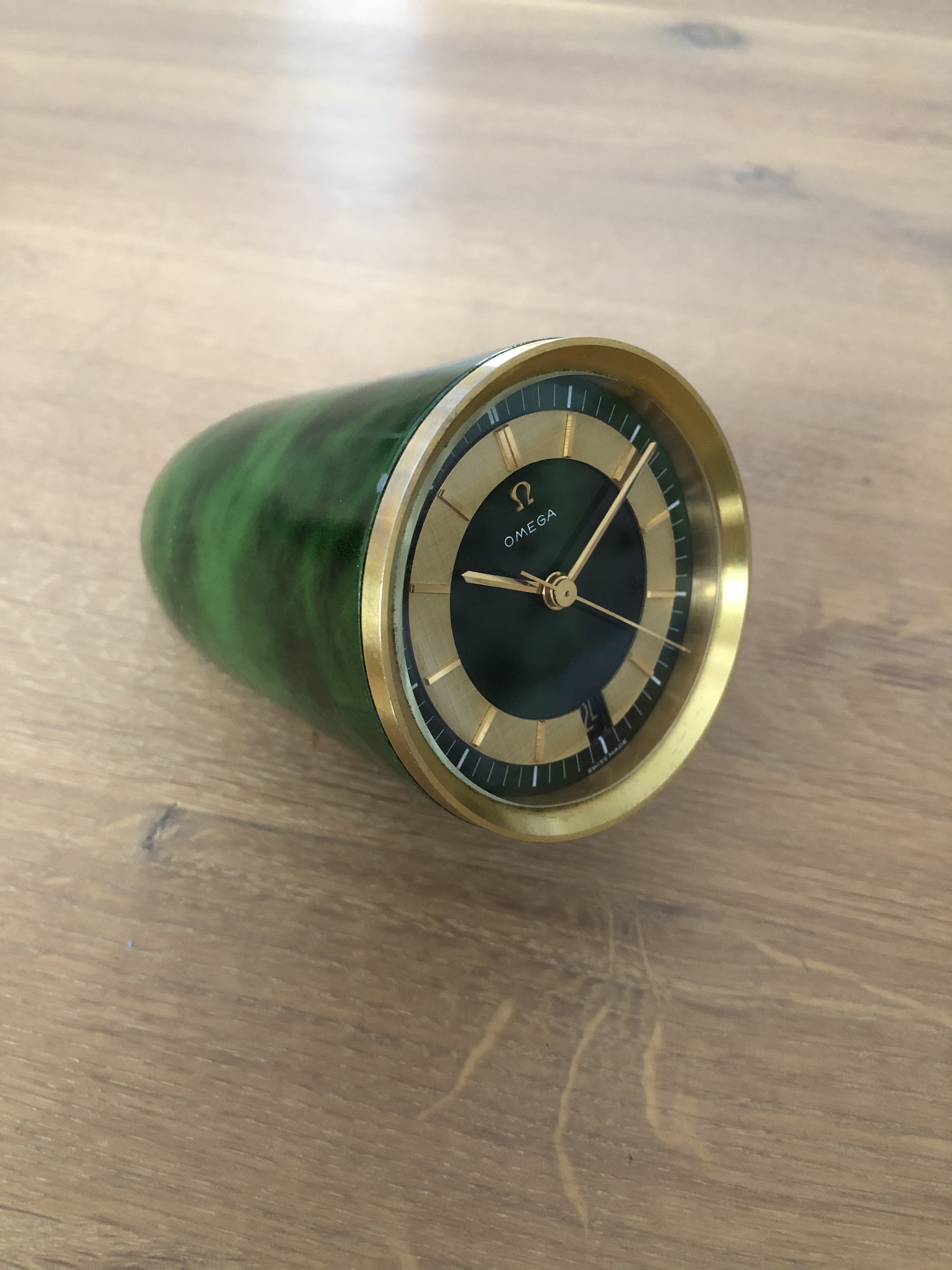

Here we have one of my favorites, the model ref. 5571 :
The elegant marbled metal body with its rocket stage shape seems to defy gravity, focusing on the linen golden and burgundy date dial.
Note also the applied logo, as we have on wrist watches of the same period.
--> First reference post updated accordingly.

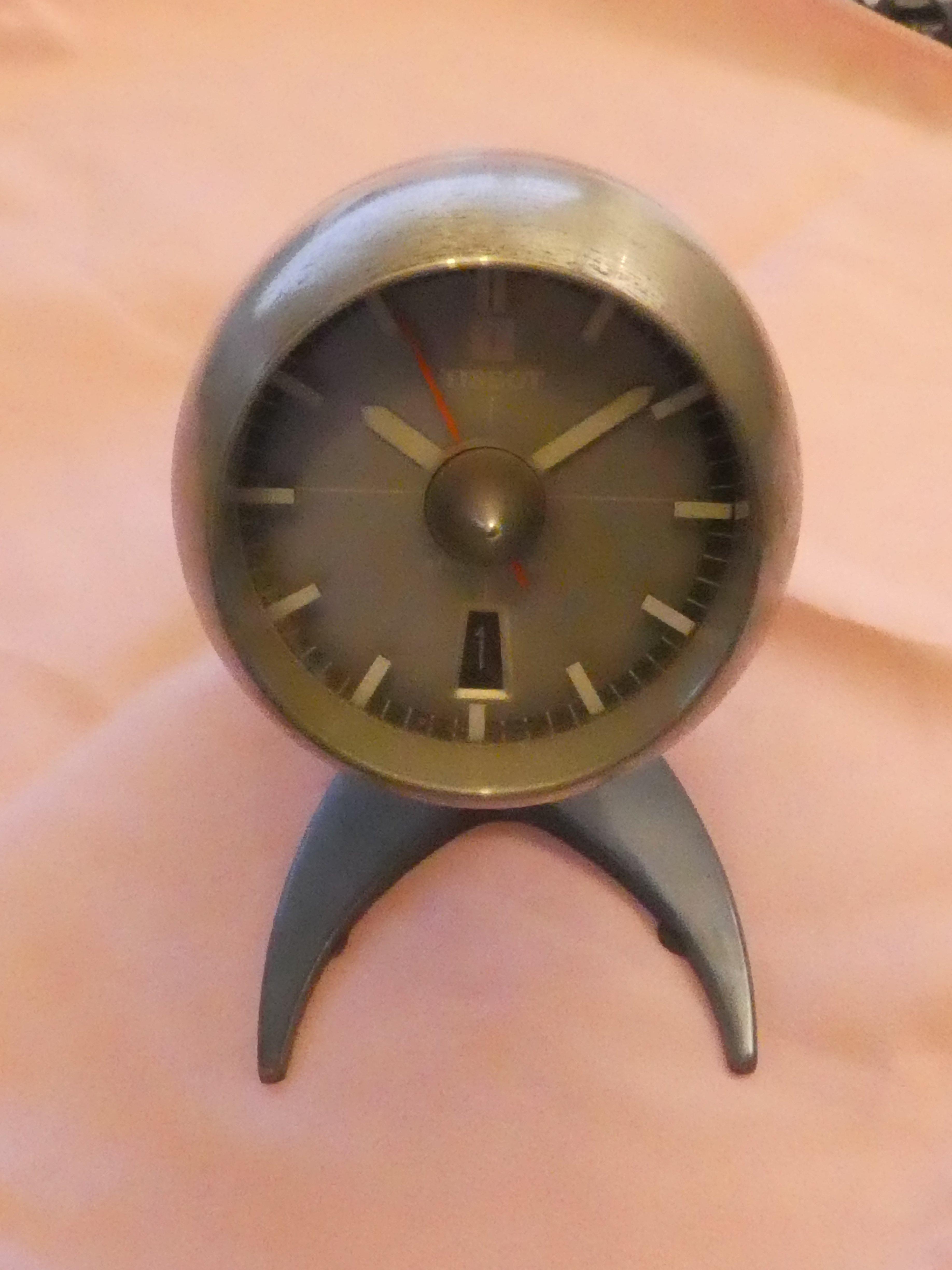

I don't have any of the rocket line yet, only the Tissot replica with a very simple electrical movement
Why did you mentioned "replica" ?

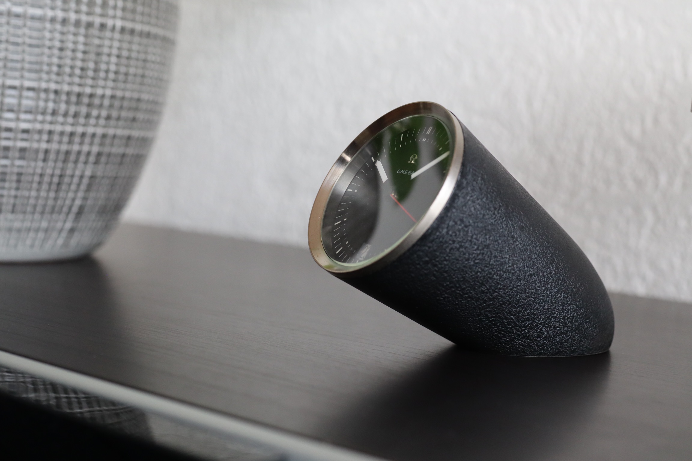

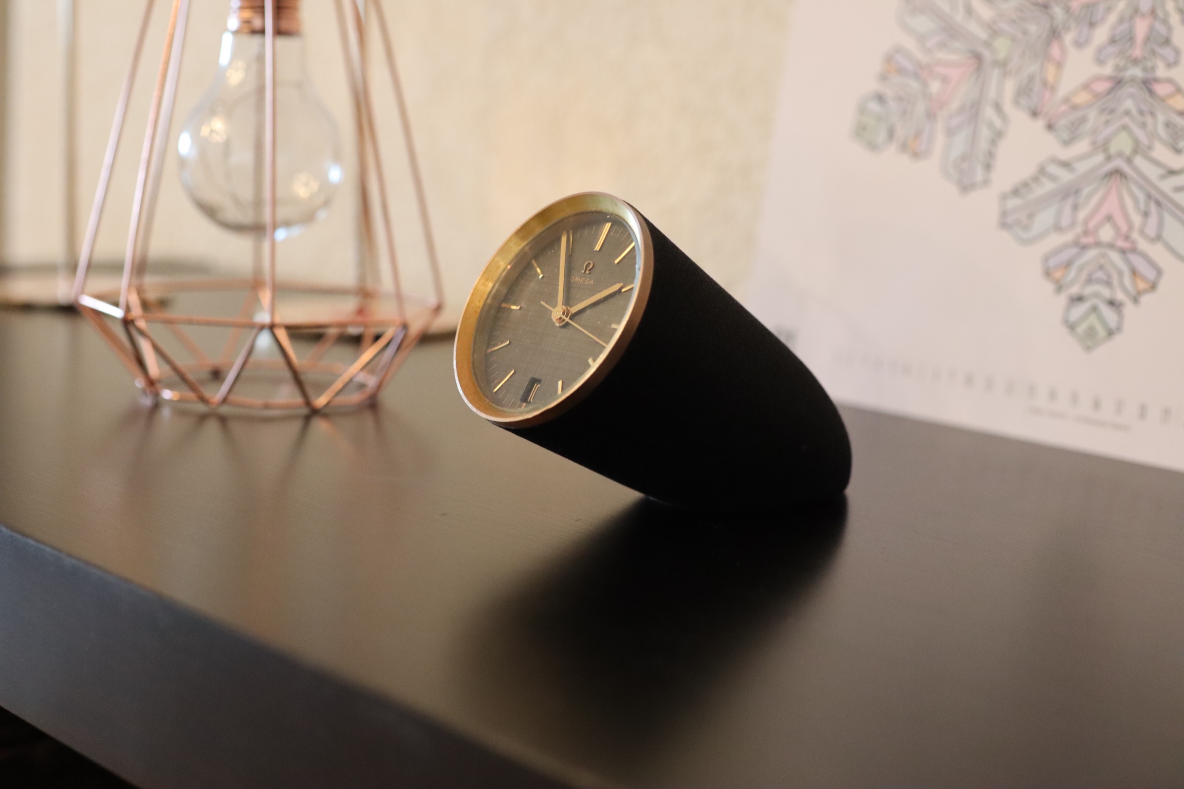

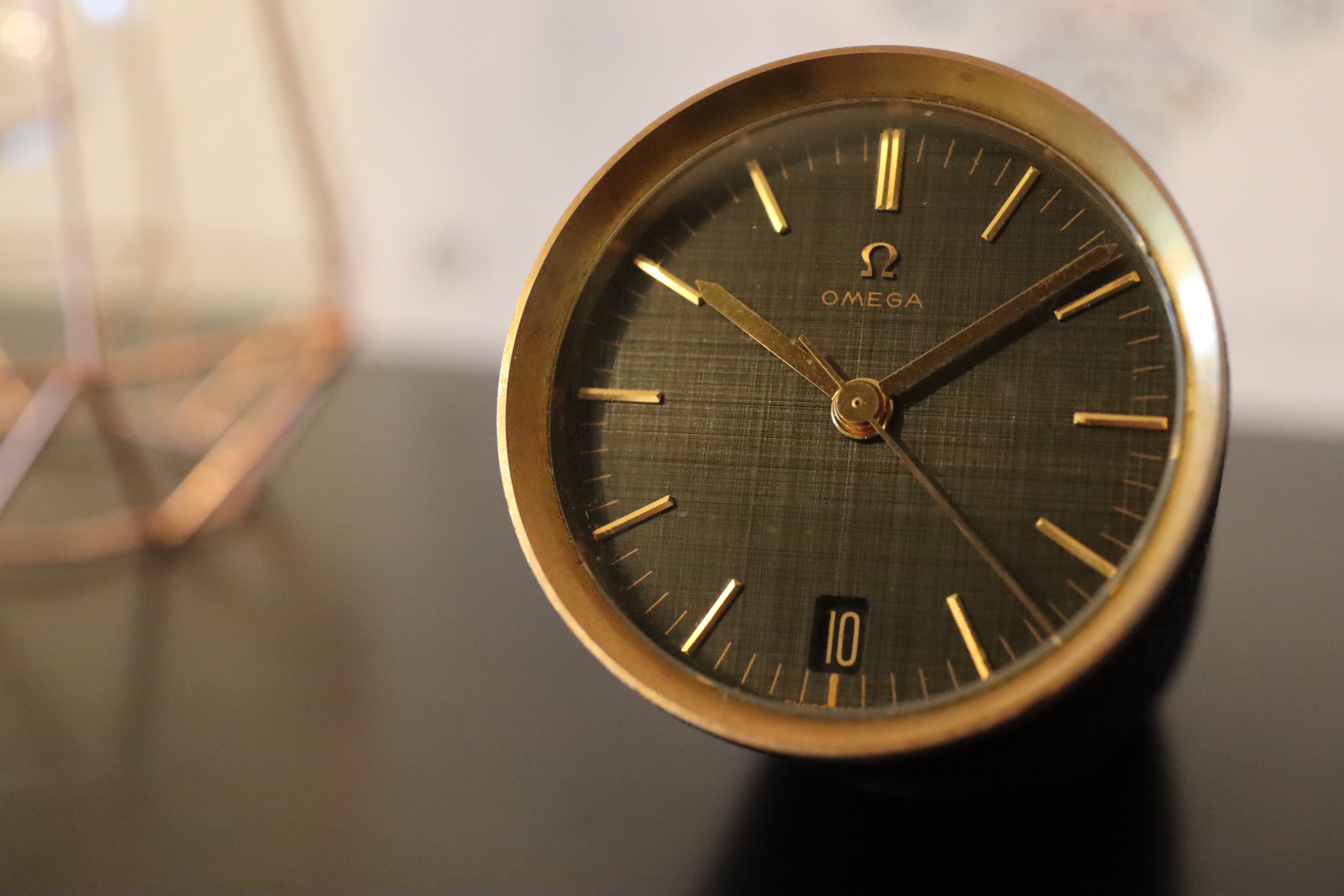

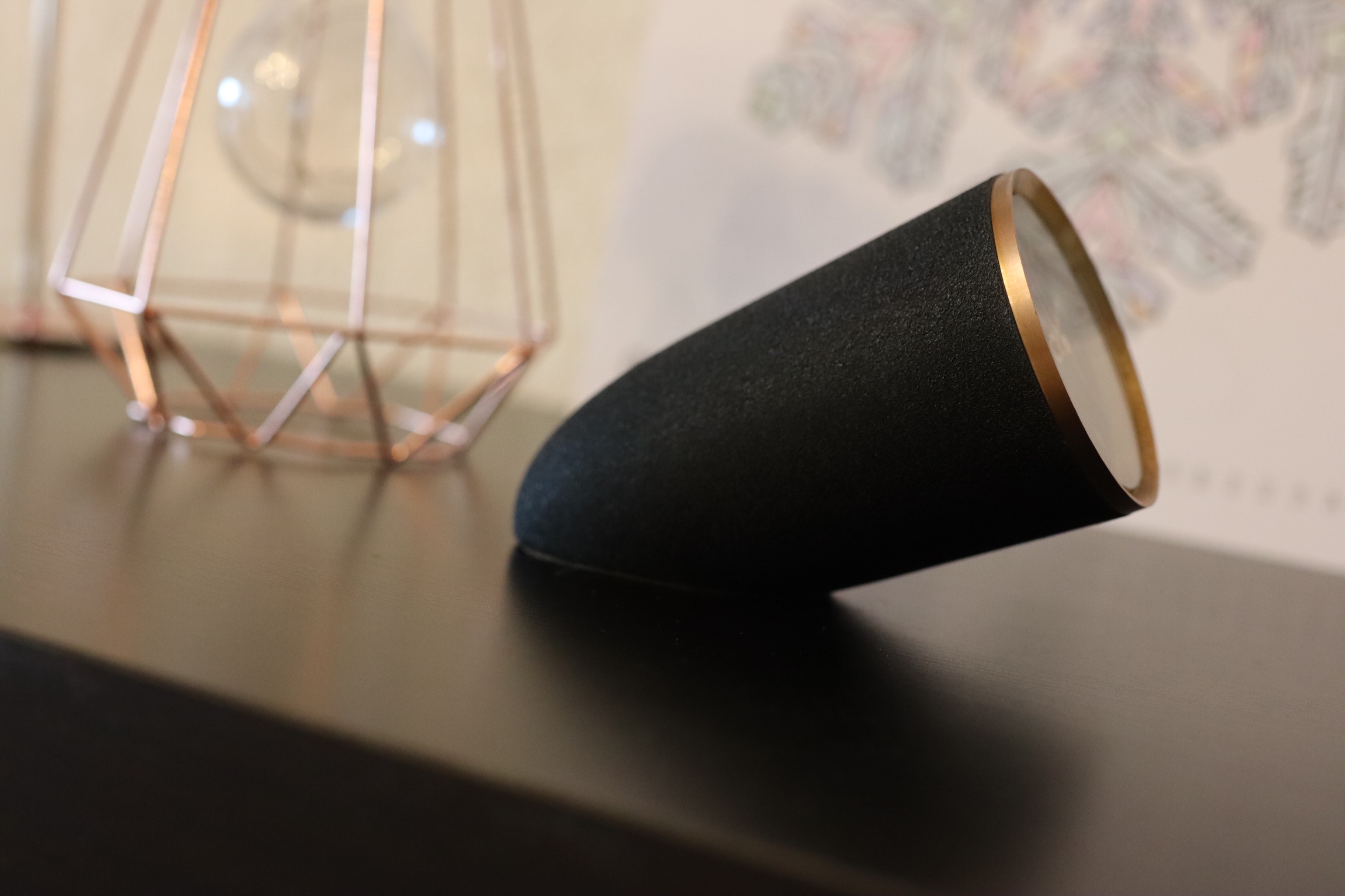

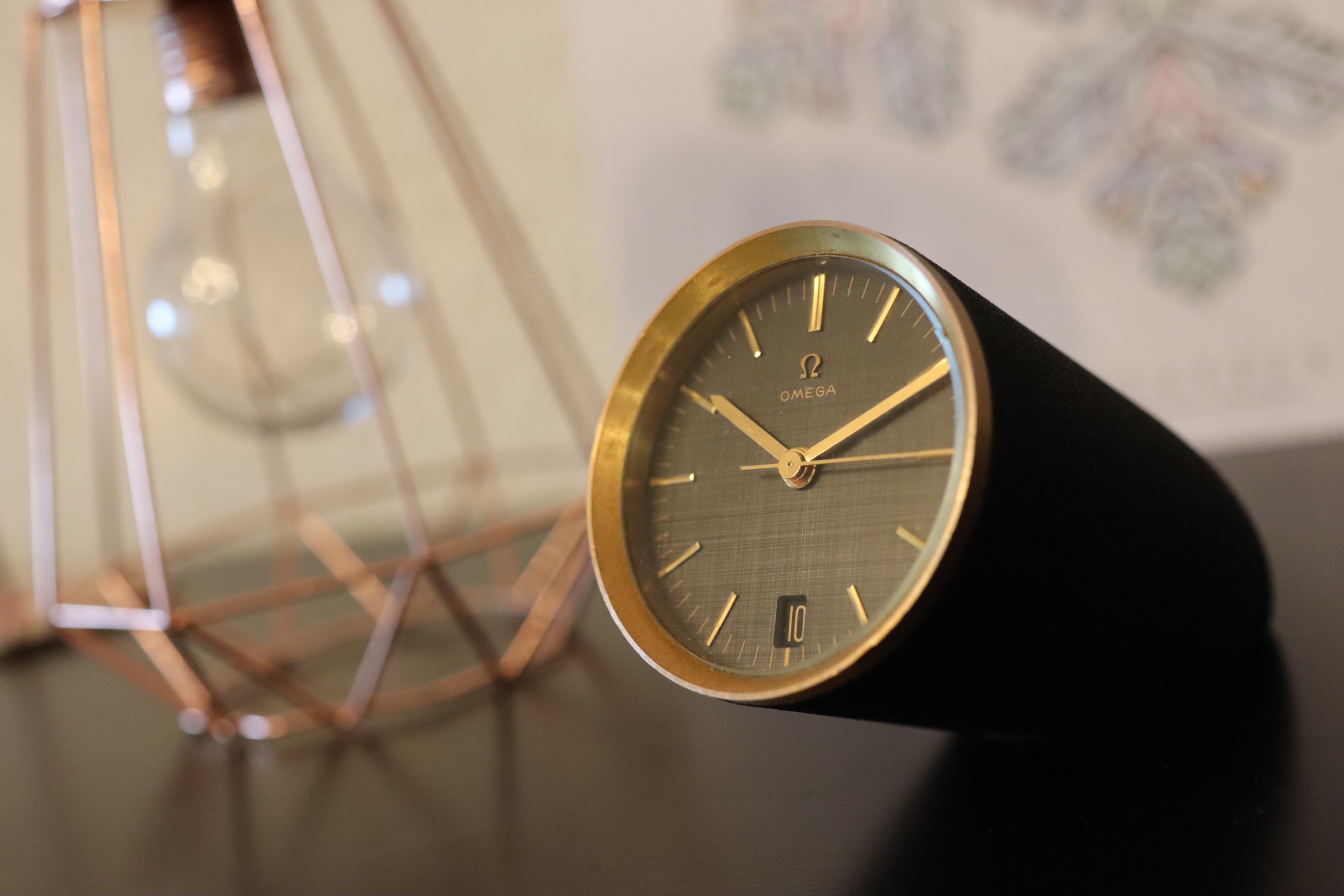

My second favorite is the ref. 5562
It has a black metal body and a black linen dial with gold accents.
Superb and very elegant variation 🥰

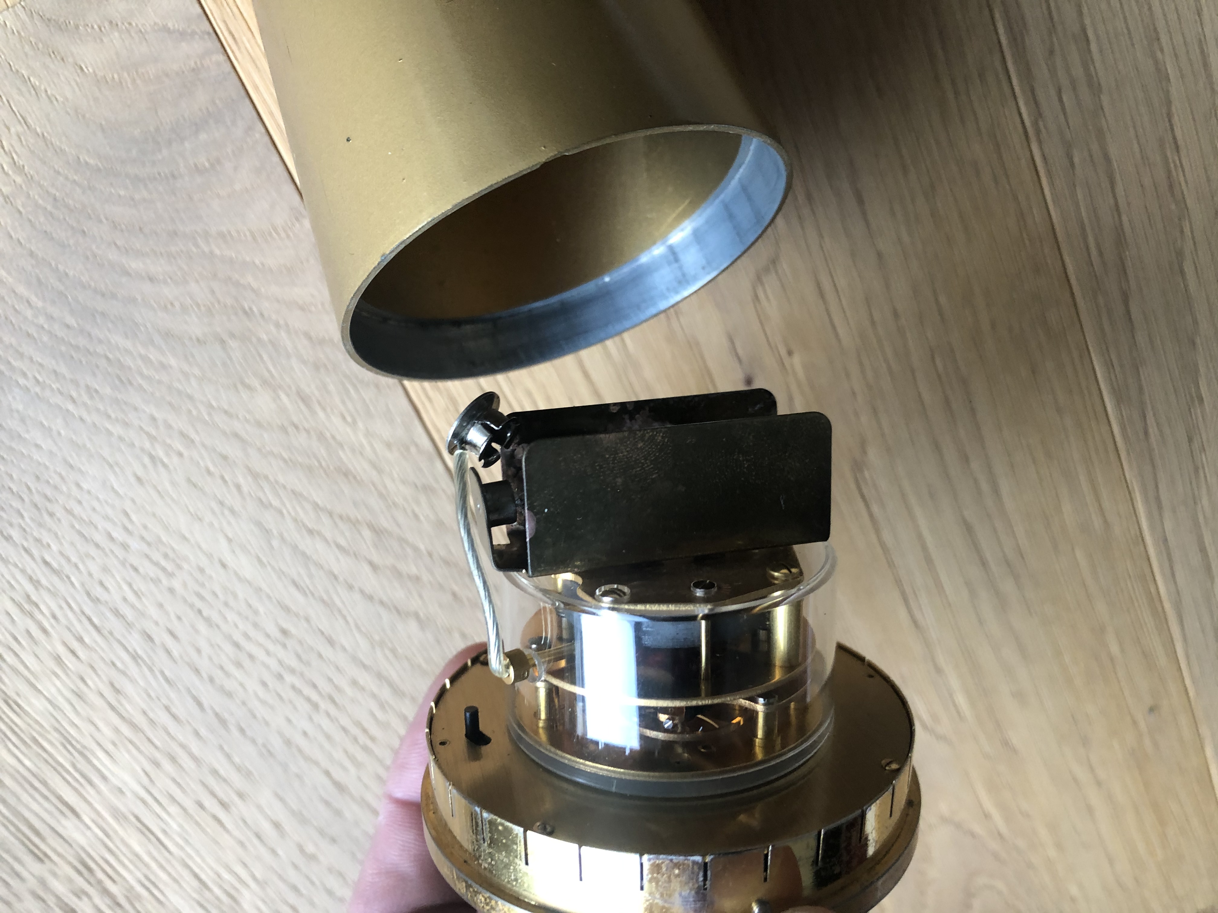

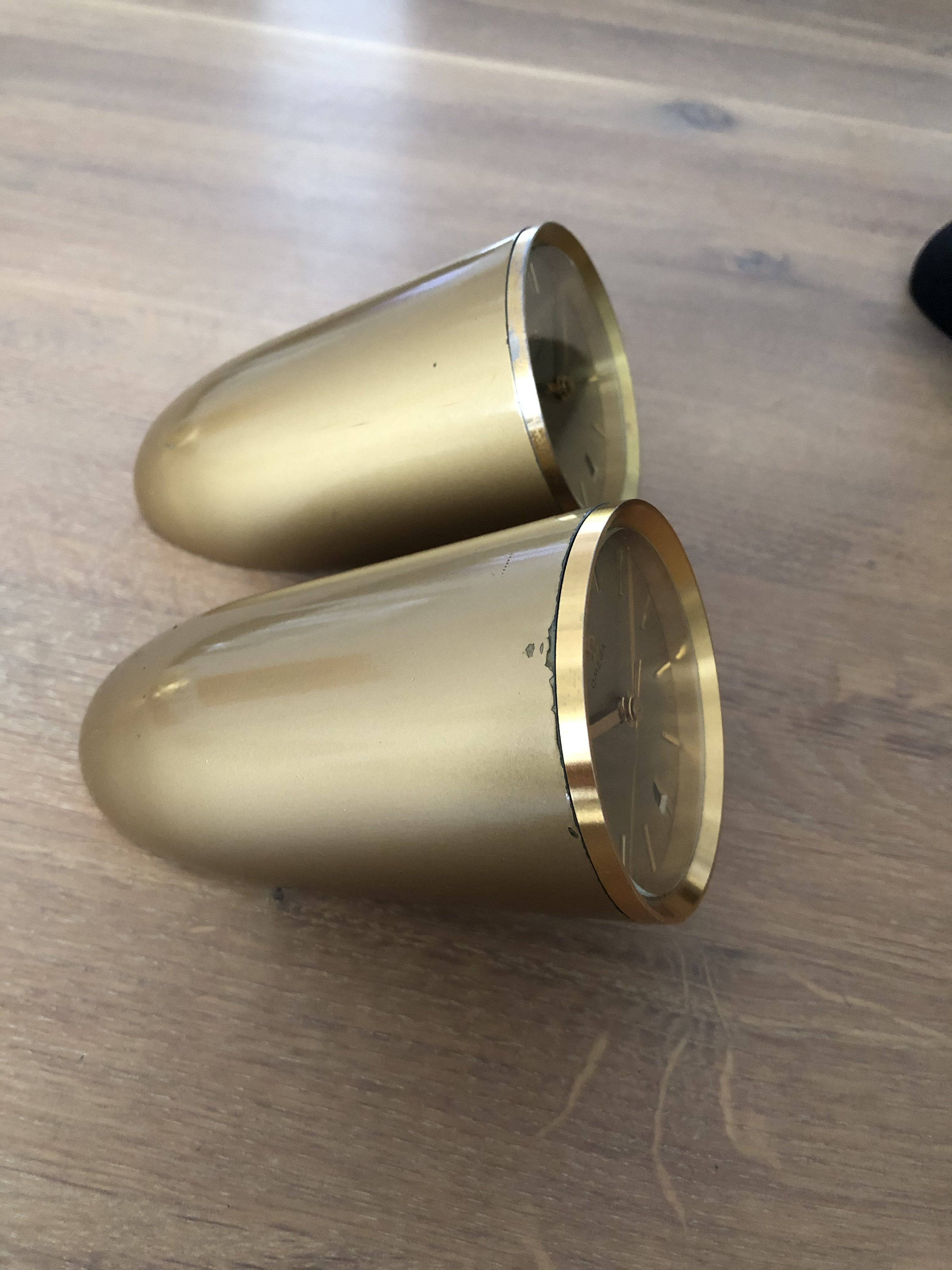

As a side note mine (5556 - sorry no pics handy) had a problem so I took it to my trusty watchmaker who's been around the block and he quickly recognized the movement as it was used for quite a few clocks in the 60s. I must have written about it somewhere but I seem to remember a reference to a "squirrel" maybe, will have to try to find my notes. So Omega "bought" that design and turned it into Cal 095.

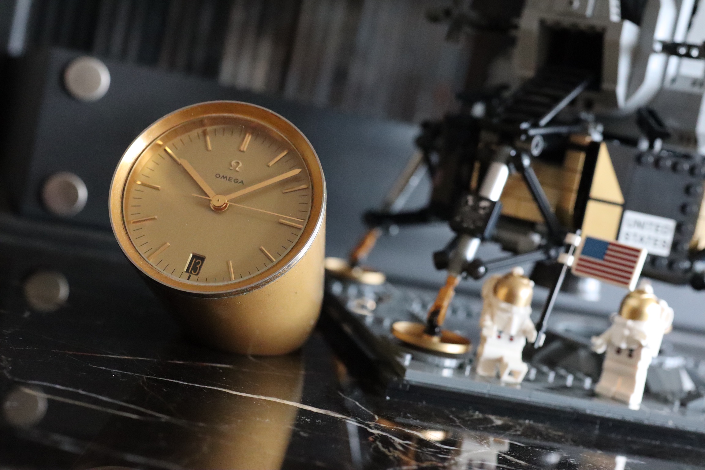

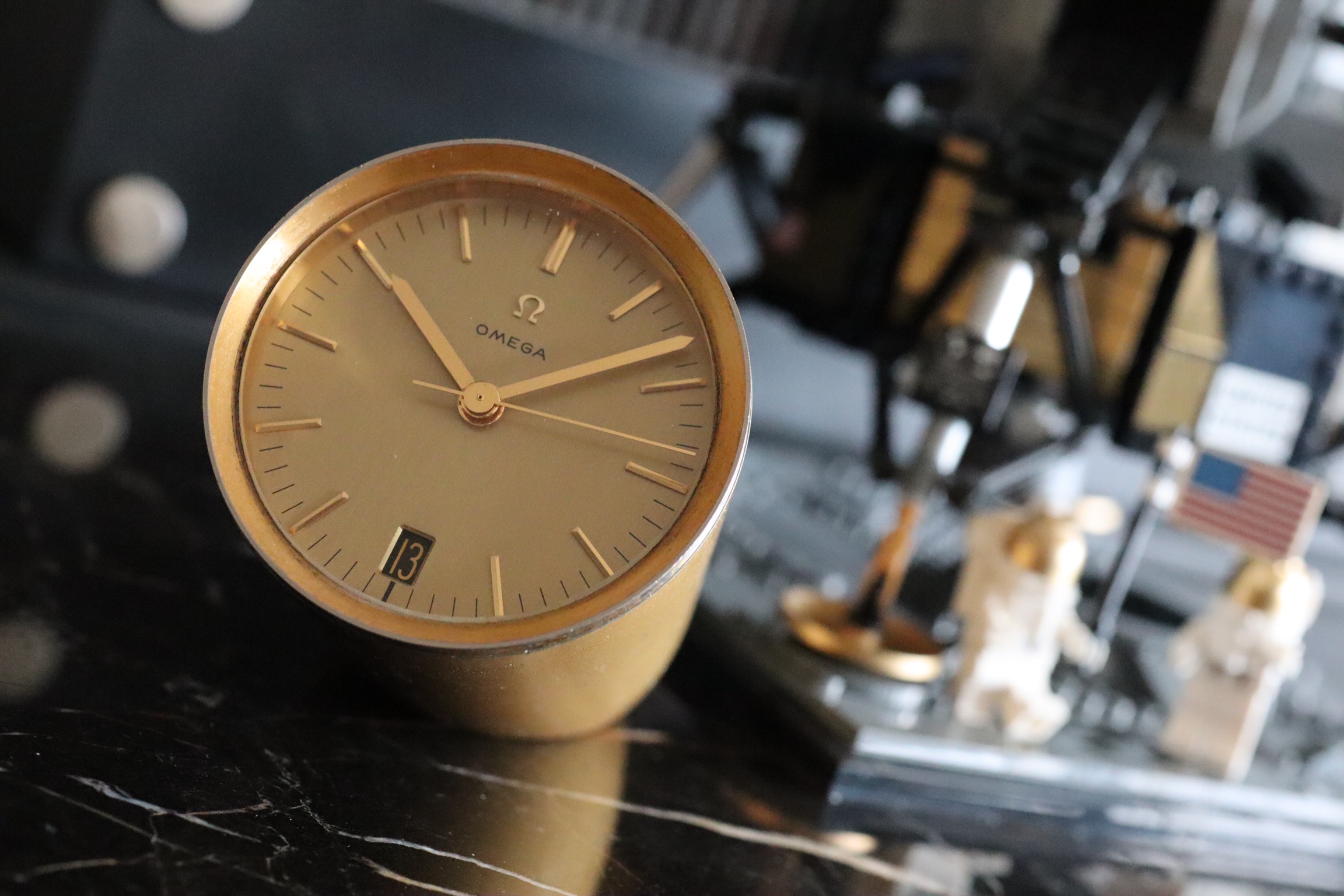

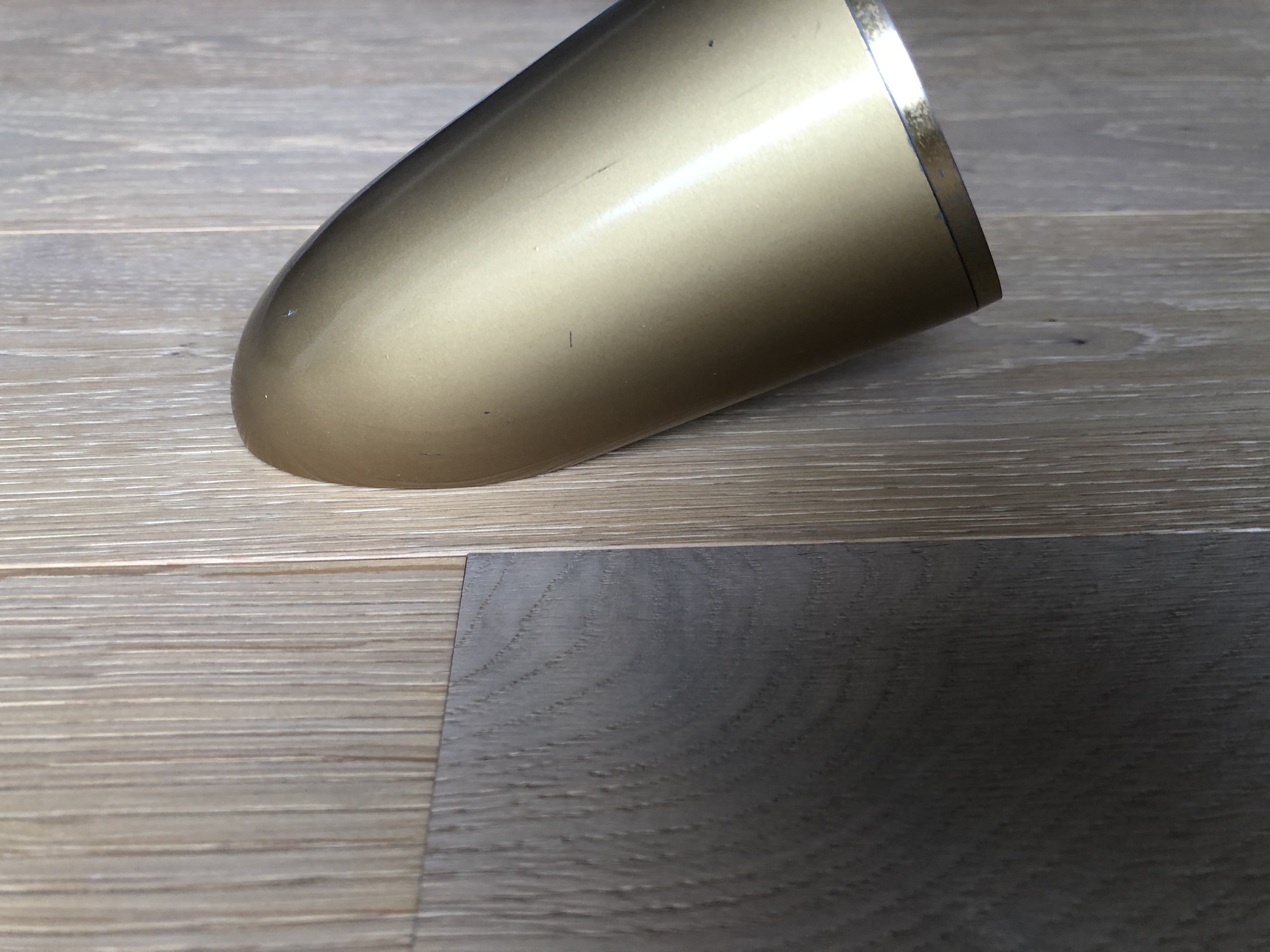

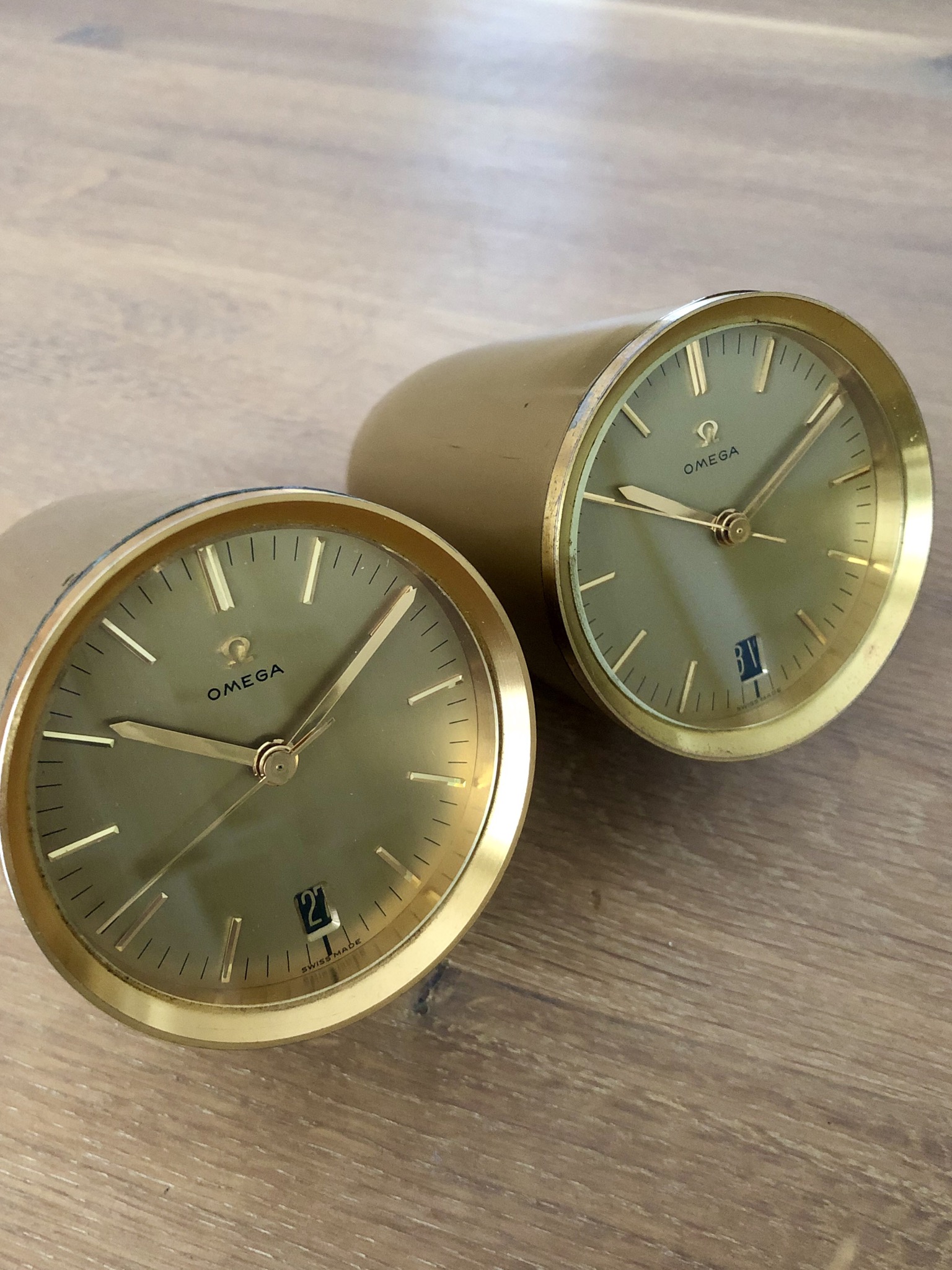

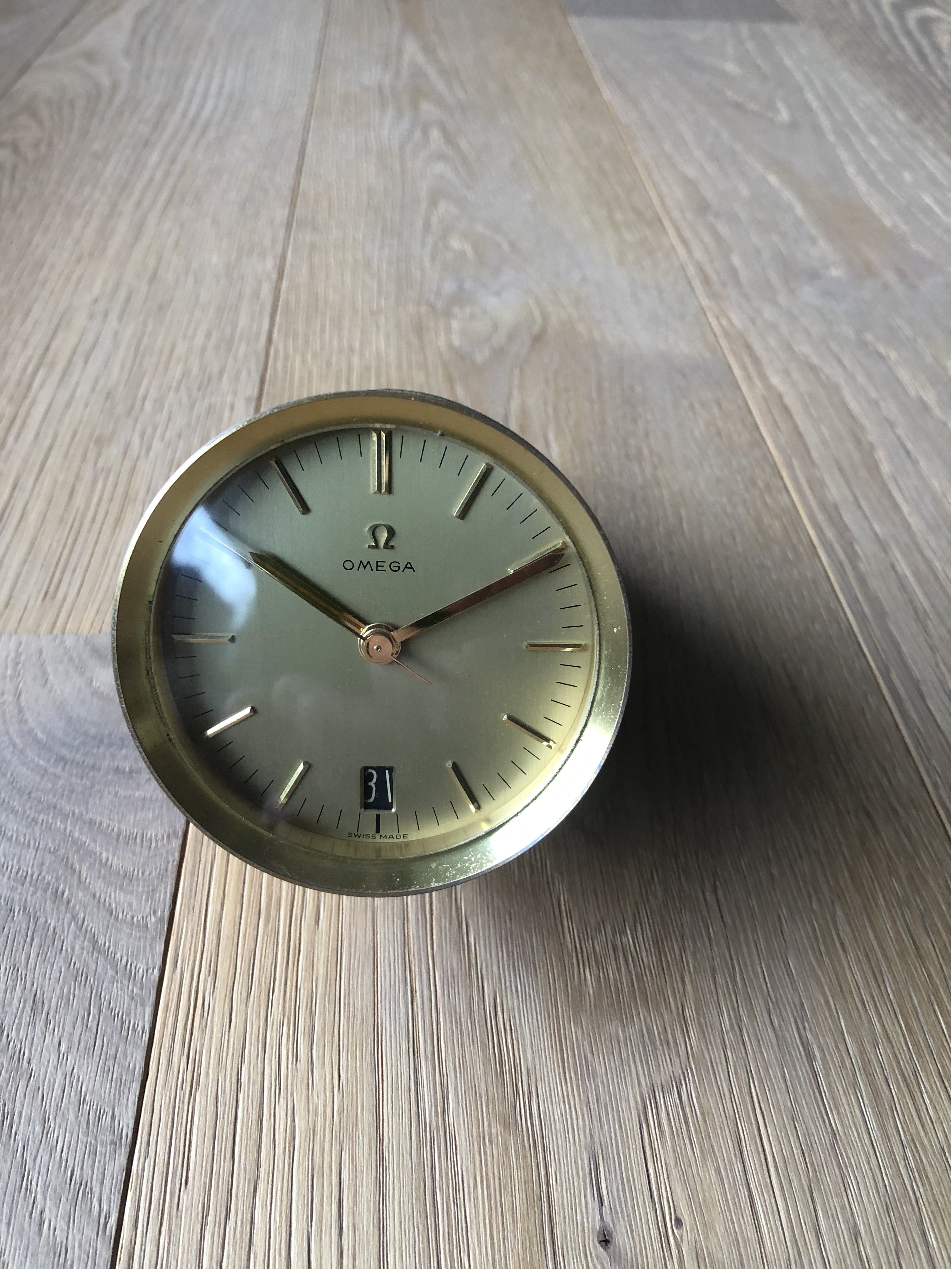

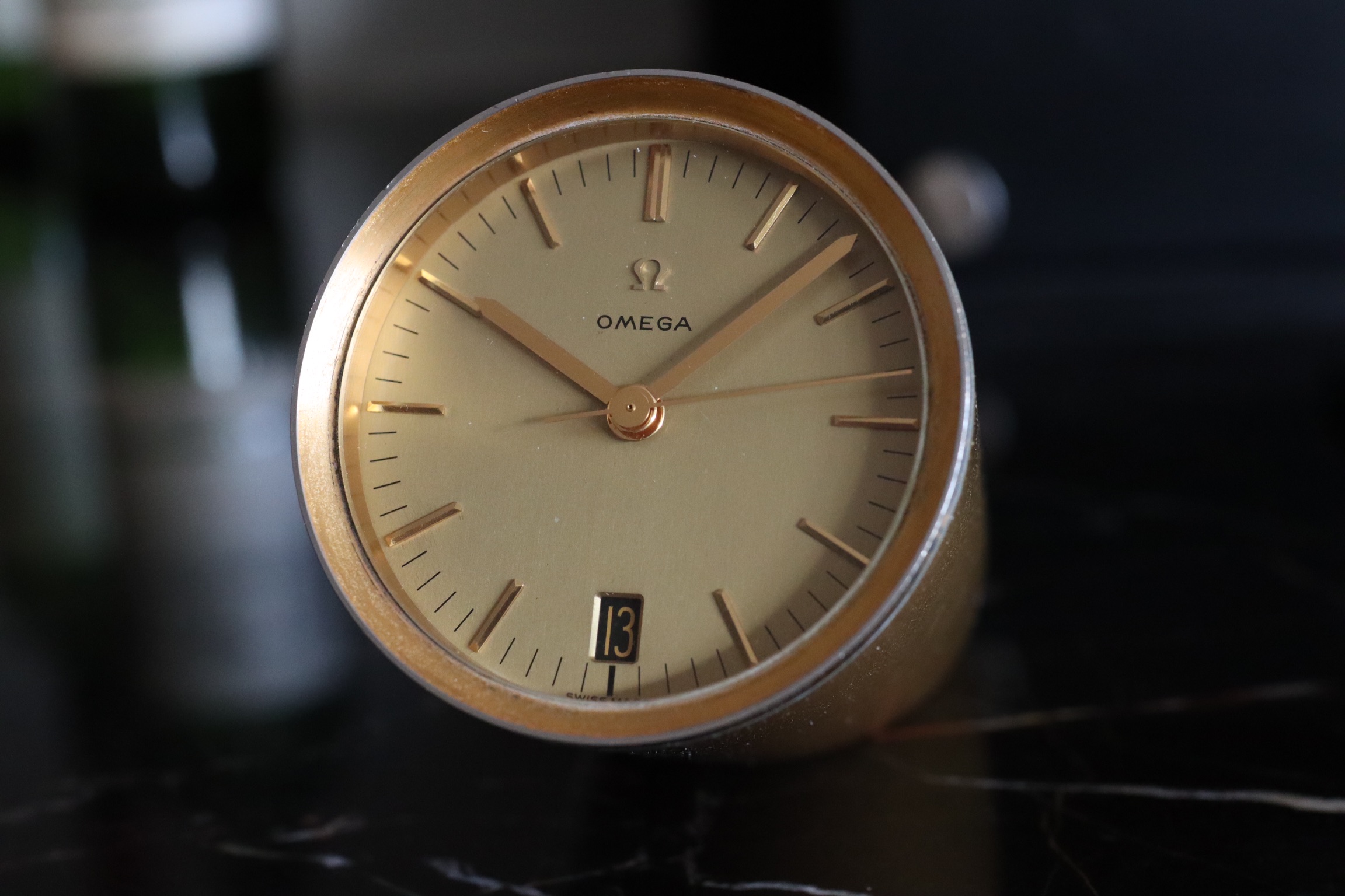

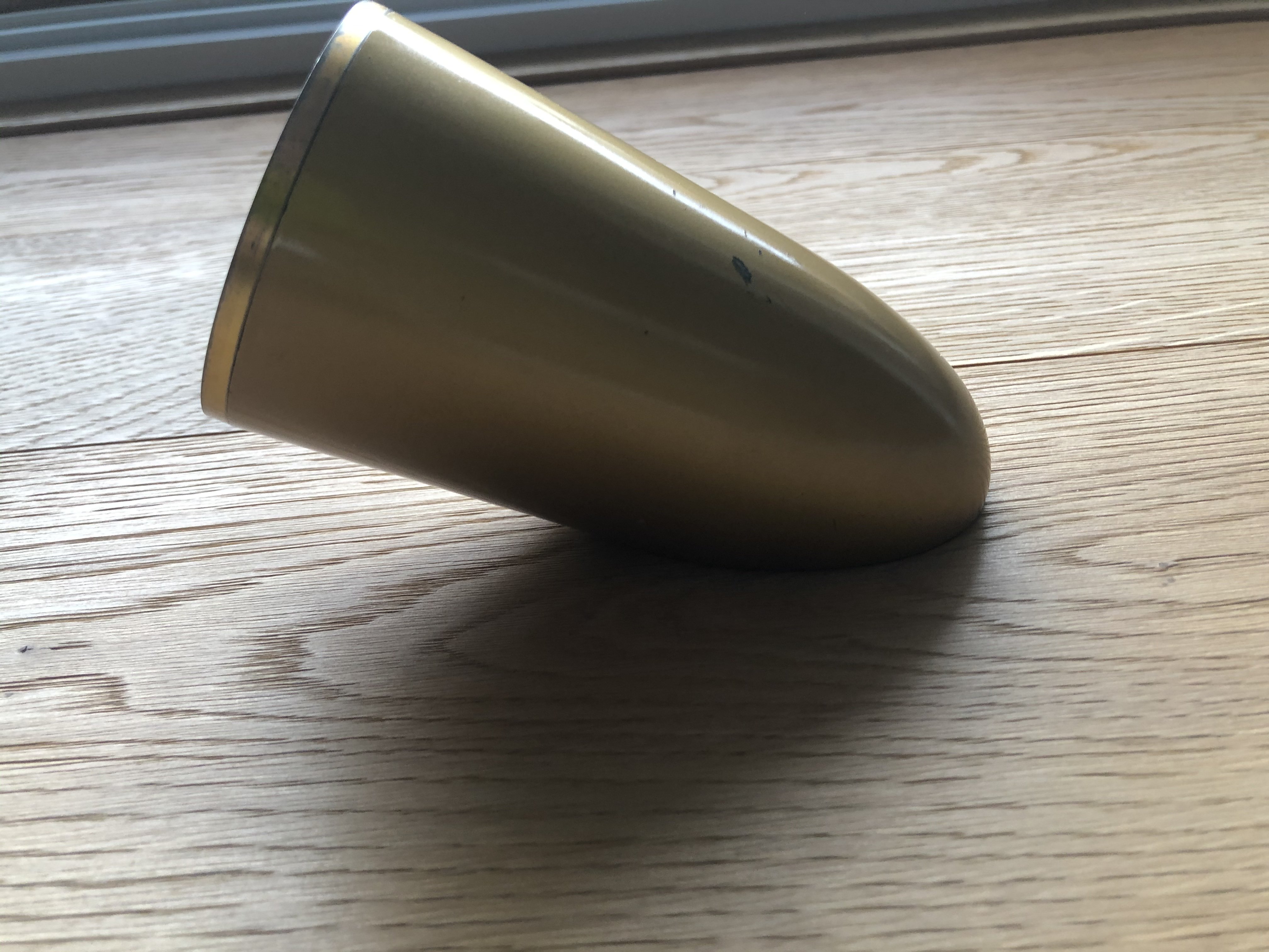

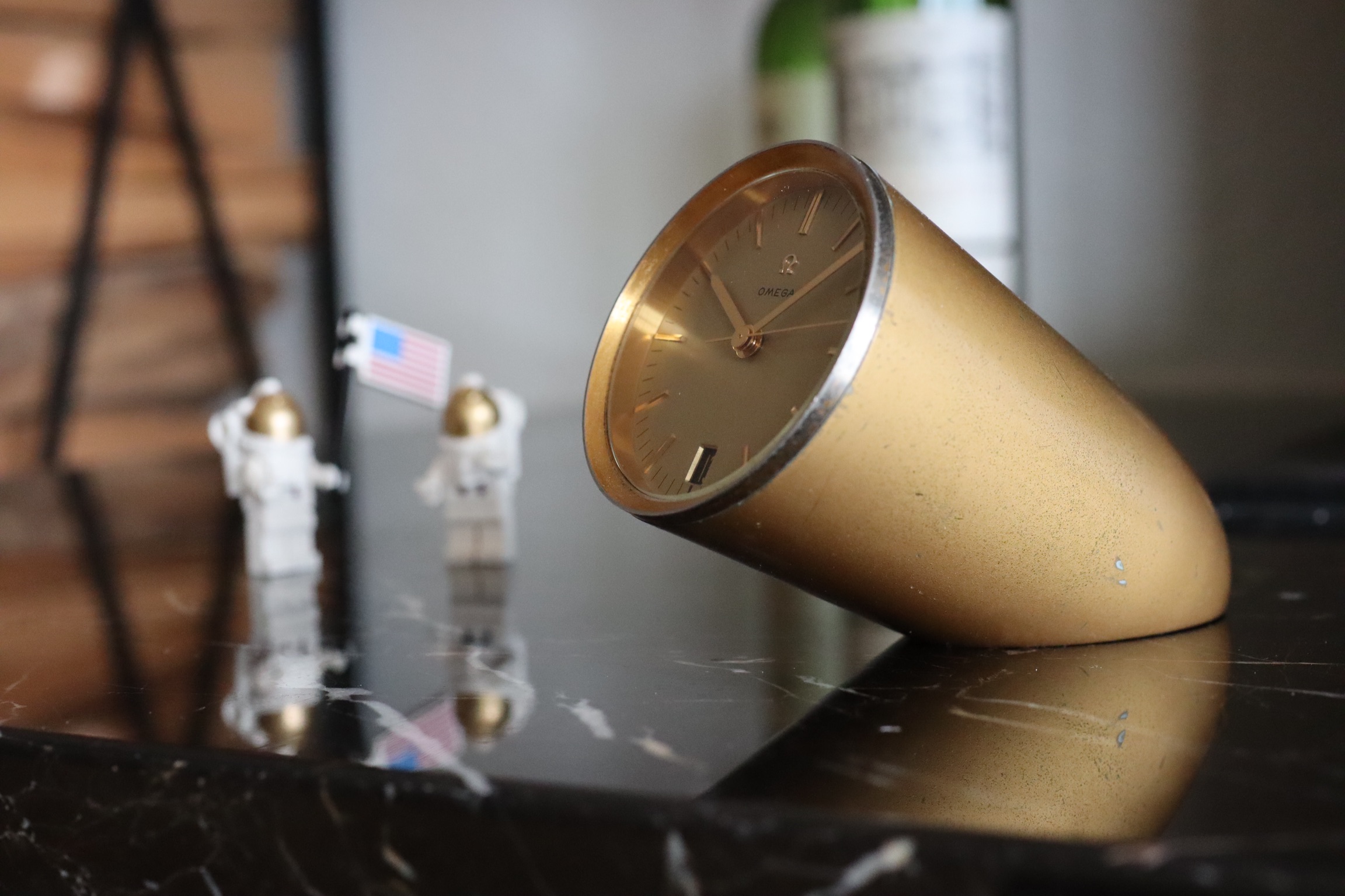

Let me help you 😀 here we go with some pics of my 5556 :
It has a gold metal body and a champagne dial with gold accents.

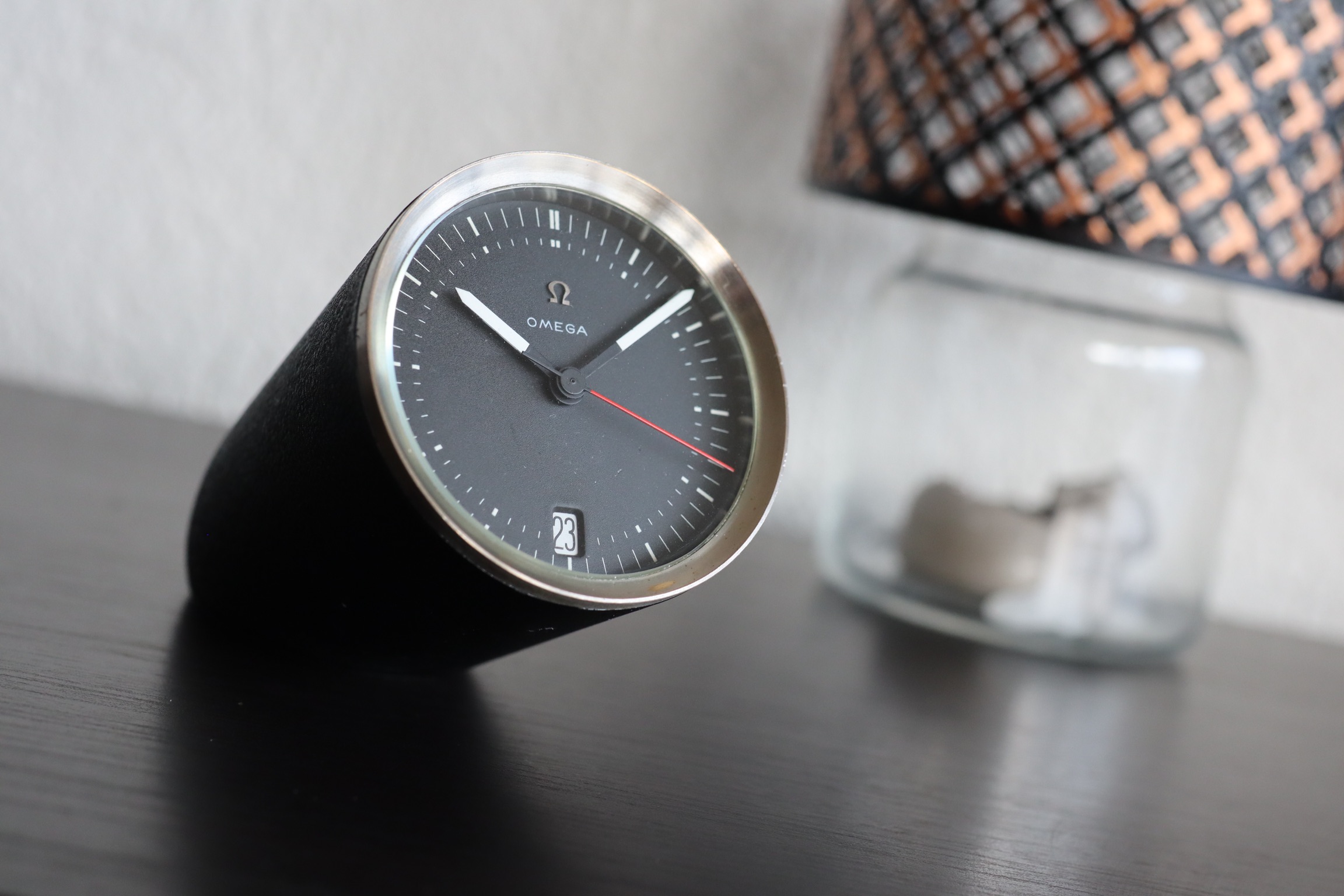

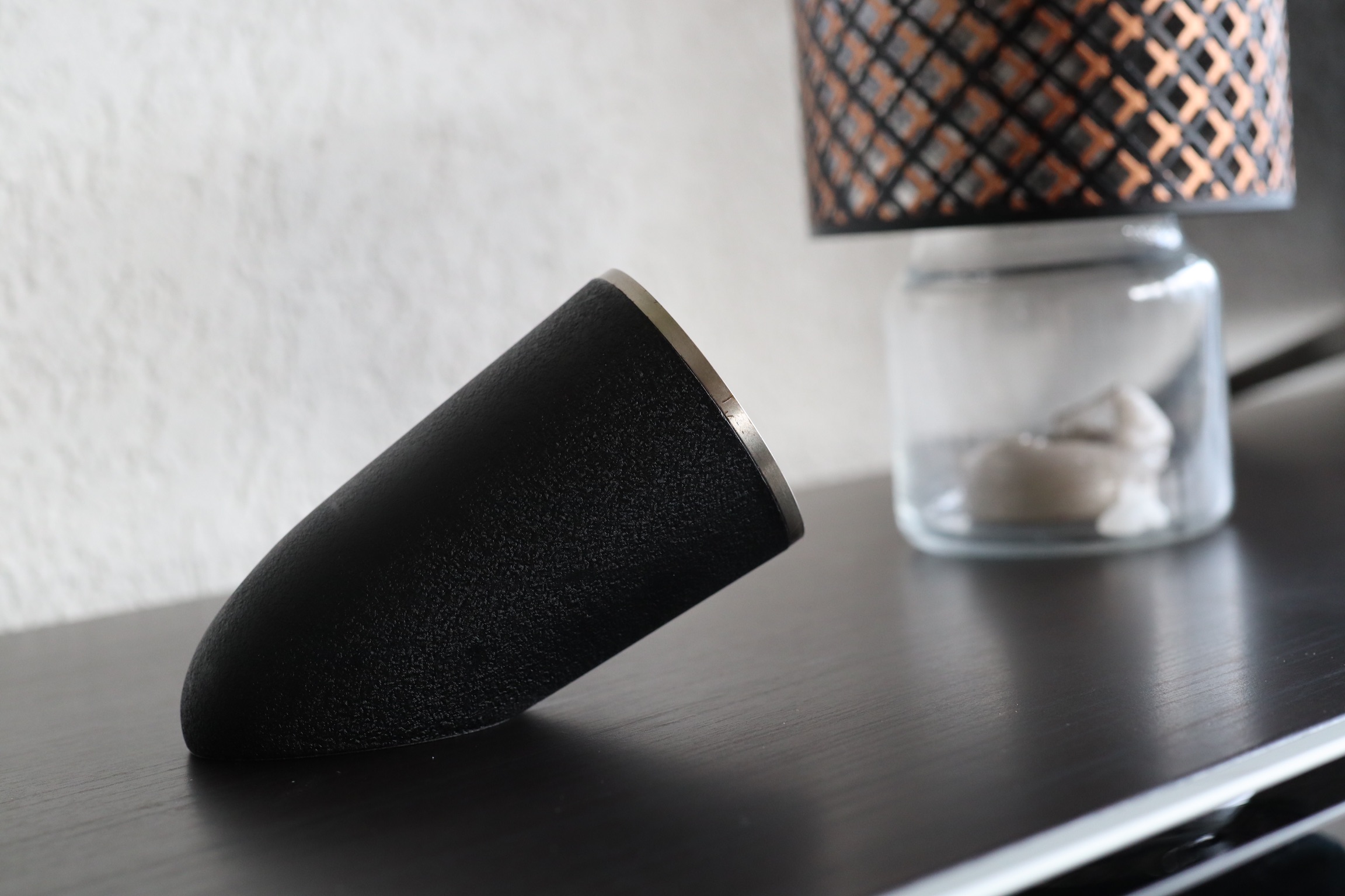

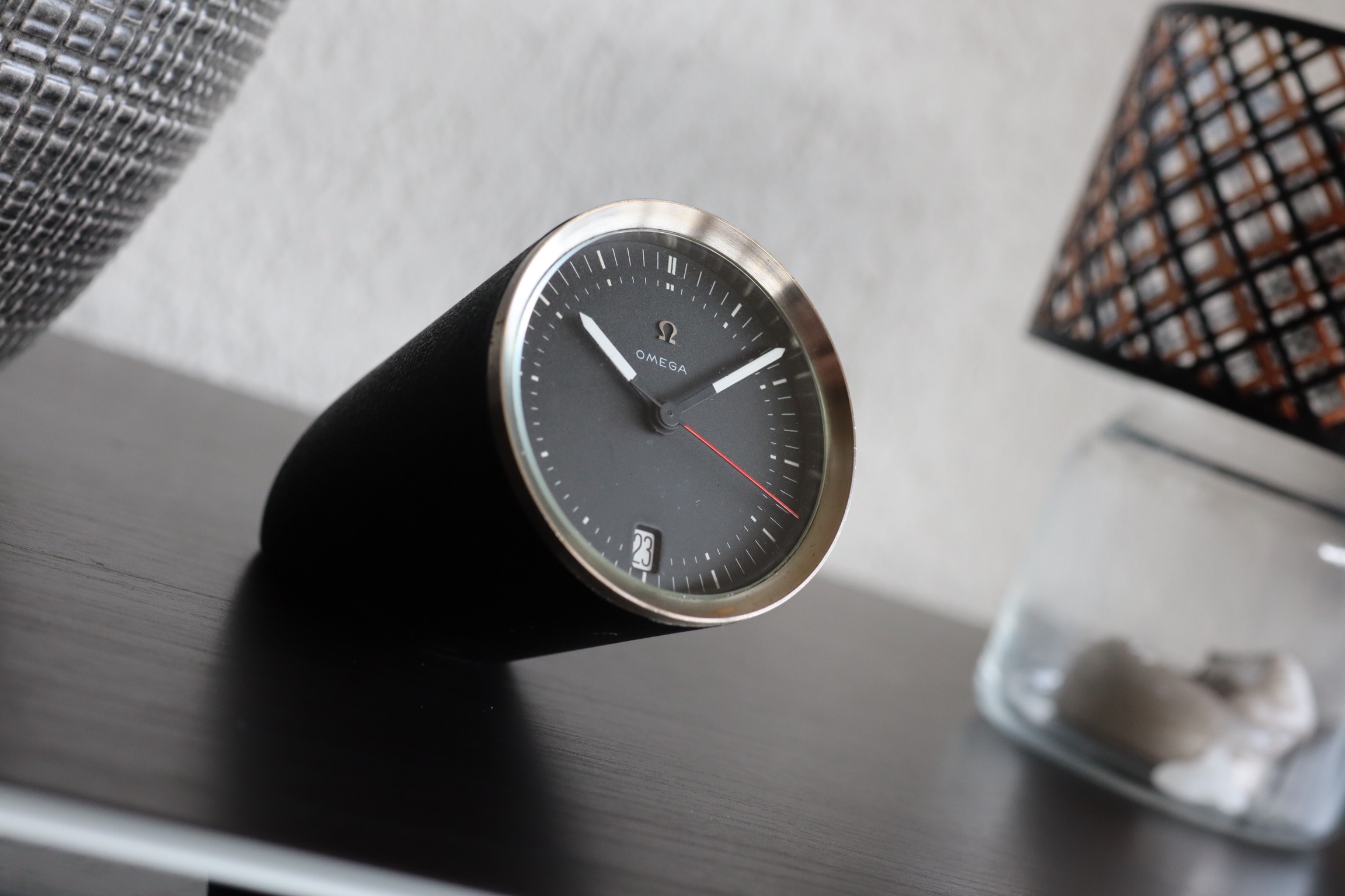

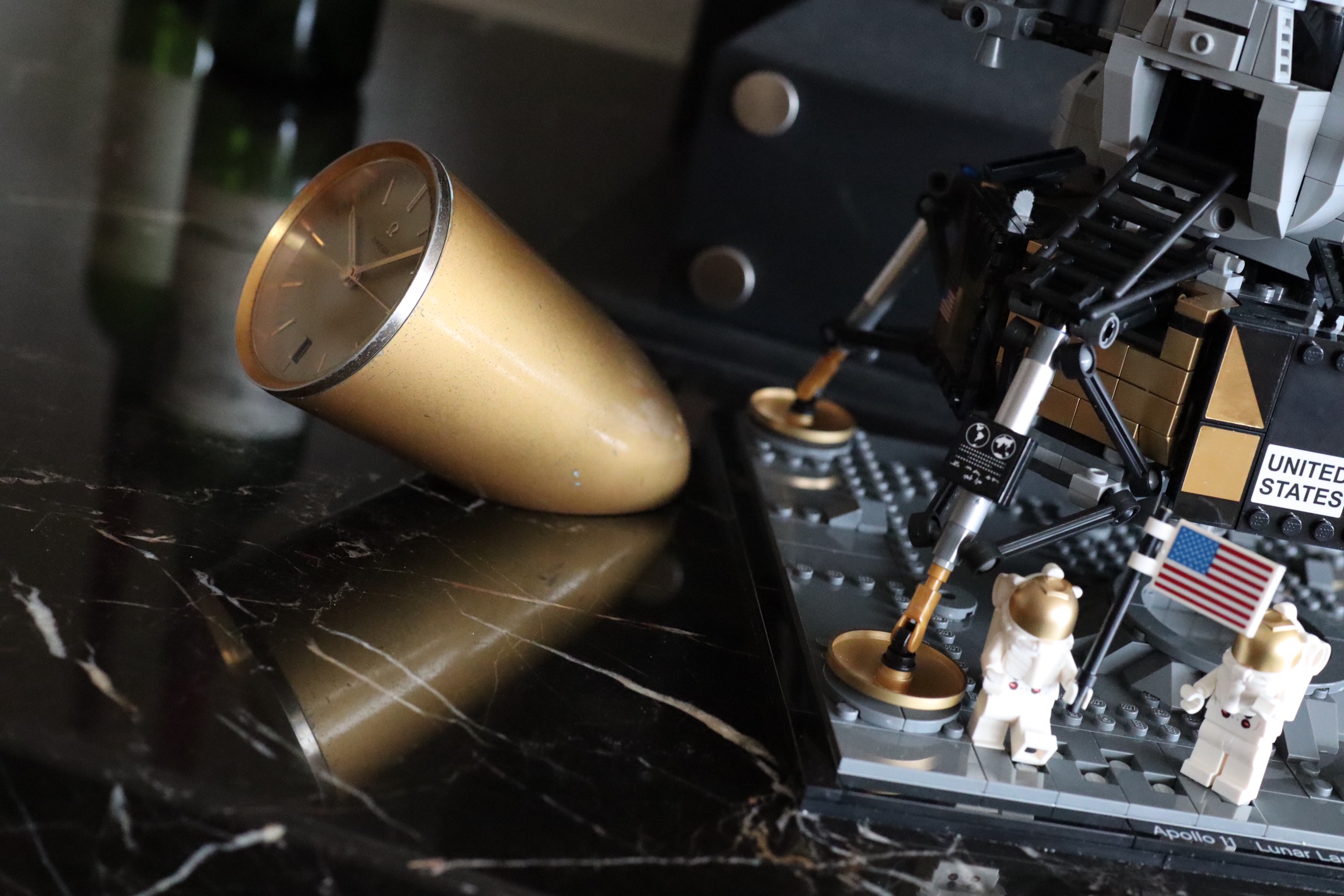

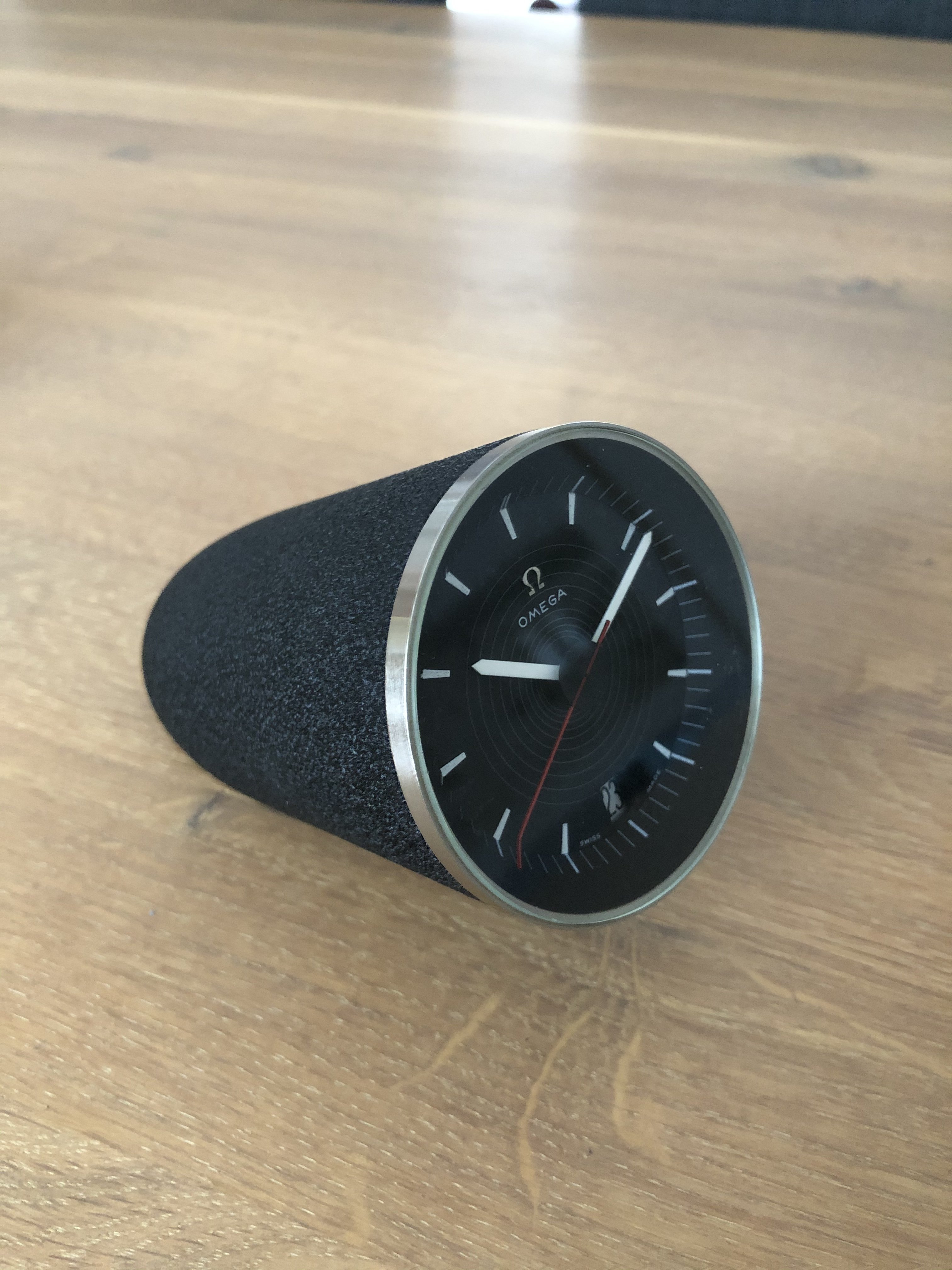

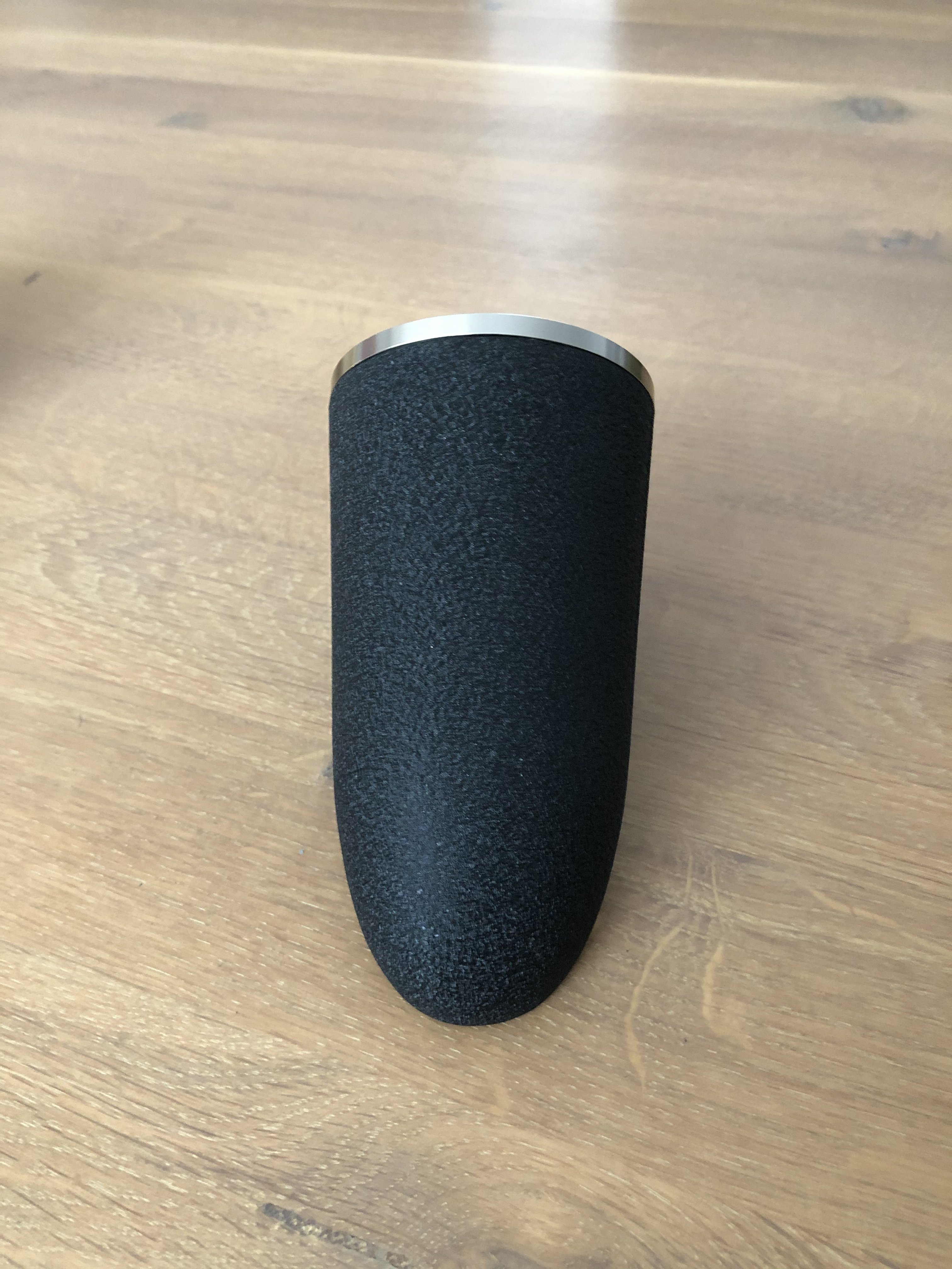

Another variation and another style, here is my 5555 :
It has a black metal body and a matte black dial with white accents.
This variation looks less classy than the others with its bi-colored hands and that red running seconds hand. Looks great nevertheless, imho.

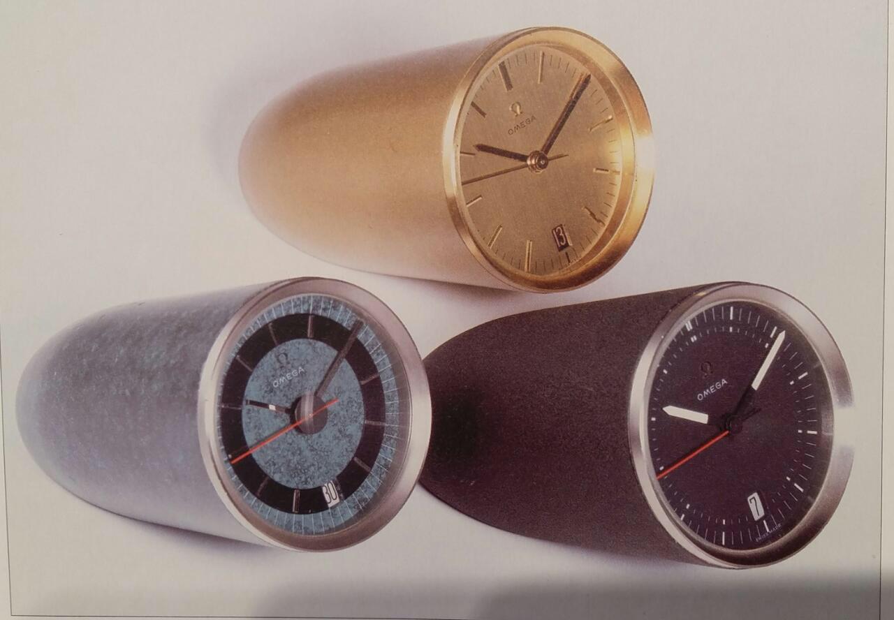

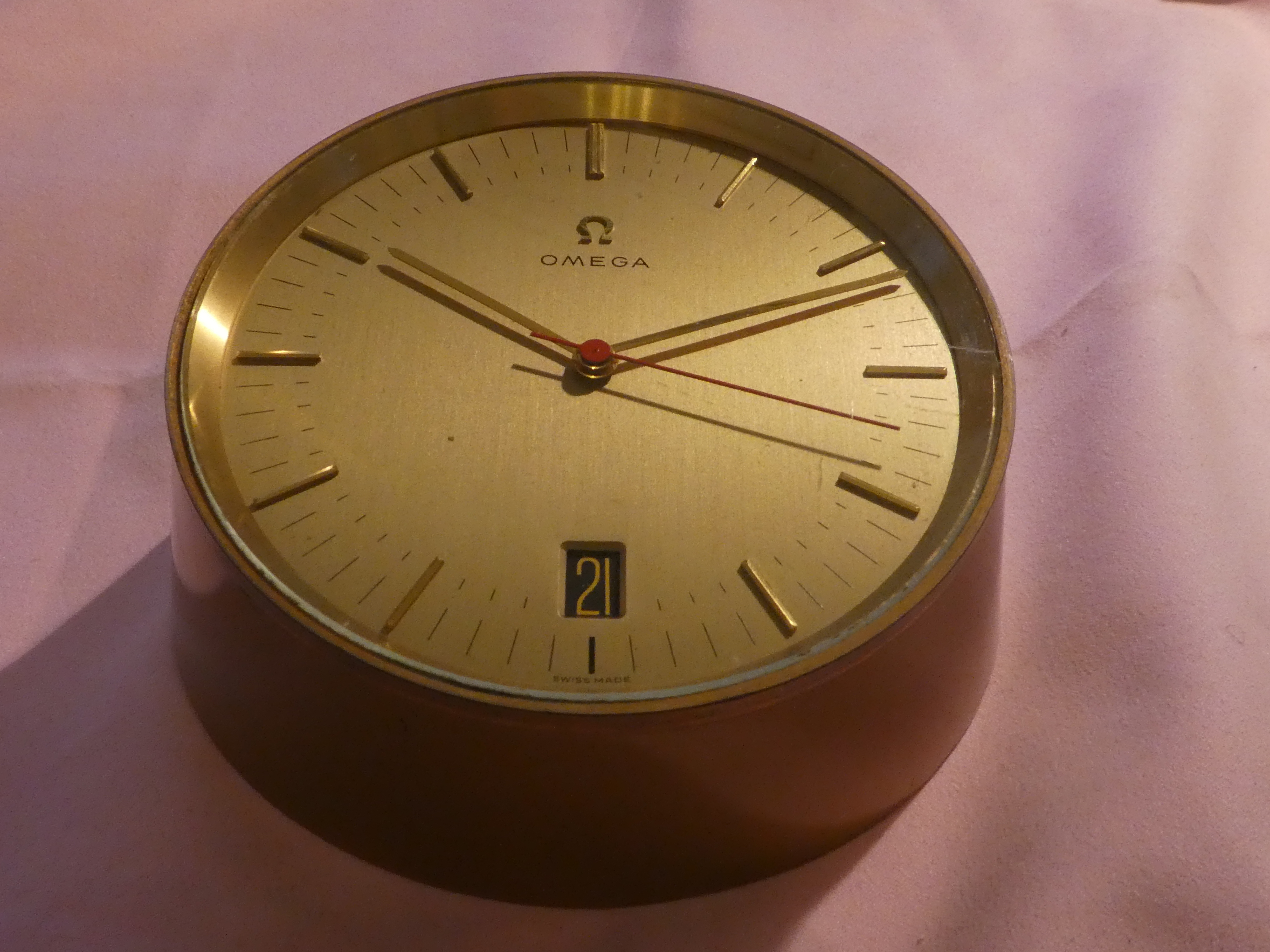

122
218
Your pictures are great. Here some more watches and variations of the Rocket. I just love them

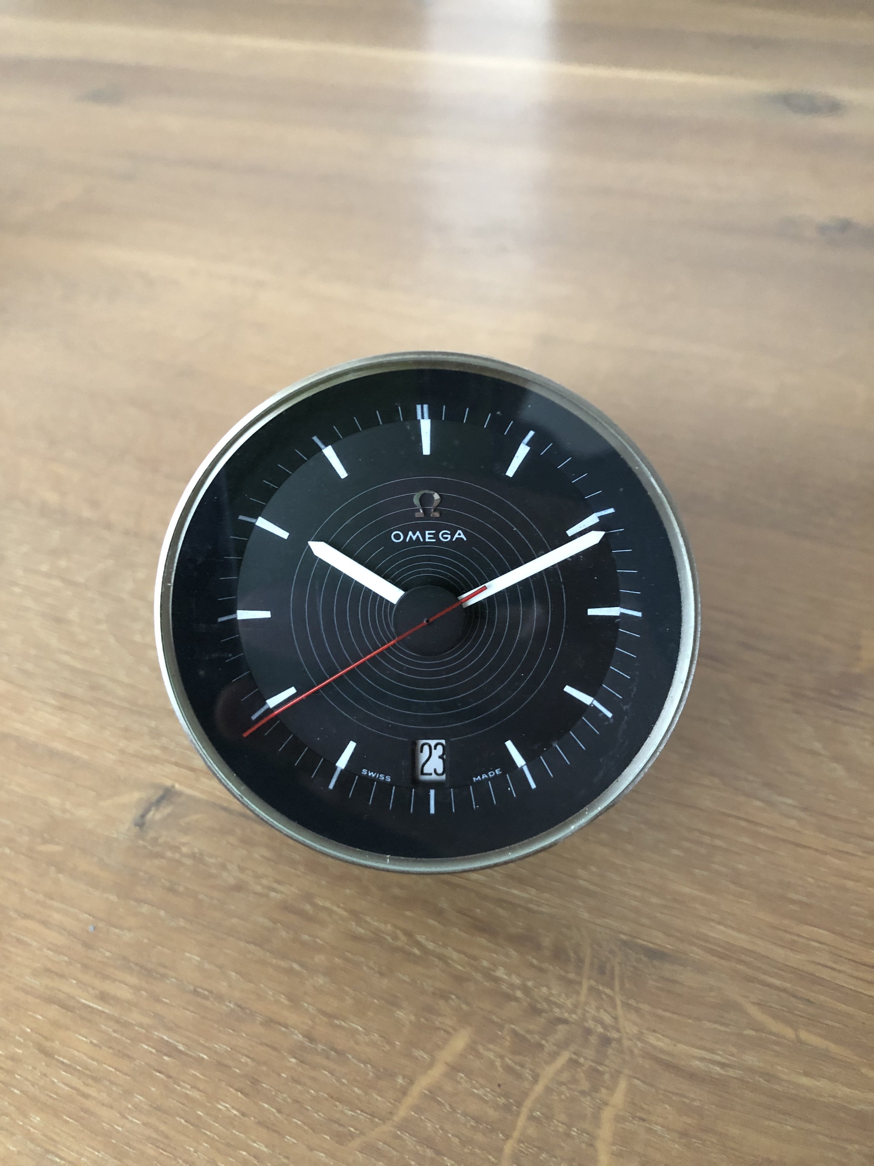

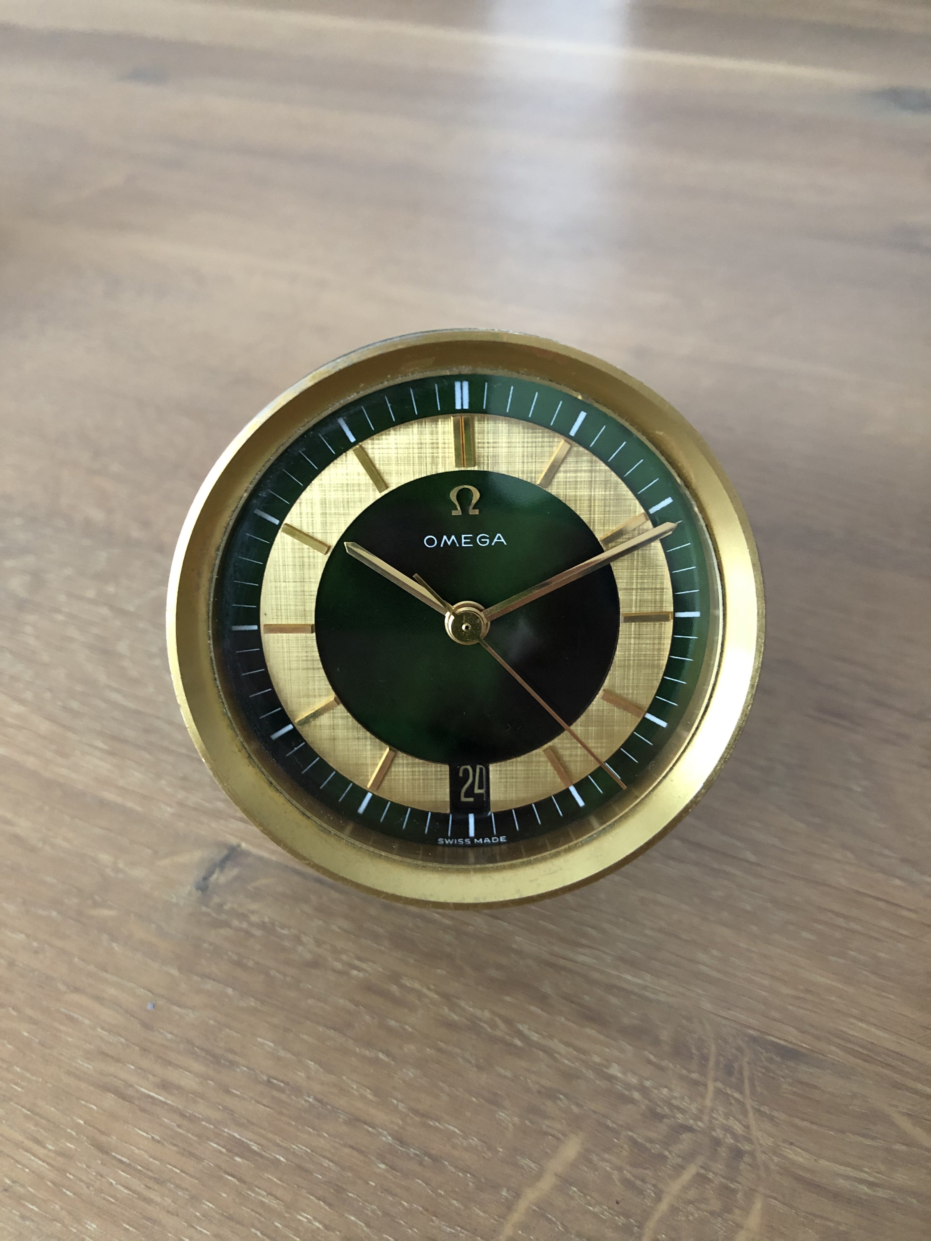

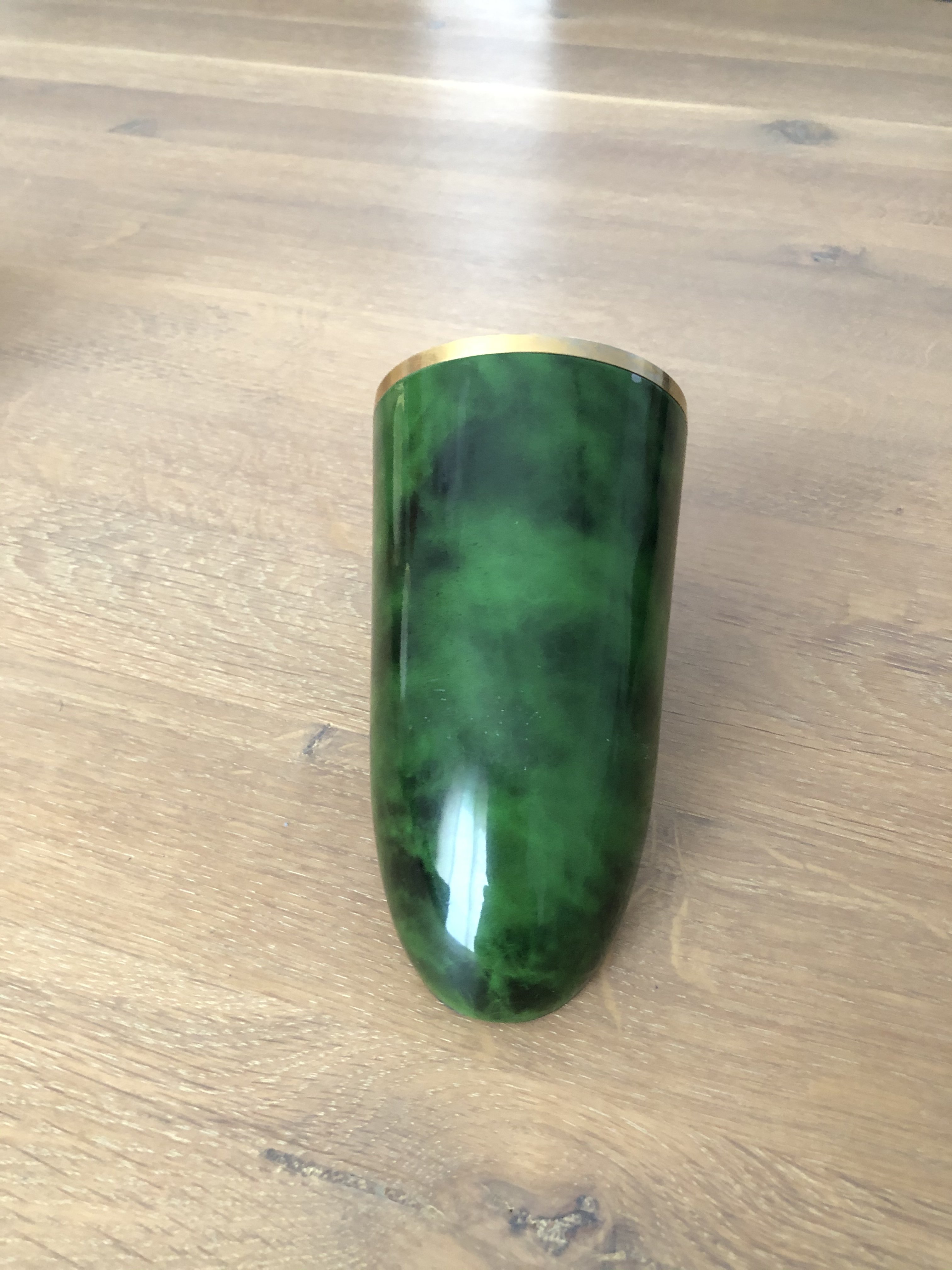

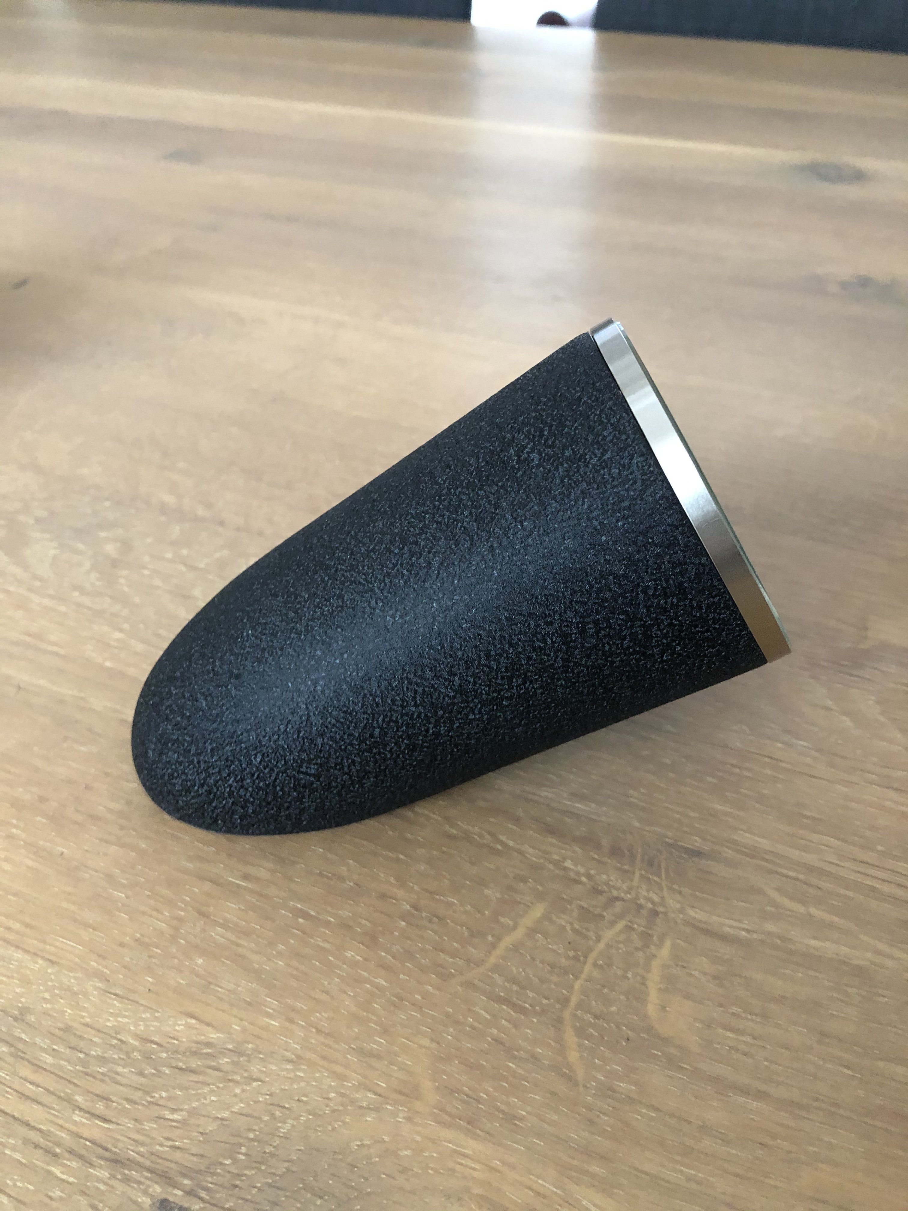

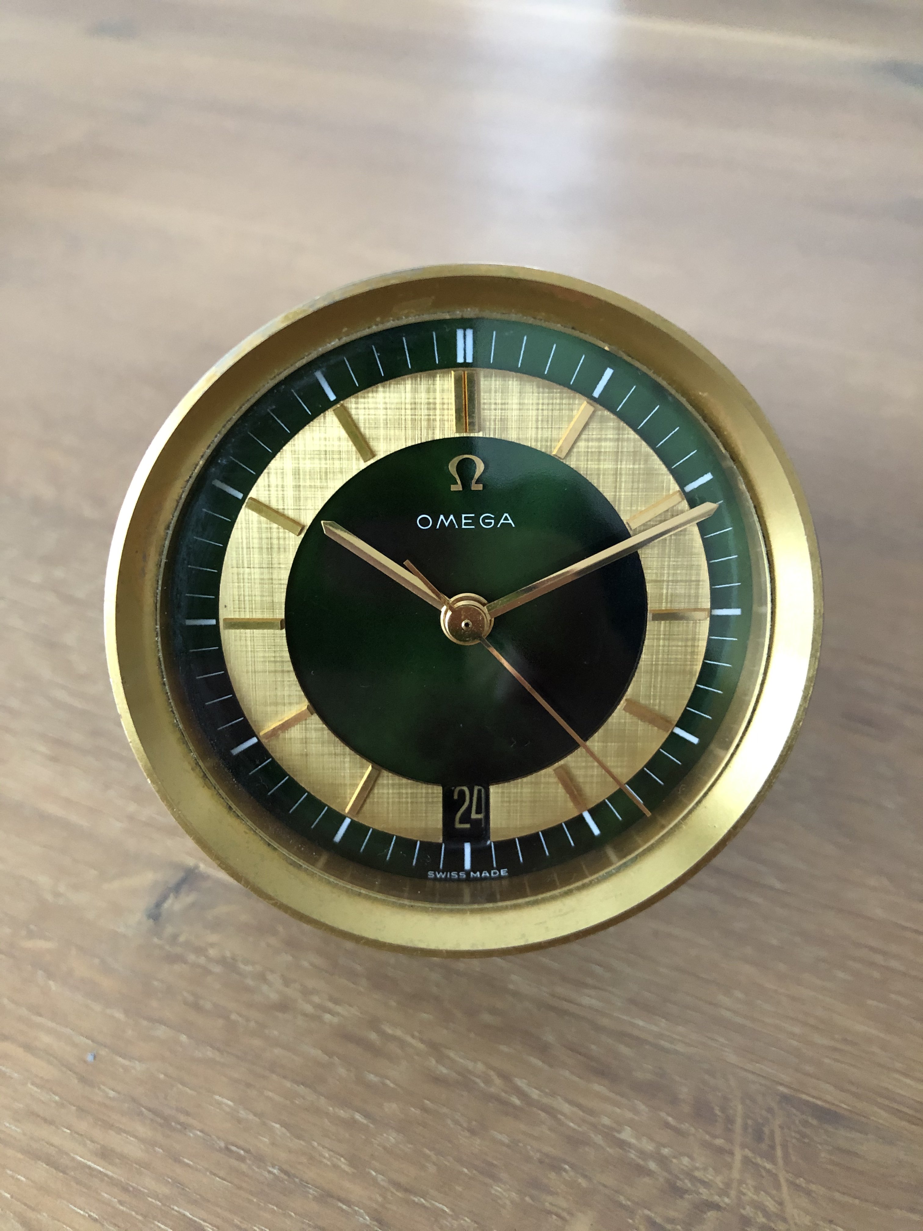

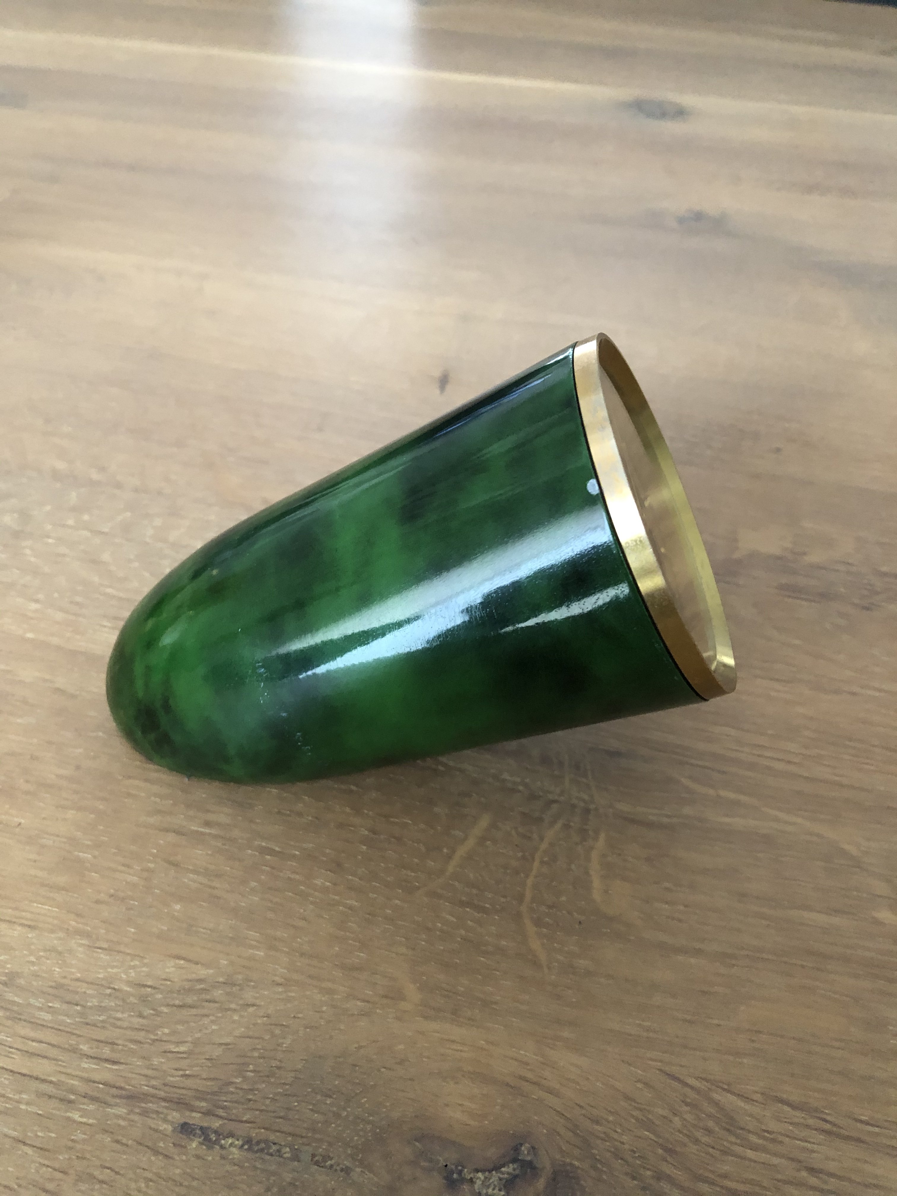

So we are adding:
5570 Green marble one
5563 black with black dial and white circles
122
218
And here the other black one. Interesting the outer side of the dial has a step and angle
