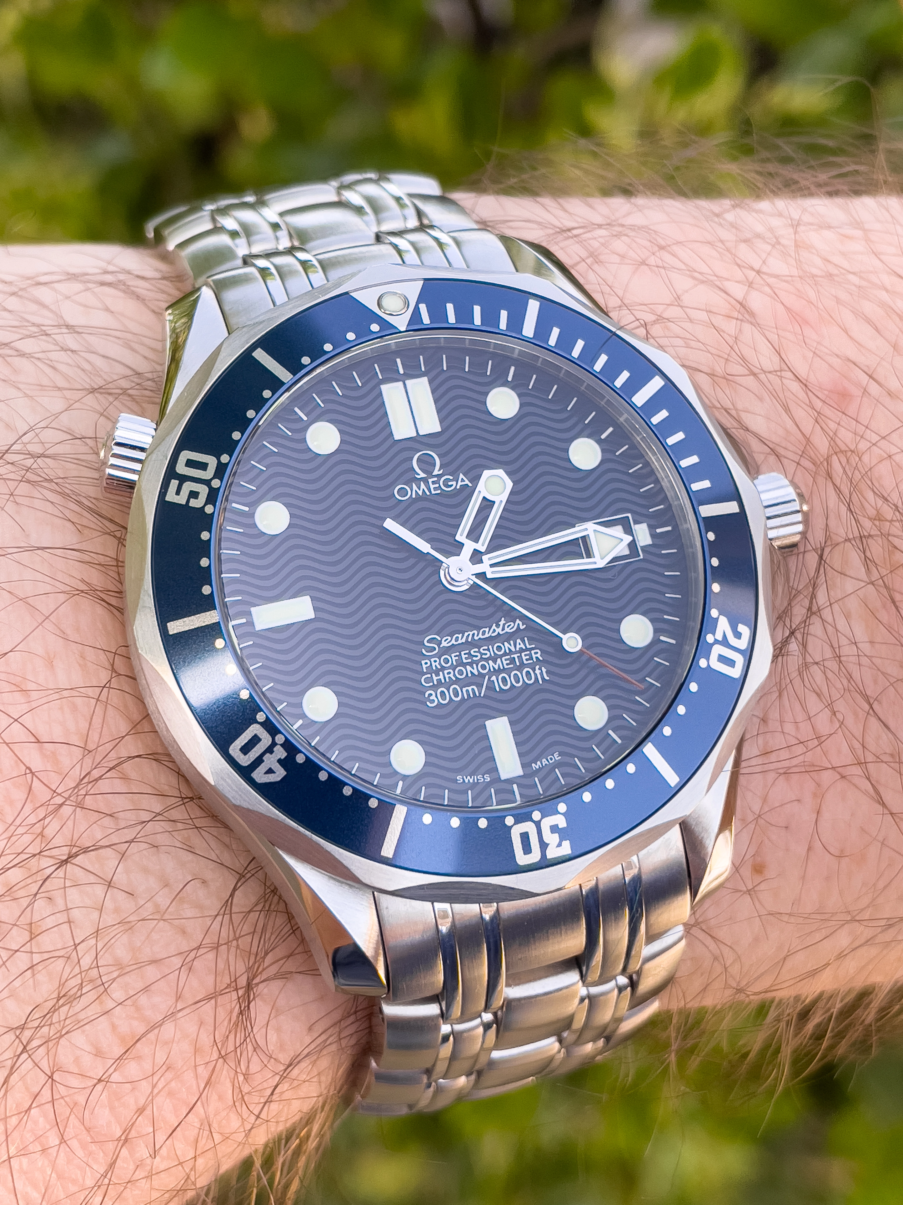

I don’t have a before pic, sorry Dave, but this was refinished during a factory service and it looks brand new with incredibly sharp lines.
Looks good!

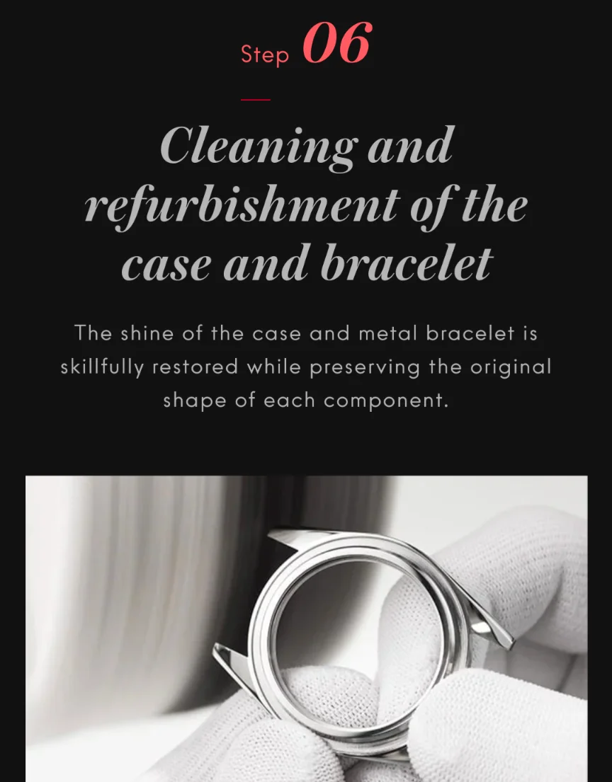

This has never been the policy for OSC's in the USA.
Edit - I just checked the Omega website in the United States. Case and bracelet refurbishment is included in a "full service."
https://www.omegawatches.com/en-us/...s-and-prices/main-steps-of-a-complete-service

There's a difference between warranty claim and a normal complete service, my A11 50SS also didn't get polished when I sent it in for a warranty claim, however a complete service at the prices they charge has step 6 included at no additional charge;
Beautiful.
I'd like to send mine in but it's keeping amazingly good time so I can't justify it. I love the 1120 movement.

I don't know why your watch didn't get refurbished first time it went in, but there are plenty of posts of refurbished watches that people were surprised about as they didn't ask/pay for it.
Even an Omega qualified watchmaker states it's part of a full service;

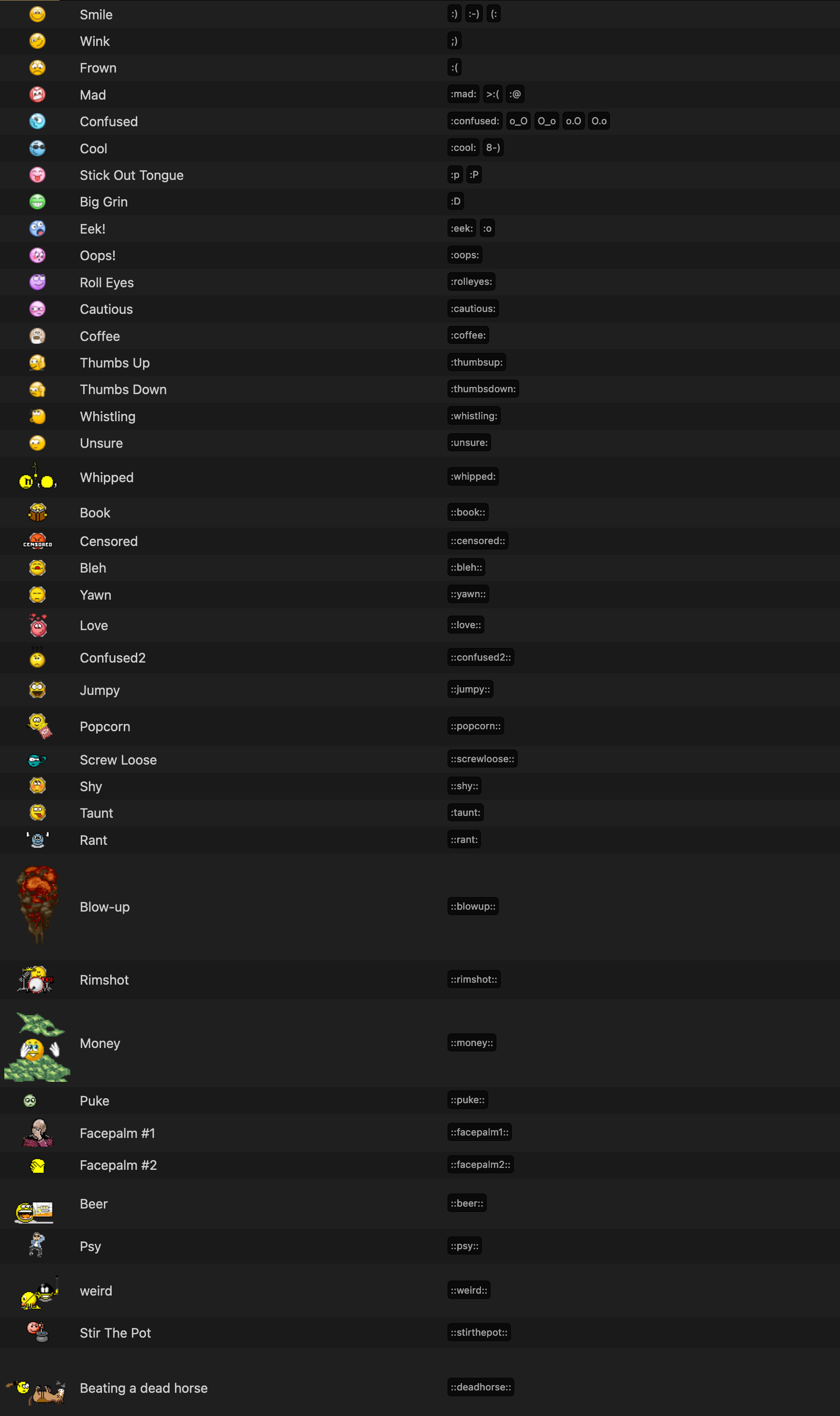

I really miss that dancing man emoji we used to have 🙁
