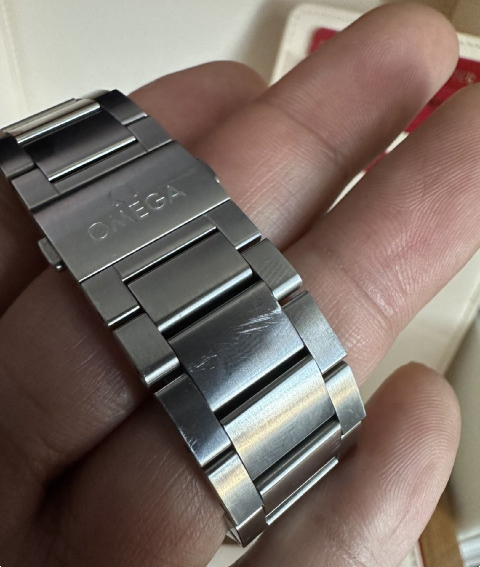

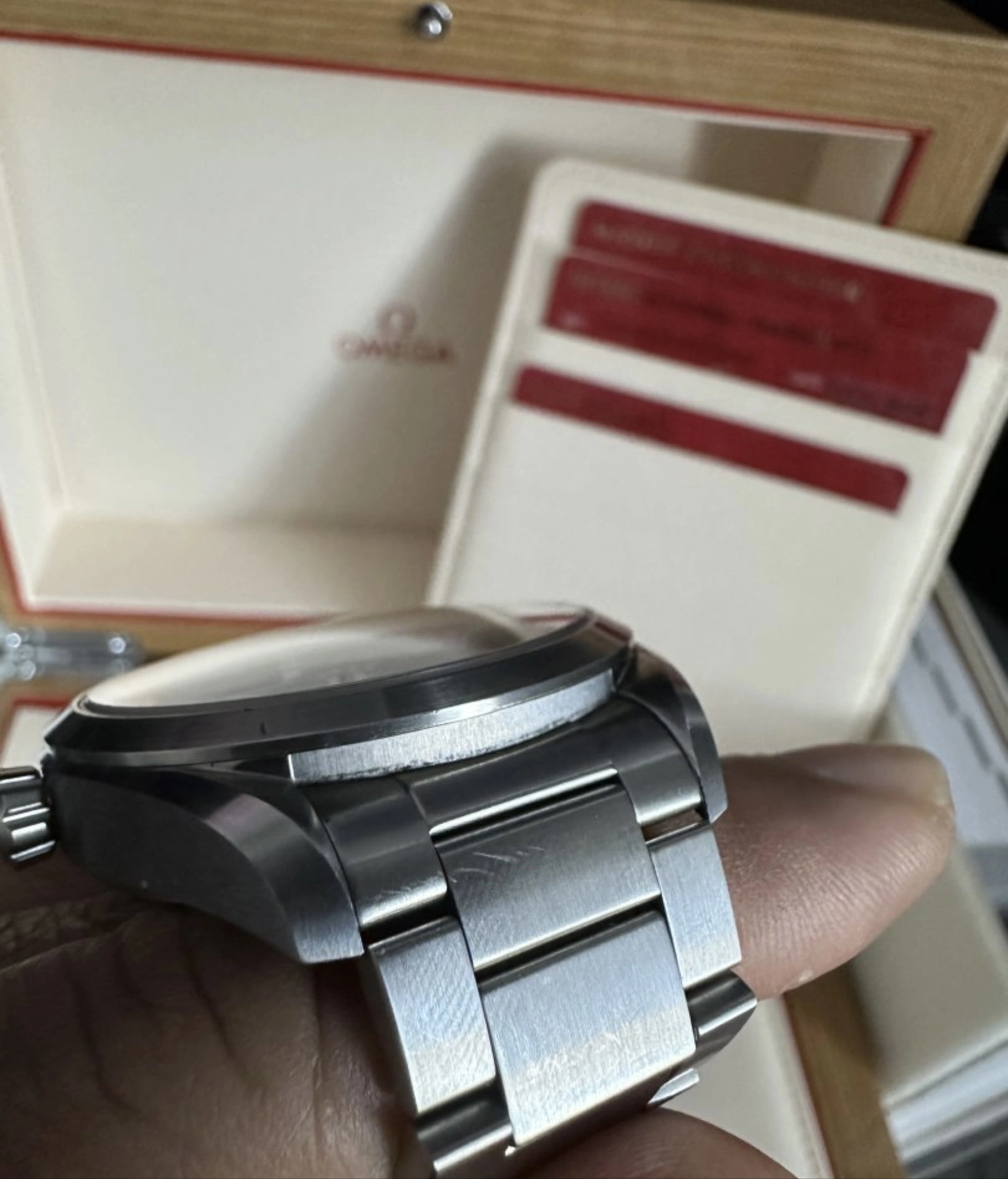

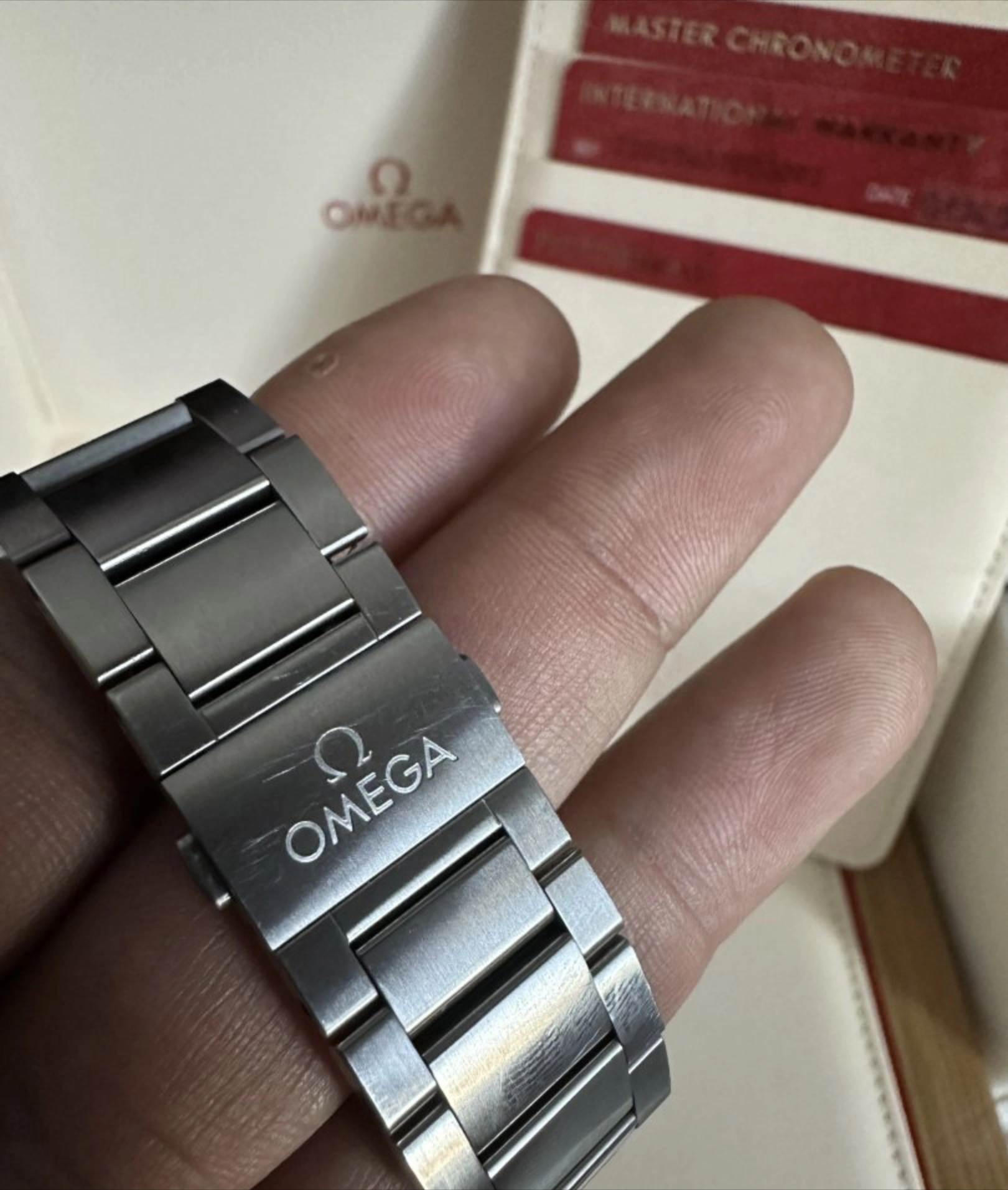

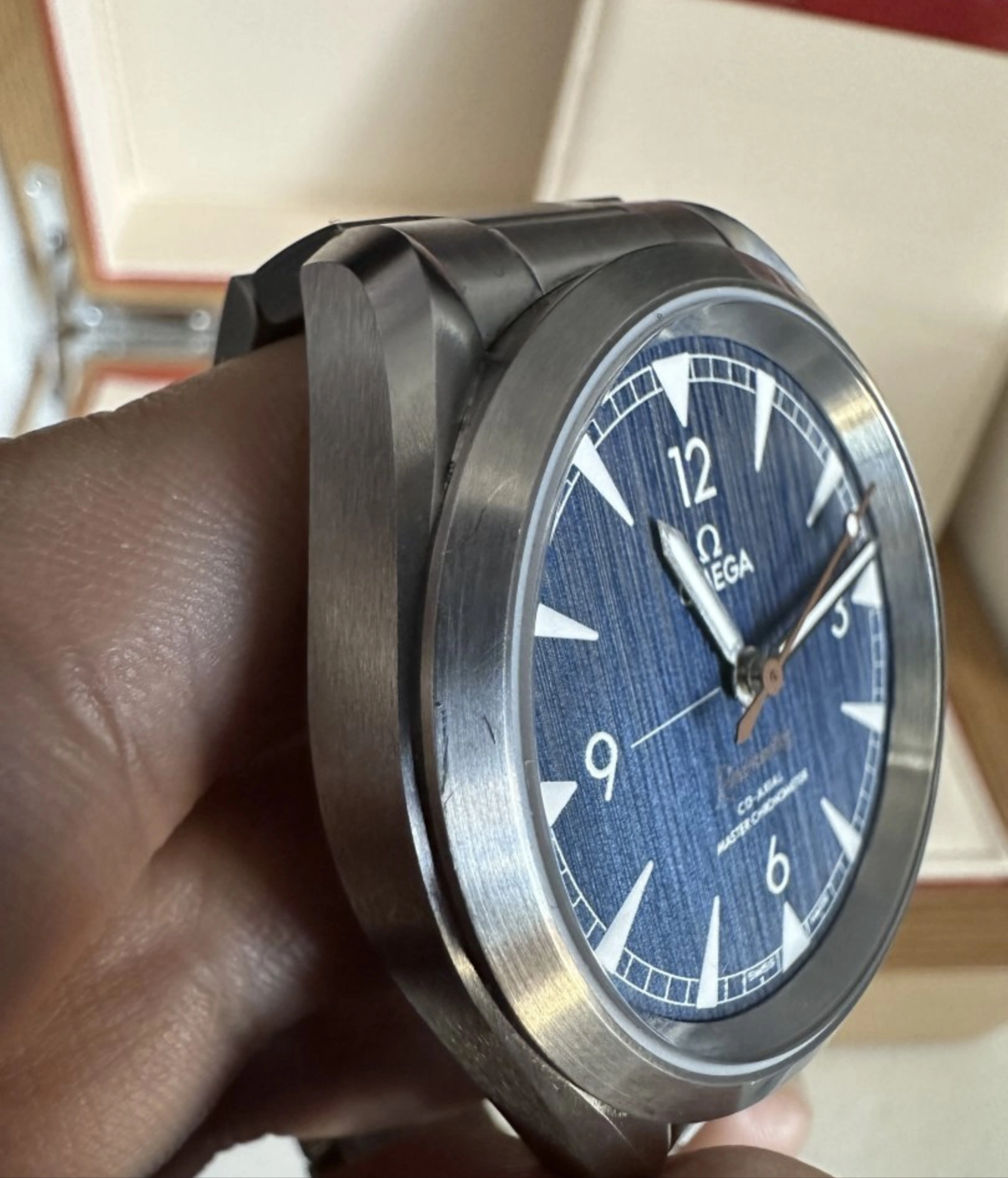

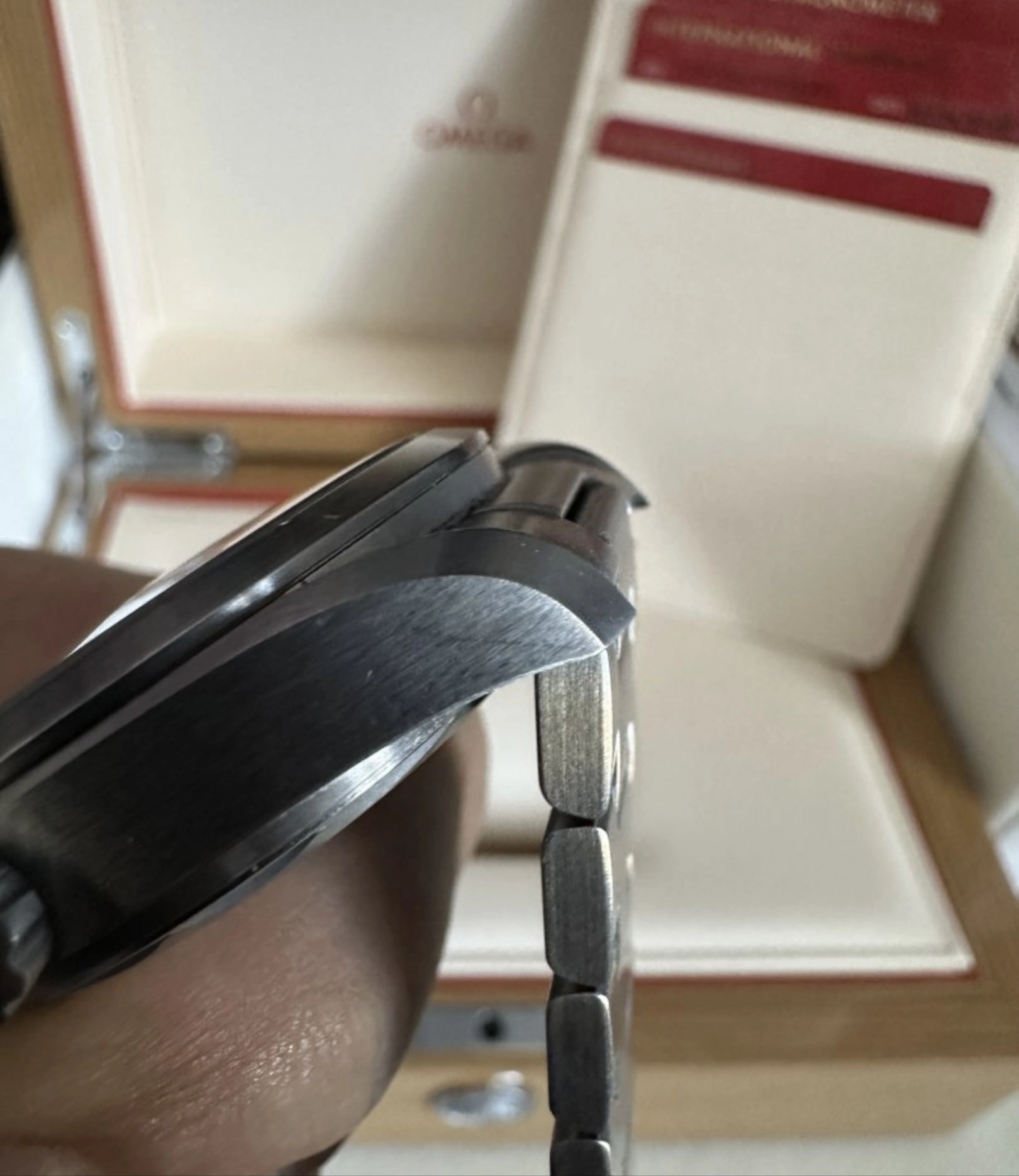

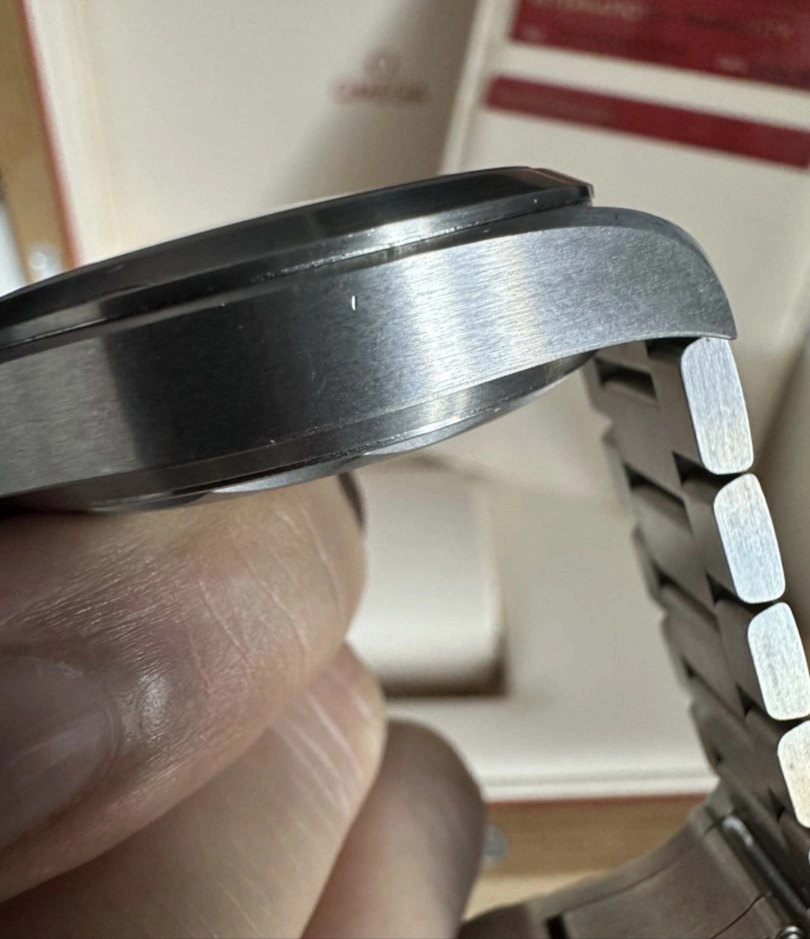

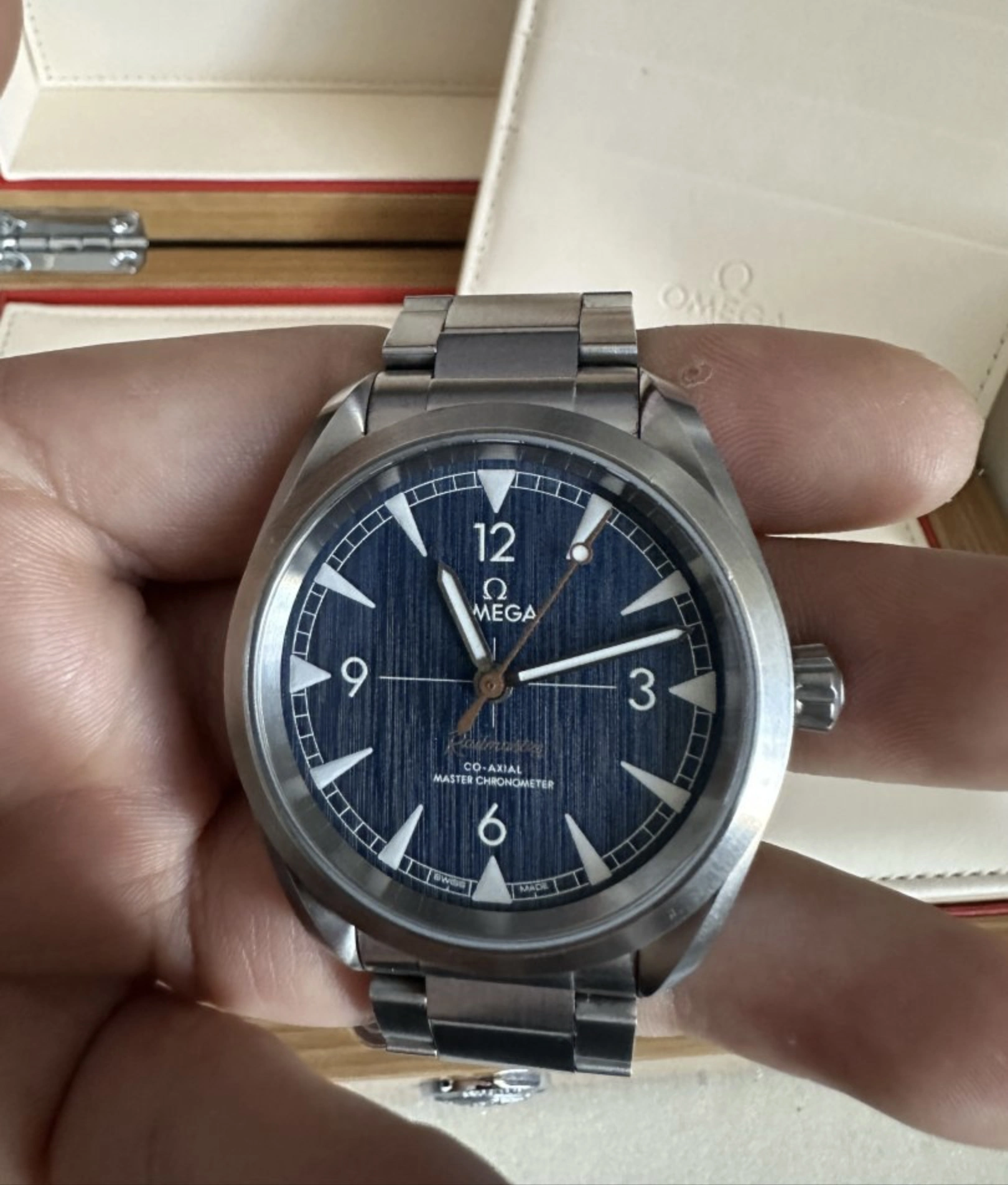

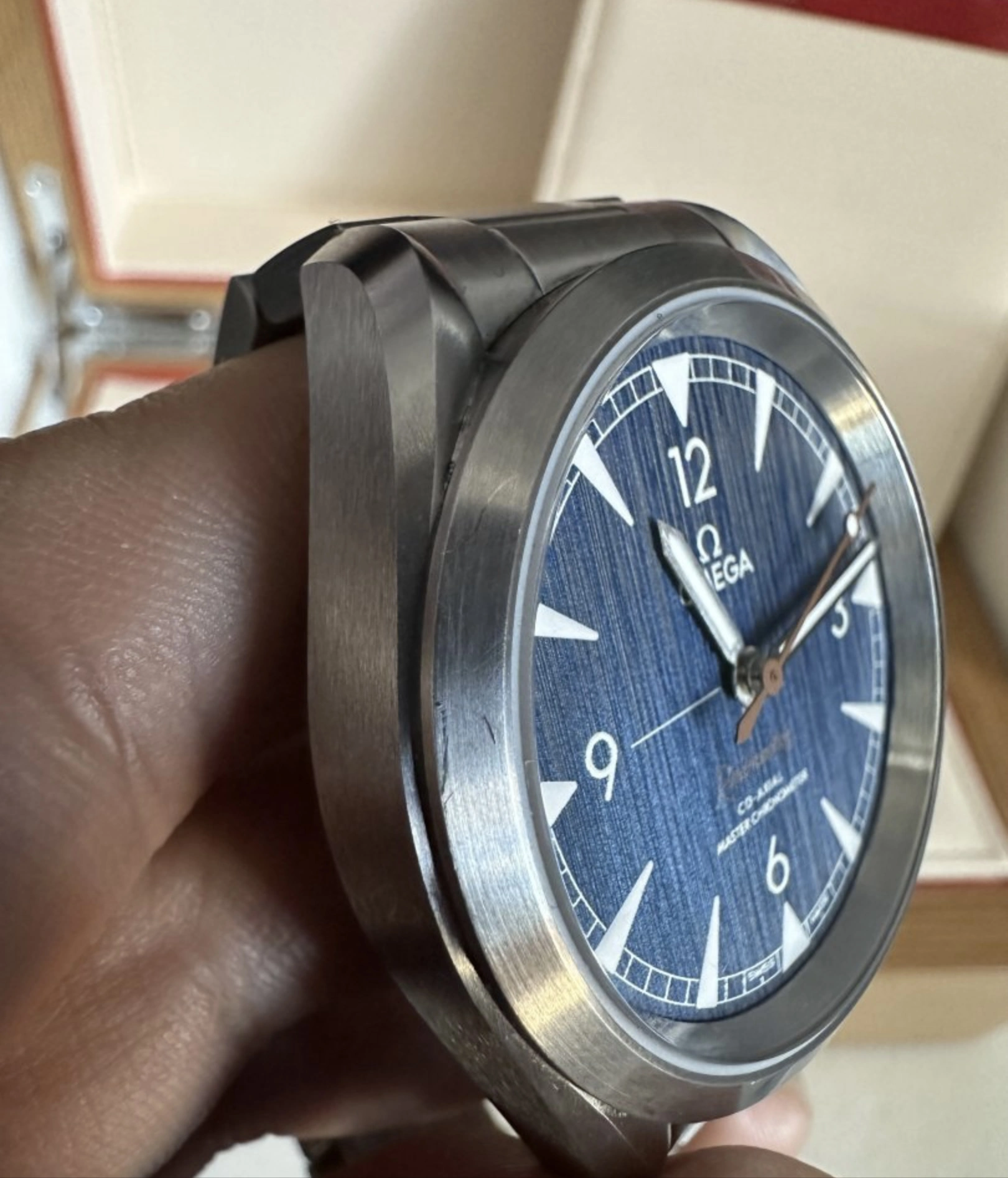

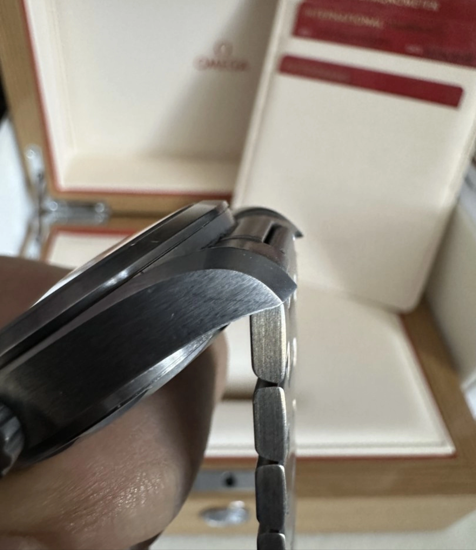

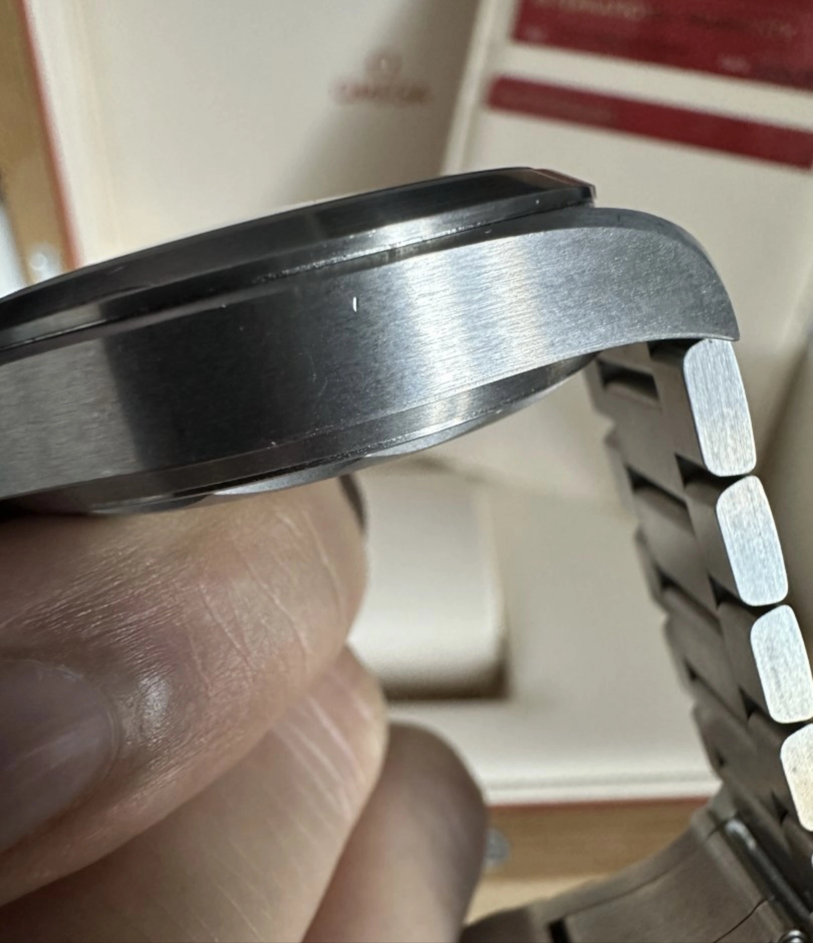

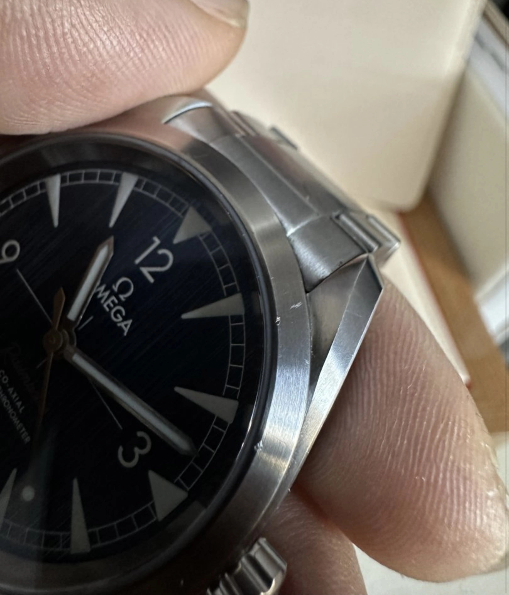

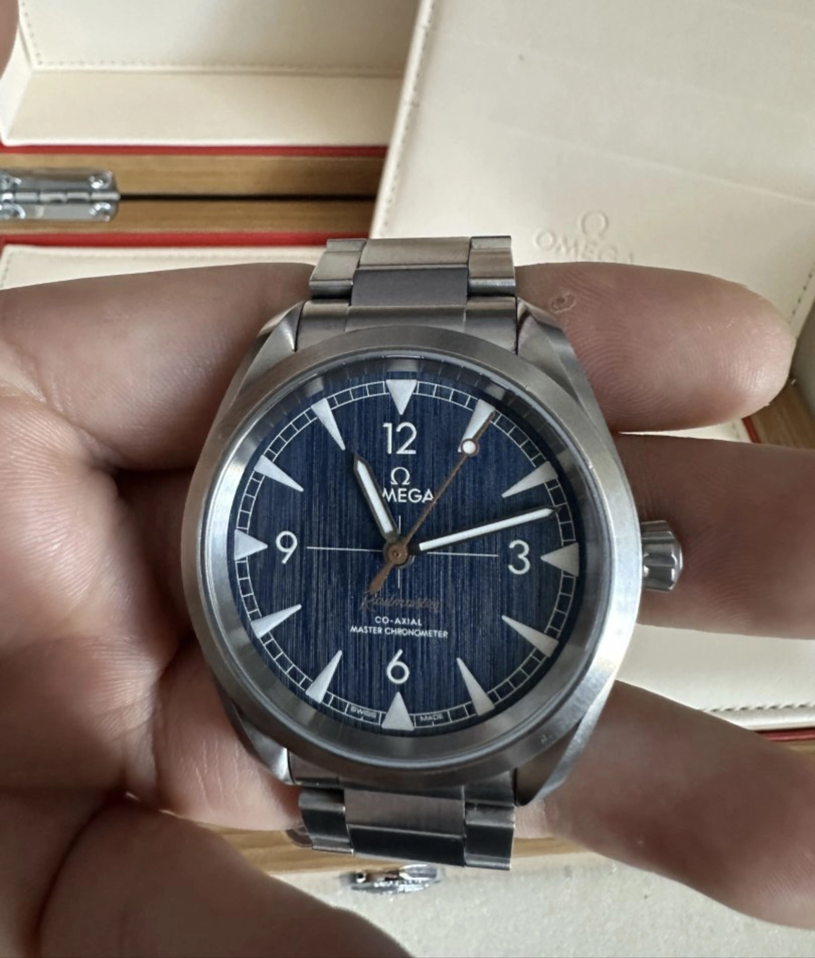

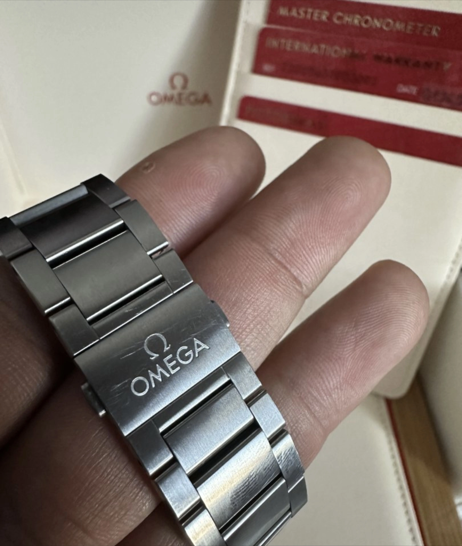

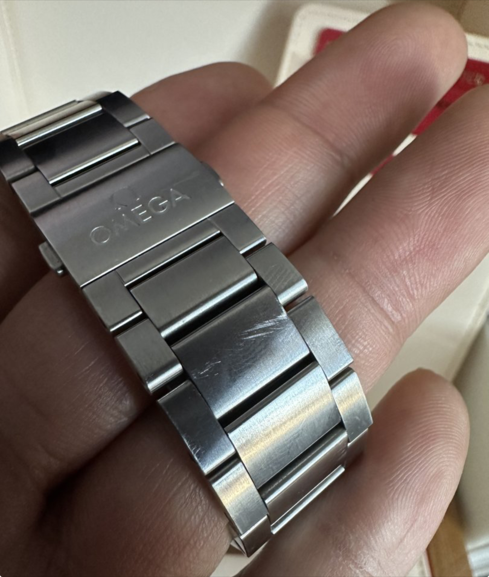

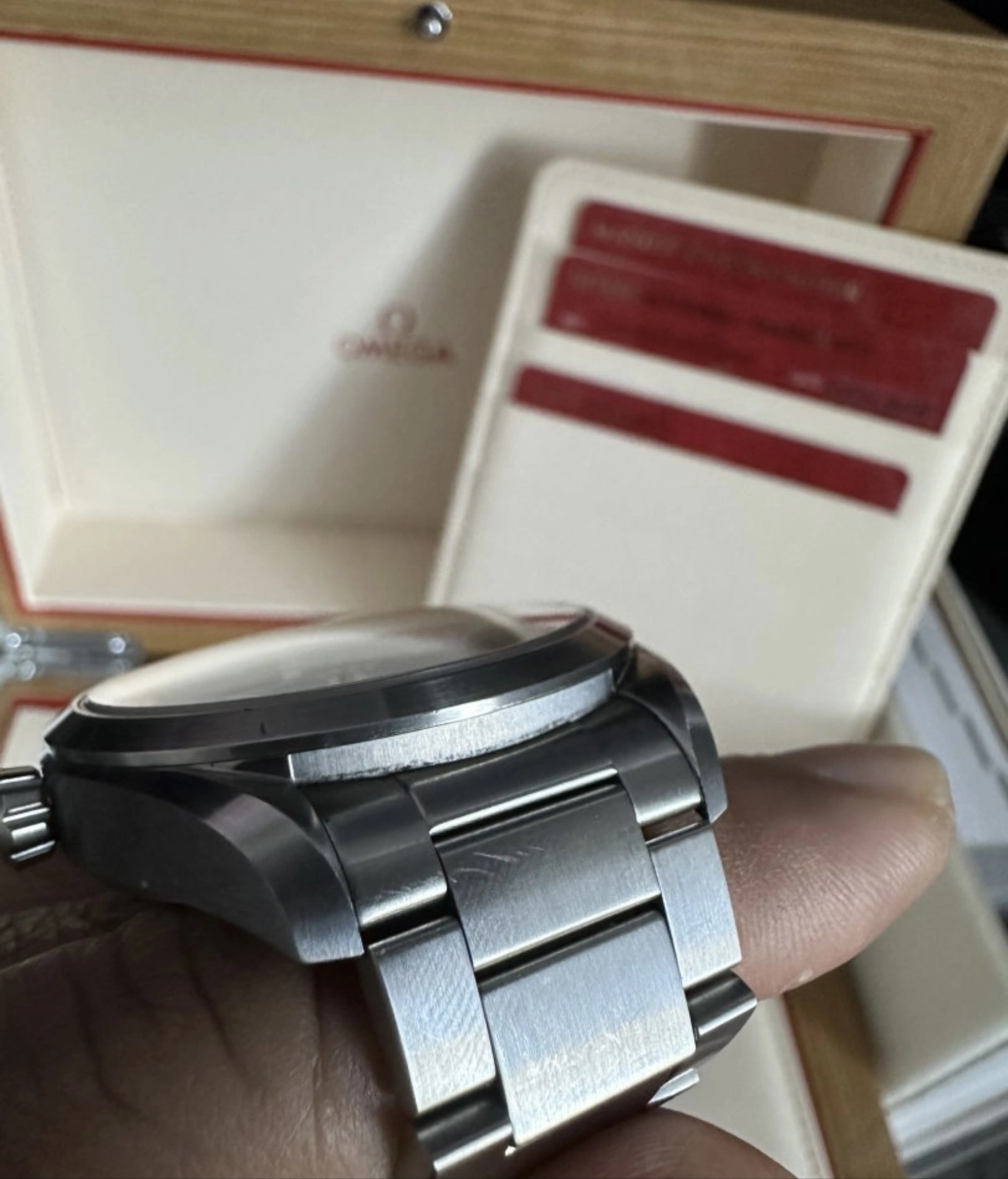

I’m looking at a Railmaster, and saw one offered on another forum. I’m looking for one that has less signs of use, but then again, the warranty card is dated 2018 so the next service isn’t too far off, and if the price is right…
I am better versed in vintage watches where polishing and making them look new isn’t often pursued. But I want this to look very new. So my question here is, would Omega fully fix these dings and scratches as part of a regular service? Or, would making the watch look good as new cost extra? The damage on the front at 1:00, 2:00 and 9:30 have me particularly concerned. I’m assuming the bracelet scratches won’t be a problem, but I’m not sure. Thanks in advance for your guidance.

From my experience with Omega service superficial scratches will be polished out routinely, without extra charge. A couple of those dings, especially the one on the case at 9 o'clock and on the bezel at 2 o'clock may be a bit too deep to polish out, so would probably be left as is. If a new case or bezel is needed to restore the watch to "as new" condition, they will likely ask you if that's what you want and charge you accordingly. Good luck and let us know what happens.

Those scrapes would come out pretty easily with 3000 or 5000 grit sanding disc, carefully and lightly run in the direction of the grain. I've done it in my seamaster clasp.

This watch isn’t so old that better examples aren’t floating around- not that this is a bad one- I wouldn’t really notice the marks other than maybe the bezel dings, and as said by Pastor- it would only be a matter time before I added my own. But some of those dings are pretty deep and if those would bother you even after a refinish (I would rather see the full ding than the lawn-mowered pock mark) then maybe this isn’t the watch for you.
I assume the asking price is too good to pass up if you are considering buying it, then sending it to omega for a full service price- but as said above, if you want it “like new” you are going to pay for it up front for a better watch, or on the back end when omega offers to replace the case at full cost rather than grind it out.

The only mark that looks too deep to be taken out through a normal service polish is the bezel at 1 o'clock. There are two solutions to that if you wanted to go down that road:
1) The entire bezel can be replaced as part of a service. I don't know the exact price, but I'm guessing $150ish (USD). I know for certain a Rolex Explorer bezel replacement is $150 currently (from experience) and I can't believe Omega would be that far off for a similar type bezel.
2) A quality case refinishing operation such as Zimmerman Watch Repair, Rolliworks, or LA Watch Works. They can laser weld the deep scratches on the bezel and recut it. That said, this would undoubtedly cost more than simply replacing the entire bezel through Omega.

I did send a modern Omega for a factory service once and they refinished the case and bracelet. I suspect that most of those marks will be completely gone and if there is anything deep, the visual impact will be greatly diminished.

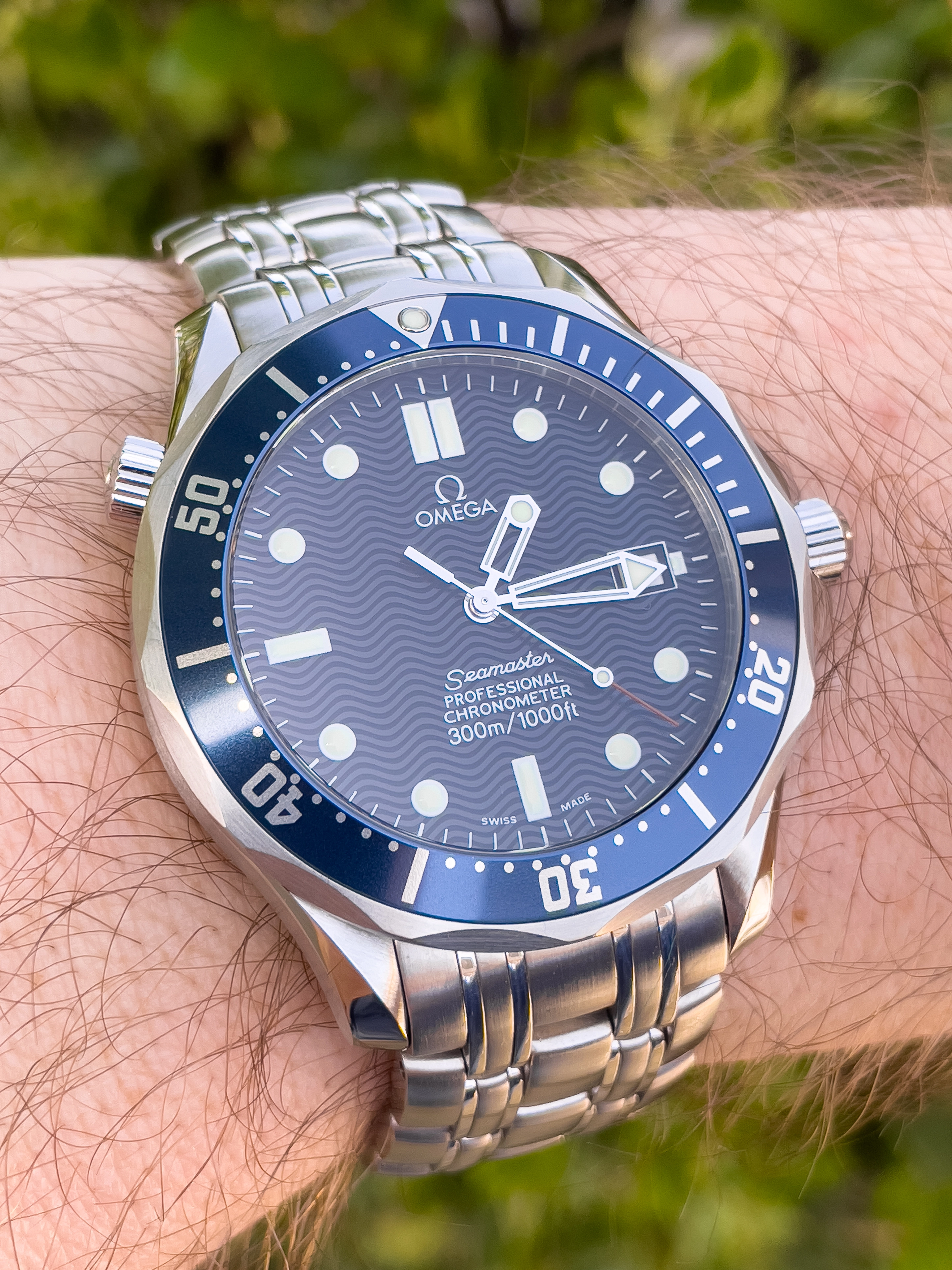

I don’t have a before pic, sorry Dave, but this was refinished during a factory service and it looks brand new with incredibly sharp lines.
