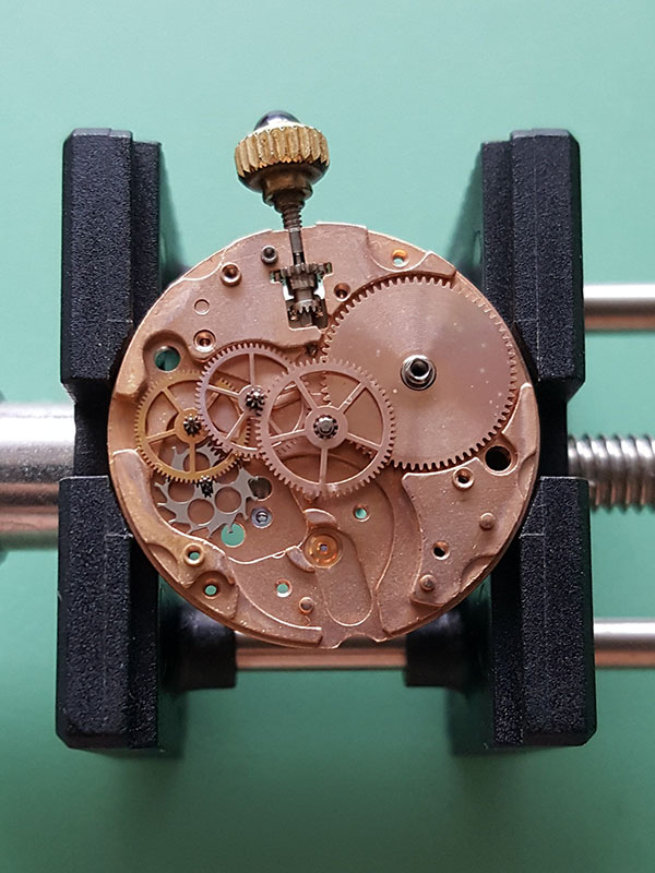

    Here, you can see the wheel train and the barrel. When I lifted the center wheel, I noticed that it was stuck to the third wheel with a drop of hardened oil or grease. That'll jam the wheels and stop the movement from running.

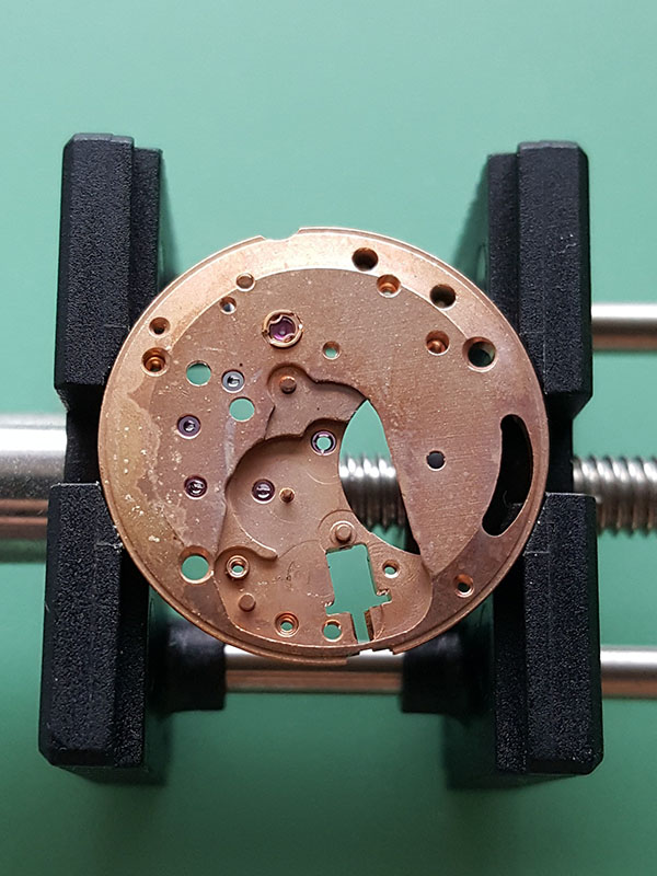

    This the empty bottom plate/dial side and you can see some sort of caked dirt around the edges. It looks to be some sort of oil as well. Looks like someone overoiled it at some point and lubrication started to leak and form puddles.

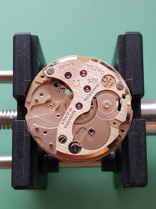

    This is the movement after I cleaned all parts in the watch cleaning machine and placed the wheel train and the 3/4 plate bridge back in position.
    There were no further problems although the Inca spring of the bottom plate did ping away after I opened it. I searched online for a bit and it seems that the spring of the 625 is notorious for doing this so, lesson learned for the next time. I was able to reinstall it with a cocktail stick and my tweezers.
    I hope it's ok to include a link to a clip on YouTube that shows the running movement after the service. It's quite small but it's still quite powerful with an amplitude of 307 degrees and accurate with a rate of -2 sec a day.
