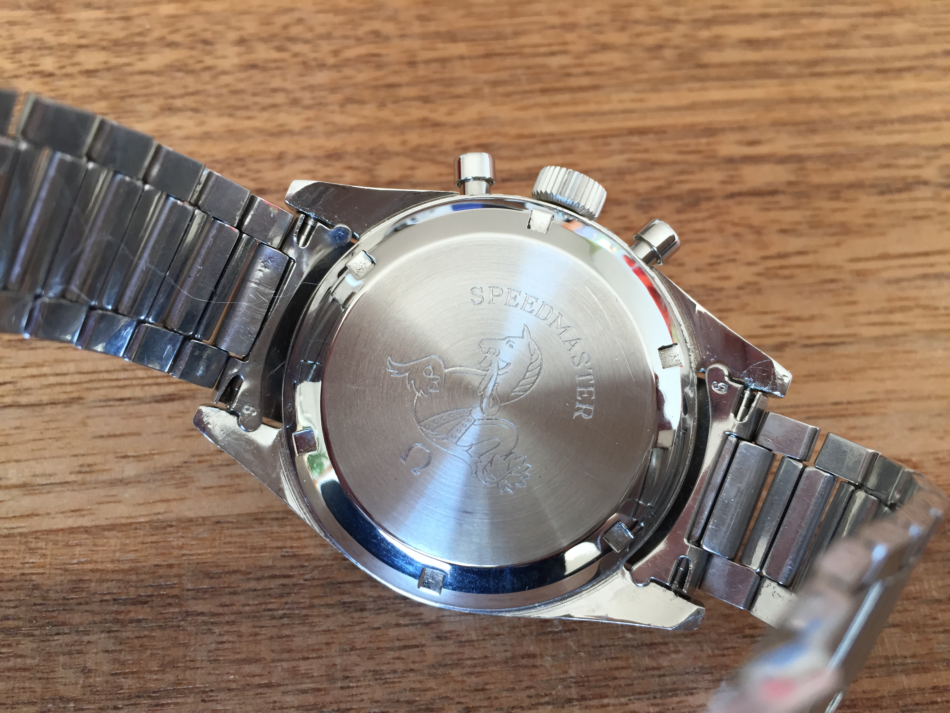

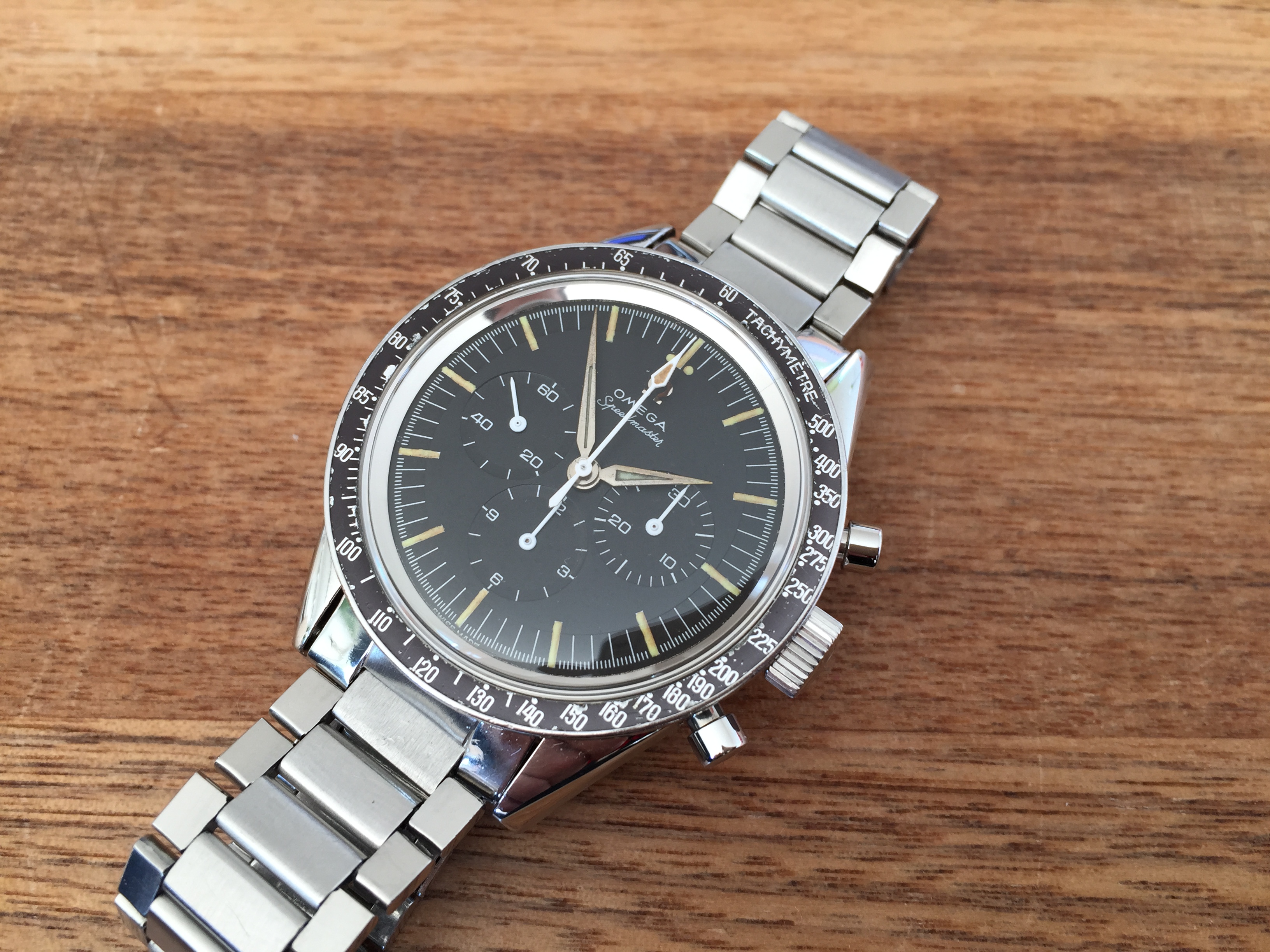

my last watch in Biel was the 2998-62, the requirement was clear to just servicing the movement and do nothing else. Some weeks ago Biel has called me, the watchmaker want to ask if i agree with a replacement of the crystal, a slightly polish of the case back and change of the sub hands because they are overpainted. That was ok for me, so i'm really happy now with my 2998 and the 321 works perfect.
bevor:
after:

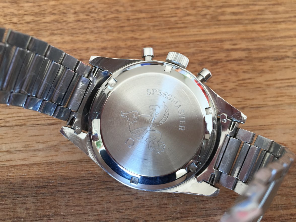

bevor:
after:
I'd like to know how you pulled this off. Only person I know so far is Tom Dick, and I think he sat at the Service Center for months to get them going his way.
