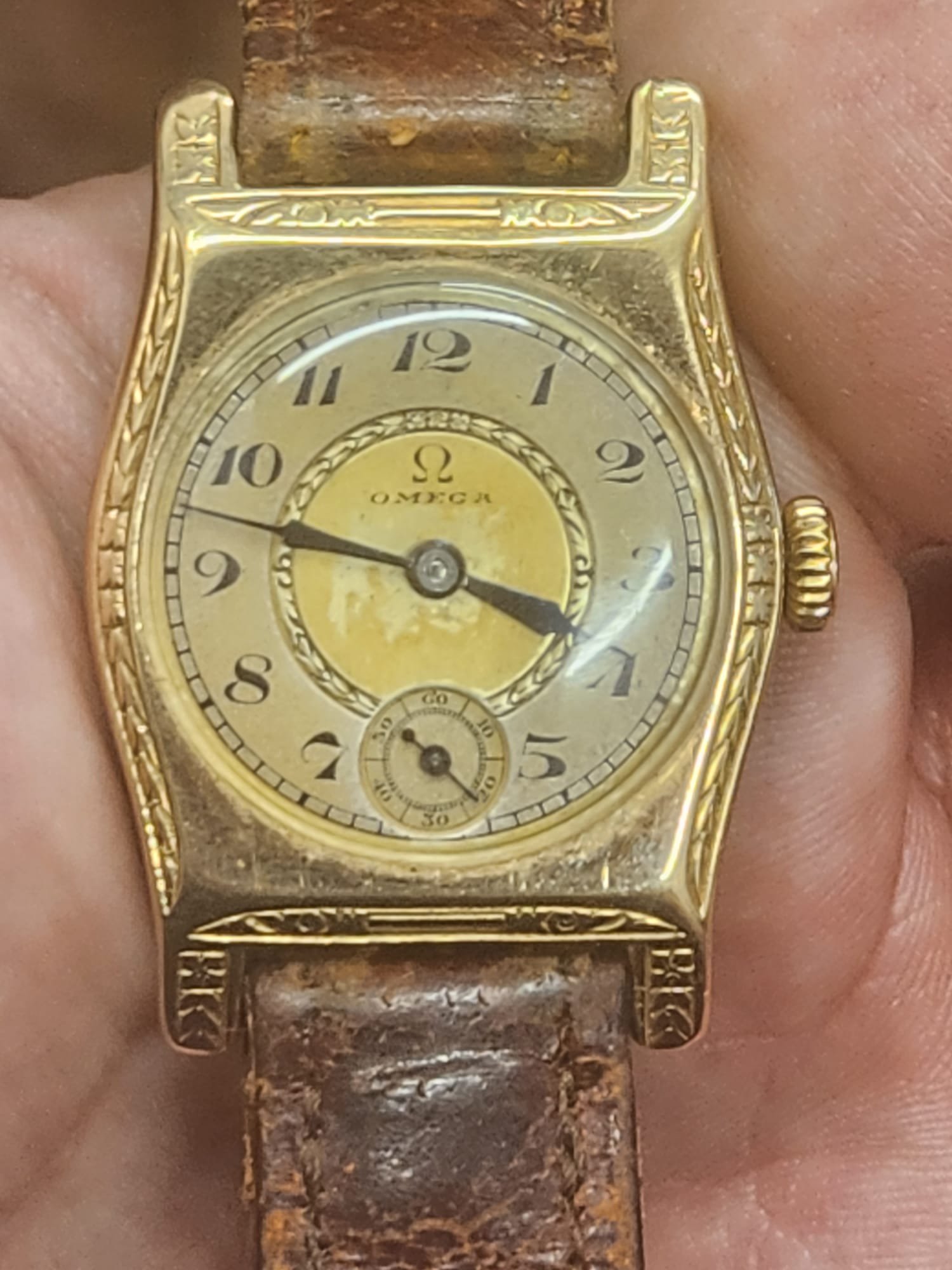

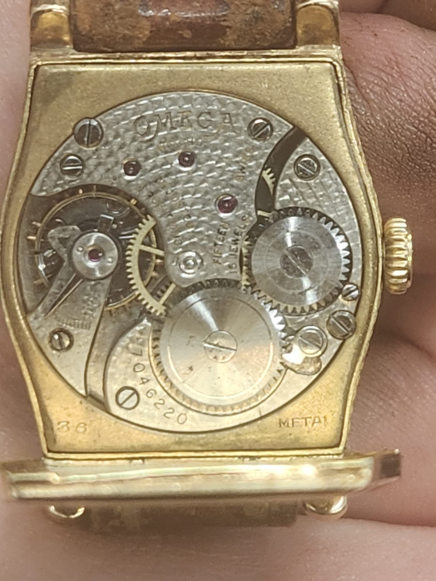

I aquired a vintage omega watch, made in 1925 I believe, the movement has numbers on it.. 7046220 I am trying to find out what balance and balance staff is needed for this movement, I have been told they need replacing.. any help will be greatly appreciated. Malcolm

You can find these parts on ebay
The movement is of caliber 23.7 - use this for search

Thank you so much. Mac_Omega . Malcolm

Keep your eBay search broad, e.g.: "Omega 23.7".
That way you get a lot of 23.7 things, but much less if you include "balance" etc.
On-line shops like Urdelar and others also have parts, mainly staffs.
You may have to risk a donor movement to get a complete balance, so best of luck in the hunt..

Thank you JiminOZ, appreciate your help.. searching now. Looks like i have to buy a donor movement, not many about.. seen one and may bid for it.

Best of luck.
It's a watch well worth saving.
