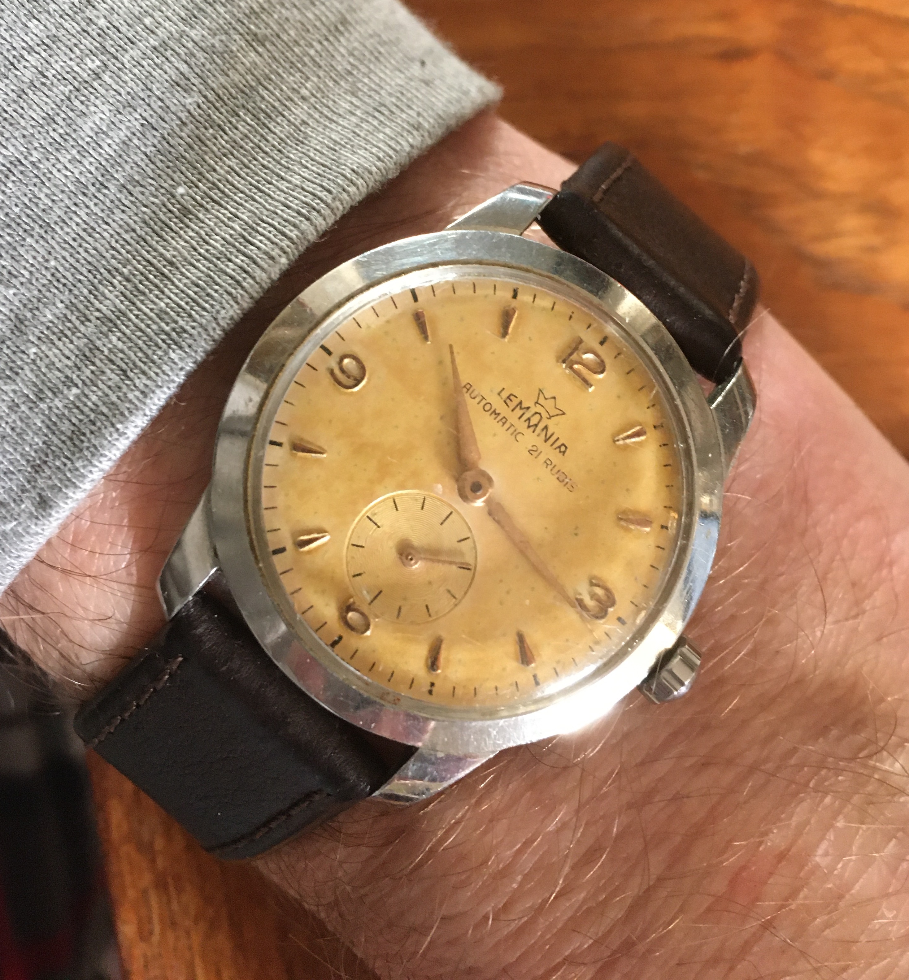

My 2 Lemanias, I used to have an ATP but sold it long ago. A humble aged auto but it is a great chunky, comfortable case and keeps great time. And the inevitable WWW but quite a good example I think. There is something 'special' about a Lemania branded watch, dunno what?

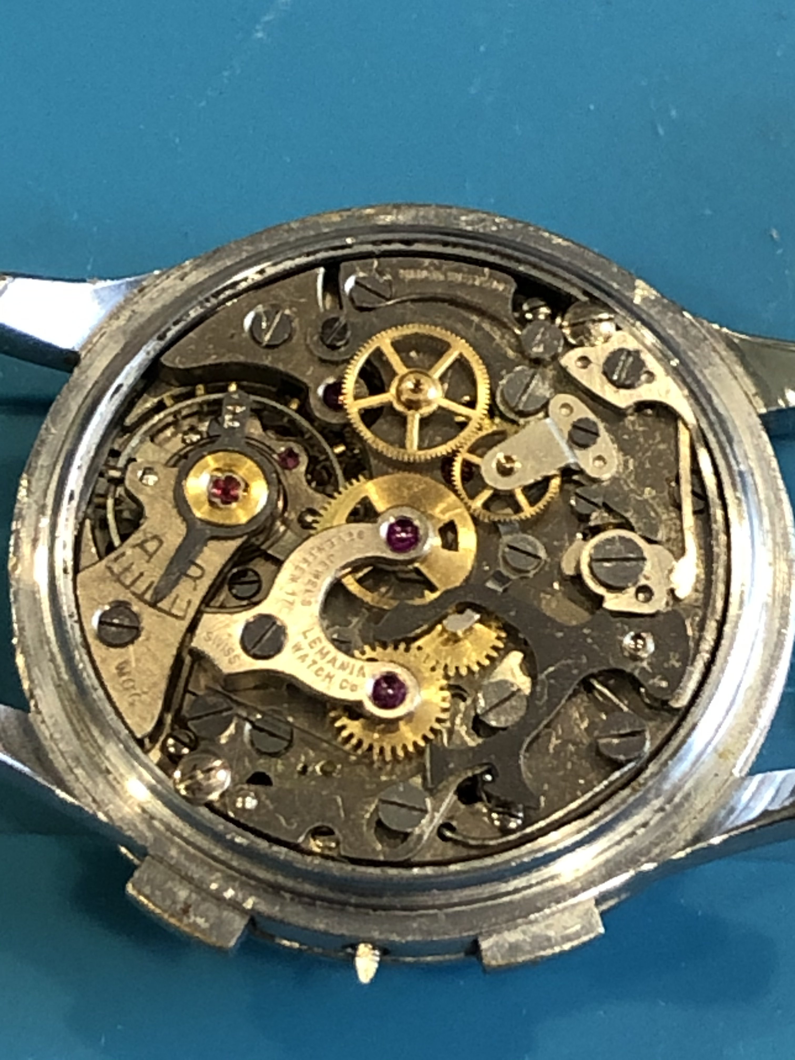

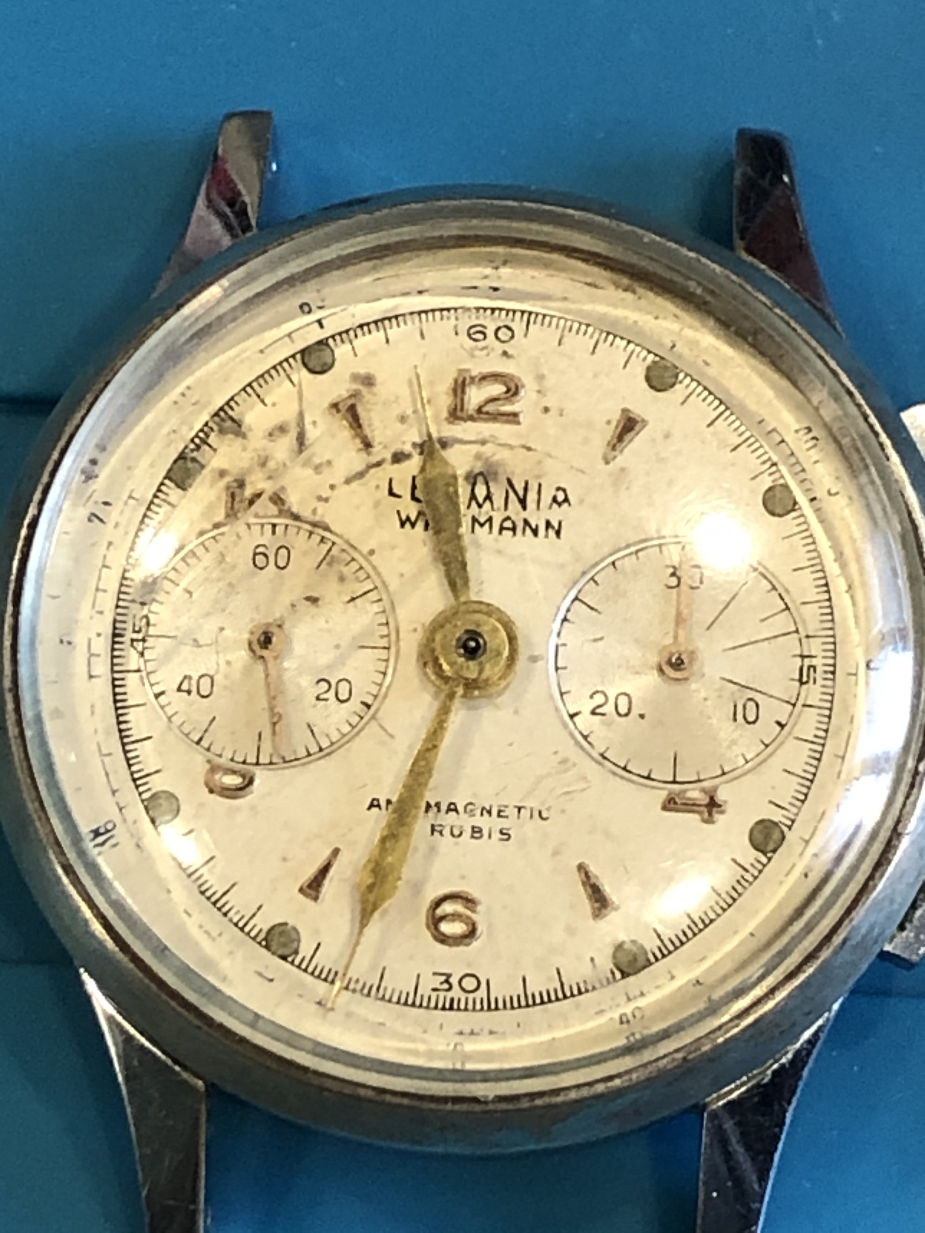

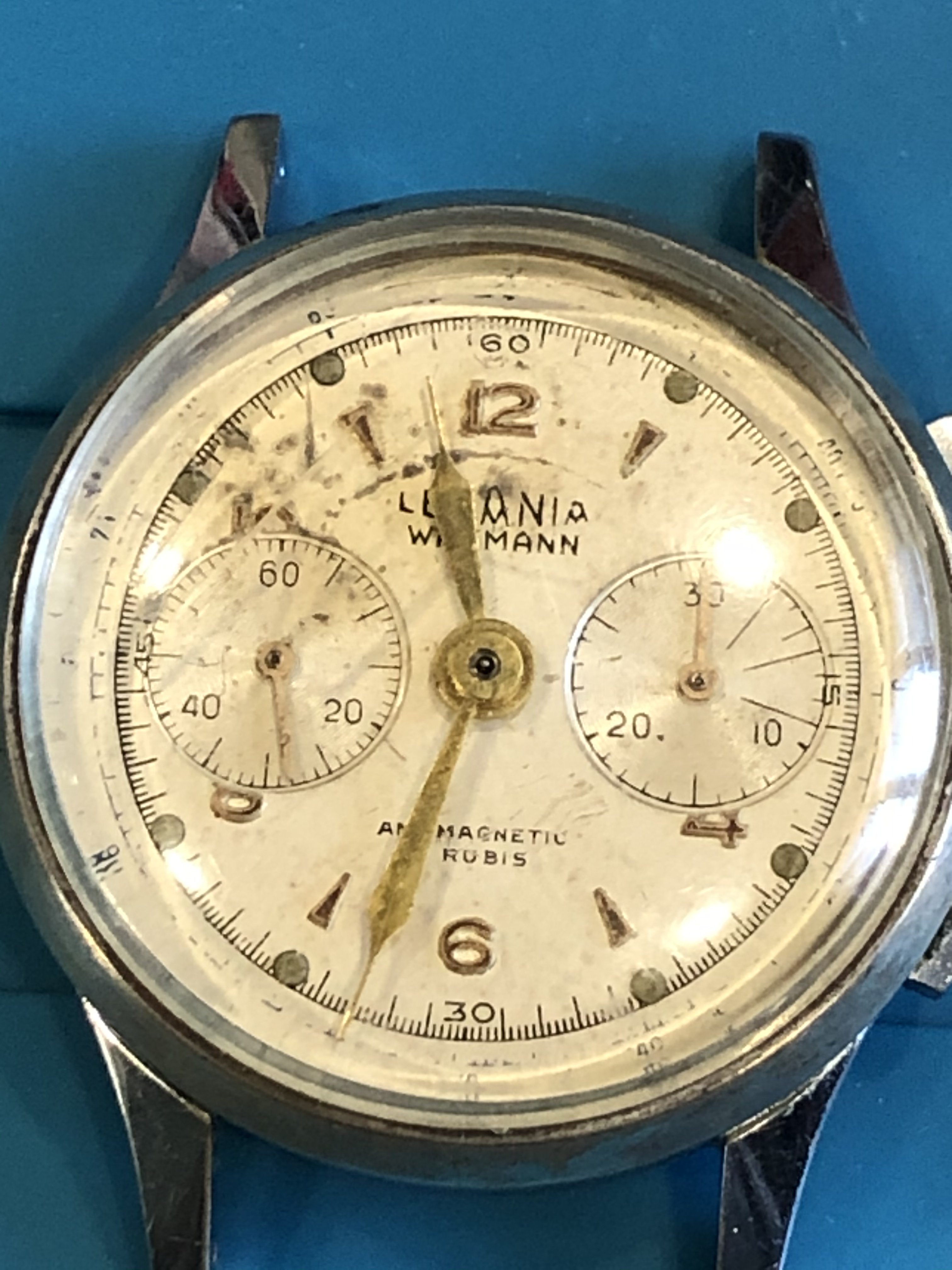

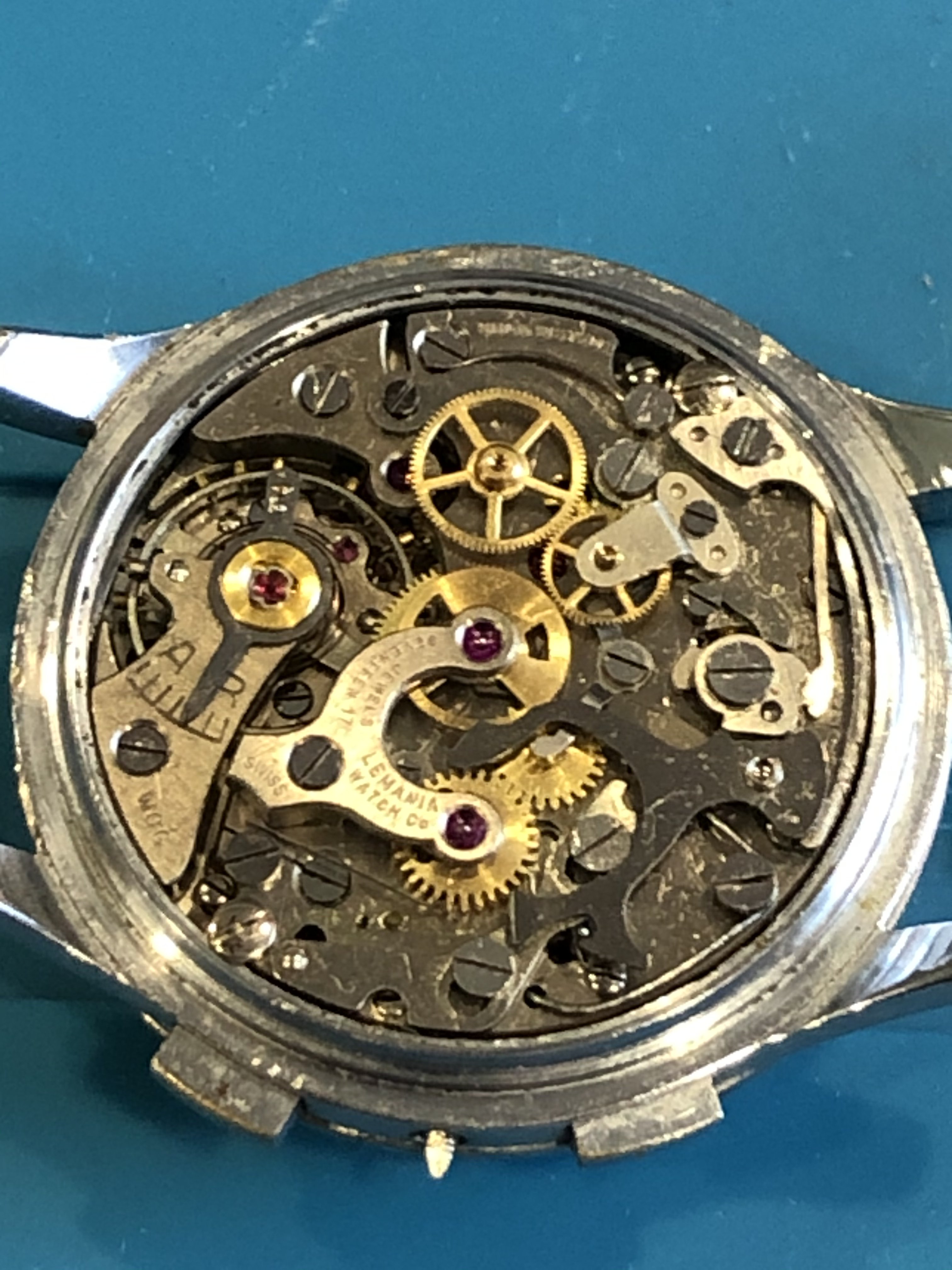

Hello all. I’m a newbie to watchmaking and collecting so please bear with me. I came across this thread while I was researching a recent purchase. I wanted to see if you guys could help shed some light on exactly what I have. As for the watch, the start/stop works but the reset doesn’t. Also the chrono runs extremely fast. The watch portion doesn’t seem to work. I tried to put the crown on outside the watch but was unsuccessful. I didn’t push it, not knowing if it was the proper crown. Hope you can help.
Lemania with a Wakman logo.
Most likely sold in the US market.
With your description of issues it will surely need a service.
If you are new to watchmaking, I would strongly recommend not to attempt this yourself.
Chronograph repairs require proper training.
If you look under the balance , the four digit reference number should be visible. 1270 perhaps?
Yes, I definitely will not attempt this myself anytime soon. I have a watchmaker that has done some amazing things, so I may send it to him. I found a replacement dial for it, minus the "Wakmann" (instead 105). What are the thoughts of putting the NOS dial on versus cleaning it up as is?
I pulled the balance. Indeed, 1270 with a cross and LWC I'm assuming.
I always recommend keeping stuff original. A 105 dial would be appropriate for the movement, but not for the case.
Ask your watchmaker to see what he could do to the dial. I’ve seen worse dials turn out fantastic after a bit of trained TLC.

Do you recommend a good resource to learn about Lemania chronos? I figured it was a 105. What would be an example of an appropriate dial for this case? Yes, my watchmaker cleaned up my Wakmann dial...it looks brand new. I'm just bummed the outside numbers aren't there.

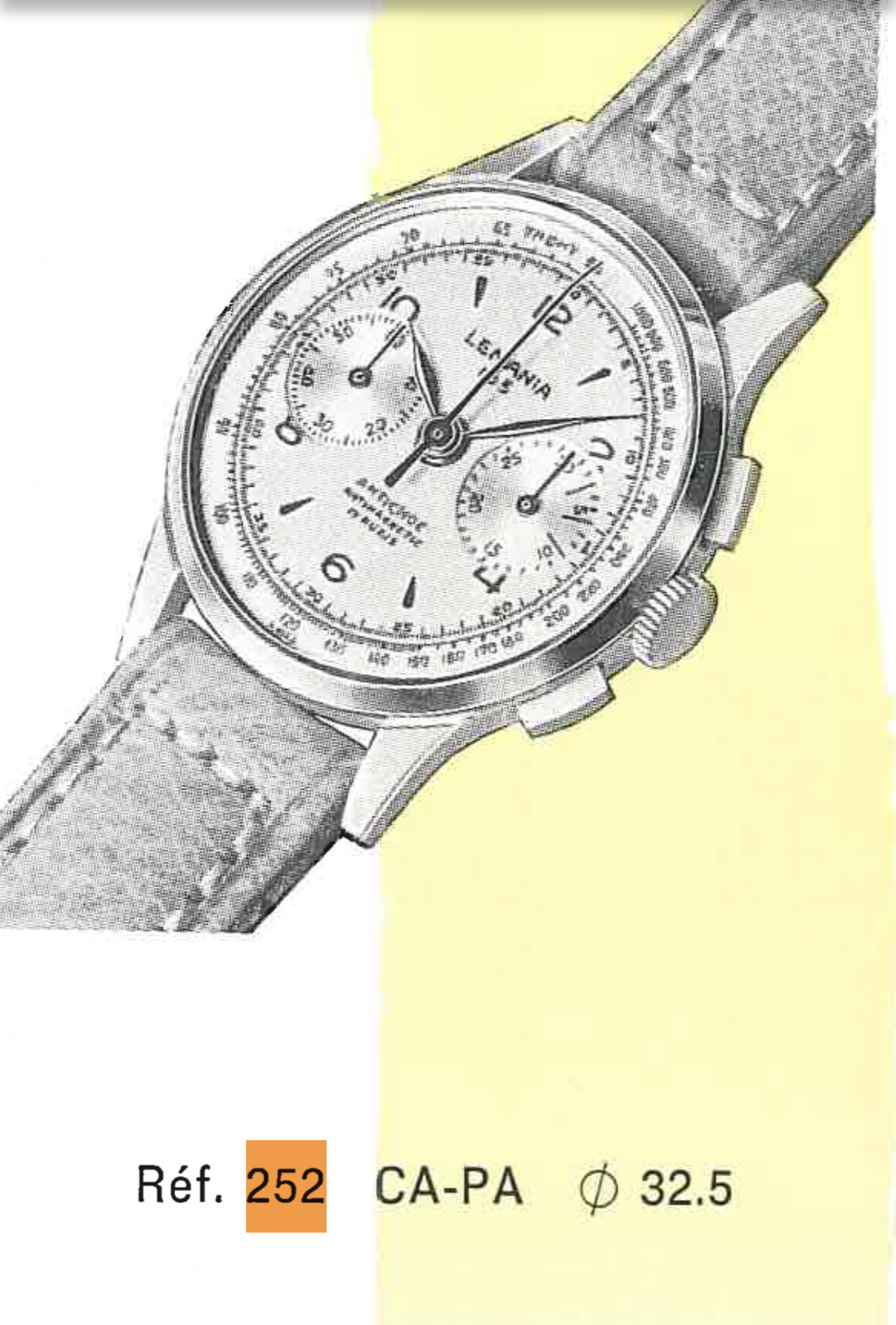

Also, it has "252" on the inside of the case back.
4,440
18,267

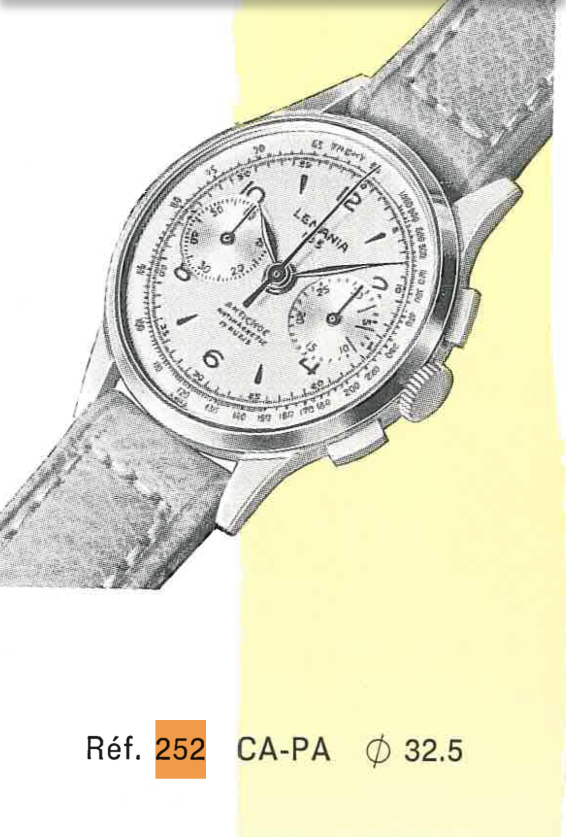

Good resources on Lemania is hard to find.
ref 252:
note: Dials and hands may/will vary. It’s a case ref.
4,440
18,267
Isn't that the same case though?? I'm confused already. LOL
Yeah. Lemania references denote the case and (usually) movement inside. The customer could choose from different dial/hand variants when placing the order. Lume/non-lume and so on.

"The customer" meaning a watch brand ordering in bulk? Or could an individual also have gotten a watch made to order?
