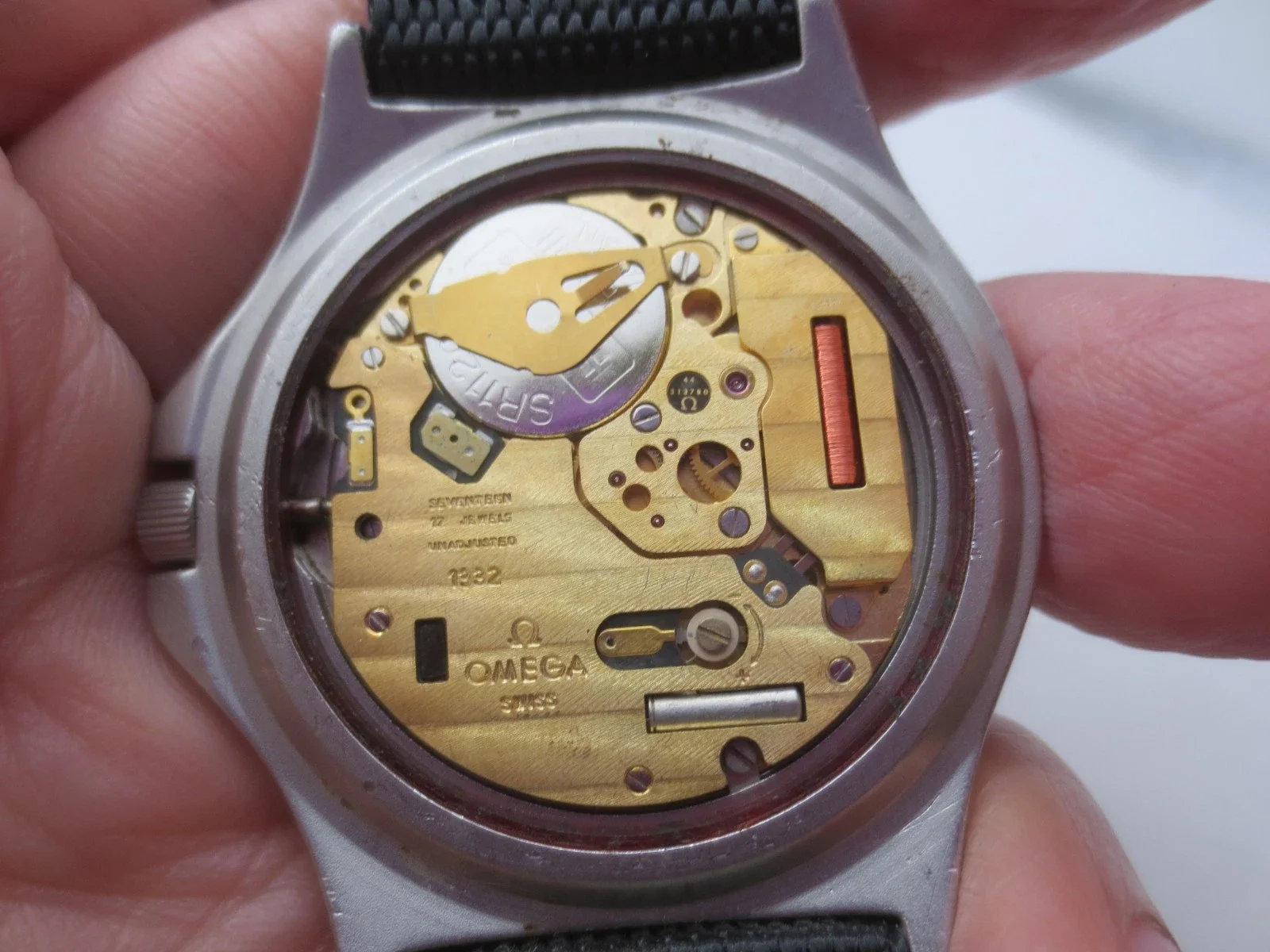

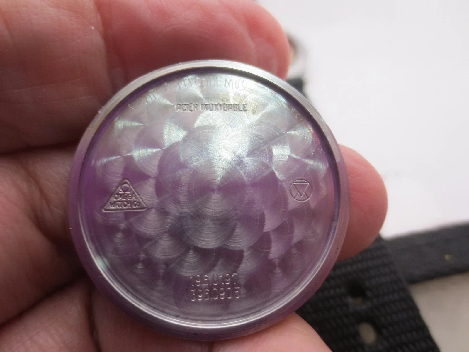

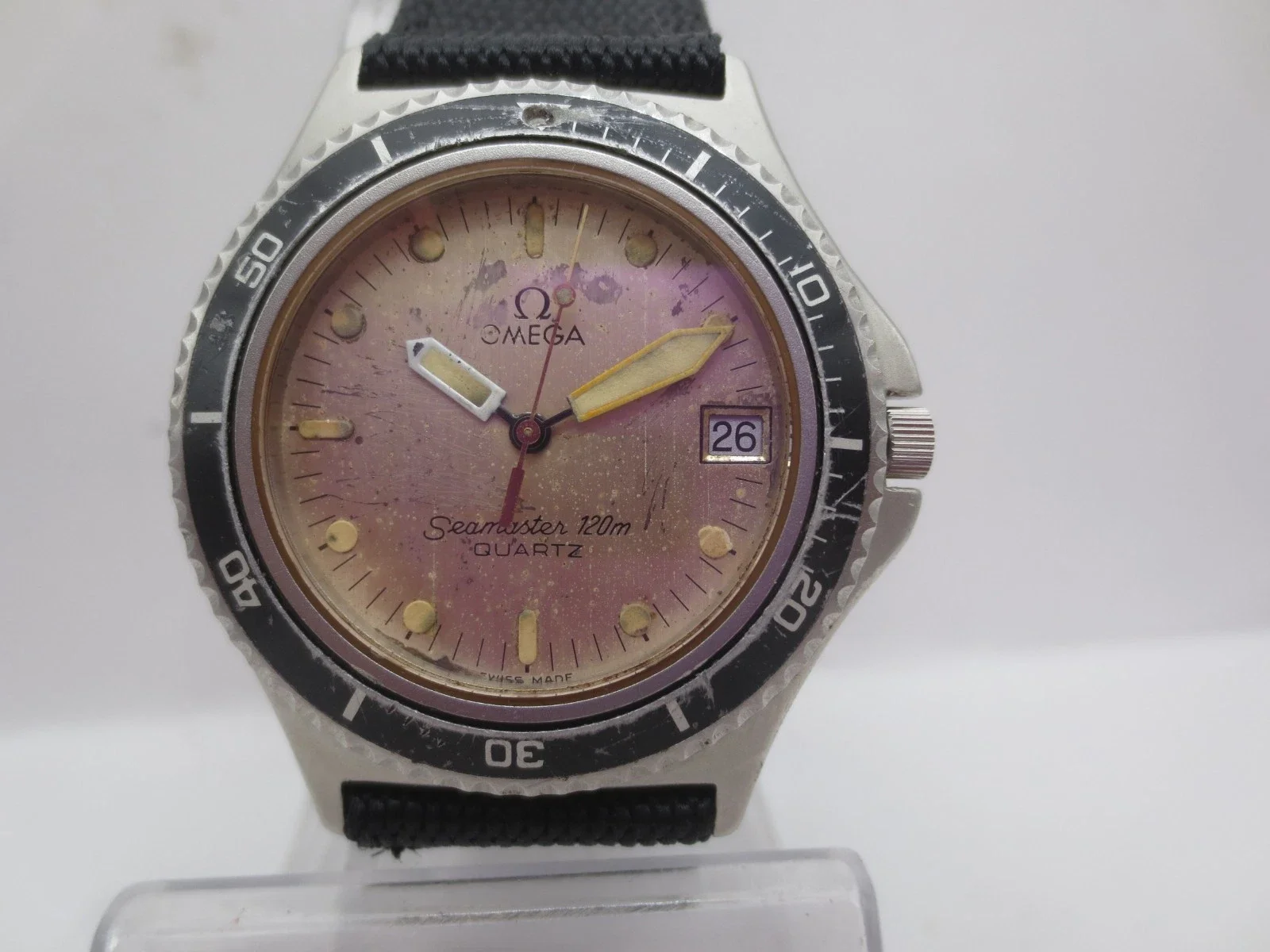

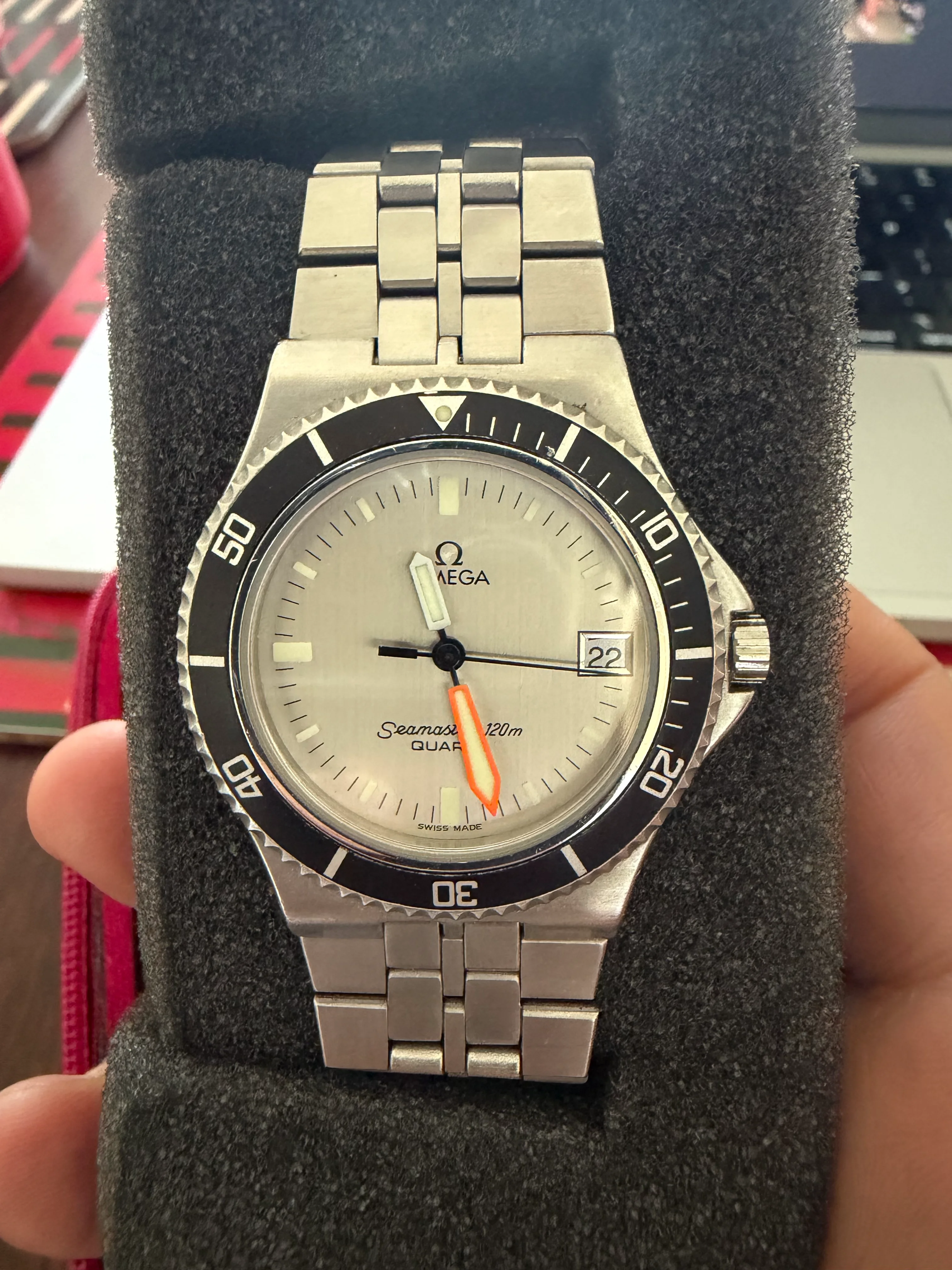

I really want this to be real, but it feels like a frankenwatch to me -- anyone else?
370
556
Well the movement is a 1332 rather than a 1337 (only difference as far as I know is that the 1337 has an end of battery life indicator function). The crown is also wrong and they're very hard to find. Just any crown won't do with this case - the correct crown interacts with teeth on the tube so the crown can't turn when in the in position and change the hour hand.
