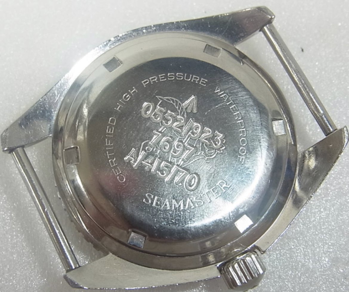

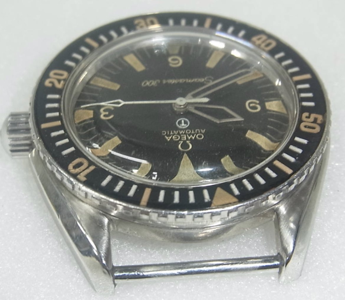

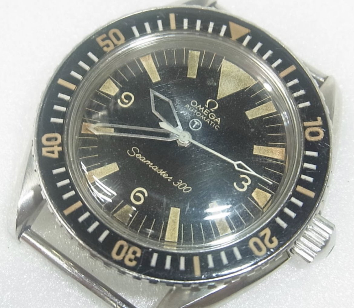

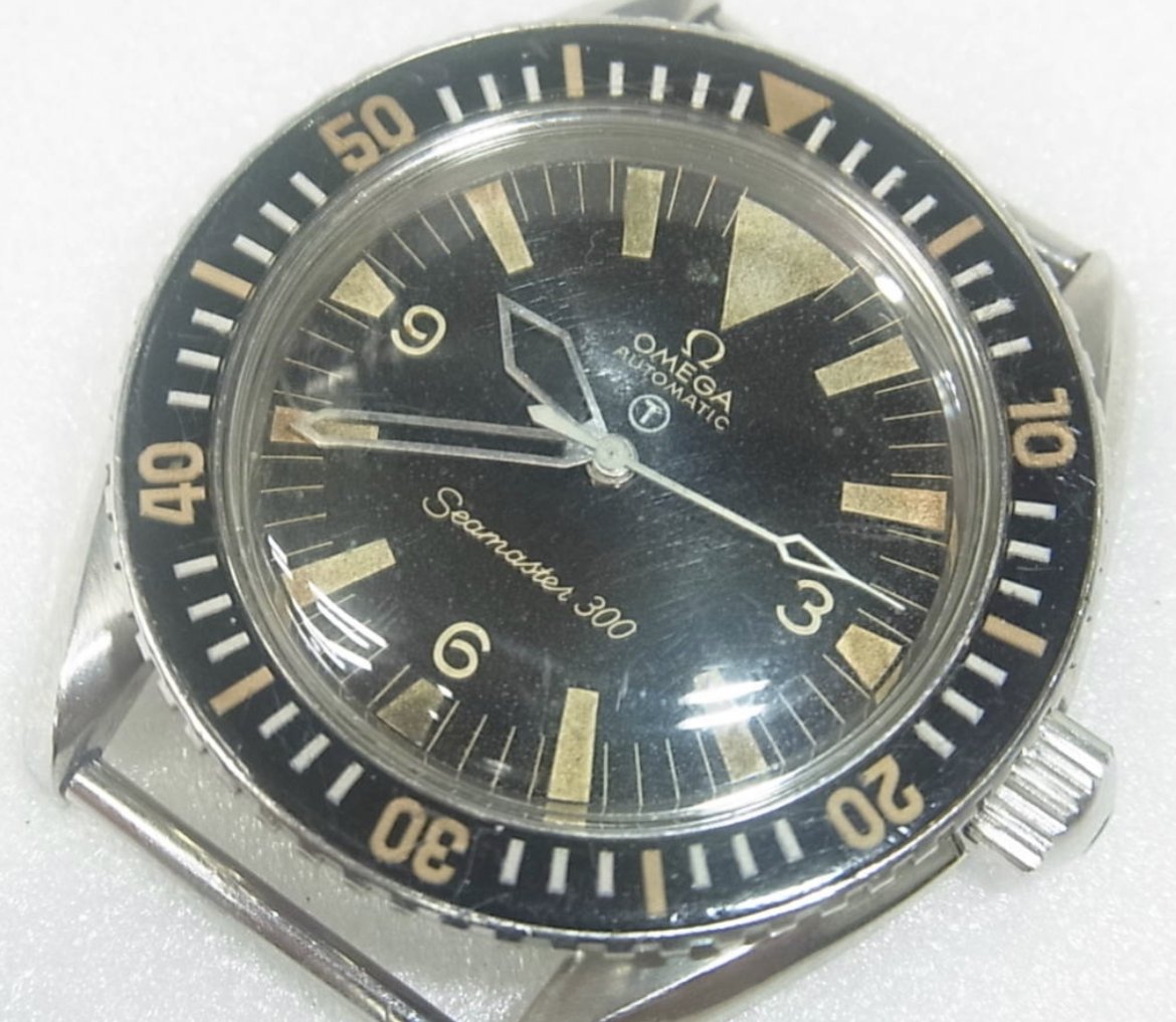

Hi all!
I came across this, to say the least, weird looking military 165.024

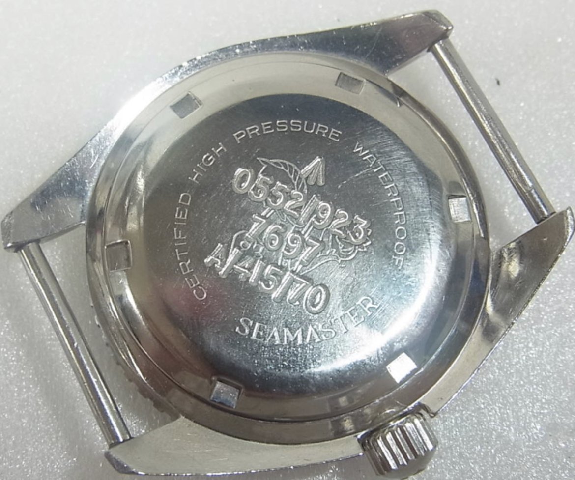

From my very limited knowledge, it seems to differ from the regular ton of fakes lying around…The bezel looks good to me and the dial kind of does too if it wasn’t for that circled T usually found in true bottom. Caseback engravings covering a regular caseback instead of a plain one…
It almost seems to me like someone butchered a classic BT SM300 to give it military features.
No idea what the listing says as it’s a screenshot in Japanese 😁
Or maybe I’m imagining things and it’s a full good old fake!
Just for the sake of knowledge 😀
3,238
6,787
IMO: forget the T and the engravings if interested. dial and hands original (lume removed - OK, better than having lume in the movement),
case: hard to see, if polished,
bars: wait for the specialists
always hard to judge without loupe , UV light and having the watch in your hands...

" Forget the T and engravings .... " .... Why?

Product description is in this section.
【商品の詳細】
・OMEGA Seamaster 165.024 オメガ シーマスター 動作不安定
・ケース径:約41mm
・腕回り:-
・ベルト:-
・付属品:なし
【商品の状態】
・動作不安定(動いたり、止まったり)ため、ジャンク品出品です。
・ケース、(ベルト)の汚れや小傷があります。
・ガラスに小傷があります。
・文字盤に汚れがあります。
Translated at DeepL
[Product Details]
OMEGA Seamaster 165.024 Omega Seamaster unstable
Case diameter: 41mm approx.
Arm circumference
Belt: -
Accessories: None
Condition of the product
This is a junk item due to unstable operation (moving or stopped).
The case and belt are dirty and have minor scratches.
There are small scratches on the glass.
There are stains on the dial.
I would not buy and pay for these two......
but: this might be a rare bird - might be. At the local flea-market I would buy the watch for a reasonable price.
Without having this watch under my nose: minefield ahead, but let s wait for the T-profs.

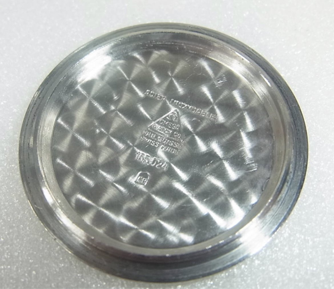

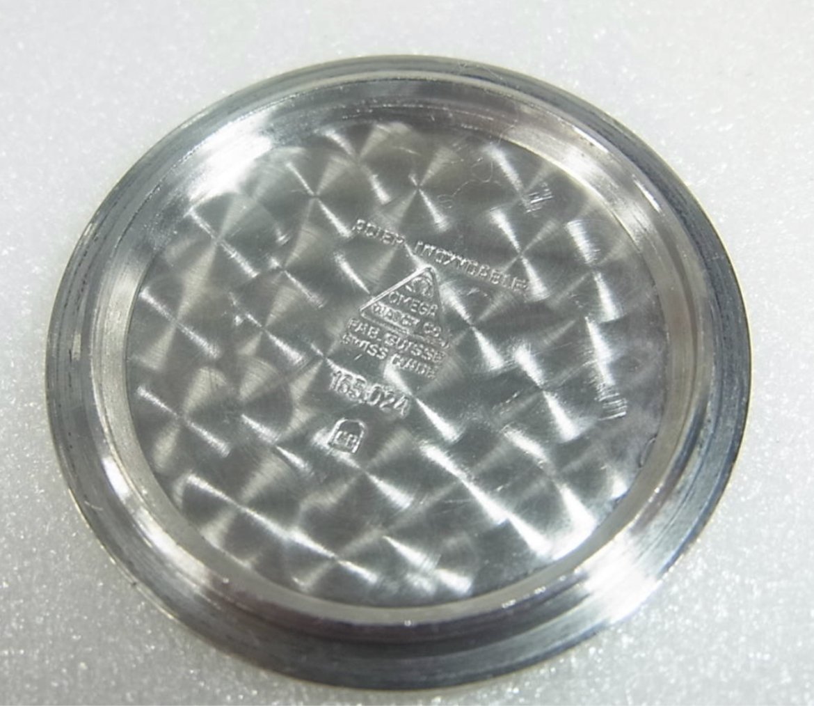

I am not close to an expert on these models, but when did Omega stop using the associated Huguenin Frères cases?
13,555
23,503
I don’t know the exact changeover point (or if there even is a precise point) but the switch to CB occurred around the early 25m serials I believe. The bezel type aligns with other CB cased watches.

This flat top 1 B3 bezel is mostly found on HF cases, so very probably was swapped.
Switch in HF/CB id cca mid 1967, starting with cca 25 mil... but the line is not sharp of course.

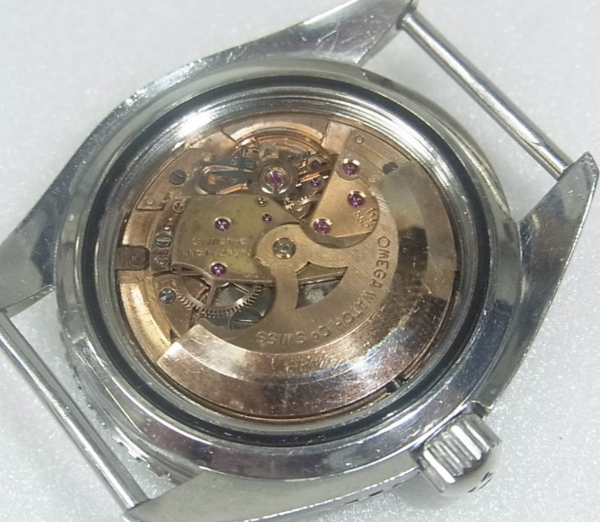

All other parts seems legit and if I can have a piece of SN, can tell more then...
Based on the caseback engraved serial, I`d place it to the UK military batch from SEP69, 27.5mil...

Seen this one too... But I do find myself wondering; has anyone ever seen a Big Triangle Mil-Spec 165.024 with the circled T mark above the hands? So far, I've only found them with the T below, or with a small triangle dial as as basis.
781
1,342
There are quite a few examples of big triangle and T above the hands on the MWR tracking thread.

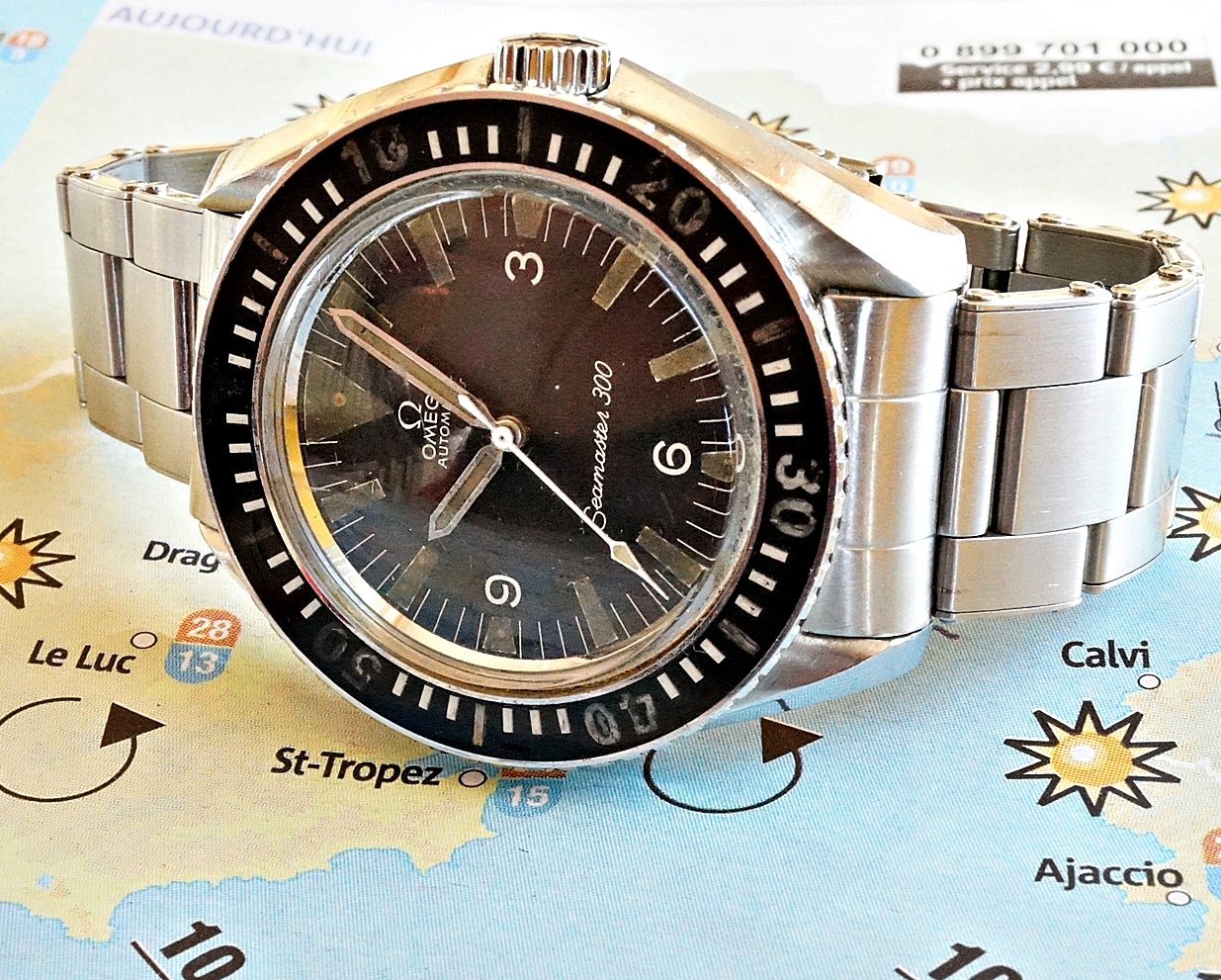

I thought, the TS will BUY the watch ("if interested"), so I gave this advice-based on my knowledge on BTs since many years . ( This is mine) :
Whats is your exact problem with my post?
That’s all correct what u say and if u magnify the movement pic you can see the serial starts with 2
i wouldn’t bother about the bezel or any part as for military watches keeping them in working condition was everything. So if the bezel was cracked it got changed…. Not bright enough in the night, relumed, so nothing would me surprise. Judged from the case condition this one hasn’t seen much action maybe a drunk walk to the officers club.
Why the hands have no lume can just ba an assumption that it was lost after active service but who cares.

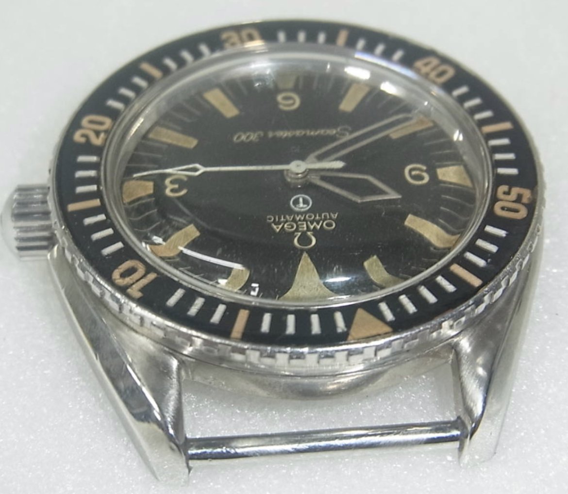

the T above the center post is legit and there are even fat and slim print versions.
just my uneducated 50cents and no recommendation to buy
273
388
Dial: legit, I own a big triangle with high located circled T by myself.
Bezel: legit, but earlier version, so it might have been swapped as said before.
Case, crown, welded bars: legit.
Caseback: legit, there is no real switch point for HF>CB regarding MIL SM300.
Engraving: legit, fat engraving on unpolished caseback started from issue no. 31x/70 on.
