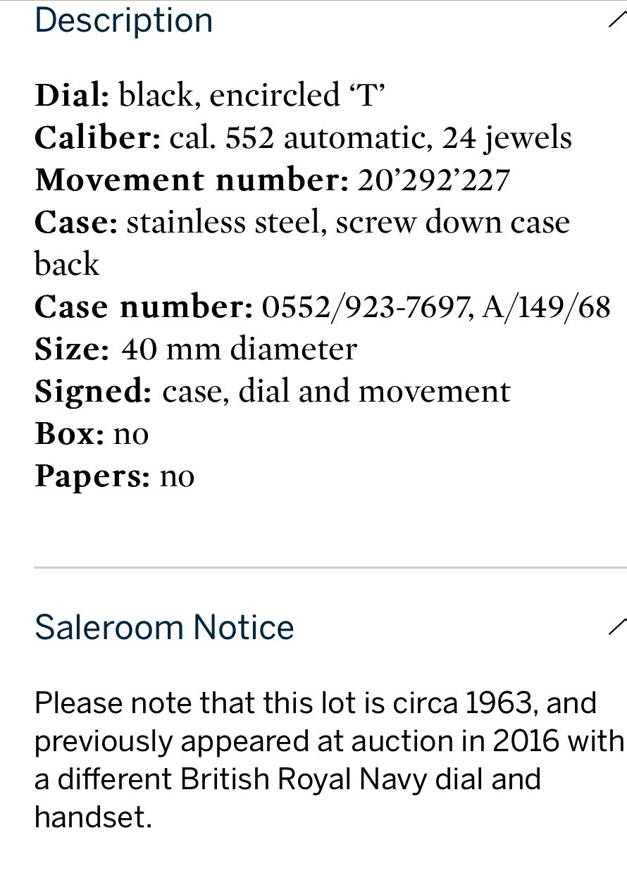

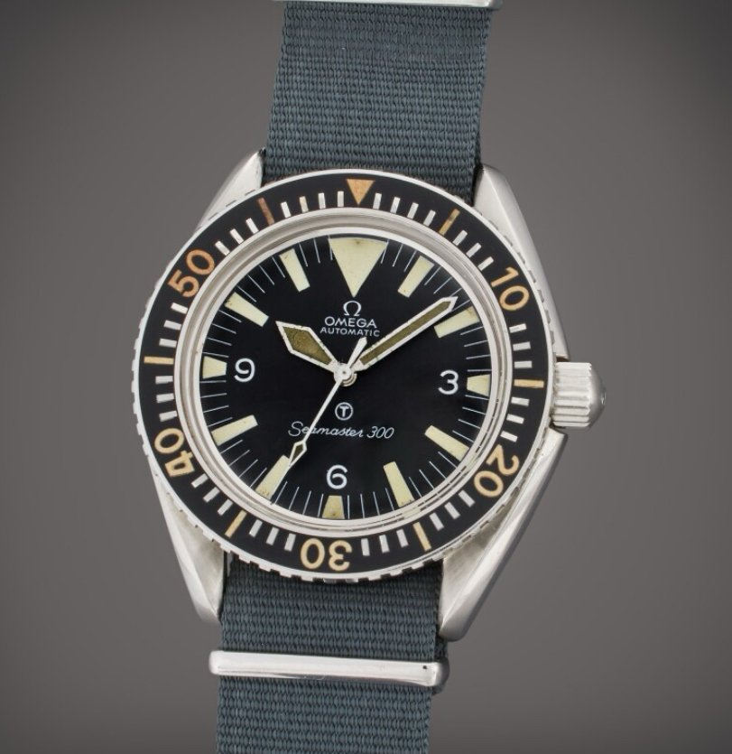

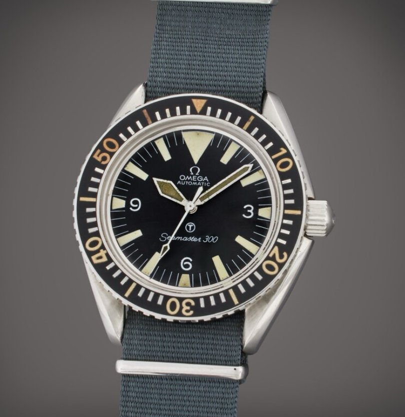

Bit of a mutt in Sothebys nyc (“military” SM300)

Current bid at $18,000 for that mutt. Three hours remain and I expect the final price will go up.

I’m wondering if we are going to see a new member in a few weeks asking us to verify that his MOD SM300 is all original.

.. even openly selling a watch that is essentially a Franken, must have some kind of impact on Sotheby's reputation, you'd think they'd run a million miles from something like that

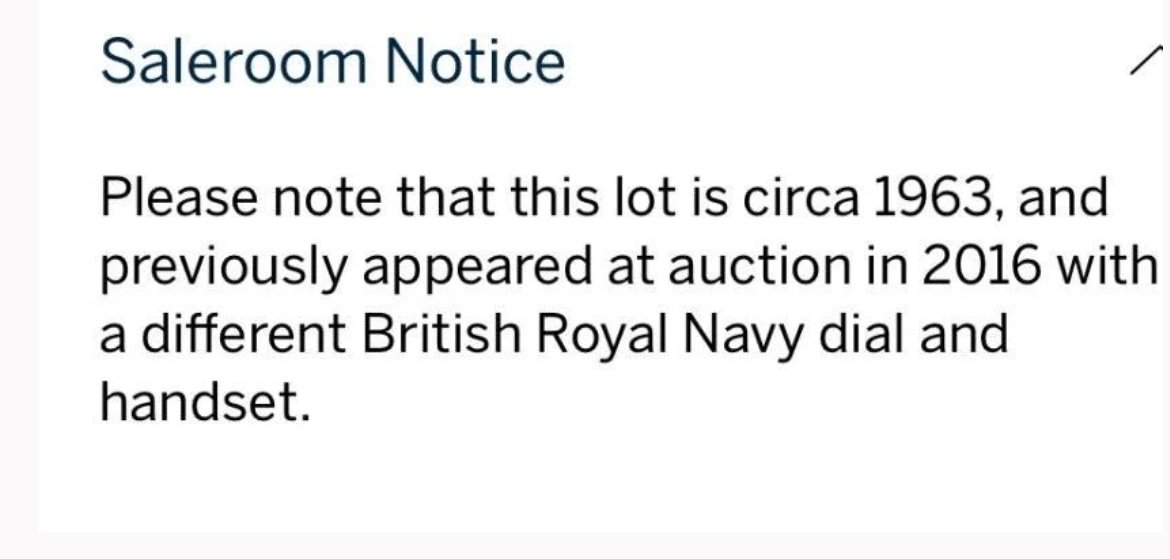

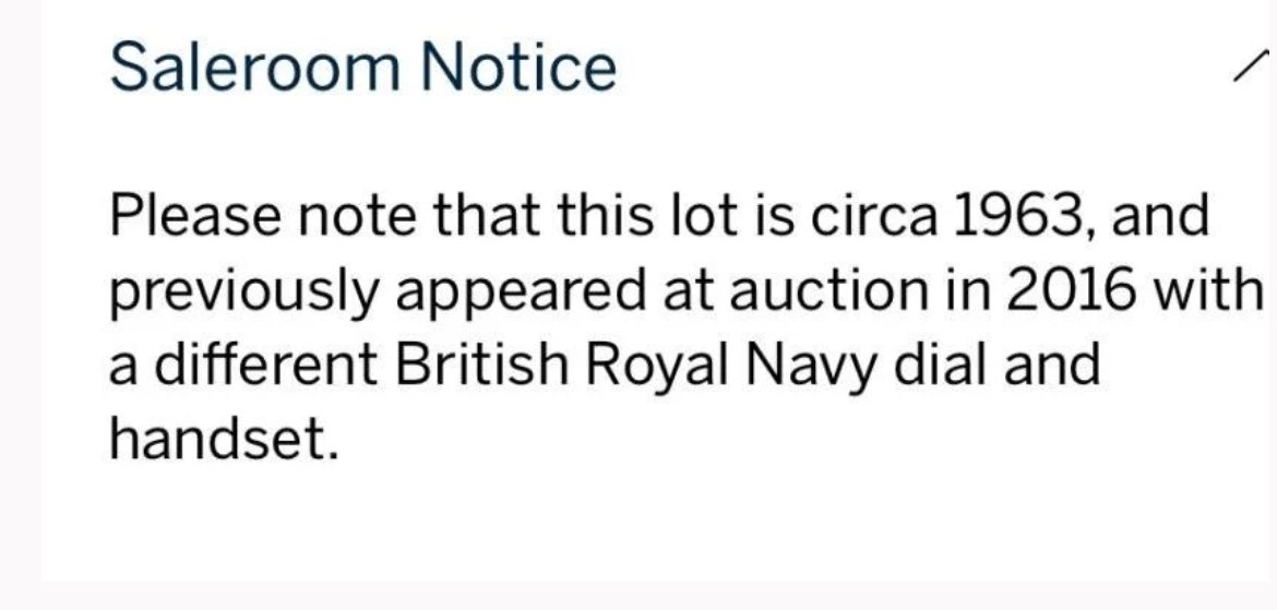

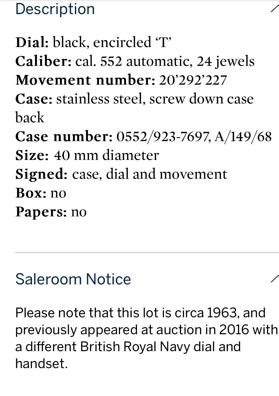

I think the note about having a previous different dial was added later. Possibly they didn’t know and were advised about it after listing?
1,320
1,679
I think you're probably right, but it's still surprising they didn't pull it, they do that in other markets often ..they must know that anything tainted like this, would get spoken about in the trade and places like this, especially given the Philips 57 (2915-1) Speedmaster debacle that's still being spoken about to this day, although it's not quite in the same league, and they were Frank about it ..pardon the pun.

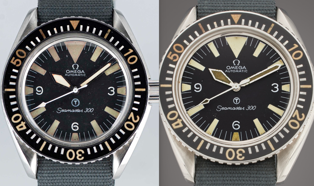

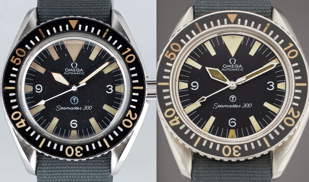

Just for future reference then. To the left how it looked back in 2016 at Bonhams, and in 2021/22 at Watches of Knightsbridge. And to the right the current 'look'. The force is absolutly not strong with this one 🤦
Oh wow.. What a difference! The Bezel looks the same, but the Case looks very different!
I wonder if they swapped the original movement out as well??
592
2,784
It's the same caseband as in the old auctions. Just dressed up 'a bit'. Movement is also the same, but again still so very wrong.
1,320
1,679
... actually it could be the same case just very bad lighting in the second
