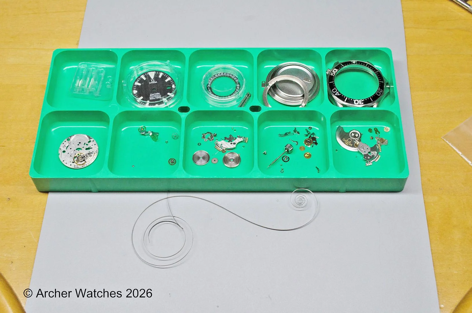

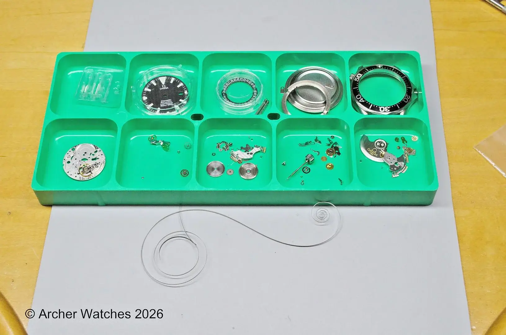

It should be very uncommon. Dials should not be getting routinely damaged from servicing.
It would be interesting to know his hand removal procedures. You might want to direct him to this thread for some tips:
One thing I don't mention in that thread is what I do with the dial once it is removed. Once the dial is removed from the movement, it immediately goes into a container all by itself. That container then goes into a covered tray where the other parts of the movement are disassembled and sorted by function - looks like this:
The cover is not on the tray at this stage, but the dial is in a container that a movement came in and it stays in there through the entire service until it's put back on the movement. When it's on the movement, the movement is always covered with a plastic dome unless I'm directly working on it.
I often see what I call watchmaker glamour shots, with all the parts of the movement and the dial/hands laid out on the bench in nice order. It makes a nice photo, but all I can say is if my watchmaking instructor ever saw me leave a dial sitting face up uncovered on a bench, it would not end well.
