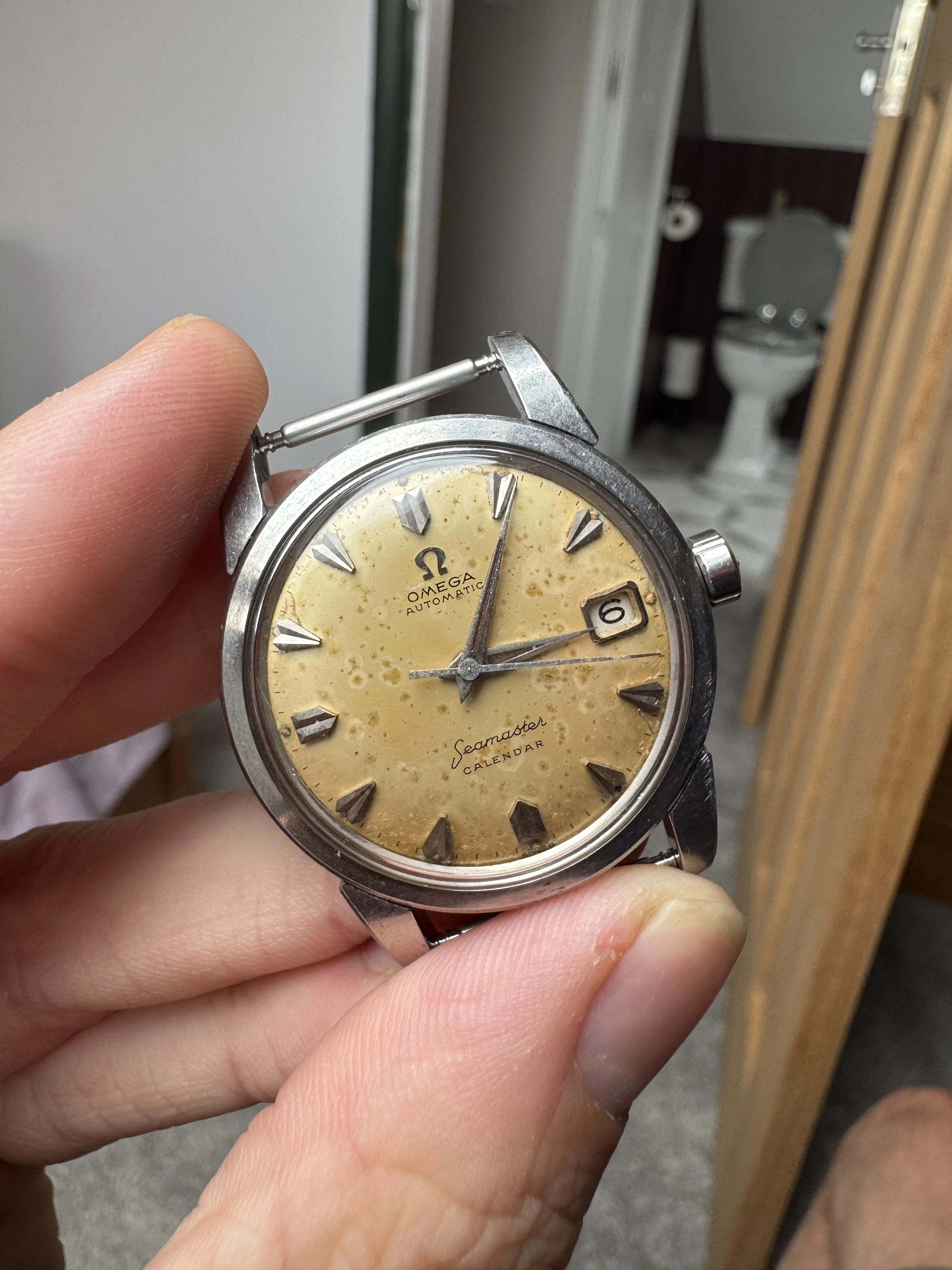

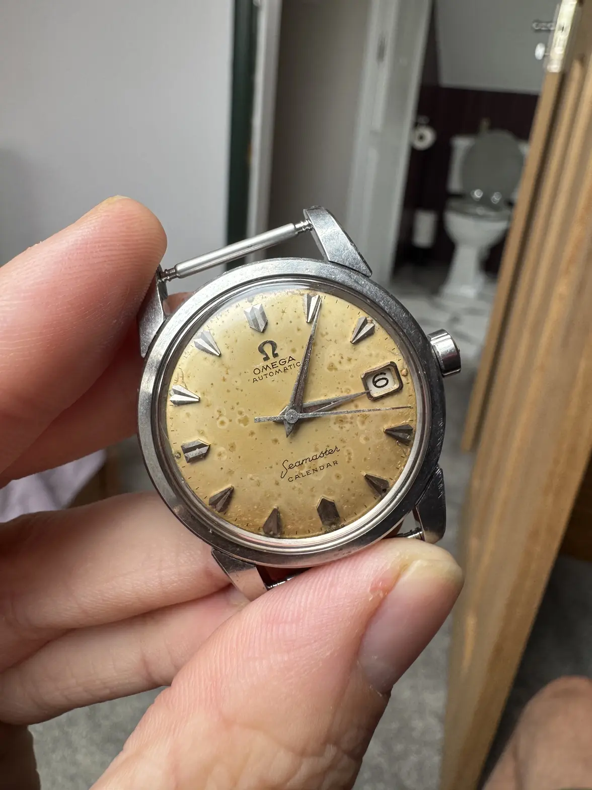

Hi all.
Just received a watch back from my watch maker. The replacement crystal is chipped internally at 5oclock. No biggie. This can be sorted. But also, see the before and after scratch to the dial.
Not feeling too great about this. My question for the OF is, how common / acceptable is this? Am I right to raise these issues with the WM?
Crystal issue:
Before scratch:
After:
Thanks as always guys. I won’t name the WM as I don’t believe in shaming for honest mistakes and they haven’t had a chance to talk to me about this.

Clearly not visible on dial with crystal freshly removed. How does a scratch like this even happen - reapplying the hands perhaps? Odd place for it to be…

On the crystal damage, I will ask for a replacement. What are peoples experiences here with minor watchmaker marks on dials?

Dramatic macros aside, the watch looks like this:
Probably not worth replacing the whole dial over.

The watchmaker has essentially claimed the scratch is not them, their response:
“I am very sorry about the crystal. Of course you can send the watch back, and we will fit another crystal.
In terms of the dial, I have to say, that I didn't even touch the dial's surface, due to it's very bad condition, but of course,
we had to take it off, to make the watch working again, which it didn't, when it came in.
Overall I am not sure, as the dial is full of scratches anyway, if this one has been there before or not. In this case I would kindly
like to refer to paragraph 1 of our terms and condition, on which you have agreed, when booking the watch in.
I will now file a warranty return for you, so you can send the watch back, due to the damaged crystal, which we then will replace.”
Calling this dial full of scratches is a bit of a pisstake, no? Aged yes, but it didn’t have this mark on it before. And that’s evidenced by their own before and after photos?

Ok, as someone who is a bad watchmaker, my take 😁
It is actually possible to get damage like that on a dial just by handling it unfortunately. On older/damaged dials, the paint near the edges can be somewhat 'lifted' or delaminated off the metal, and just touching it causes it to flake off. I've noticed this on dials I've worked on (and seen touchups of other watchmakers who clearly ran into the same damage).
I WILL say the damage above looks exactly like what I've seen with that. So YES, they DID cause it to flake off, but frankly, I don't think it was avoidable. Just touching it causes this.
