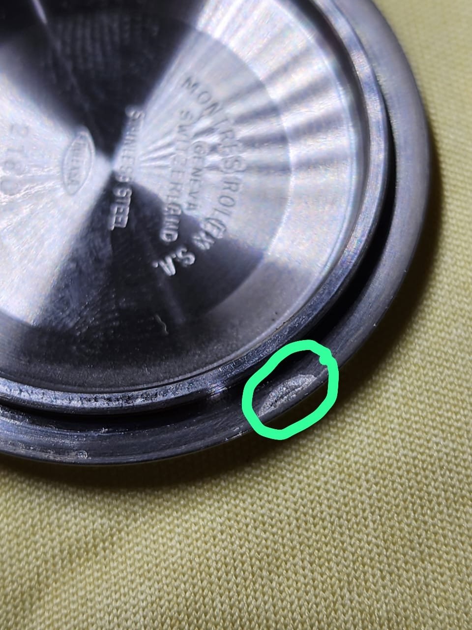

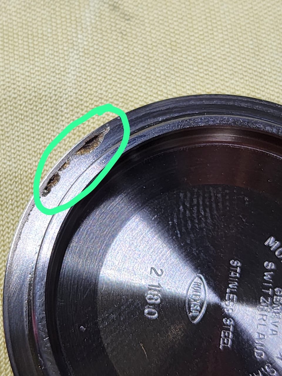

Hi, I’ve purchased a Explorer II with a partially rusty inner caseback (I knew it) , my idea was to have it fixed via laser welding (had welding on a Omega case done before) , one watchmaker I asked here told me his technicians say it would be too difficult to do? Is that true in your opinion? It’s a bit complicated to find the correct replacement caseback (the one with the curved lettering) that’s why I wanted to do it. I appreciate your remarks

I had a watch case with some surface pitting that I tried to get laser welded. Everyone I spoke to said they cannot laser weld pitting.

In my experience, the better people who do cosmetic laser welding do not want to work on these porous corroded parts because the results are very inconsistent and they can't guarantee them. You might be able to find a jeweler or hobbyist to give it a shot.
Because your corrosion is quite far out on the flange, and the inner part looks pretty good, I suspect it might still seal pretty well. You might just want to have it pressure tested before going to extreme measures.
