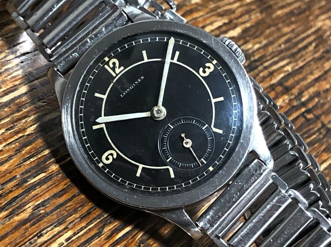

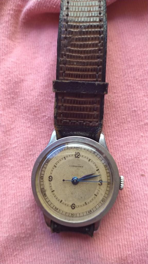

Reviving this thread to get some thoughts on this example I'm considering for purchase. Case and 12.68z movement serials match. Extract dates to 1935 in Italy and lists ref 2326 which is consistent with this style case, as far as I know. My hesitation is with the dial - the text and print configuration. It's a close match to the dial earlier on in this thread but the subdial, minute track, and text are not. I also searched the ads and catalogs I have and have come close but no match yet. I'd really appreciate some feedback from the more experienced here. The applied sector dial is a grail for me, but don't want to make a foolish mistake.
On the first view the "Longines" looks different from others, not correct in my eyes, also the subdial print.
Thanks. Glad to know my suspicions are well-founded. I'm leaning towards passing on this piece, but I'd still love to hear what others think. Also looking closely now at the hands and while I love this style, they appear slightly too large for the dial.
Signature and sub-dial are wrong, it is redial.
