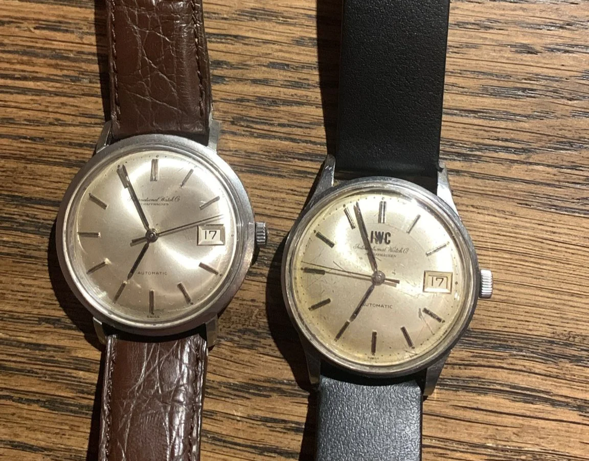

Hello,
I have a question on dials on Calibre 8541: When did IWC start using the "double logo" variant?
I am talking about the dials that have the applied "IWC" and the printed, long "International Watch Co." script. I understand that these were used on Cal. 8541 watches, which were introduced around 1964. But did IWC use applied logos right away? I associated them with late 60s/early 70s...
A little bit of background and why I ask this question:
I have two IWCs with Cal. 8451 that are around the same age by serial numbers. But one has a "double logo", the other one doesn't:
Ref. 808:
Movement: 175xxxx
Case: 177xxxx
Ref 809:
Movement:176xxxx
Case: 175xxxx
Accoring to moeb.ch's DateYourIWC, both of them get very similar "birthyears": Calibres are 1964, cased and delivered up to '68. Most likely 1964 or 1965 watches.
Now, I ask myself if the double logo dial on the 809 is a later replacement? Or did IWC just put dials on movements that were available at the moment? I'm thankful for any information around this topic! 😀

I'm not completely sure, but I suspect that the one with the applied logo is a replacement dial.
Probably it went to IWC and they replaced the original dial because of tritium. IWC often did so; in fact, many dials have the writing "swiss" instead of "t swiss t" because of a replacement by IWC themselves.

@osterman Thank you! That definetly happened often. But the dials on my watches are both non-lume.

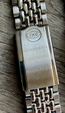

Does anyone know which time period this bracelet logo was used?

I found online a bracelet like this one produced by Gay Freres in January 1968

@gatorcpa @osterman Thank you very much for your help! I am getting more and more the impression that the watch was either born with the dial (because it could be delivered until 1967/68). Or the dial was “updated” shortly afterwards. However, I do not have the impression that it is a “wrong” dial in the bad sense.
@vibe My gut tells me 60s, too. But I'm not sure if this particular example is authentic.
