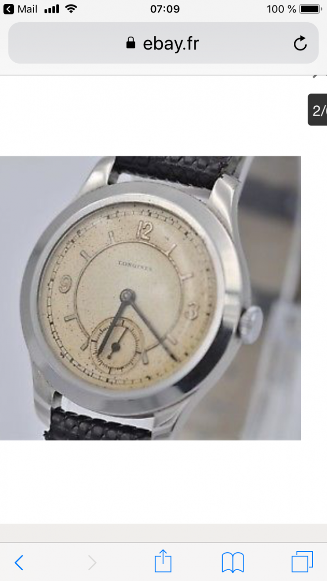

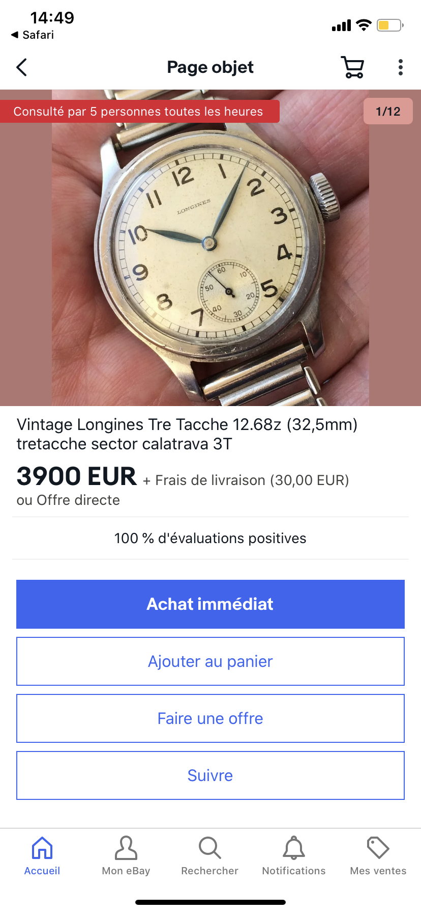

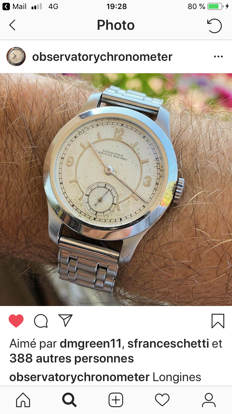

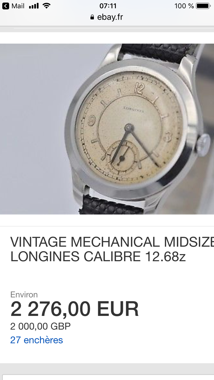

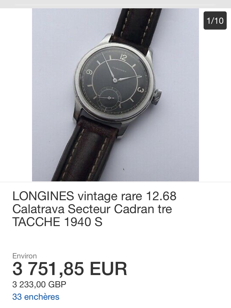

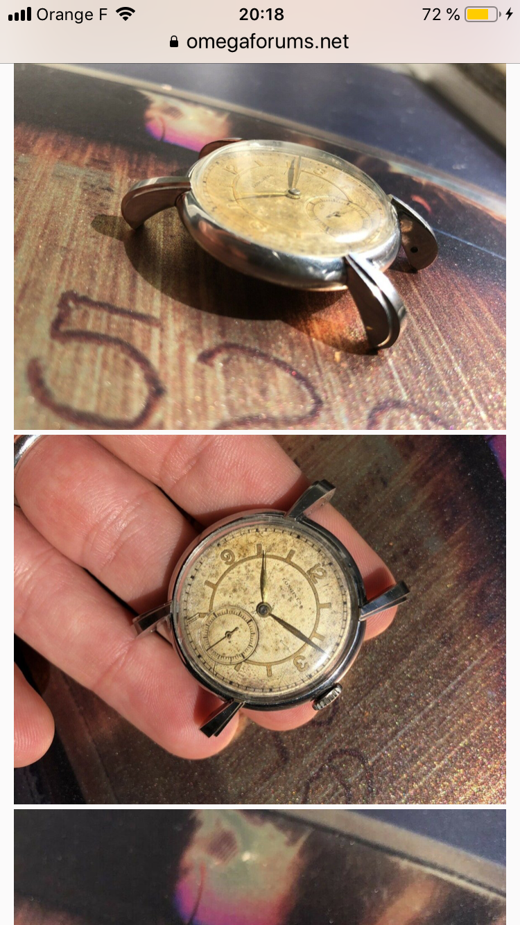

I agree with @DirtyDozen12 that this dial would look more plausible in the first generation TT case, but the market thougt otherwise. 3300£ for a 32,5mm must be some kind of record?

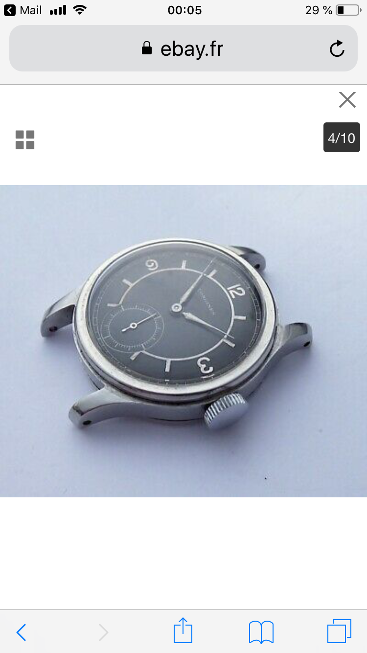

That's a hefty price for a franken watch. Wish I'd saved the pics. when it sold for 400 Euro's on ebay in a different case

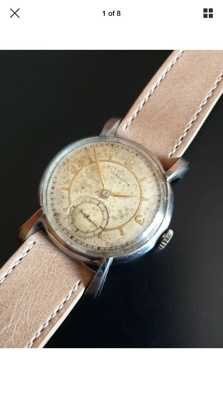

I strongly believe this one is a redial though I’m not an expert. There are certain inconsistencies on this one.

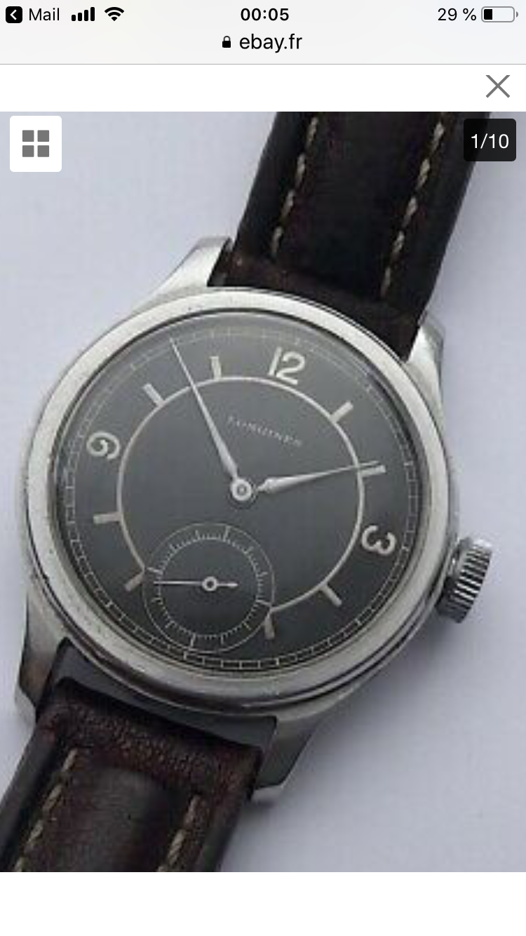

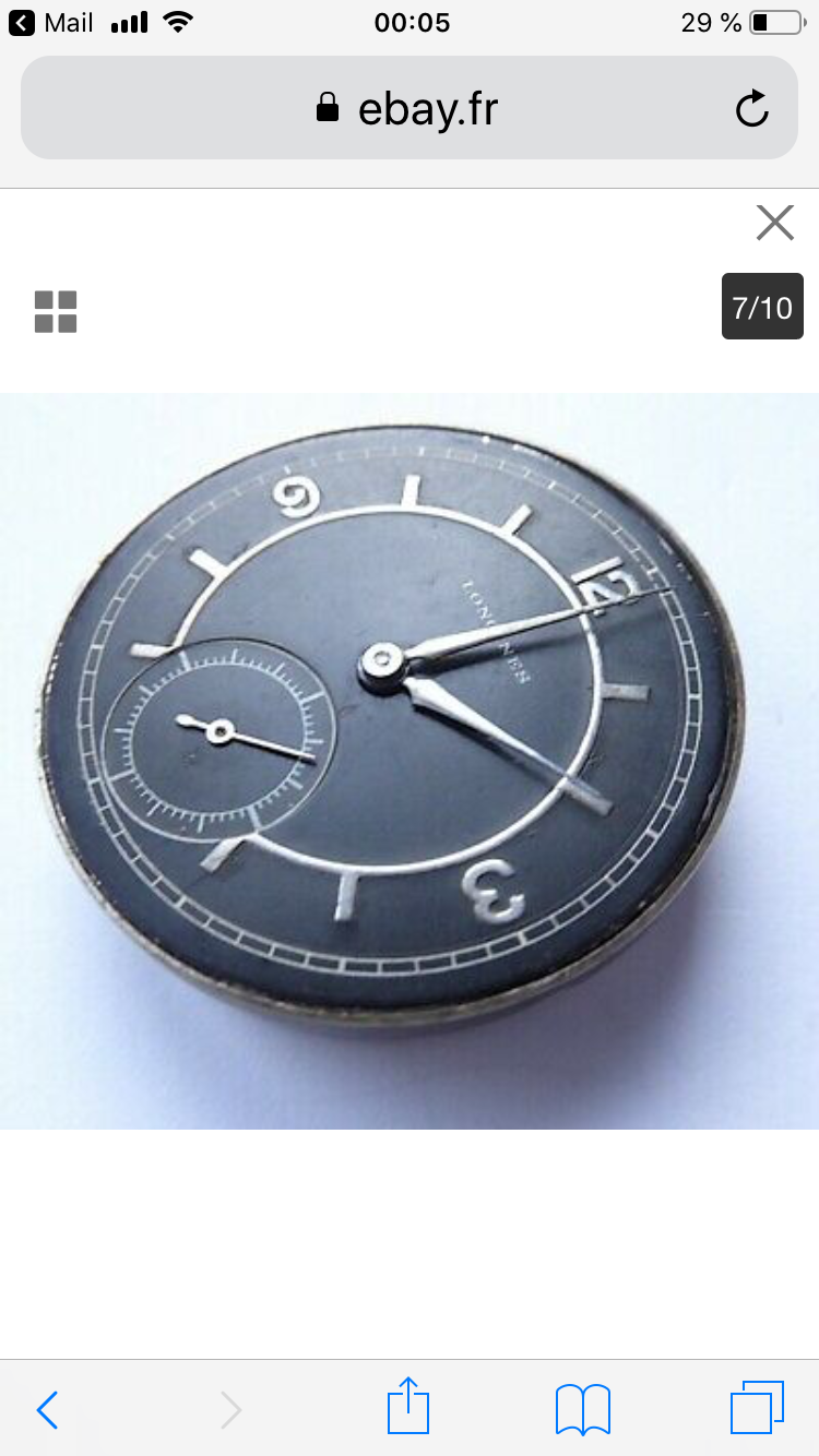

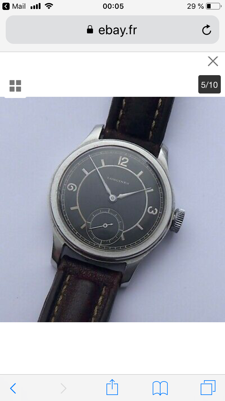

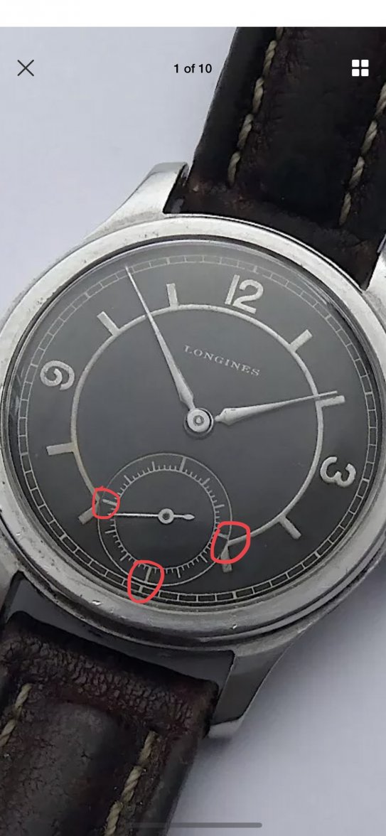

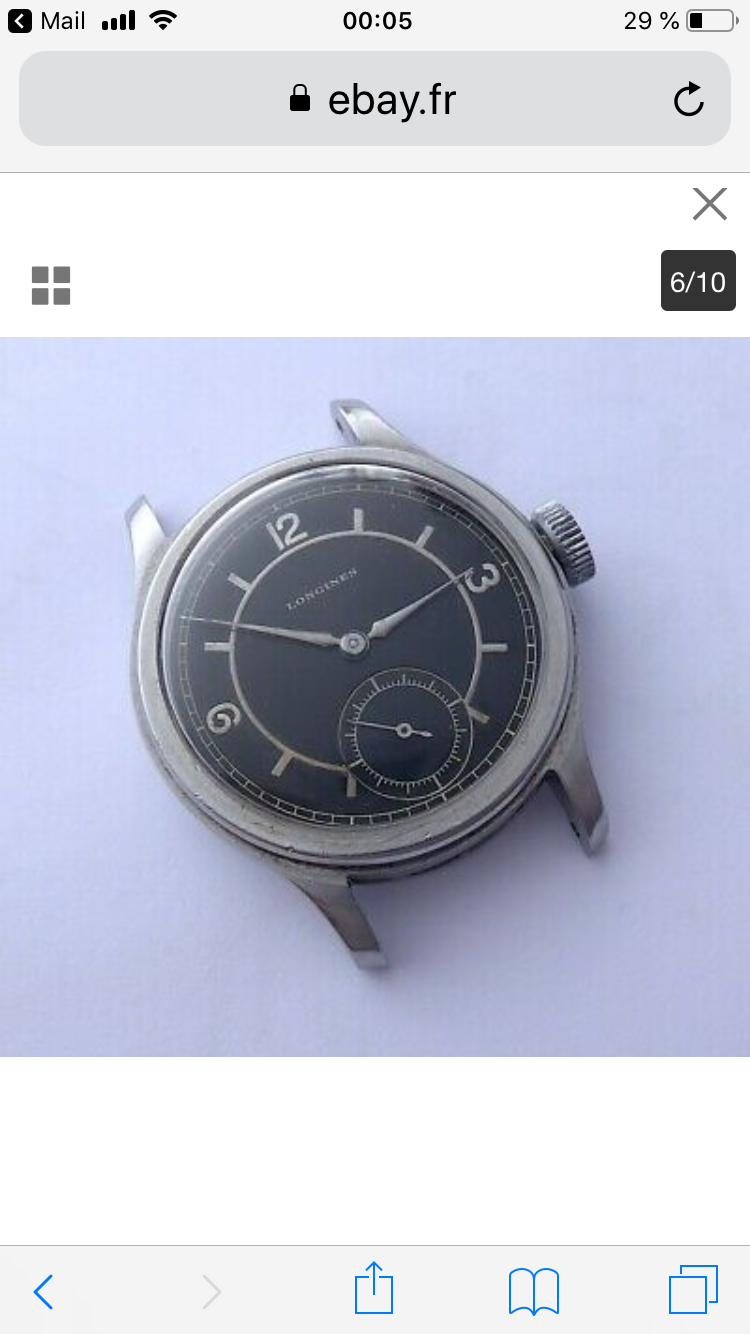

As a follow-up to my previous post on this watch (https://omegaforums.net/threads/recommended-longines-watches-on-ebay.3388/page-42#post-1199692), archival information suggests that it did not originally come with a black dial.

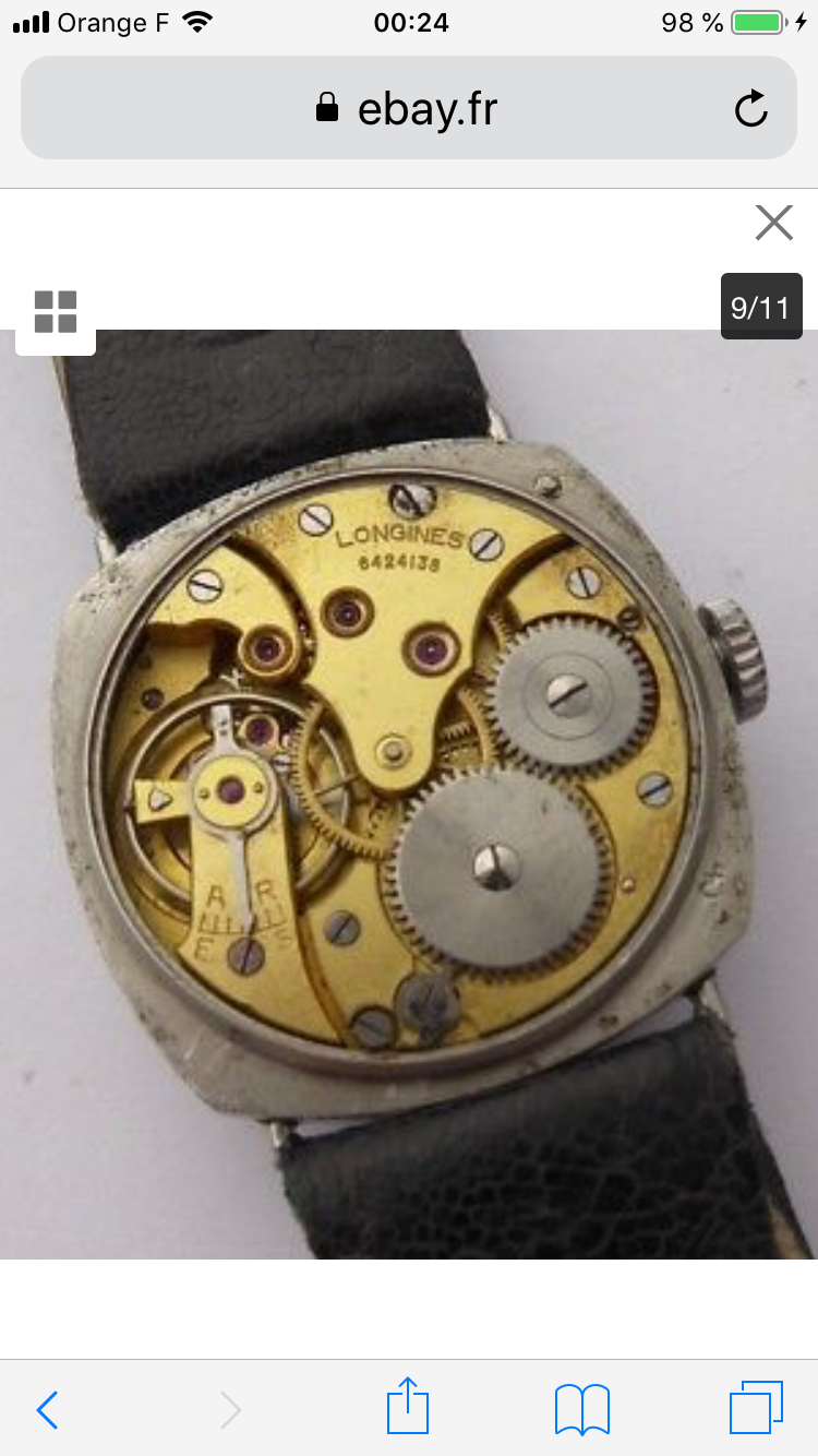

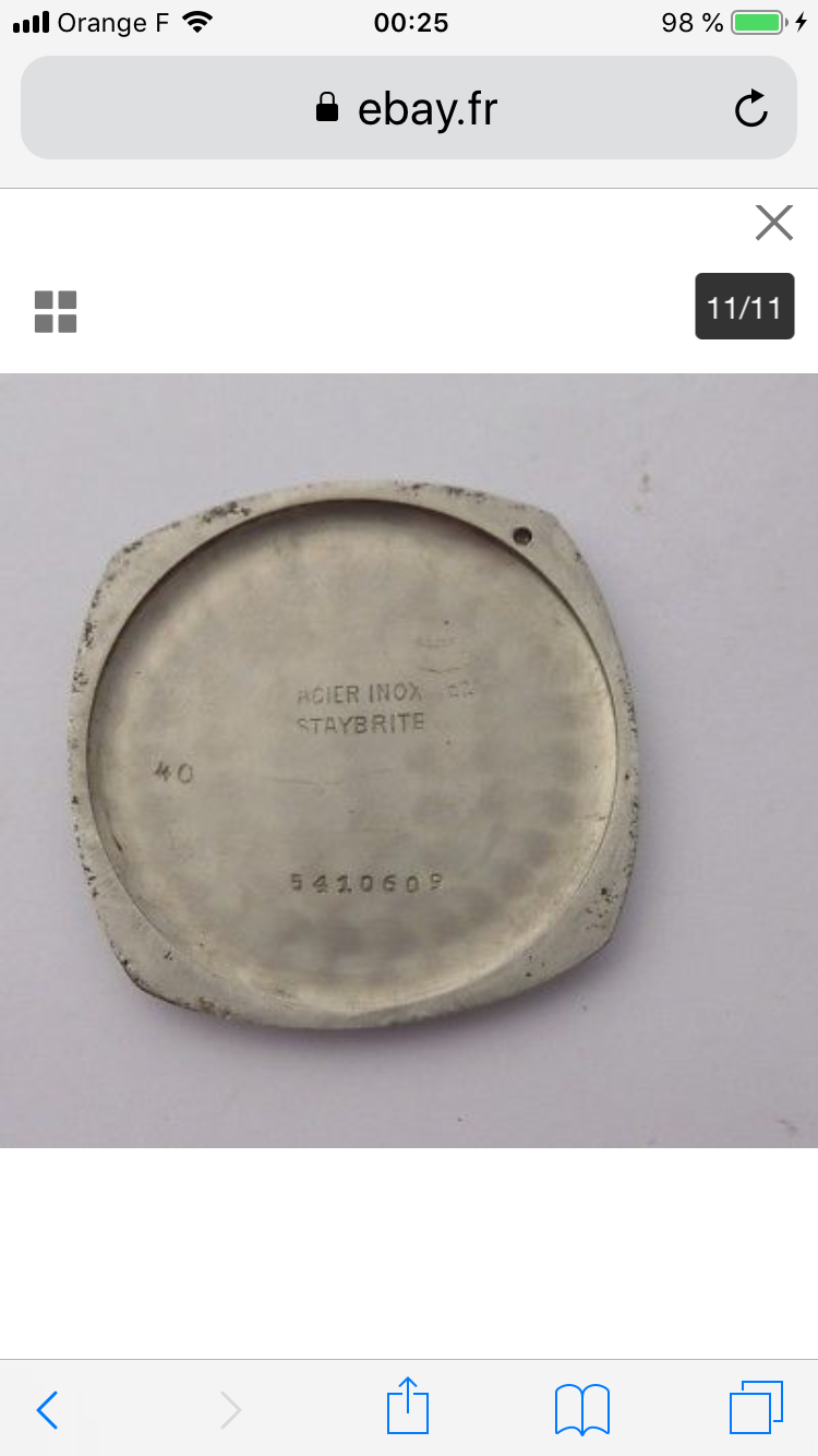

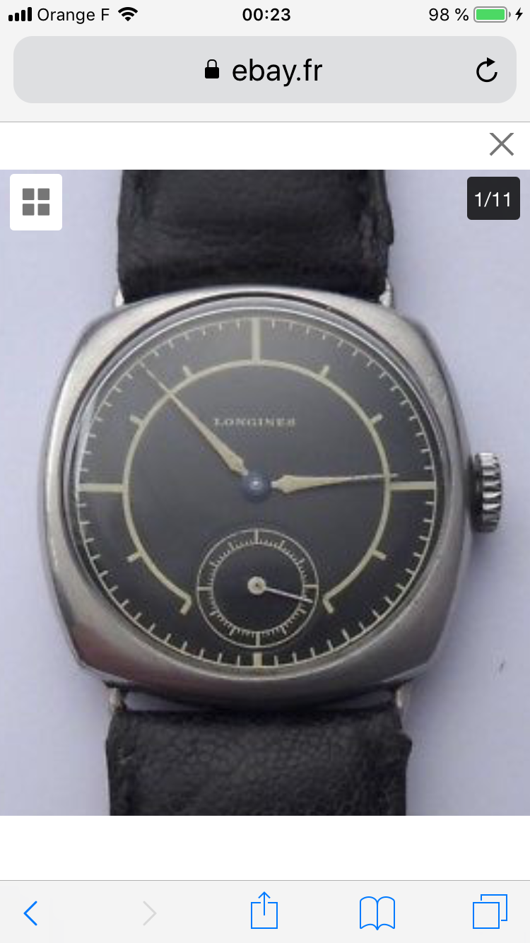

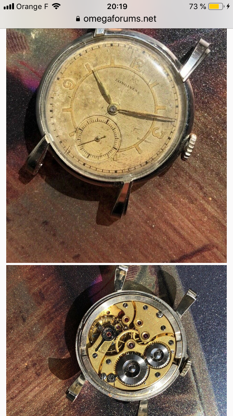

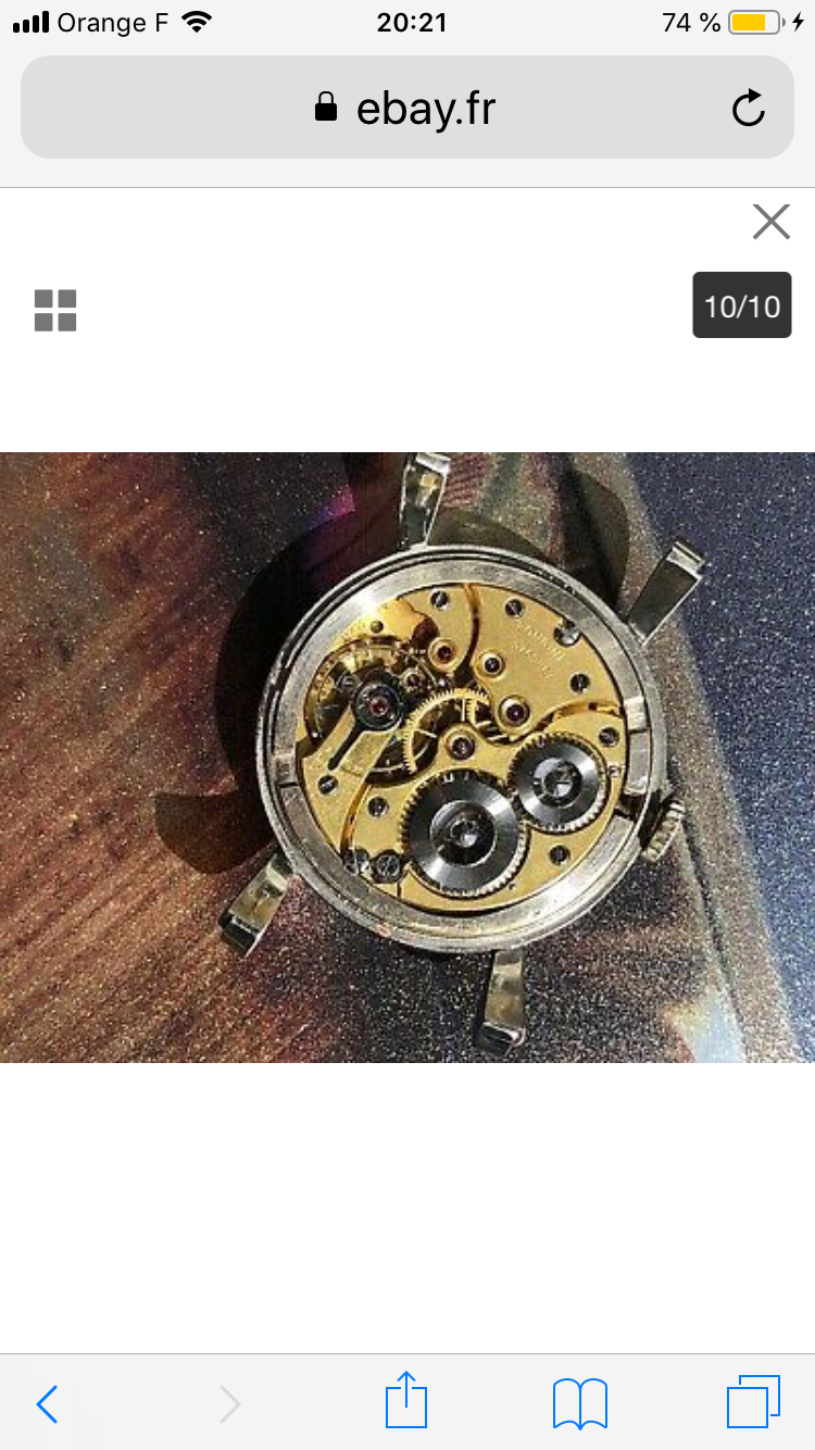

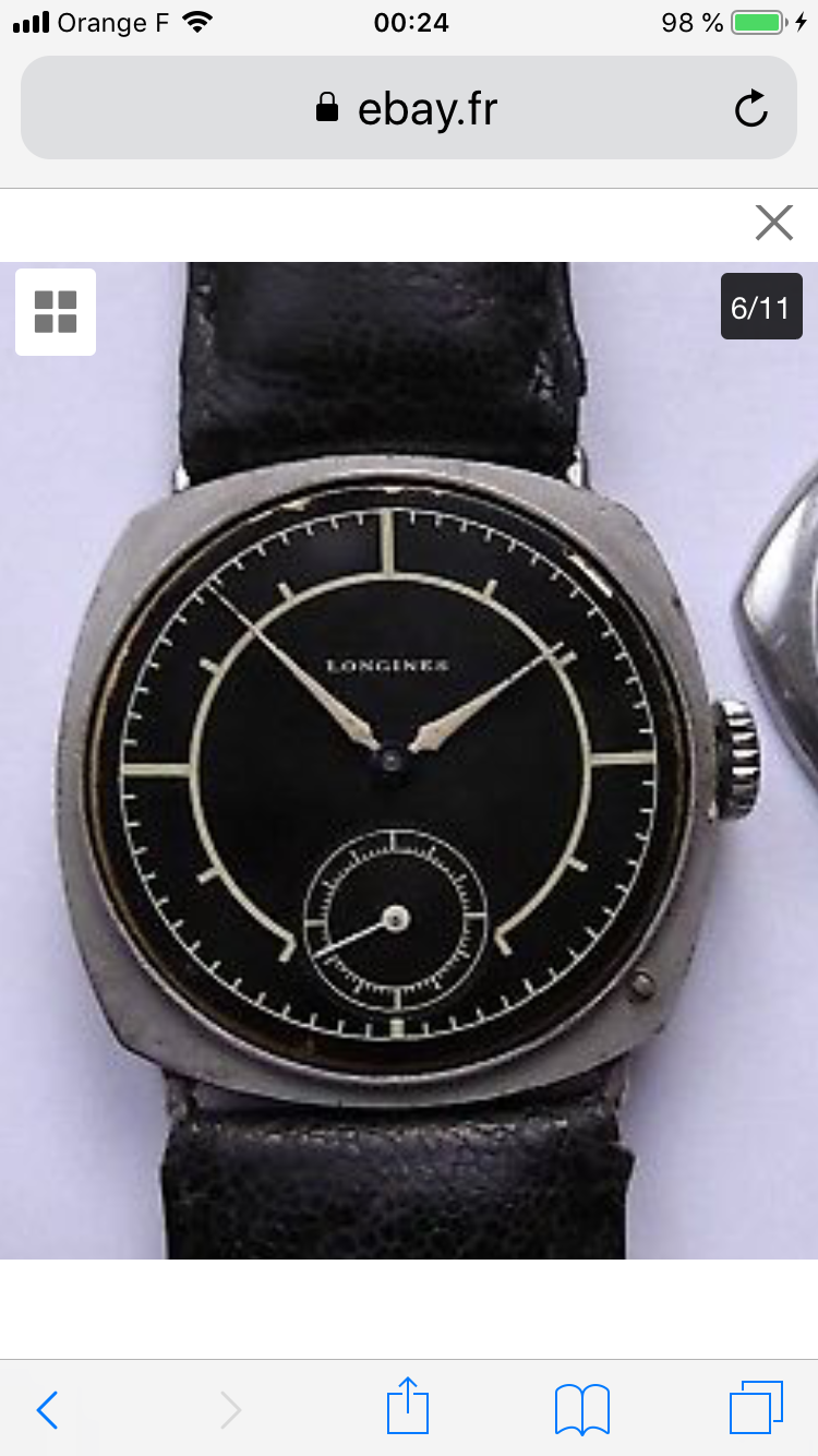

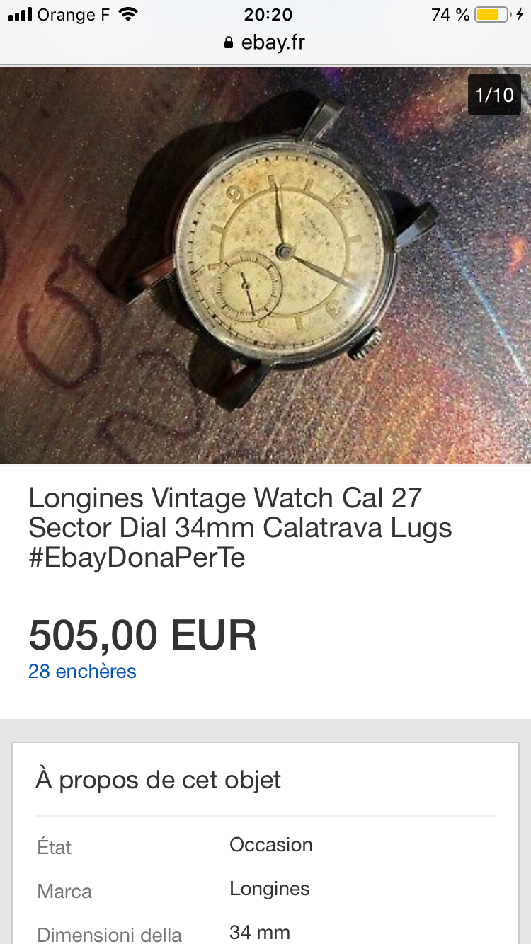

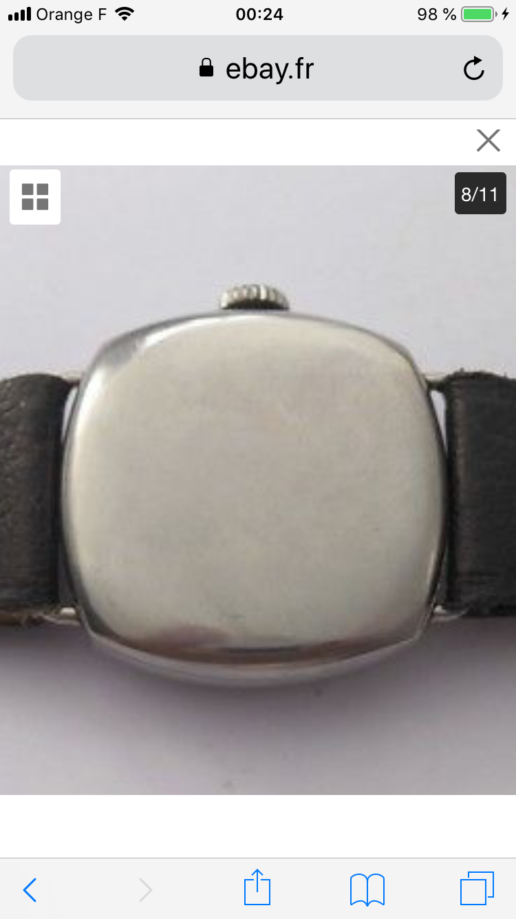

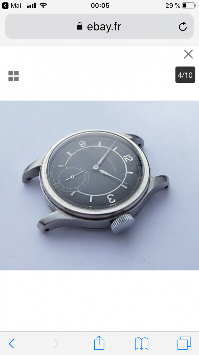

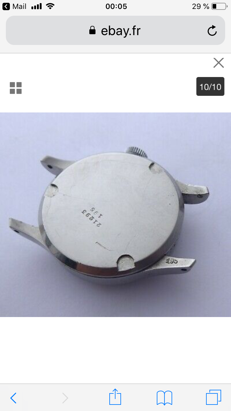

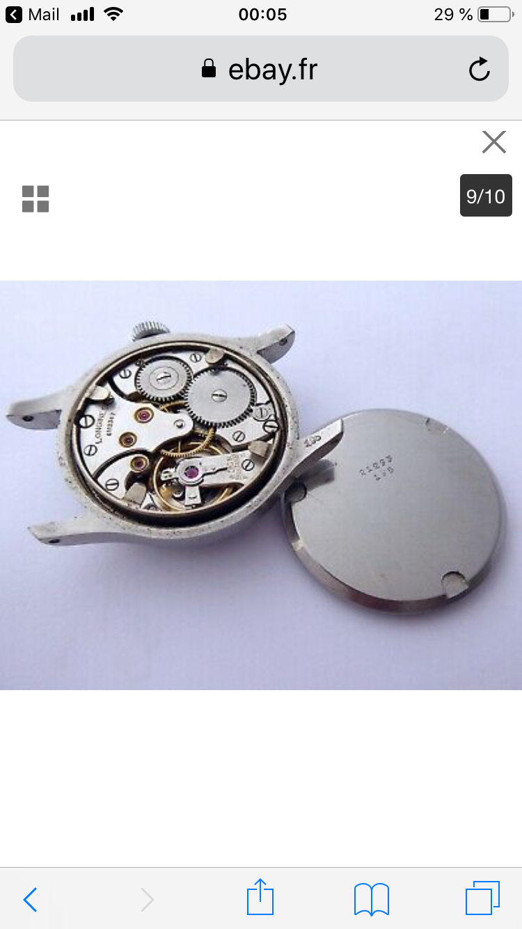

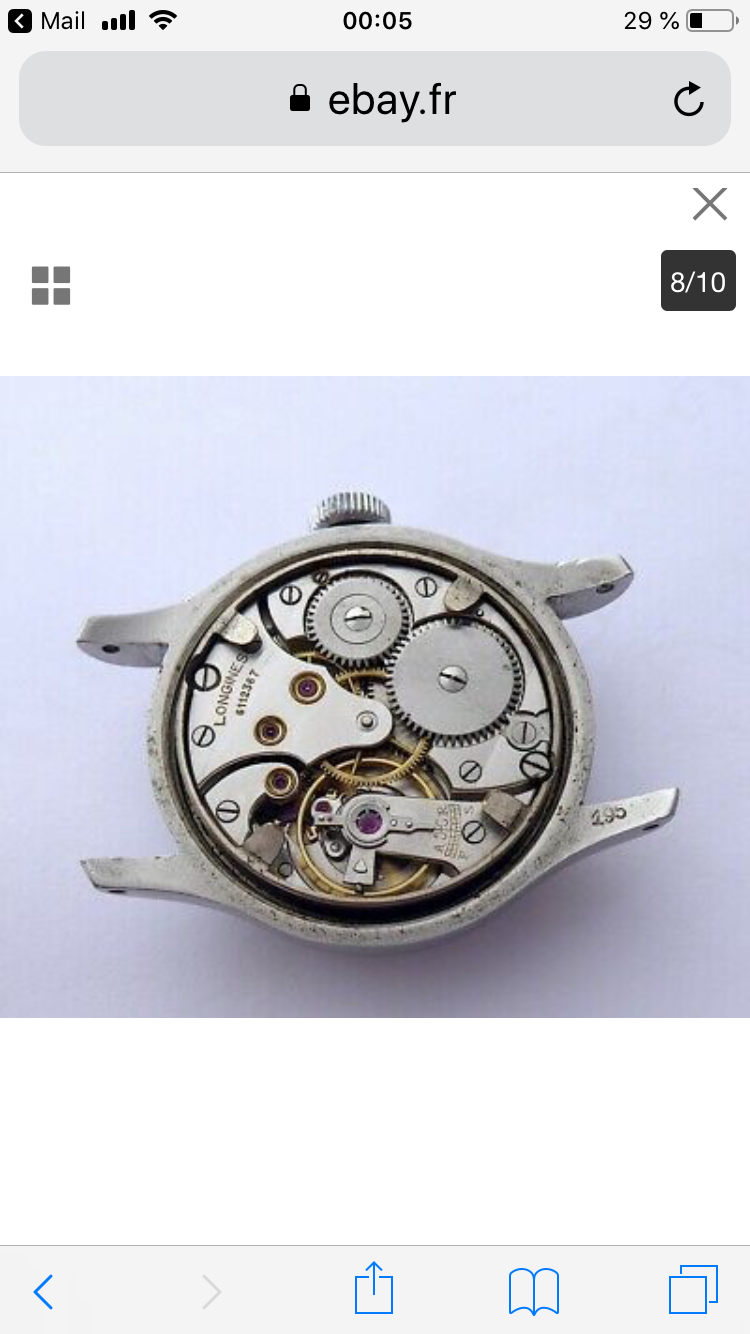

I knew what you were alluding to sounded familiar — but are you sure the watch you saw was really the same? I think there’s a fair chance the one you saw is below. I saved these pictures on December 8, 2018. The hands are similar. The indexes are not raised even though the pattern is similar- however one dial has numerals and the other doesn’t. And this watch is definitely a franken as the serial number on the case (from about 1937) ought to be the same as the one on the movement- which it isn’t. The movemnt serial is from the 1940s.
Your archive is much better than mine That's the once indeed. Exactly the same hands but not raised. Interesting...!
Memory can play tricks...... so documentary evidence is key. That’s right, hands are the same shape, silver colored steel vs blued steel that’s been painted or lumed on the cushion case. So there’s no evidence they’re replacements even if there’s no evidence they’re original.

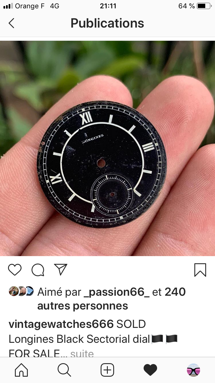

According to an astute member, my post above is rather opaque. To elucidate, I contacted Longines and inquired about 6'112'367. As it turns out, there is information regarding the original dial in the archive. It is indicated that the original dial should not be black, but rather another color. Given the value of larger tre tacches, these swaps will be become more and more prevalent.

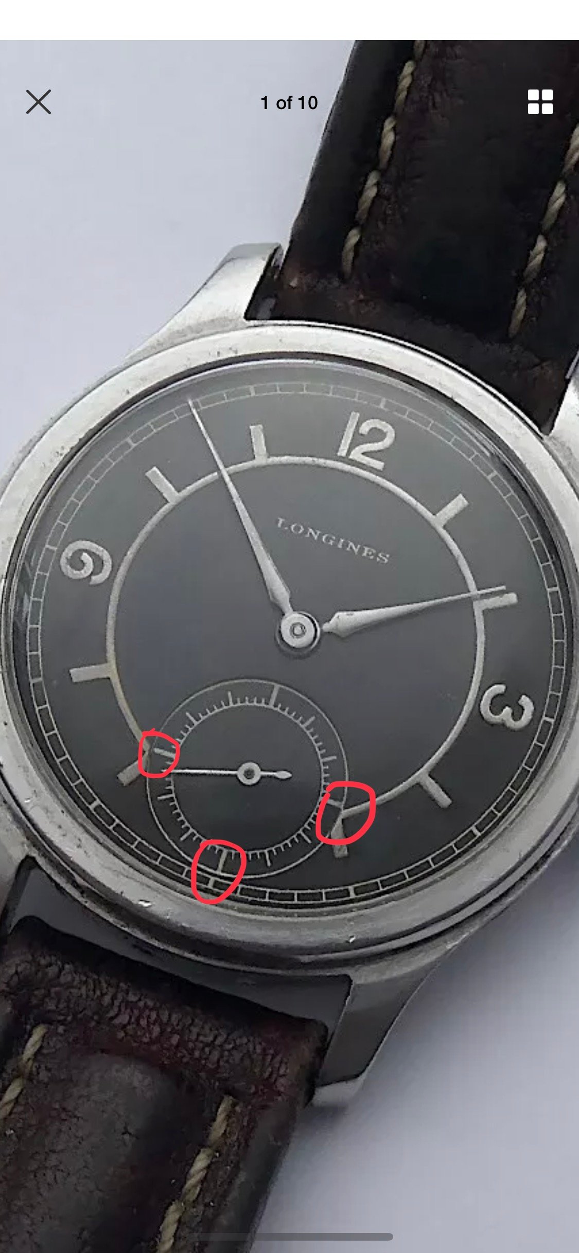

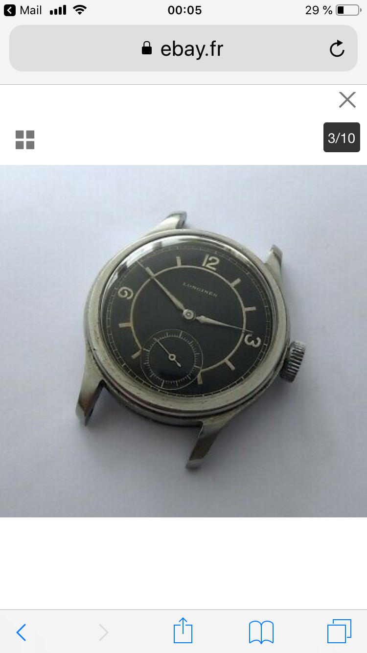

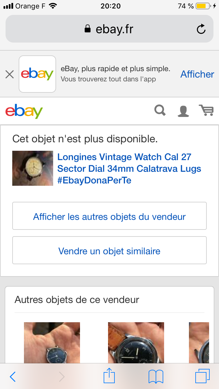

For the record, those are references bearing an applied sector dial. The fact this 32mm reference is not specifically well known or subject to speculation makes me believe those dials are original to the watches. Also interesting to see the matching baton hands on both examples.
Reposting this from another thread. https://www.ebay.fr/itm/Longines-Vintage-Watch-Cal-27-Sector-Dial-34mm-Calatrava-Lugs-EbayDonaPerTe/264264548600?_mwBanner=1&ul_ref=http://rover.ebay.com/rover/1/709-53476-19255-0/1?campid=5337239012&toolid=10001&mpre=http://www.ebay.fr/itm/264264548600&srcrot=709-53476-19255-0&rvr_id=1942276730437&rvr_ts=41209f3516a0a9c4b8c134e6ffe28bbc&ul_noapp=true&pageci=0787d4da-80ba-4f05-8f4e-ec221547ecf3Purchases made through these links may earn this site a commission from the eBay Partner Network

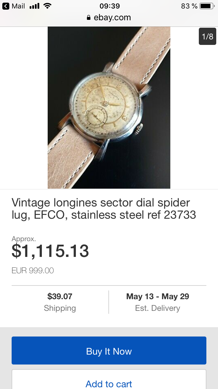

This one seems to have resurfaced. https://rover.ebay.com/rover/0/0/0?mpre=https://www.ebay.com/ulk/itm/113730277347

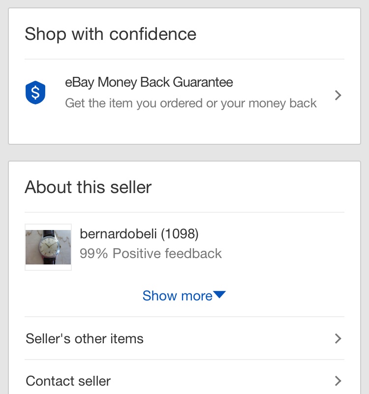

Sure enough, bought for 500 and two weeks later they want 1100- also on Ebay. Another flip worth retaining for posterity. (Seller Bernardobeli out of Ripollet, Catalunya, Spain).

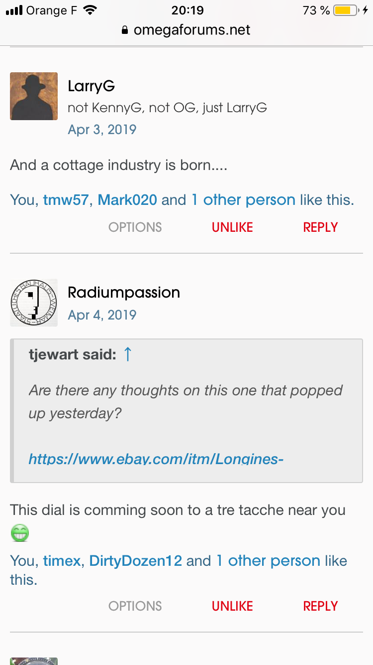

Not an applied sector dial, but probably soon coming to a tre tacche near you— as @Radiumpassion once said so aptly.
Thanks to @DirtyDozen12 , 6112367 now appears to have --thankfully--recovered its original dial. Clearly much more correct period-wise, and it's a nice watch. https://www.ebay.fr/itm/Vintage-Lon...658567?hash=item3b4818d987:g:yEwAAOSwMQ5e0q4tPurchases made through these links may earn this site a commission from the eBay Partner Network
