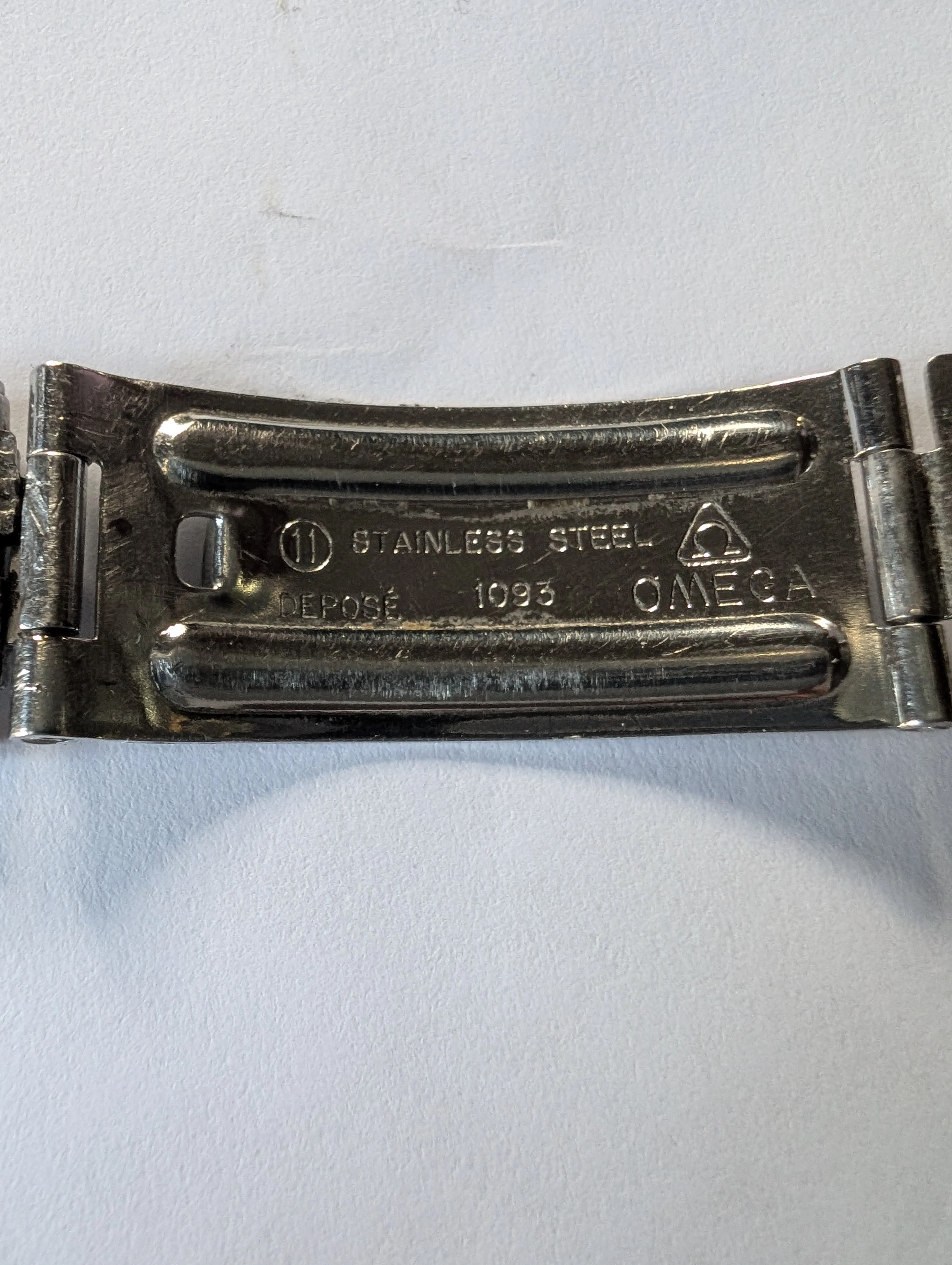

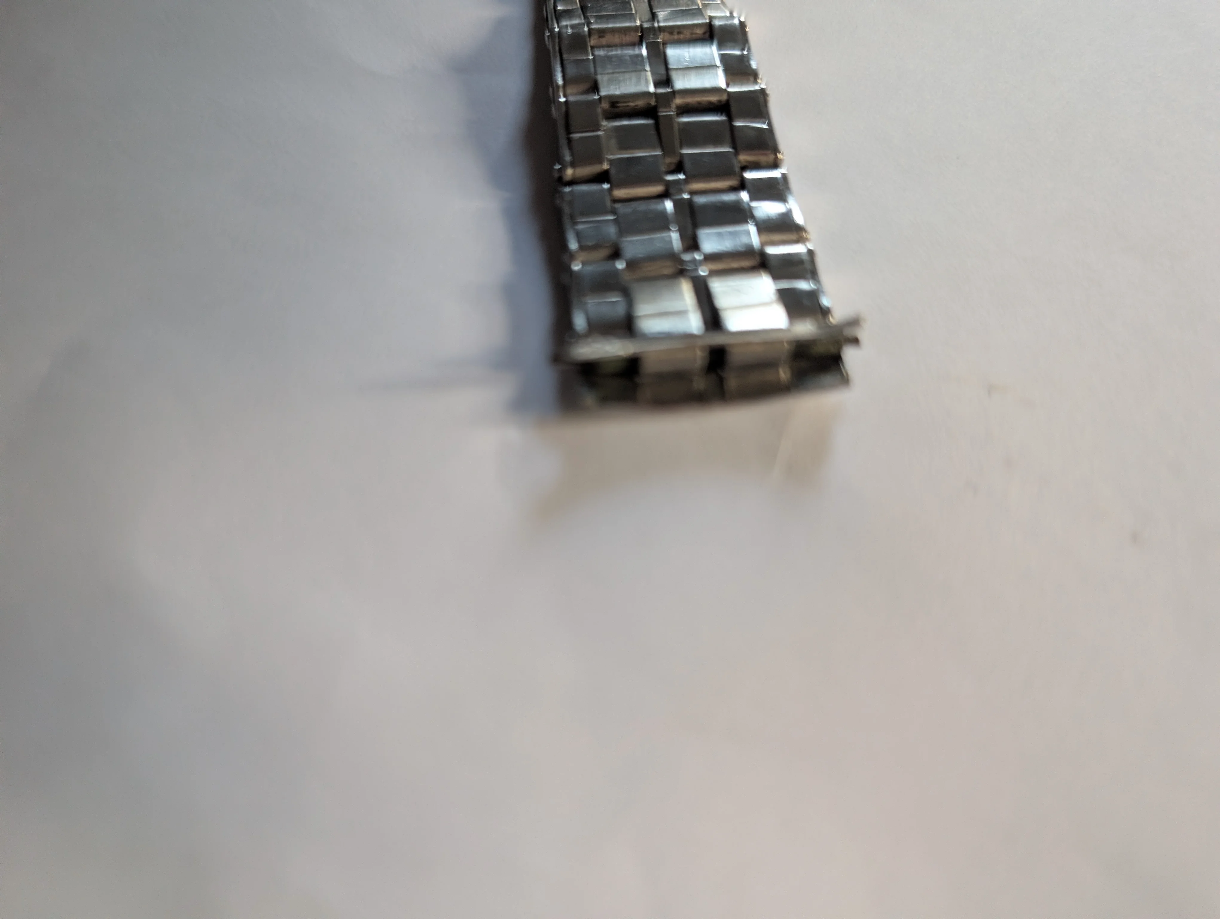

Hello,
we found this bracelet in the belongings of my father in law, passed away long time ago. My wife would like to use this bracelet as a memory and we want to find the watches, that once has this bracelet.
Anyone knows, which models could have been sold with it?
Thanks a lot

166.035 and 166.045 show up on chart

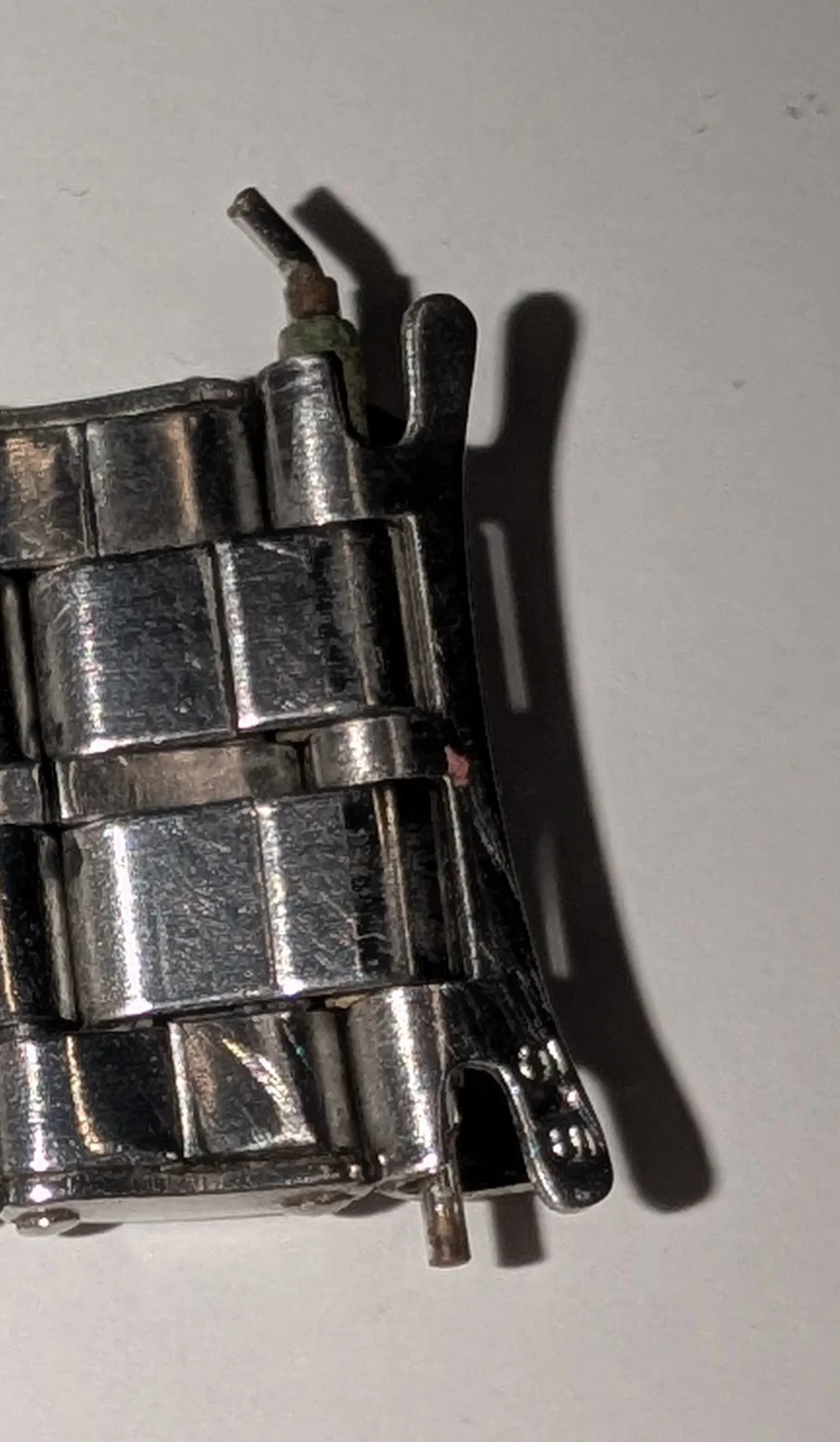

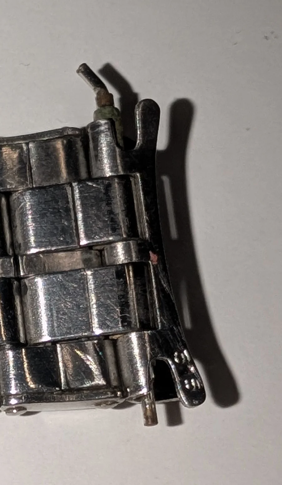

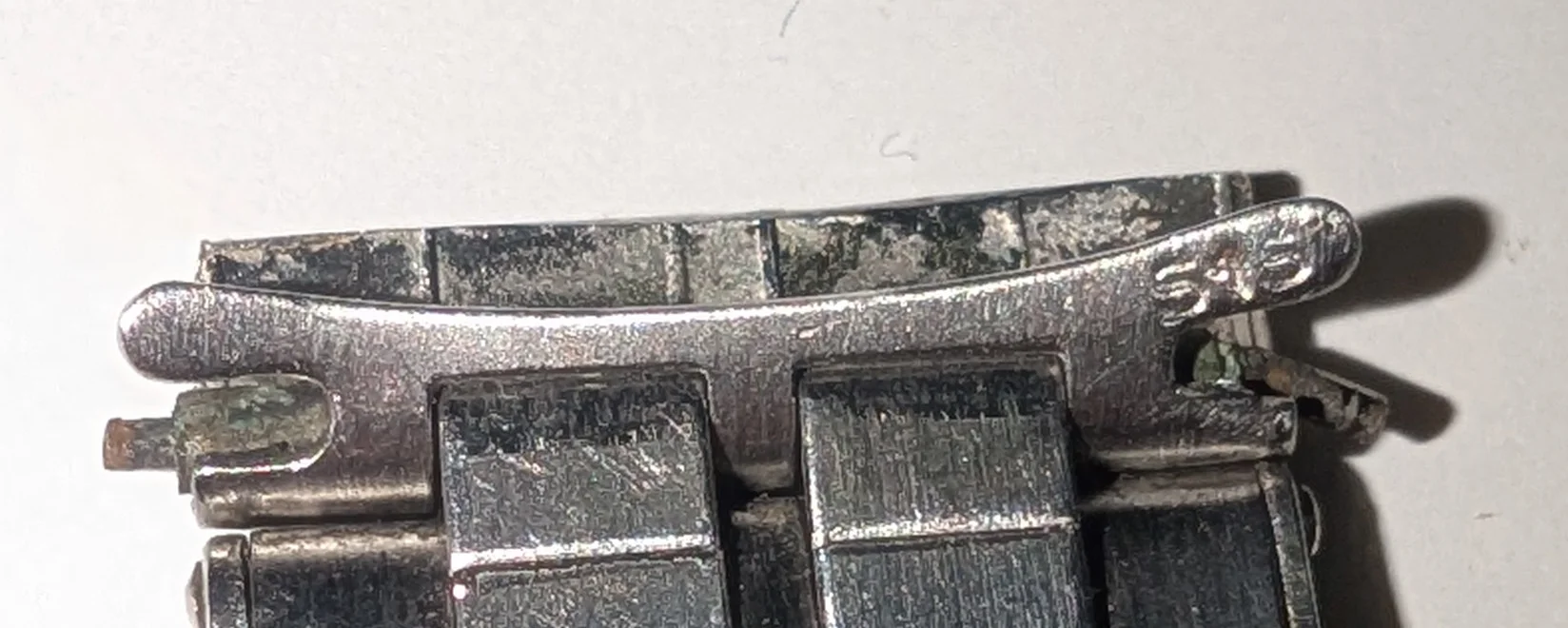

I only see 1093 bracelet for the 2 above references, both paired with 139 endlinks. OP can you take photo of back of endlinks to see a number? If its 139 then you can look for the the 2 watch references above and you will have a match.
Both references are Seamaster Cosmics- which are pretty nice watches
Kind of backwards to search for a watch based on the bracelet- but its an heirloom I suppose

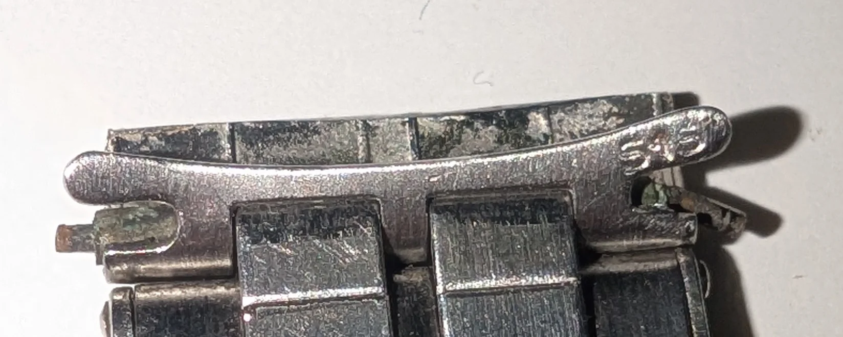

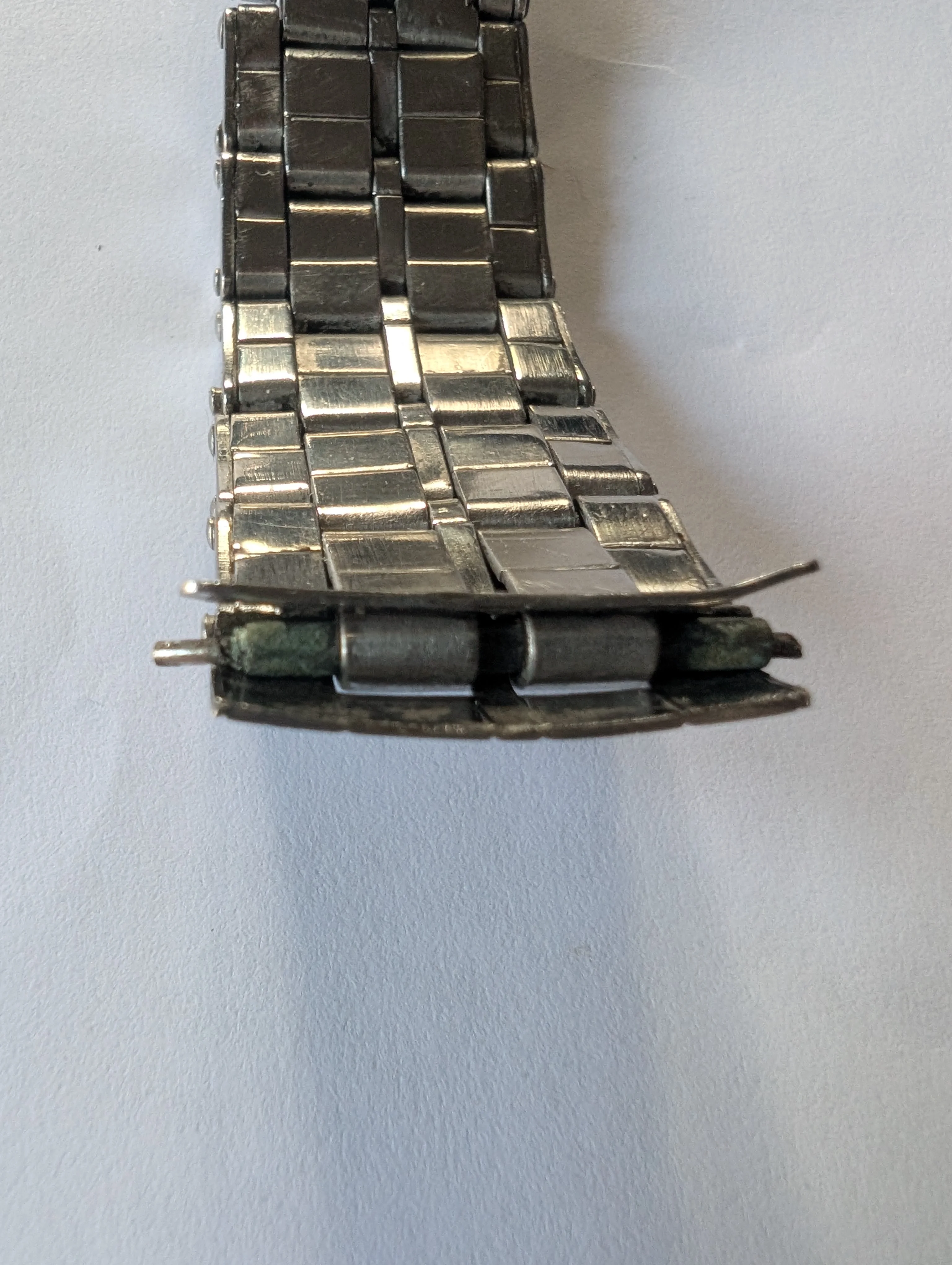

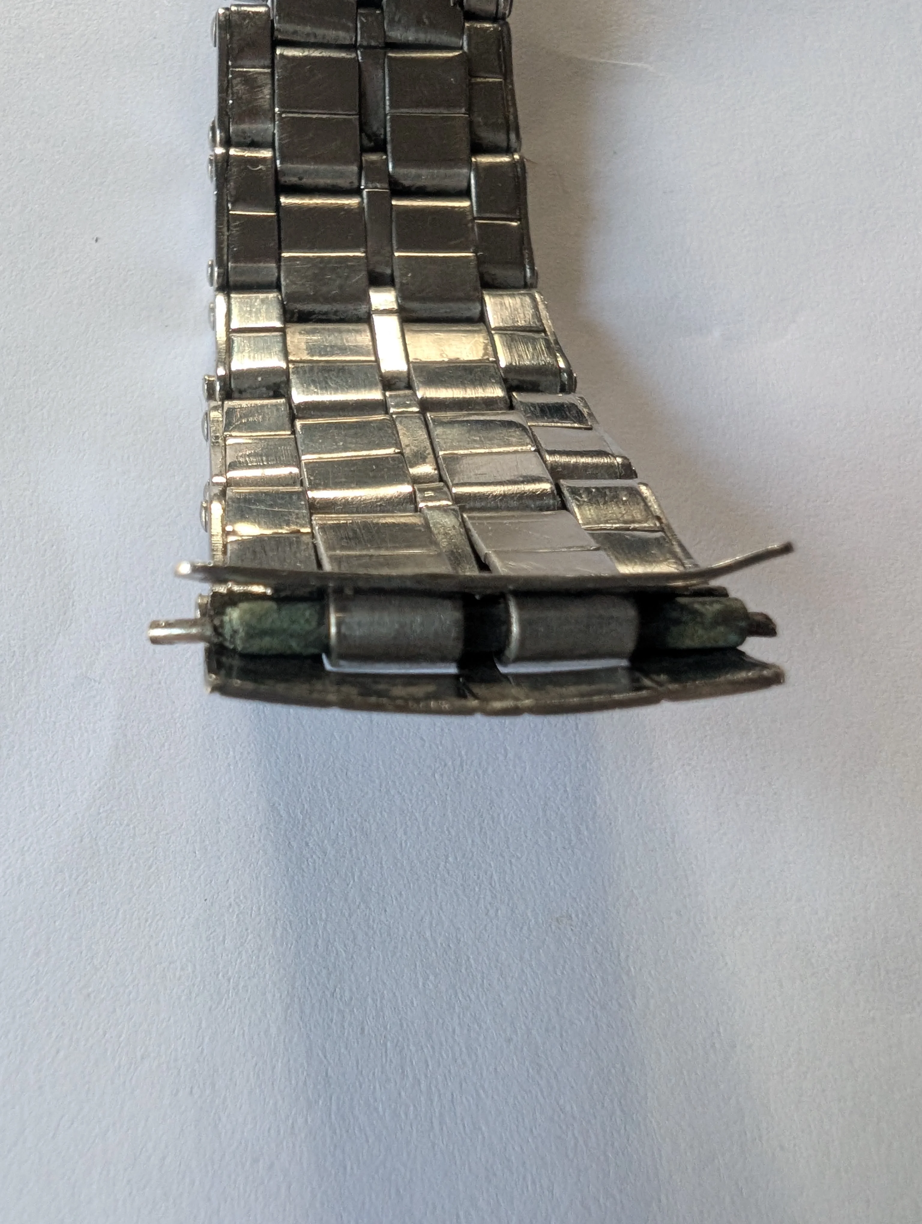

Thanks to all, later I will add the photos of the endlink
770
823
The 1093 was used on a few models. In this case 515 endlinks were used on c-case constellation models (168.017 et al.). I don’t think it is reflected in the official lists, and this bracelet isn’t super common.
24,525
54,494
Those are definitely c-case endlinks.

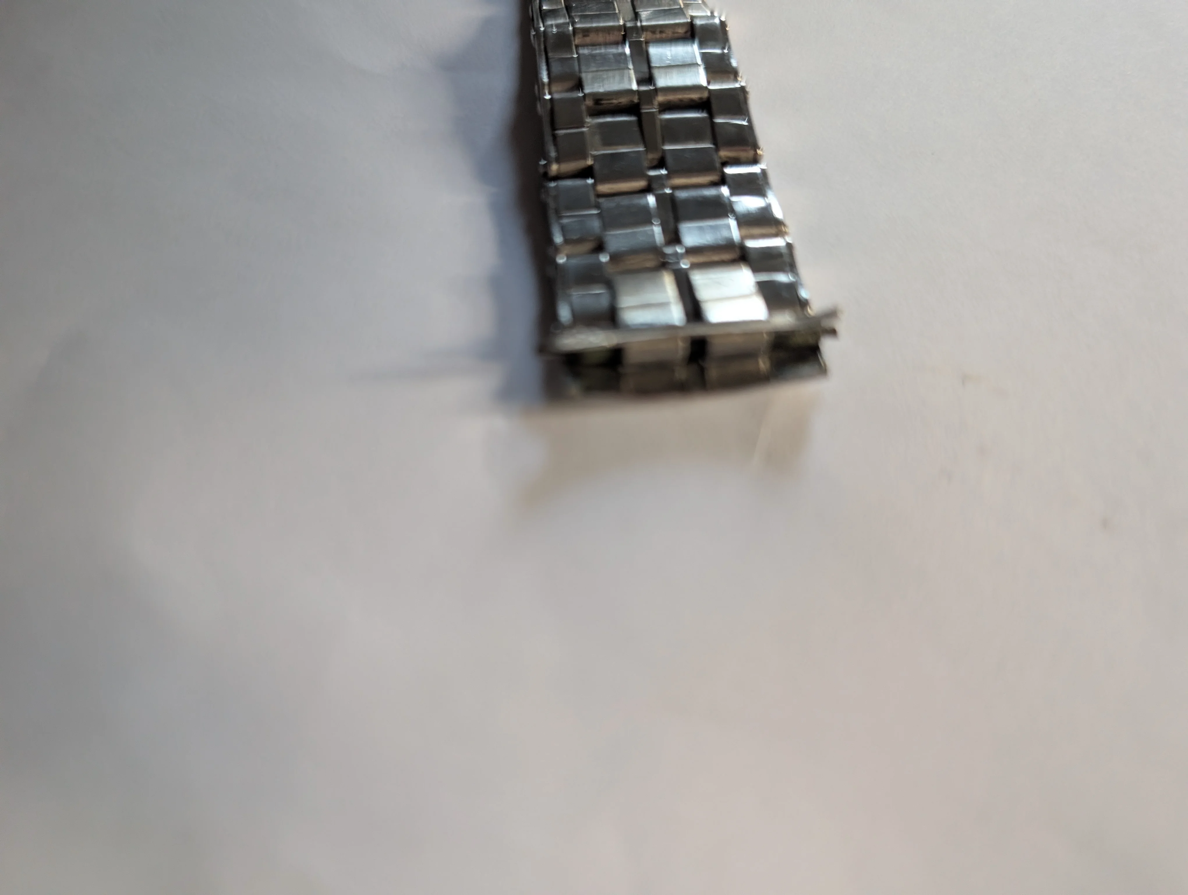

Would you mind posting a photo of the actual bracelet from the top side. Not underneath. It's hard to answer your questions if we don't know what the bracelet looks like.
