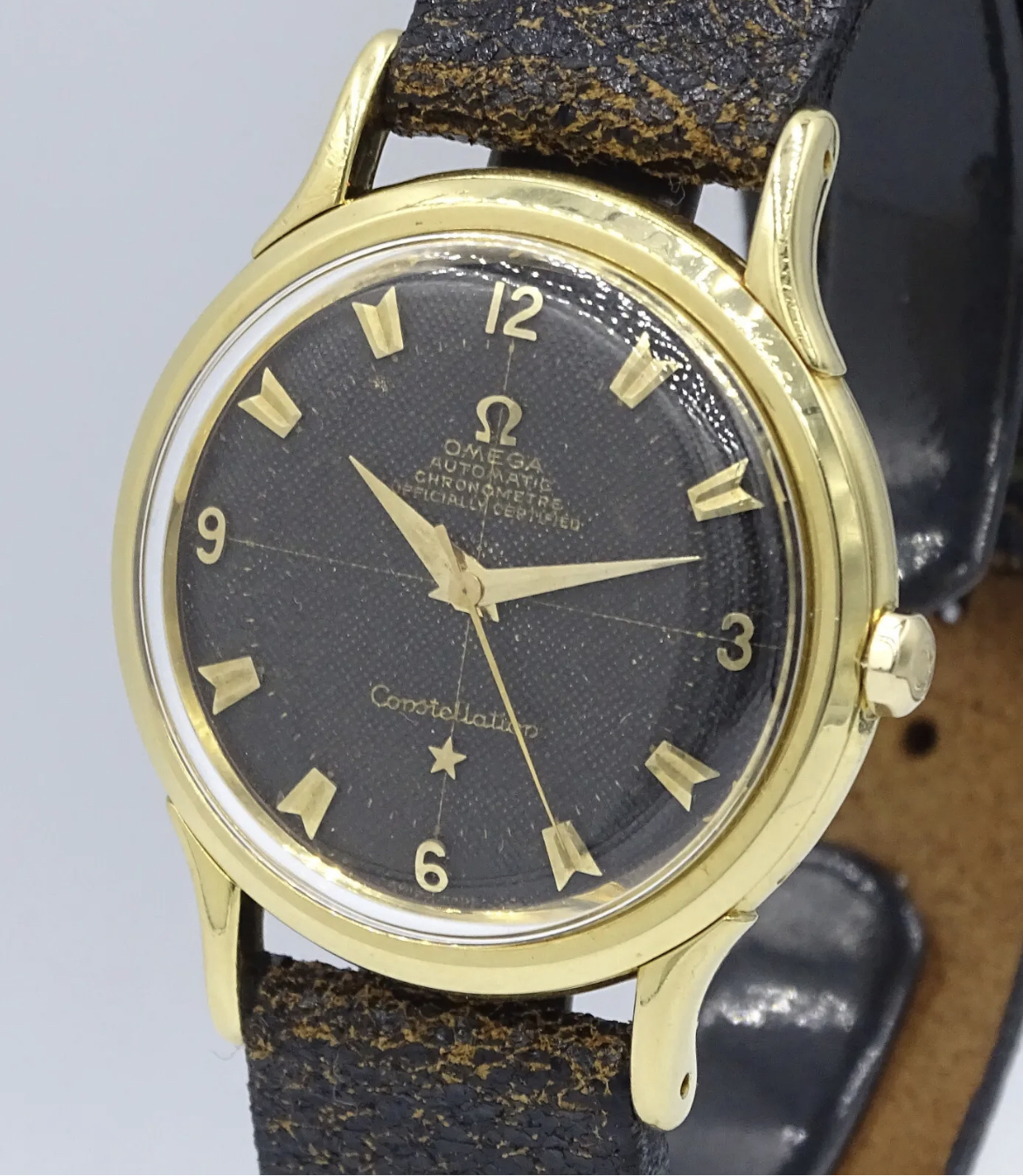

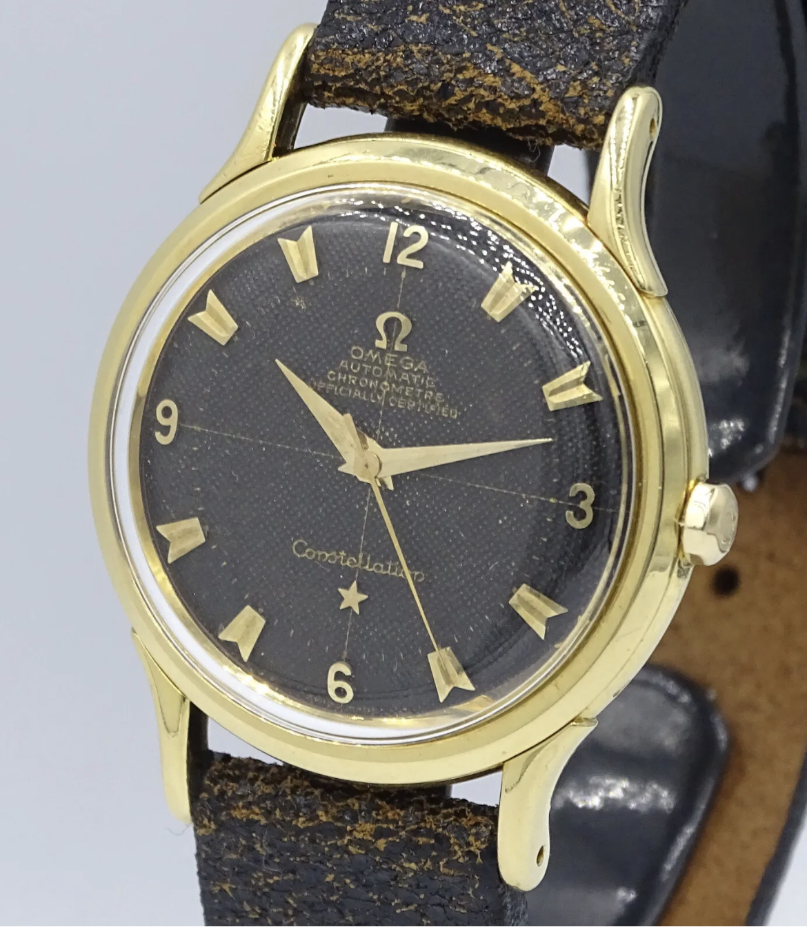

There's currently an 18k 2648 Constellation on eBay with a black honeycomb dial. A rare watch indeed - 2648s don't come up for sale that often, much less so in black, and with a structured black dial as the cherry on the cake, I assume it won't go unnoticed among the OF audience.
https://www.ebay.ch/itm/334746600299?ssPageName=STRK:MEBIDX:IT&fromMakeTrack=true
It's seen some polishing, the dial shows degrading, possibly from cleaning attempts, but that's not why I'm creating this thread.

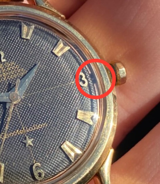

I first noticed the watch on IG from a Polish dealer and inquired regarding further pictures. On some of them, I noticed this:

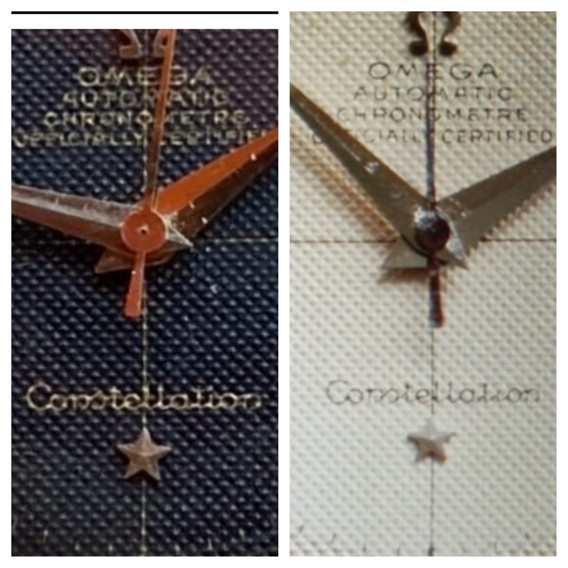

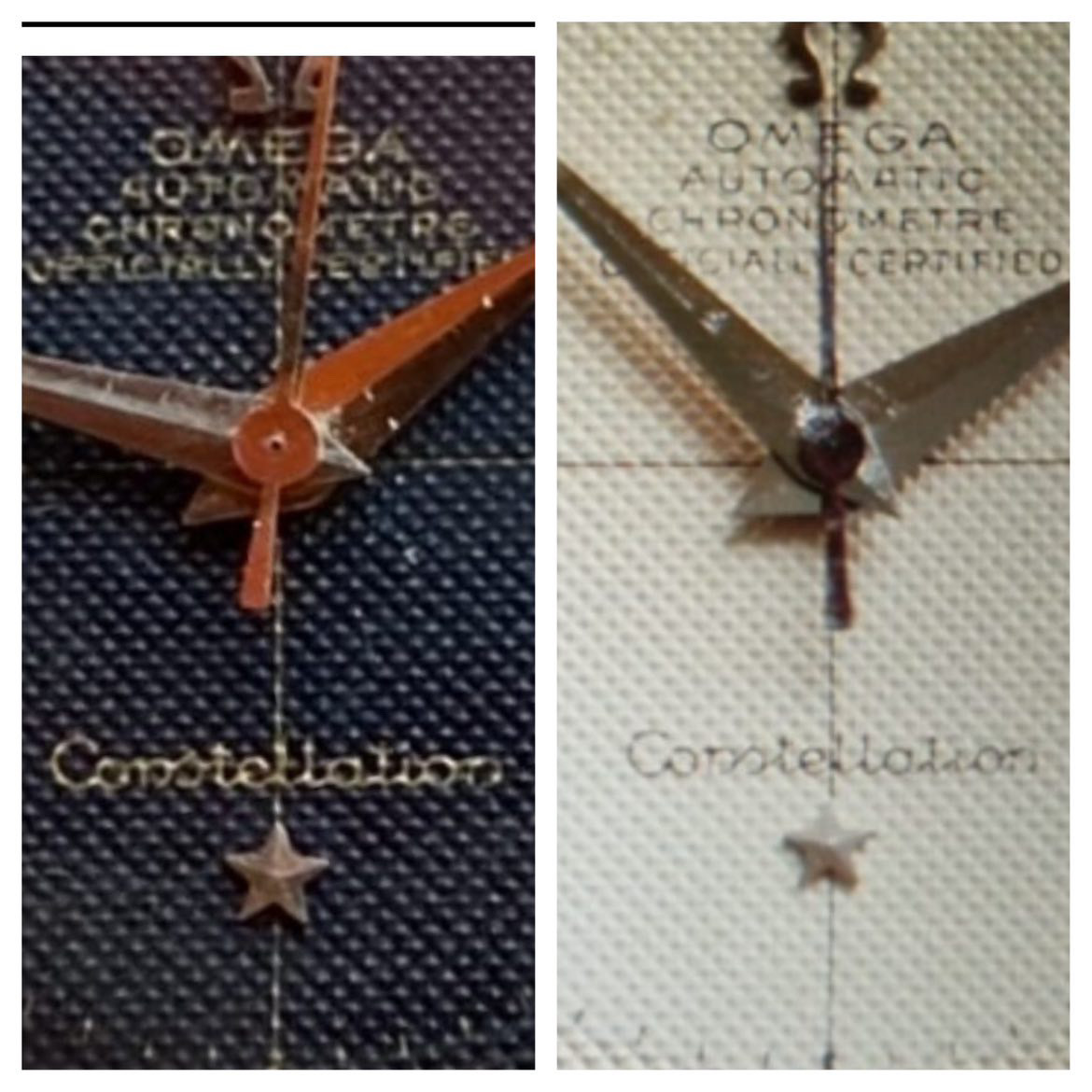

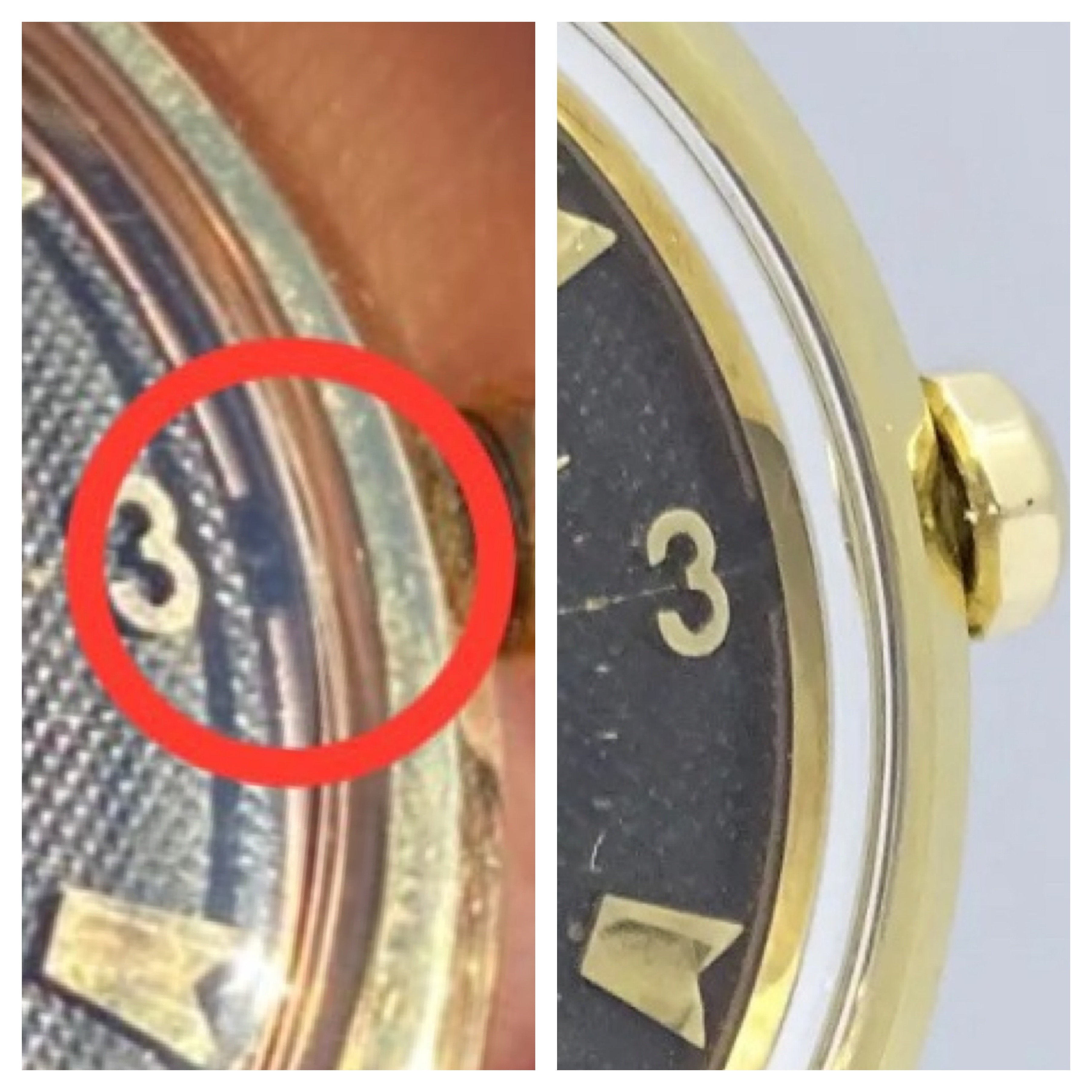

There is a significant gap at the 3 o clock position. Looking closer, the Constellation font isnt what I'd expect on a 2648, and the distance between the star and the 6 o clock tick is also incorrect. Correct 2648 on the right, the incorrect dial on the left:

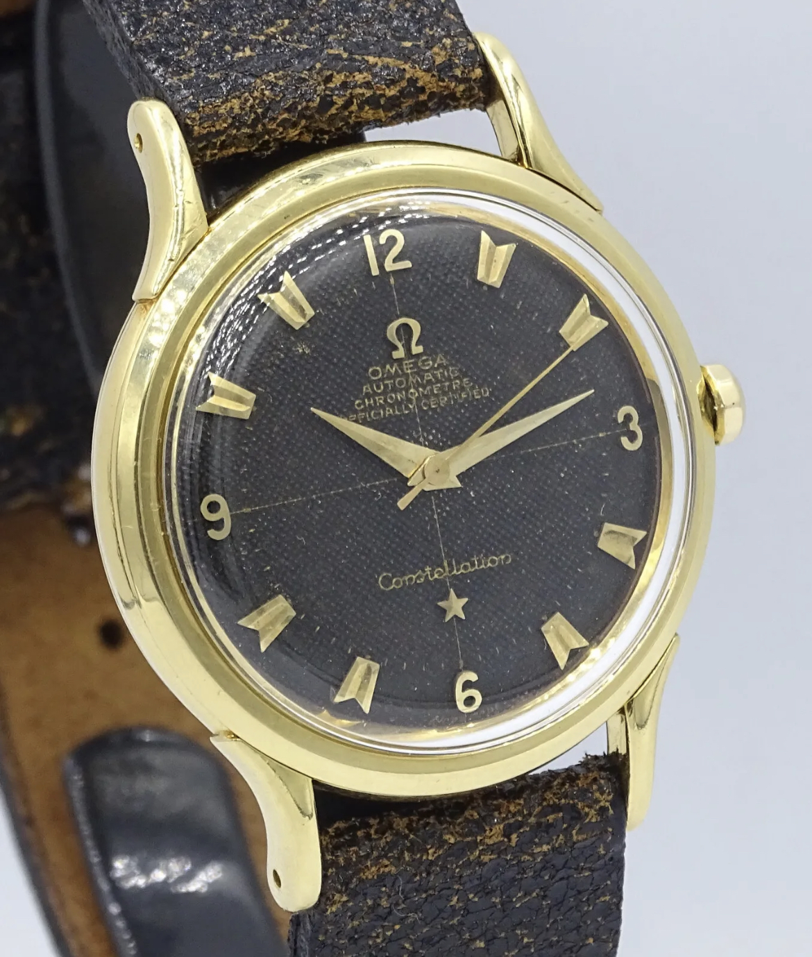

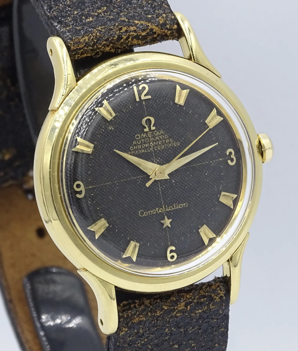

Turns out: This is likely a 2652 / 2782 dial in a 2648 case. The latter have 2mm larger dials (and slimmer bezels). Put in the smaller dials of the slightly later references and you'll end up with a gap between the dial and the case, which the eBay seller cunningly tried to cover with a different plexi that features a wider tension ring. It's still visible though, if you look closely:
I had asked the dealer about the dial size, not hiding my concerns regarding a dial switch. He said he'd have his watchmaker measure it, but never got back to me. Now that it popped up on eBay, he says he passed it on to a friend who apparently tries to flip it, but unfortunately, this friend also fails to mention the major flaw.
Price is already at ~3k USD, already too much for what it is: a polished Frankenwatch. Someone will get burned on this; please don't be that person.

I knew I'd seen this one before somewhere....now I know where! 馃憤馃憤馃憤

Yup. I had to compare the serial too, the horrible over-exposed images on eBay vs the nice sunlight shots from the IG seller didn鈥檛 make it easy.
Thanks again to you for a) the tip regarding the positioning of the star and b) the picture provided for comparison. Credit where credit is due. 馃榾

No worries there, it was an interesting dissection!

What they said. Plus the omega logo is also different between the dials.
