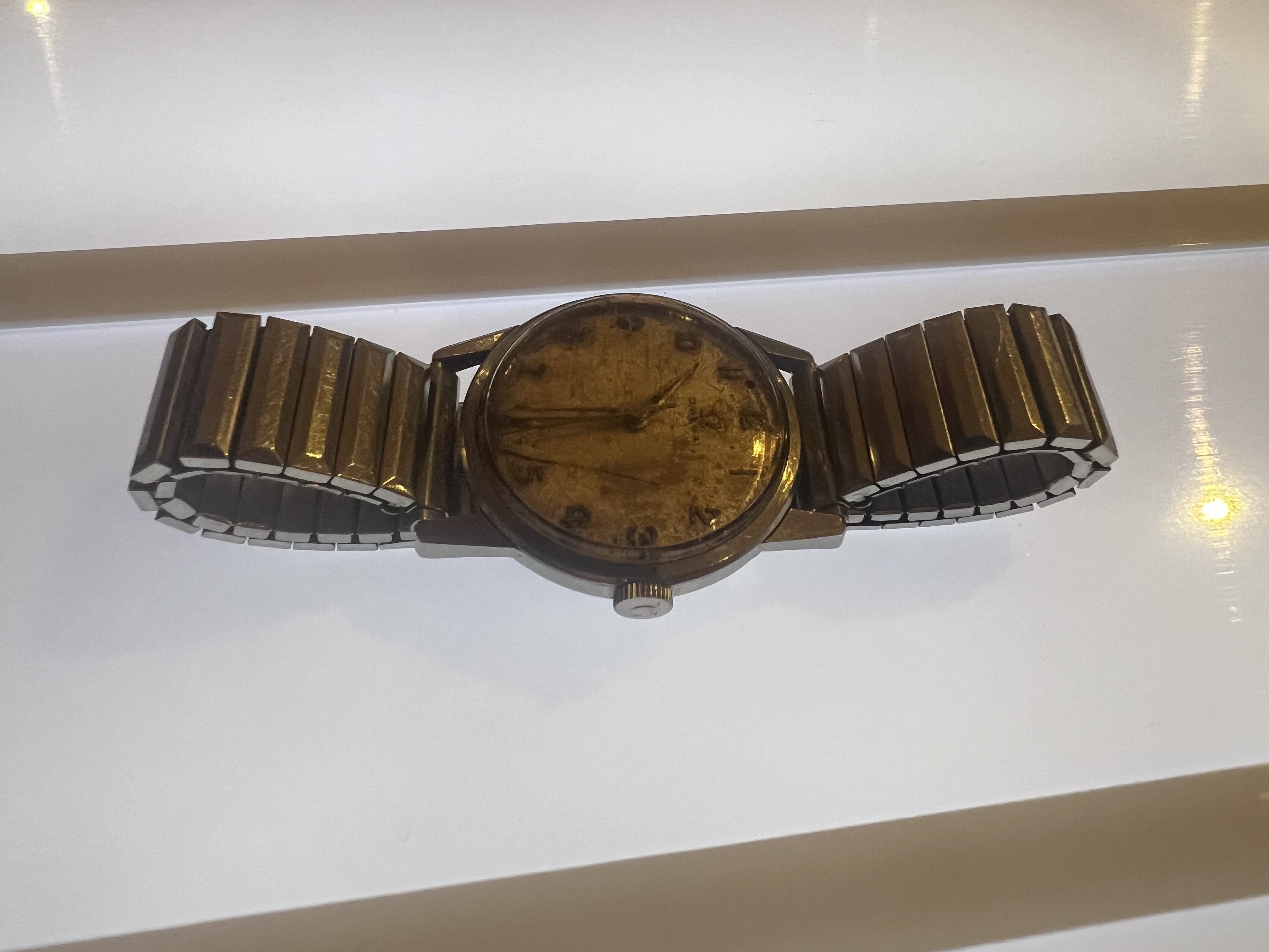

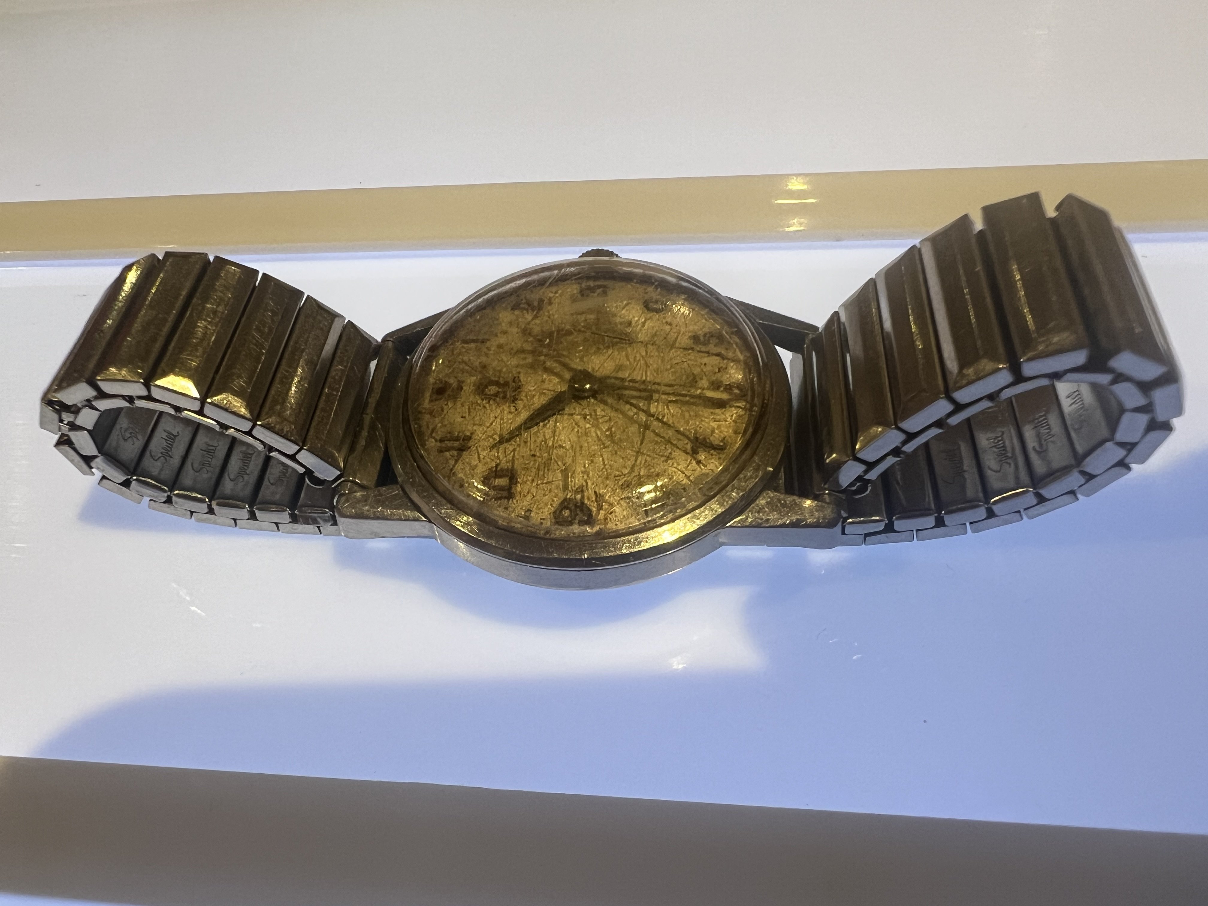

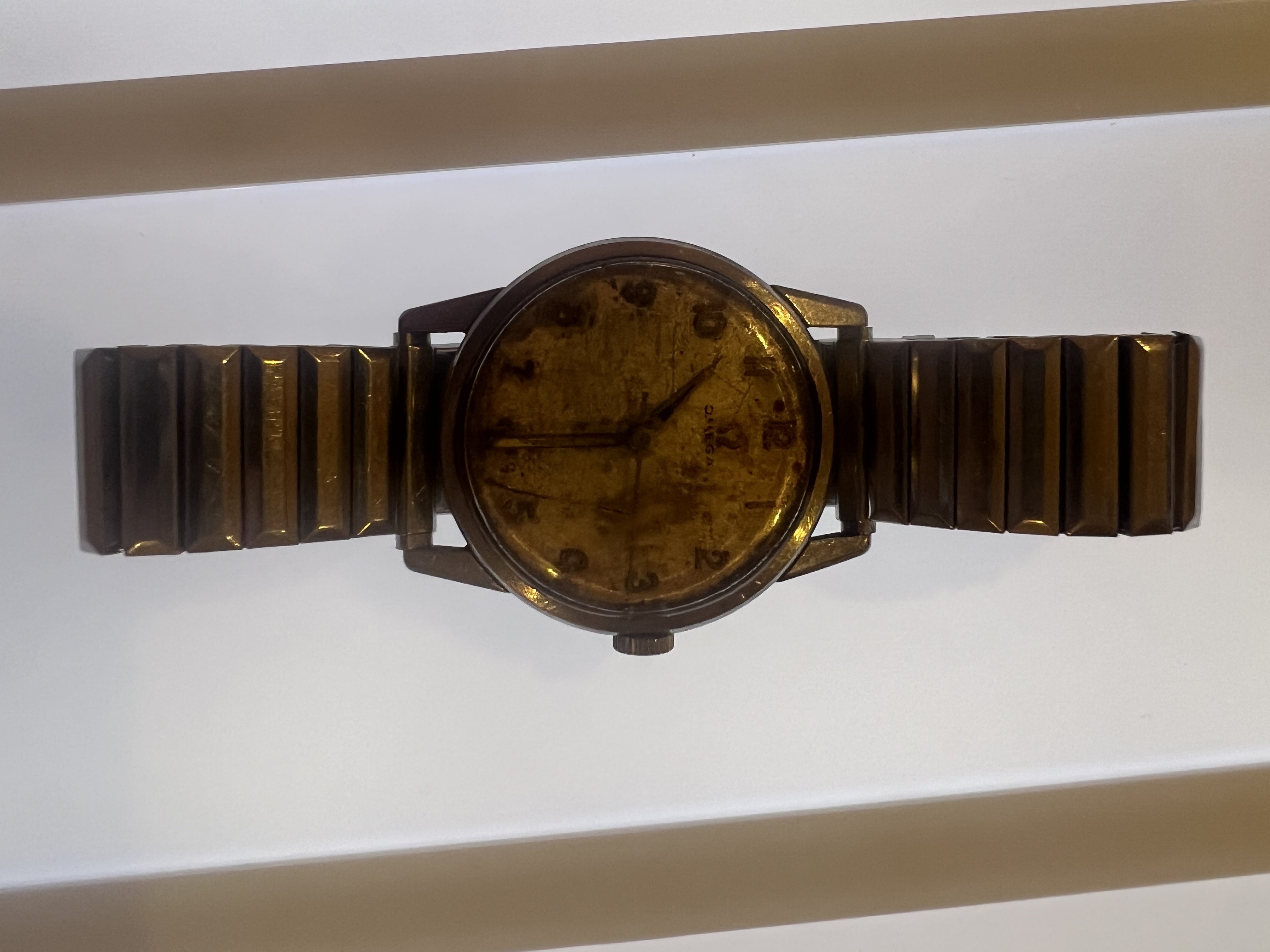

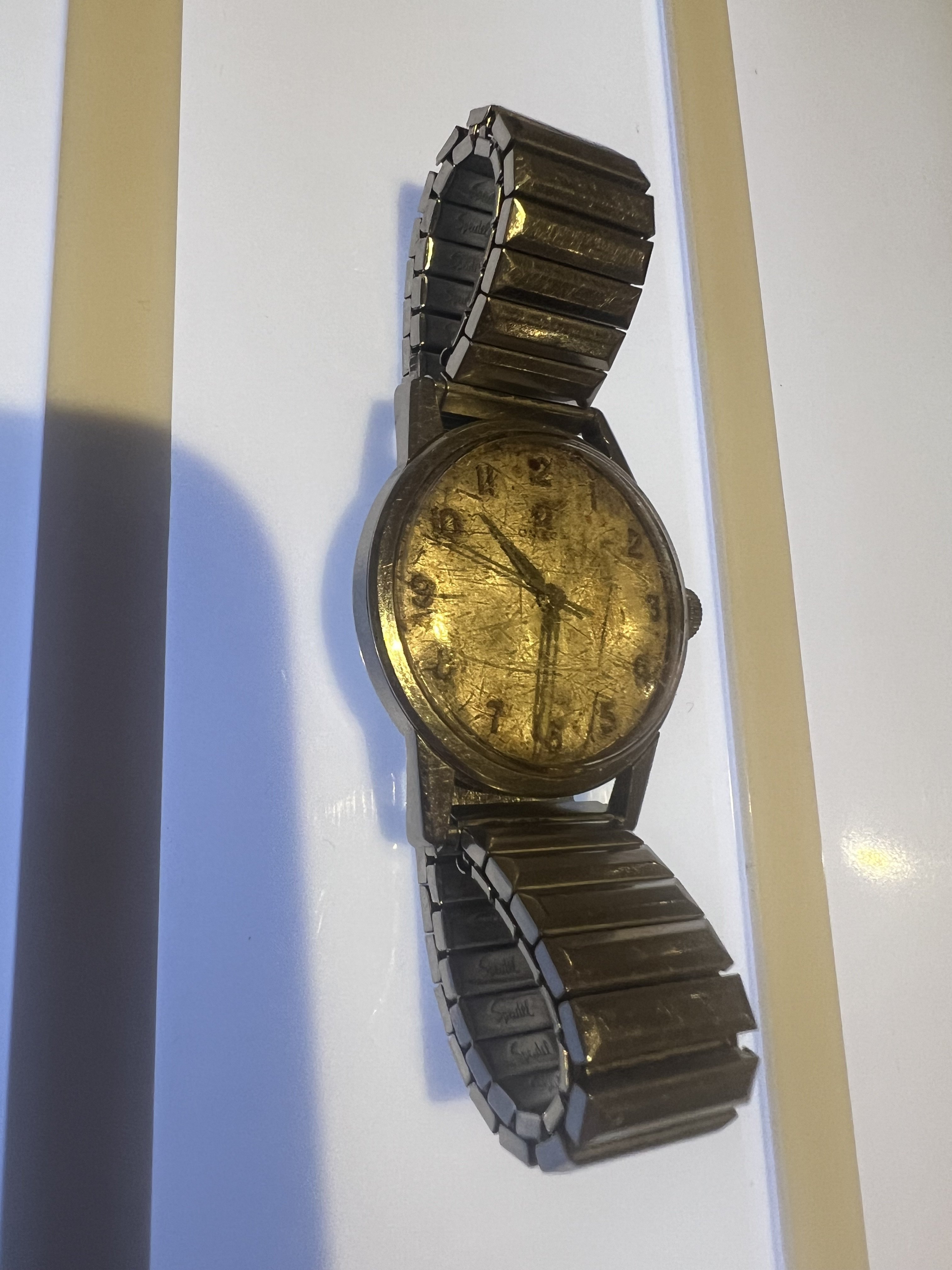

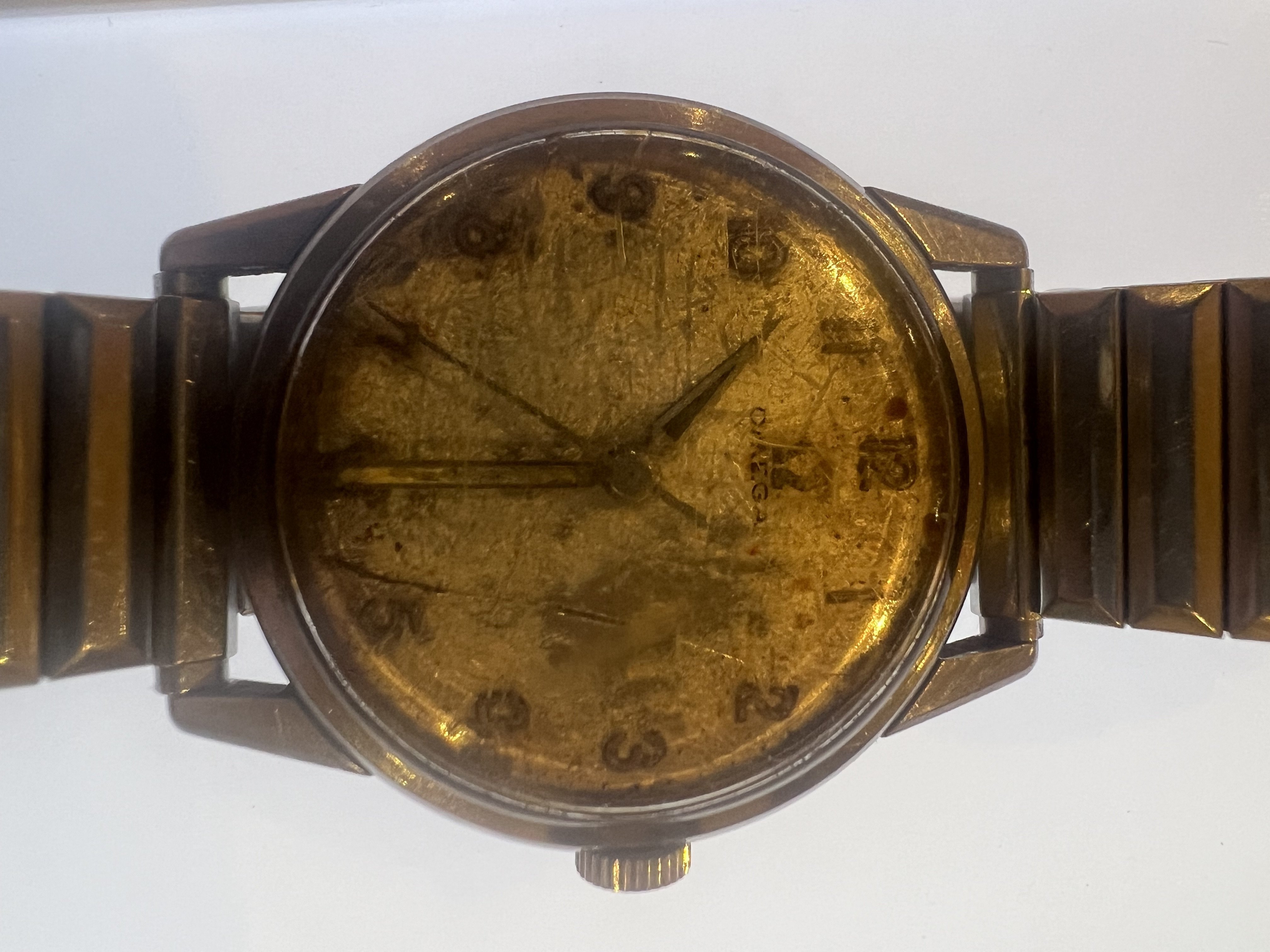

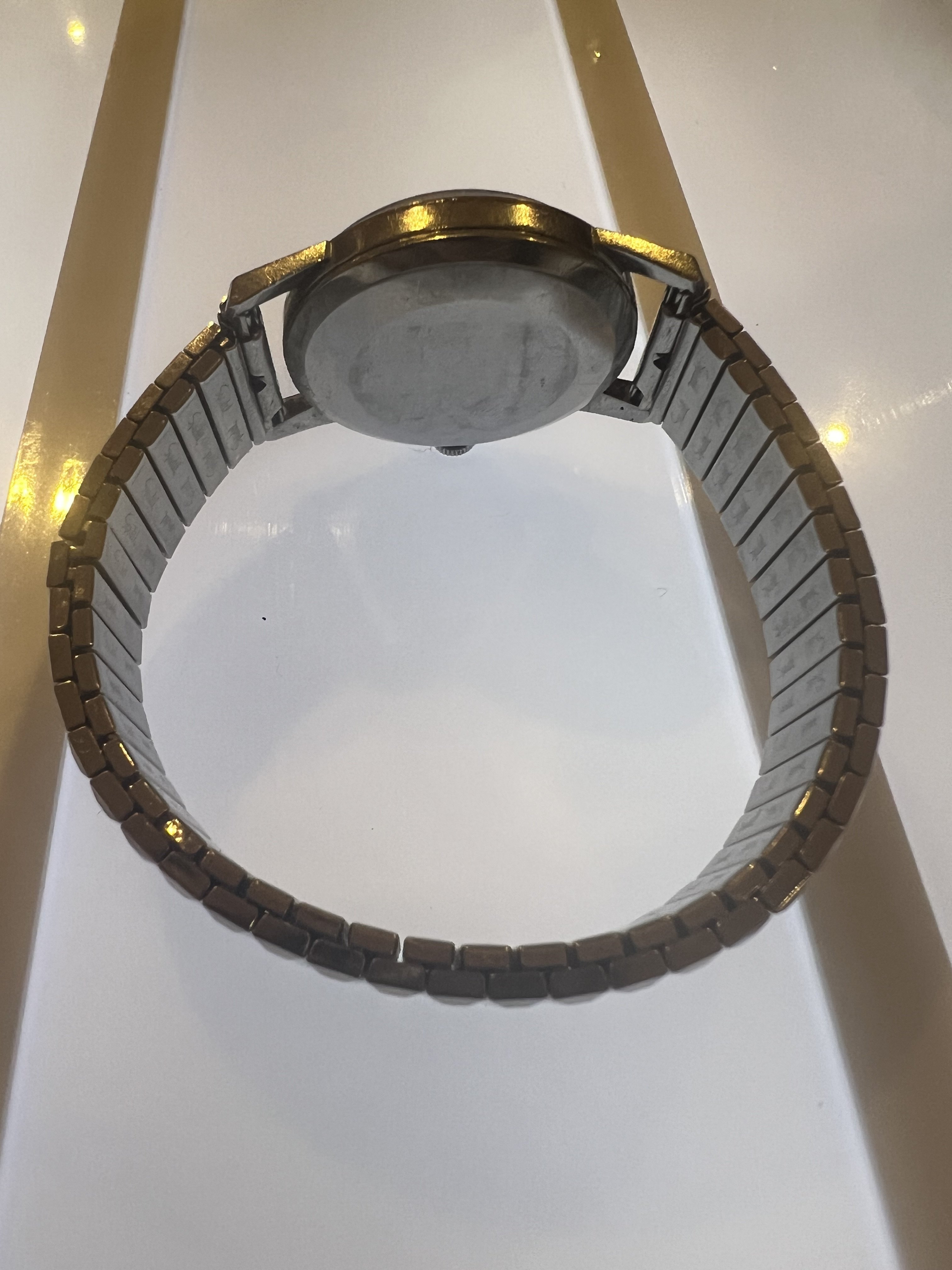

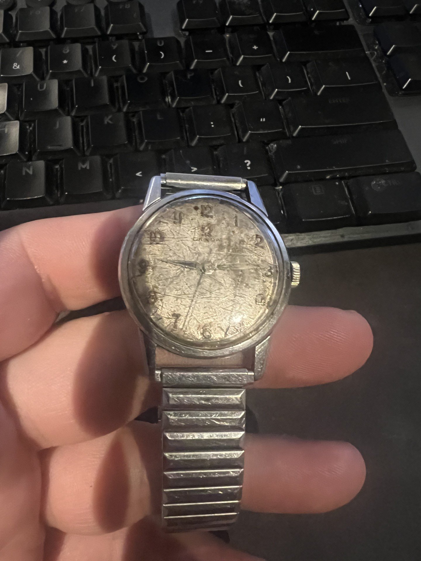

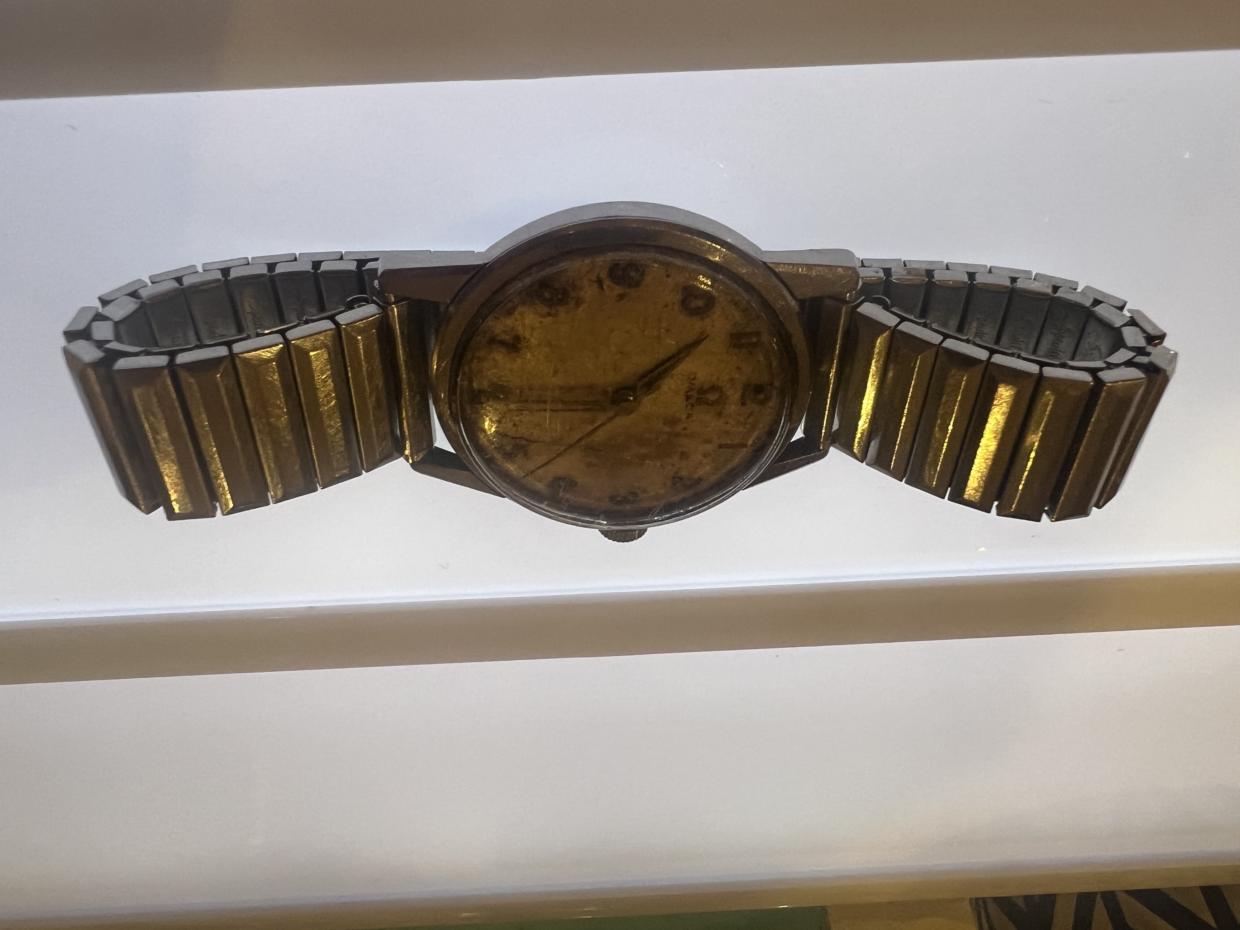

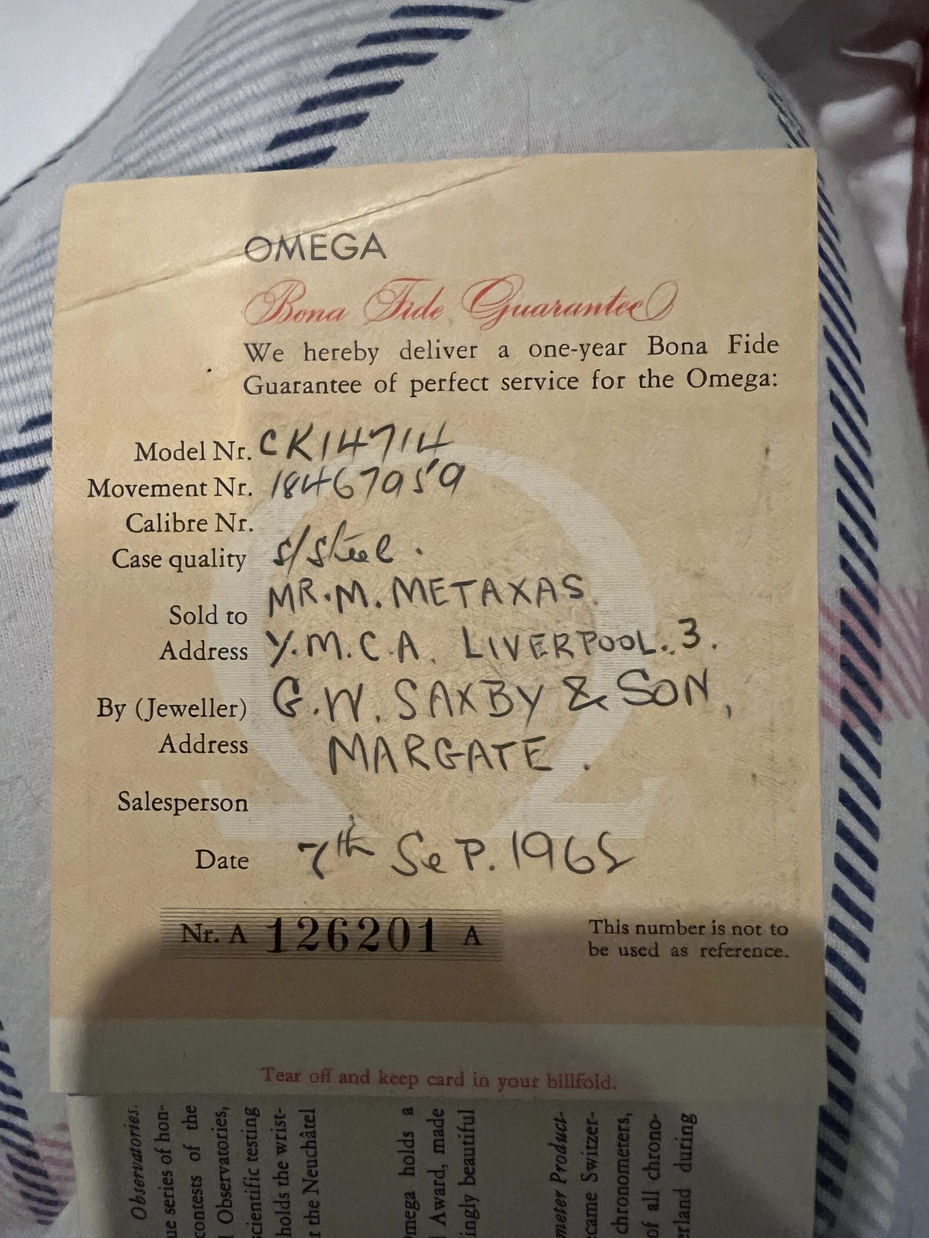

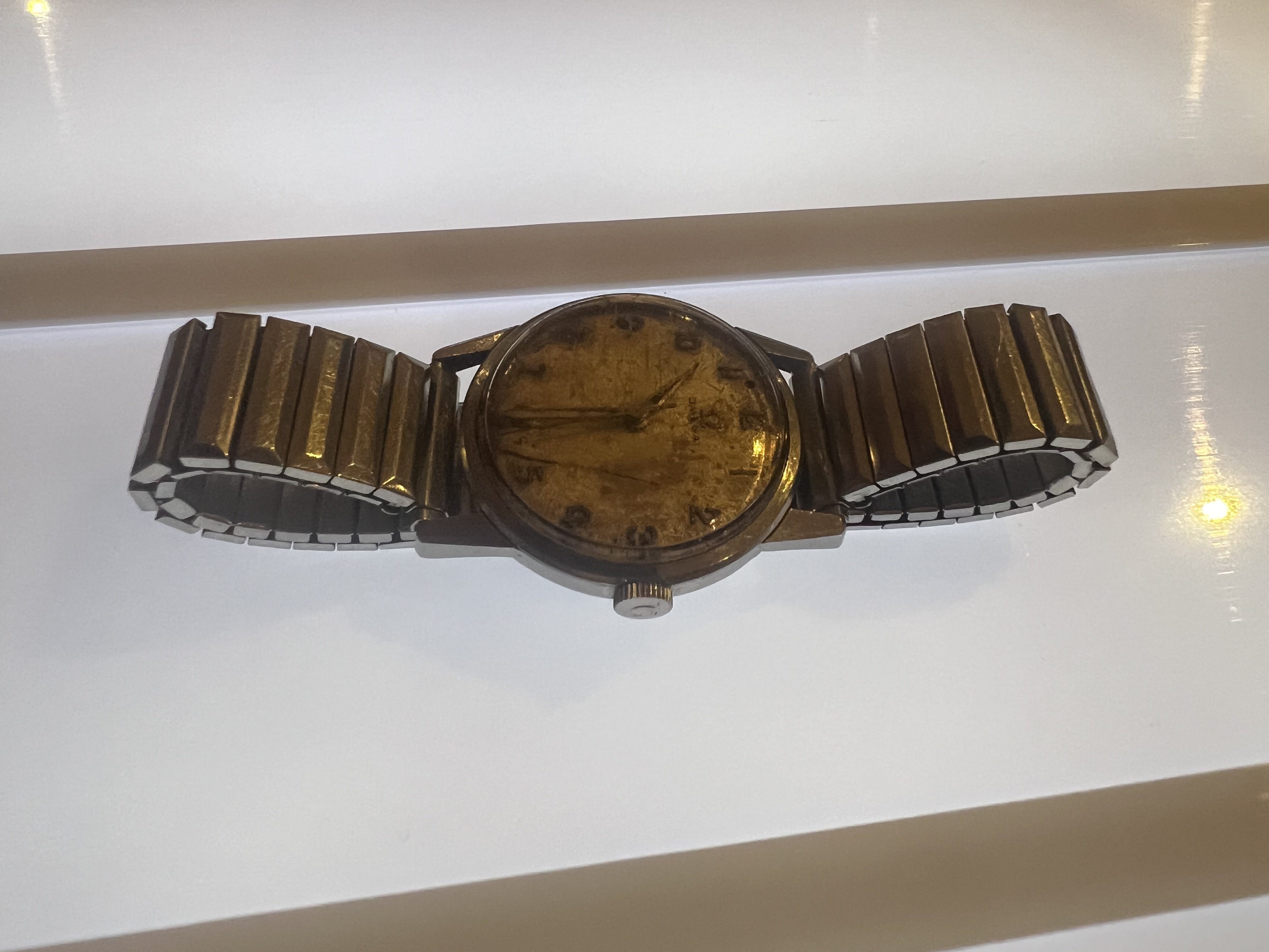

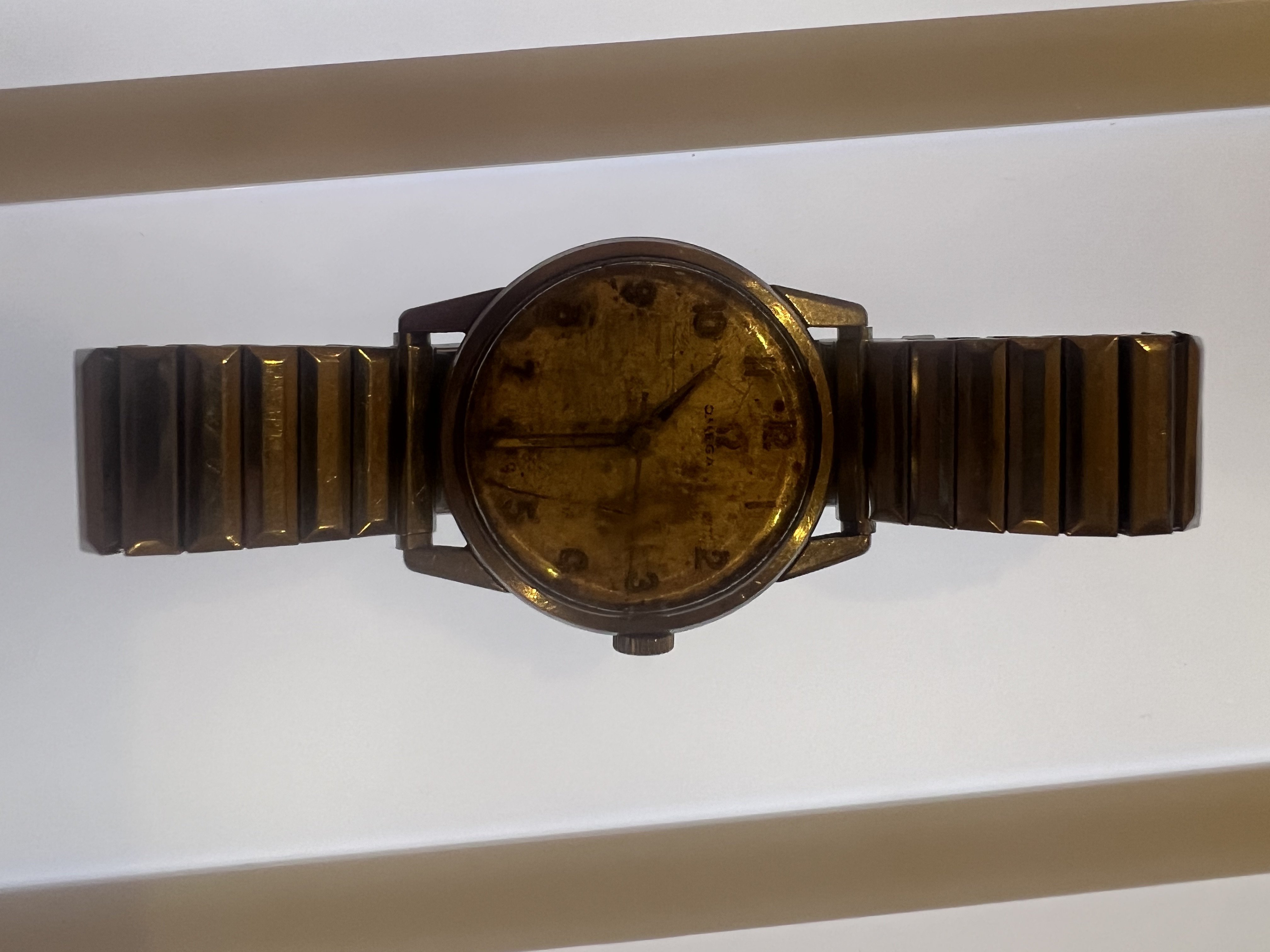

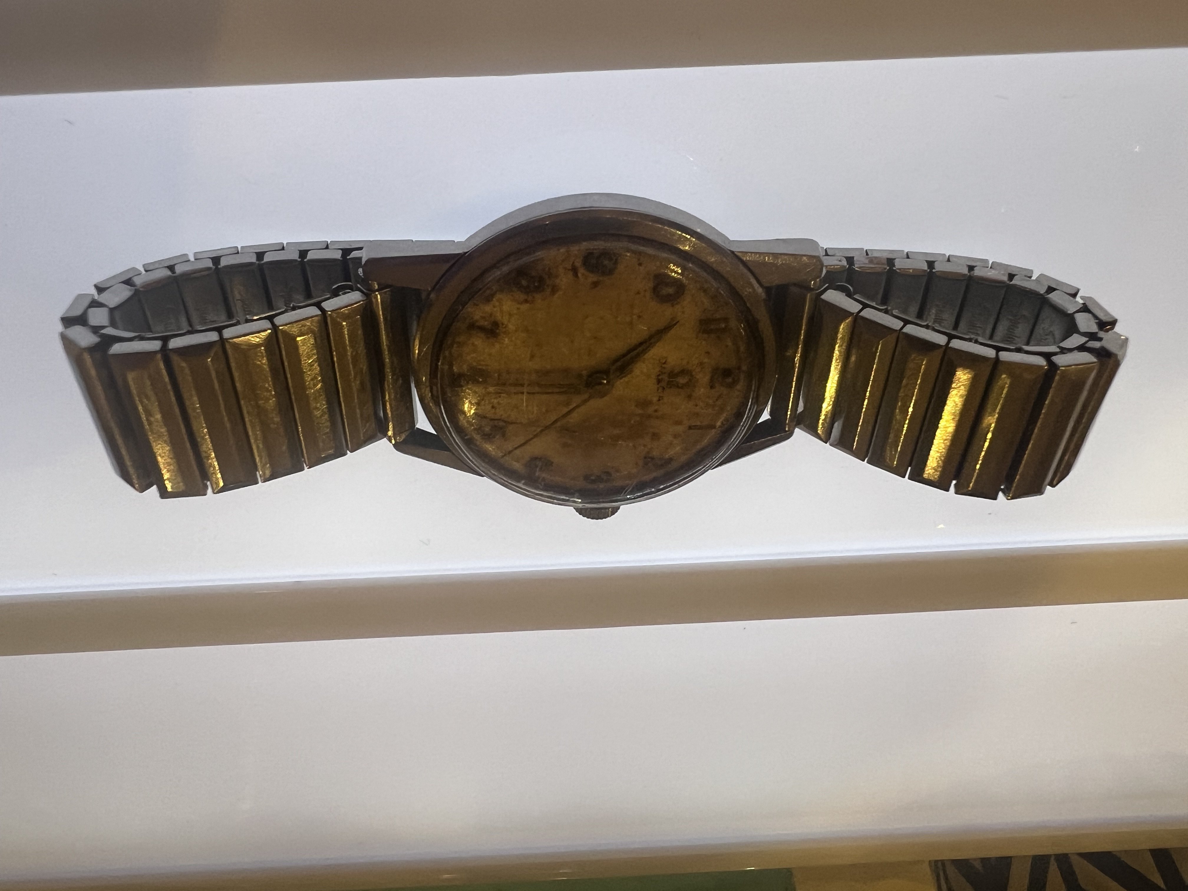

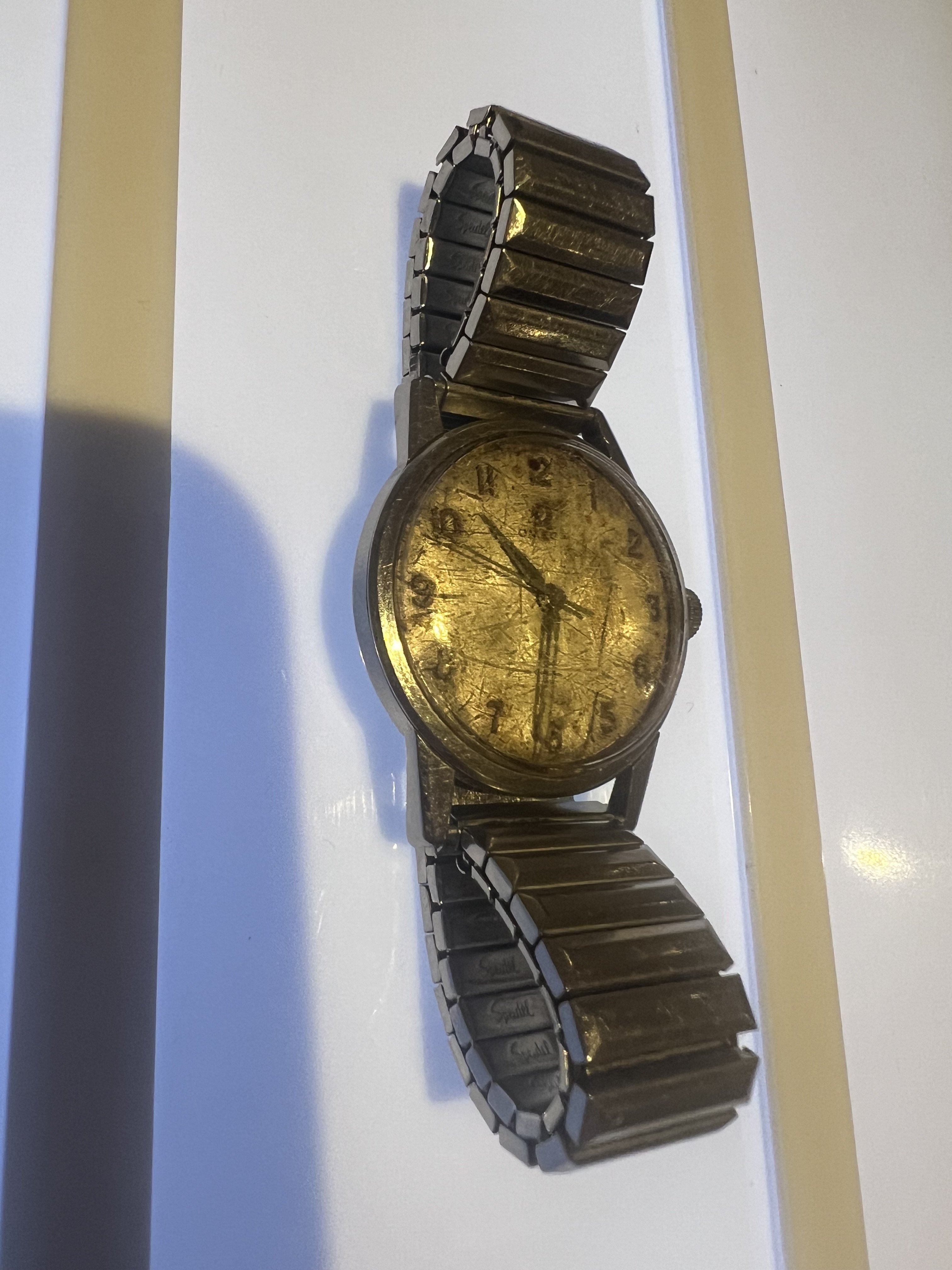

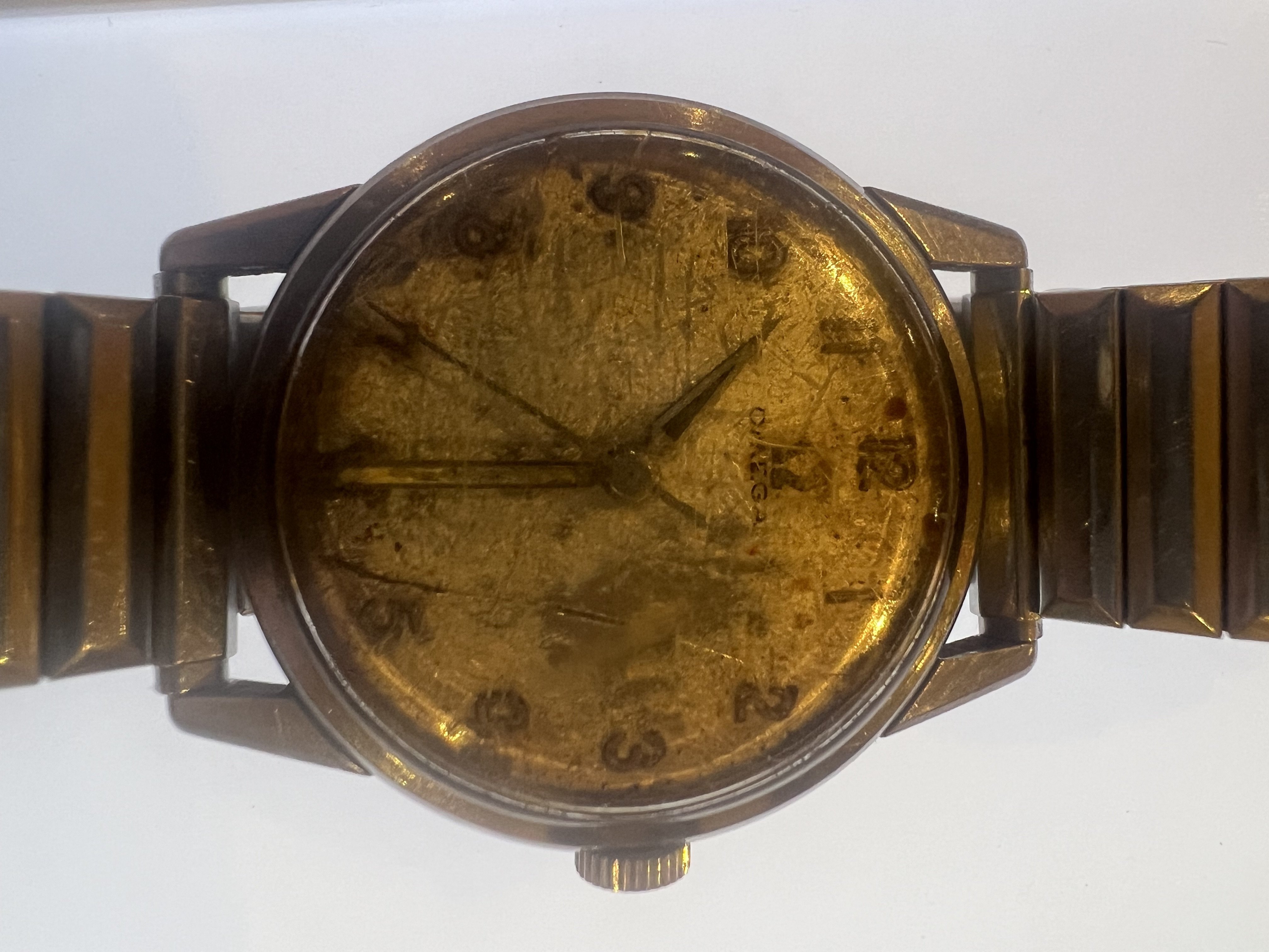

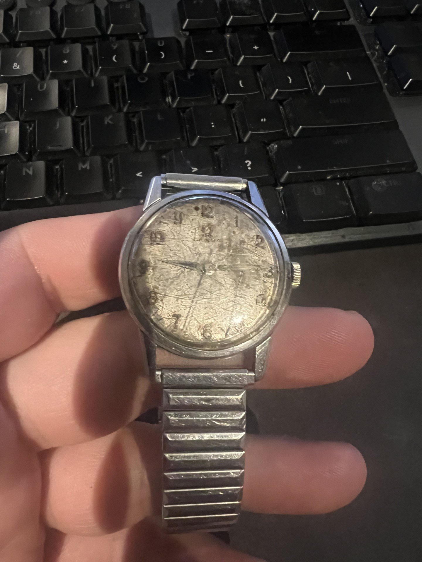

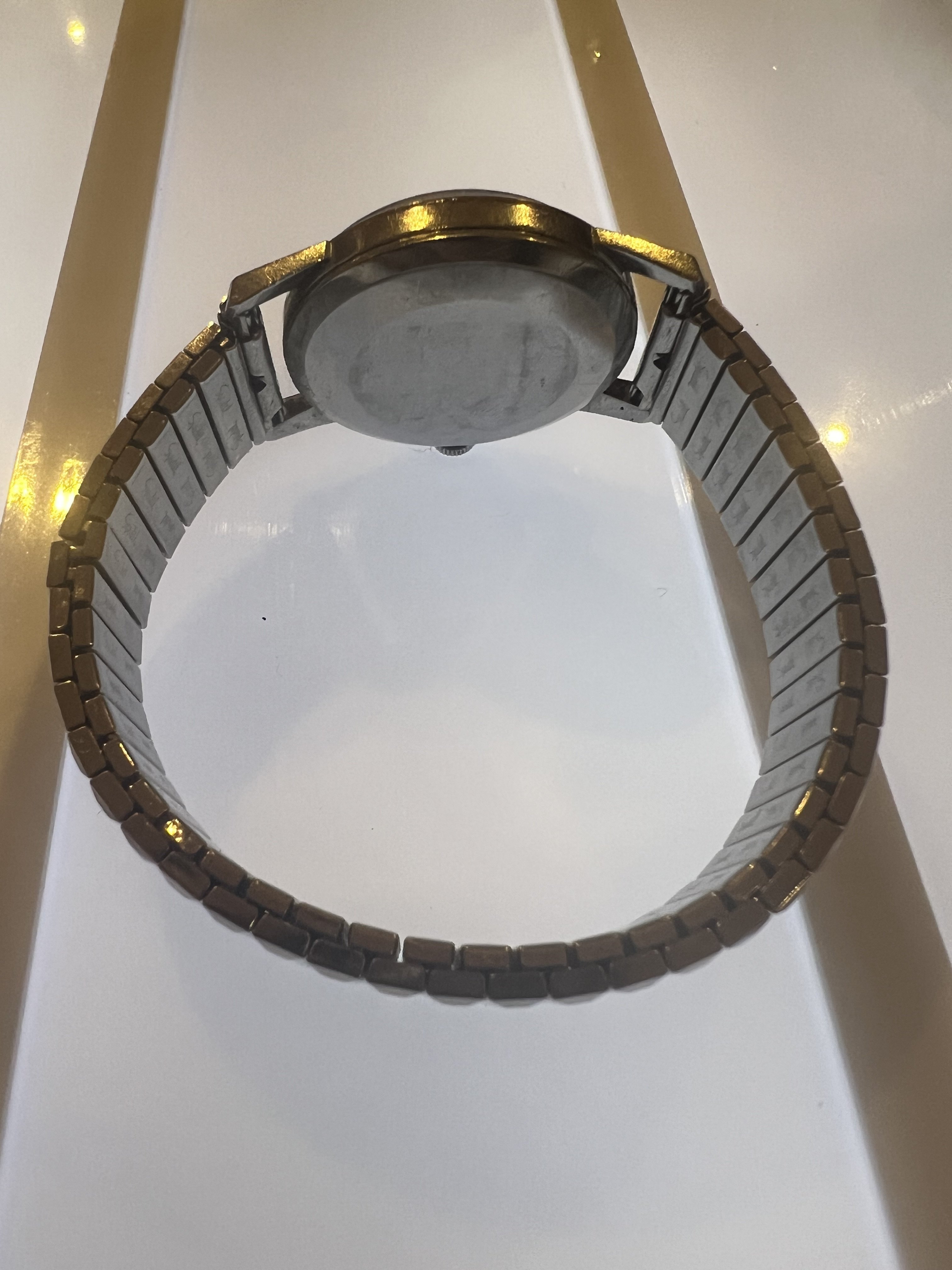

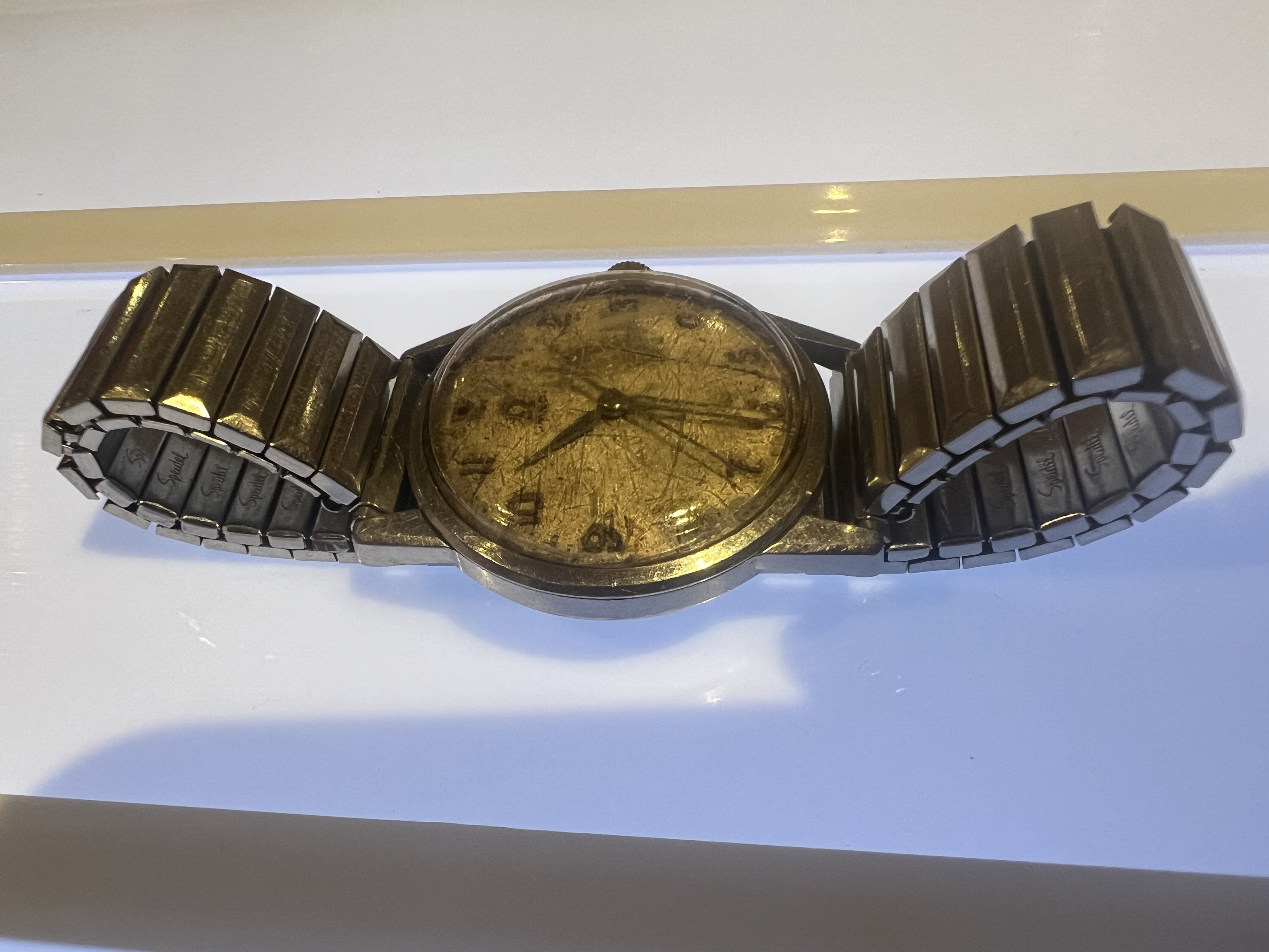

Hi all,
I was given the below watch by late grandfather and I am trying to identify what I can about it, as I will be looking to get it restored.
Watch I believe is original strap with extra links, papers and box. However being a noob with watches I am looking to read up about this watch.
Model Number: CK14714
Movement Number: 18467959
Stainless Steel
Purchase in the UK in 1965.
Any information that can be provided will be greatly appreciated. I am located in Melboune Australia 😀

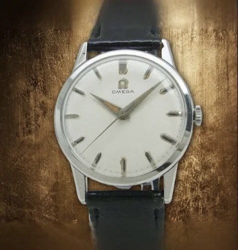

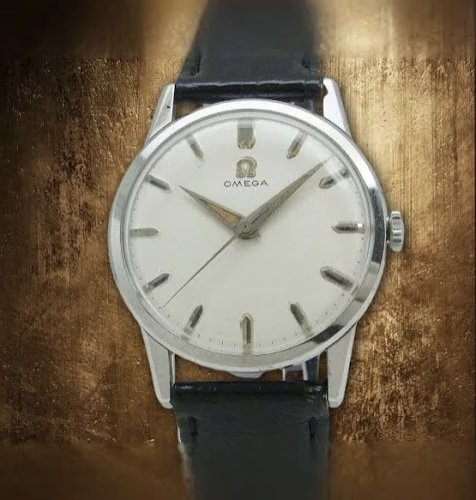

It's hard to say much about the condition without better photos (this forum really likes pictures - the movement and even your box and paperwork are of interest), but the attached is another example on that model from the web.
Generally its advised to NOT send it to Omega, but instead to a watchmaker who will perform a "sympathetic restoration" as opposed to replacing all parts that have some wear and polishing the case.
384
375
I can tell you it needs a new plexi 😁, the flex bracelet is not original and caliber is likely 285.
More pics will help - show us more angles, and the box and papers.
15,996
48,112
If you were able to have someone remove the back of the case to show us a/ any stampings inside the case back (ignore any “scribbles” left by watchmakers), and b/ the mechanism, we’d be able to help with more information. Your pictures should be well lit (daylight, no glare), enlarged, and well focussed, then return to the thread you’ve started, click on REPLY, and add the pictures. It is imperative that we be able to read serial numbers and model numbers on case and movement.

Hour and minute hands are mismatched and that gash running from 2' to 5' may be on the dial rather than the plexi

what do you mean by mismatched? not original?

I would also suggest to replace the "lug-eater" flexi bracelet with something else... damages to lugs have already been done but wouldn't hurt to remove it

Means that the two hands are not from the same set. It's like having, with cards suits, a spade and a club.

The H and M hands have totally different styles/shapes, one is lumed and one is not. Perhaps one of them is original.

Dial may be ok under that totaled plexi. Its heirloom have it cleaned and serviced with new crystal and nice leather strap. Please share the result! Dont go to Omega find independent watchmaker with Omega parts account. Share your location and someone can advise.

Hi all and thank you for your advice,
I have gone to an independent watchmaker and finally received a quote.
The dial was in bad condition and had the deep scratch on it and was also water damaged.
The watch maker has said that he may be able to remove the numbers and remove the deep scratch.
The quote i have recieved is: (AUD)
$ 880 Full service overhaul of the movement
$ 88.00 Relumiate hand
$ 380 Supply and fit new original plexi glass or generic glass $110
Dial:
$1700 - Full complete dial restoration (sent to the USA)
or
$750 - Local Dial Restoration - If they can remove the number / scratch
Just looking for some advice as to whether it is worth the cost of the repair. As initially i thought the watch to be only worth $1800
Any guidance is appreciated.

In your place, I would have the movement repaired/serviced and the crystal replaced. I would leave the dial as it is. It's unfortunate that the dial is damaged, but that is how you received the watch and how your grandfather wore it. As far as I know, there is nobody in the US who can really do a decent dial restoration for an old Omega, so paying $1700 (or even $170) would be a waste of money.

Fully concurring with other members, the key question is how much you want to spend in order to wear your grand father’s watch for some years.
That’ll be the only return you get, as the dial damage means it has no value as a collectible. (Condition is a critical element of value; Compare with the other watch posted in the thread).
It does suggest your grand father used it a lot though.
Another option we haven’t mentioned is to hunt for a non restored replacement dial from what we call a «donor » watch, but you’d have to find a decent example of the same reference, which in turn would cost a few hundred $$ (Australian or US).
The result would be a more desirable watch, but the replacement of the dial still makes it technically less valuable on the collectors’ market and you will still be spending more cash that the watch is worth from a purely monetary view point.
