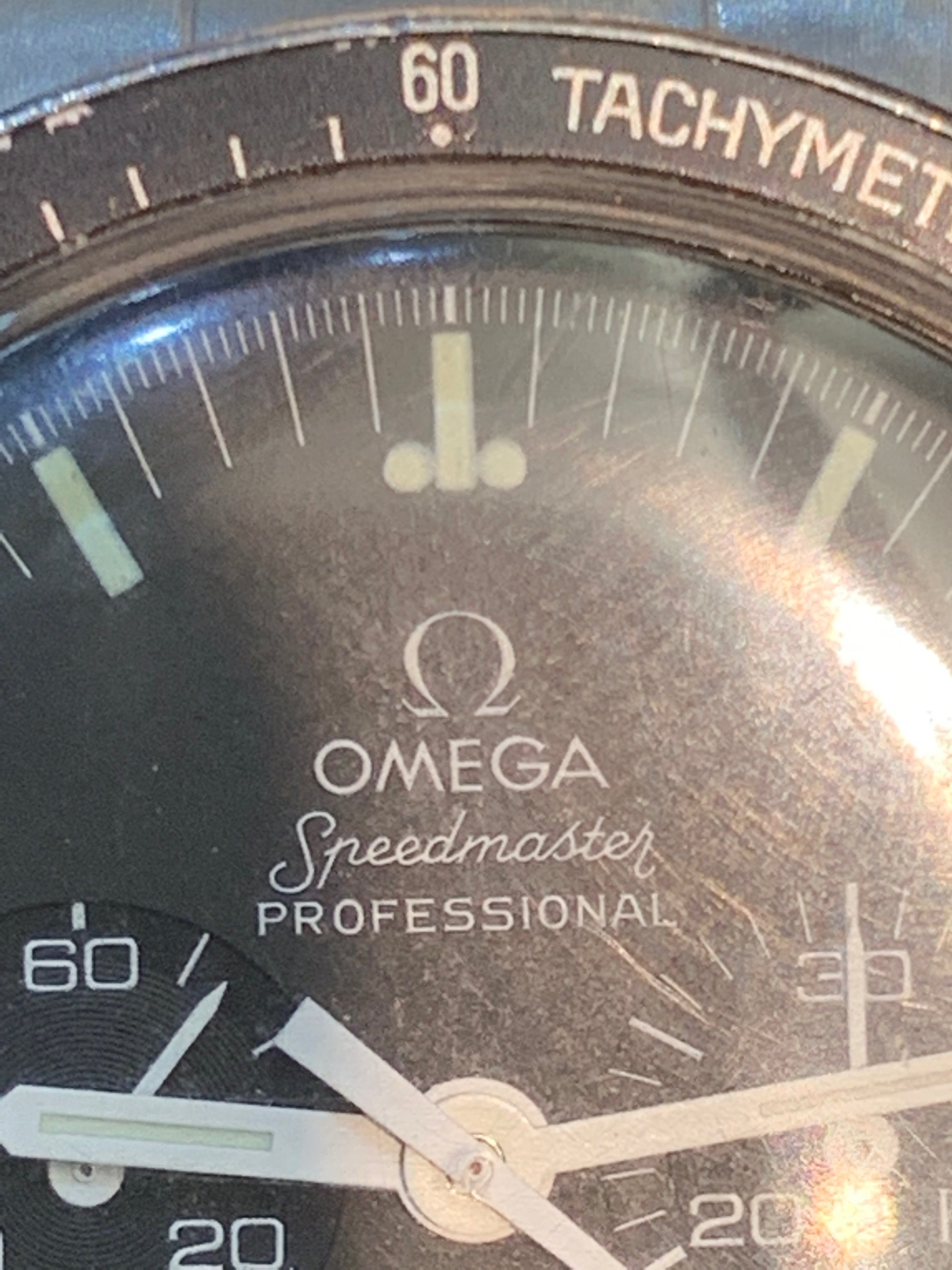

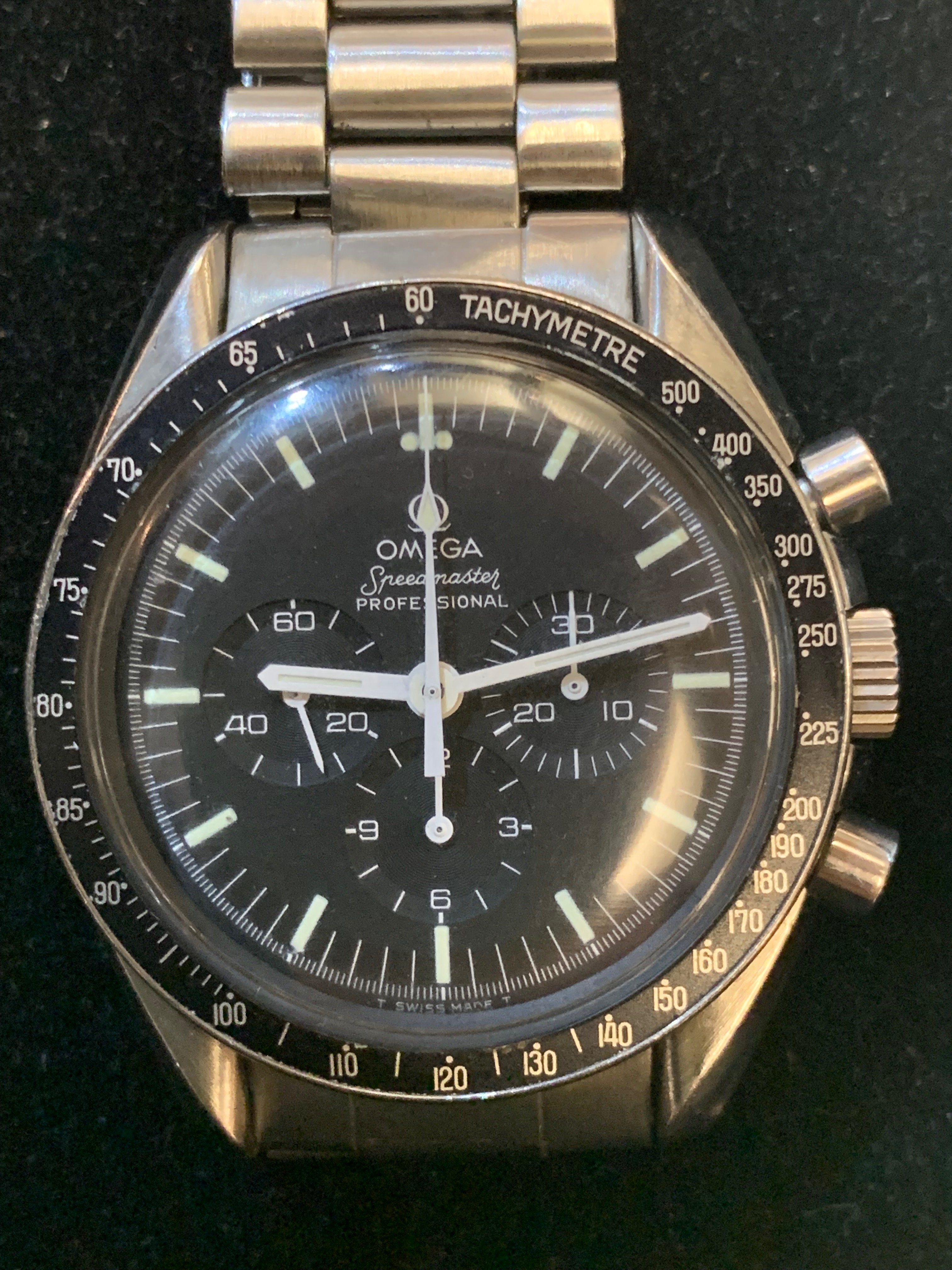

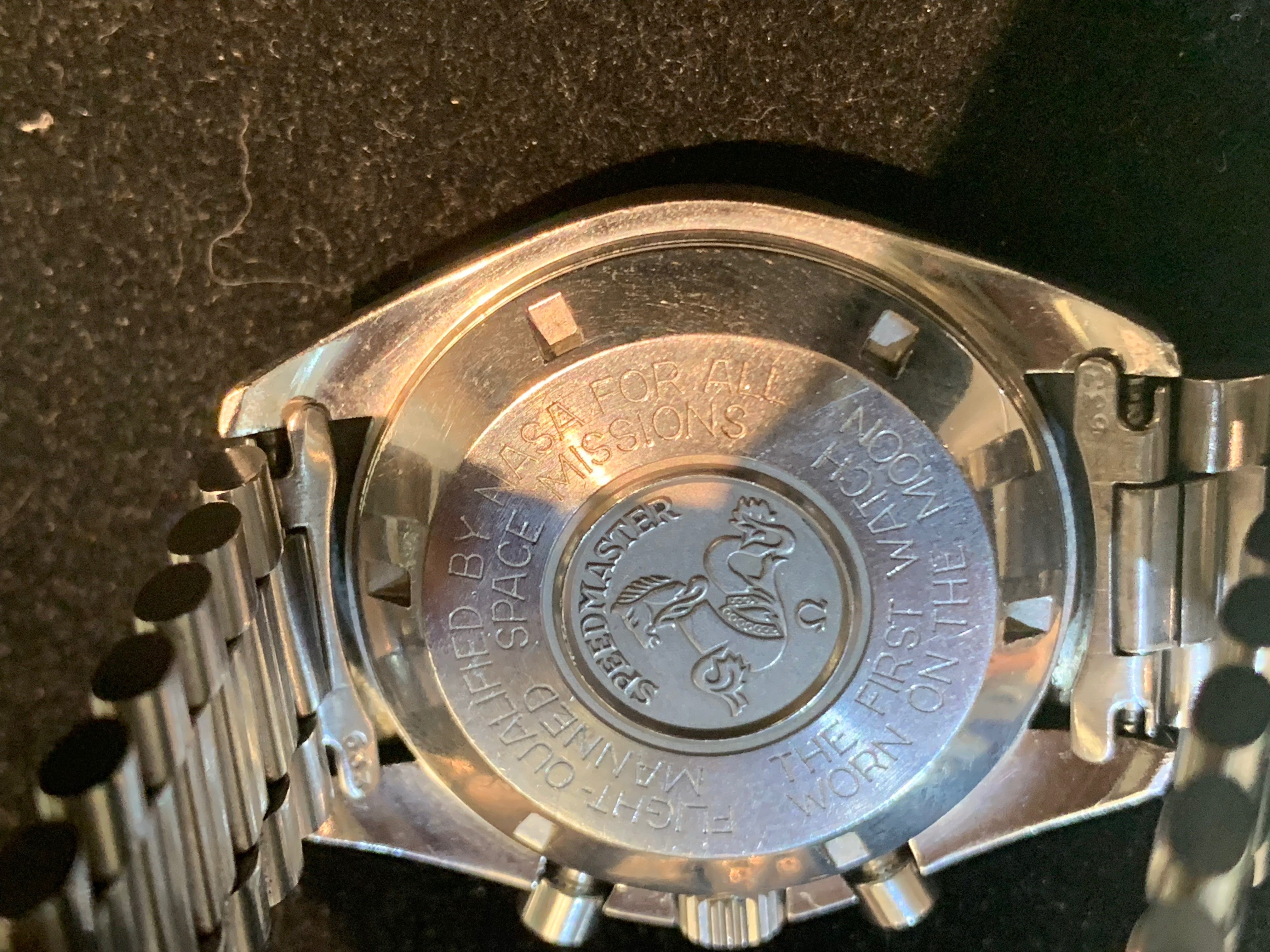

Hello,
Here is a Speedmaster 145.022-78 (pls correct me if I'm wrong) on which I need an expert opinion.
It seems original to me, just the hands are confusing... but I'm just a beginner...
I'm in the position to buy it for around $5K. Does it worth it?

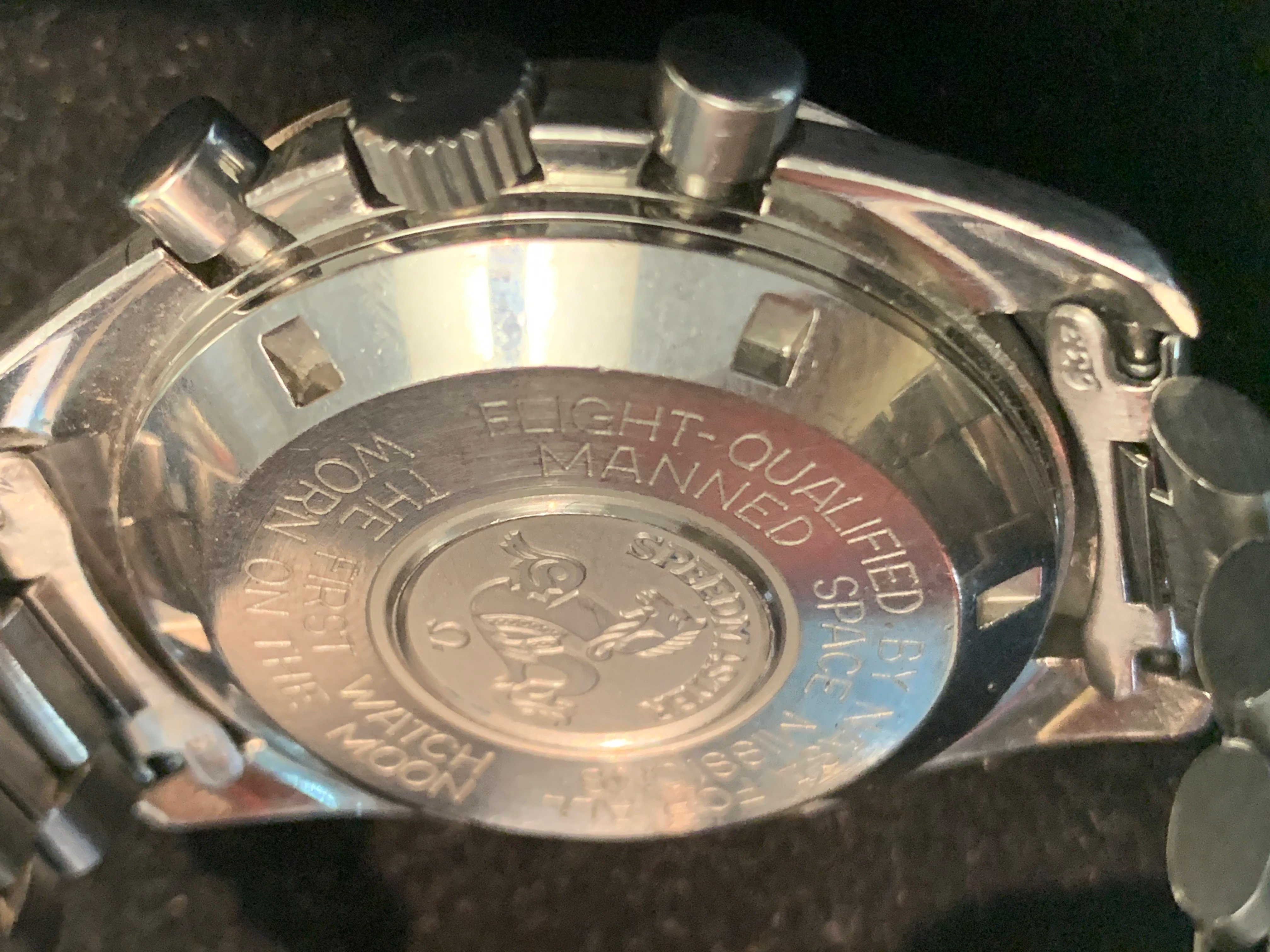

Unfortunately, could not open it to see the numbers...
Thanks in advance!!!

Yeah , @Spacefruit 's speedmaster101.com is your friend. Those hands are definitely wonky. Pass and don't even bother to ask for more /additional photos.

I bought a 145.022-76 with similar - perhaps the same - hands last year: https://omegaforums.net/threads/my-first-speedy-gets-handsy-with-me.81108/
I agree that they look like Mark IV hands
I had the hands on mine replaced with NOS tritium hands at service, but they cost me a couple hundred bucks. But as I got a good deal on the watch I didn't mind so much. For $5k you can definitely get a speedy with correct parts - hard pass on this one at that price.

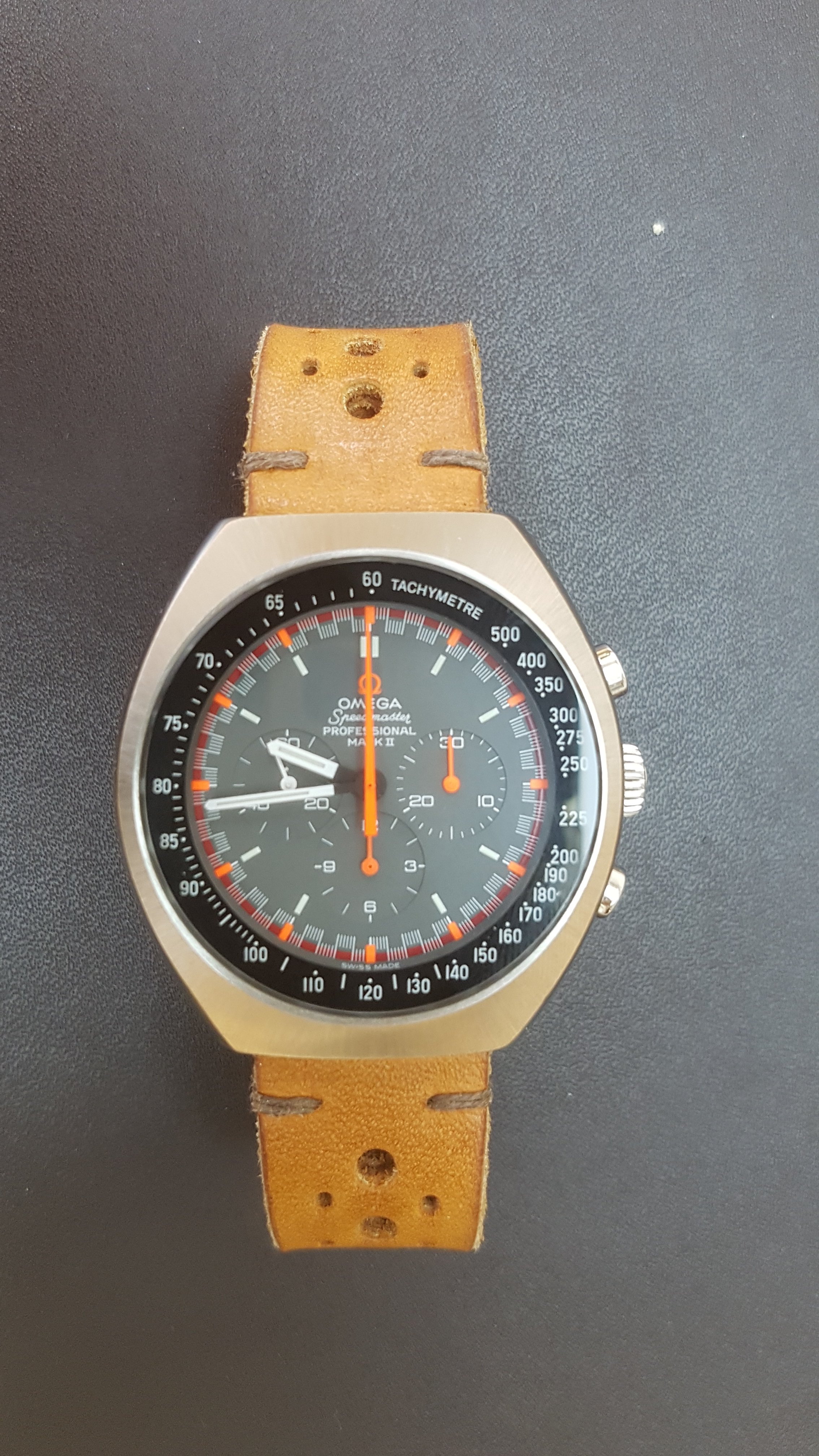

I dont think they could be mk2 racing.
Every racing dial i can find has black and white hands.
Here is mine
