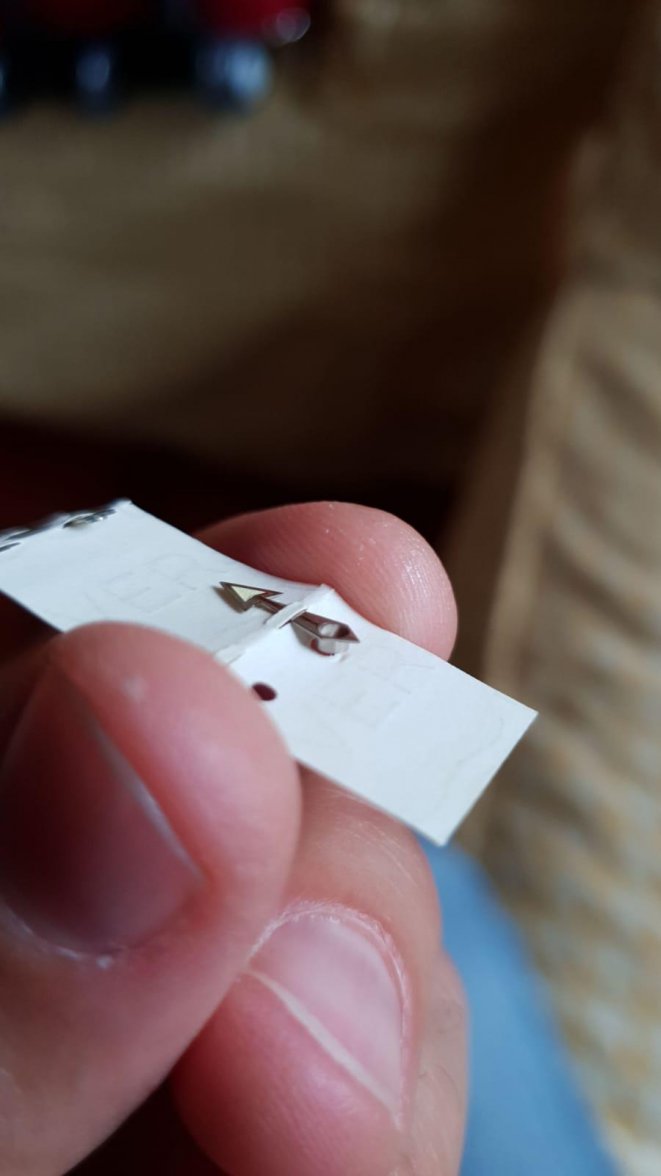

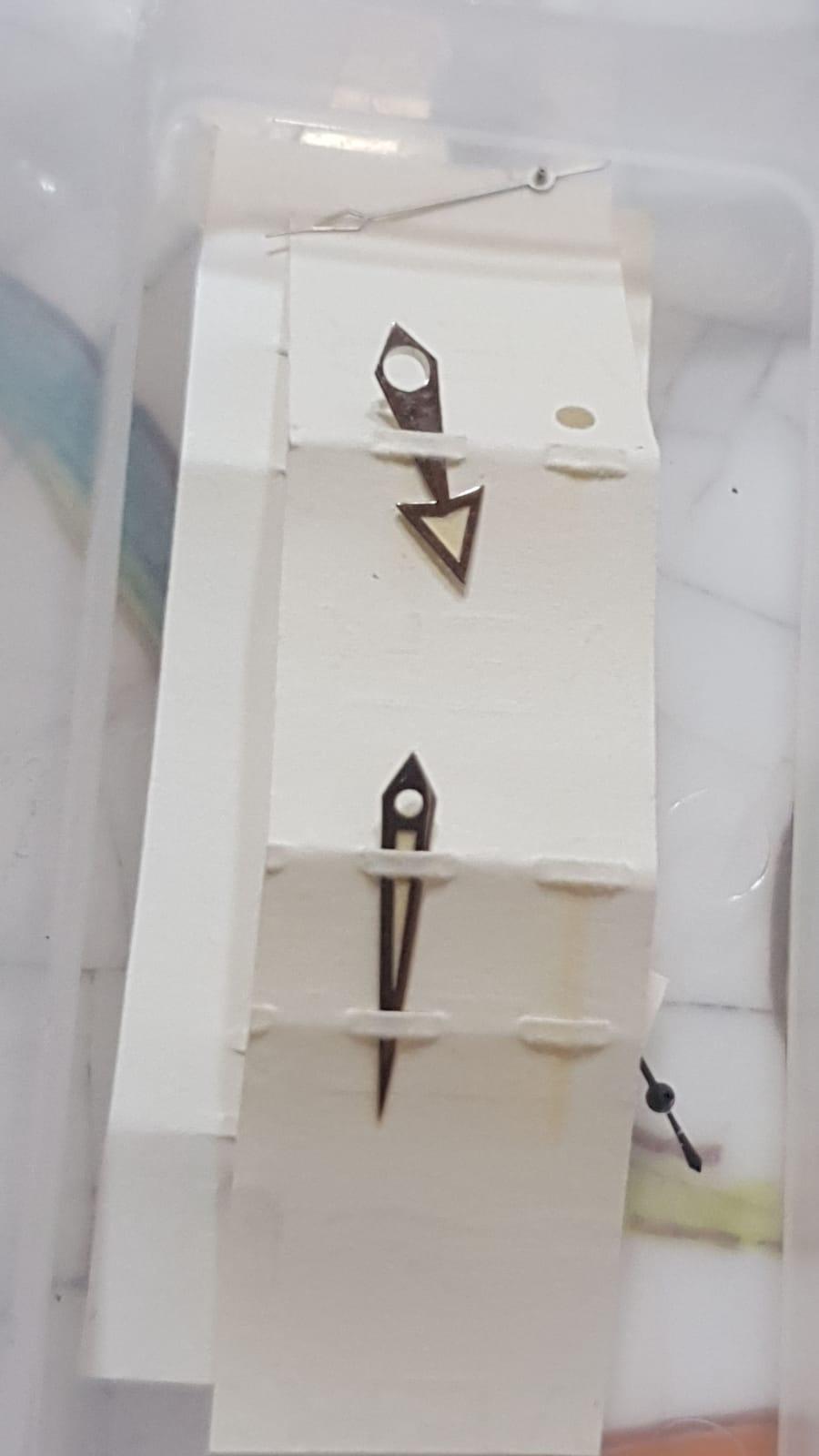

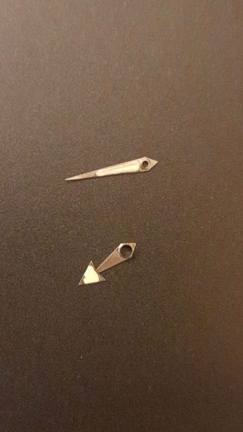

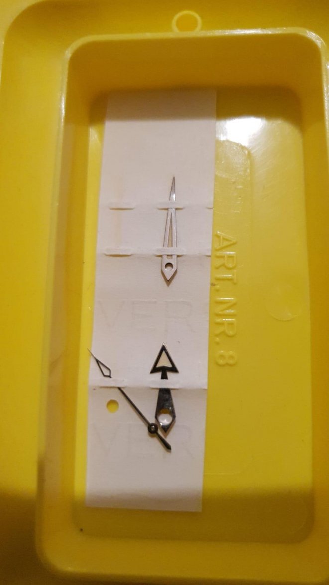

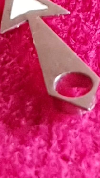

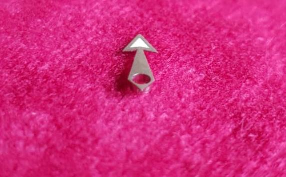

    I would need your help to determine if the following hands are original vintage broad arrow for Speedmaster 2915 ref of course.
    On the back of many excellent topics in this forum, original hour hand should be slightly curved. It looks like the minute hand is probably a later replacement due to the shape of the lume.
    What do you think about these ones? knowing they have the correct size for this reference (1,9 for the hour hand and 1,05 for the minute)

    Lume looks like relumed luminova. But there is a brown trace on paper where another minutehand was. That trace is a sign of radium that burned into the paper. A Geigercounter would help alot.

    The lume on these hands are indeed a relume discloses by the seller, but I did not see this stain on the paper ;)
    I will ask if the guy has a Geigercounter
