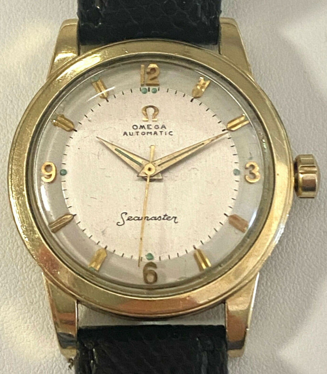

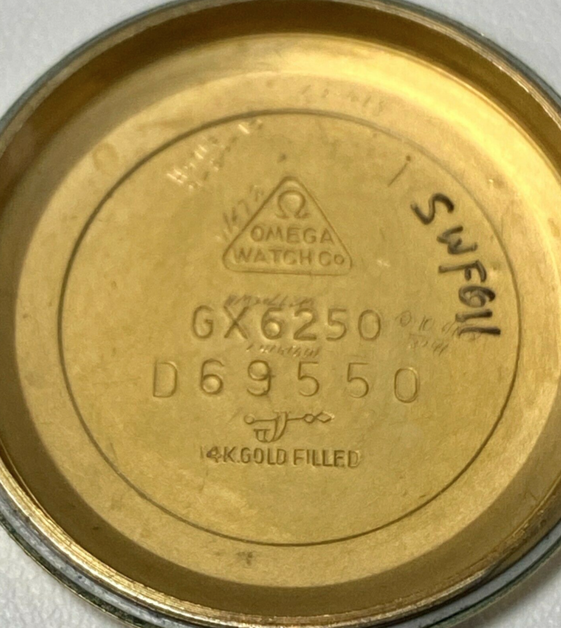

Looking for opinions on this recently acquired seamaster. Couple things stand out to me as odd.
1. Lume - rarely have I seen two dots of lume at the 12 mark.
2. "S" in Seamaster seems to be a little in between the coat hanger and the rounder "S" of latter models.
3. Overall dial font.

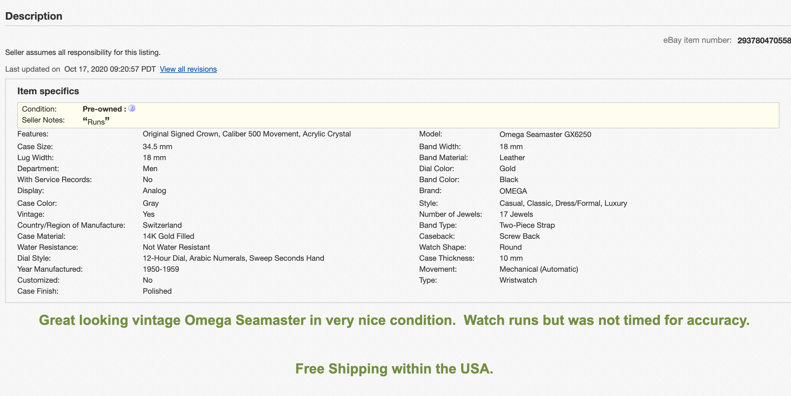

Seller says the watch is from 1958. I have included the (rather light) spec list.

Even with the horrible photos it doesn’t look good.
Lume was often added but it looks like this Lume is mint toothpaste

Redialled US domestic case model. Jonelle case? Not the best example to be honest.

It’s not a fake, but unfortunately it is a relatively poor example with a refinished dial.

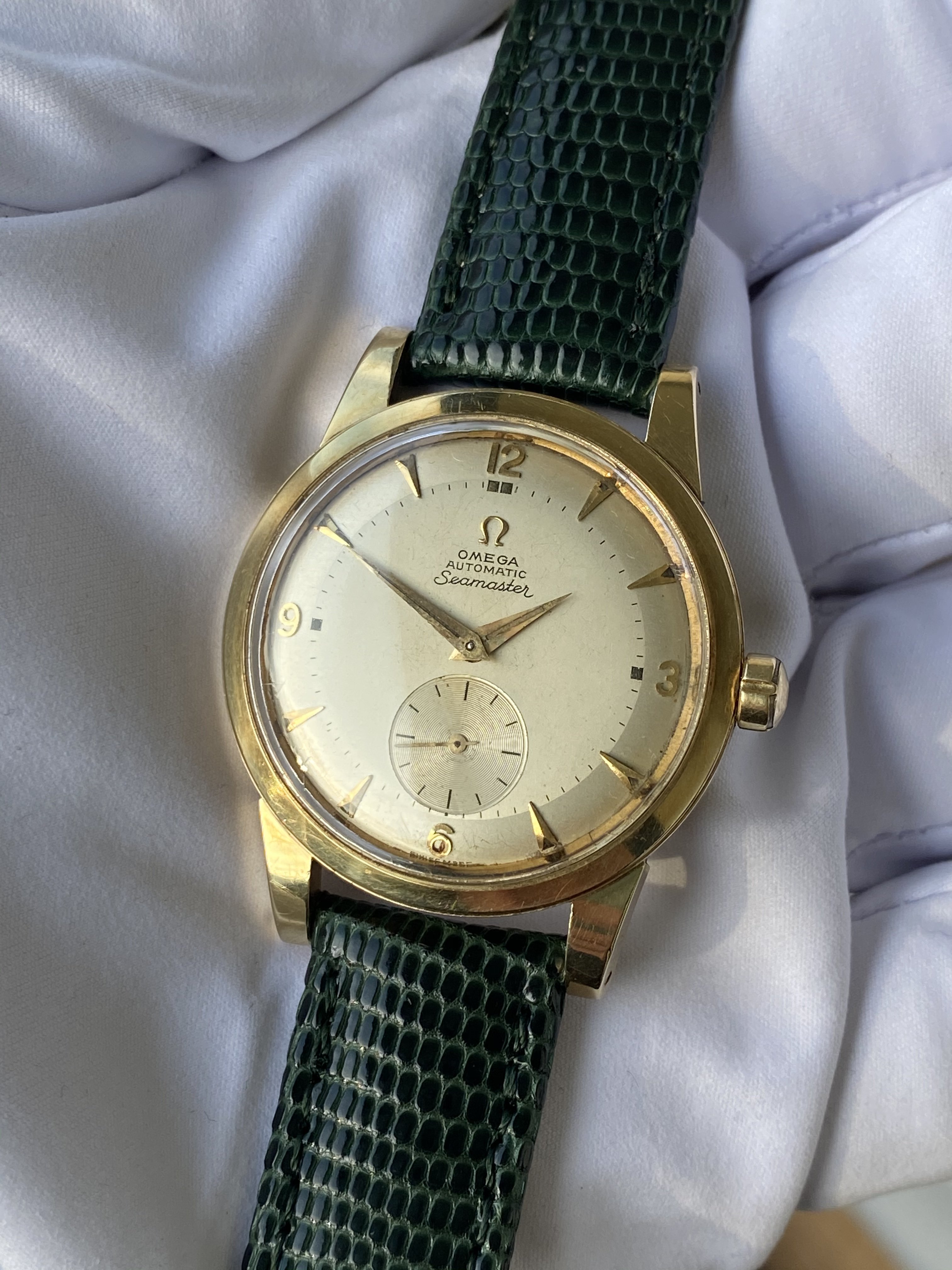

Two lume dots underneath the 12 did exist:
They don’t, however, in this mint color. Also, the dial is a bad redial, I’m afraid. If you can still return it I’d do so. Hope you didn’t pay too much!
