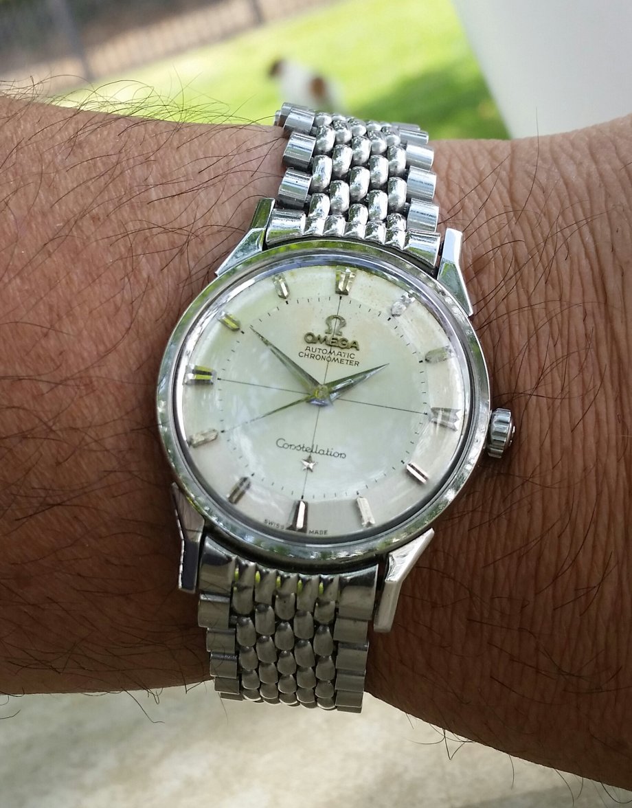

    You may recognize this Connie from such posts as, Jim at the dog park, or my first vintage omega. Anyway I've worn it for a bit now after a service. The hands came back fabulous by the way. Any who, I still wonder if a lemon juice bath might be the last thing this old girl needs. What say you?

  3. wristpirate May 4, 2016
    1,231
    3,723
    Looks nice as it is. I would be too worried about ruining it, so would leave it as it is
  4. ConElPueblo May 4, 2016
    9,587
    26,961
    I'd stay well away from touching that, if I were you!
    +1 to the two post above me :)
  5. Darlinboy Pratts! Will I B******S!!! May 4, 2016
    8,727
    69,007
    Lemon juice is a weak acid.
    Need more be said? :whipped:

  6. MSNWatch Vintage Omega Aficionado Staff Member May 4, 2016
    6,528
    10,780
    Looks like it was already cleaned in the past. Would definitely not mess with it further.
  7. cicindela Steve @ ΩF Staff Member May 4, 2016
    15,047
    23,789
    Do Not Touch.

  8. Vercingetorix Spam Risk May 4, 2016
    3,238
    5,219
    If the dial is not up to your standards, sell it and buy one that is.

  9. Alpha Kilt Owner, Beagle Parent, Omega Collector May 4, 2016
    16,005
    140,950
    Preferred use of lemon :thumbsup:
    Seriously I am in the "leave" camp.
  10. jimdgreat1 May 4, 2016
    477
    1,700
    Another open forum I visit has a saying. First post nails it. :thumbsup:
    It actually looks worse in person. Not enough to mess with. Thanks everyone.
  11. ulackfocus May 4, 2016
    25,983
    26,968
    The problem with cleaning a dial using any acid or even Windex is that you strip away the top coat. Yes, there is the potential to make it look nice for a while, but removing the top coat will expose the dial to even worse elements and eventually ruin it completely. If you're gonna attempt to clean it, you should know it's gonna work and you should have a way to put a protective lacquer back over it after it dries. Otherwise, buy a new watch if you want a watch that looks like new.

  12. jimdgreat1 May 4, 2016
    477
    1,700
    Different shot of the damage. Thanks for talking me out of a restore. 20160504_102743-1.jpg
