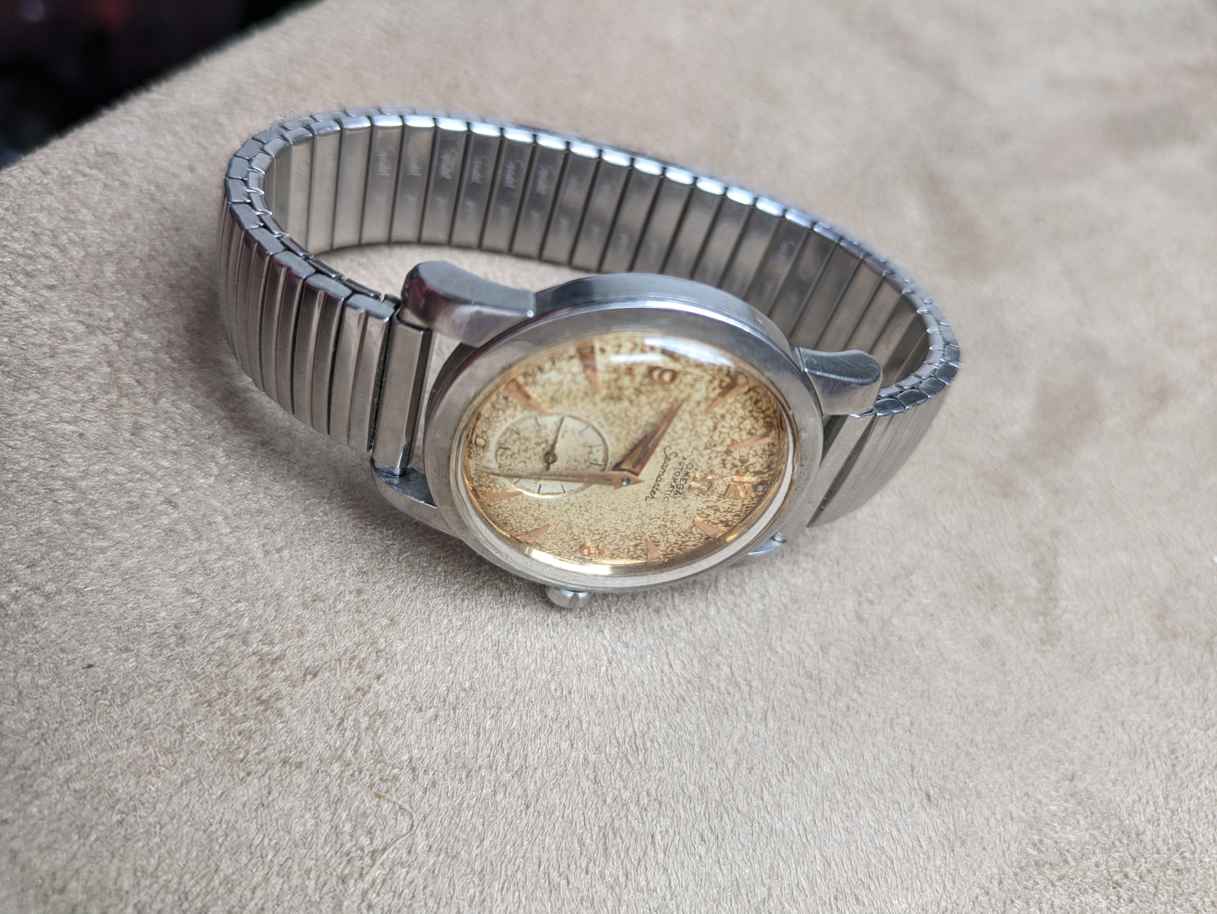

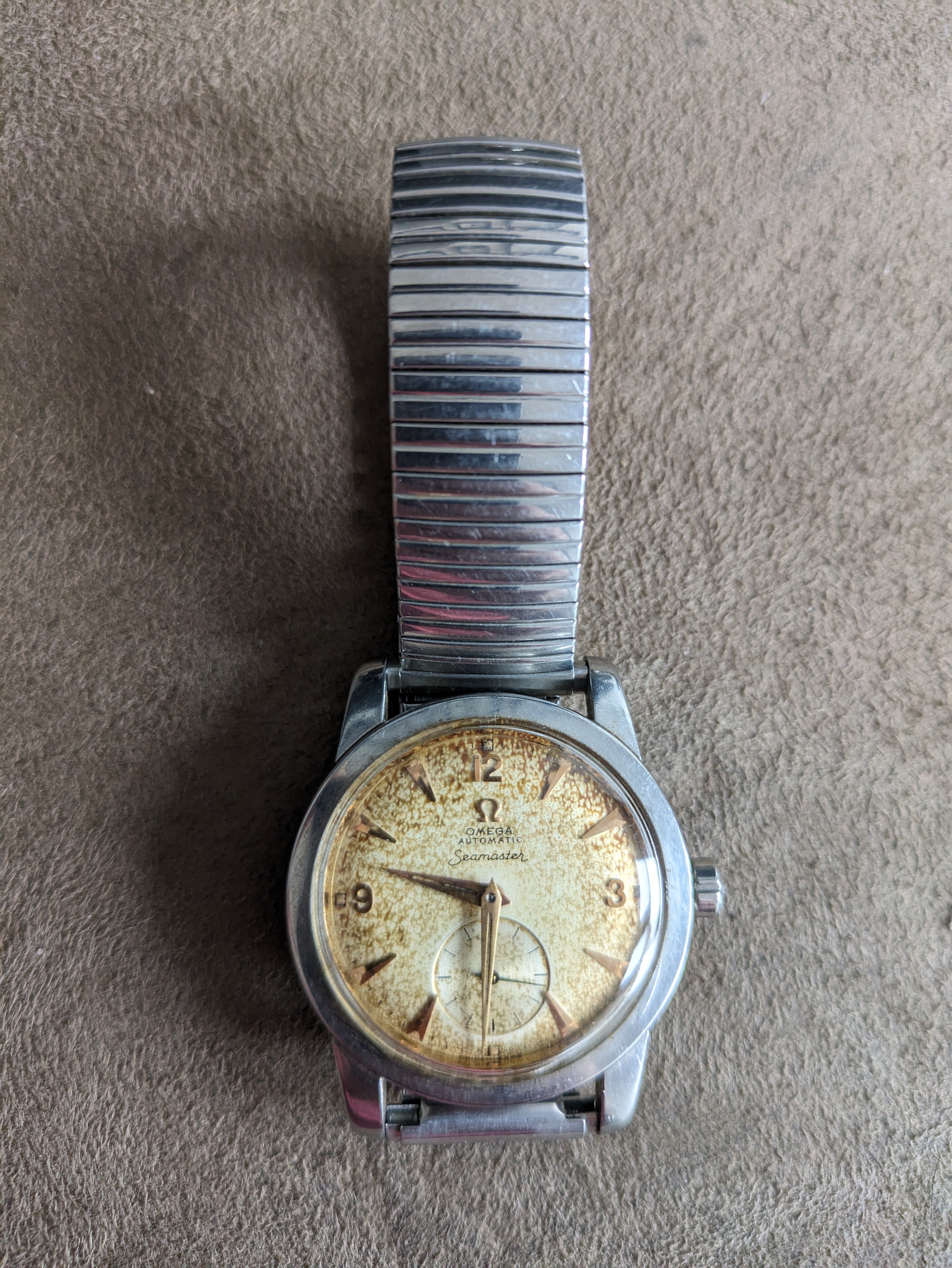

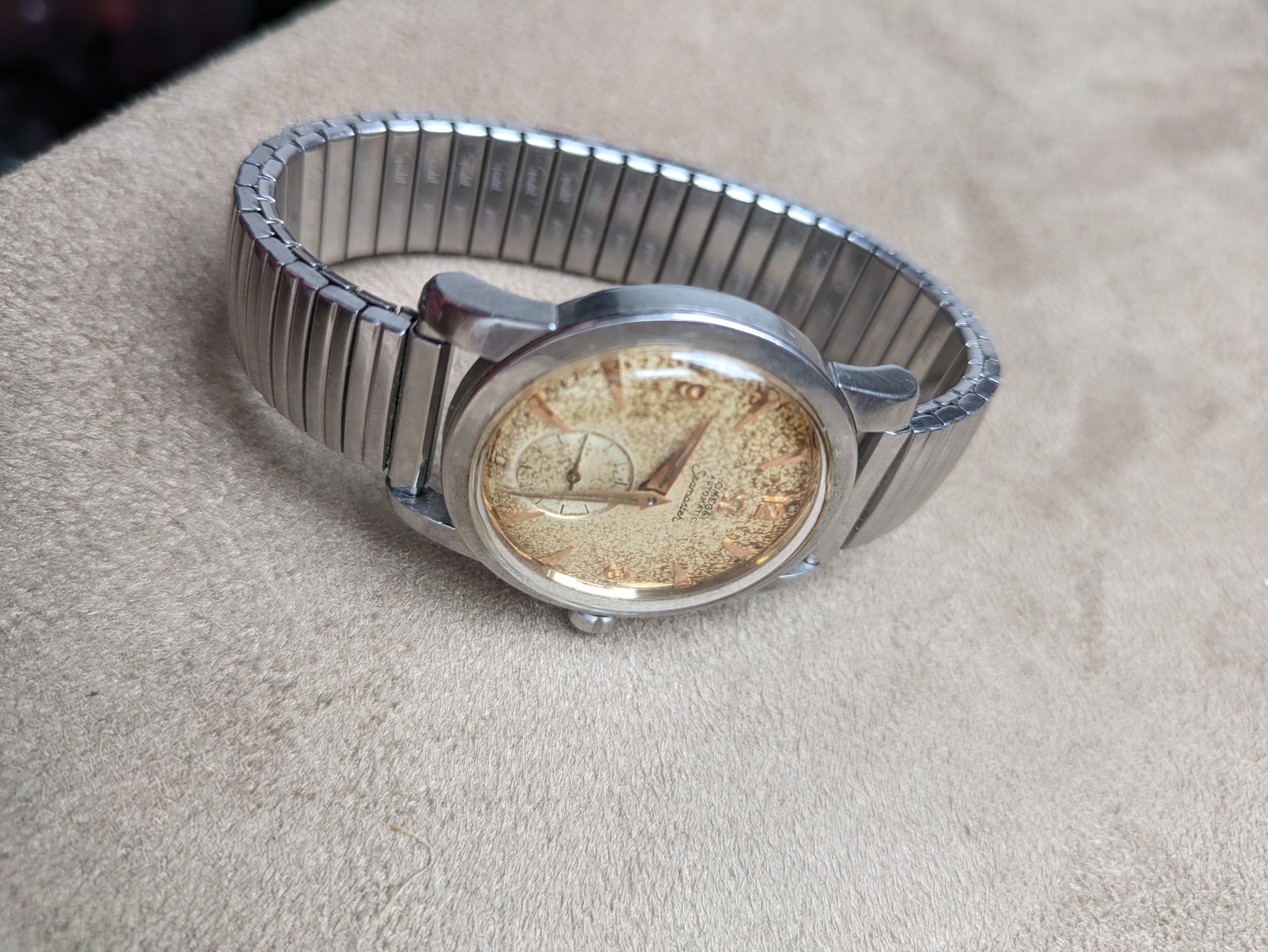

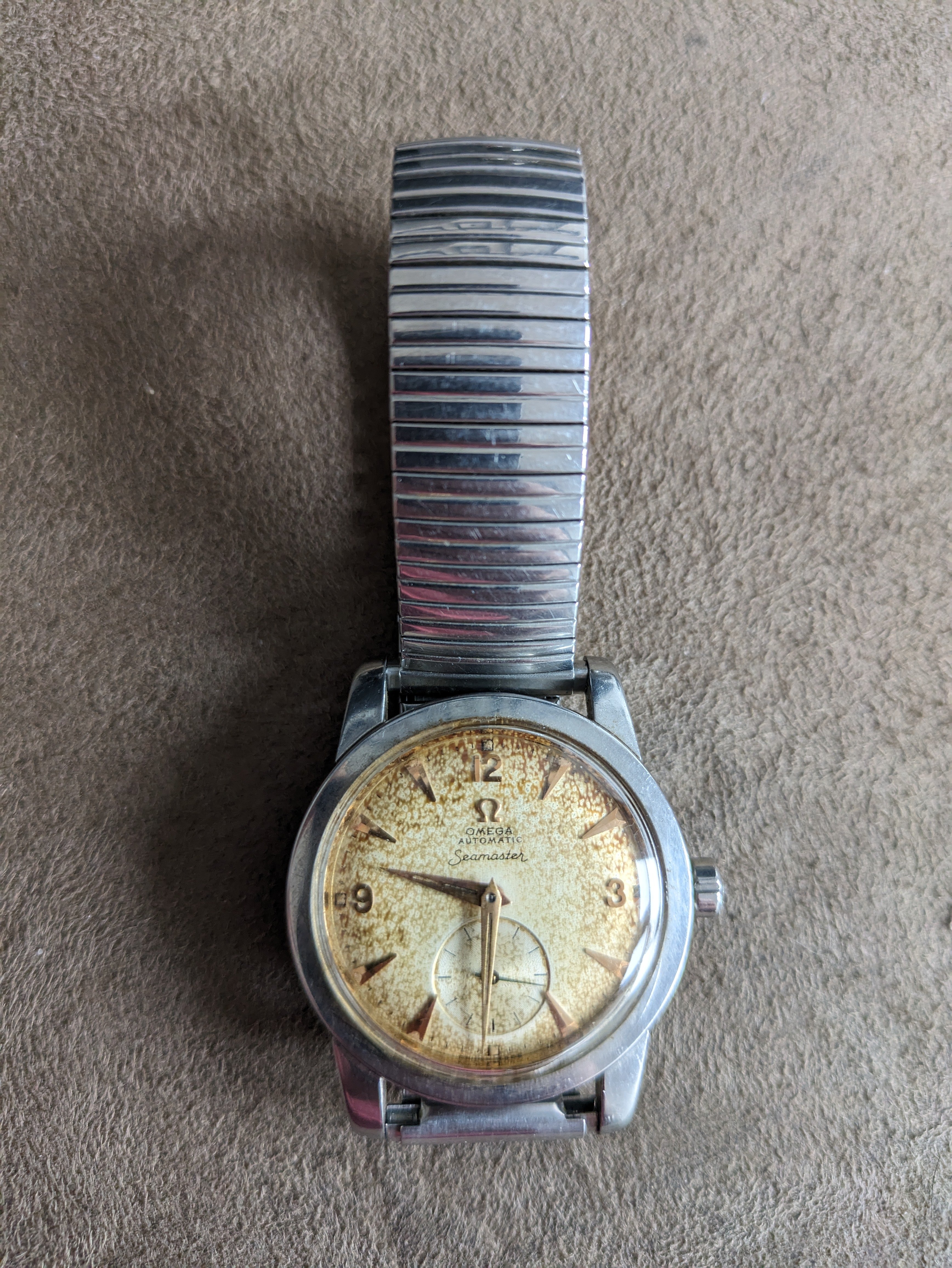

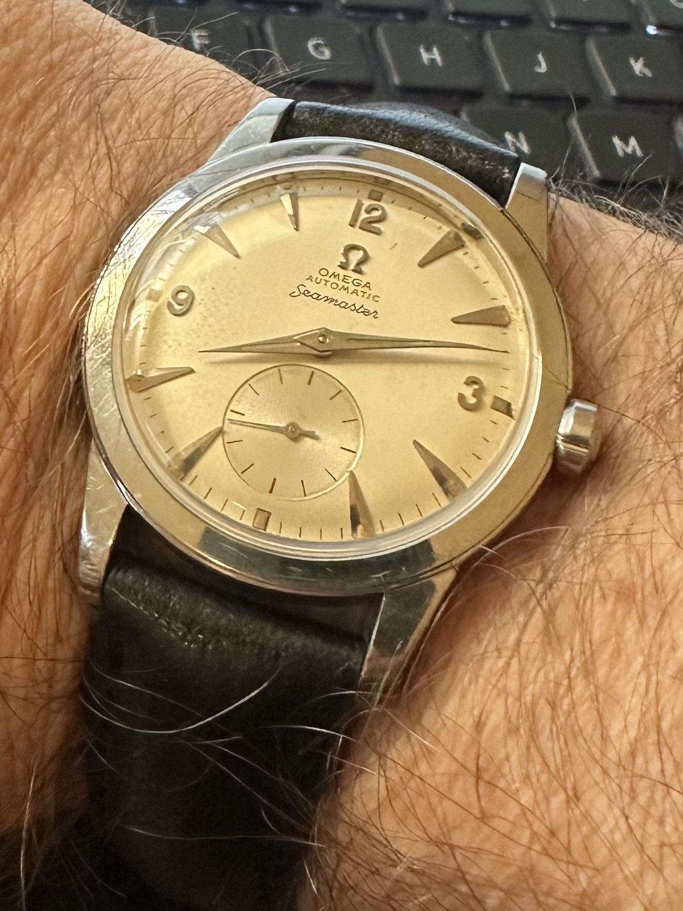

Hello all, I'm a complete newcomer and have just one omega watch to my name. It was given to me by grandfather 10 years or so ago. Im not sure of the exact model, but I'd like to know more. It seems to be in good working order and seems to keep time well. My main concern is that it's always had quite a heavy 'patina' on the face, and I don't know whether this could eventually cause a problem or affect its value. Is it something I should get cleaned? I know some people like patinas but I wonder if this is a bit much. Personally I quite like it (it's softer than it appears in the photos) but I know it's not for everyone! I have no intention of selling it but I am also interested in whether it has much value. Thanks all.

Generally you can't clean a dial. And like you said it comes down to the personal preference on anyone who might want to buy it.
Best bet is to make sure its been serviced in the last 10 years and leave it be

Ok, thanks for your reply. Is this likely to be mostly on the dial surface, or on the inside of the watch too? Any idea of the model number or year for this watch? I took it to someone to find out its number, but they refused to take the back off it!

Both these questions to be answered need you to get the back opened, the movement will show the damage (if any). And the serial number, which will tell the date of production.
in the inside of the caseback there will be a reference number, which identifies the exact model, and guide search for its characteristics.
the dial very rarely can be serviced, usually gets ruined. Better find a suitable substitute (keeping the original for sentimental and historical reasons - and reversibility)

I think your watch is an Omega Seamaster Ref. 2576. Here is some information from Omega:
https://www.omegawatches.com/en-us/watch-omega-seamaster-omega-ck-2576
No picture there, but if you Google “Omega watch 2576”, you’ll find hundreds of similar examples with dozens of different dials.
The patina on your dial is caused by natural yellowing of the lacquer. This happens with most Omega watches from the 1940’s through the 1950’s. Environmental factors play a role in this, like exposure to cigarette smoke, radioactivity (yes, that is real radium on the dial and hands) and high humidity.
The issue with trying to clean a dial with this type of damage is that removing the lacquer is likely to also remove the original printing on the dial. IMO, this destroys the vintage charm of the watch. Most people don’t feel this way, so when you search, you will see many watches with varying quality of refinished dials.
If the watch hasn’t been serviced in years and you want to wear it regularly, you should find a watchmaker in your area that can clean and lubricate the movement. It will cost a few hundred dollars, but will preserve some of the moving parts.

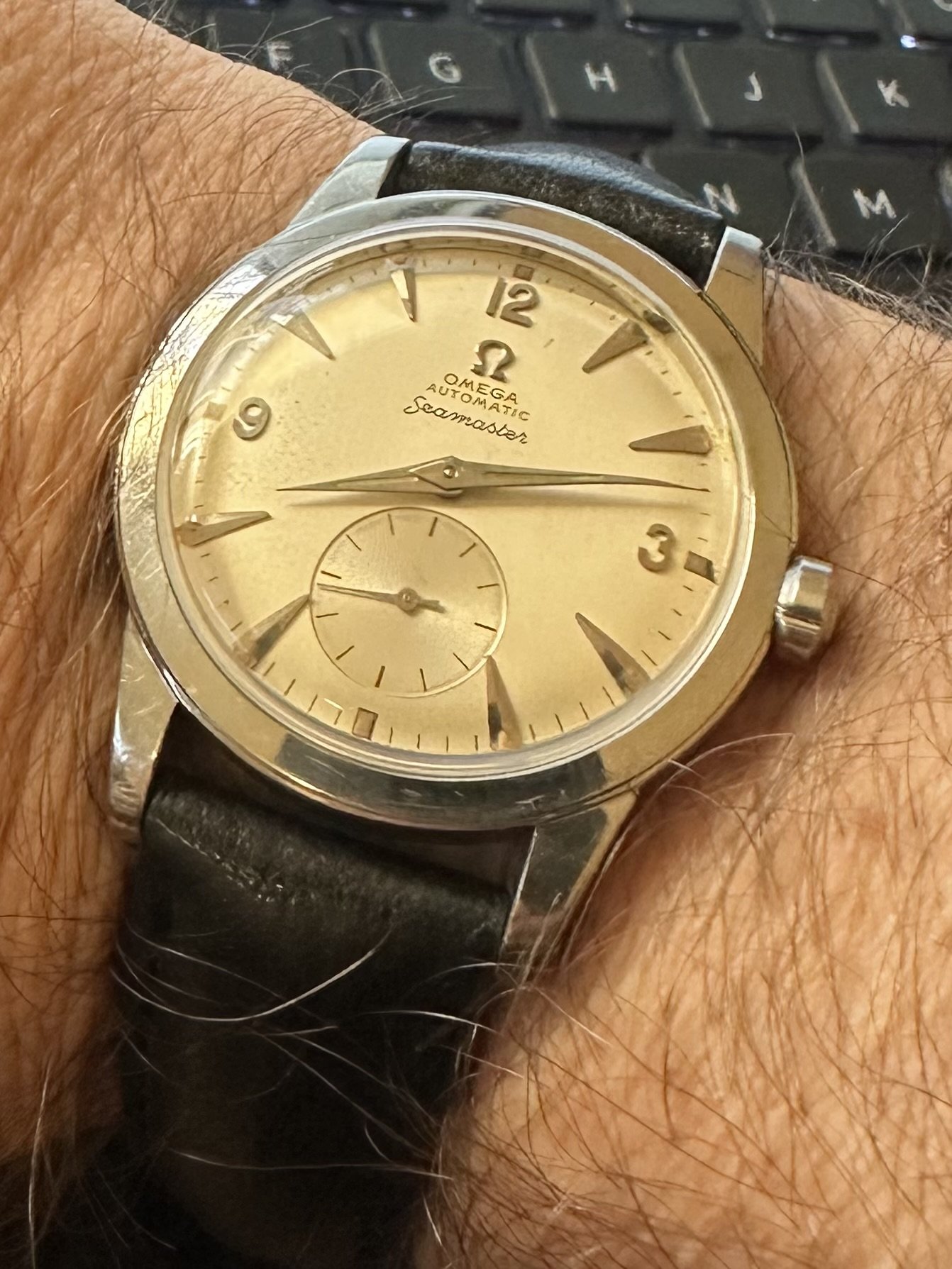

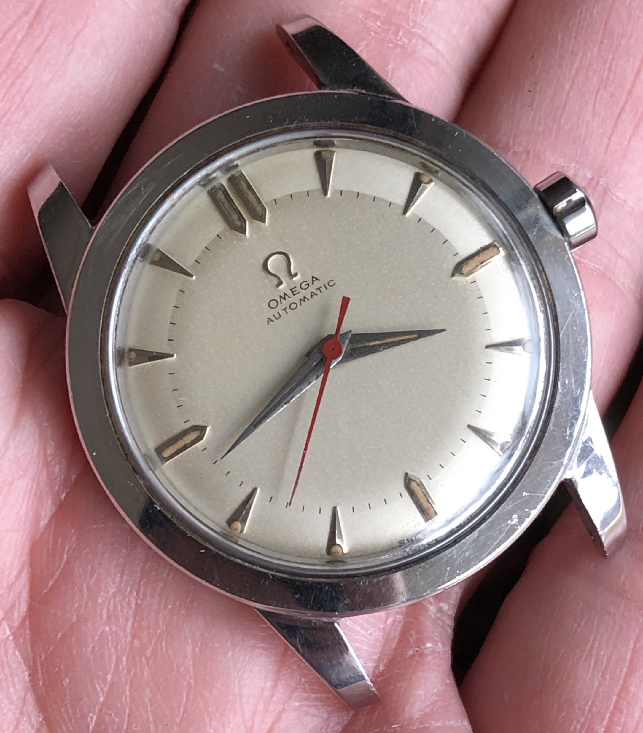

gatorcpa is correct that this is a reference 2576. Here is a photo of mine to show you what an unpolished example with an original unrefinished dial in good condition looks like:
If you’re not bothered by the dial patina, just have the movement serviced by an independent watchmaker with an Omega parts account and wear it. Cleaning the dial will almost certainly destroy it. There were many of this model made, so you may be able to find one with a nice original dial that you could salvage to replace yours. Be careful if you choose this option because there are many redials out there as gatorcpa notes.

Patina is a matter of taste. This is a bit heavy but it’s pretty consistent and thus kinda interesting. Don’t try to have it cleaned. The more important work is a full movement service to keep it running.

That solar flare patina is kinda cool. Keep it like that if you like it! Leave the refinishing decision to whoever gets it later down the road.

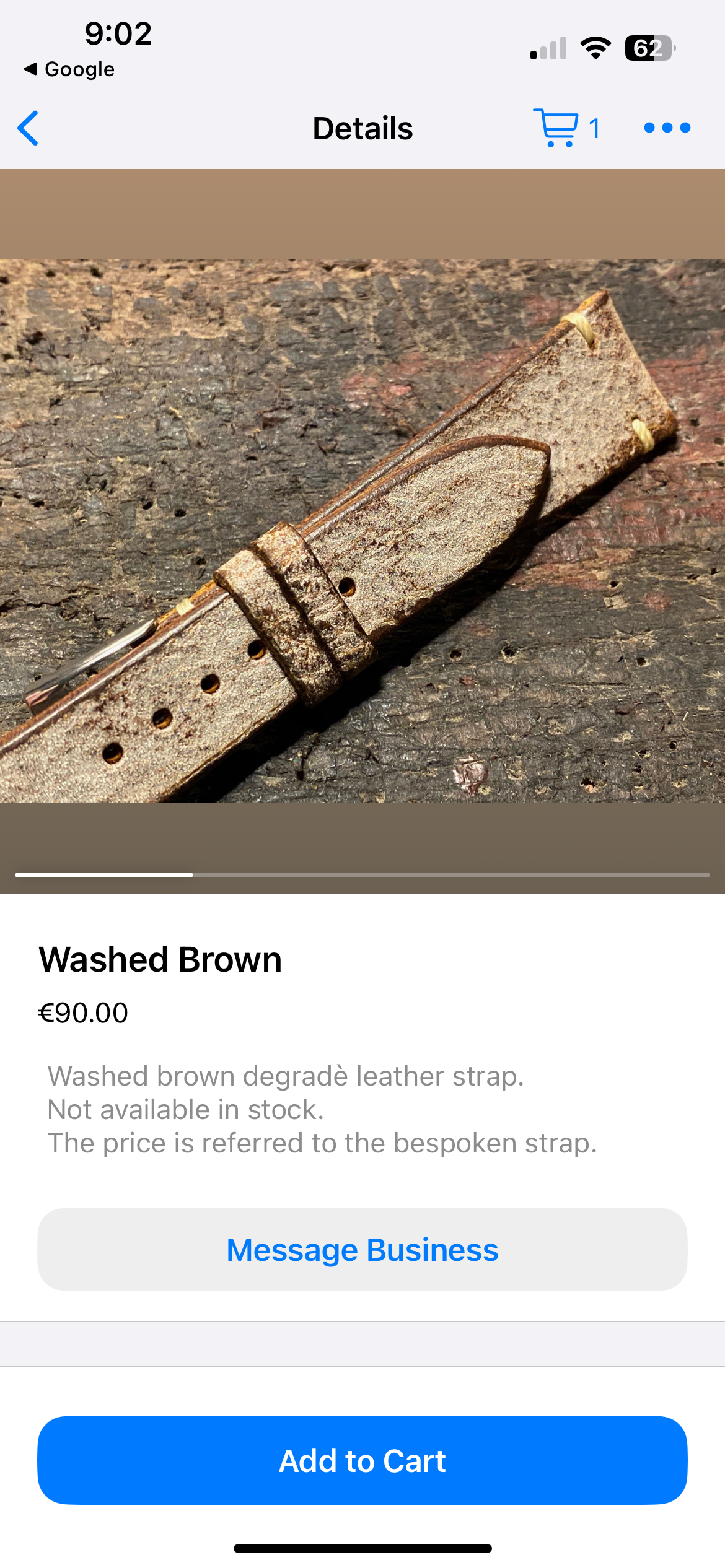

This is a very nice watch, and most importantly was your grandfathers watch. It is a sought after reference among collectors. I would definitely follow advice already given to have it serviced, but instruct watchmaker no case polishing, do not touch the dial or hands. I would put it on a nice brown leather strap with vintage style, and enjoy wearing the watch of your grandfather and think of him as you look at that one of a kind dial. Priceless!!!
