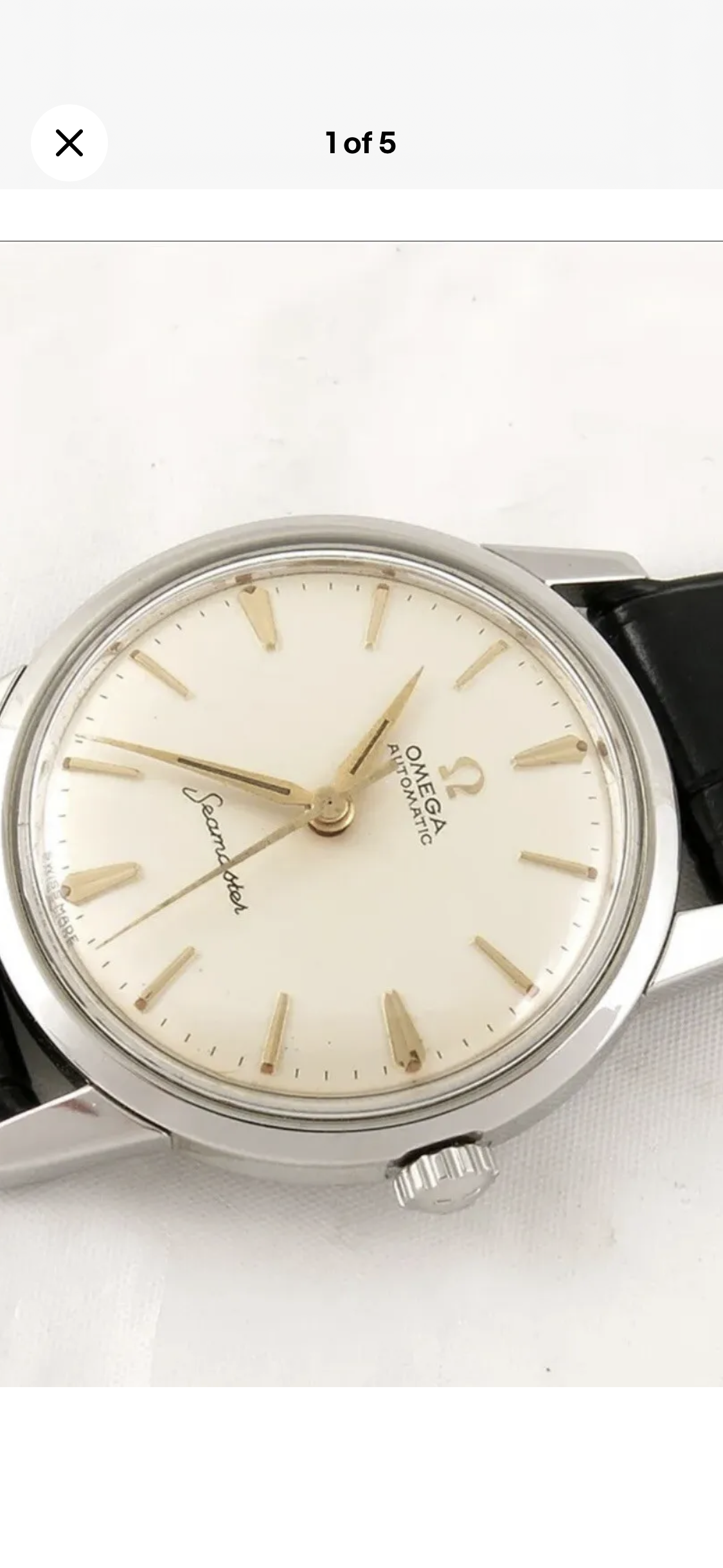

Hey everyone,
I’m new to watch collecting but have been really interested in buying a vintage Seamaster or Constellation. I’ve been doing some reading and browsing to try and educate myself but I understand vintage watches can be a bit risky sometimes. I’m looking at this watch in particular and wanted to see if the community had any “watch-outs” or tips. Thanks everyone!

Welcome. Overexposed poorly focused photo need straight on good quality shot to assess
But looks like redial Need more photos
What is asking price?

The dial looks original to me, but I agree better pictures are needed to confirm.

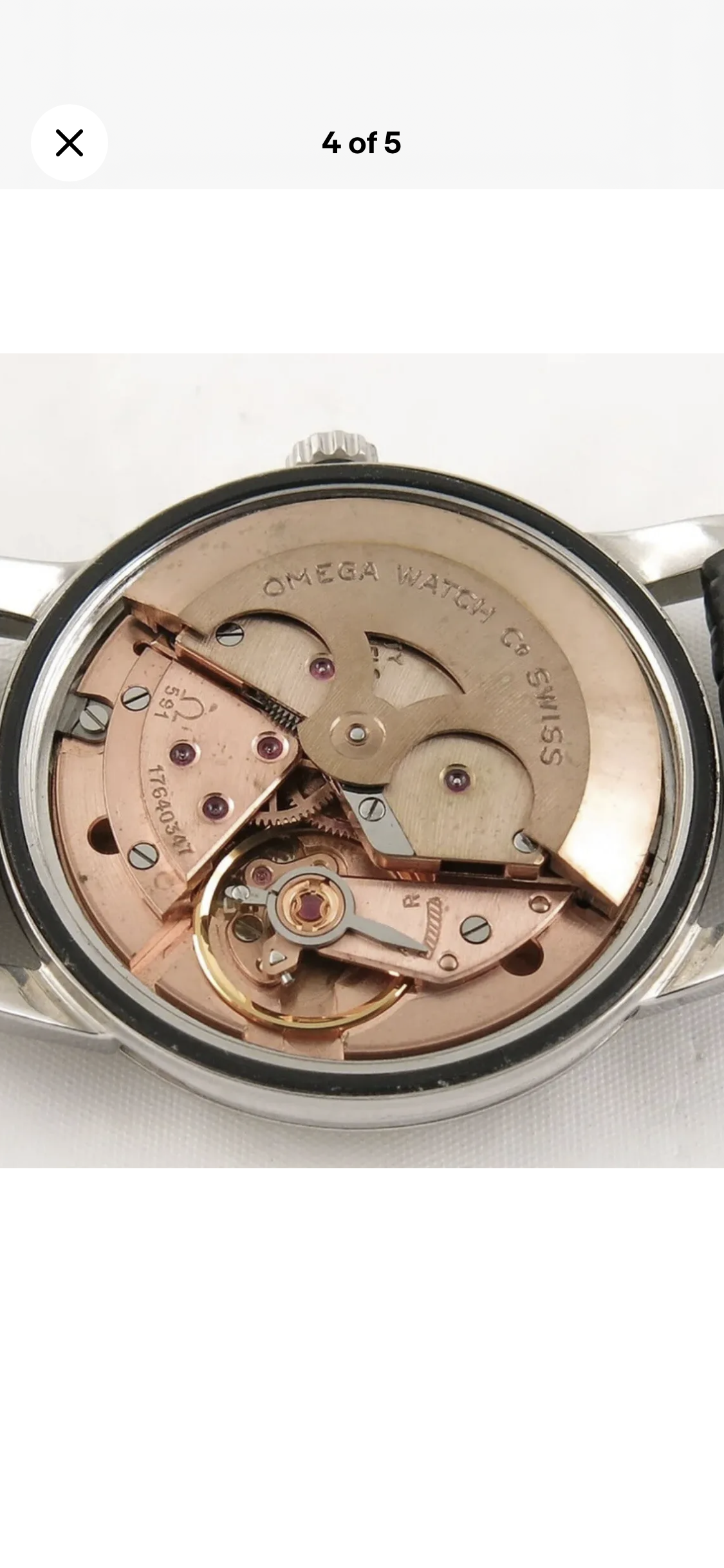

Thank you! I've attached an updated photo and would very much appreciate any opinions on the dial, movement, and case. The asking price is $850 including the beads of rice bracelet.

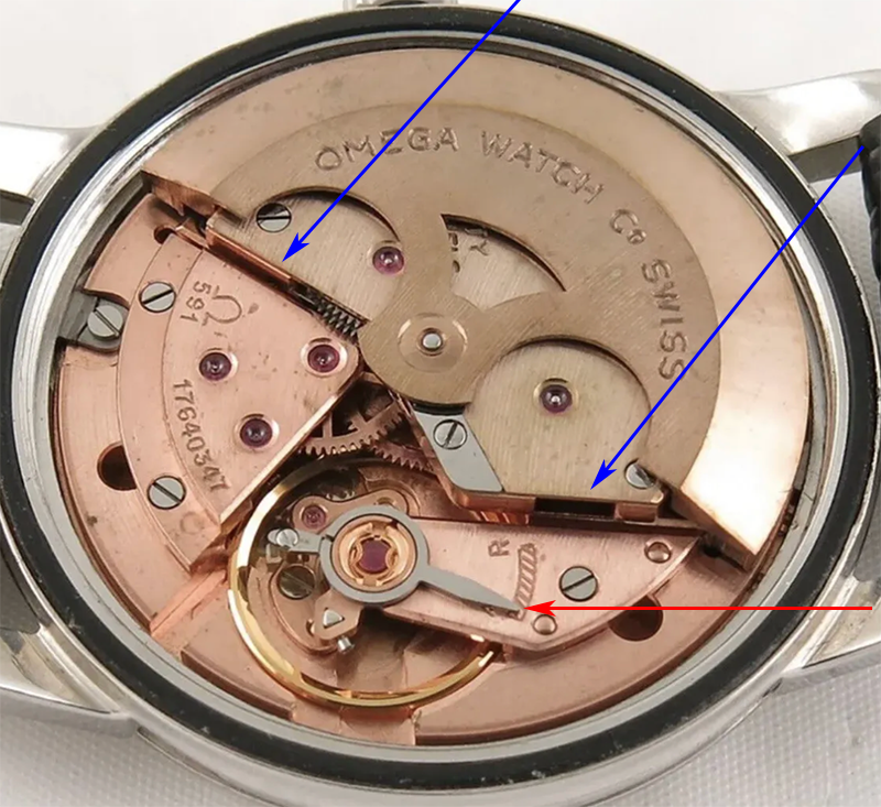

Movement either needs service or was poorly serviced, note the position of the regulator. Also note the difference in color between the main plate and the rotor/rotor bridge. Replaced, put together?... Additionally the case is polished I'd pass at anything above $450-500. Best thing about this one is the dial but it doesn't make up for the other issues, especially at $850.

Thank you all so much. When you point it out the different colors on the movement, that is quite obvious. I'll do some research to understand what you mean by the regulator position.

Should be in the center not way over to A - advance (fast) or R - retard (slow).
