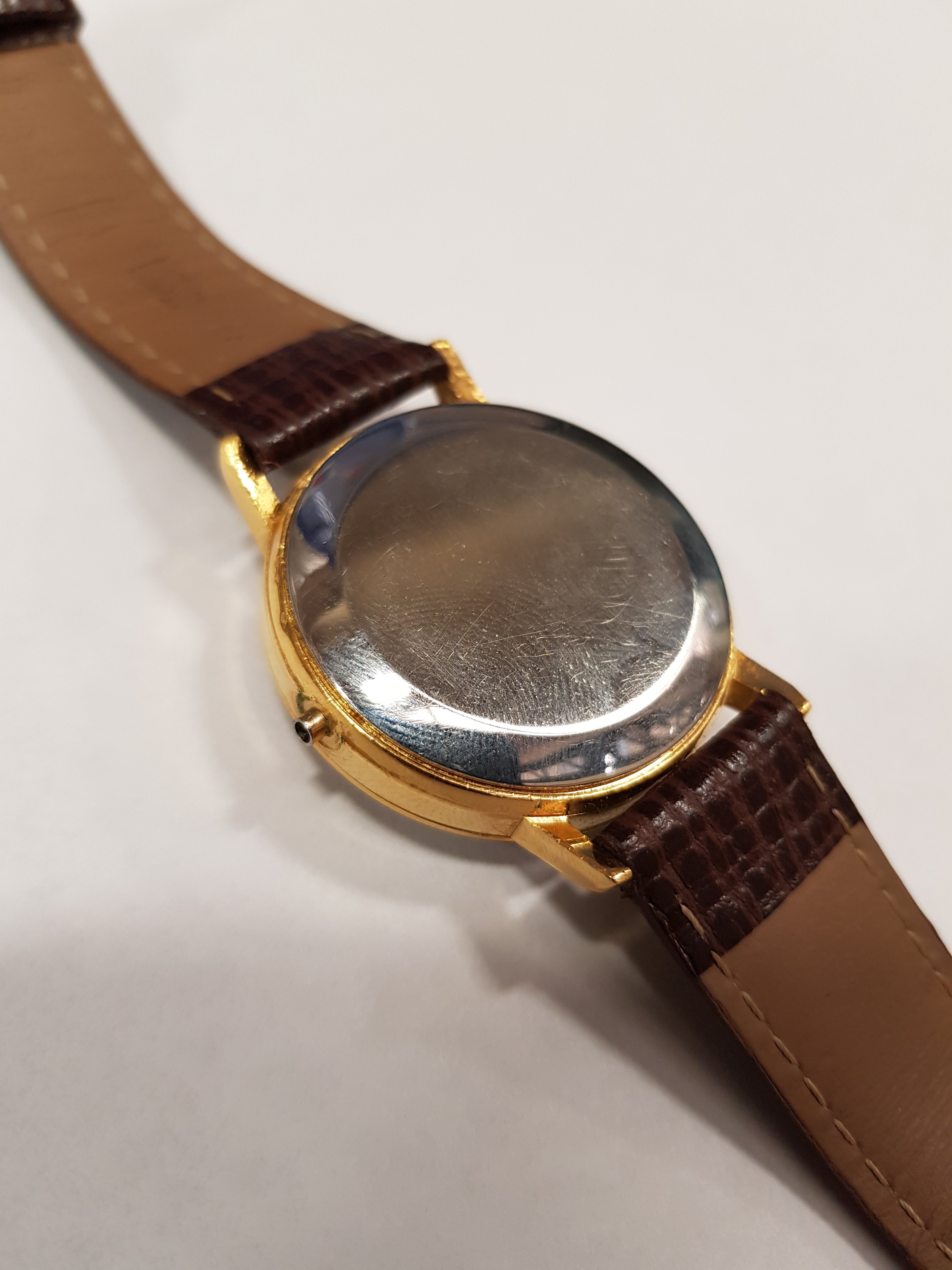

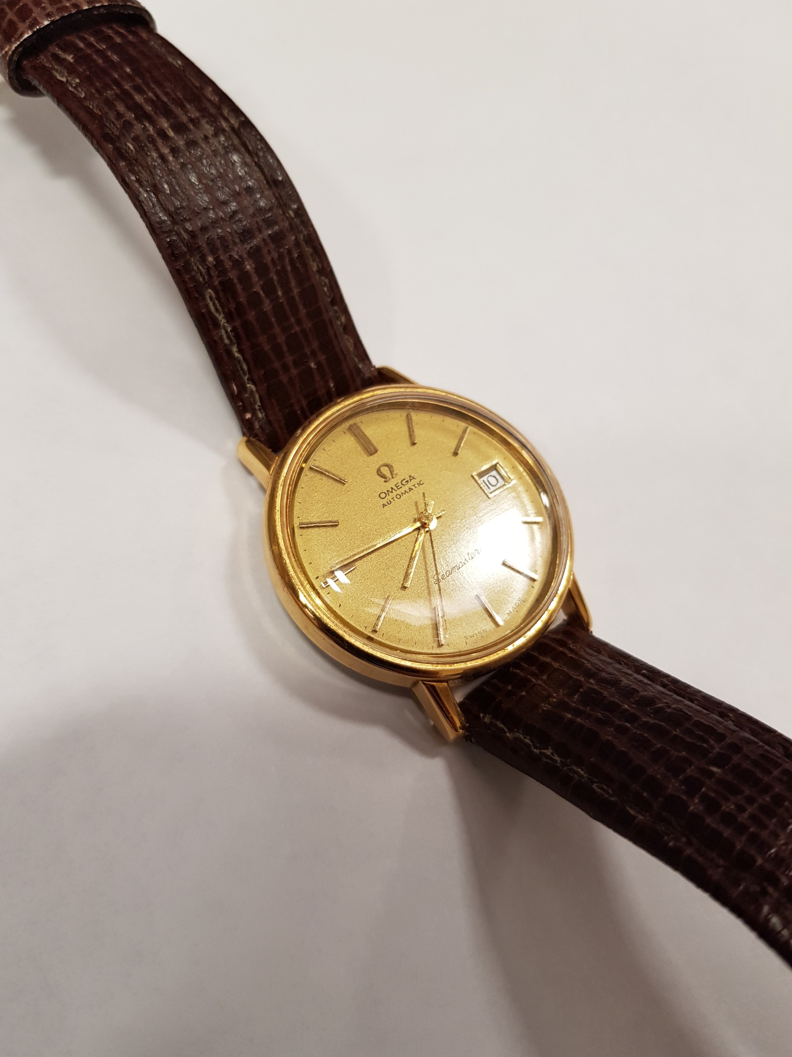

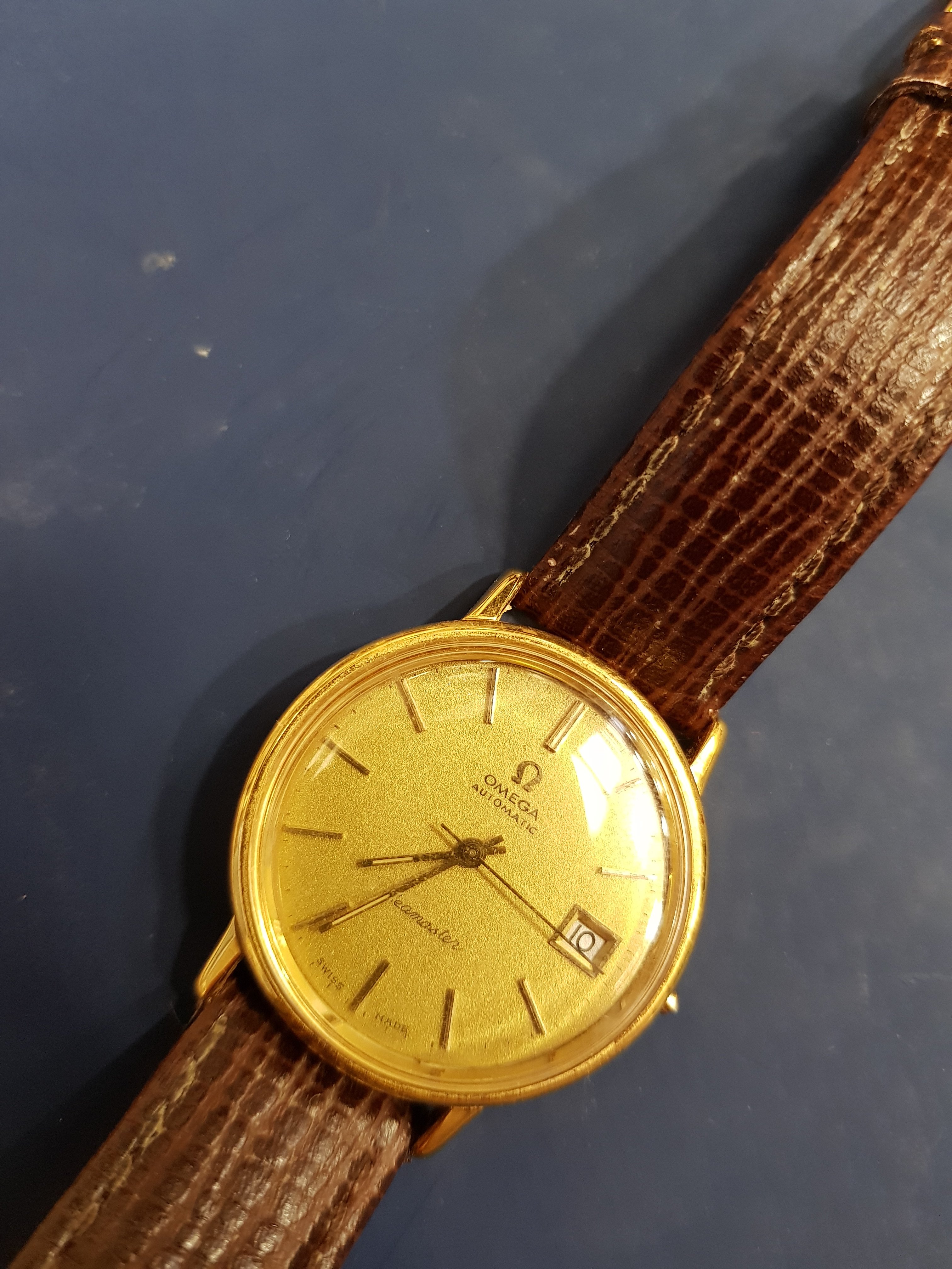

I had a few too many beers and started sending offers on Ebay, I know idiot !! I have won this what appears to be a Seamaster for £200, however once really looking at the Dial I noticed the S appears to be odd looking as well as the OMEGA font. No pictures of the mechanism and no relief on the Case Back. May be in for a loss here. Does anyone recon this is a full on fake or a redial. Can update the thread with a conclusion when it arrives. 1st post after months of reading. Many thanks !

That really is an awful redial and, although it’s after the event, it would have been sensible to post here for opinions before, rather than after, you bought it.
That said, your best course, given that the seller states 'no returns' is to complain to eBay on the basis that the seller deliberately posted poor quality pictures and made no mention of the fact that the dial had been refurbished or refinished, implying that it was in an original condition.

The listing doesn't claim that the watch is all original and the photos are good enough to see the issues, IMO. In addition to the repainted dial, the lugs are brassed and the crown/stem has problems. On the positive side, the case-back has a nice protective sticker. 😁

Yeah, only just now clocked the lugs when you pointed it out. Was naive, I knew about the stem / crown I presumed a replacement stem would sort it for £10 or £15 but no point now with the condition it is in. Will just have to accept the loss and move on. Not sure what I was thinking as my own preference is stainless with a bracelet, so I bough a gold plated leather one ? haha dafty !

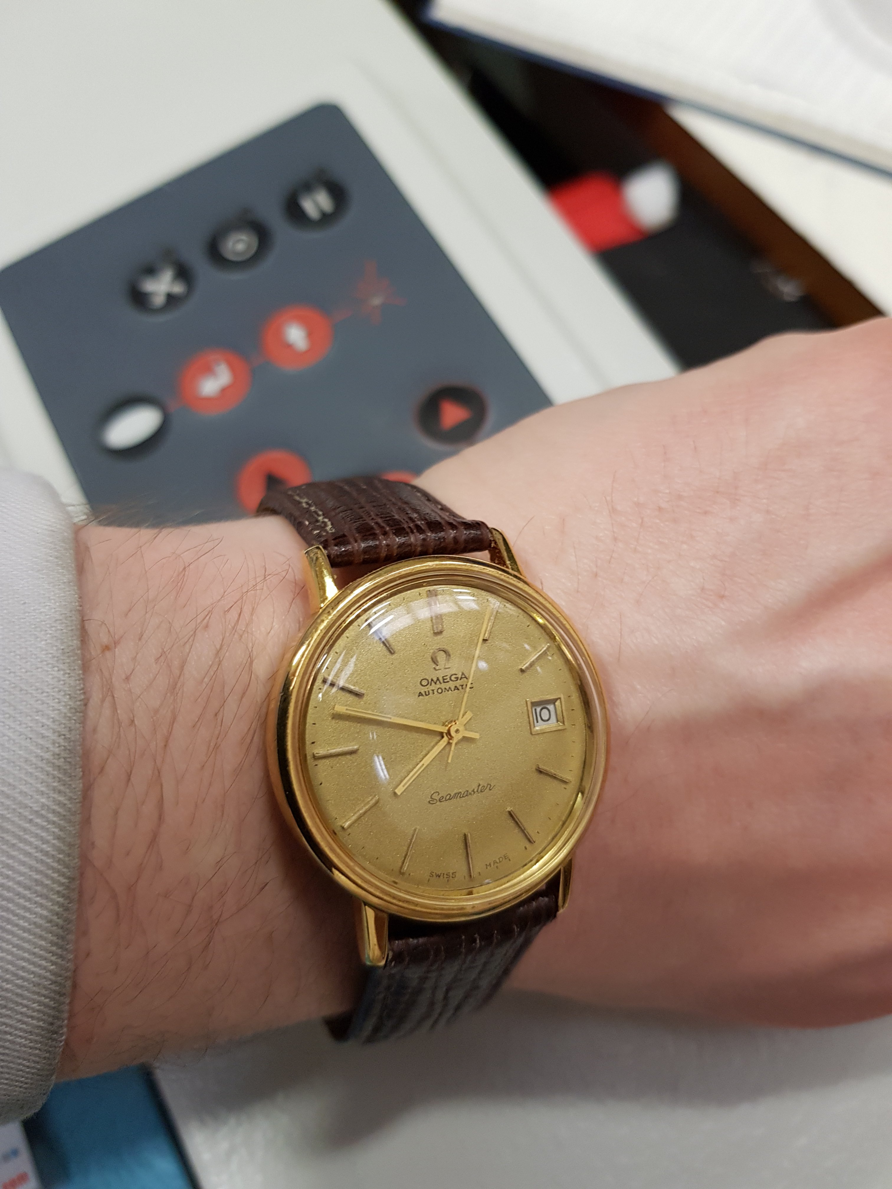

Even though this is a horrific redial it's worse the more you look, would you class this as an unauthentic Omega ? Say for instance I quite like the crown and colour and I fit the stem and it runs, and hoping the movement is original could you still look at this and call it an Omega Seamaster ?

Most likely it is authentic, but we haven't seen photos of the inside.

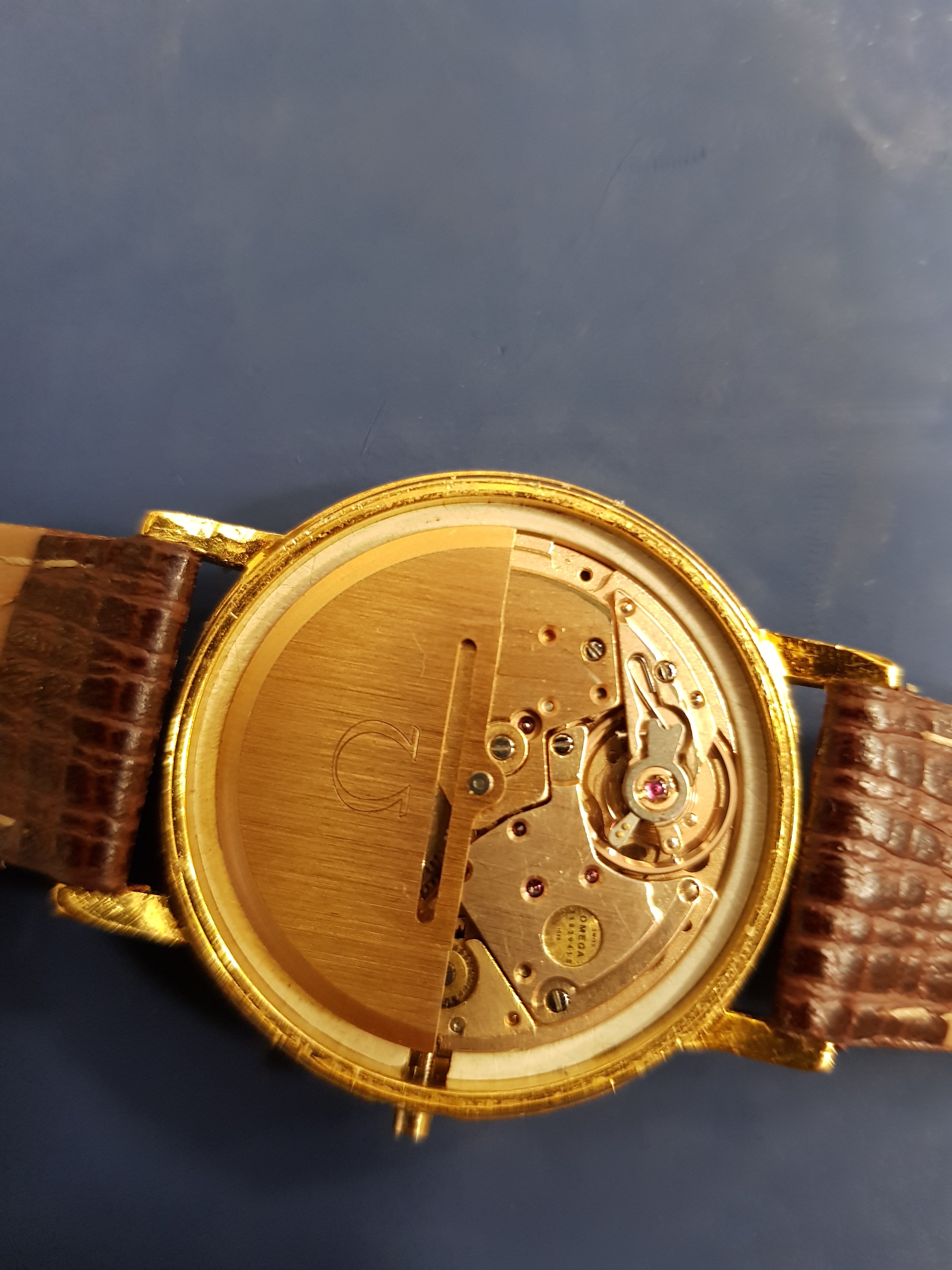

Hi All,

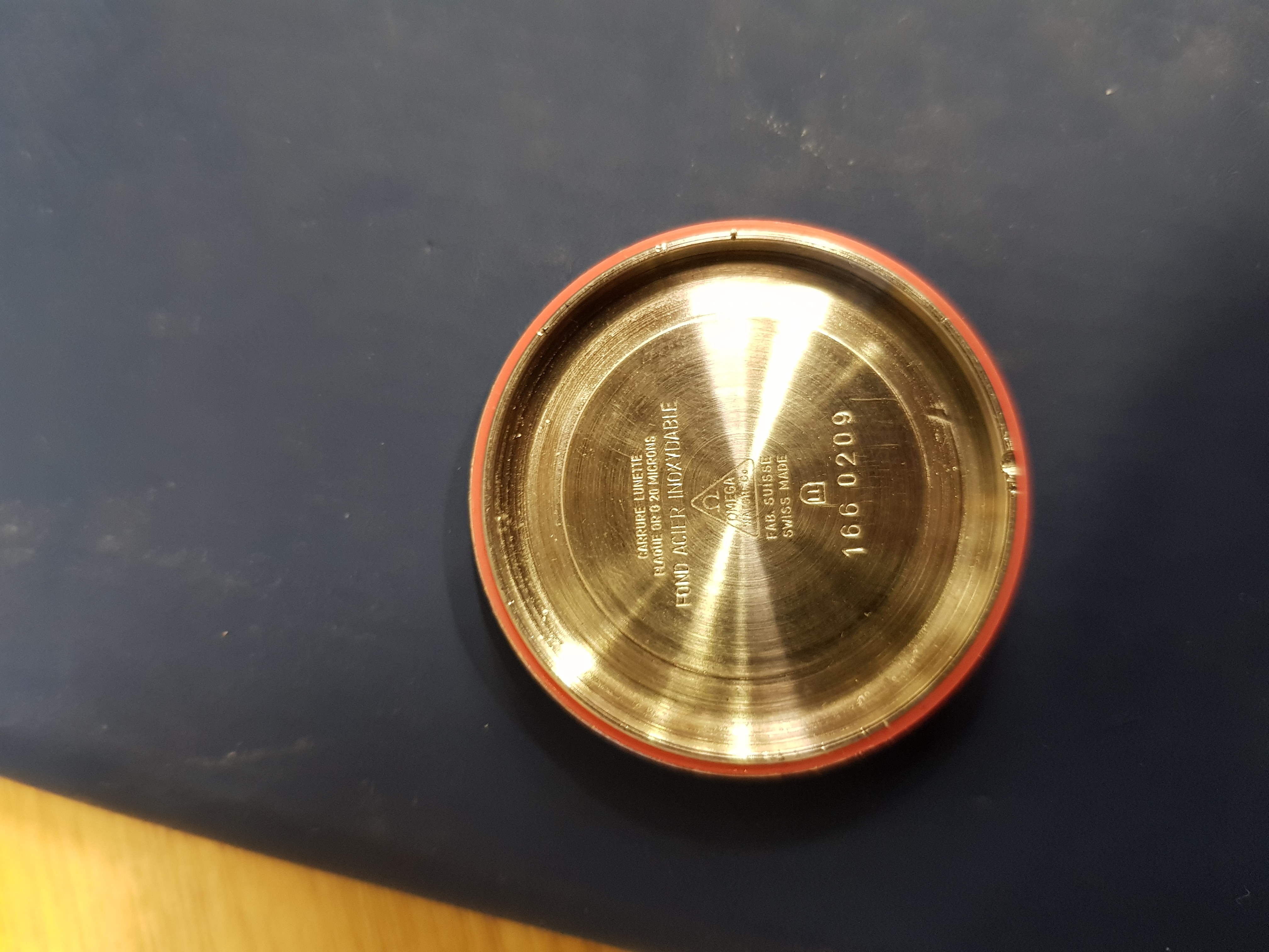

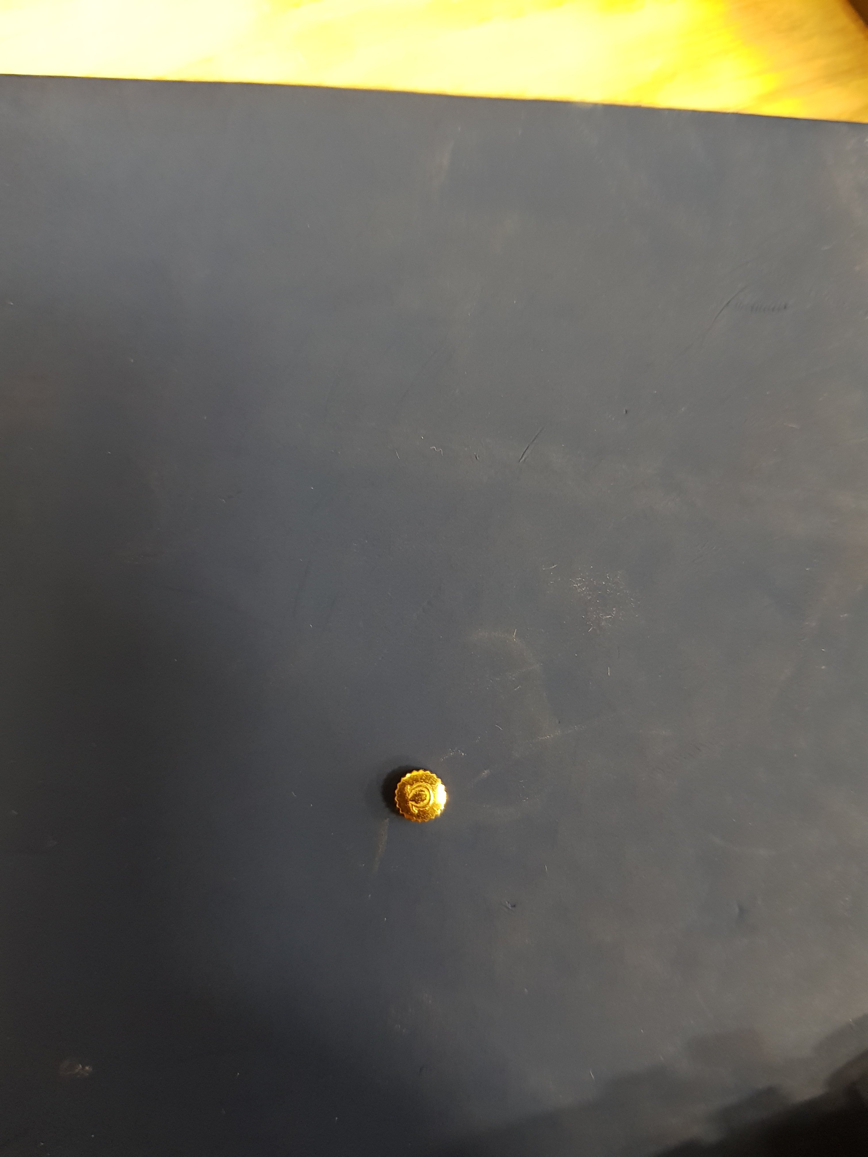

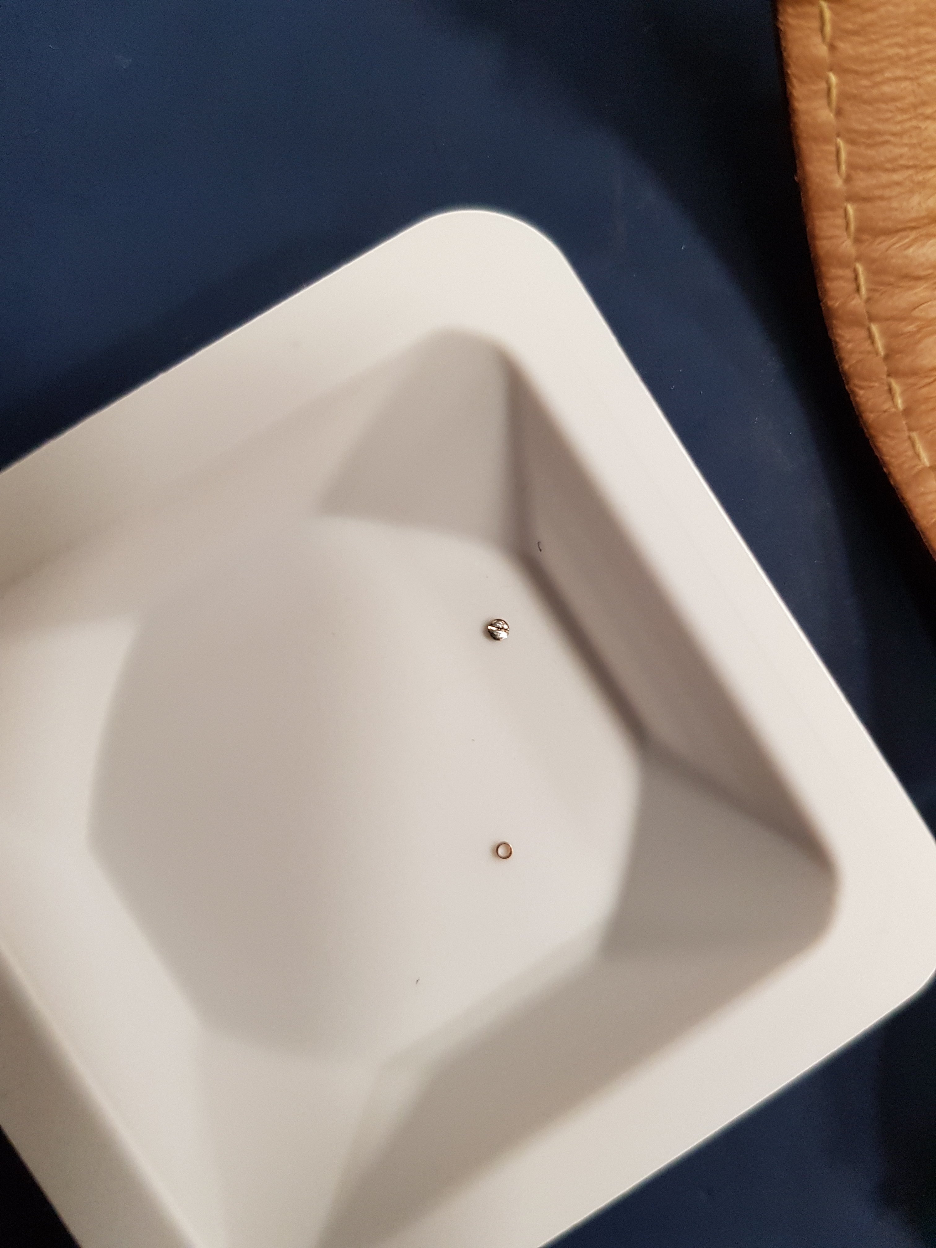

Watch arrived ! I took the back off to get a look at the mechanism and see the reference number etc, It is 166.0209 which doesn't match up at all with the dial. I believe it may be a bits-er made up of different Omegas over the years but to it's defence its does work. What are your opinions as I truly am a novice and only got into it a month ago. I think it is authentic just not original, and also does anyone know what the small copper spacer / washer and screw could be ? This was inside the case, so small I am scared to touch them so stuck them in a Petri dish at work haha. Crown / Stem is completely snapped but gear assembly looks okay. I am pleasantly surprised but maybe going with my heart a bit. I really appreciate everyone sharing their comments and knowledge. Proper community you have here !

Here is the listing on the watch case reference from Omega:
https://www.omegawatches.com/en-us/watch-omega-seamaster-omega-st-166-0209
The shape of your case looks correct. Your watch has only a date feature. So it probably has a cal 1010 or 1012 movement. It could be that there is a similar case reference where the only difference is day/date vs. date only. Times were so bad for Omega in the late 1970’s that they just used any parts that would fit together. So in other words, the case may be OK for this watch.
The dial was incorrectly redone. A very common occurance. Hopefully, you won’t need to double your investment to have a wearable watch. It will never be a collector’s item, but you didn’t pay collectors money for it either.
Good luck with the repair,
gatorcpa
Edit - I was able to track down the cal. 1010/1012 version of this watch:
https://www.omegawatches.com/en-us/watch-omega-seamaster-omega-md-166-0202
It is still possible that the casebacks for 166.0209 and 166.0202 were interchanged at the factory. We will never know for sure.

Would make for a good practice watch. It already seems to be a franken/fantasy. One could always part it piecemeal as the parts may be worth more than the whole.
The listed price does not seem to be too bad. But then I am attracted to basket cases. One can spend that much for a balance complete.
