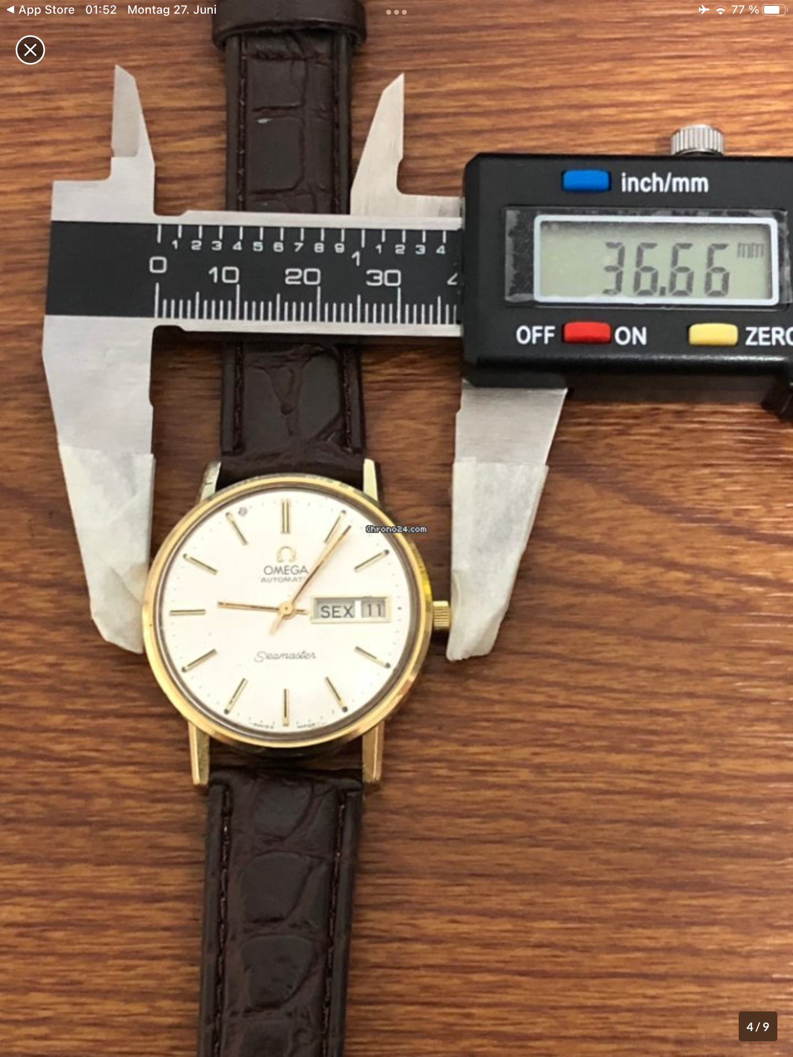

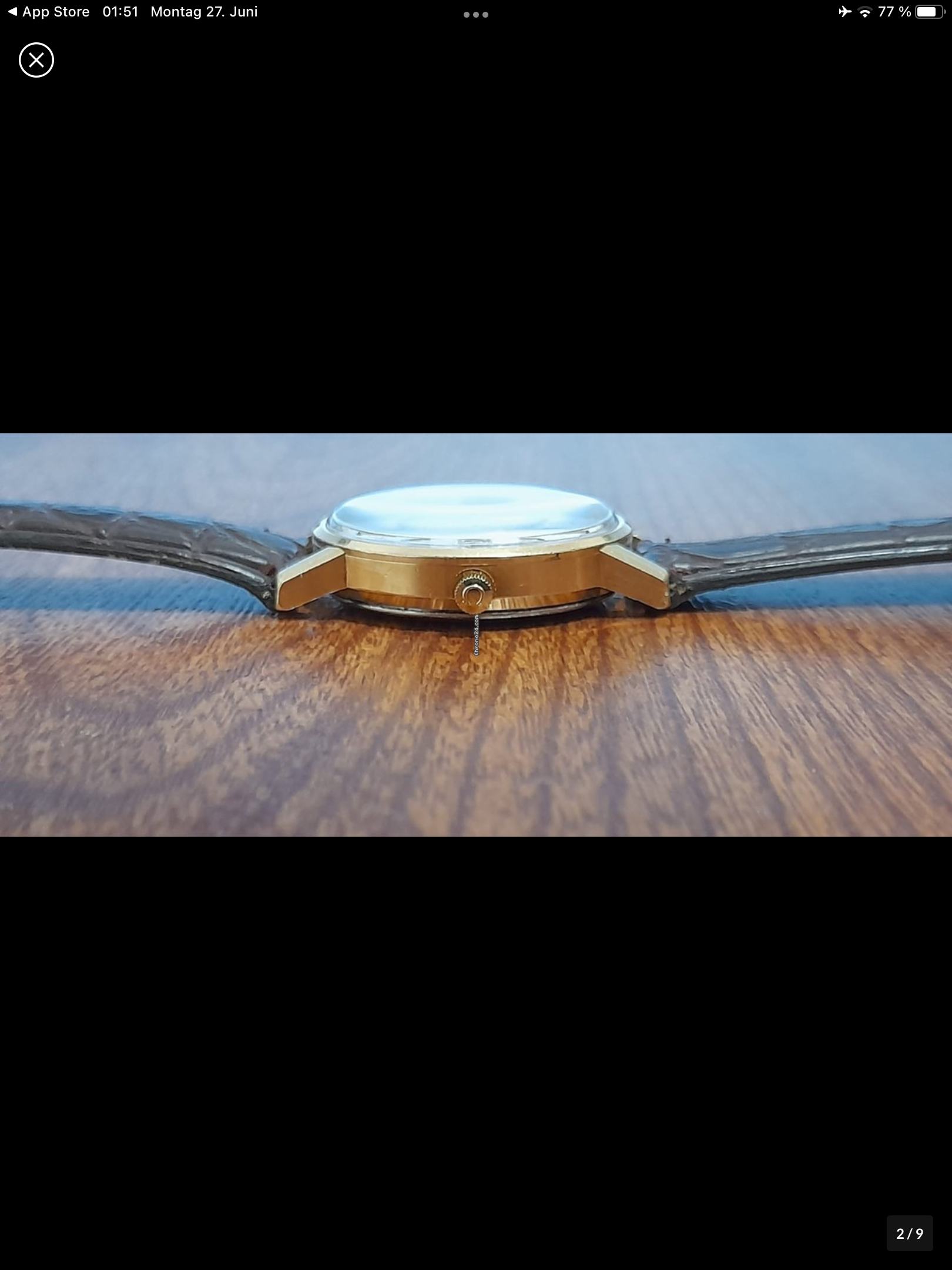

I am looking to get my first ever Omega (first ever luxury watch even) for my Graduation in a few weeks and found this Seamaster which really caught my eye because of the unique (Portuguese) Weekday feature.

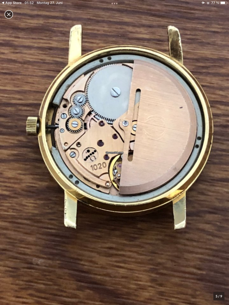

Being the newb I am I would love to hear your thoughts and opinions on this piece (is it legit? are the parts stock or did something get changed?) and any other things you would like to say about it!
Also, do you think 650€ is a fair price to pay for it?

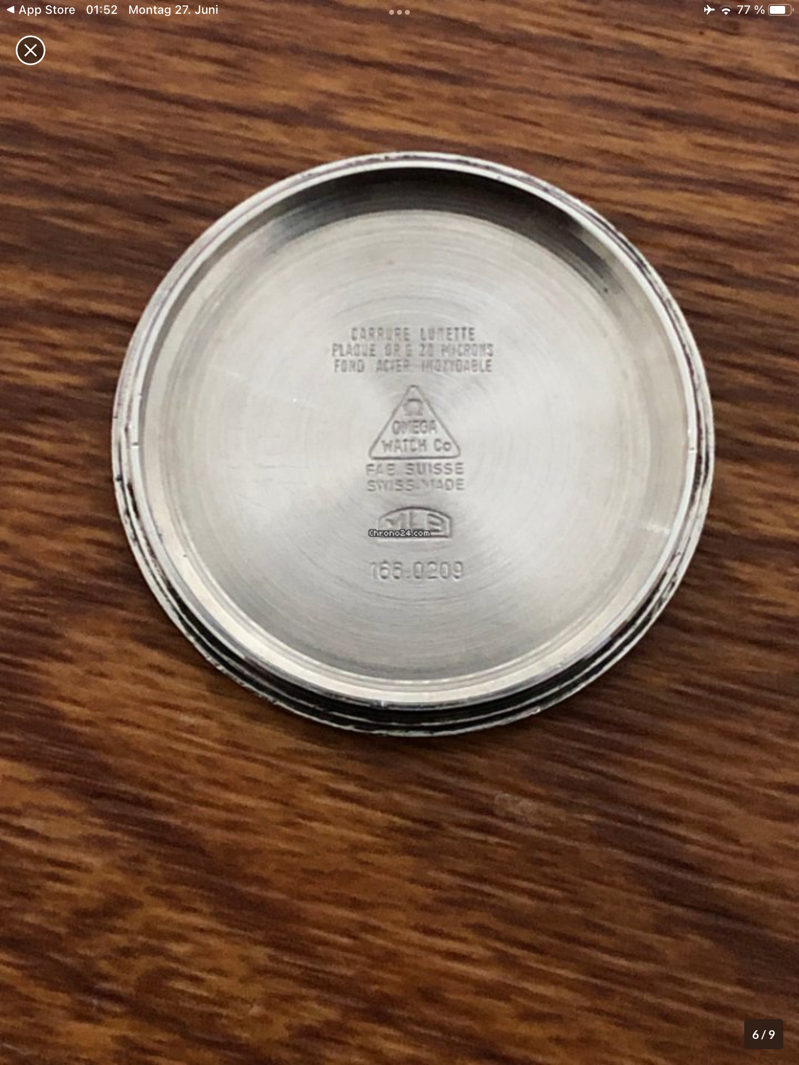

The seller says it’s a Ref. 166.0209; Cal. 1020

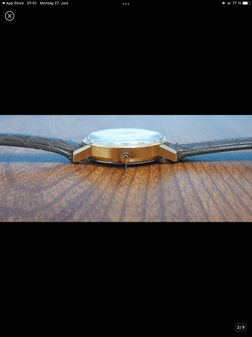

Upper left hand lug looks well bent. That would be enough to put me off.
18,840
39,184

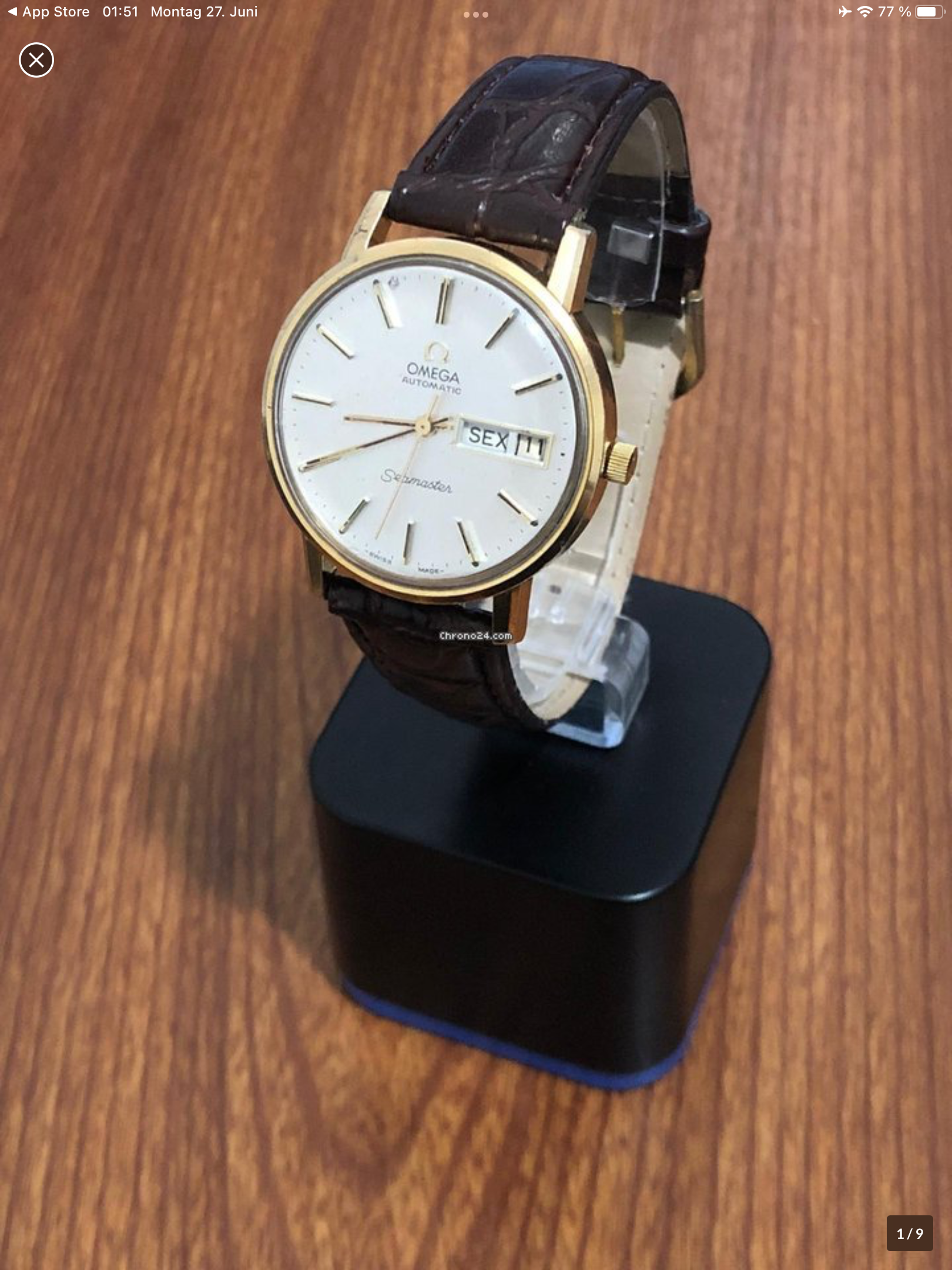

The spot on the dial at 11 would annoy me. Dial foot problem?
Stamp marks on lower left lug, do they still stamp watches in Portugal?
2,346
1,475
Case has too much damage and not the most popular of models
I would pass

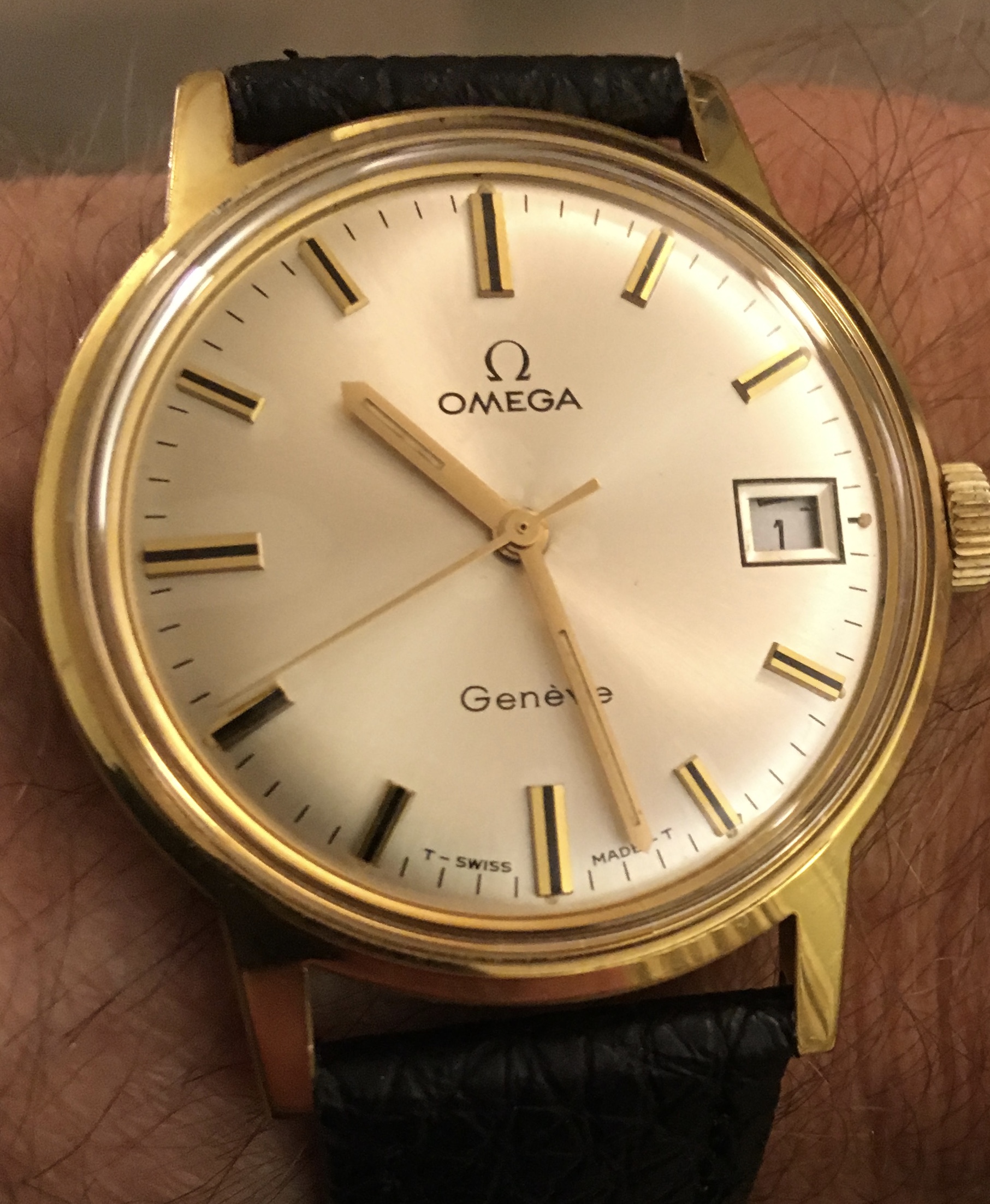

For example, last year I sold this one on eBay, with a 613 movement, for £350.
