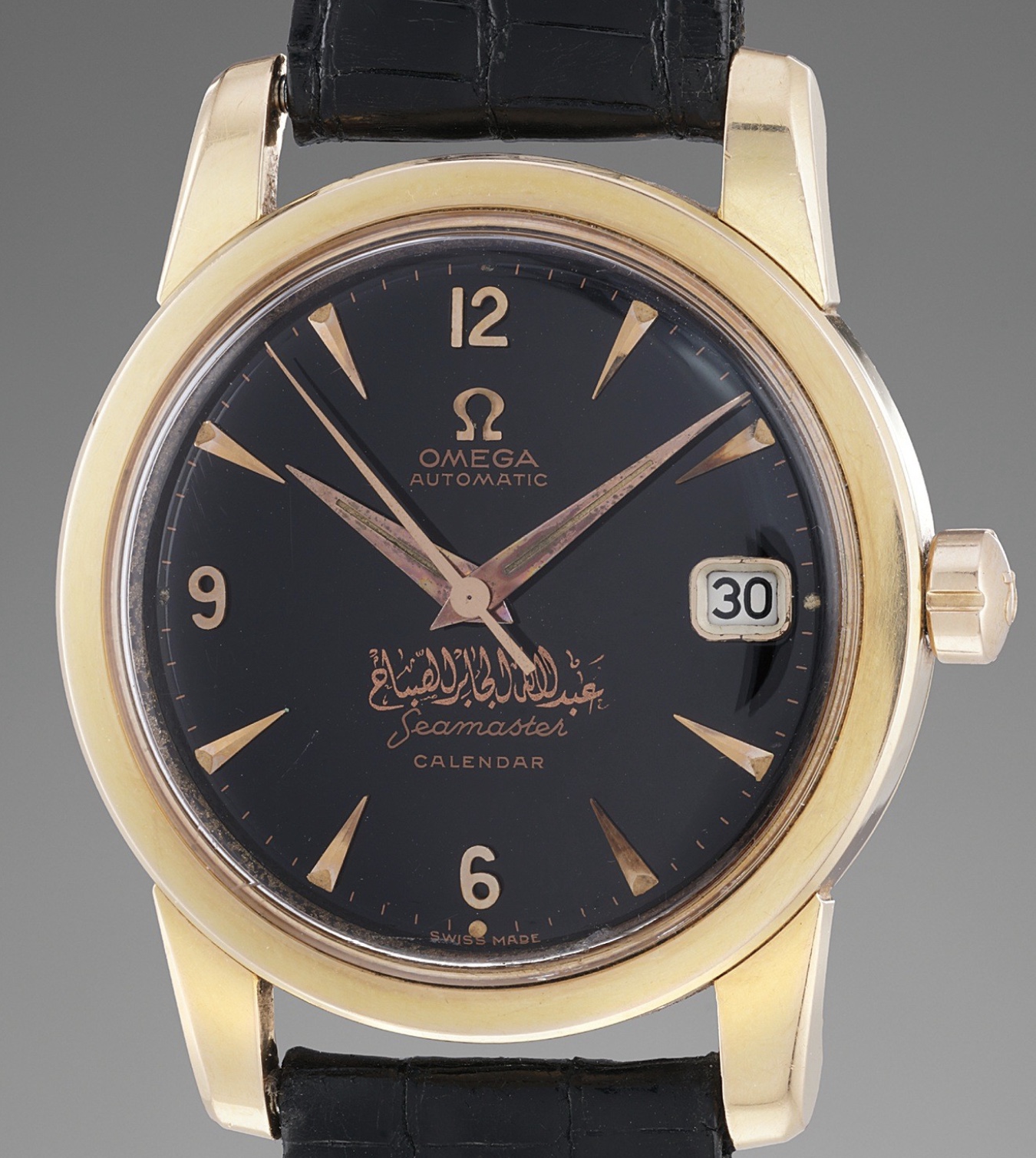

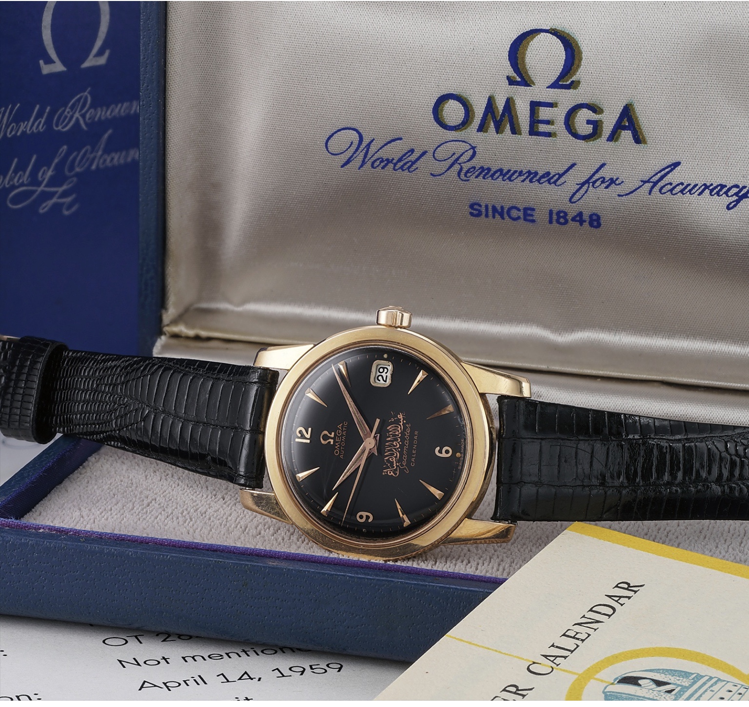

Thank you for the link Yousef
So that is a second watch with the Al Sabah signature and from the same period.
The Geneva Phillips watch is in exceptional (pretty much untouched) condition and in 18k solid pink gold.
I’m sure you know the region well enough to know that there are many Kuwaitis with very deep pockets (many of whom vacation in Switzerland each year) who wouldn’t think twice about spending $30,000 on a watch of this quality, simply to own it.
Unfortunately, your watch doesn’t quite compare to this beauty and so falls into the general collectors’ market rather than the super-rich market and so won’t command such a premium.
pics of the Phillips watch for OF reference
OT 2849
Cal 503 20 jewel
1958
Serial 16,560,xxx
sold for CHF28,750 May 2019
