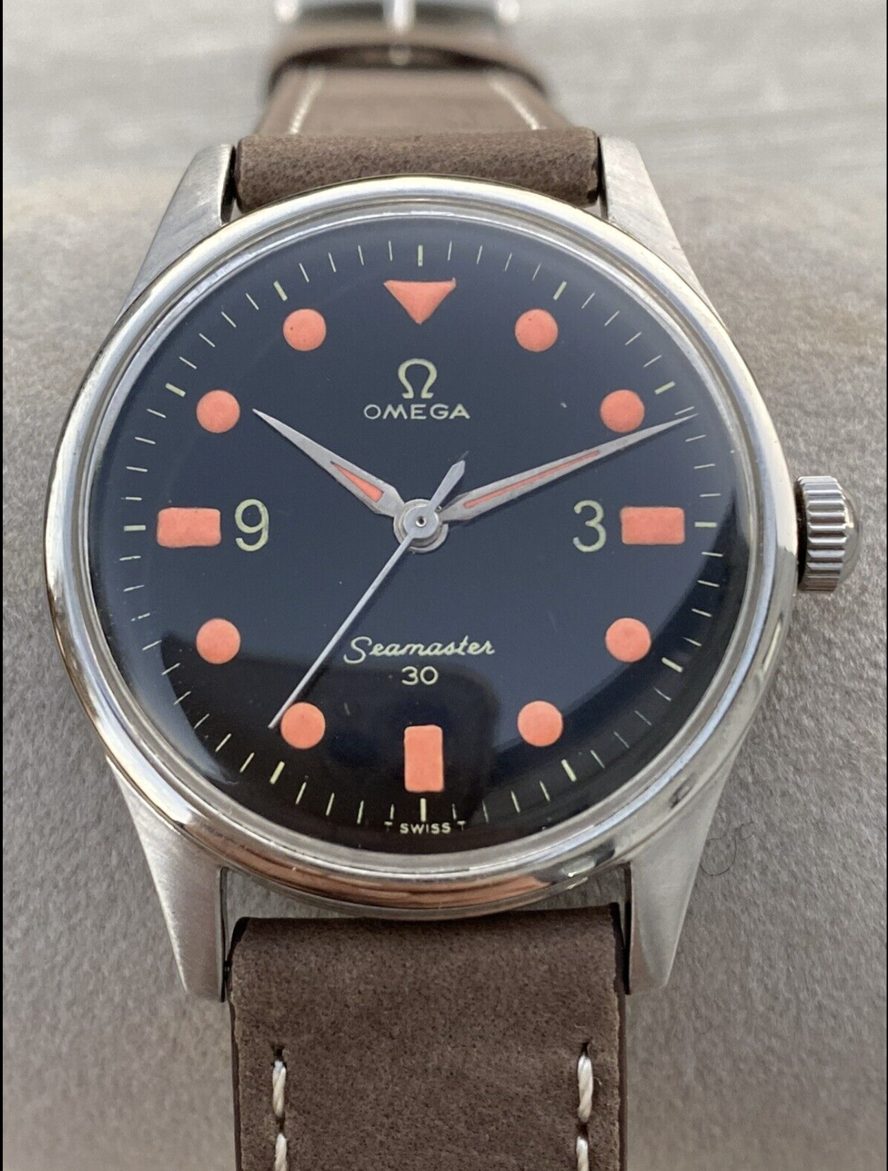

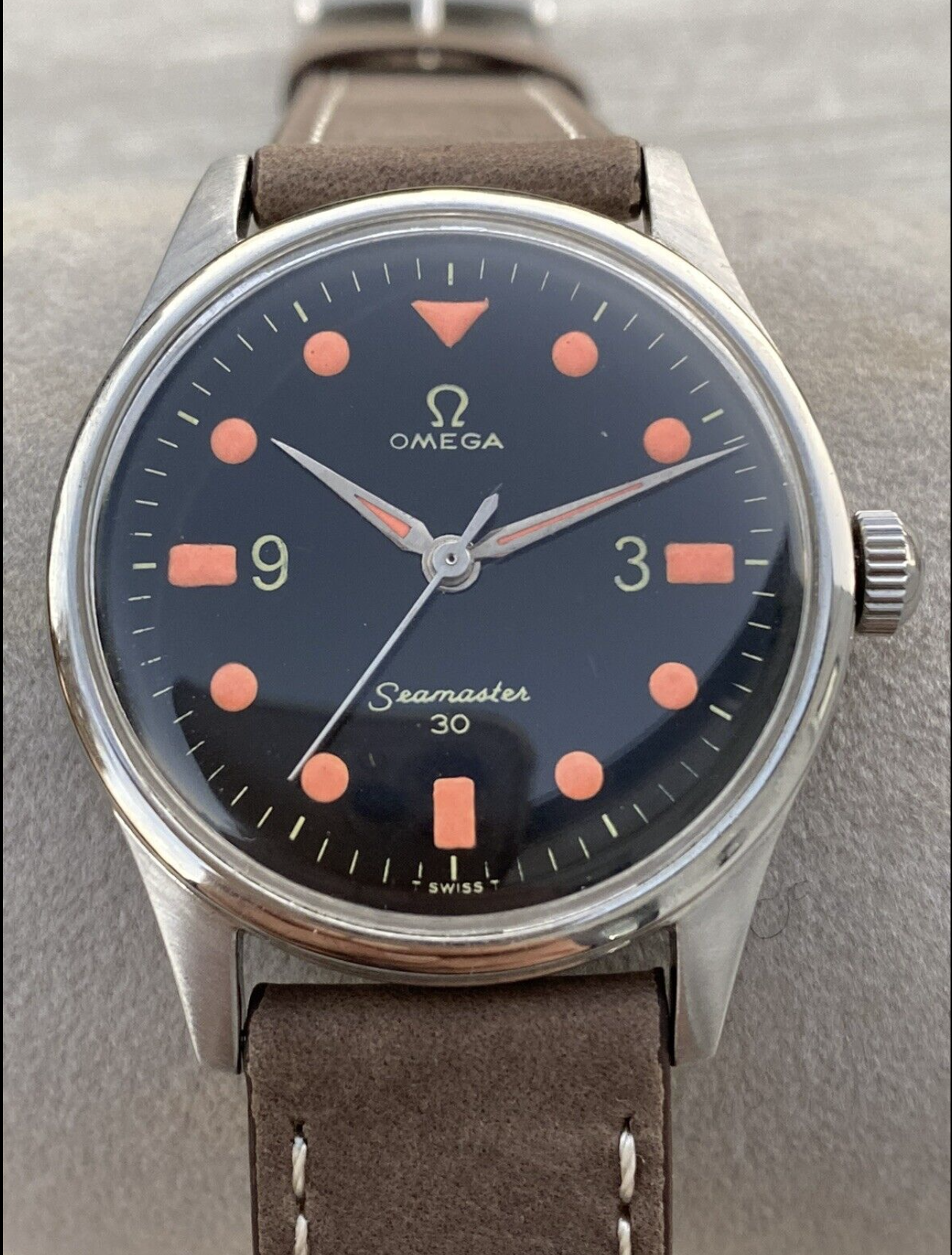

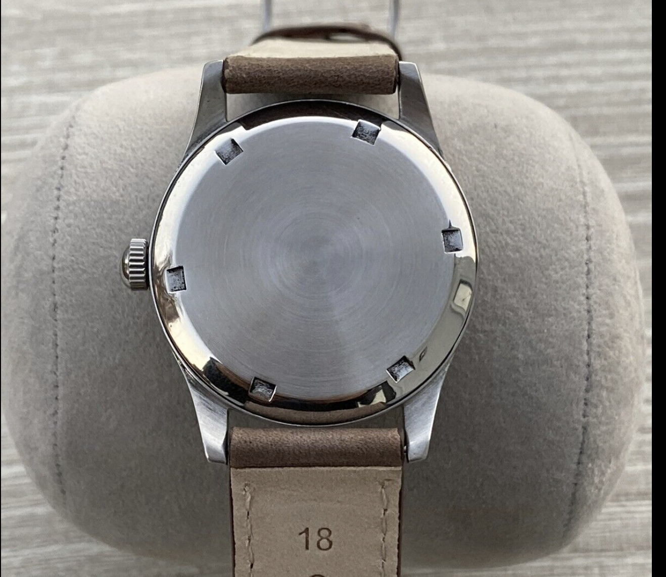

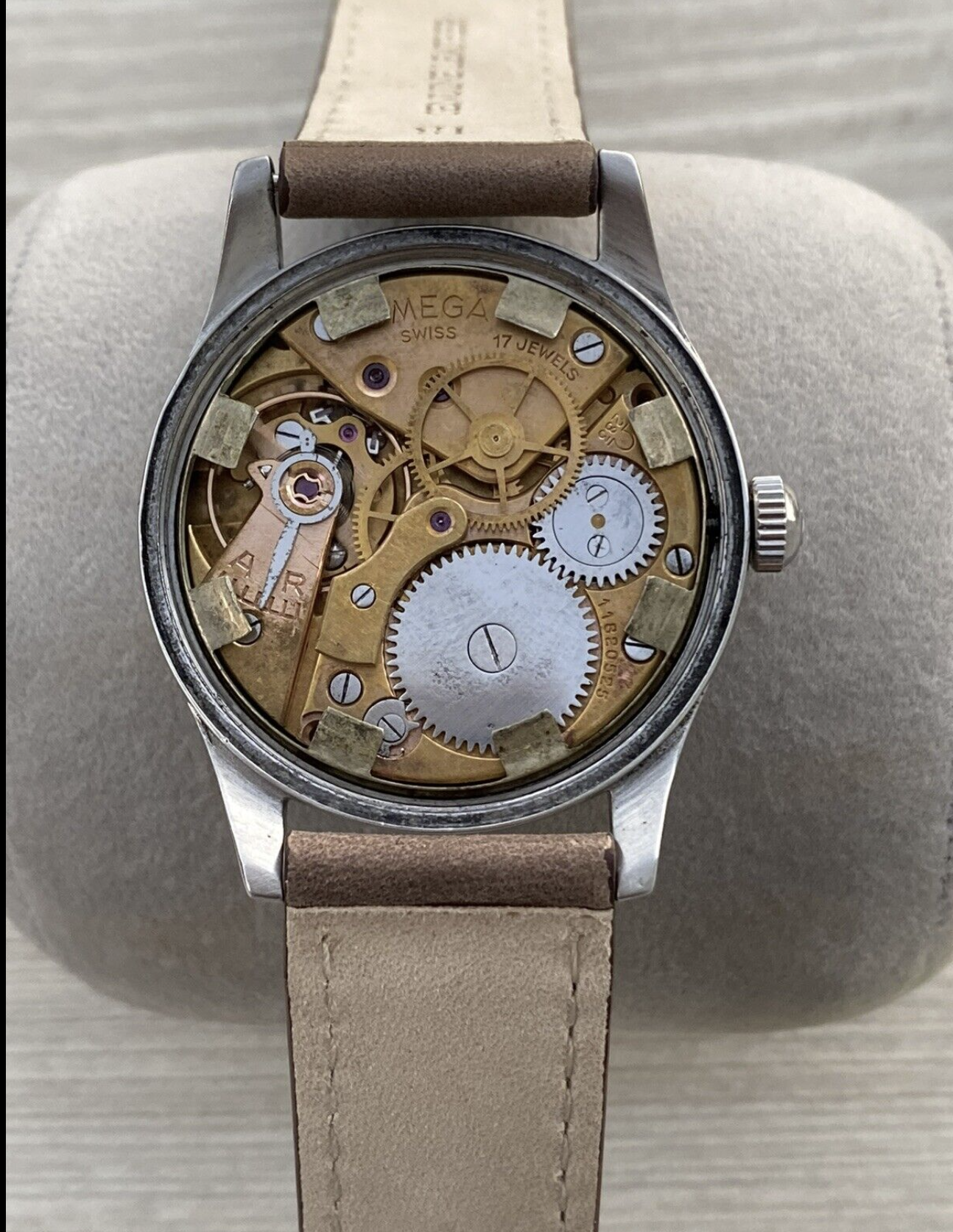

Hi everyone,
I'm a newbie in the Omega vintage world, so please excuse my mistakes in the case.
After some lurking on the forum and learning a lot from you on the endless various Seamasters out there, I've recently stumbled across this very funky one on eBay..and I have no clue about what I'm looking at!
The movement seems kind of ok to me, however, the lack of Seamonster on the case and the colors of the dials seem a bit strange to me. I have to admit that it looks cool, however, I'd like to happily move on if this watch is a complete Frankenstein.
Do you have any info to help me through?
Thanks a lot everyone!

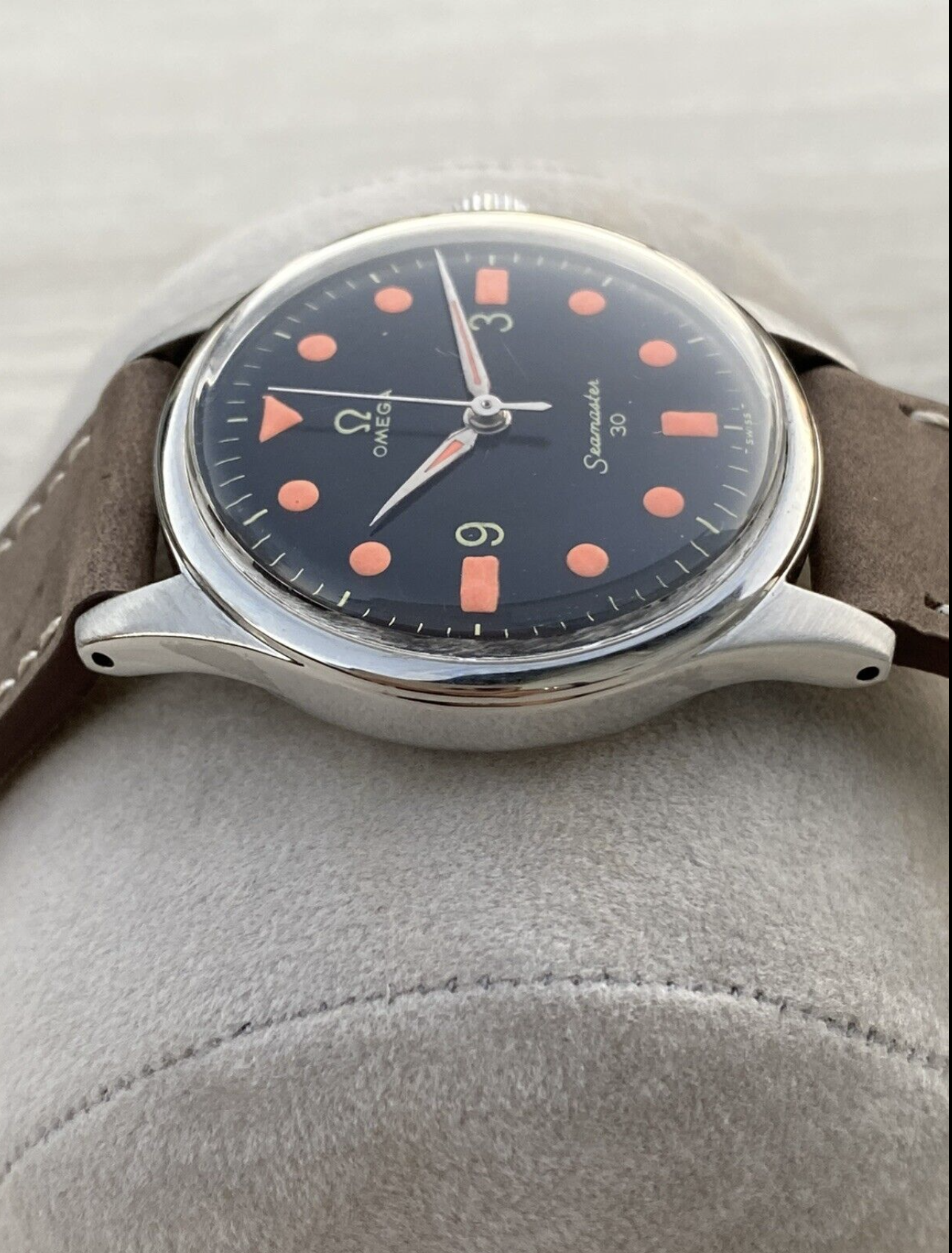

It’s an utter piece of shit. The movement is tired and has lost half its plating, the case is severely over polished and the dial is an utter fantasy that someone crudely painted very recently.
I’ll bet this was a heavily worn and water damaged watch (with a silver dial) that someone has tarted up for a quick profit.

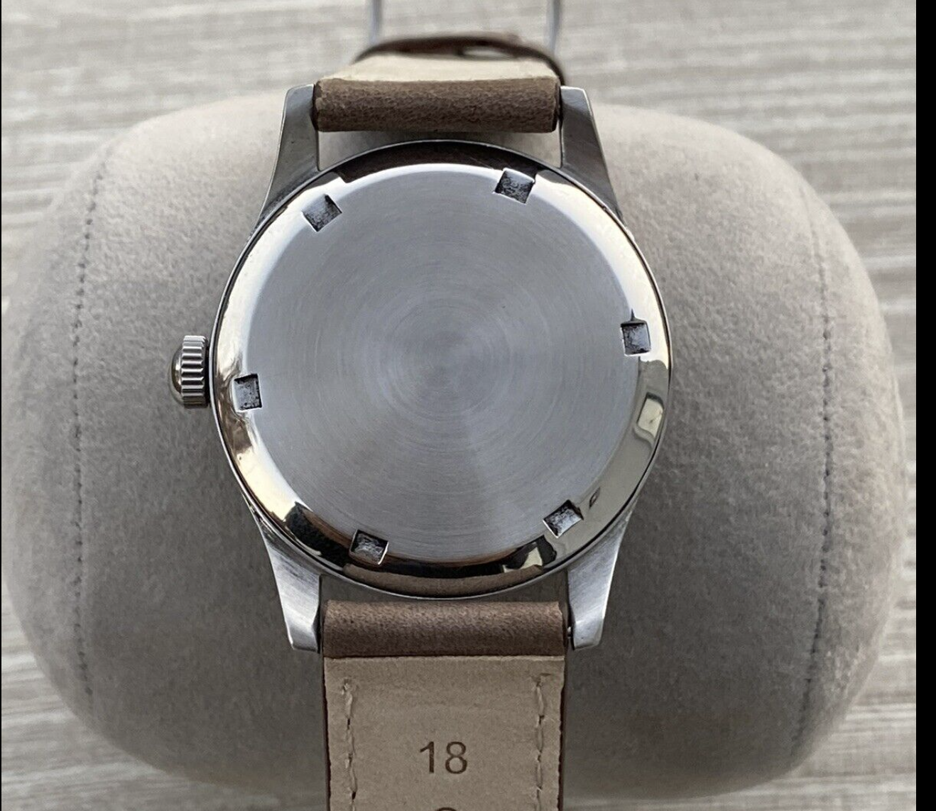

So a franken watch with a very bad painted dial..but i suspect that the case also is not Omega. The screw of the movement which hold in the case are missing so i do not think it fit well..
