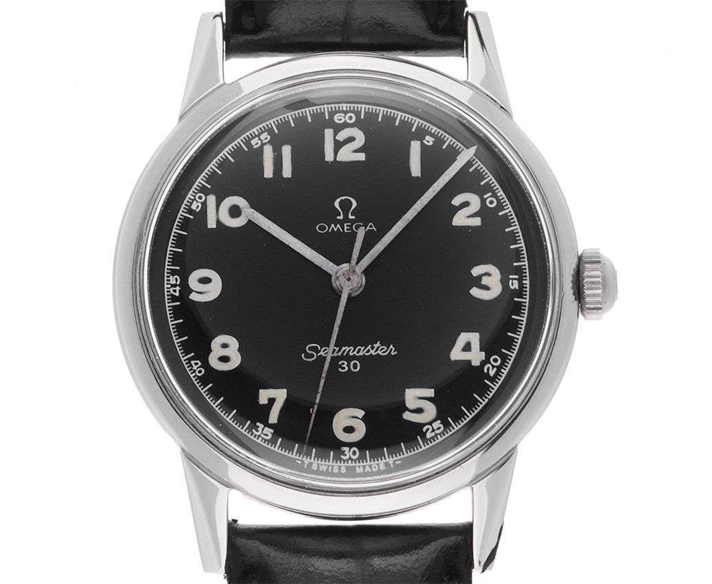

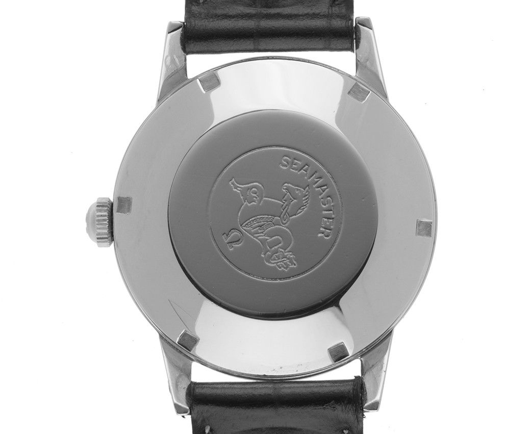

    I've just started taking a serious interest in watch collecting and one of the watches I decided I wanted to find is a Calibre 286 Seamaster 30 with sweeping seconds on a black dial with arabic numerals. I found one listed on eBay by a jewellers based in Stuttgart, which looks almost exactly like what I am after (I might prefer one with a "railway track" for the seconds register, but that's a very minor quibble).
    However, I am a bit nervous about committing myself - it's a bit outside my budget, but I could stretch to it if I am convinced it is worth it. I have contacted the jewellers who told me that they bought a complete watch collection from an old gentleman and that this formed part of it. It was apparently serviced in January of this year and, as far as they are aware, the dial is original and not refinished in any way.
    It is the dial in particular that is causing me some concerns. On the magnified pictures it would appear that the lume has not been applied to match exactly the underlying numerals - as if someone had painted outside the lines... This seems strange to me if the dial has not been refinished, but I just don't know enough. Can anyone help? I attach all the pictures provided by the seller on his website.

    The dial is a horrible redial, with a fantasy layout Omega never made on a Seamaster 30.
    The case have been heavily polished.
    Hands are wrong.
    I would not buy it.

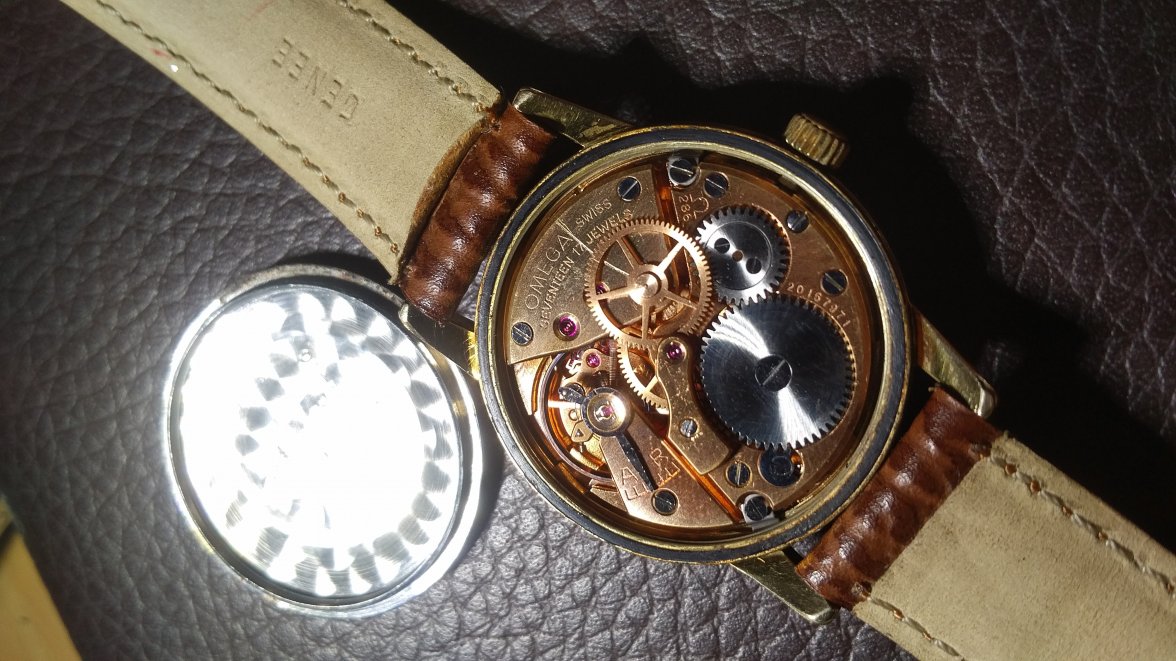

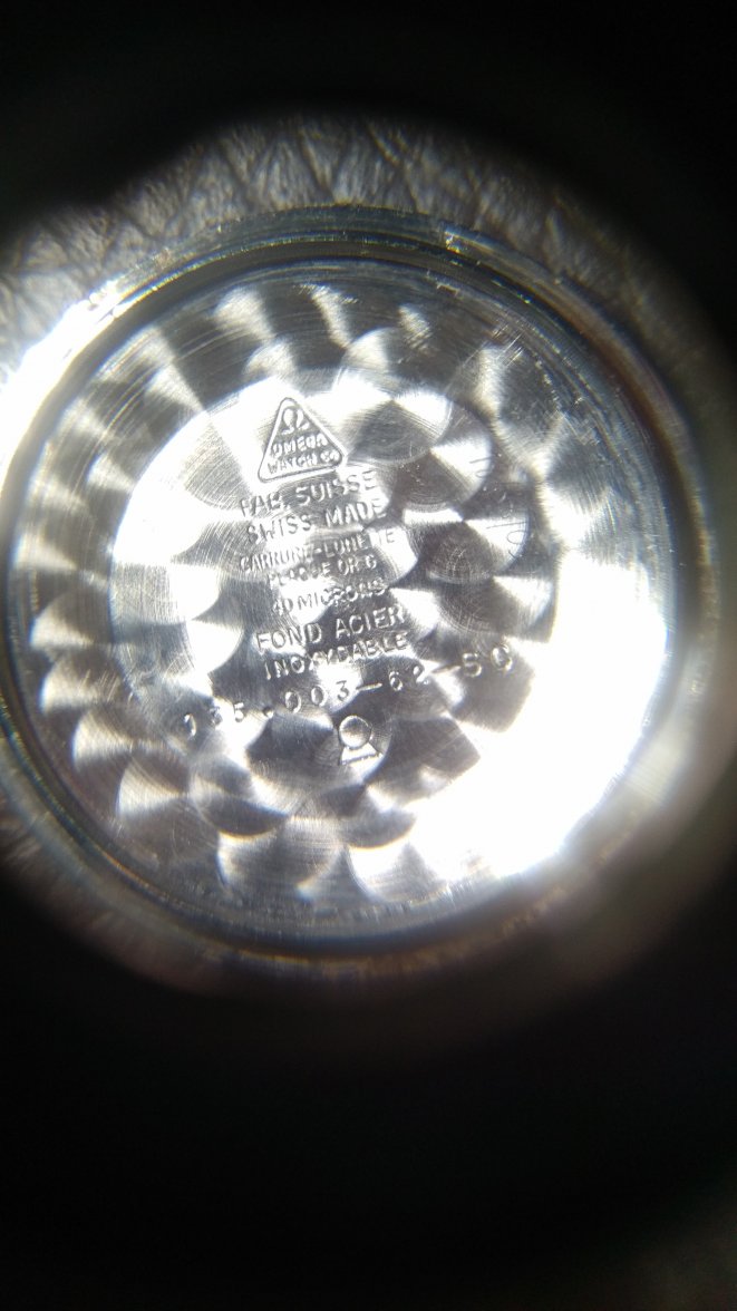

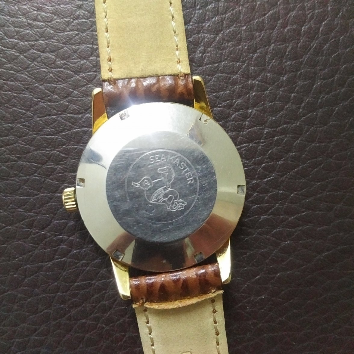

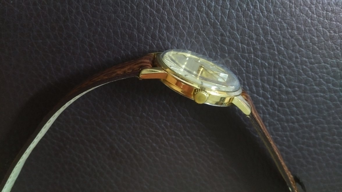

    I have just got a Seamaster 30 with cal. 286 and serial number 20167971 into custody. I noticed in the picture FRaulier posted that the movement bears no serial number, would that be normal?
    The crown of my watch isn't signed! That doesn't seem right, does it?
    Thank you all for sharing great knowledge and wonderful photos.
    IMG_20181108_2248538.jpg IMG_20181108_2309548.jpg IMG_20181108_2303329.jpg IMG_20181108_2306165.jpg IMG_20181108_2253035.jpg
  16. hoipolloi Vintage Omega Connoisseur Nov 8, 2018
    3,516
    5,795
    The serial number was erased by Photoshop I guess.
    Your crown should have omega logo on it to be correct for that period.
  17. thecollector Nov 11, 2018
    10
    I took a closer, longer, and more thorough look at the crown and thought I saw the remnant of the logo itself. It seemingly wore off; which might sound consistent with what the previous owner told me of intensive daily wearing over...50 years! :O
