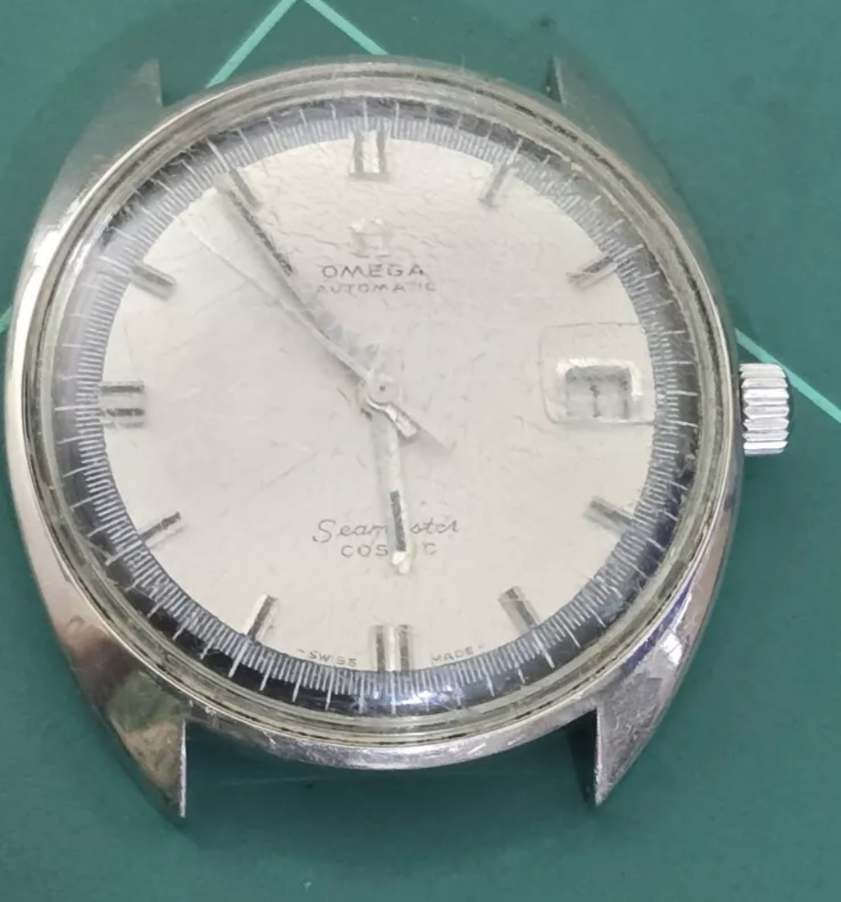

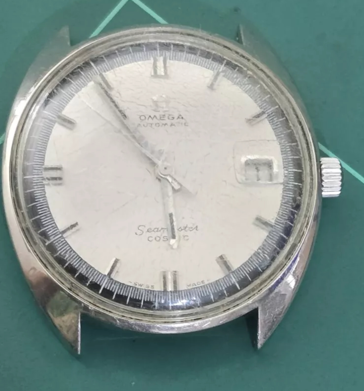

Surfing the eBay, I came across a vintage seamaster cosmic. The crystal is completely nackered and will need replacement.

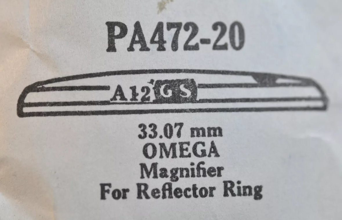

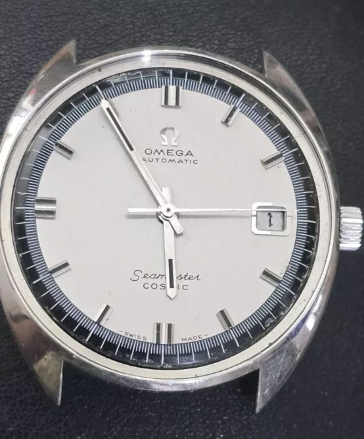

The crystal is 32.95mm. I found a replacement but it’s $435aud and it’s for the day date version (longer cyclops).
My question is this, I found a crystal that an omega replacement but not genuine omega. It has a date cyclops and is 33.07mm. Is the extra that much where it won’t fit or is that close enough to fit well?
This crystal is $34aud so significant price difference.
I work on watches as a hobby so installing it is easy, it’s more about the extra 0.12mm.

This is an armoured crystal - these crystals need to be of correct size otherwise you might fail...
2,781
4,707
It's hard to say without the watch in front of me to measure precisely, and even then I'd need to see the crystal It might not just be a matter of diameter, the maybe a different profile that may bring you unstuck.
But my guess ( and it is a guess ) is that with a little very careful fettling you might get away with it.
It comes down to rolling the dice.....do you feel lucky?
If it was me I'd take a punt on it. but I'm a fitter and turner so I'm used to making things fit with precision. I don't know your skill level, so I can't really say how doable it is for you.
Of course there maybe someone who knows for sure and if so don't listen to me, go with their advice.

Those front-loaders have a rebate cut in the tension ring that that dial seats into. GS may have cut this correctly for your watch. If not, it’s sometimes possible to swap the tension rings between crystals.
435aud for an acrylic crystal seems obscene to me. I’m sure you can find cheaper than that.
Bear in mind also that Omega outsourced parts like crystals, so it will still have been made by one of the larger fabricators like Sternkreuz….. or maybe even GS!

Yeah the price for a genuine is crazy. Most of the other models of omega I could see crystals for at 1/8 the price and all genuine articles. Just with the cosmic it was not.

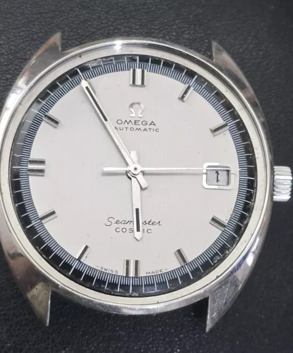

The other issue with the genuine one is that it had a cyclops for a day/date dial.

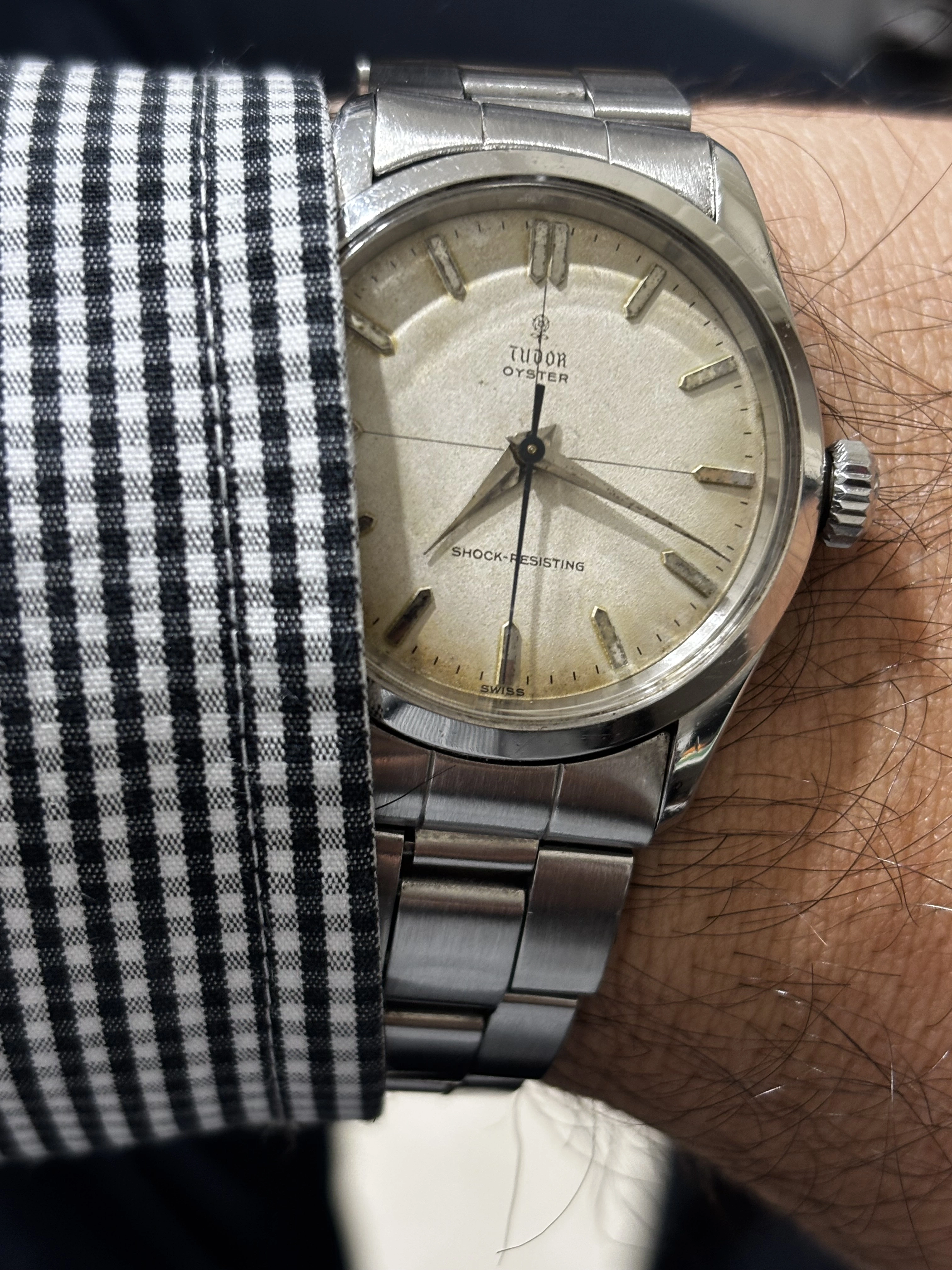

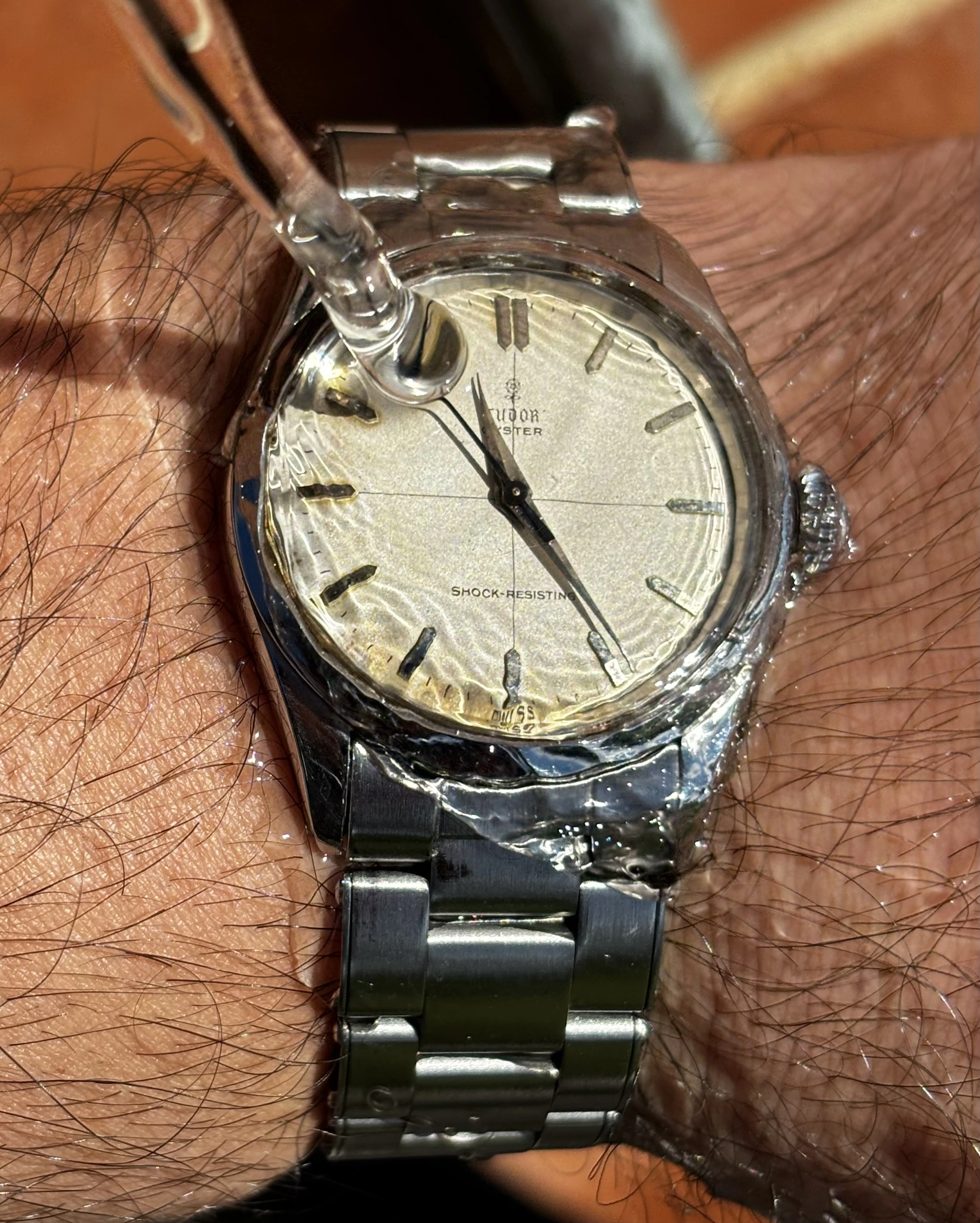

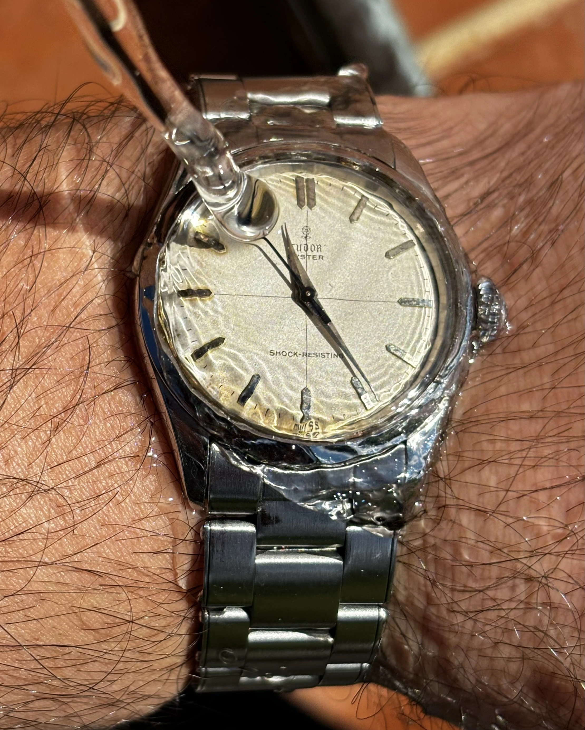

Good advice, I have numerous vintage pieces from a variety of brands. I pressure test them but only consider them splash proof regardless of the results.
The only vintage piece I have really pushed to have meet its original rating was my vintage Tudor 7934. It still retains its 100m rating.

They is a way you might be able to swing it if it seems pretty close, though it may not be without problems further up the track, given that the original crystal looks to be a poly type in the photo, and a lot of plastics have a fair bit of thermal expansion, you could perhaps chill it to shrink it down a smidgen and whilst that is chilling you heat the watch a little, I don't mean bake it, no you would just put it in the sun, and you wouldn't want to chill the crystal to much either as you don't want to break it because it is too brittle, you would also want to make sure there is low humidity as you will only trap moisture in the watch as it condensates on the crystal, you would need to move quickly before the temperature differential equalises, but not use any force, if it just doesn't all drop into place, stop and try the process again.
What are those aforementioned further problems I hear you ask? Well the potential condensation problem that I've already mentioned is one and the other one is once the temperature has equalised it wont be possible to get a temperature differential of the components you want to separate, so it may well be difficult to pull apart again if and when you might need to in the future, which is why you don't want to apply any force during assembly, it just wants to drop in to place.
This is just me throwing up possible solutions, if anyone knows better for sure then please say so, I won't be offended if you can poke holes in my theory. Indeed please do so.
