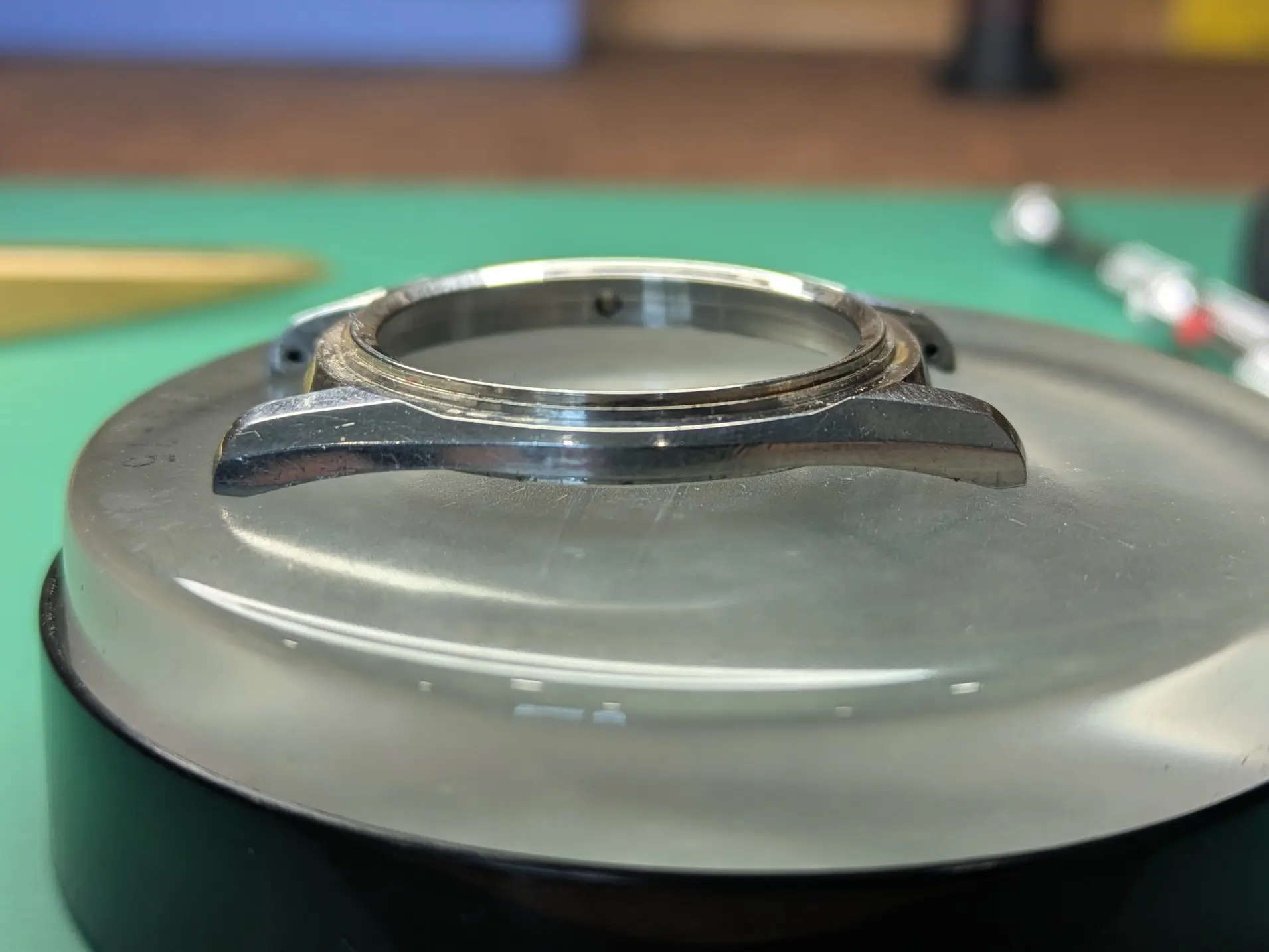

SO I have a broken crystal on this old Movado. Here is a picture of the case:
The crystal goes over the 'faux' tension ring there, and there is a bezel that clamps it into place. The OD of the crystal is 31.6mm, which fits 'nicely' in the bezel (with just a touch of clamping?).
When it arrived to me, the crystal was broken off, but I could see that there was a ring of plastic clamped between the 'faux' tension ring and the crystal.
However, here's my problem: Every crystal I have/have bought that is 31.6mm OD, doesn't match the ID (which is 30.2mm). It is either too thick (for non-tension ring crystals) or too thin (tension ring crystals tend to have a much thinner wall).
SO, what do I do? My only thought is to take one with too thick of a wall, and put it in my lathe to turn it down. Has anyone done something like that? What sort of work-holding could I use for something like that? I have a sizable lathe/can make something, I just can't envision what it would be.
Alternatively, anyone know where I can buy watch crystals by both ID AND OD?

You may need a crystal for a "reflector ring", rather than a tension ring. In these the ring is not involved in keeping the crystal in place, but just provides the ring.
IS there a good way to try other than ordering a handful? I've actually ordered quite a few of the others already trying to see if i could get lucky D:
Measure the ID of what you have if you still can, then ask people who are selling if they can match it.

Had a similar problem, and if you do not get lucky with the ordered crystals, here is what I did.
Take a piece of aluminum or hard plastic, say 40-50 mm in diameter.
Turn a "hole" in the center about 2-3 times deeper than the thickness of the crystal and with the same diameter as the crystal's outer diameter. Drill a small hole in the middle to be able to press the crystal out of the jig when you're done.
Then take some Rodico, warm it up so it gets sticky, and fill the middle of your newly made jig with it and press the crystal in place. The Rodico acts both as glue and helps stabilize the crystal's shape in the jig. If you have a tailstock, use it to press the crystal in place so it is absolutely square.
Take light cuts and you should be good! 馃榾
Thanks! That's about what I needed to hear 馃榿 I might give that a try!
