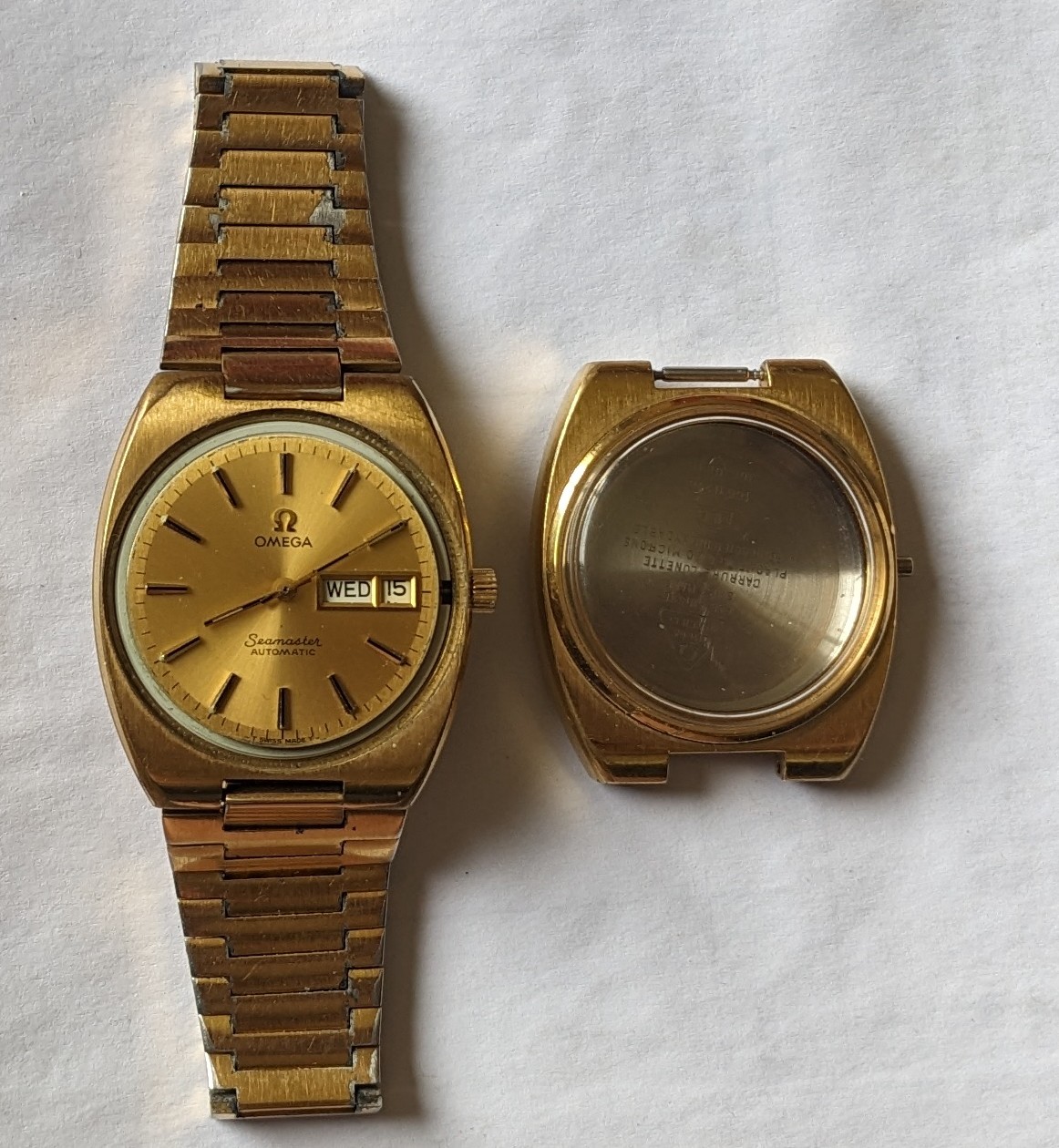

Posts 3 Likes 0 Tojo ·Mar 19, 2023 Did Omega produce this particular watch with hour and minute hands only, as in the photo uploaded? Advice greatly appreciated
Posts 15,997 Likes 48,116 Canuck ·Mar 19, 2023 That watch is missing the centre sweep seconds hand. Possibly a broken sweep pinion owing to the watch (left) not having the bezel or crystal.
Posts 3 Likes 0 Tojo ·Mar 19, 2023 Much appreciated, thank you, guess I'll just have to source one like I was able to with the spare body case, bezel and crystal. Thank you
Posts 3 Likes 0 Tojo ·Mar 19, 2023 Canuck That watch is missing the centre sweep seconds hand. Possibly a broken sweep pinion owing to the watch (left) not having the bezel or crystal. Thank you, which calibre is this likely to be for ordering spare sweeping hand purposes, Thank you
Posts 24,837 Likes 55,257 Dan S ·Mar 19, 2023 Tojo Thank you, which calibre is this likely to be for ordering spare sweeping hand purposes, Thank you The caliber will be engraved clearly on a bridge in the movement. No need to guess
Posts 15,997 Likes 48,116 Canuck ·Mar 19, 2023 Tojo Thank you, which calibre is this likely to be for ordering spare sweeping hand purposes, Thank you Planning to do the job yourself? Let us know how THAT goes! 😗
Posts 1,626 Likes 6,078 bardamu ·Mar 19, 2023 Tojo Thank you, which calibre is this likely to be for ordering spare sweeping hand purposes, Thank you Most likely a 1020.
