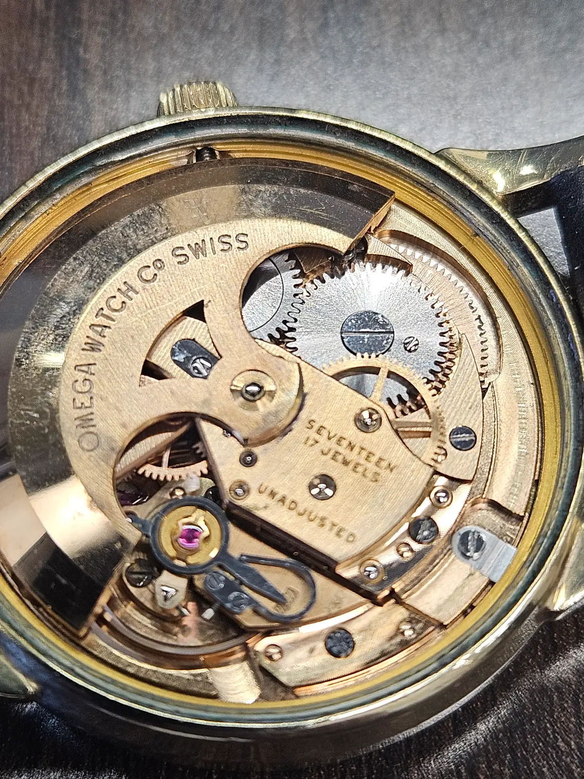

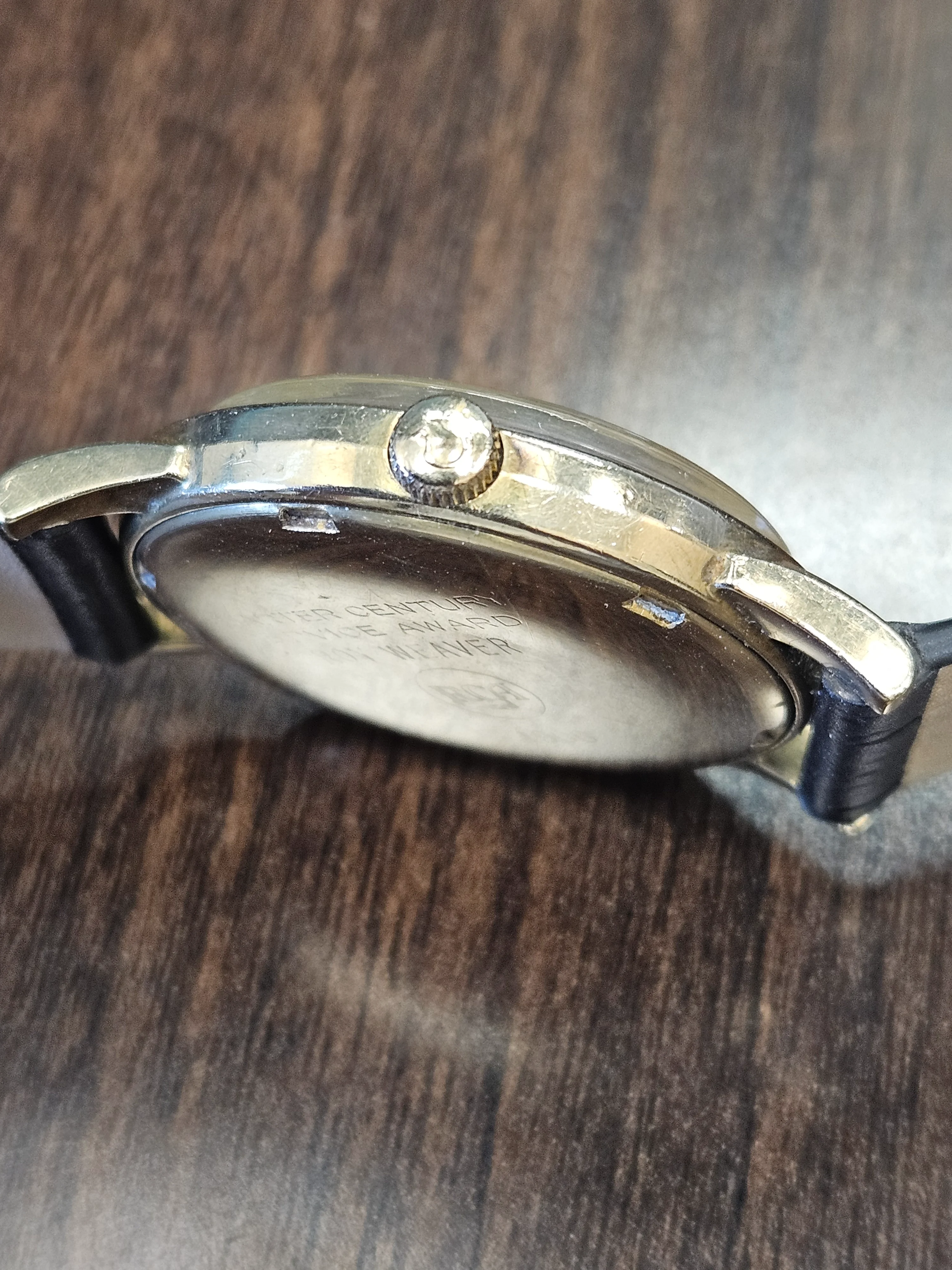

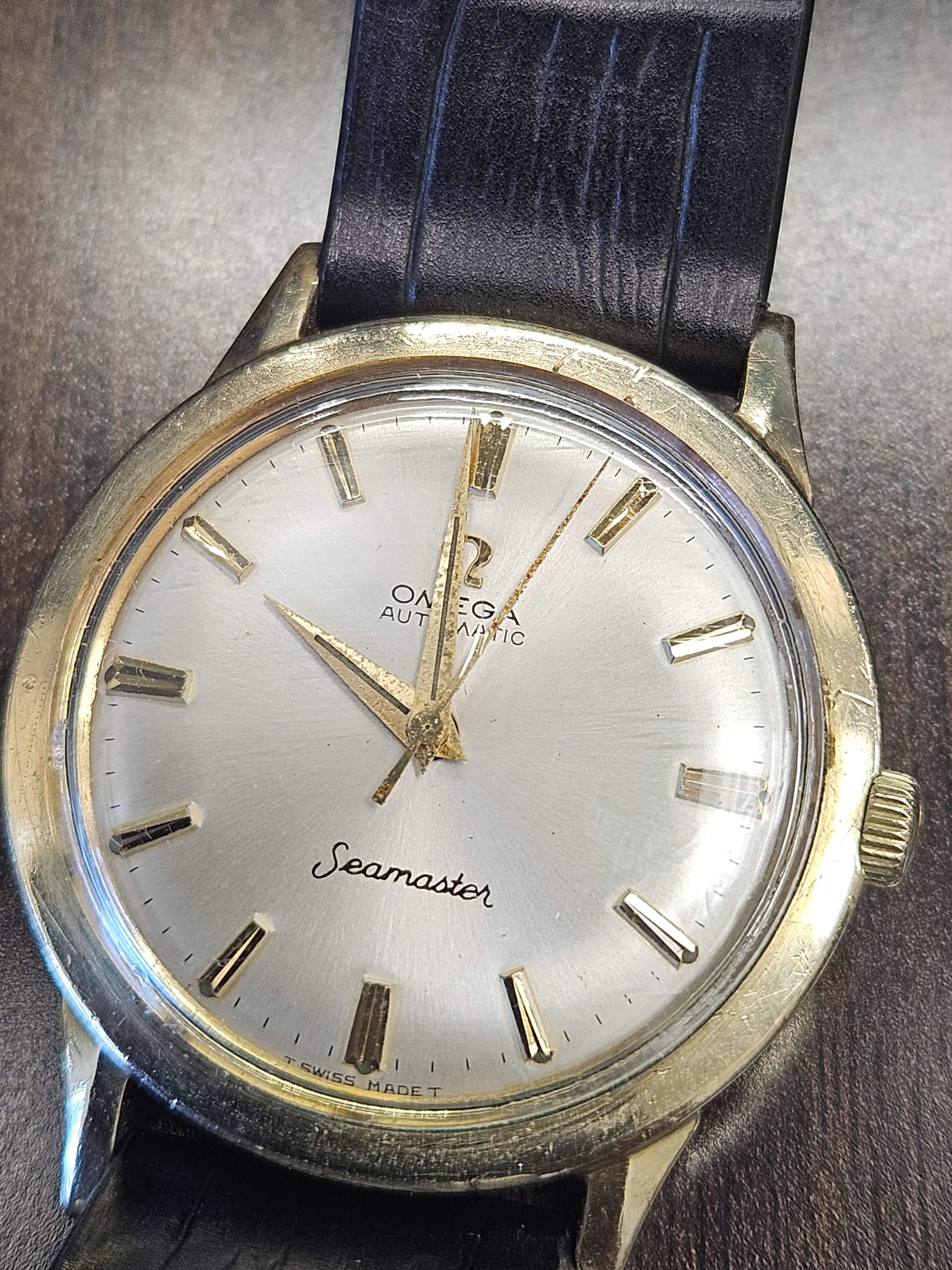

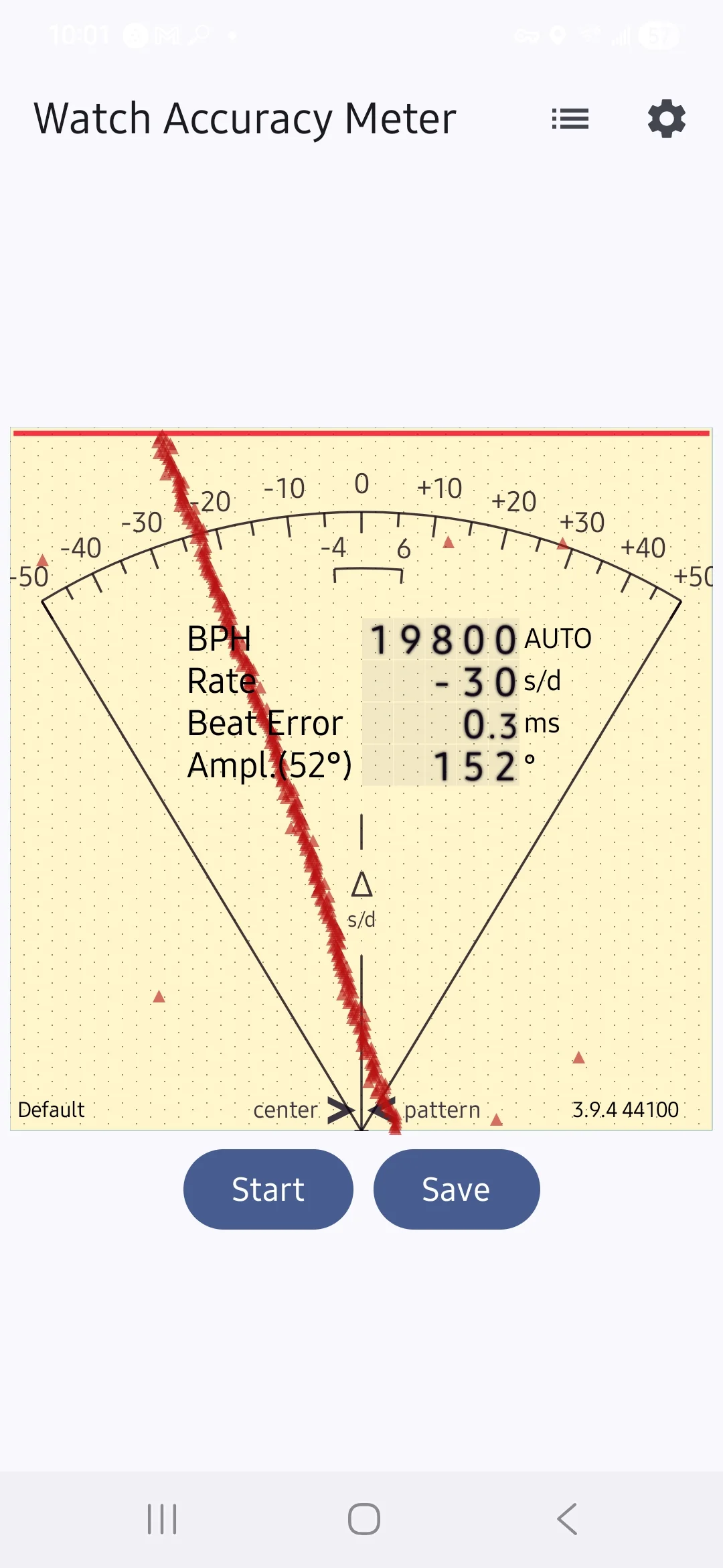

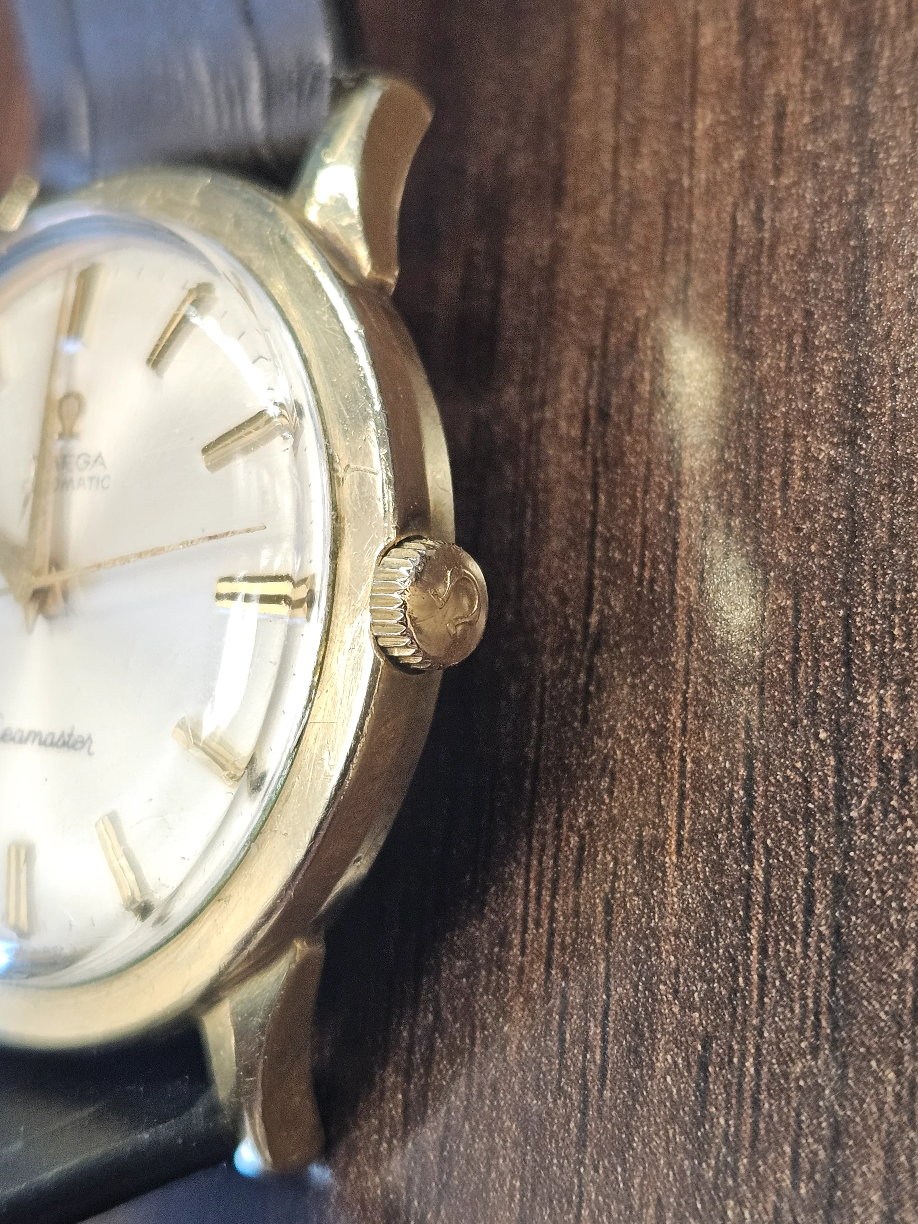

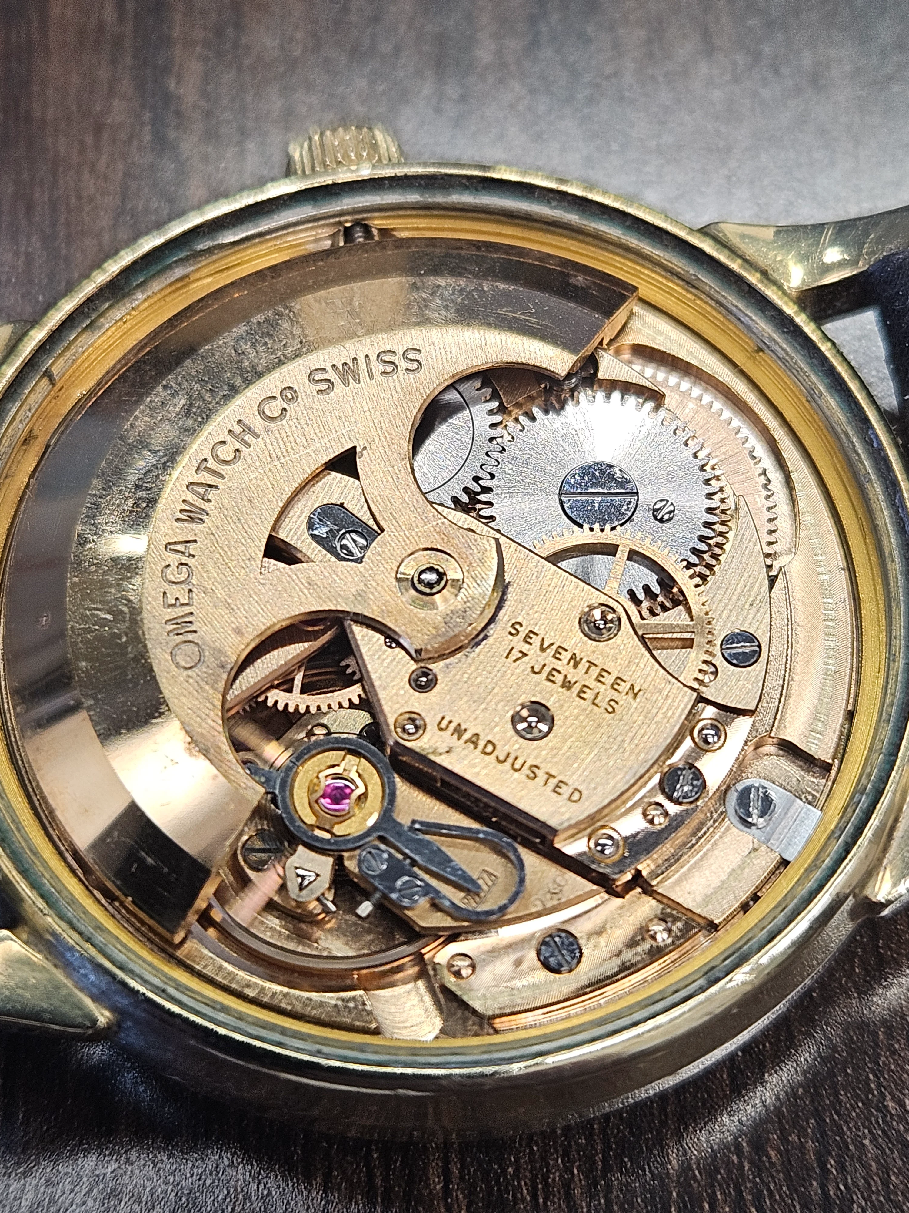

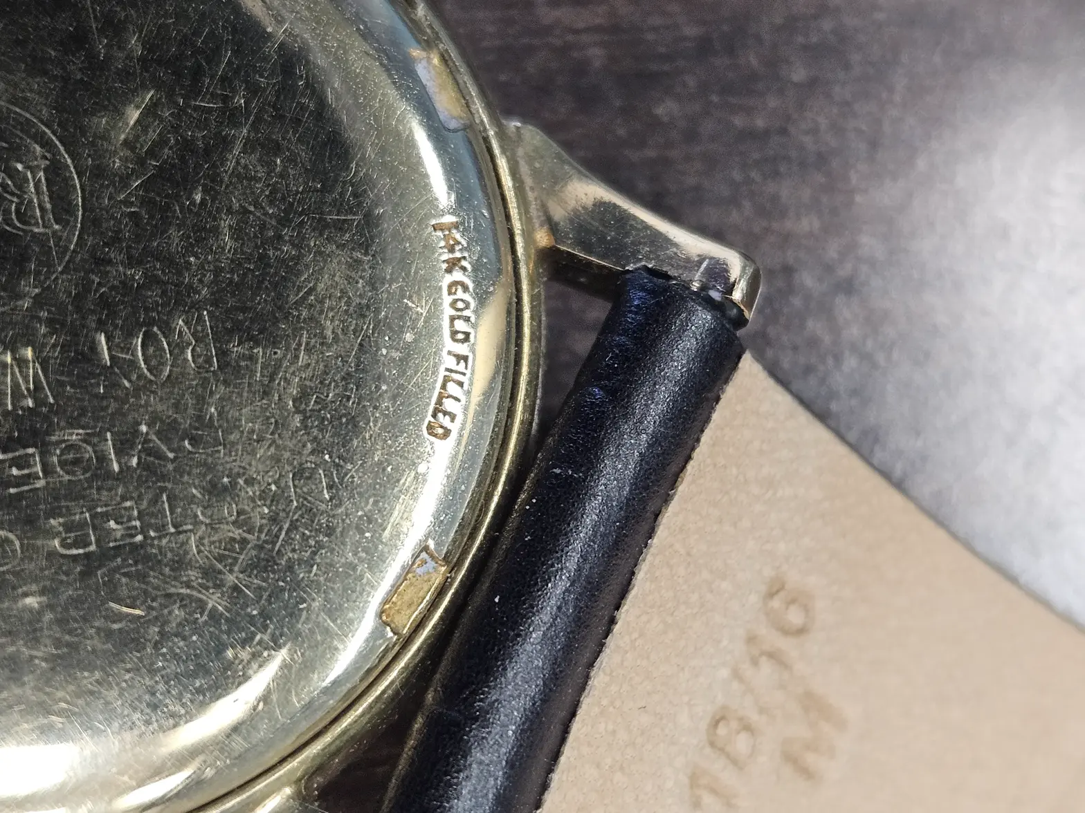

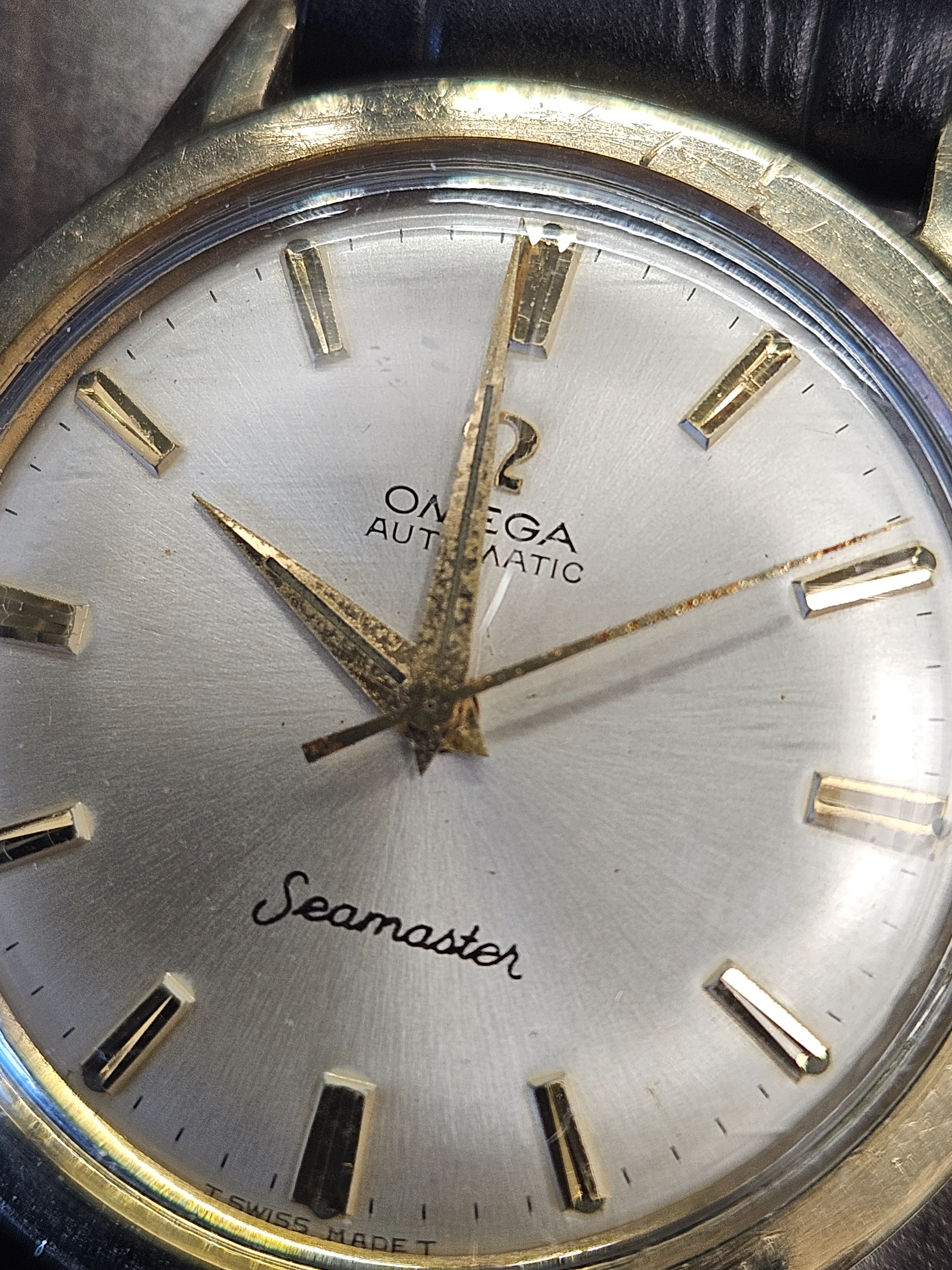

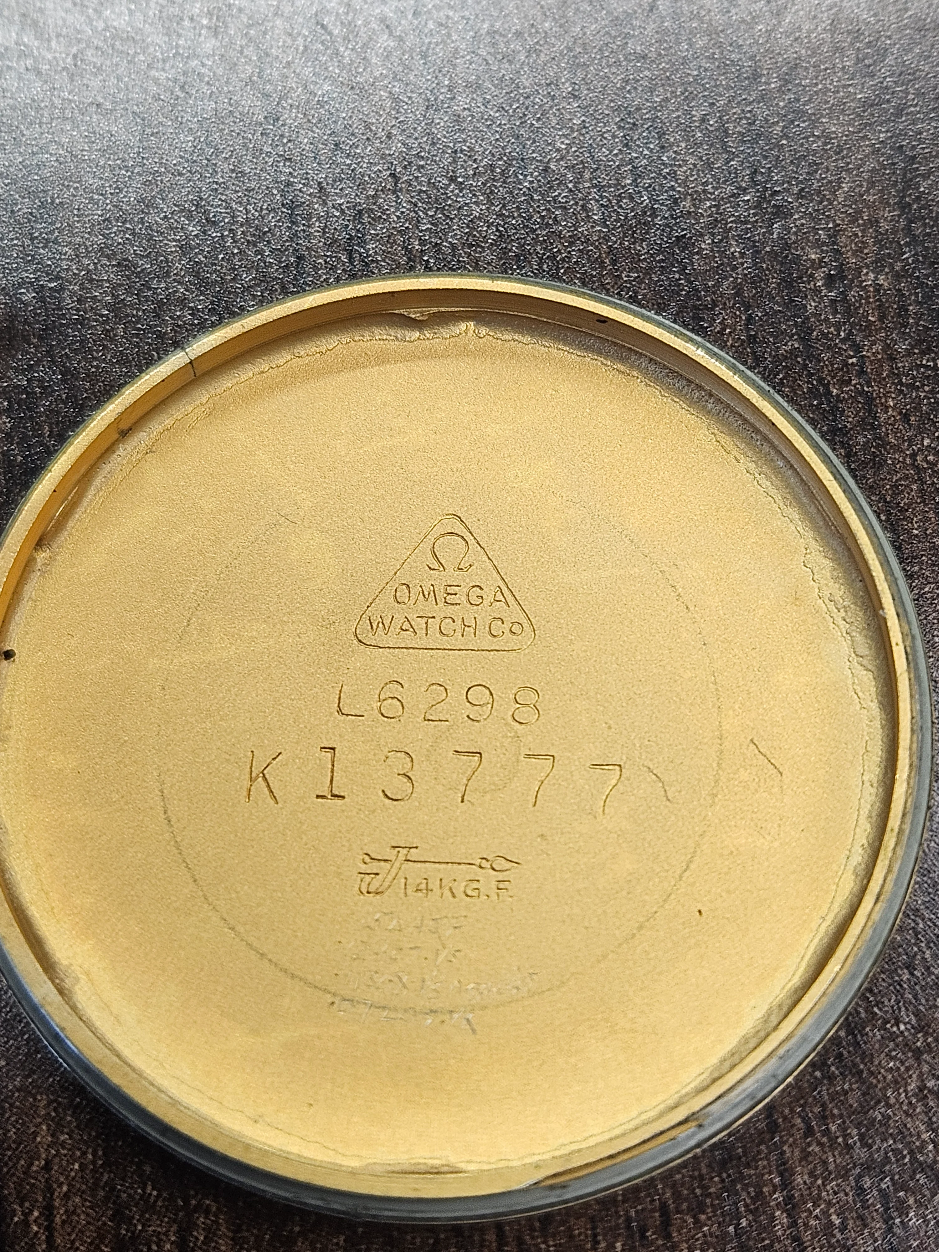

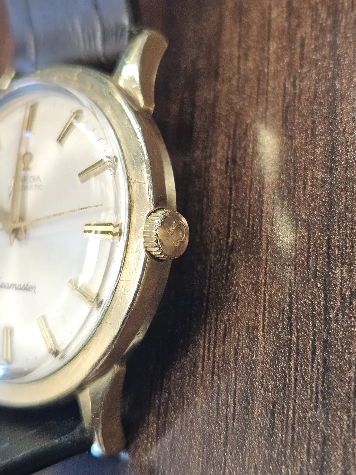

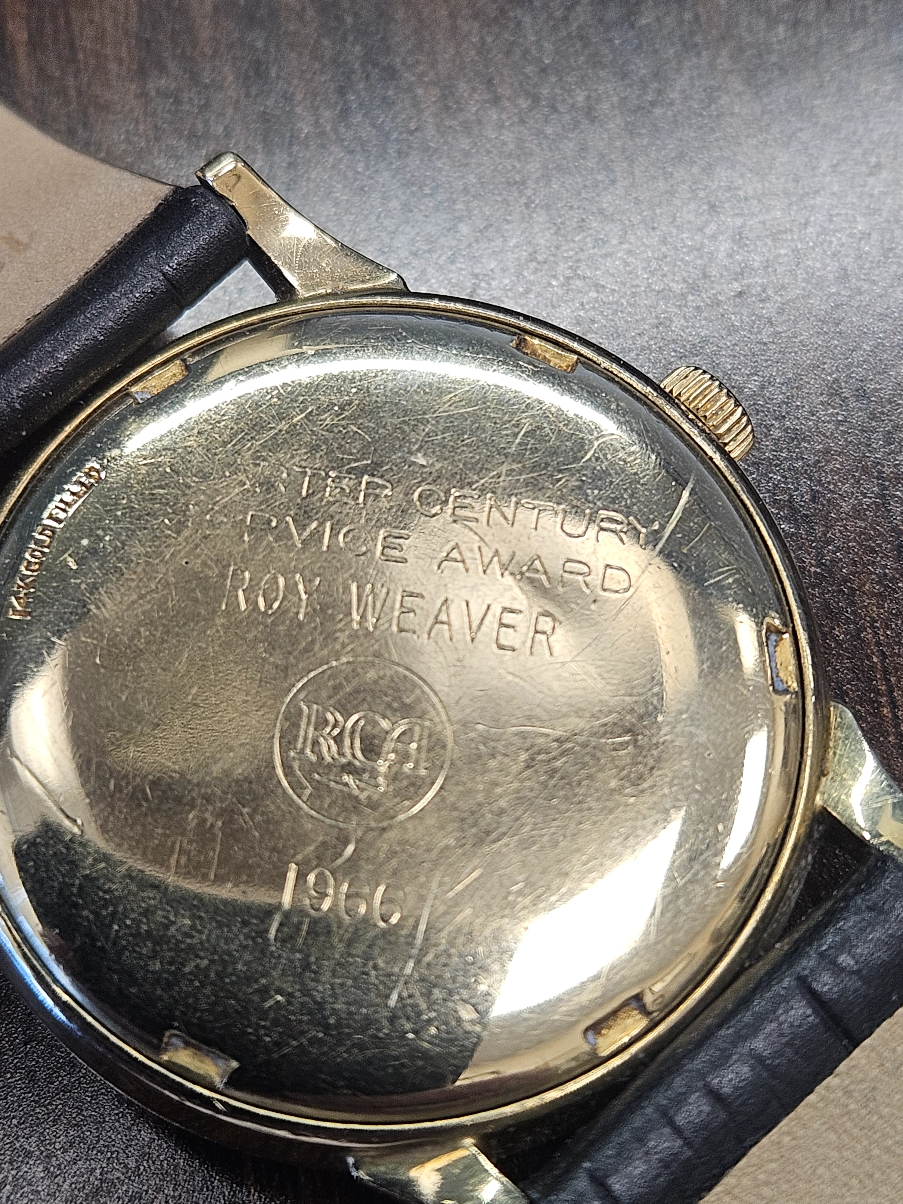

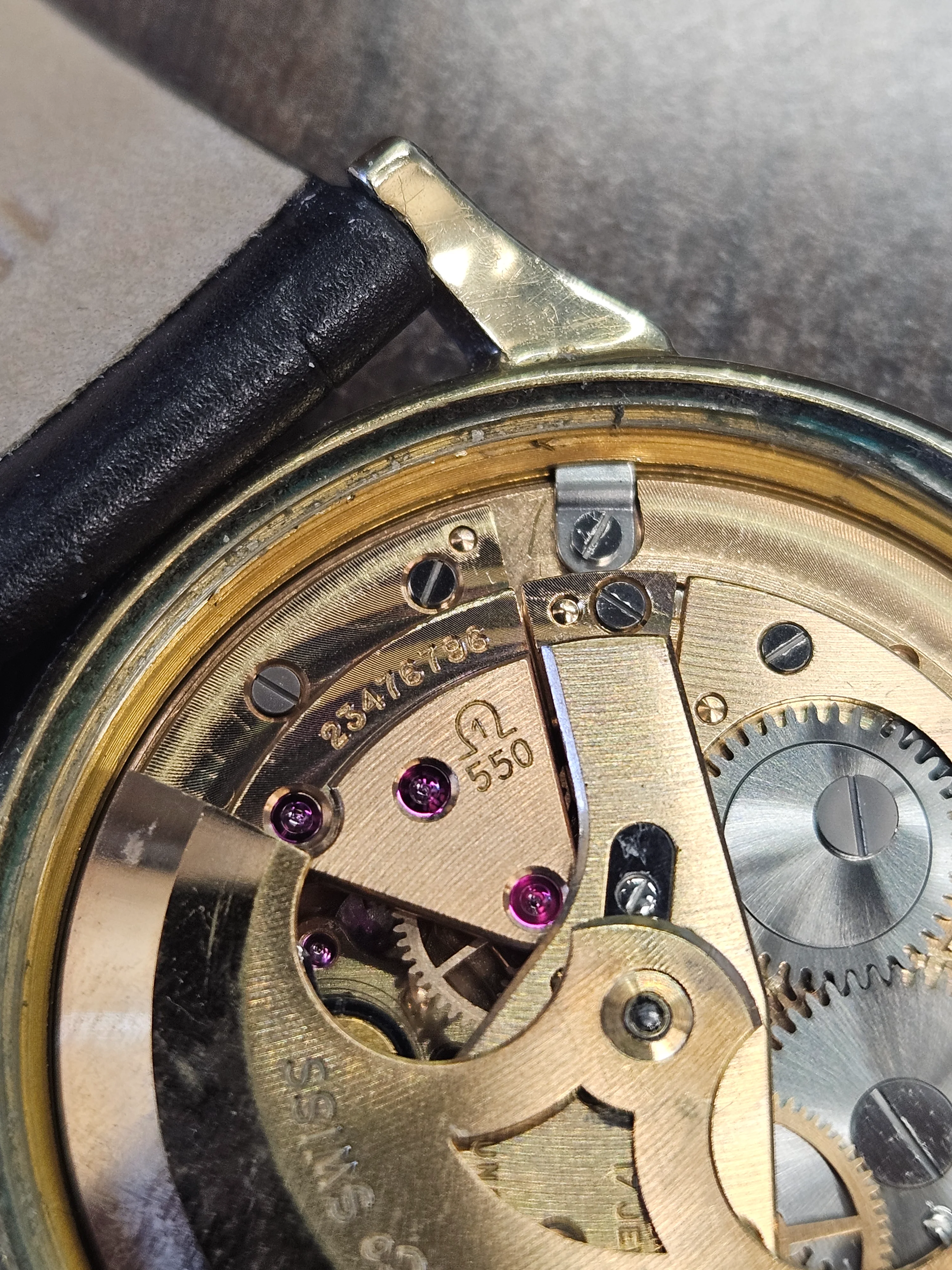

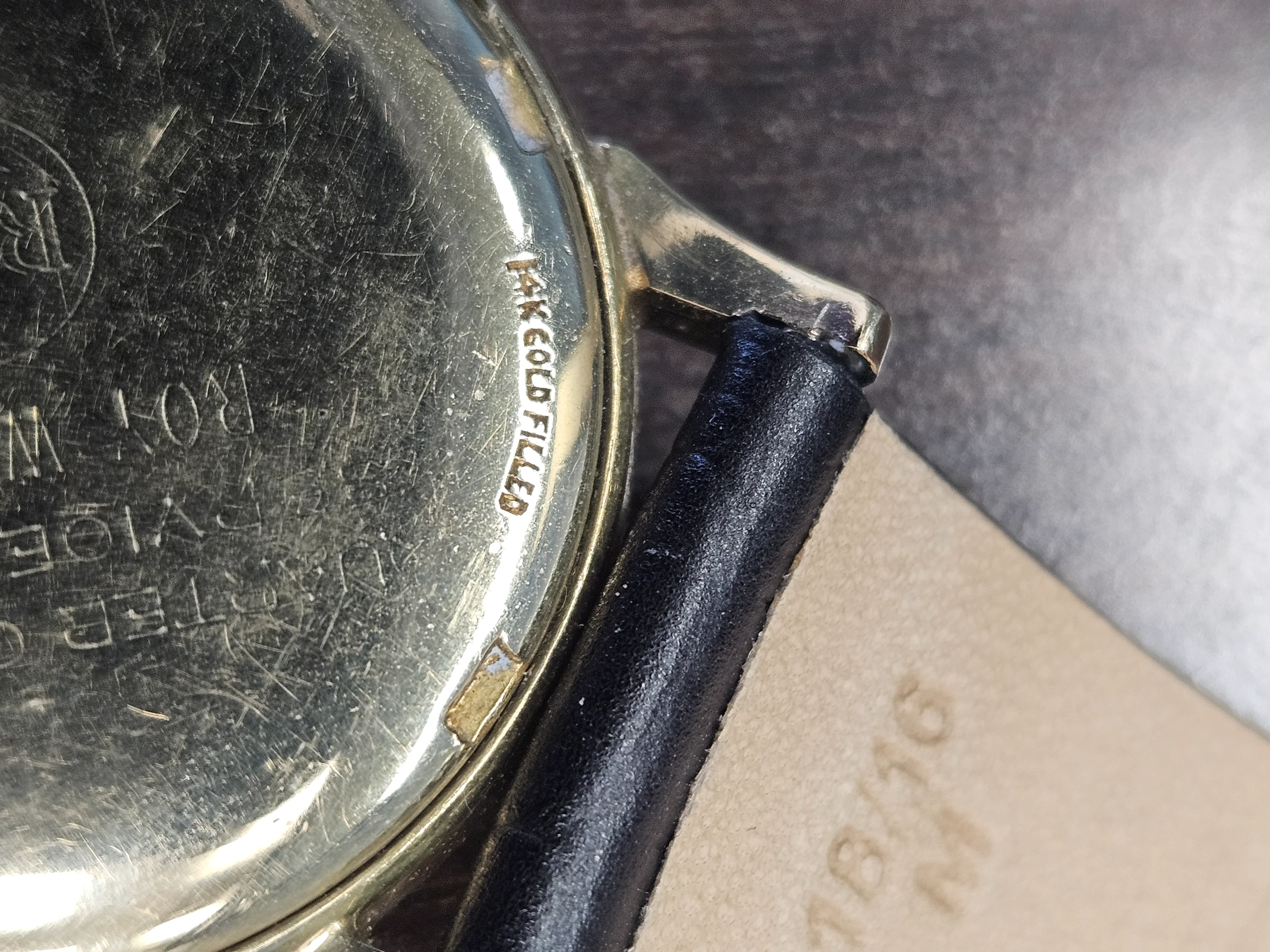

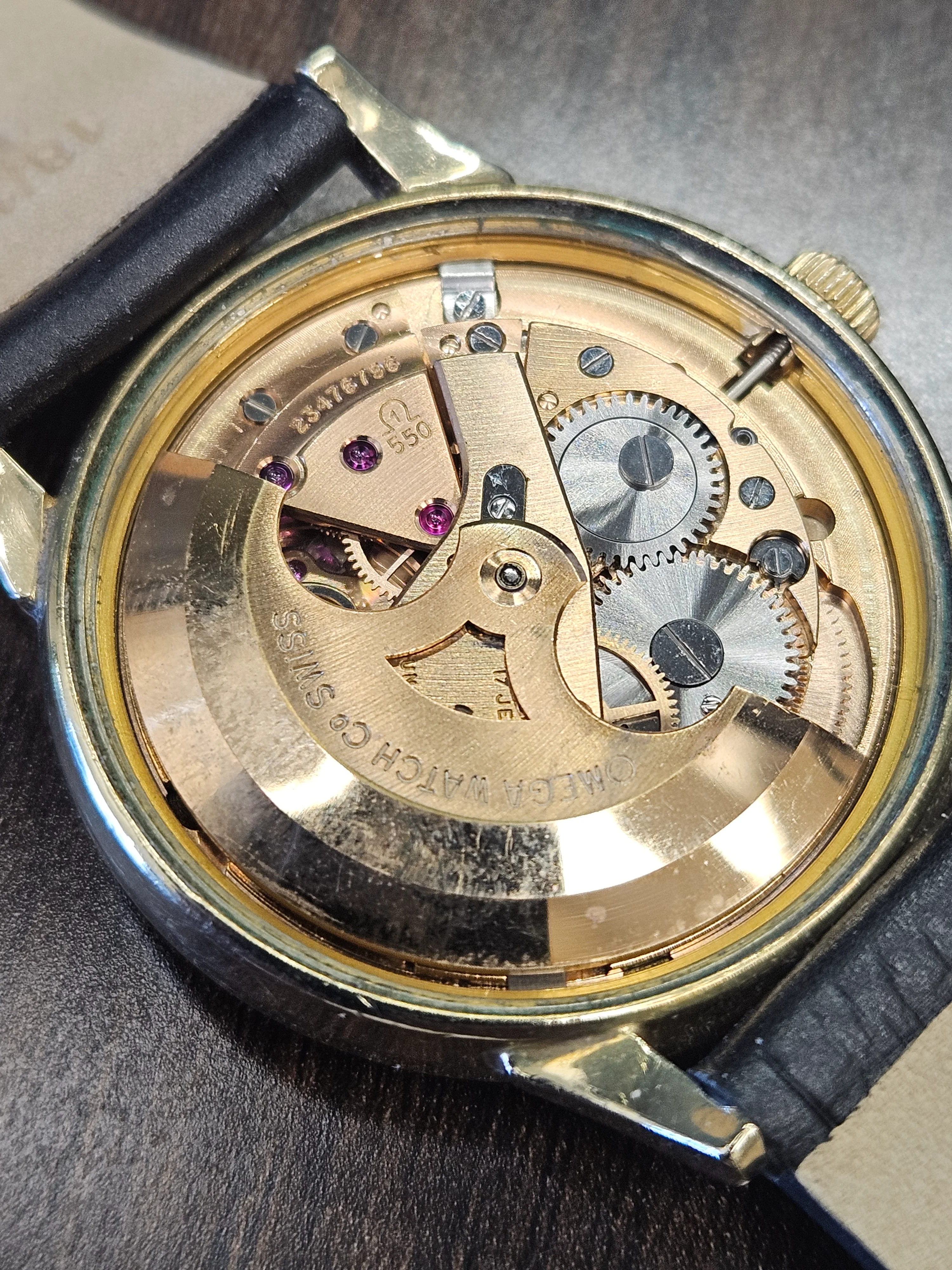

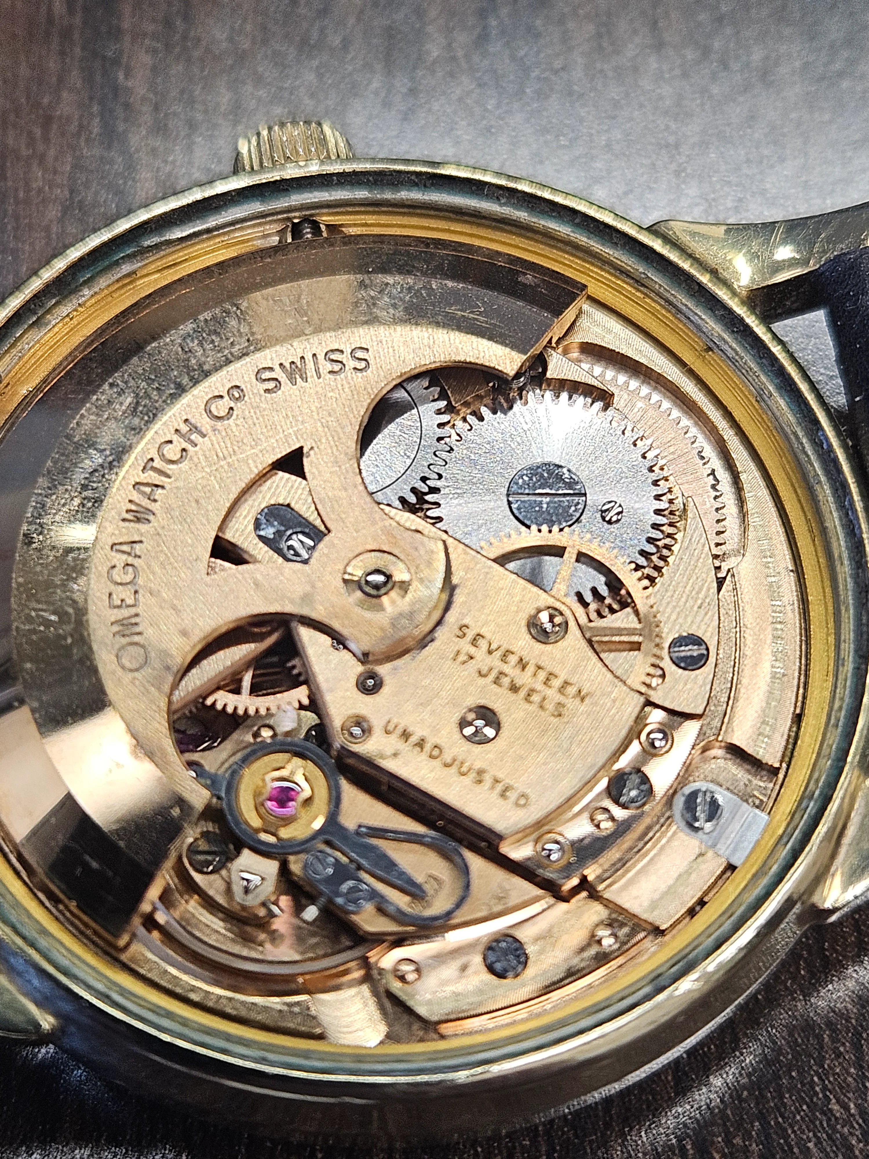

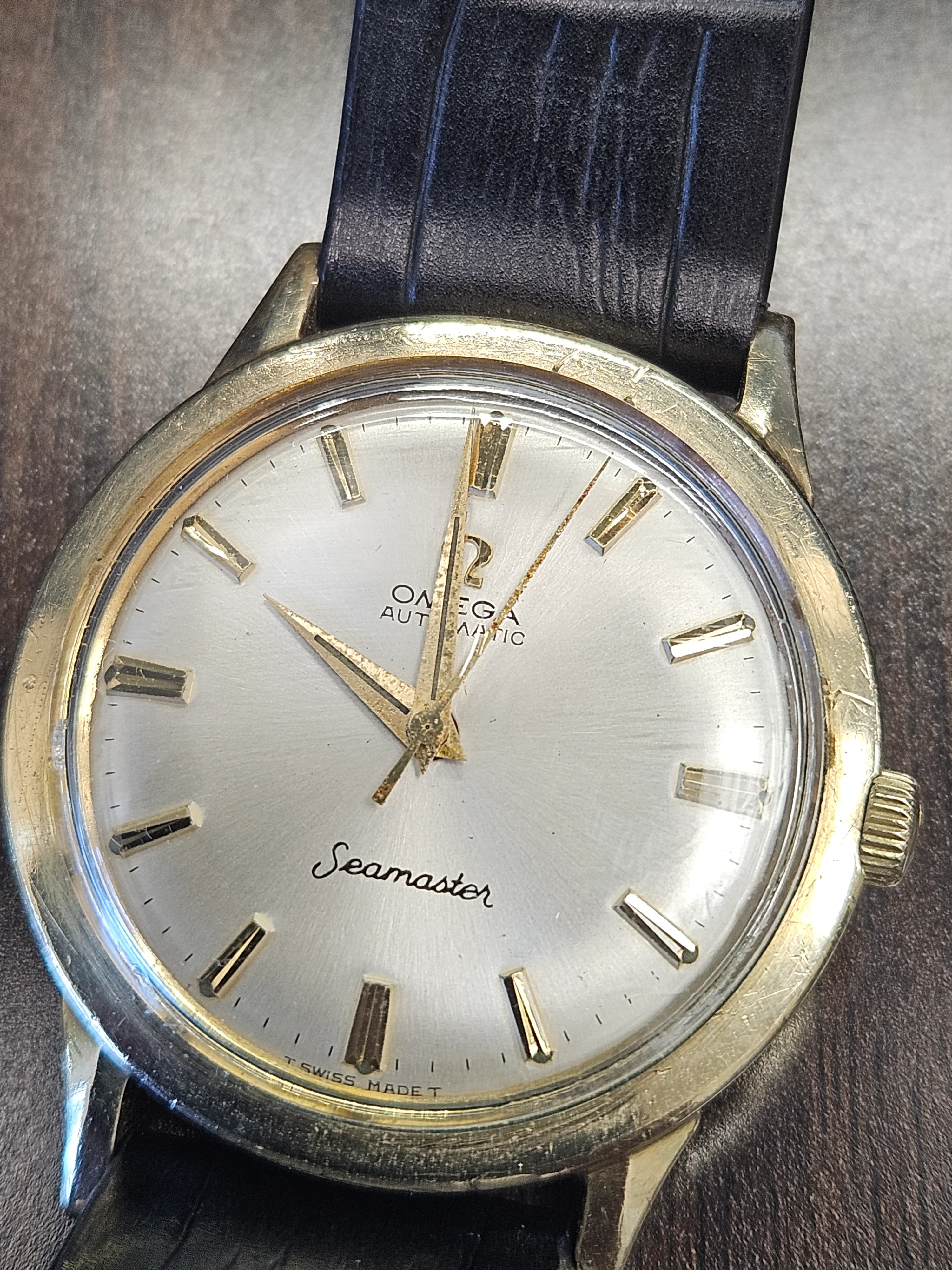

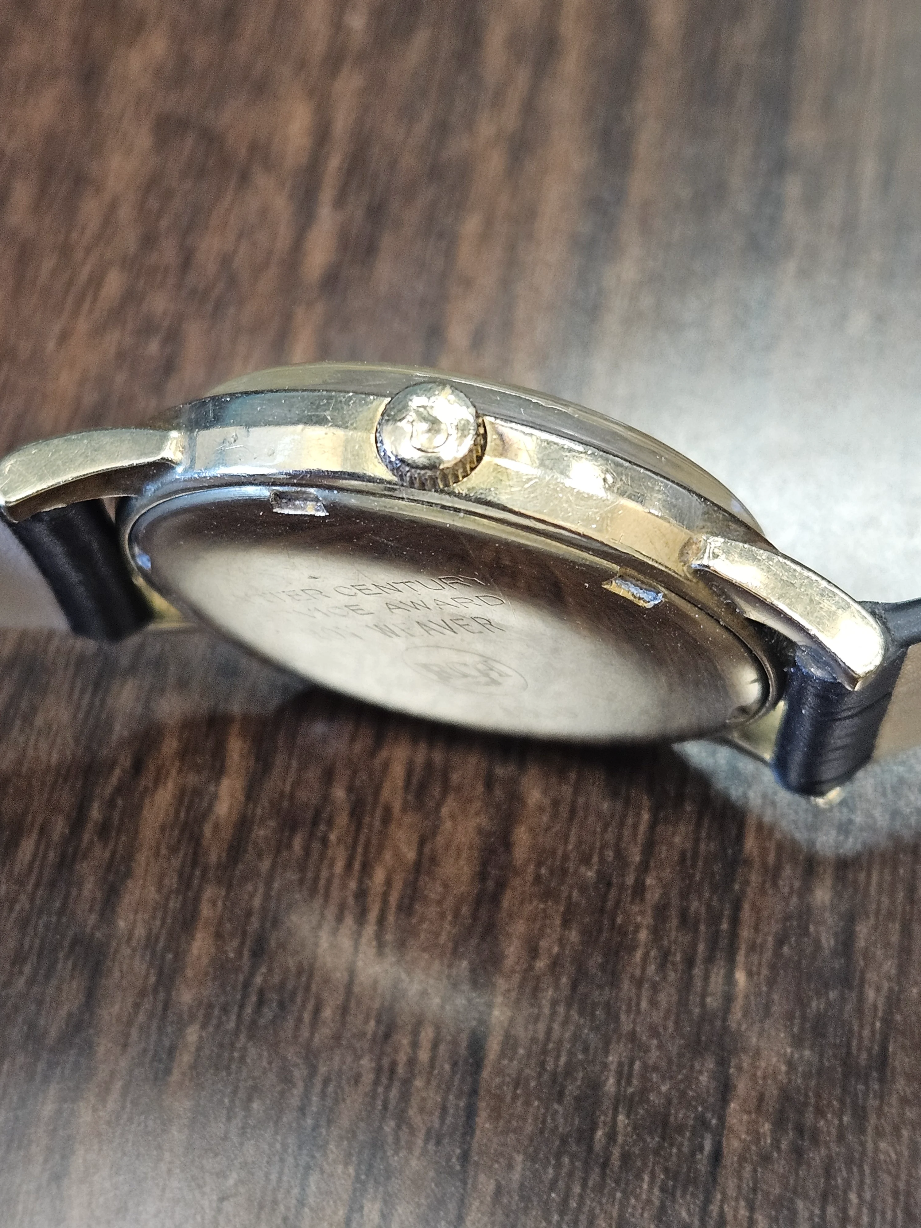

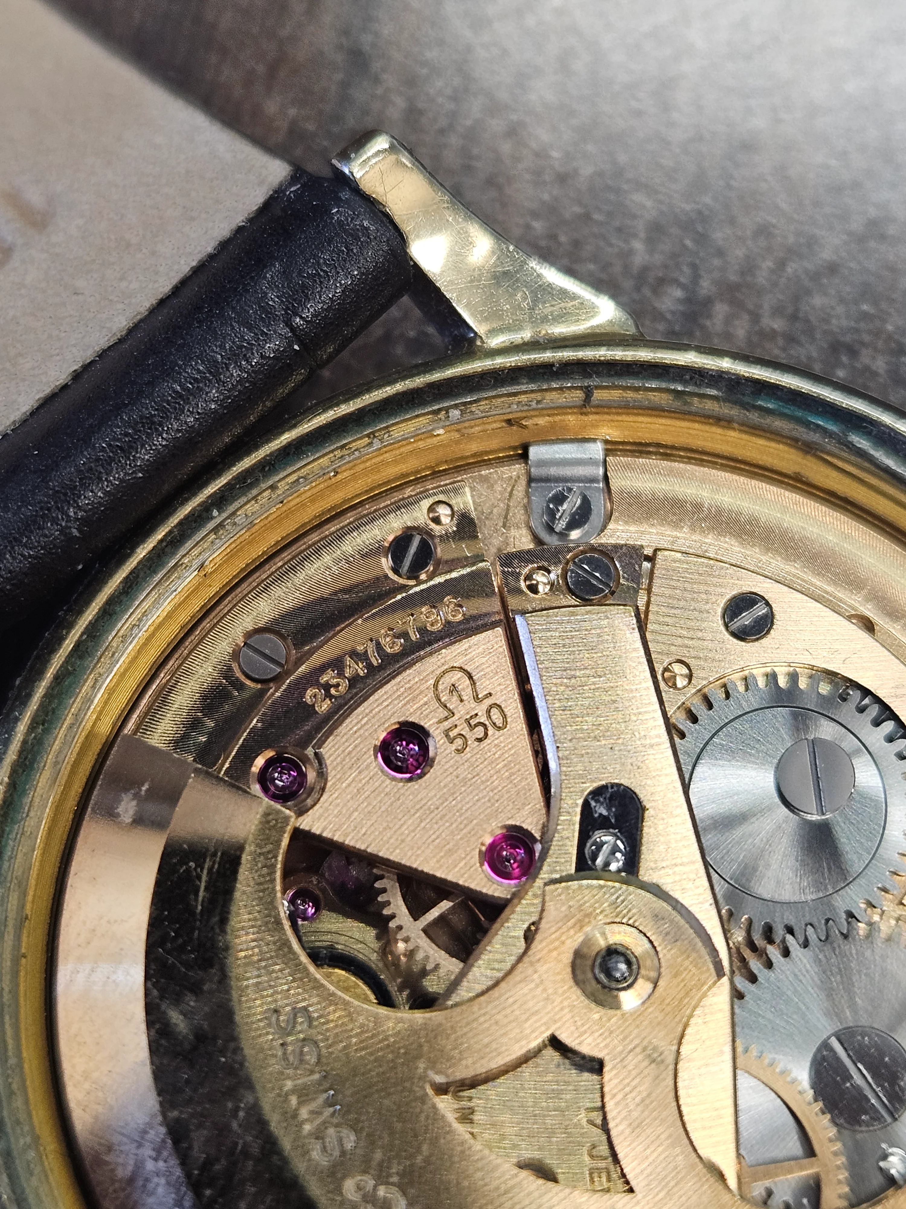

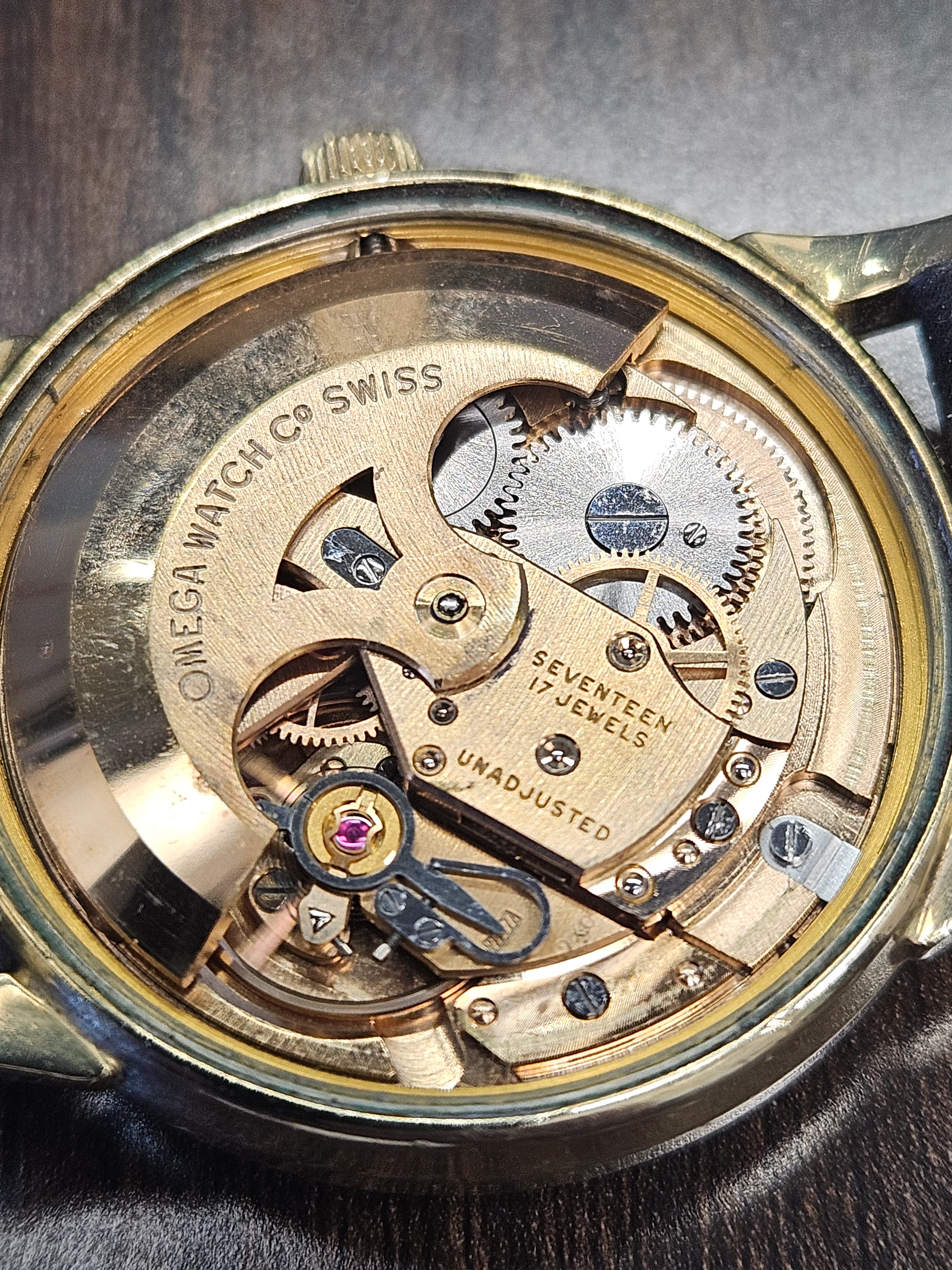

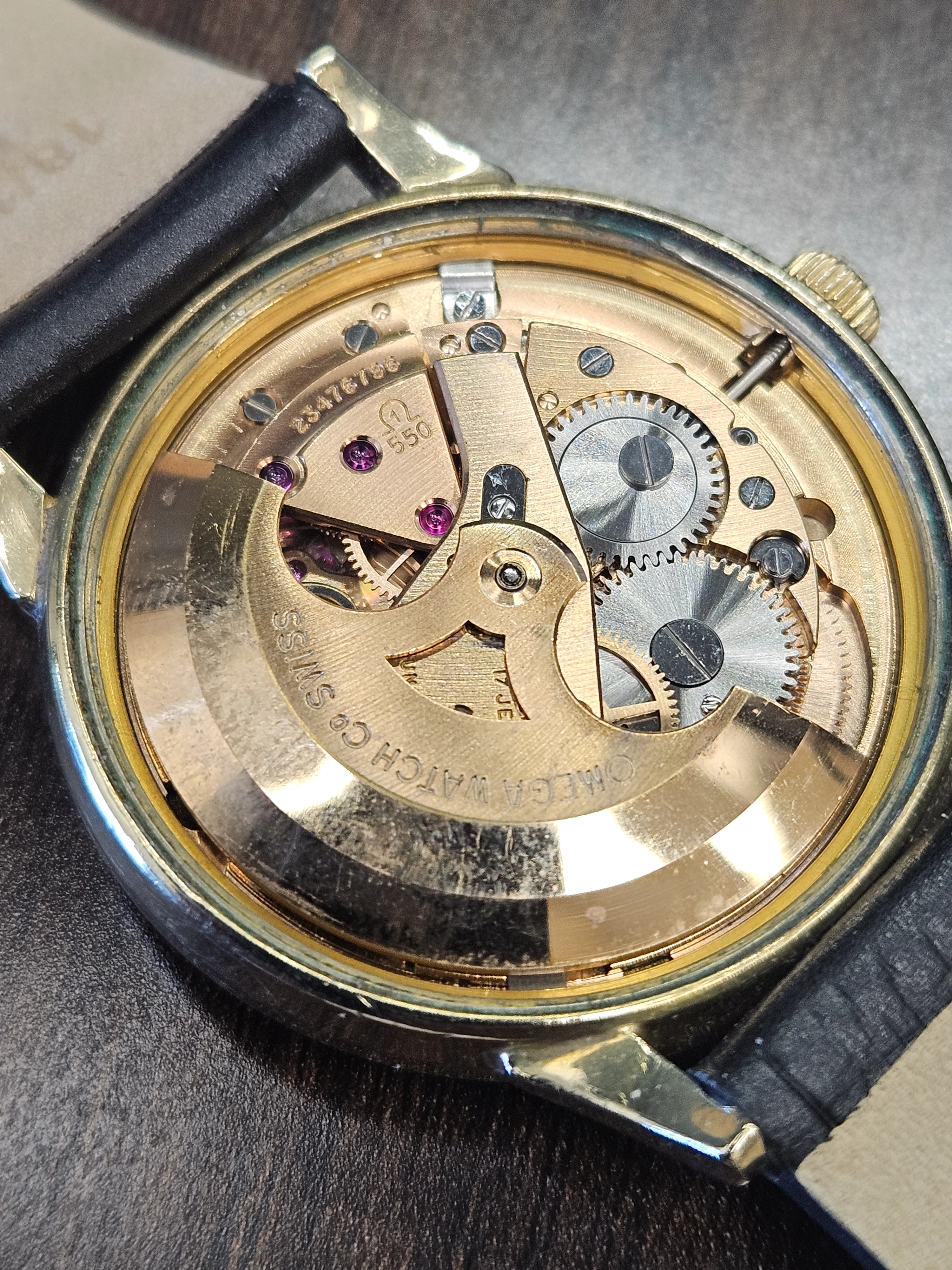

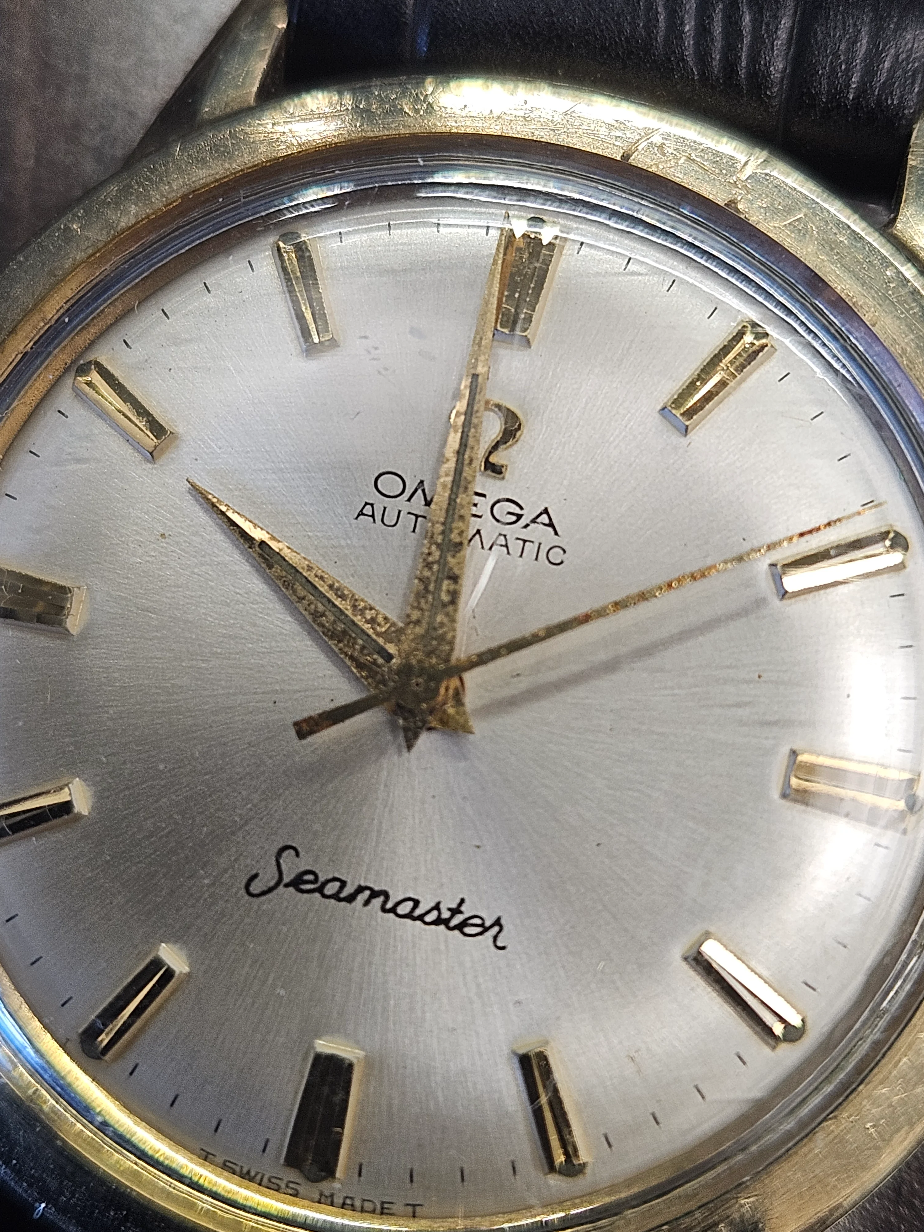

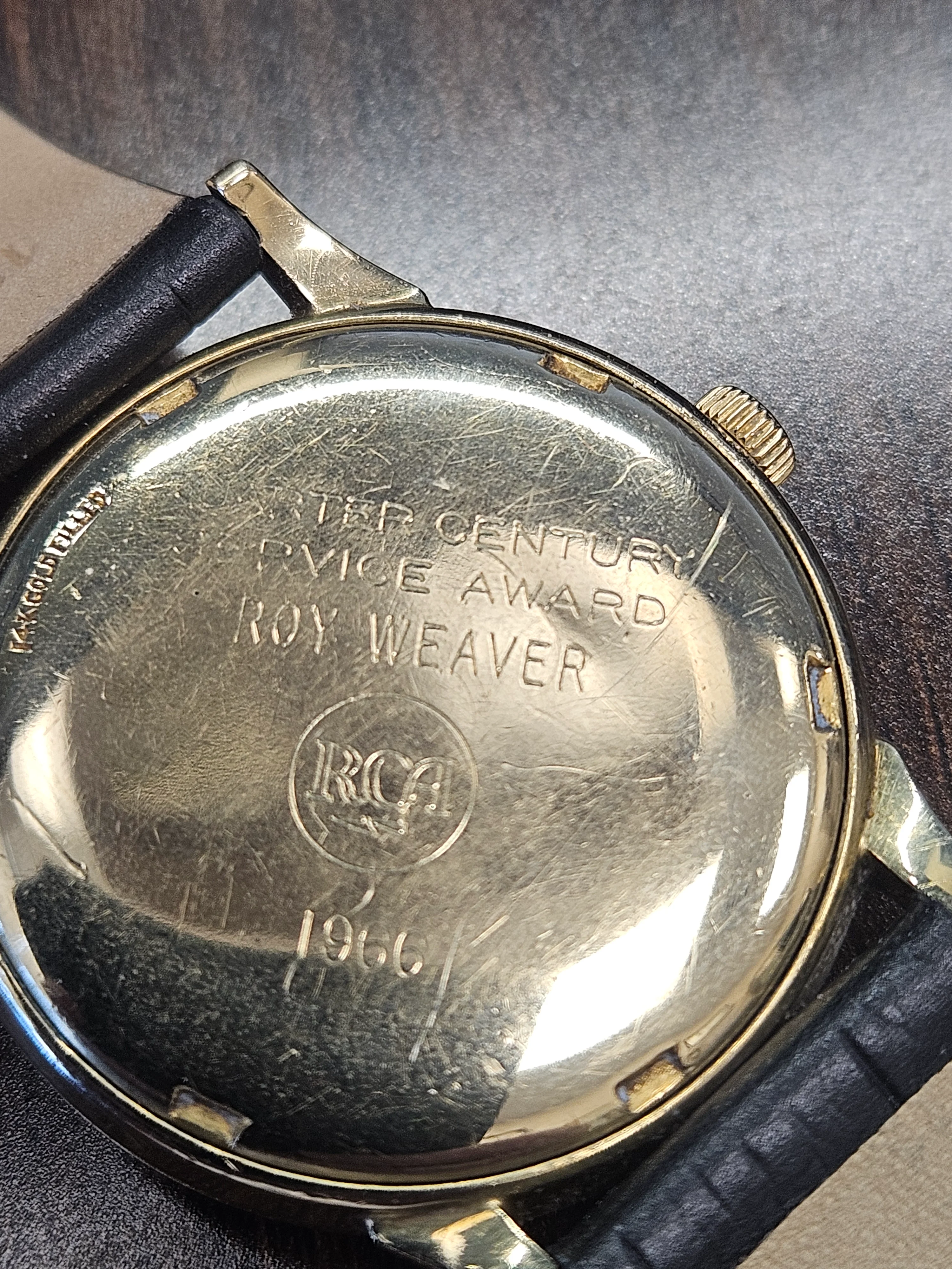

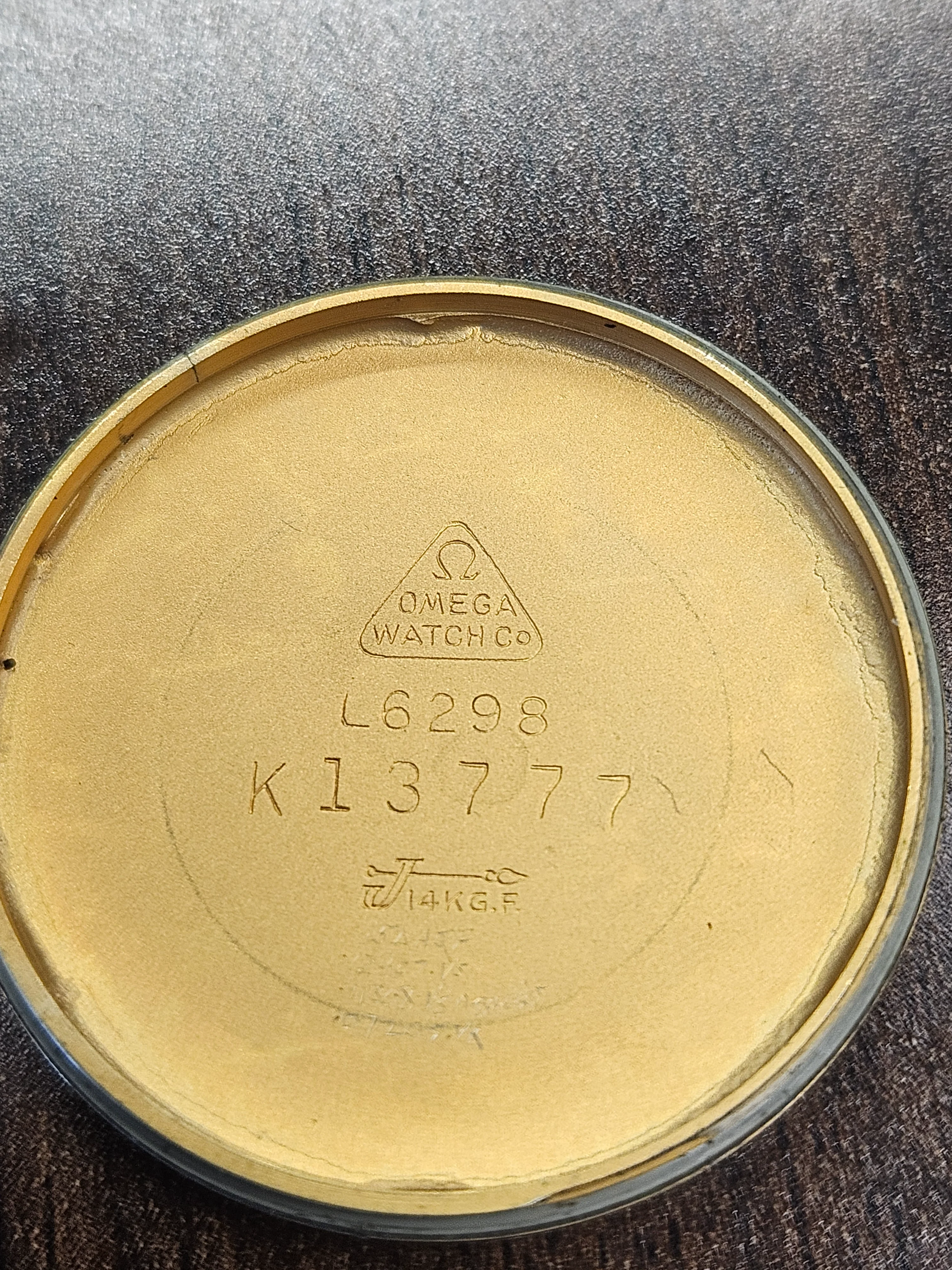

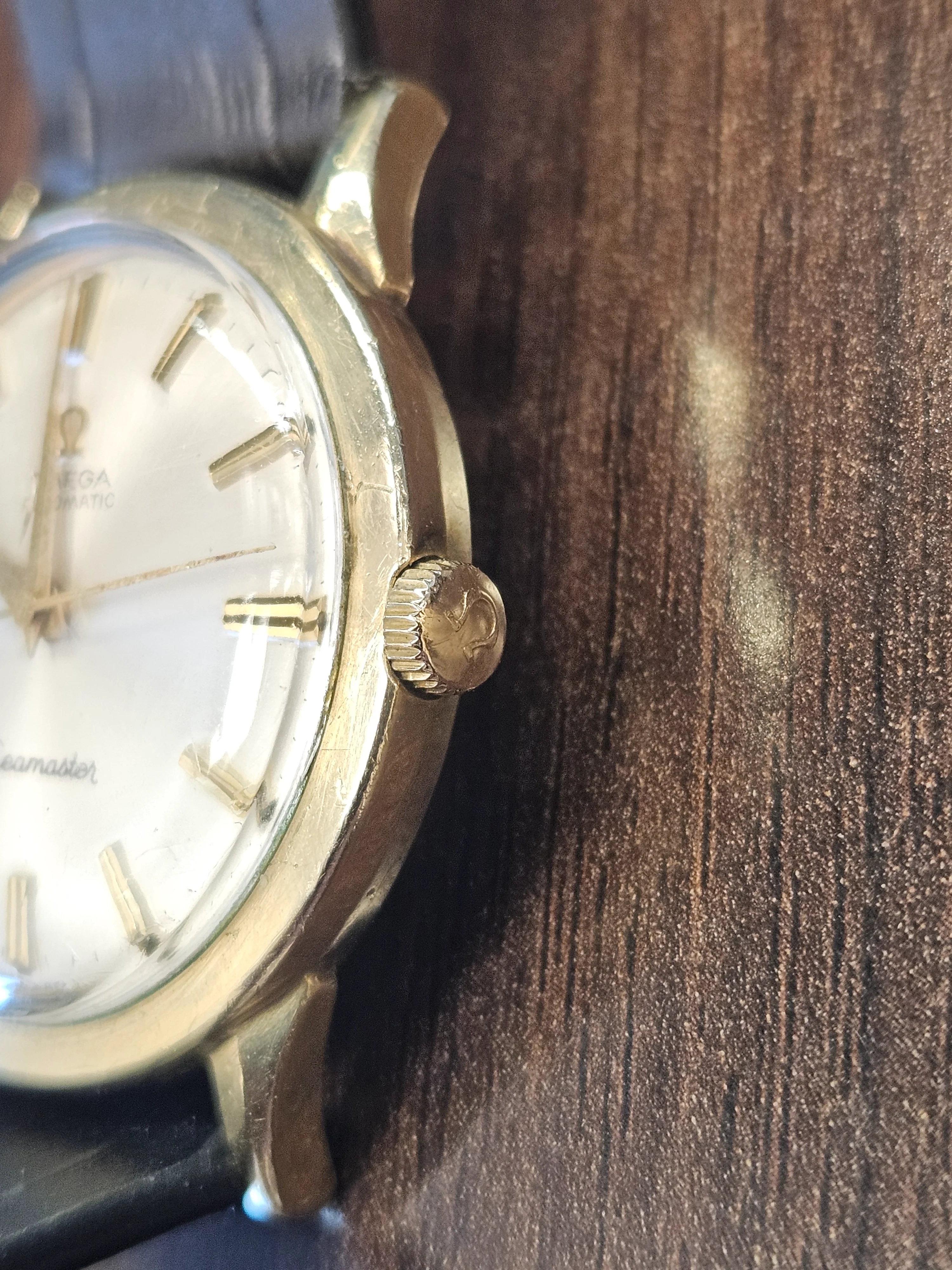

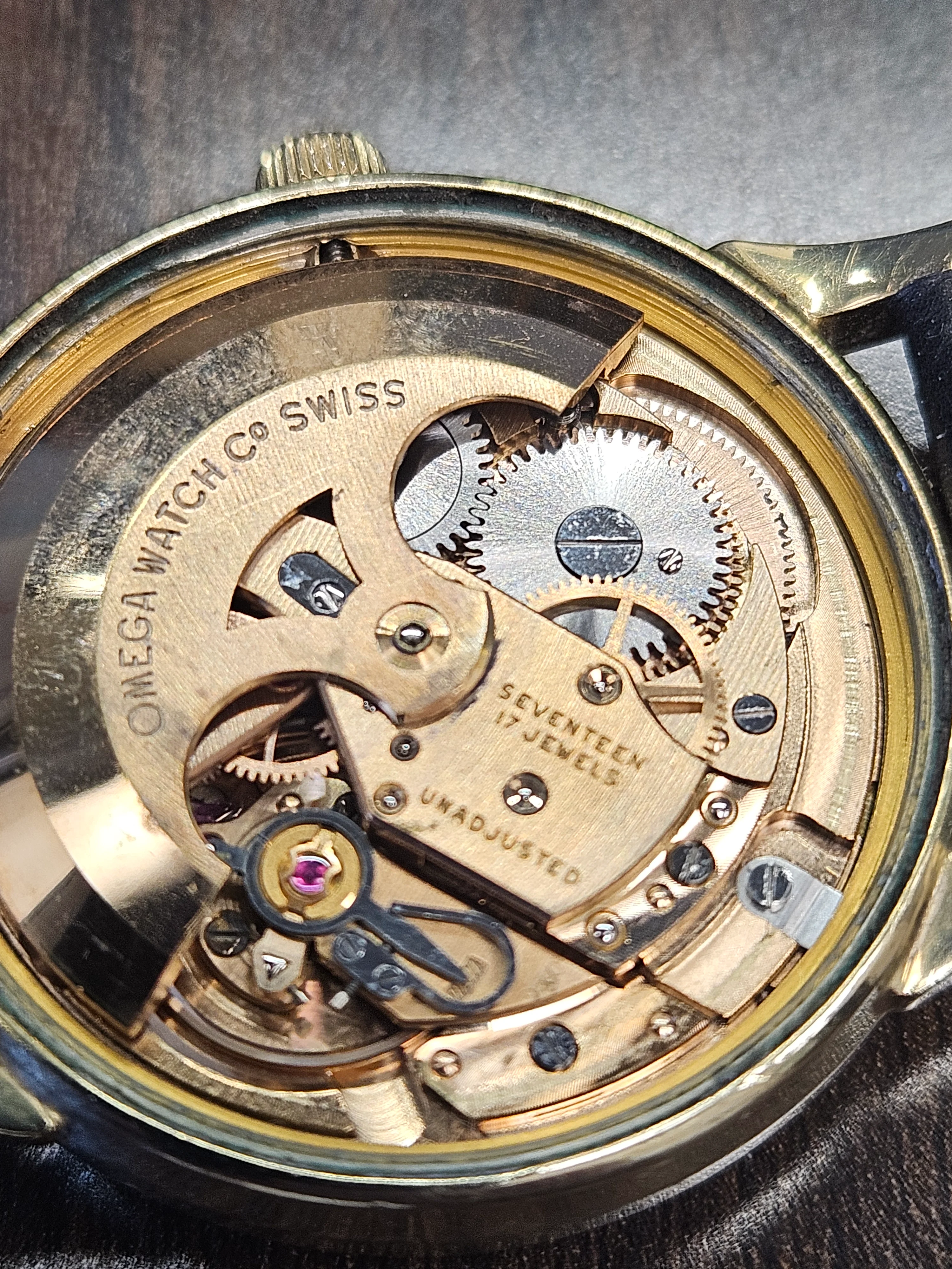

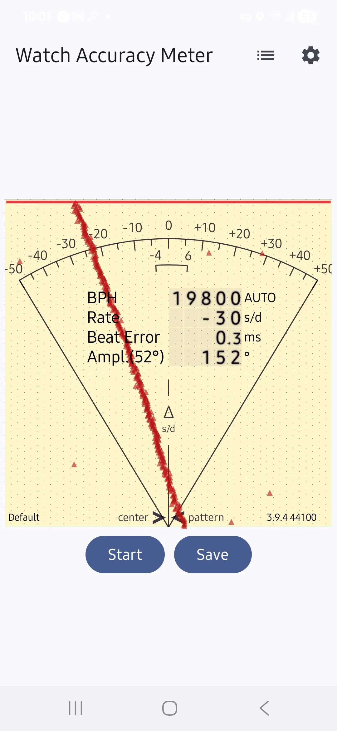

Picked up this mid-60s Omega Seamaster Automatic in a US-cased 14K gold-filled case (J. Wadsworth), with a nicely preserved silver sunburst dial signed Omega Automatic Seamaster and correct? applied indices. Caseback is engraved “25th Century Service Award - Roy Weaver - 1966,” which lines up well with the era. Inside is an Omega automatic marked Seventeen Jewels, Unadjusted (US import), running at 19,800 bph. On the timegrapher it’s currently about -30 s/day with very low beat error (~0.3 ms), though amplitude is modest (~150°), so a service is likely due. Crown appears Omega-signed and period-correct. Would appreciate thoughts on dial originality, exact movement ID, and whether the case/dial combo looks right for a US-market Seamaster of this period.

Omega 550 movement obviously, a 551 or 552 is a nicer movement (24 vs 17 jewel), but nice neough and looks in pretty good shape other than the timegrapher result. There migth be signs of rotor rubbing, which is a bit concerning, but would be taken care of by servicing.
Case, dial, hands all look about right, nothing suspicious there, case number L6298 gets you ton of search results, so have at it 😀
450 is about reasonable for it, though it needs $3-500 in service of course. I have a ton of 601-series watches (the manual wind versions of these) that I typically pay $350-$400 in about equally running shape, so $450 is perhaps a touch high, but not meaninfully so.
Side note: 150 degrees amplitude is not 'modest', that is 'basically not running'. Note lift angle on these is 49 degrees, so it is perhaps a touch worse than that too.

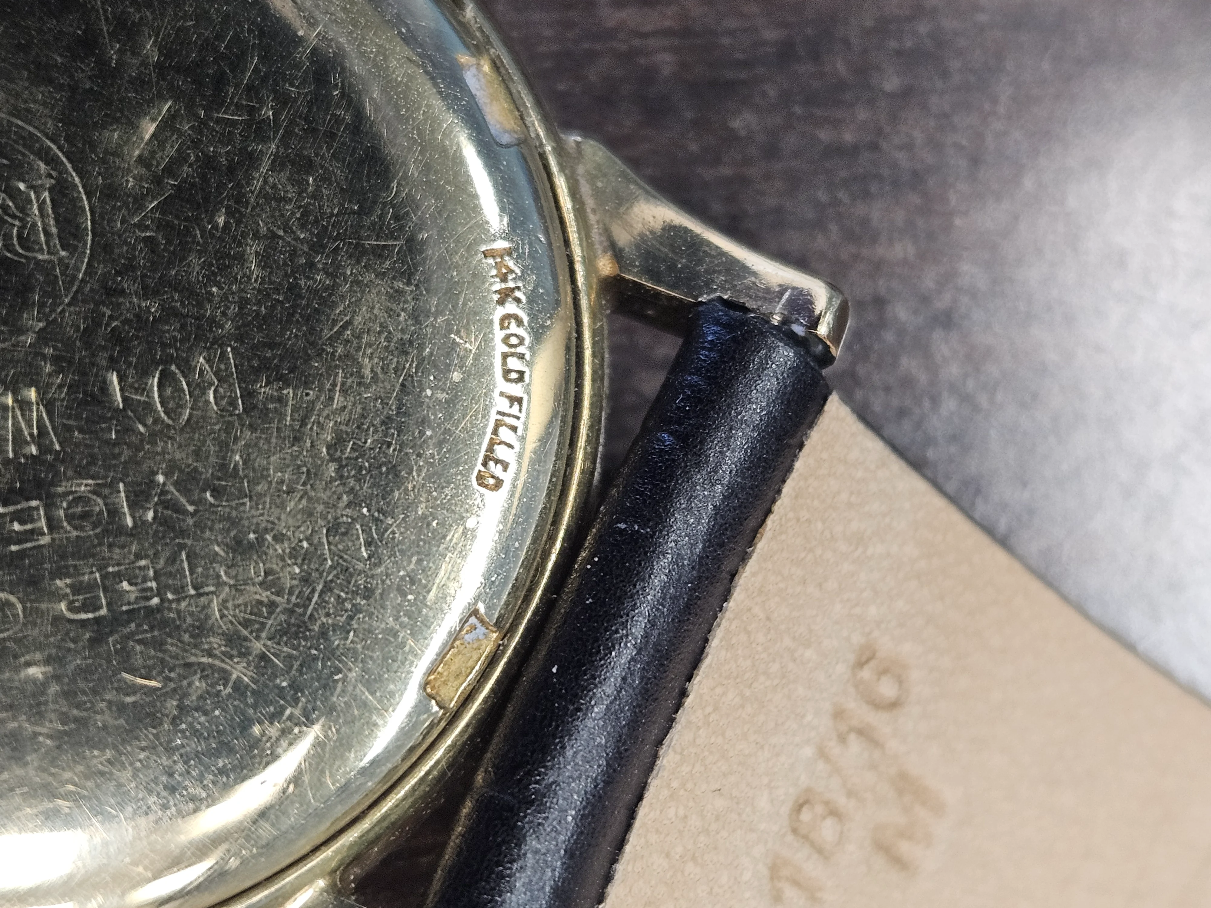

Case was made by the Jonell Watch Case Company of Long Island City, New York.
217
104
Thank you.Nice to pick up.I wasn't sure and I showed it to chat G p t I guess it got it wrong. Thx again
