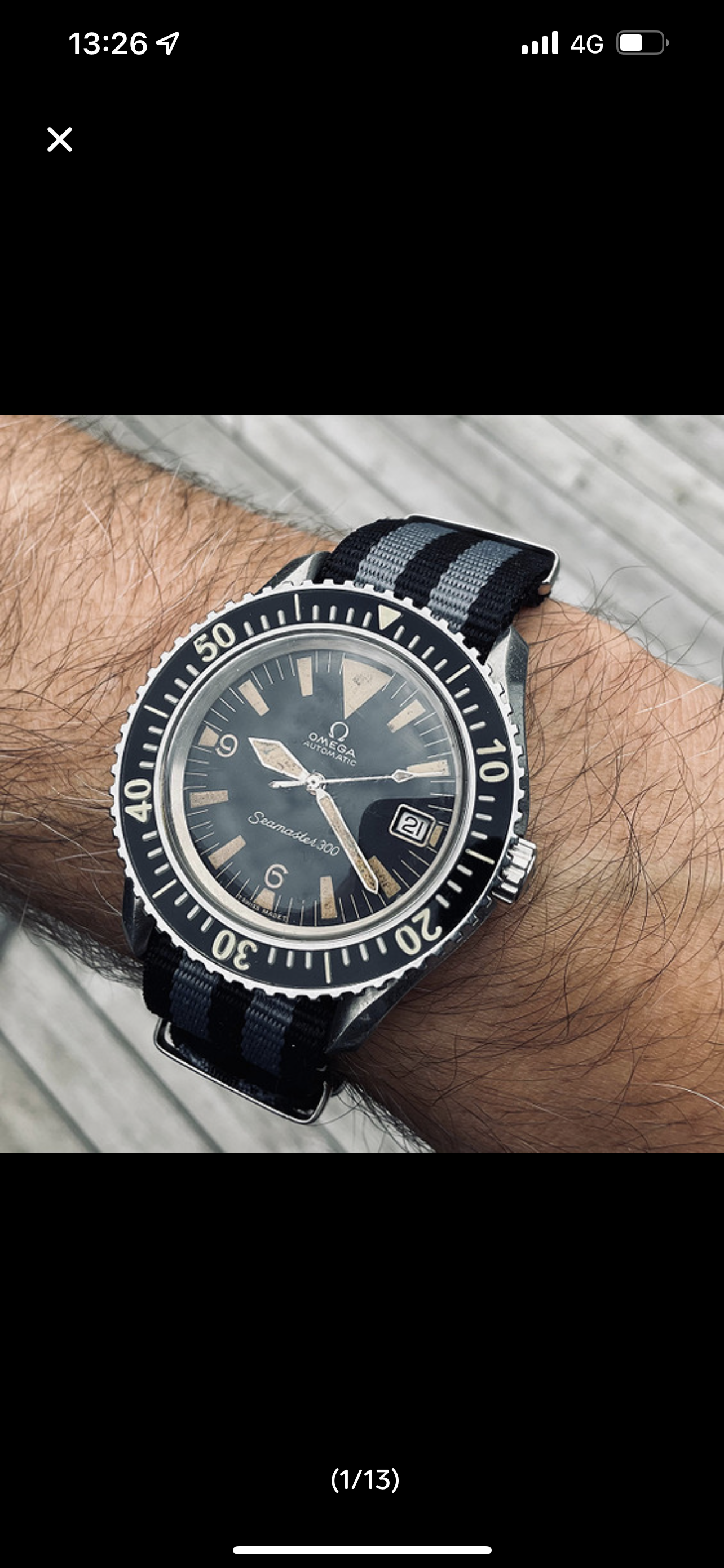

Vintage Omega Seamaster 300 Big triangle , case none original ?

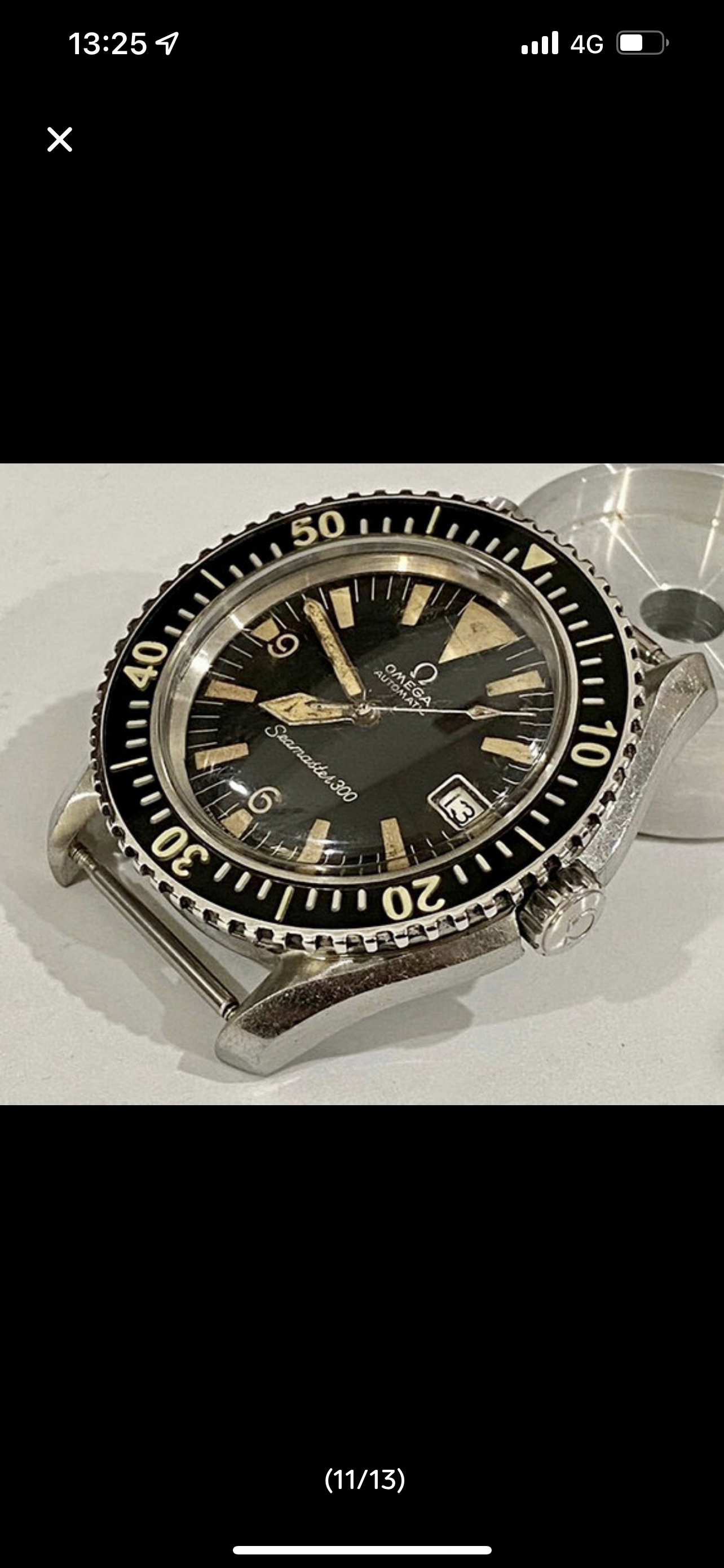

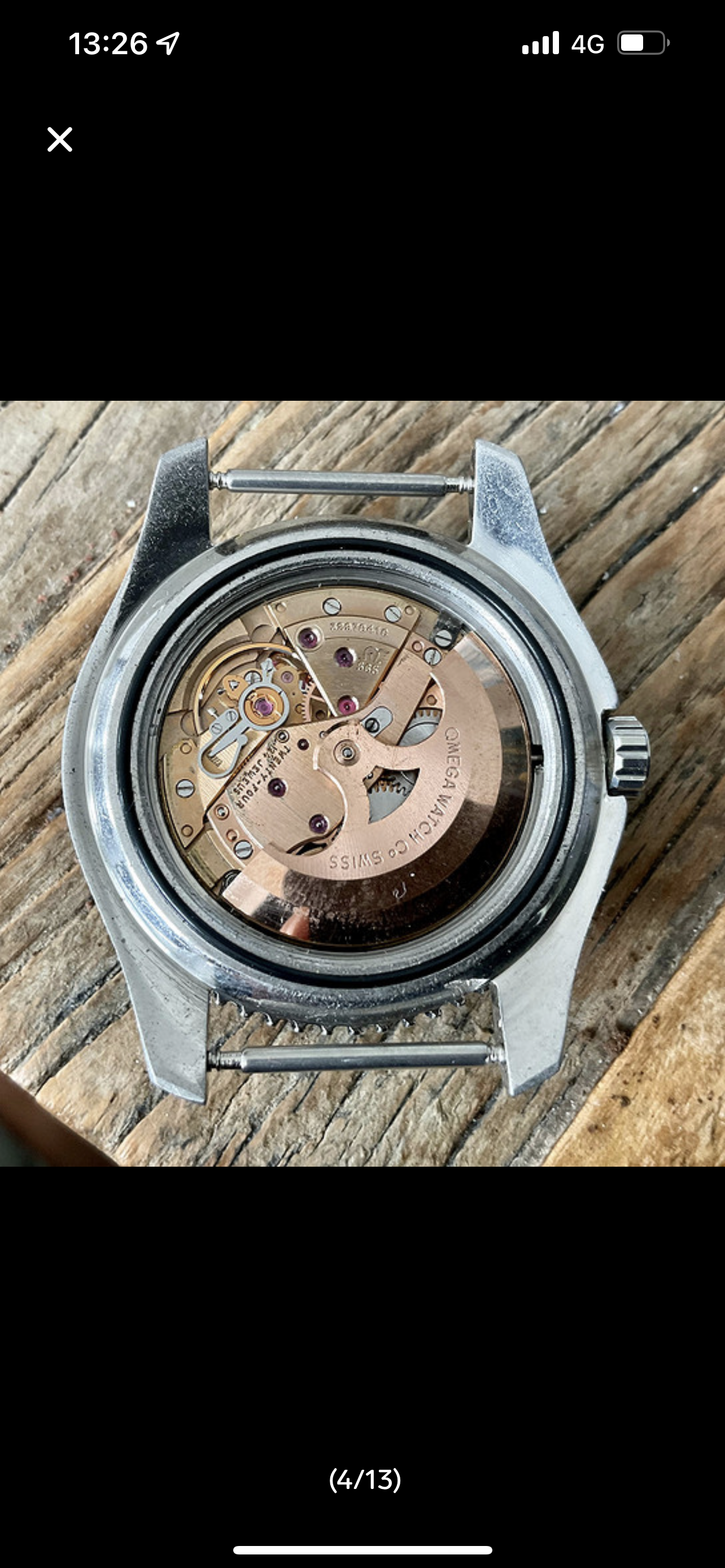

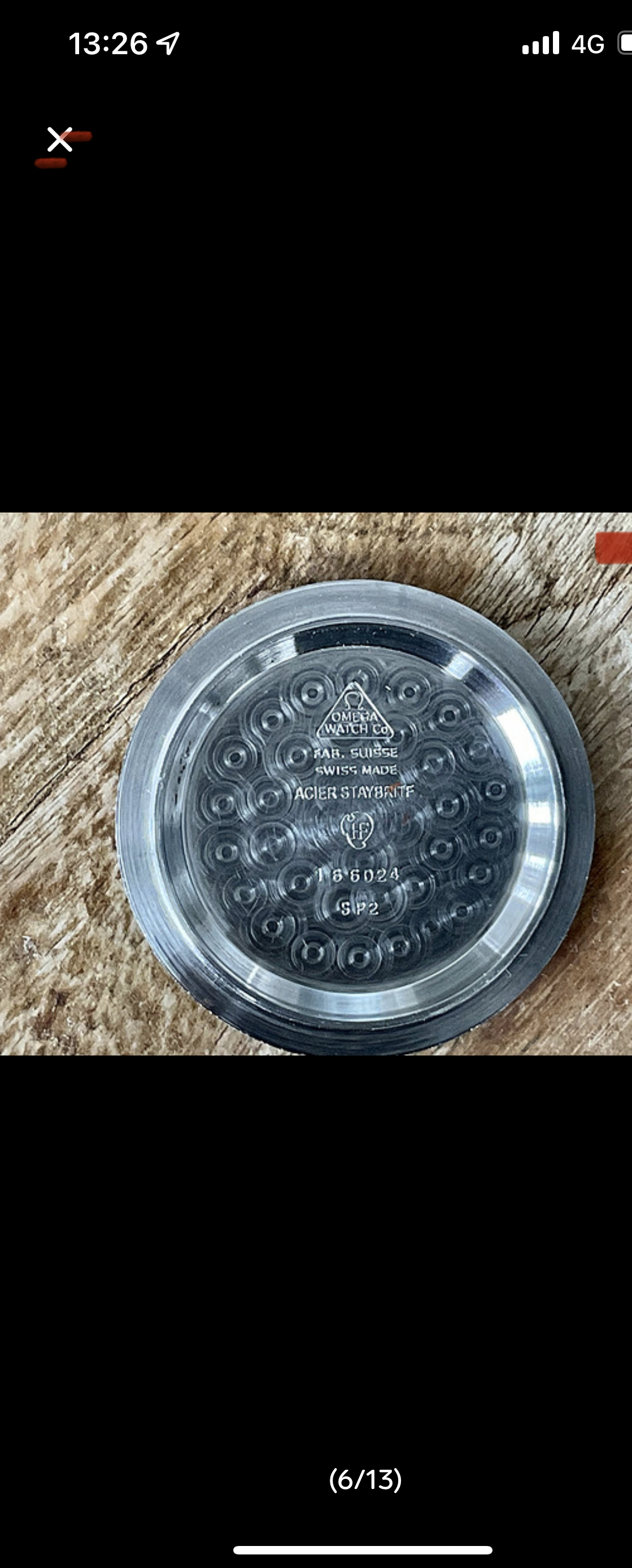

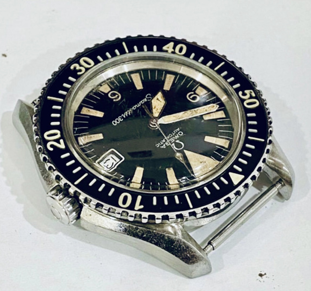

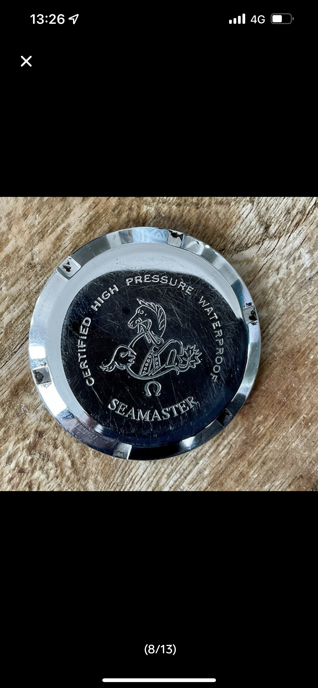

I just see fake parts here! Cant exactly tell on the mid-case...but when everything else is fake, why should this be genuine?

Only the movement is genuine.
Tha mid case is fake as the rest of the watch. You can see it from the shape and the edges. It's completely different form the original one.
