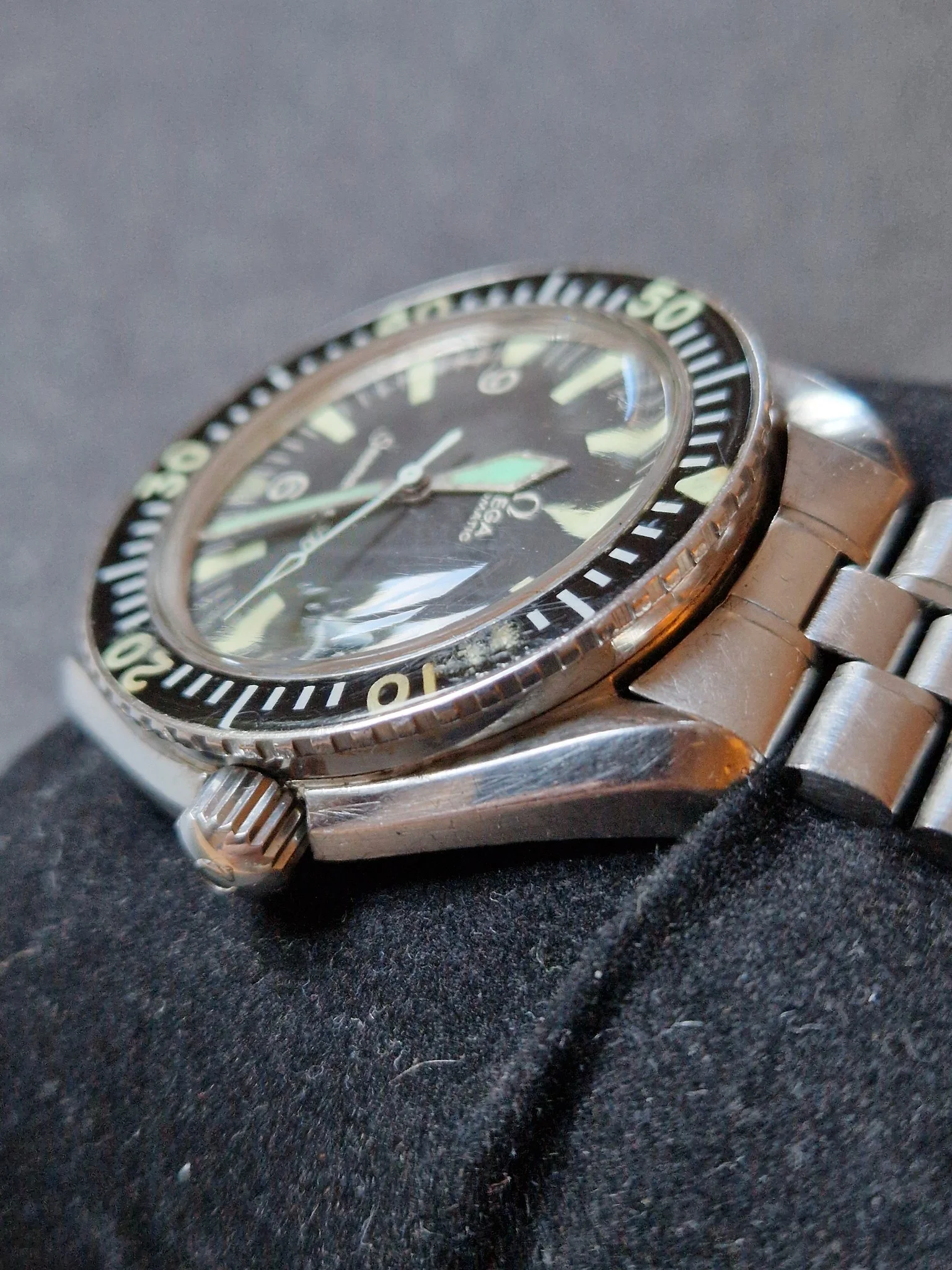

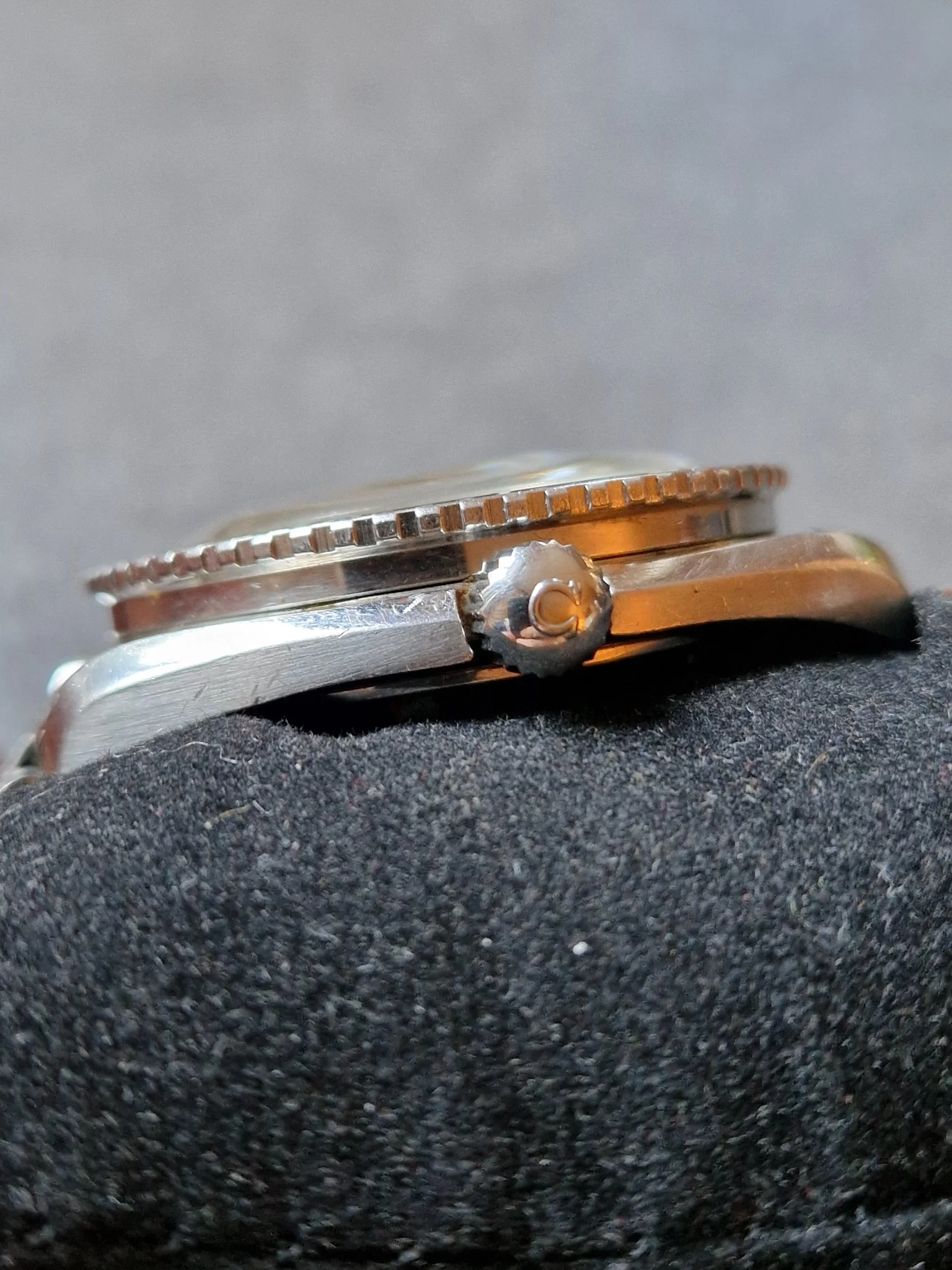

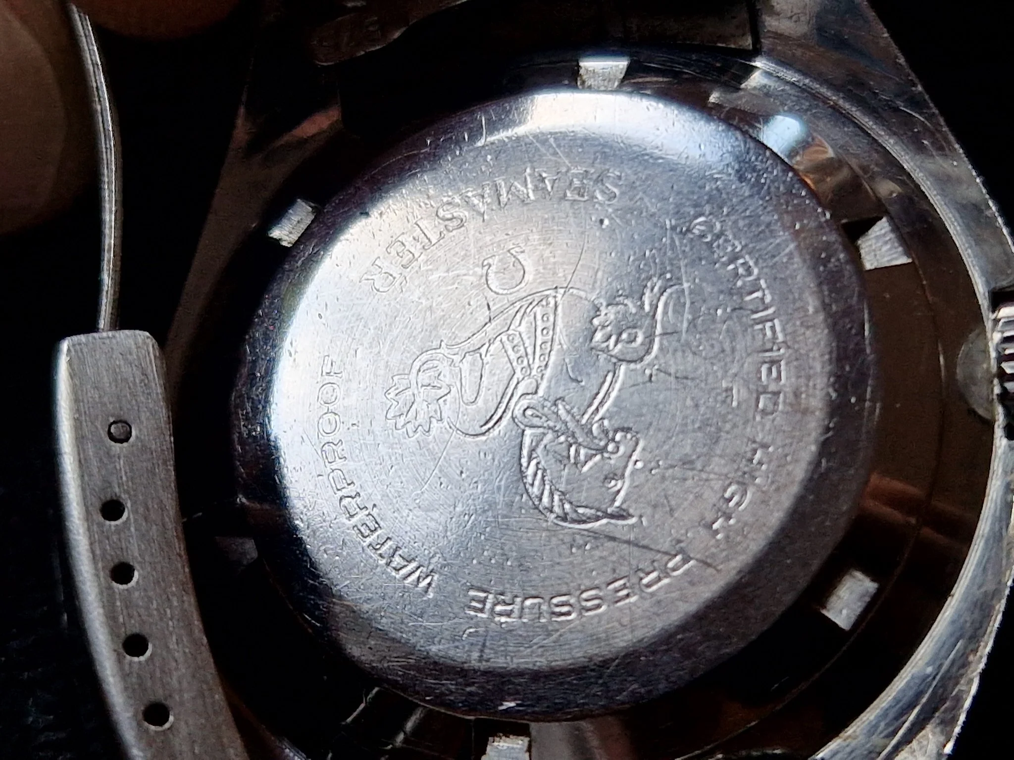

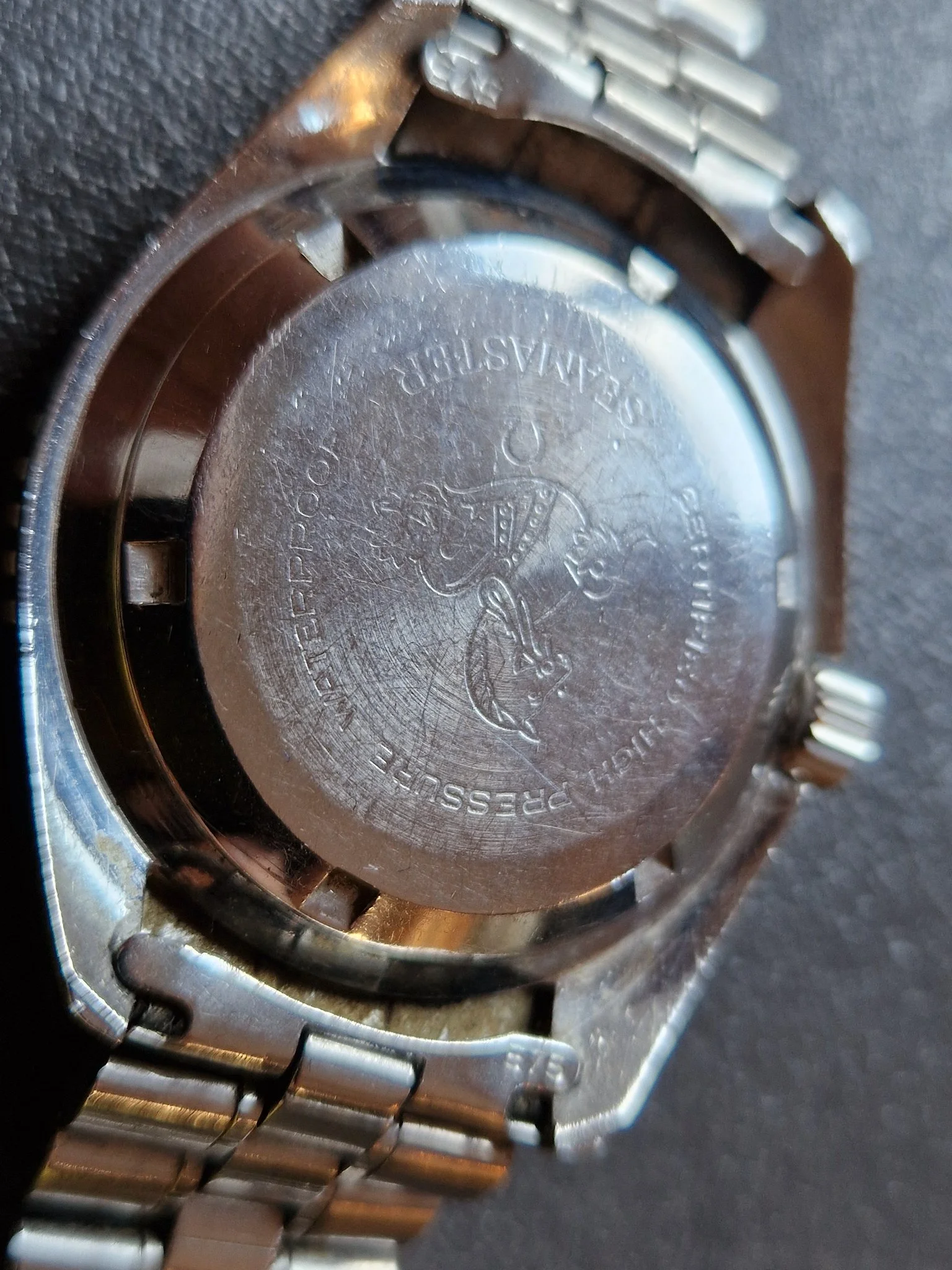

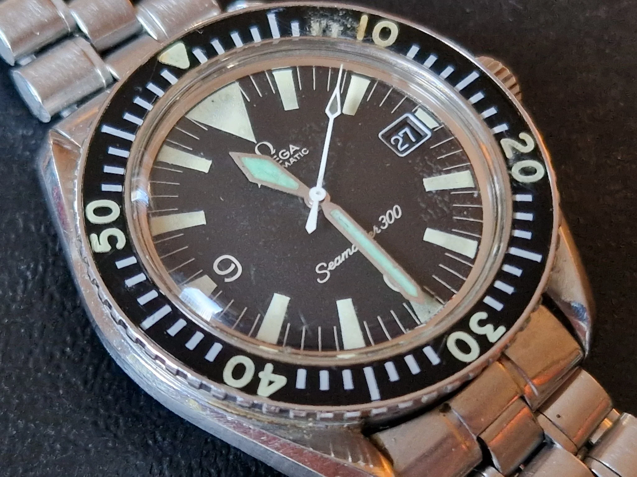

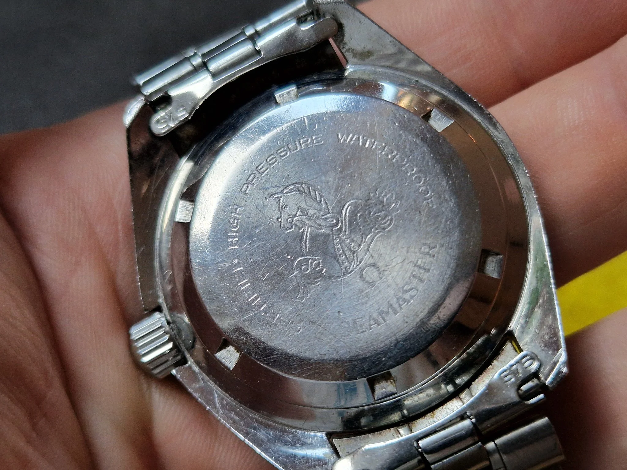

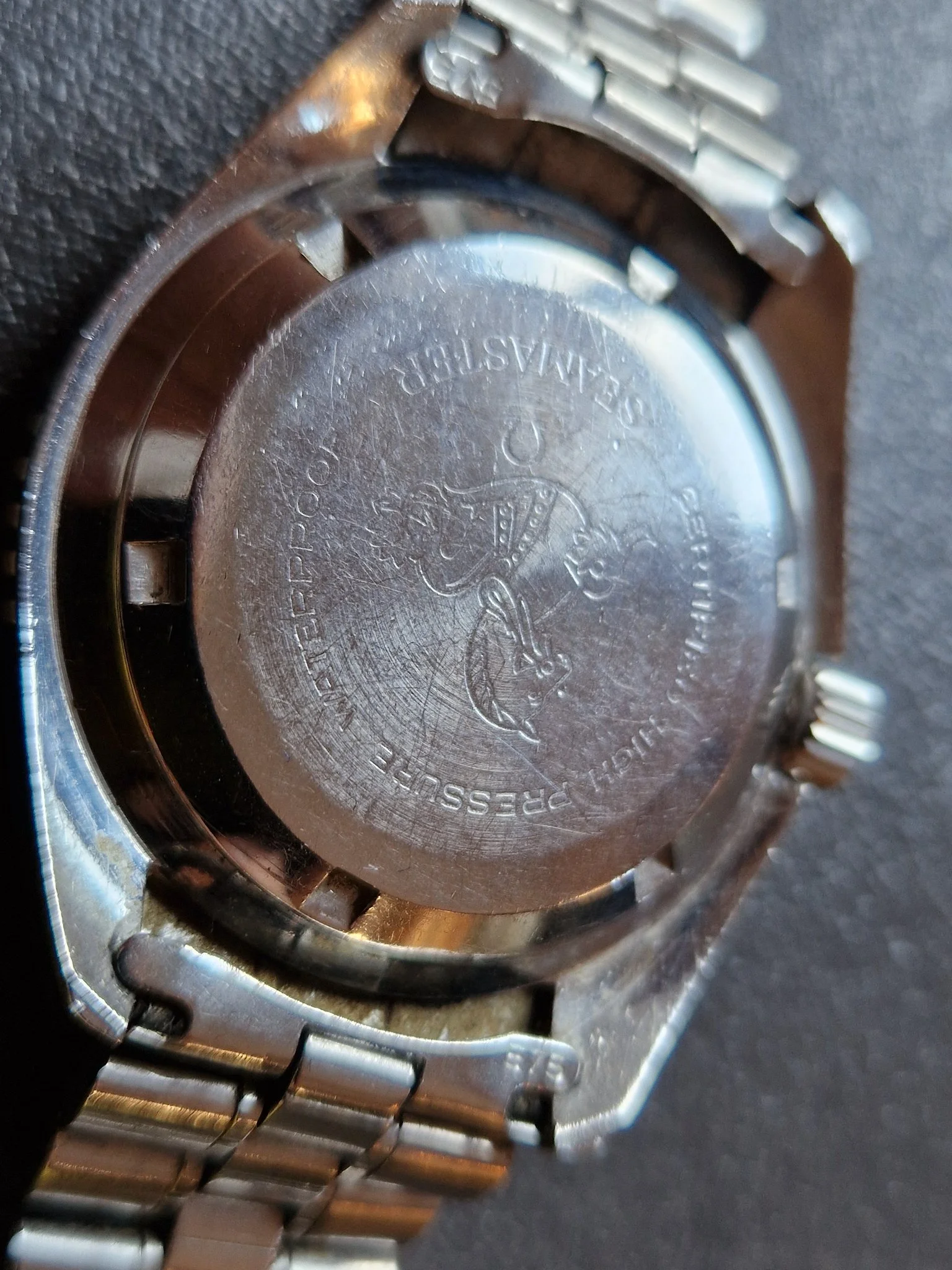

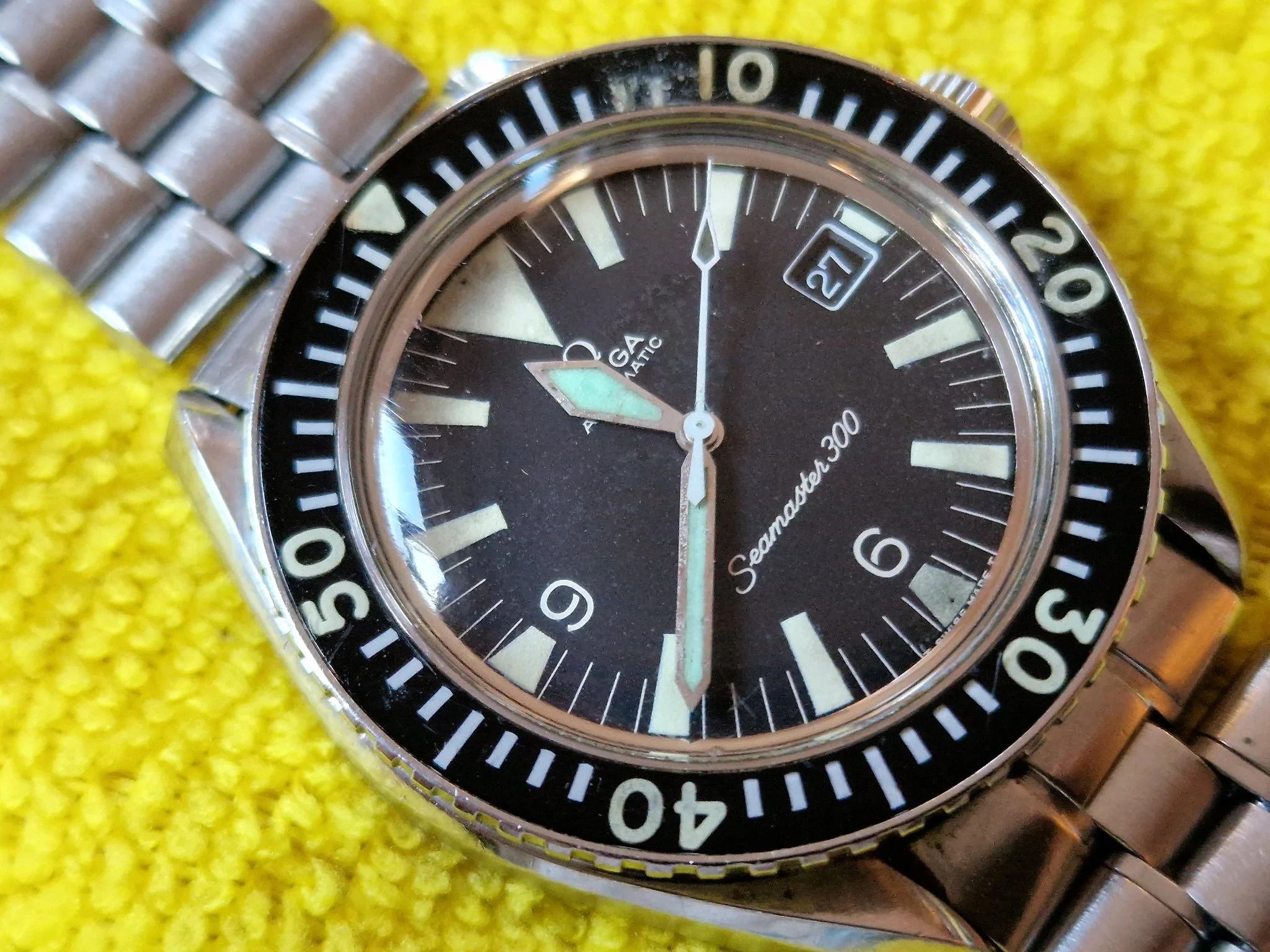

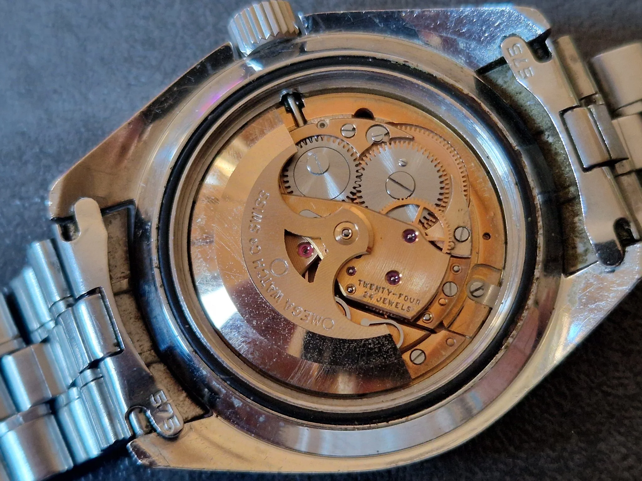

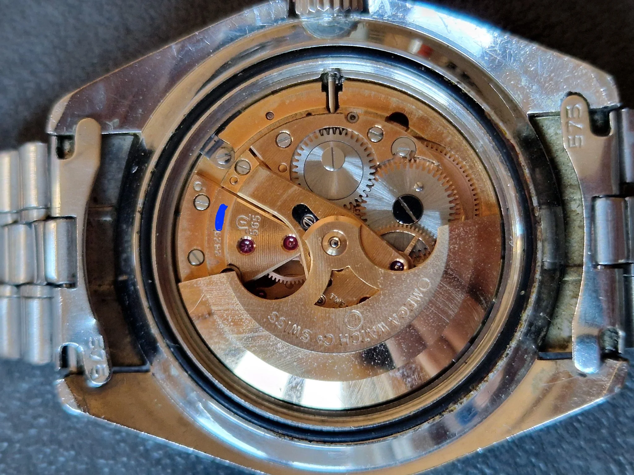

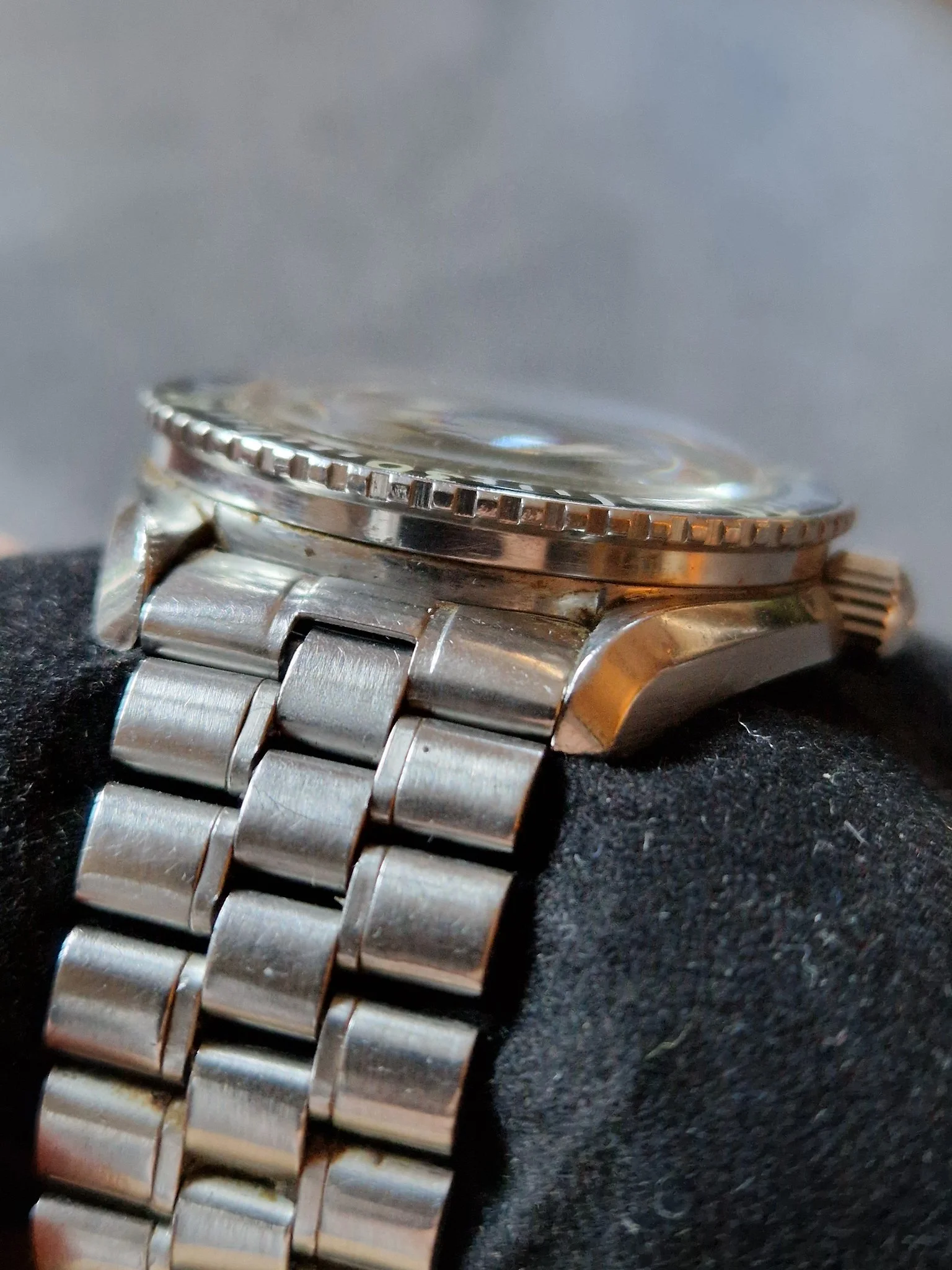

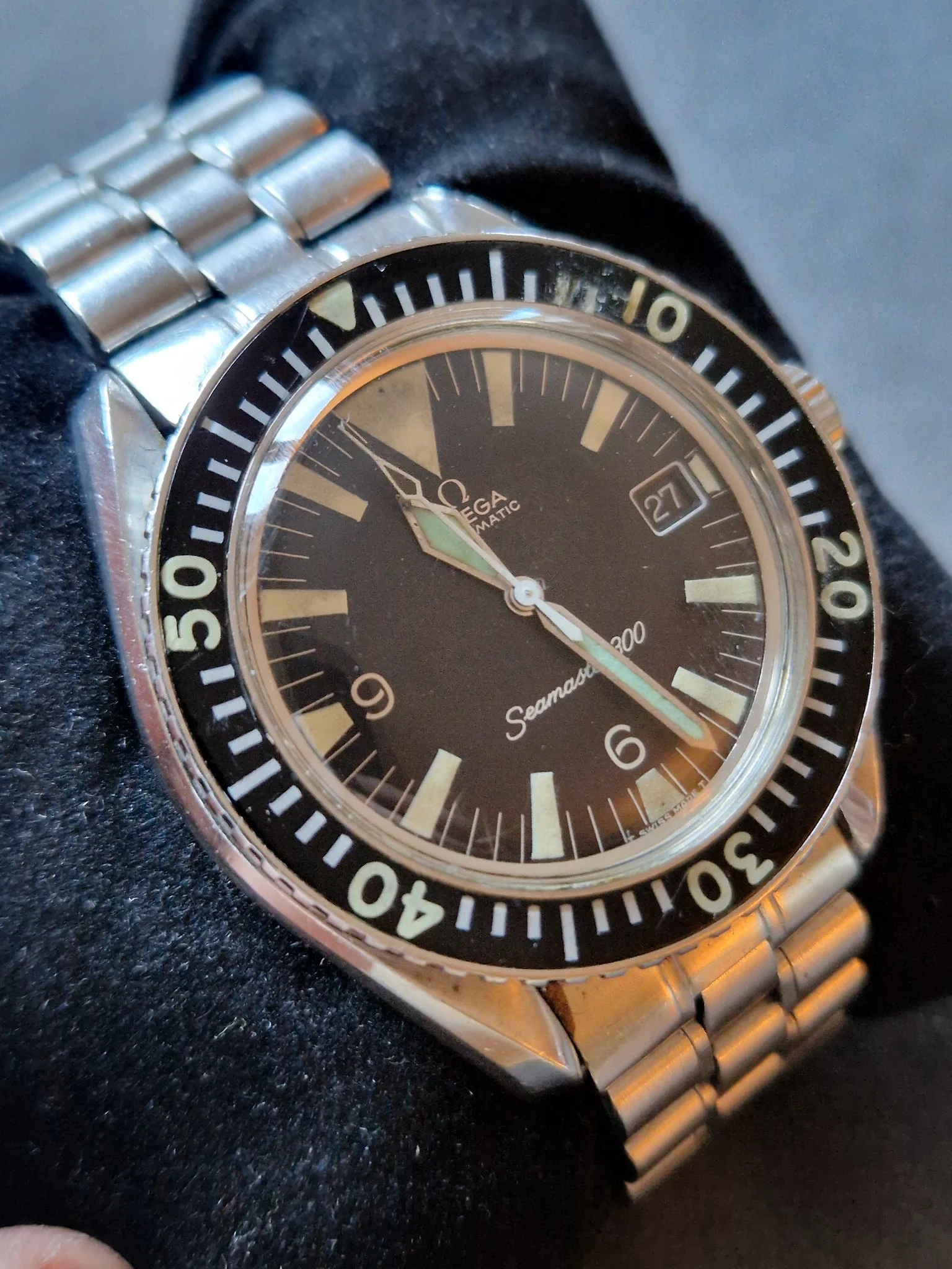

This is my first post on the forum as I just got my hands on a vintage Seamaster Big Triangle 166024 which I bought from the original owner family.
The watch is running fine including the quick set date function.

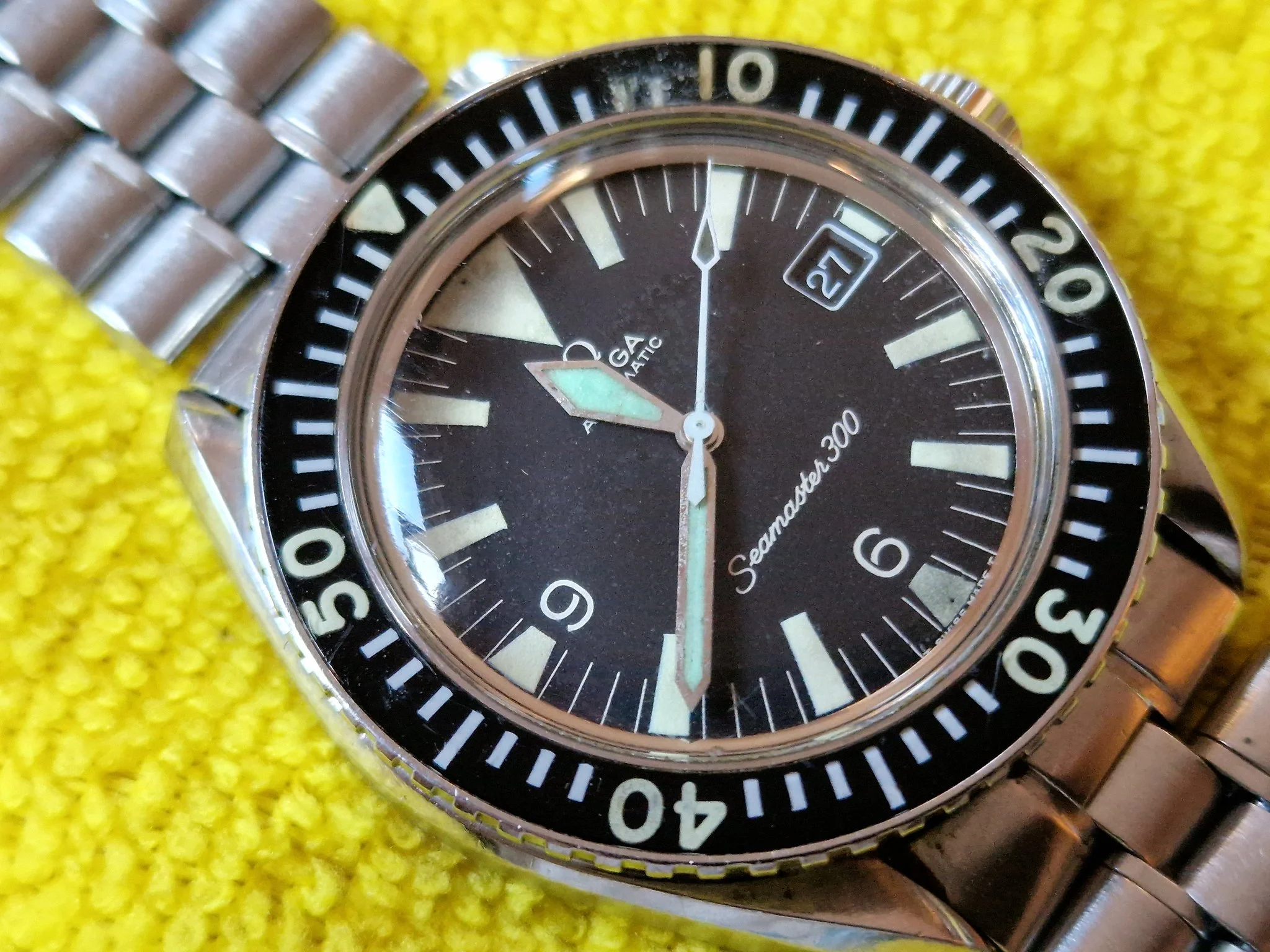

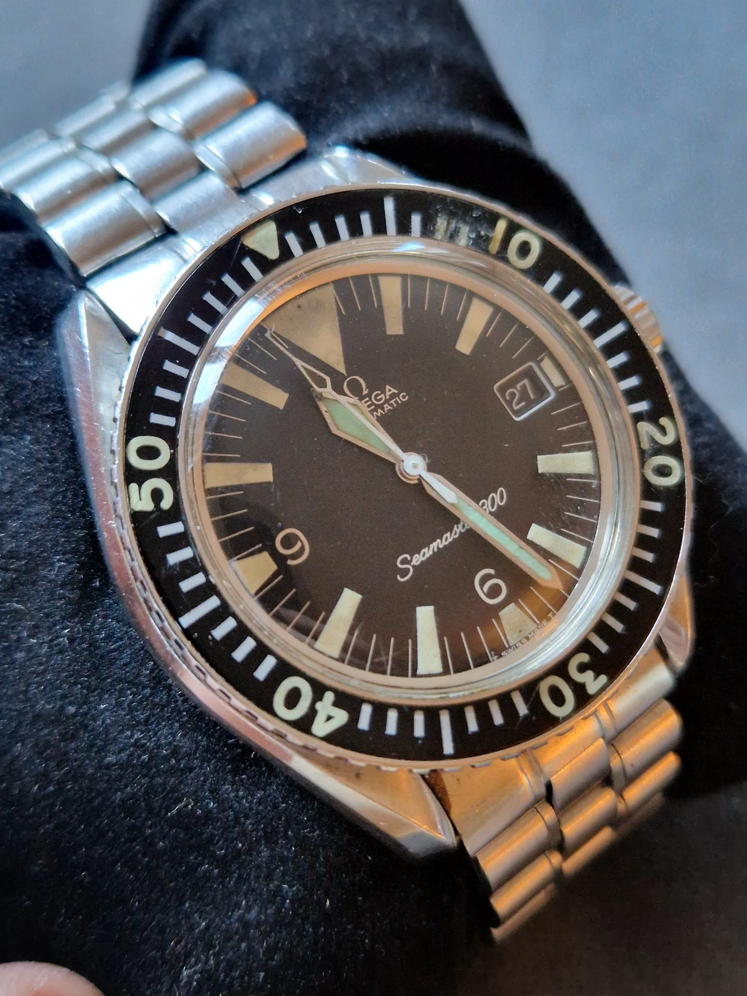

I would be glad if you could help me identify what may be not original to the watch.
From what I read I would say :

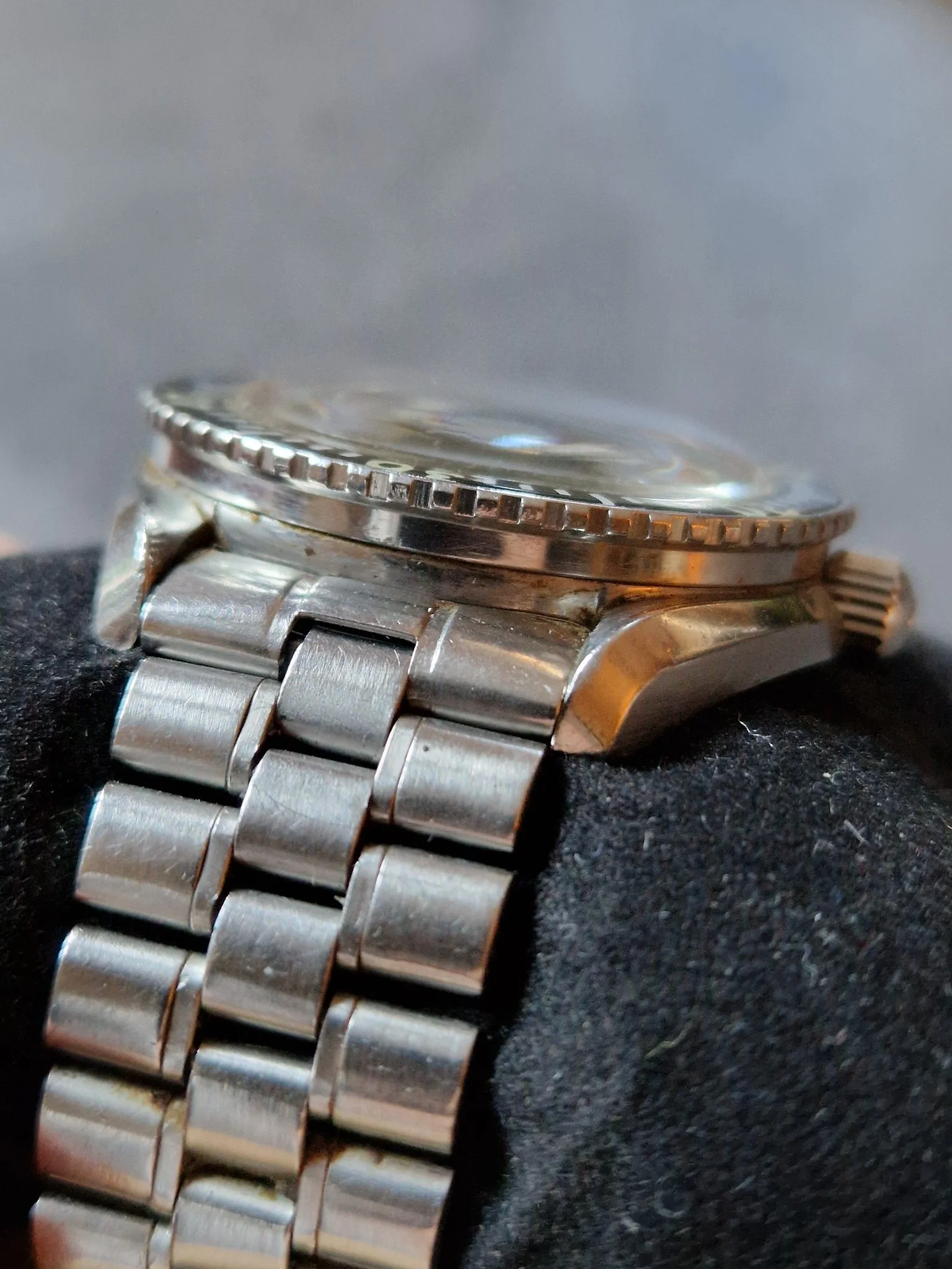

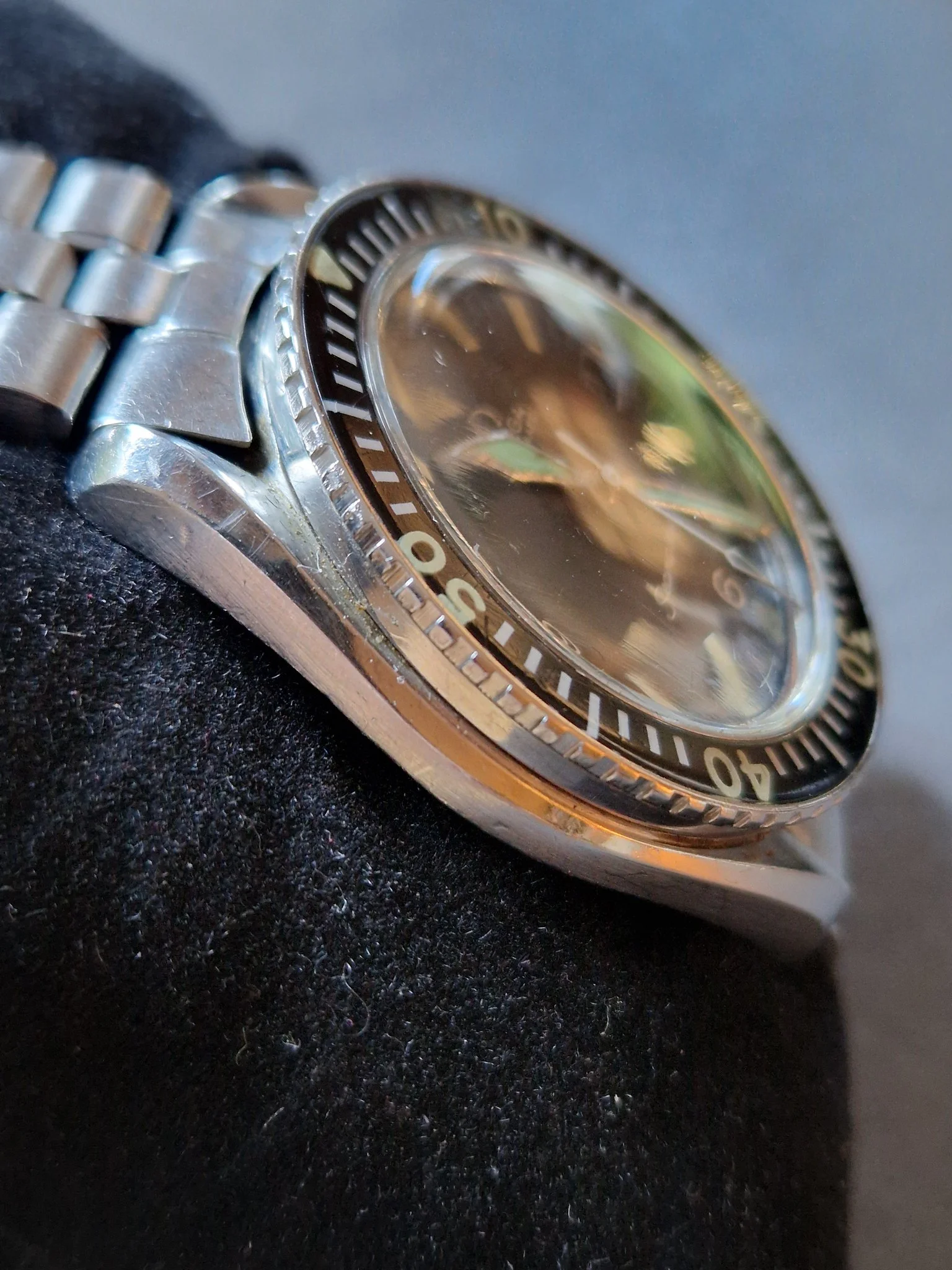

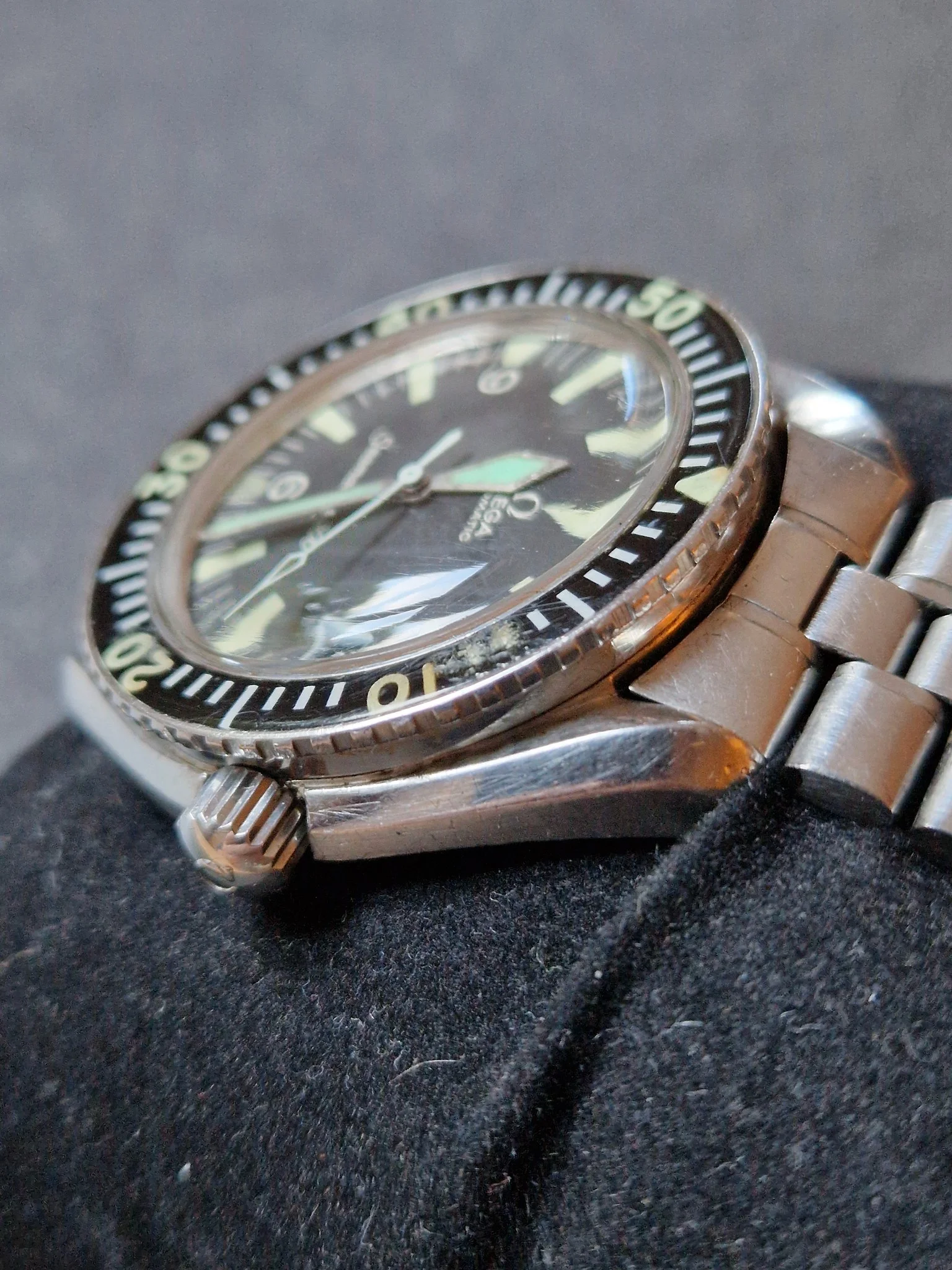

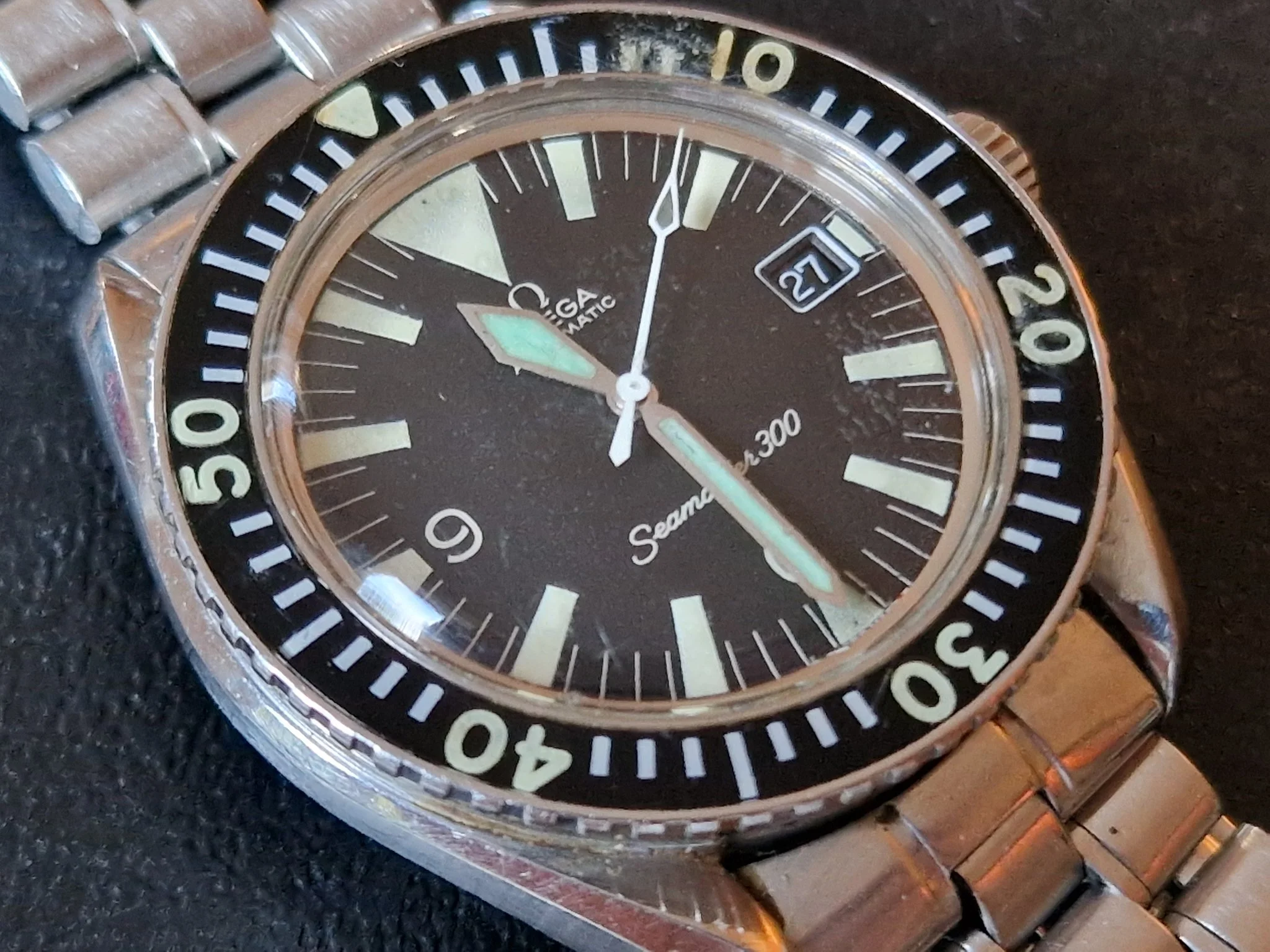

  • the glass has been replaced
  • hours and minutes hands have probably been relumed long time ago
Do you see anything else?

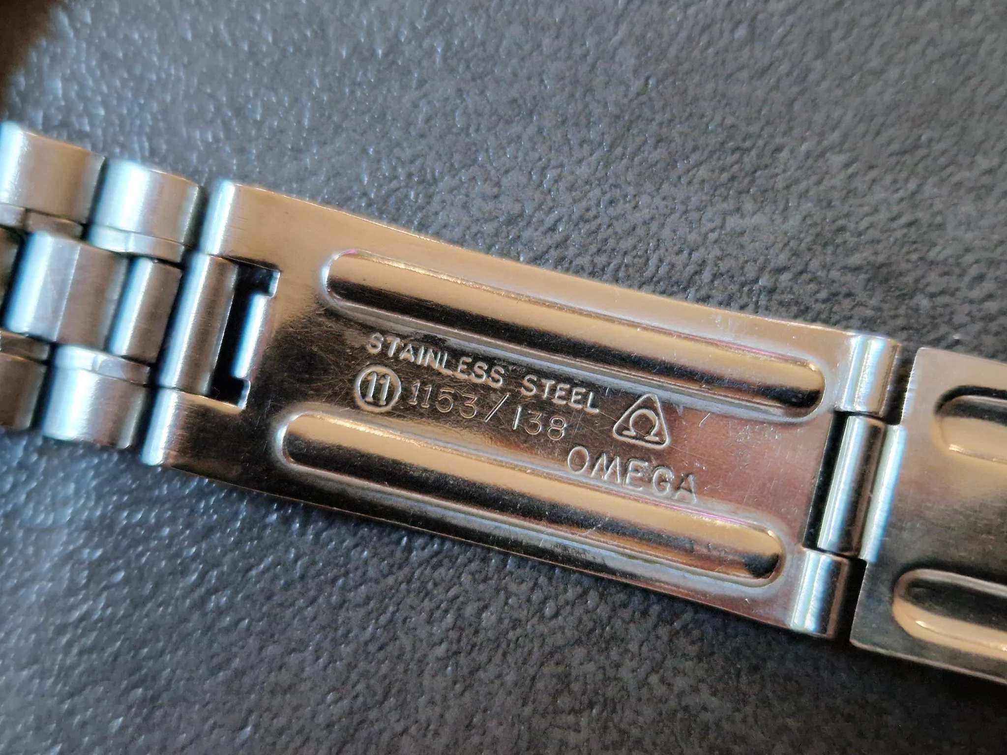

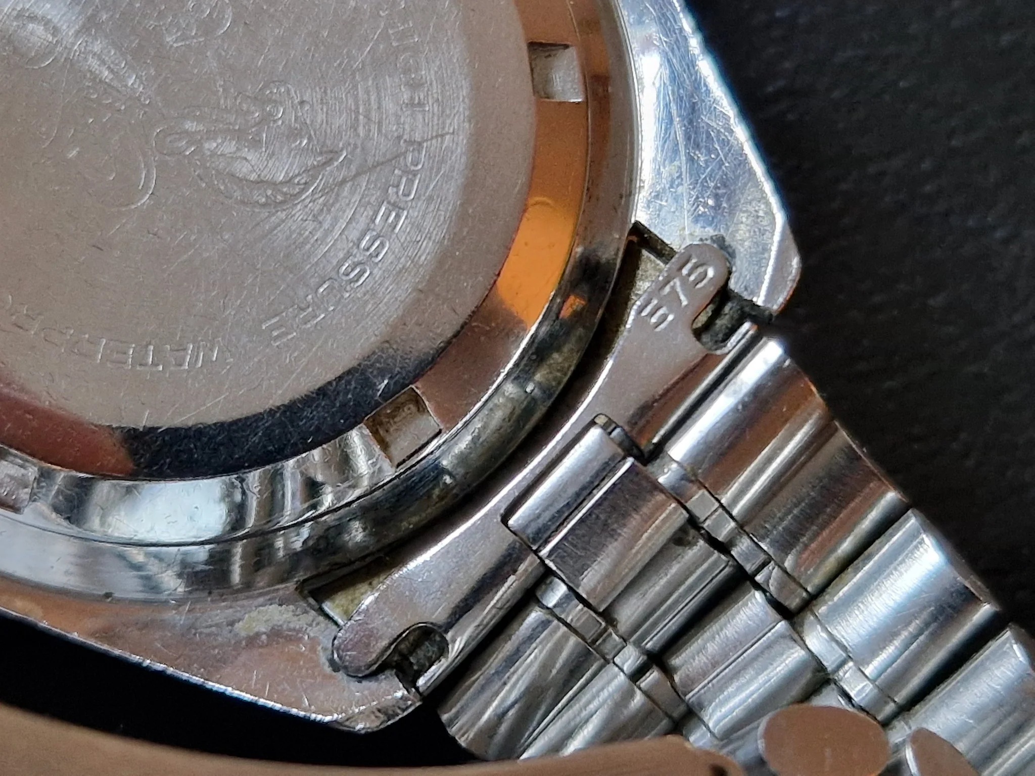

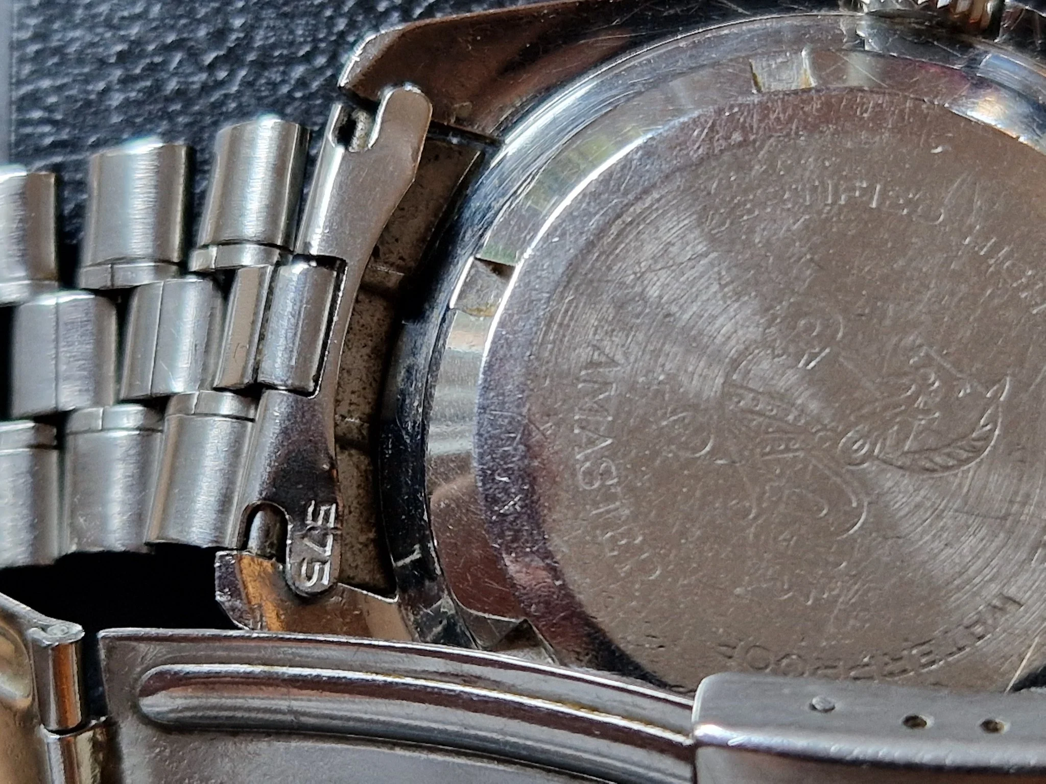

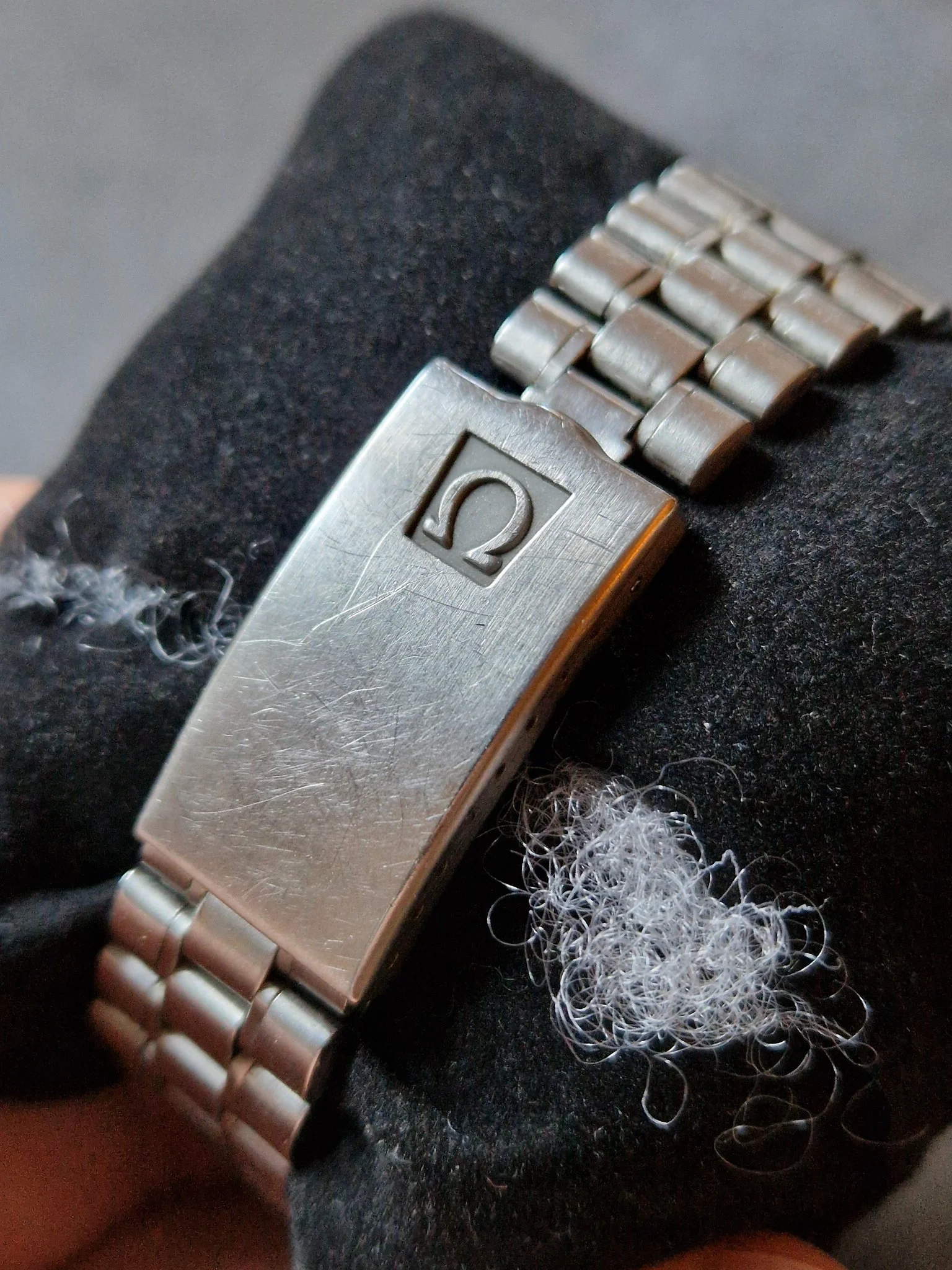

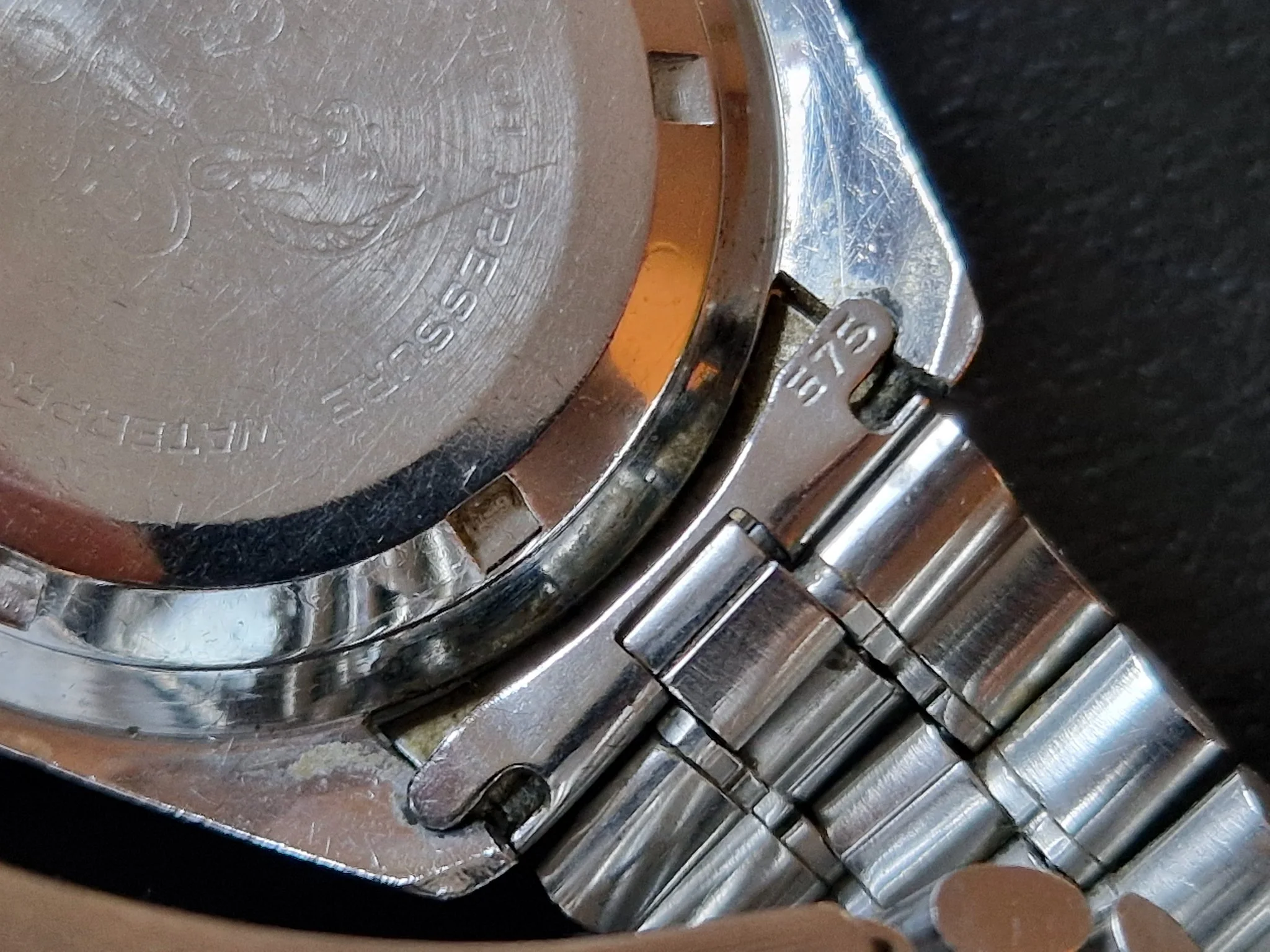

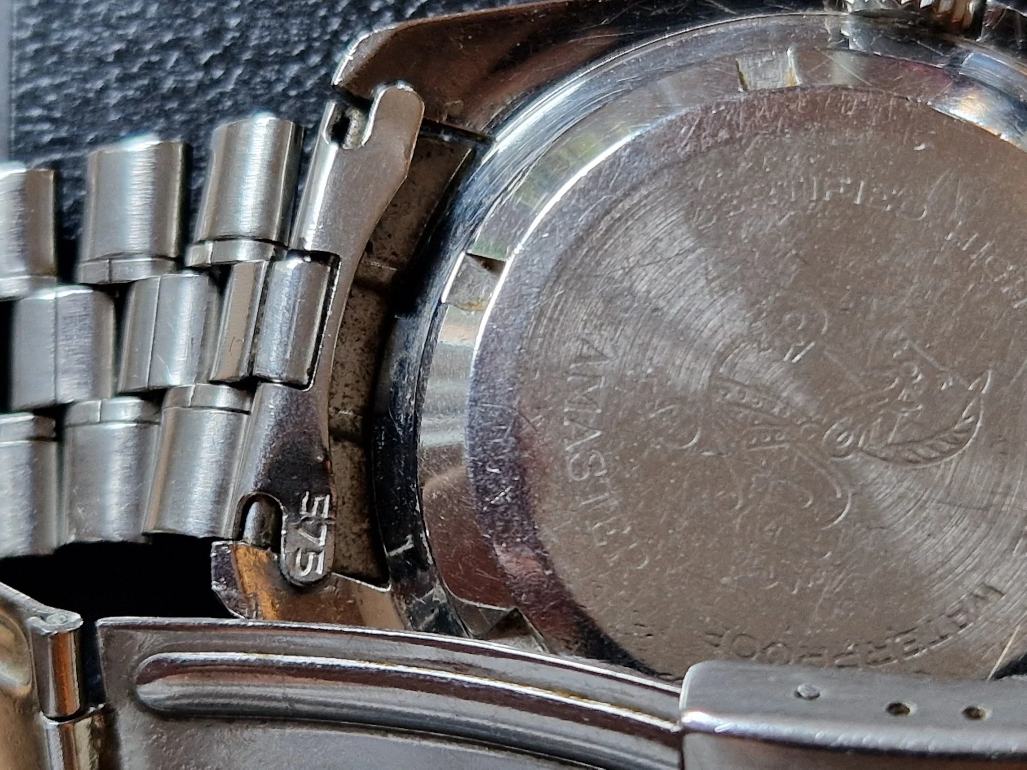

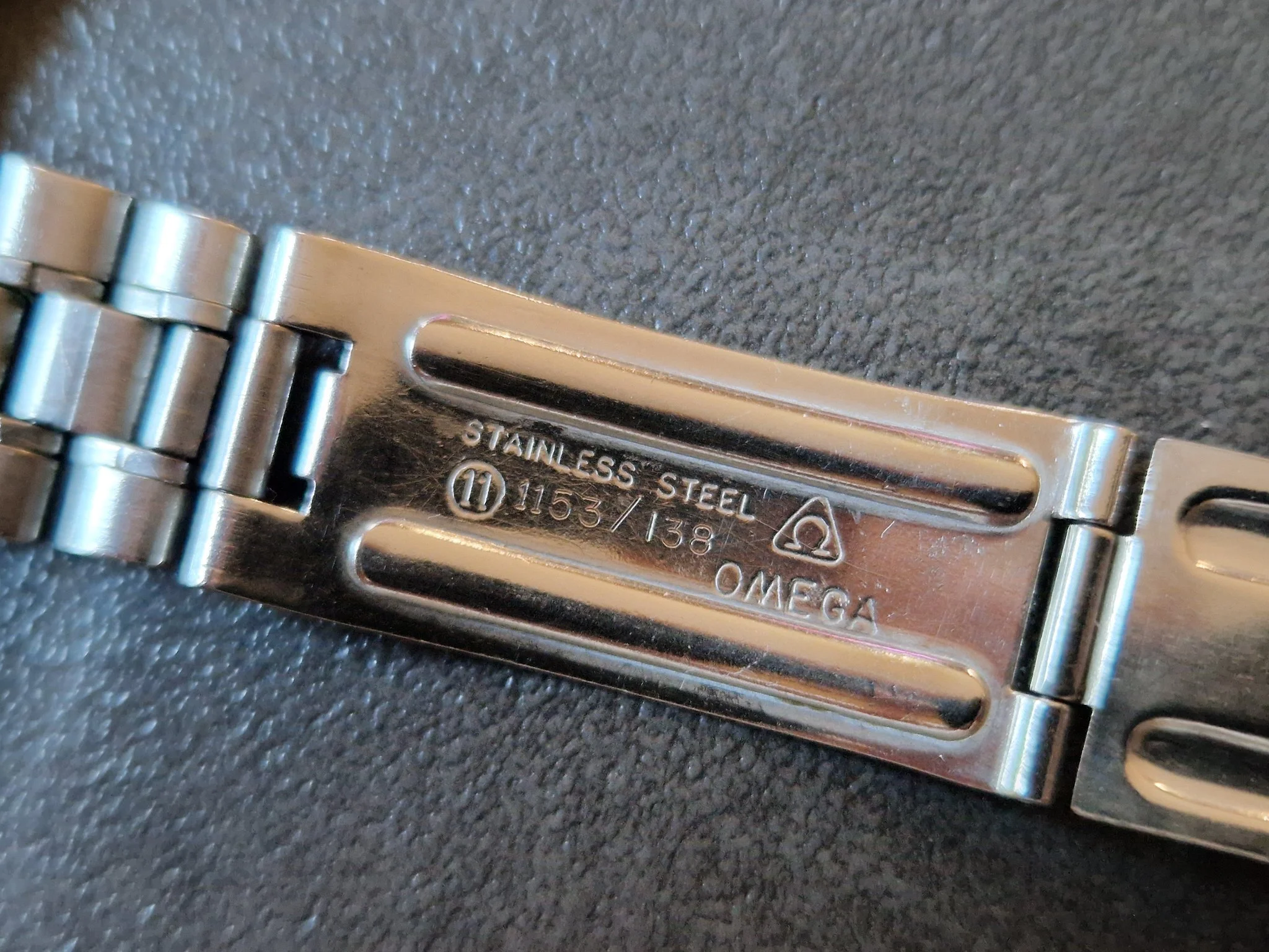

The band model is 1153/138 with 575 end pieces. May it be original to the watch, or at least been bought at the same time?

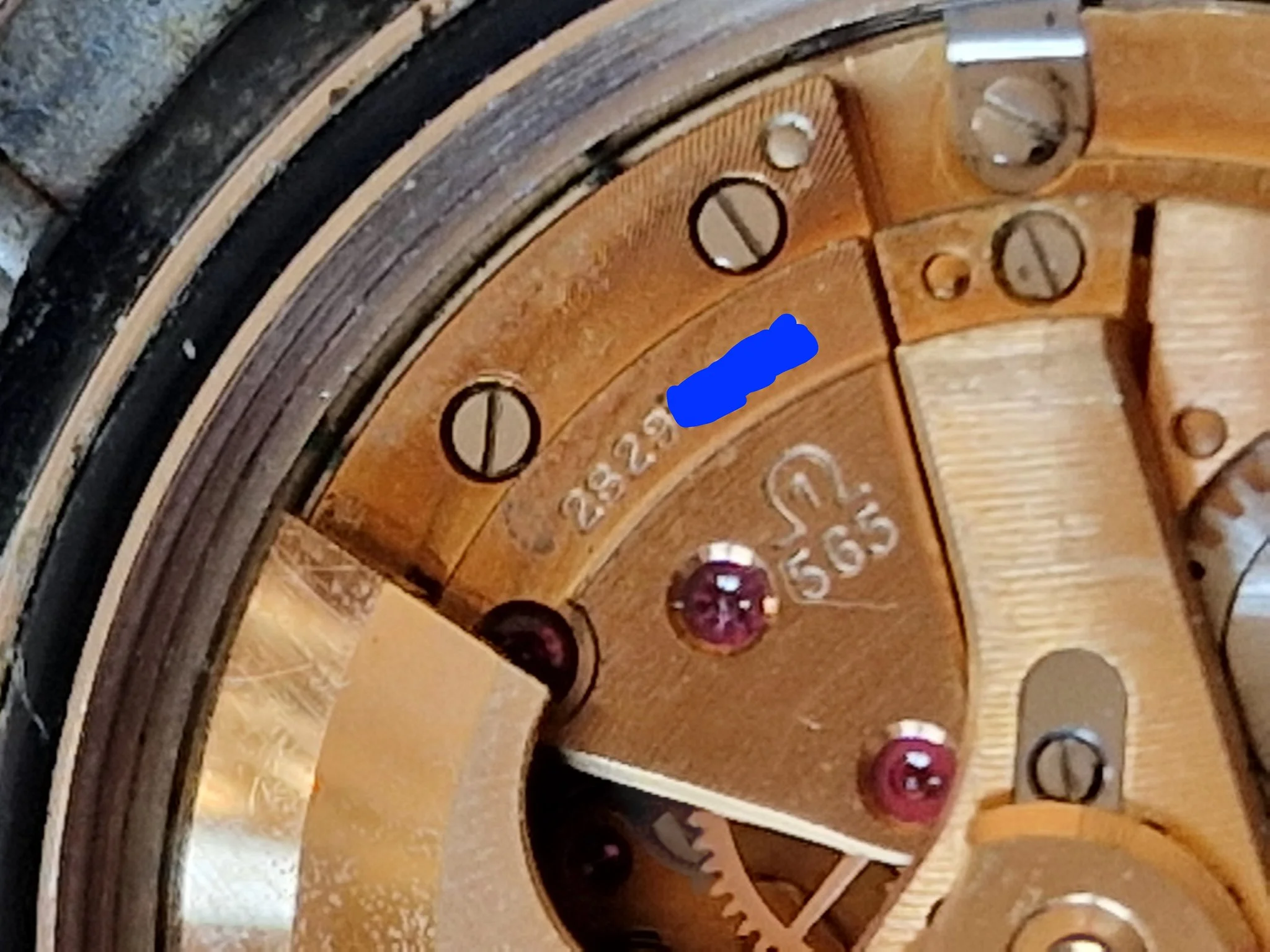

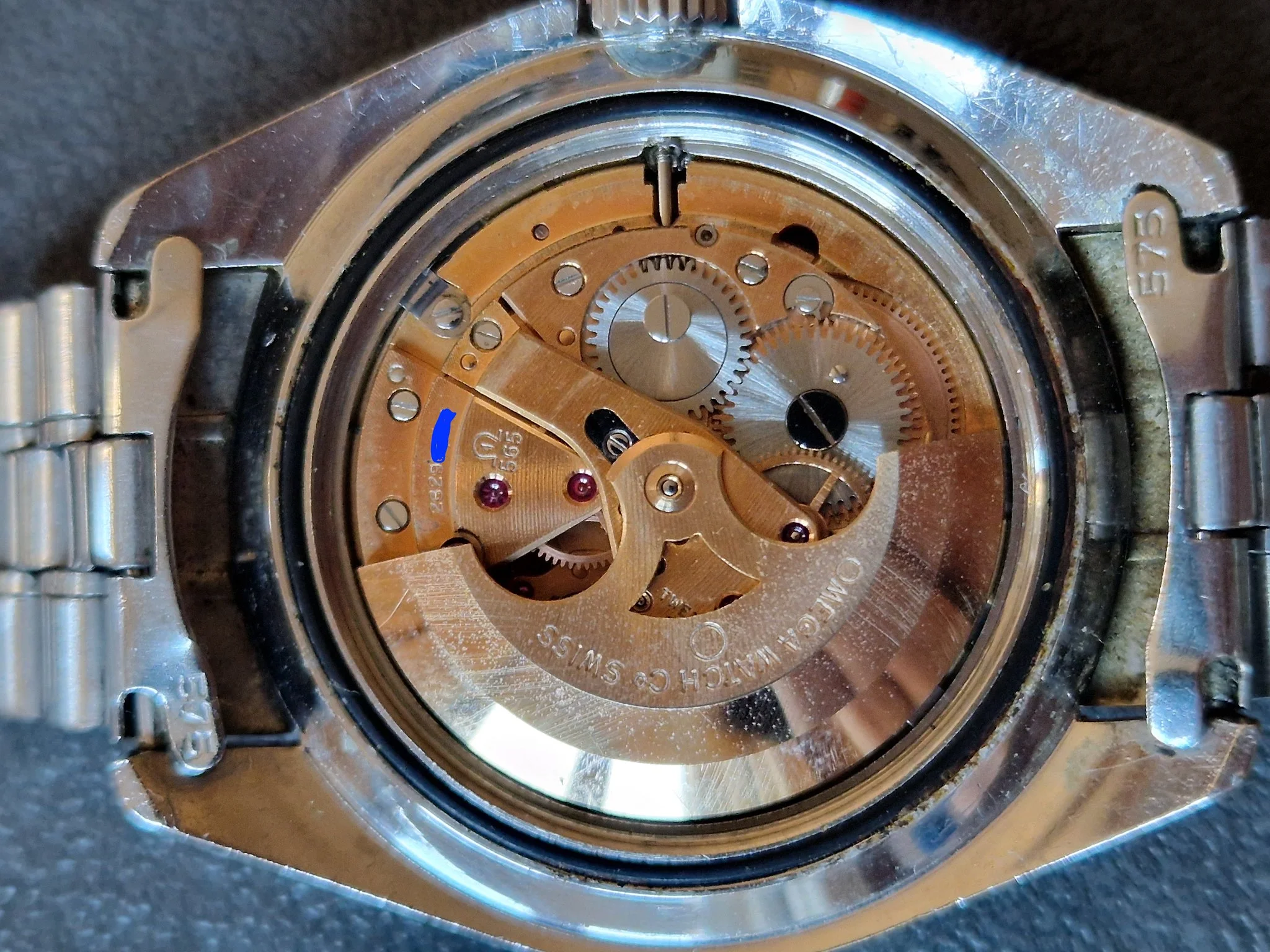

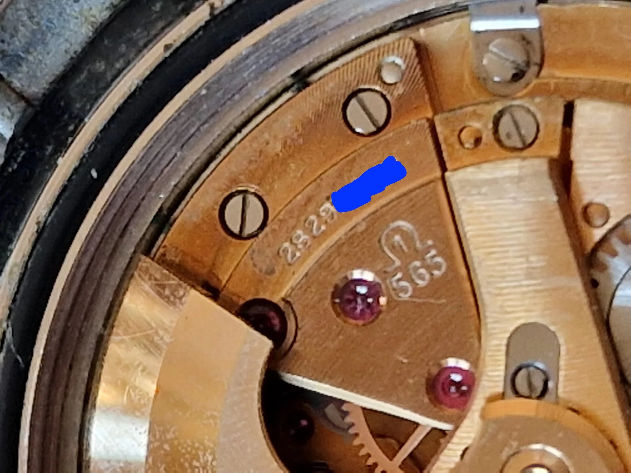

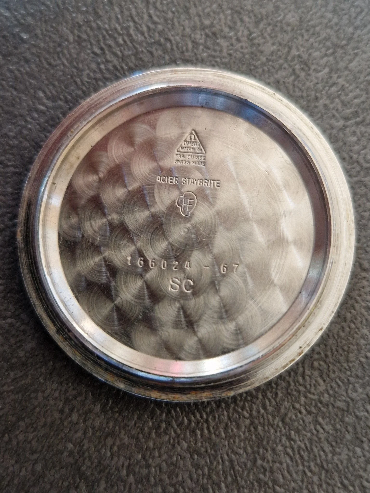

The serial number is 28,29x,xxx which I understand dates the watch from 1968 or 1969?
Many thanks in advance for all the information you will be able to provide me with! 🙂

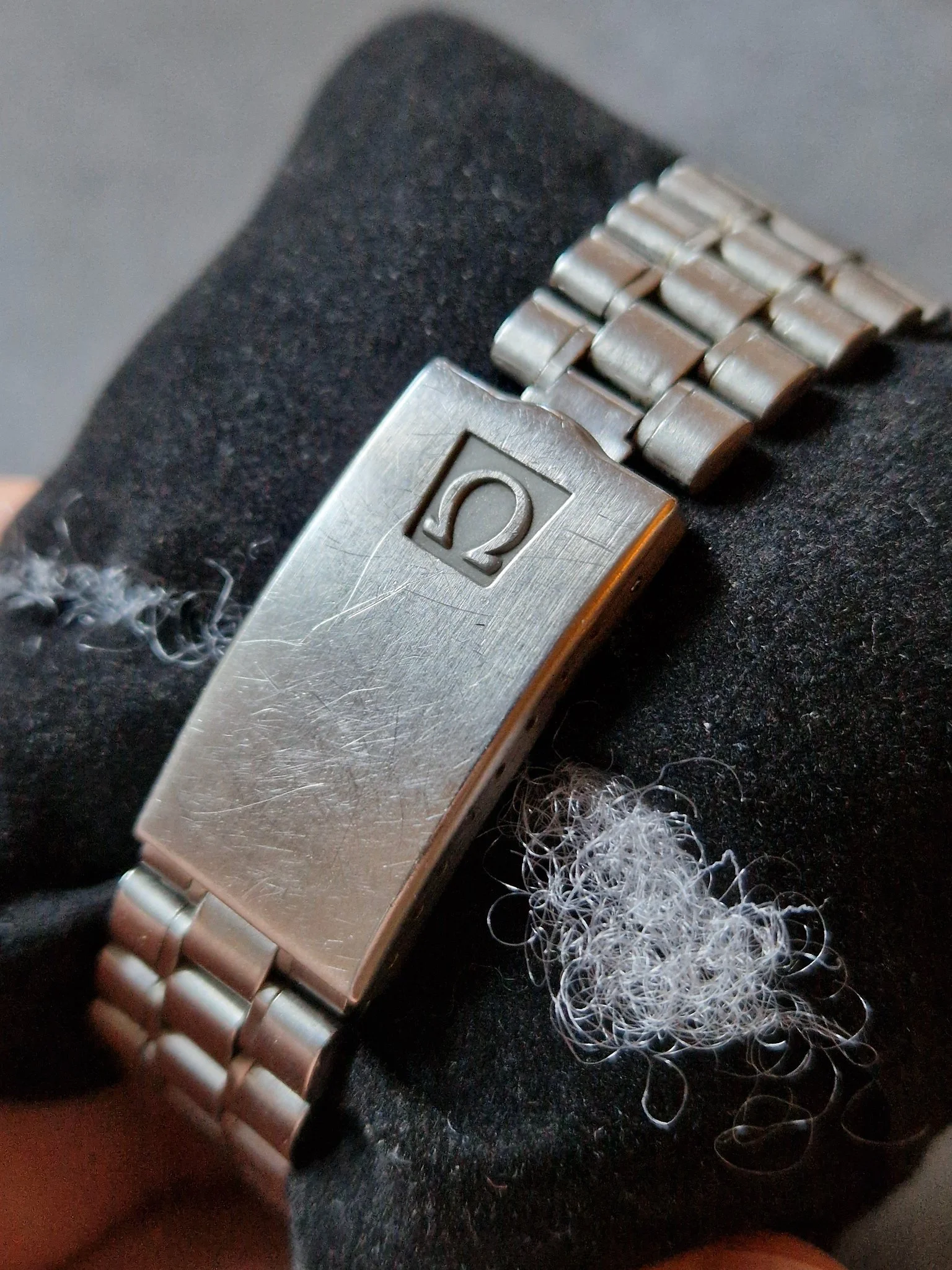

The bracelet looks a bit like a mash-up. I remember the 1153/138 being an oyster style integrated bracelet for the Dynamic series, so maybe period correct but as far as I know not for a 166.024. These came on 1039 or 1171 IIRC. The bracelet looks more like a 1116, the 575 end links are the vintage execution, never seen them on a 166.024 either.
Hope that helped a bit, kind regards,
Max
14
Many thanks for your comment Max, I does help! 😀
Indeed, I had read the 1153/138 being an integrated band for the Dynamic looking nothing like mine
I understand the 1116/575 was provided with Speedmaster from 1968 to 1971/1972
So indeed period correct but the clasp may have been swapped?
935
1,059
Yes, maybe a change of the clasp and yes, period correct but not „correct for the model“,
kind regards Max

The owner family told me they always knew the watch in this condition
So maybe be bought the bracelet at the same time he bought the Seamaster
I suppose the hands lume can not be original?

I think it’s as you say and generally original bar the hands lume. I think the bracelet and Endlinks are likely original but the clasp has been swapped. Not terribly unusual as these did wear out or break.

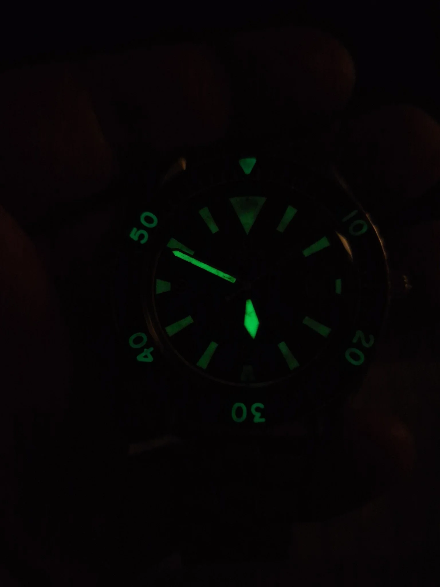

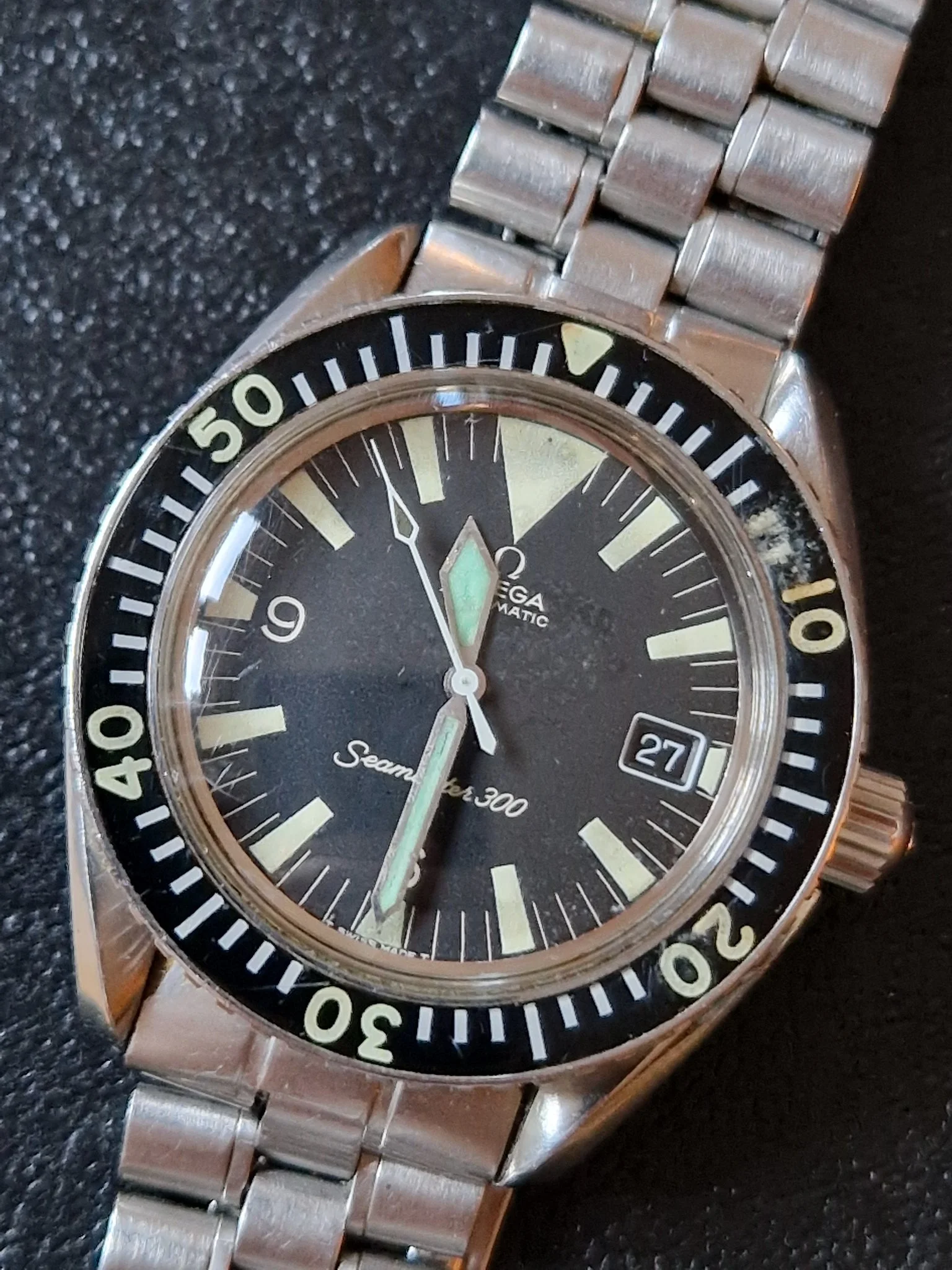

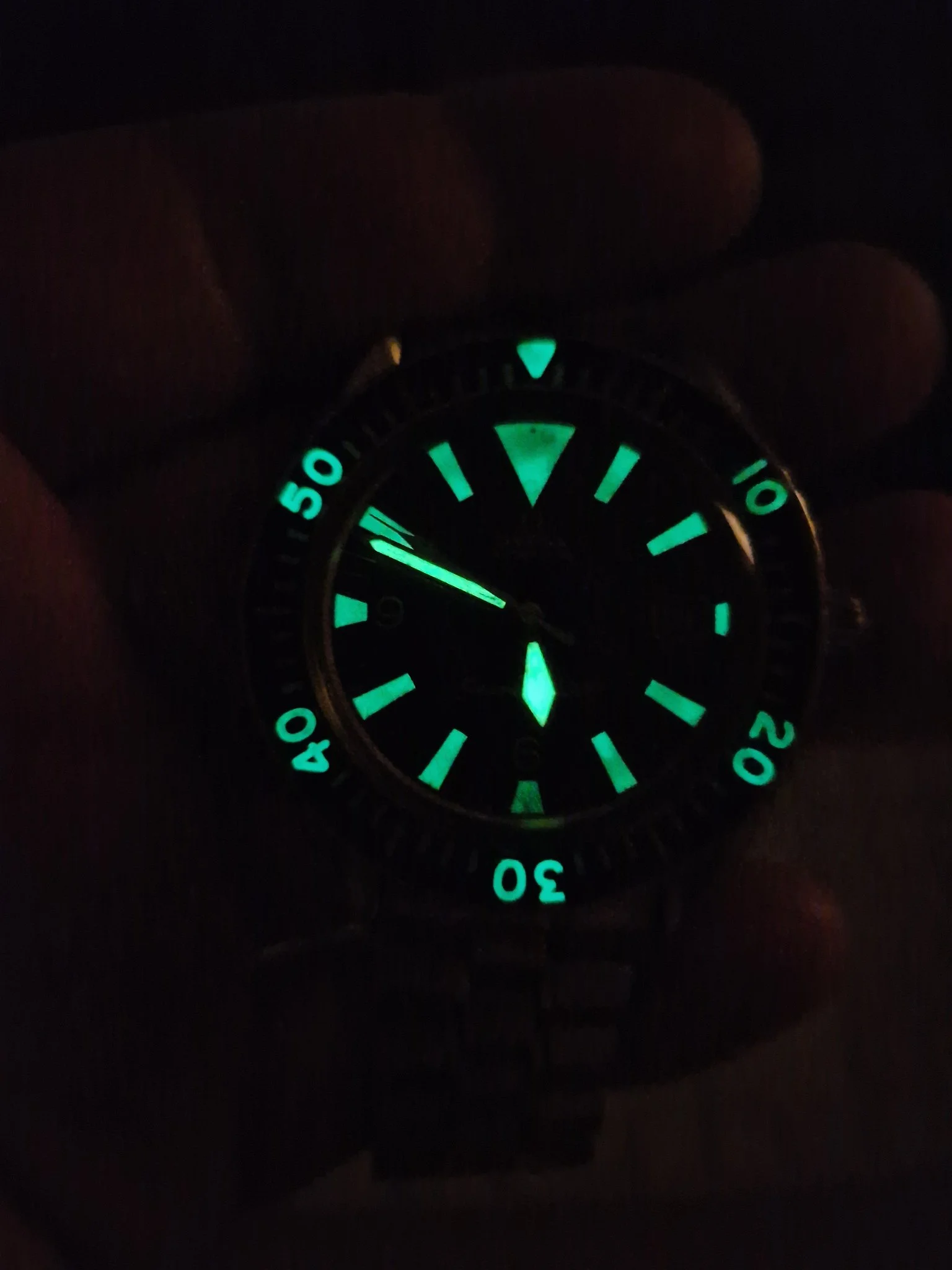

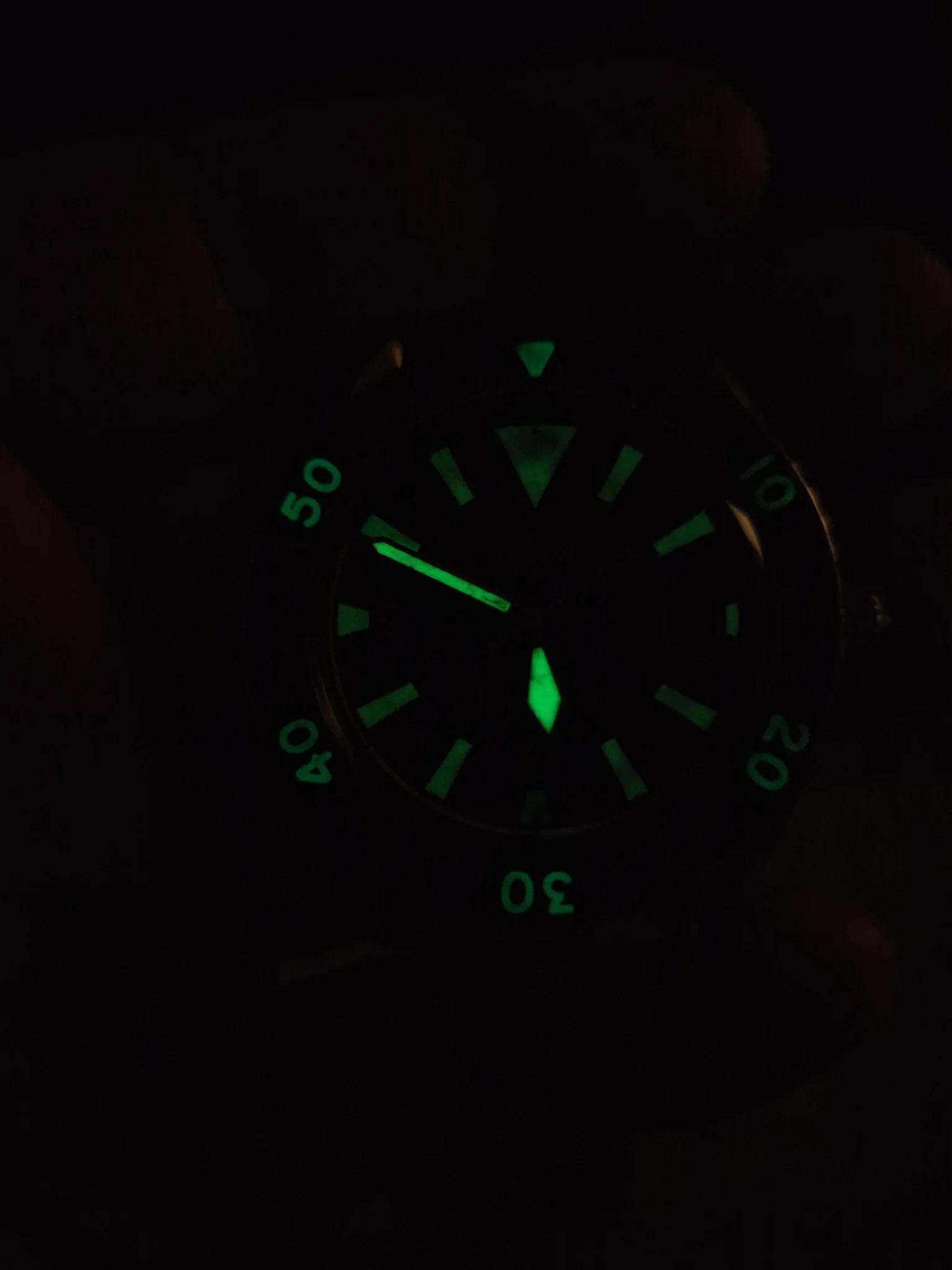

Regarding the hands, use a UV light source in a dark room and you might see that the hour/minute hands glow in a different colour and keep glowing for a much longer time than the markers. That would be a hint that they are Superlumuniva or similar,
kind regards Max

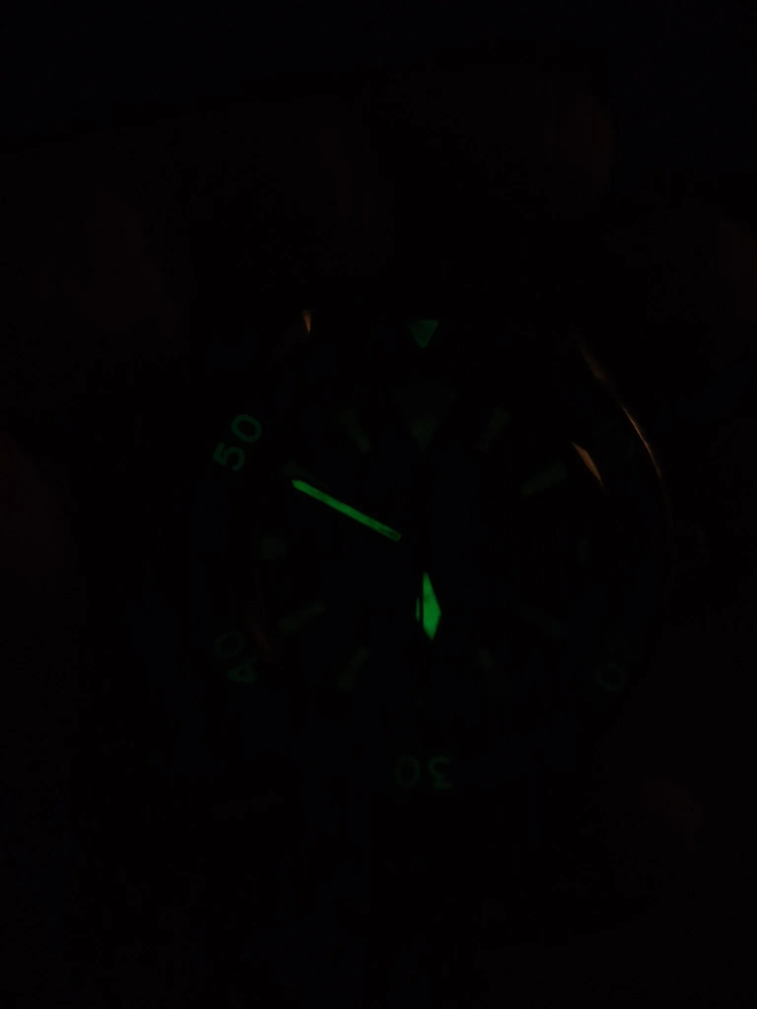

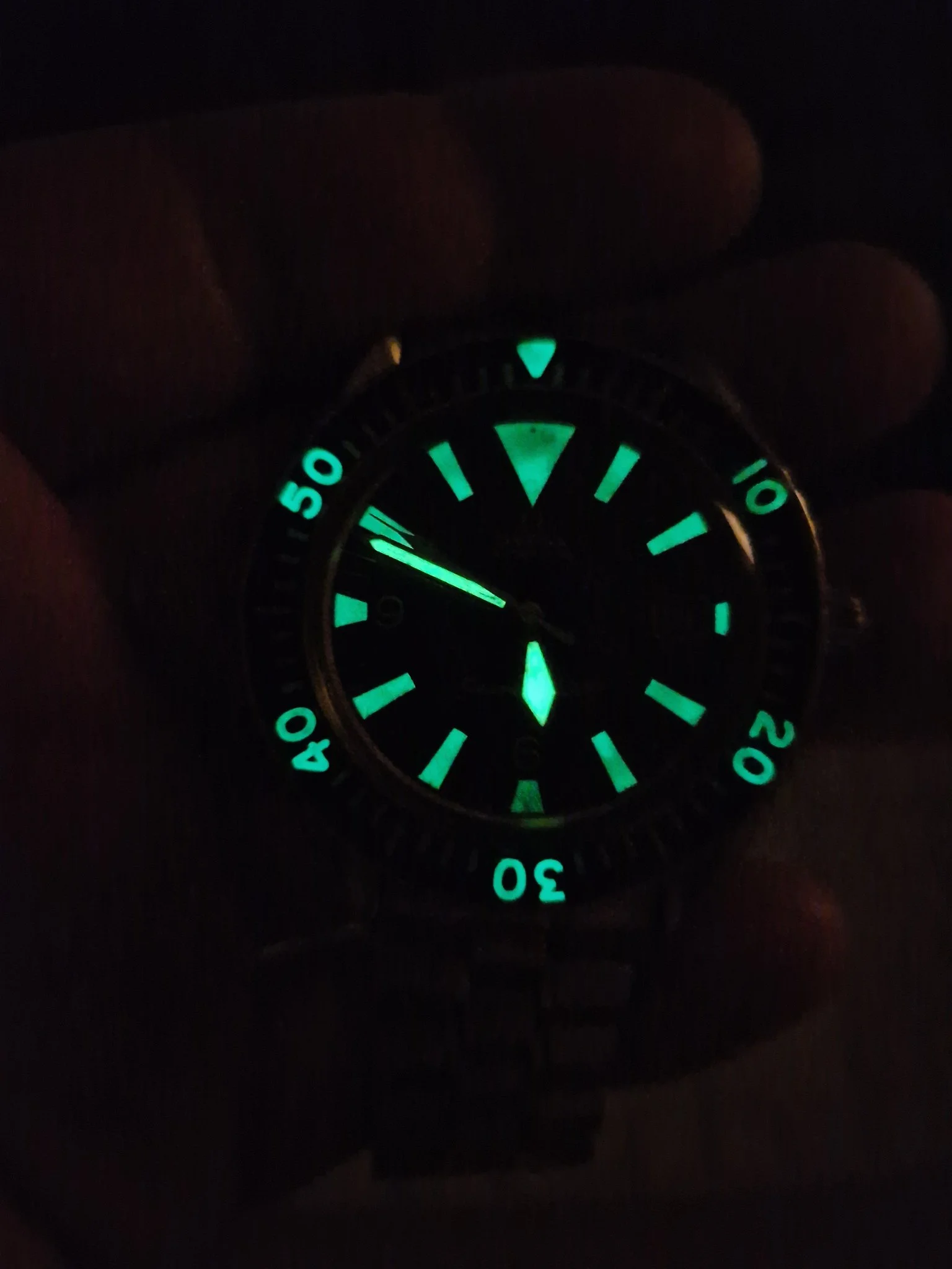

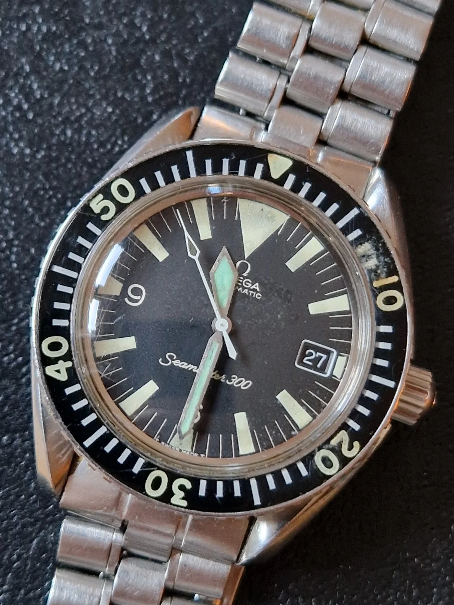

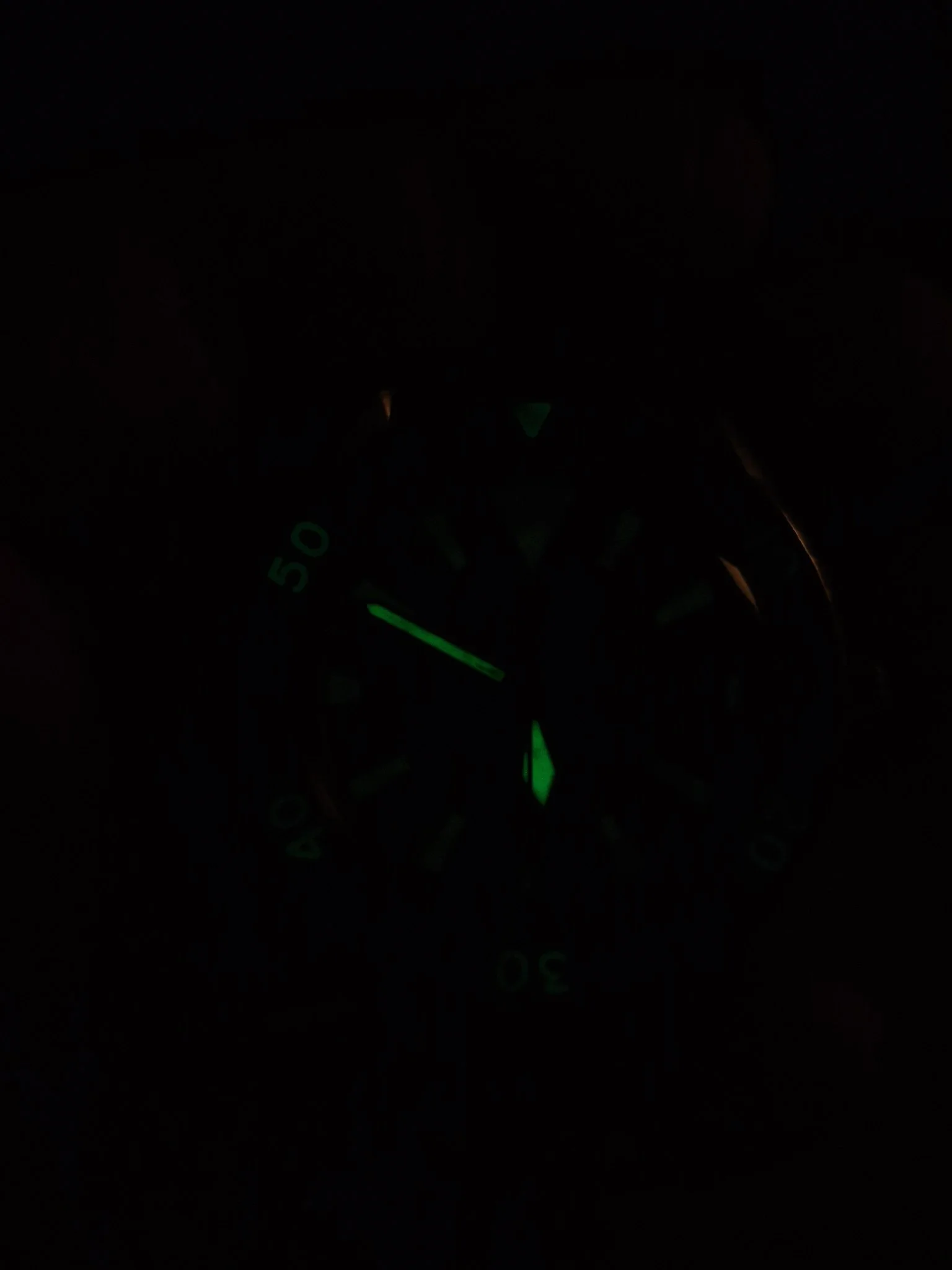

Here is what happens when I expose the watch to a spotlight and then switch if off
The 3 photos have been taken over about 30 sec in total
Hands indeed glow brighter and longer but still fade away quite quickly
But I notice the seconds hand do not glow
935
1,059
I see, could be painted with no lume grey colour,
kind regards Max
3,679
8,014
was this UV light? I would say hands are tritium so probably relumed a while back.
14

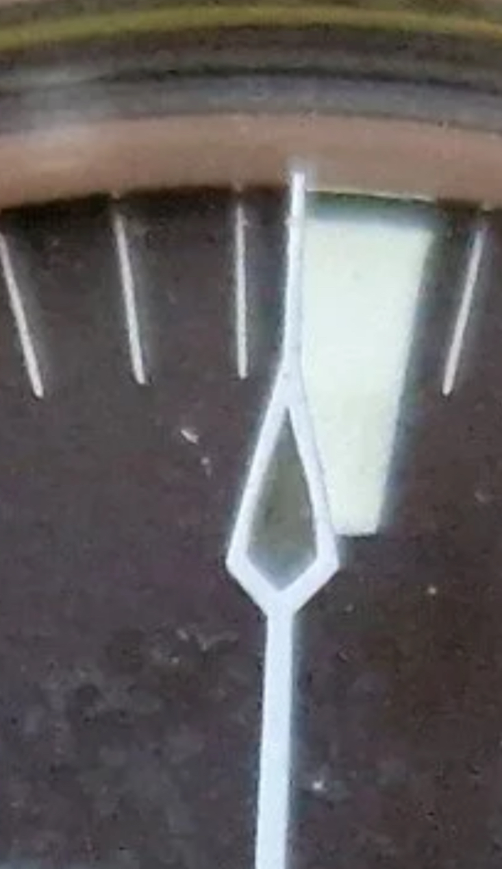

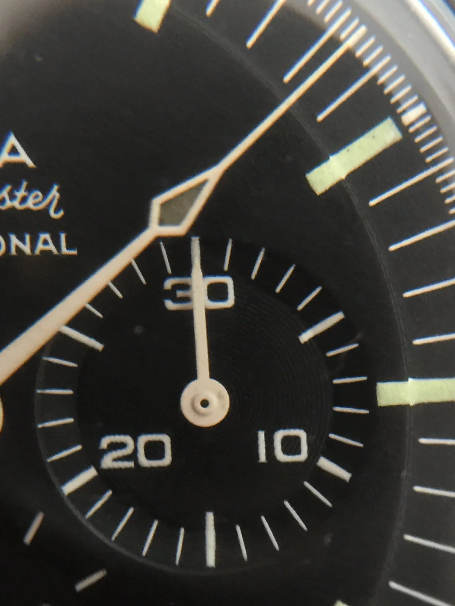

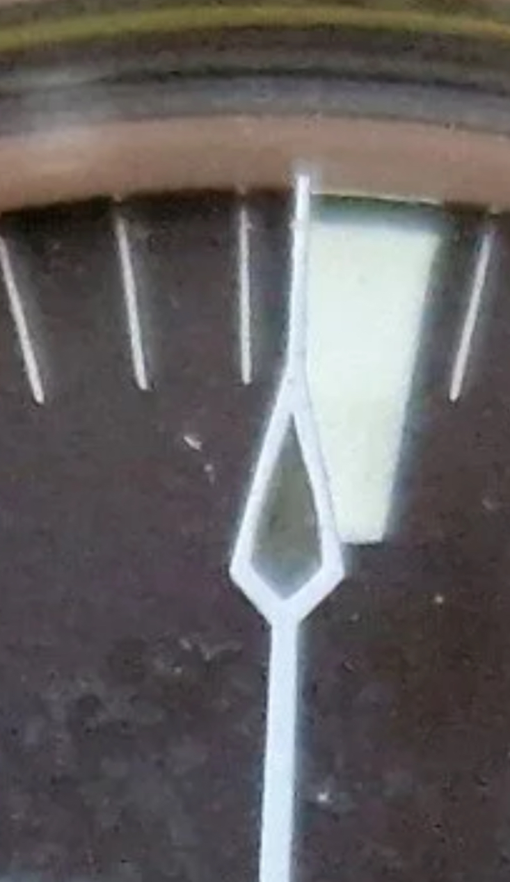

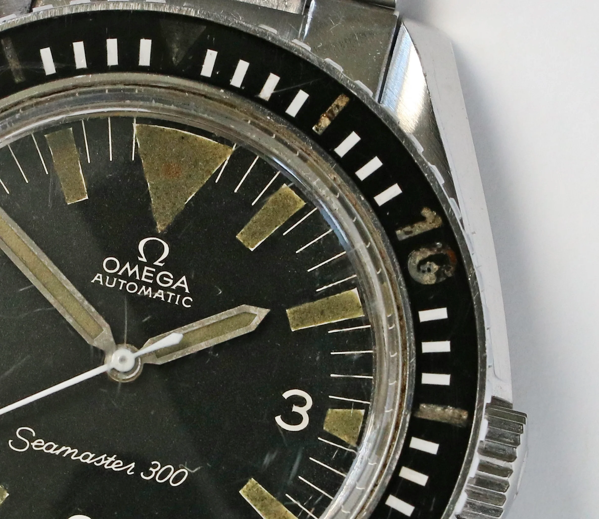

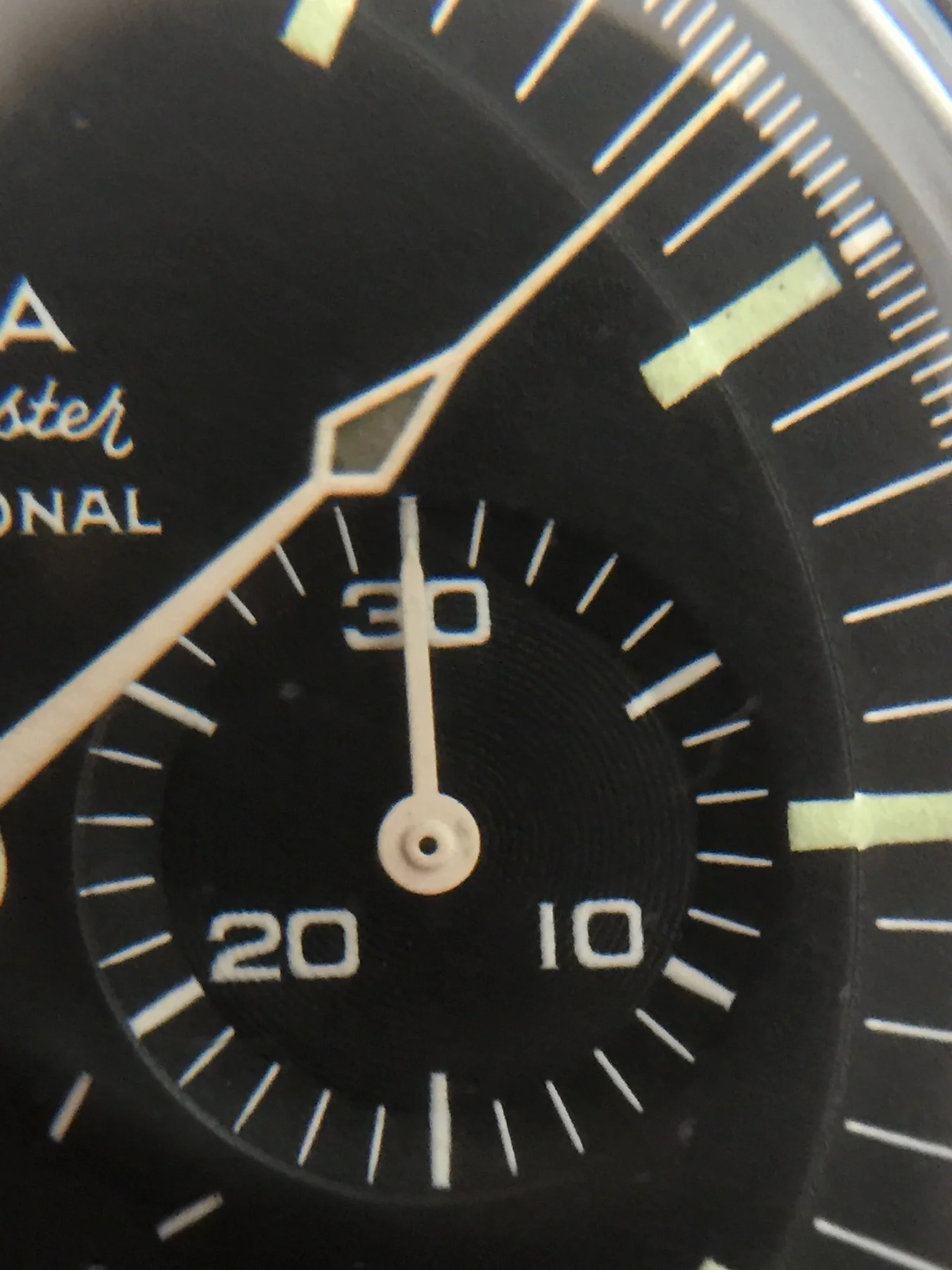

Do you think the lume of the seconds hand could be original?
It looks like the one on this Speedmaster (photo taken from the thread "Speedmaster Hand Lume Color Variation Picture Database" on this forum )
14
No, it used a standard desk light as I do not have UV light
I thought too they were tritium
And it may be quite old as you can even see some light cracks on the minutes hand lume
308
231
2829 is the last batch of 166024, late 1969/early 1970.
The second hand is indeed the only original thing in my oppinion. Minute and hour hands were relumed and the dial is an old service piece.
14
Thank you for your comment
May I ask what makes you think the dial is a service piece?
3,242
6,798
I doubt dial and bezel (both original but later) and hands (lume). Tritium is 95% dead after 55 years.
What is the asking price?
308
231
Experience. The dial was replaced, hands were relumed,as the watch had some moisture in side and the tritium was deteriorated. The bezel is genuine, as should be for this case/year. This type doesn`t age much.
