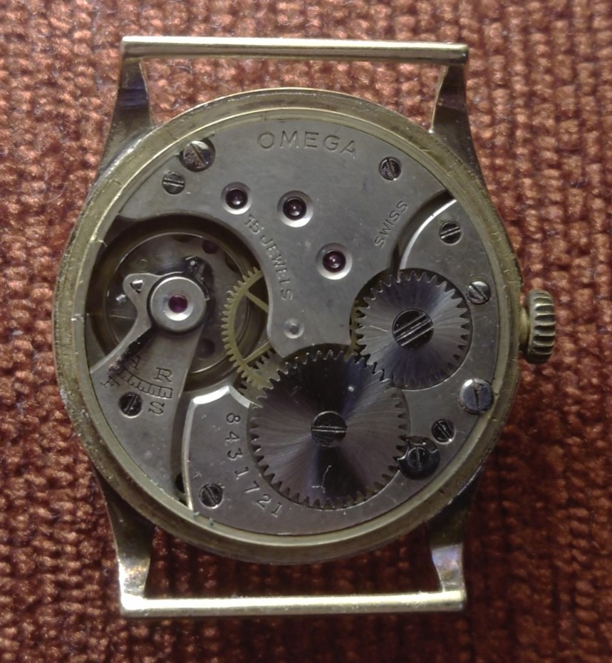

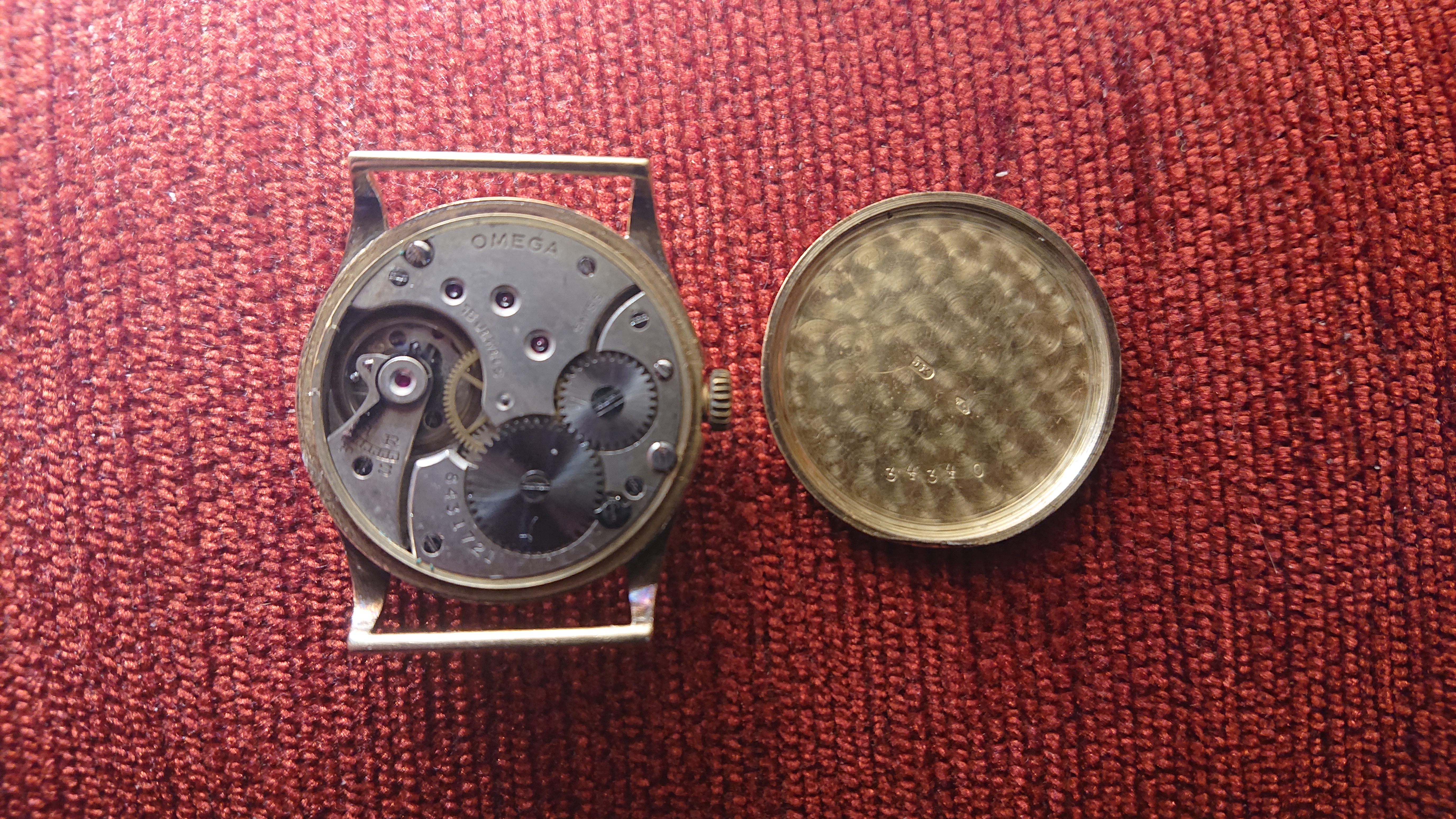

Inherited ladies' watch. Can't find anything useful about it on the web. Would anyone please help? I think it's from the 30s. Reference (I think?) on the back plate is 34340.

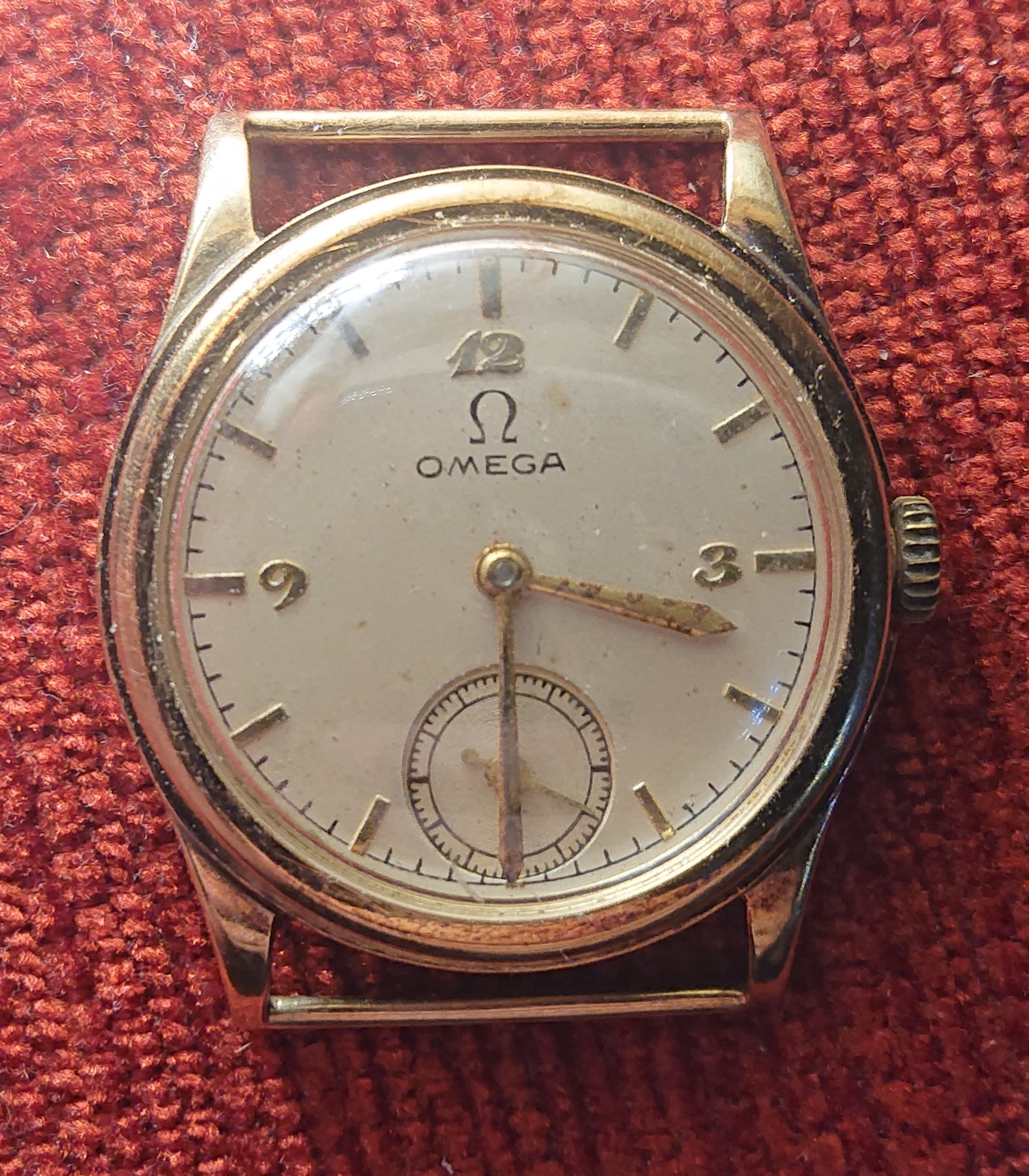

Hi,
Caliber 26,5. The case may be made of 9k gold. It is not Swiss made. I cannot read the hallmarks.
Unless there is a huge distortion due to the glass altering the pic, the dial has been redone in the past.

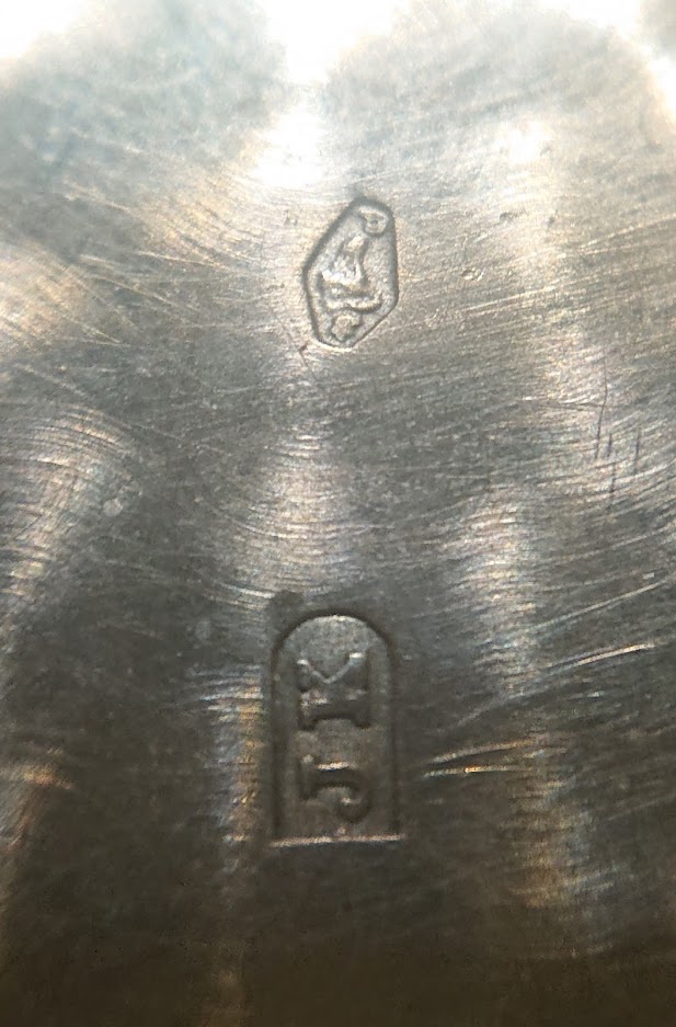

Hi François,
Thank you. Shot a macro of the back plate. I don't think the owner ever had it refurbished, but it's too late to ask her now. I don't see at all what the hallmark could be.
