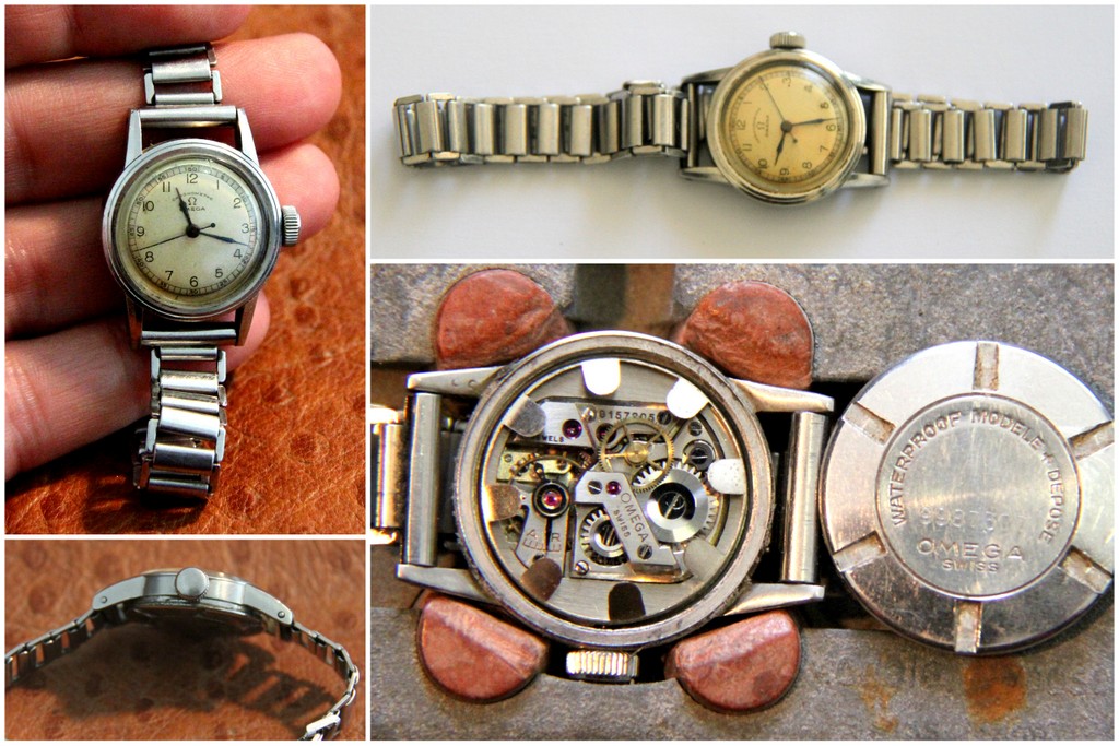

You are all wrong about the reference.
It is neither a 2254 nor a 2192 (which should have subsec.) - no movement from the 30mm family at all!
It is a ref. CK 2144 with a R 17.8 movement inside.
hope this helps
erich

This states that the CK2144 has no water resistance yet the OP's case back says waterproof. Yet another database discrepancy?
I don't think it is a 2144
51
16
I think you should be able to read instead of making stupid speculations!
Stop it now, you are causing chaos here
Read the item description of Bonham´s watch and see the related pictures which clearly show a screw back:
Omega. A stainless steel manual wind bracelet watch
Chronometre, Ref:CK2144, Case No.9.989.255, Movement No.9.162.497, Made 19th July 1941
17-jewel Cal.R17.8 manual wind movement, silvered dial with black Arabic numerals, black outer minute track with five minute markers, blued steel baton hands, subsidiary dial at 6 for running seconds, polished round case with screw down back, fitted associated expandable bracelet,together with Extract from the Archives, case, dial and movement signed
31mm.
Im not disputing anything from that article I'm saying that the watch that was posted does not look like that. It has center seconds(so did the 2254) it has a screw caseback just like the 2254(and apparently the 2144). I found numerous photos online of a 2254 that looks just like the one that was posted, and no 2144s with center seconds.

Have a close look at the lugs - ref 2254 has double step lugs!
The watch of the OP is much smaller than 2254
51
16
fair enough, I didn't notice the lugs.
3,532
7,563
I am not shy to correct my own statements - obviously I have made a mistake myself...
The wrist watch of the OP is pretty small and the case design (lugs) is the same as on the ref. 2144
As the watch has a center second movement encased in the same case style of 2144 it might deserve a different ref.# maybe 2145 or other 214x ?
There is a ref. 2143 in the data base which has the same case and movement as 2144 but does not have chronometre rating and hence no chronometre inscription on the dial.
Only an extract from the archive will shed some light on this topic and hence we would need at least the movement serial#
I am pretty confident that there is no ref.# in the case back, only a case serial.
Let´s wait and see.
Yes, or as Erich states, a very similar model with a difference in back/crown

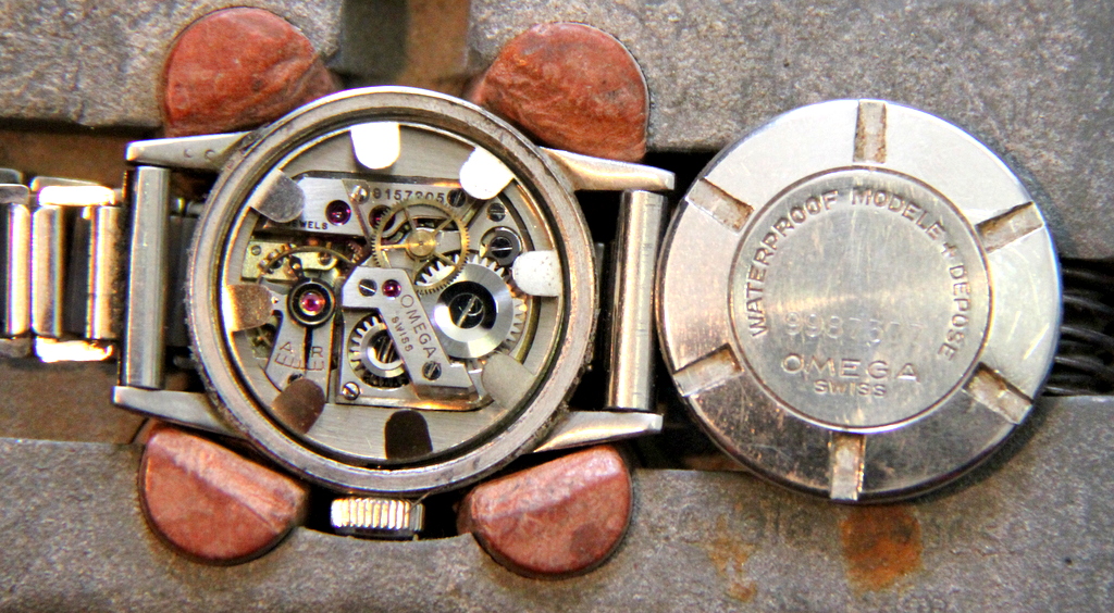

This must have been the most messed up thread ever on OF!
The second watch is the more interesting one and we need better pictures of the back and good pictures of the inside to determine what it is. By all appearances so far, it is a very valuable watch but with some uncertainty.

30
4
I am trying to figure out the story of this watch, am battling to find much info on it and dont know enough to discern much from numbers besides that it is a 1939 and quite rare. Pls advise if anybody knows anything about this piece
