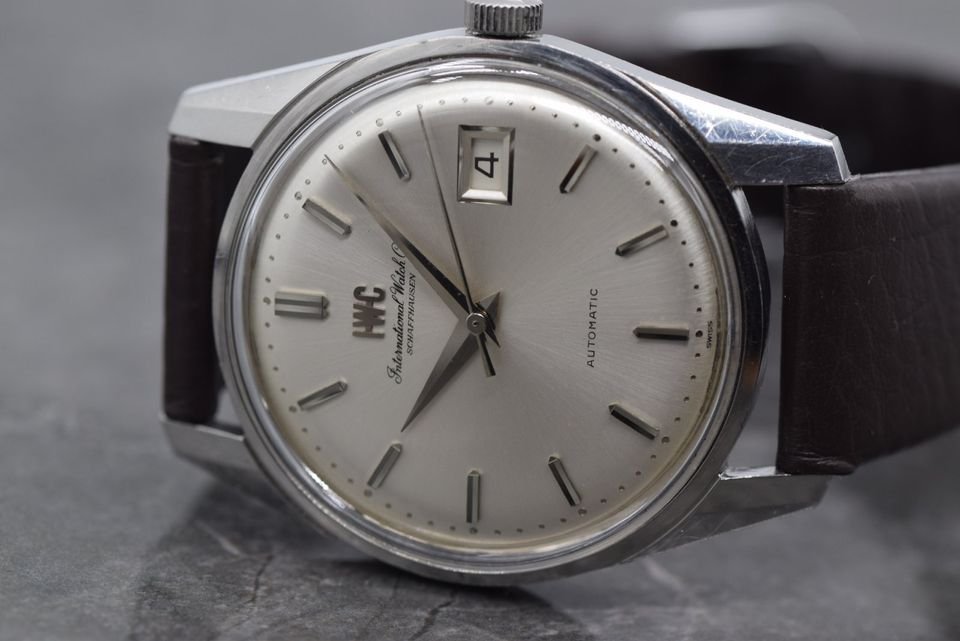

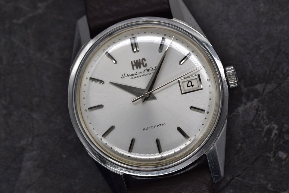

Hello members,
I am considering to buy this IWC Ref. 820 online. I can't see any obvious errors. The dial looks a bit too good to be true, but I can't see any of the typical signs of it being a redial. Maybe a factory service exange?? All the other 820s on the internet have pristine dials, too. It seems to be a rare IWC, generally speaking. I would love to have your opinion!
Here's the link to the listing:
https://www.kleinanzeigen.de/s-anzeige/iwc-820ad-date-vintage-aus-1971/2617115334-157-7969
Yours,
vintage'97

The dial appears to be genuine, but as you say, perhaps a replacement given its condition relative to the case.
My concern would be the lack of photos of the inner case back and movement, and given the case condition, I would not pay that kind of money even if everything looked good inside.

Thank you, Tony! I will ask for more photos including the movement. But I love the design of the watch, especially the lugs and the hands, so I am still interested 😀

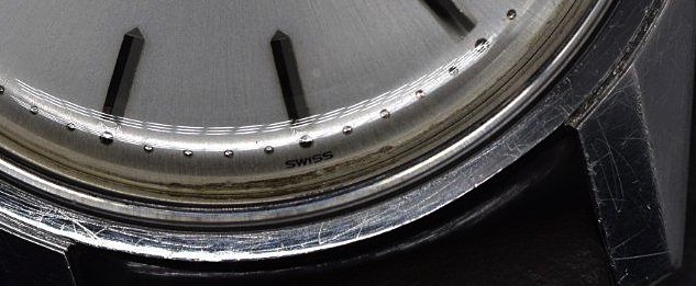

Did you notice the stains on the dial (edge) at 11...1 and 6? Does the 4 have some signs of corrosion? You should darken the pics....
Let s see the movement 😁
I like this model 👍: classic, never un-modern

Thank you! I didn't notice the signs of corrosion at the four, but I did realise sthe stains at the edge.

The 820 is a great looking reference especially in unpolished condition. They are pretty uncommon and I believe they are from the late 60’s and into the 70’s. It is 36mm with a screw back. These non-lume dials age a lot better than the ones with lume.

Thank you! Seen one online from a japanese dealer that seems to be from 68 and this one seems to be from 71. So that matches.
