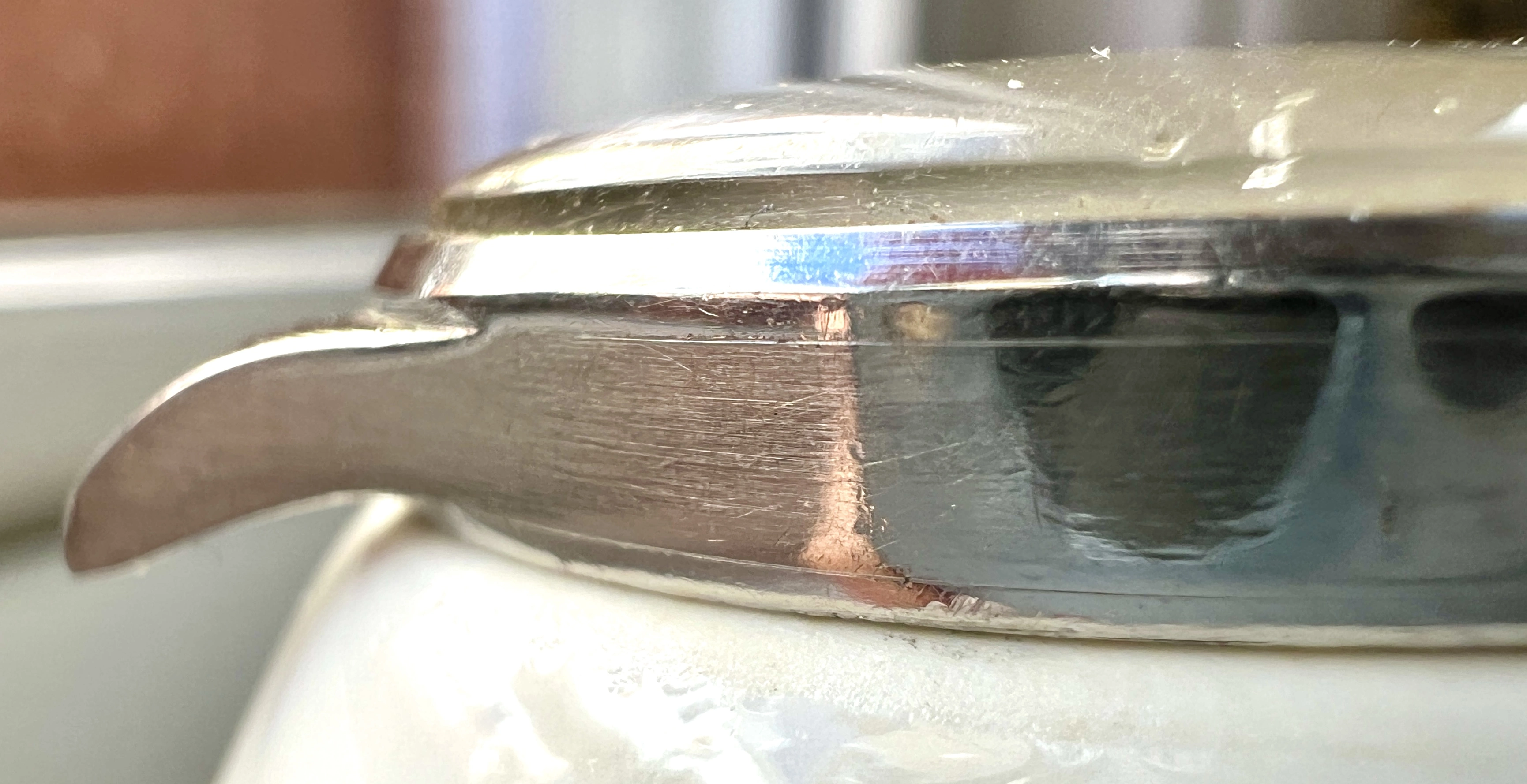

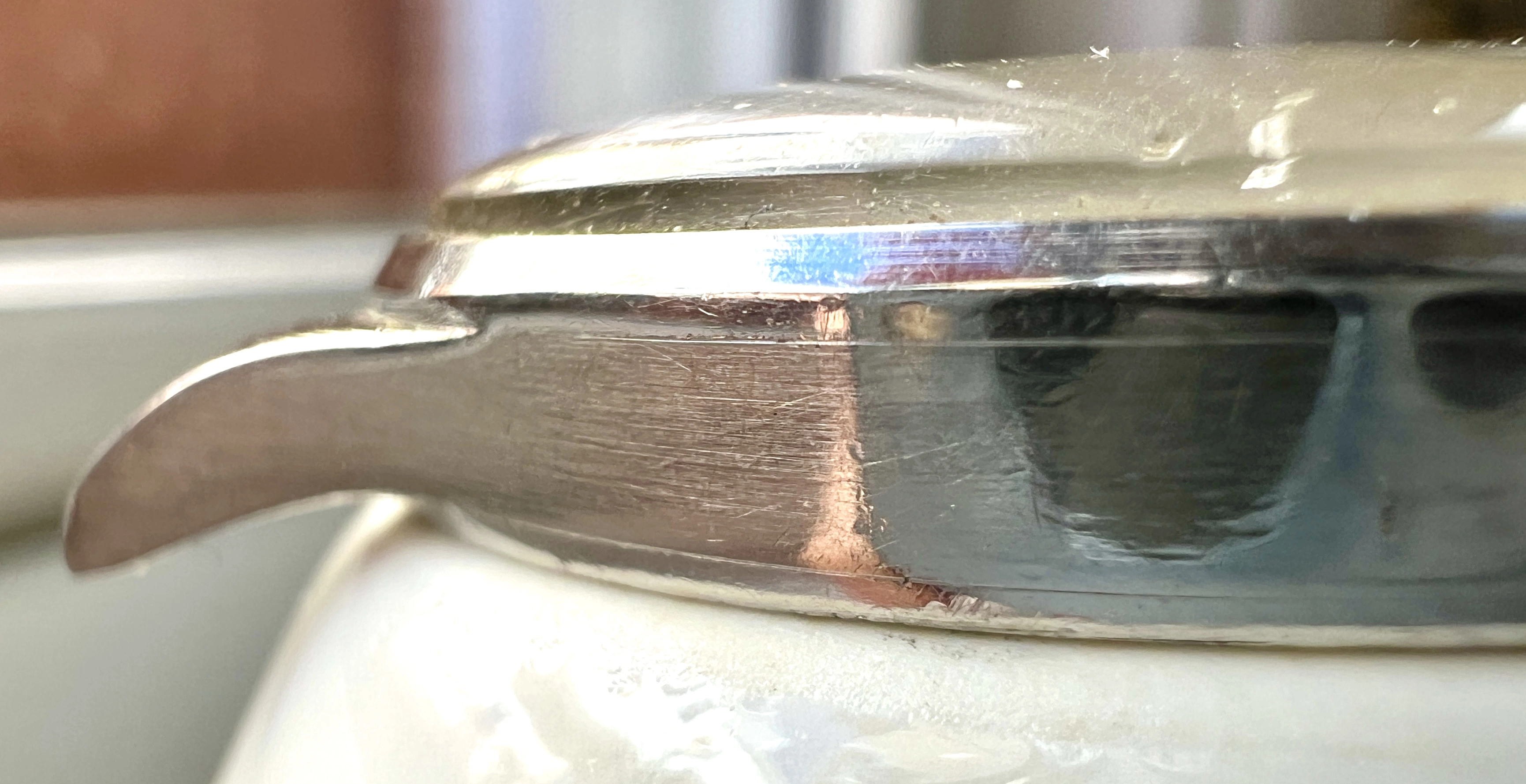

Here's a picture of the side of the case. There is minimal gap at the seam. It's like this on the whole perimeter.
2,671
2,856
Archer uses a razor blade, probably better, I use an exacto knife, but that looks like what I was saying above. I suggest doing it somewhere reasonably hidden (between the lugs) since it is possible to damage the case for an inexperienced person, but should be easy enough.

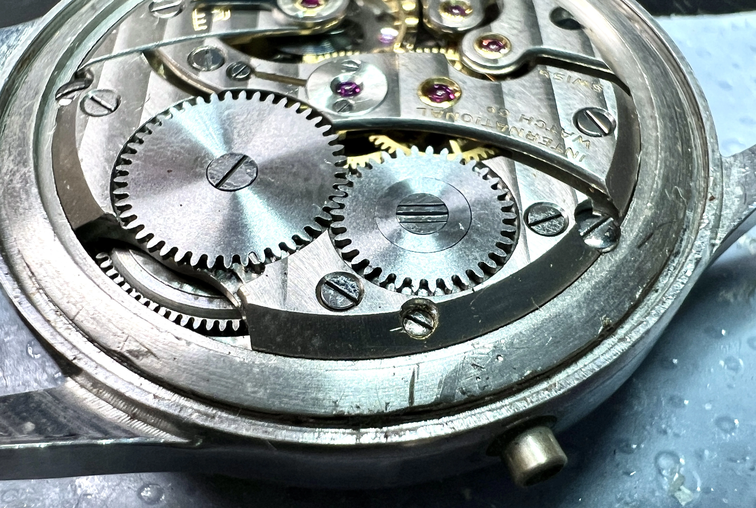

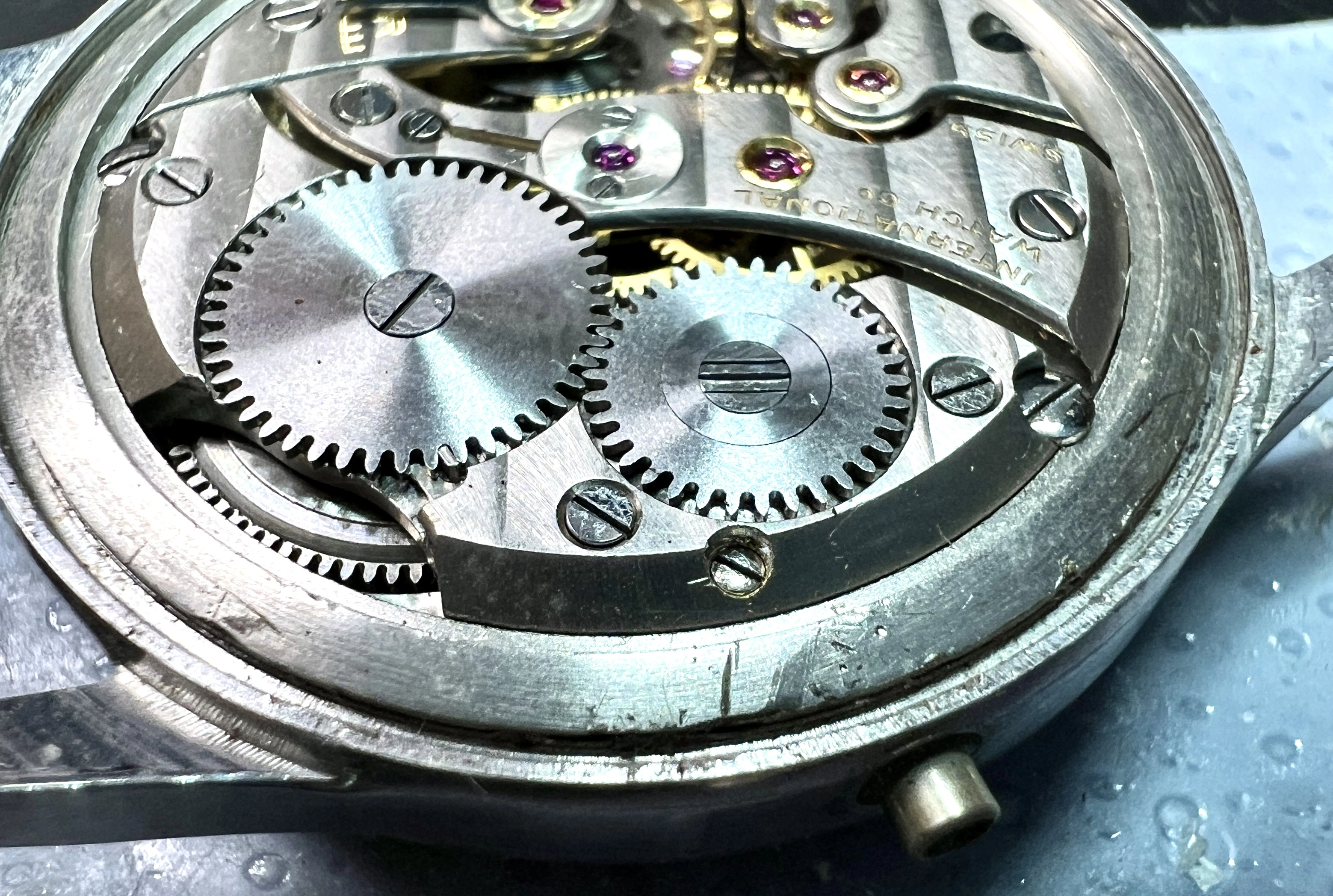

Now I'm thinking that perhaps the bezel doesn't need to come off. Looking from the movement side the case screws are abutting a ring-shaped case spacer. Perhaps the spacer can come out from the movement side together with the case and dial. Another possibility is to remove the two case screws, remove the spacer and then remove the movement/dial. The is evidence that a past watchmaker has done this because there is some damage to the case spacer near the crown tube.

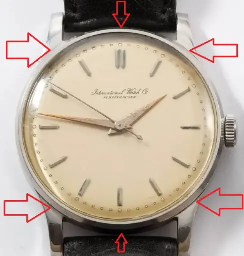

Some more photos of the other sides of the bezel would also help me form a better opinion. Sometimes the bezel is put back on with the opened lip on a less accessible side than the left flank of the case.

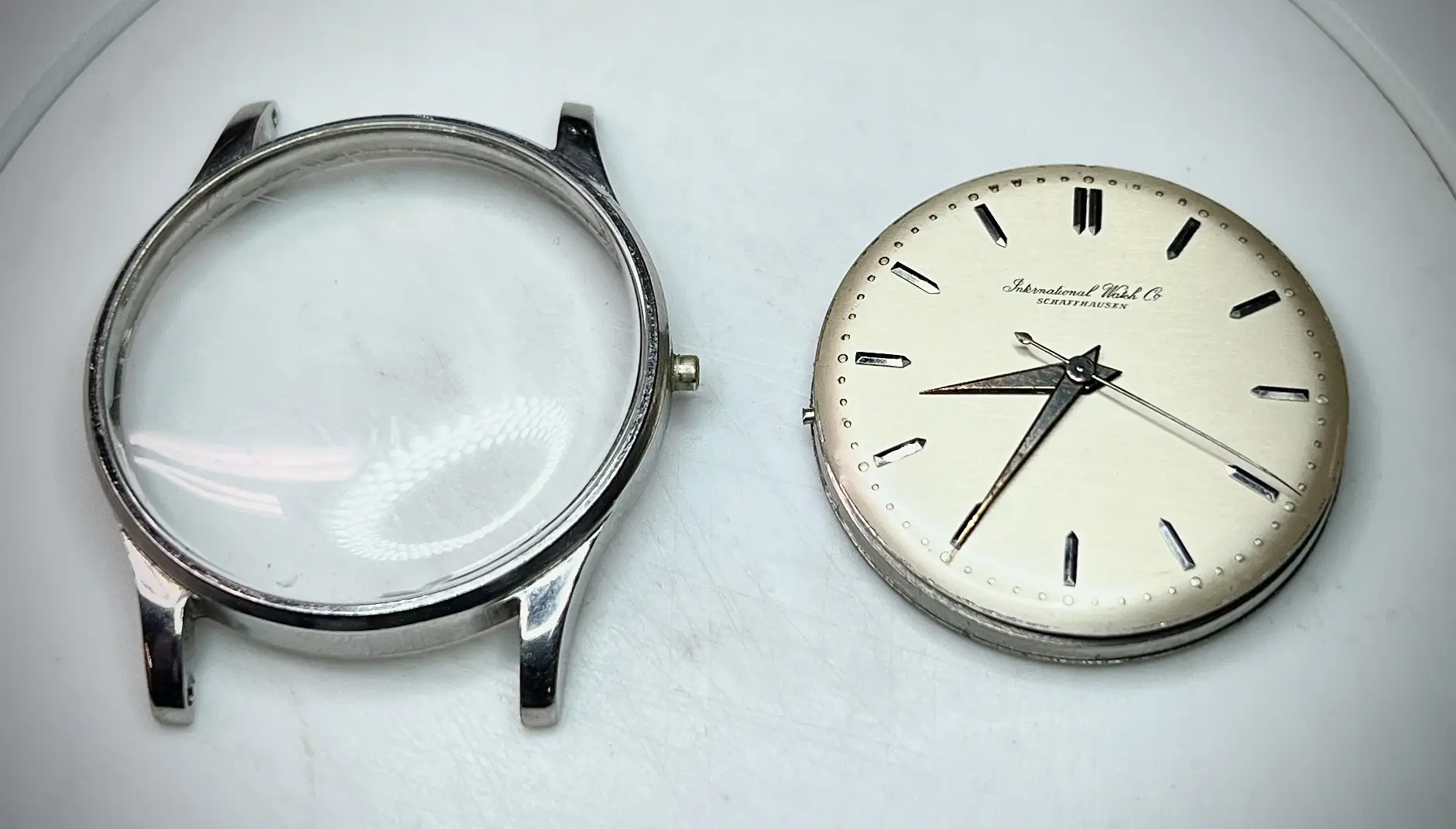

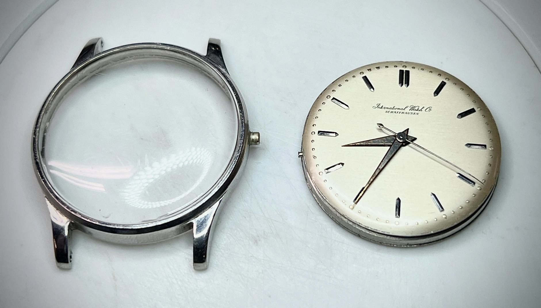

Well, I managed to remove the movement from the case. Turns out I can remove it from the back with the dial by lifting the spacer.
Thanks to all who proposed ideas.

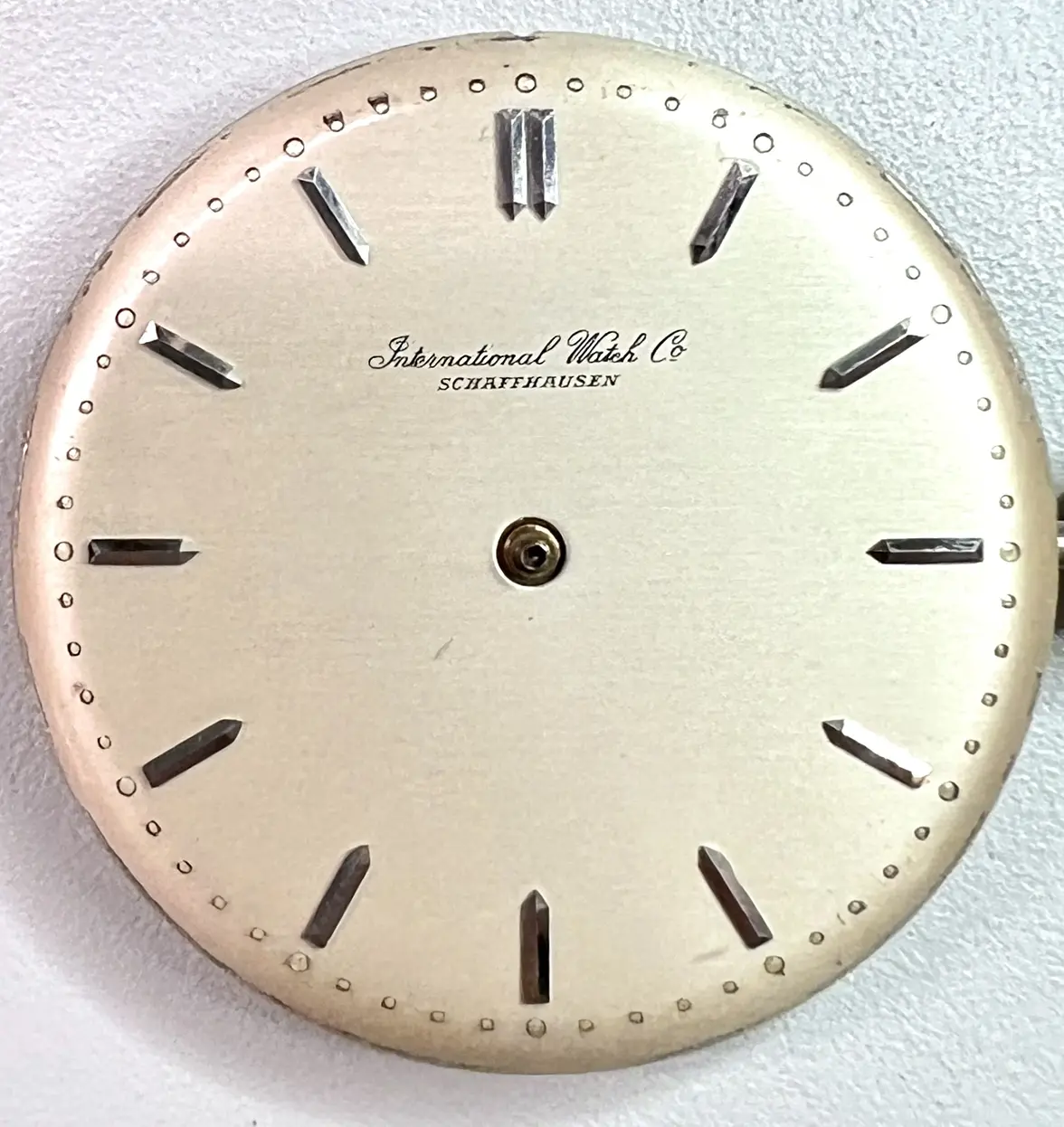

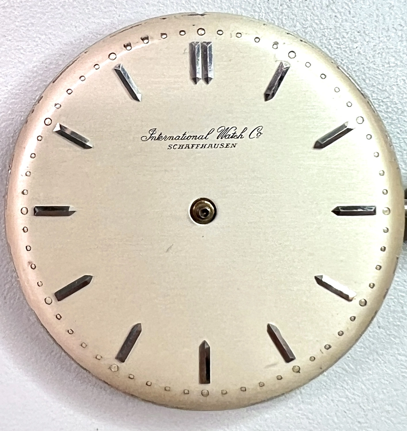

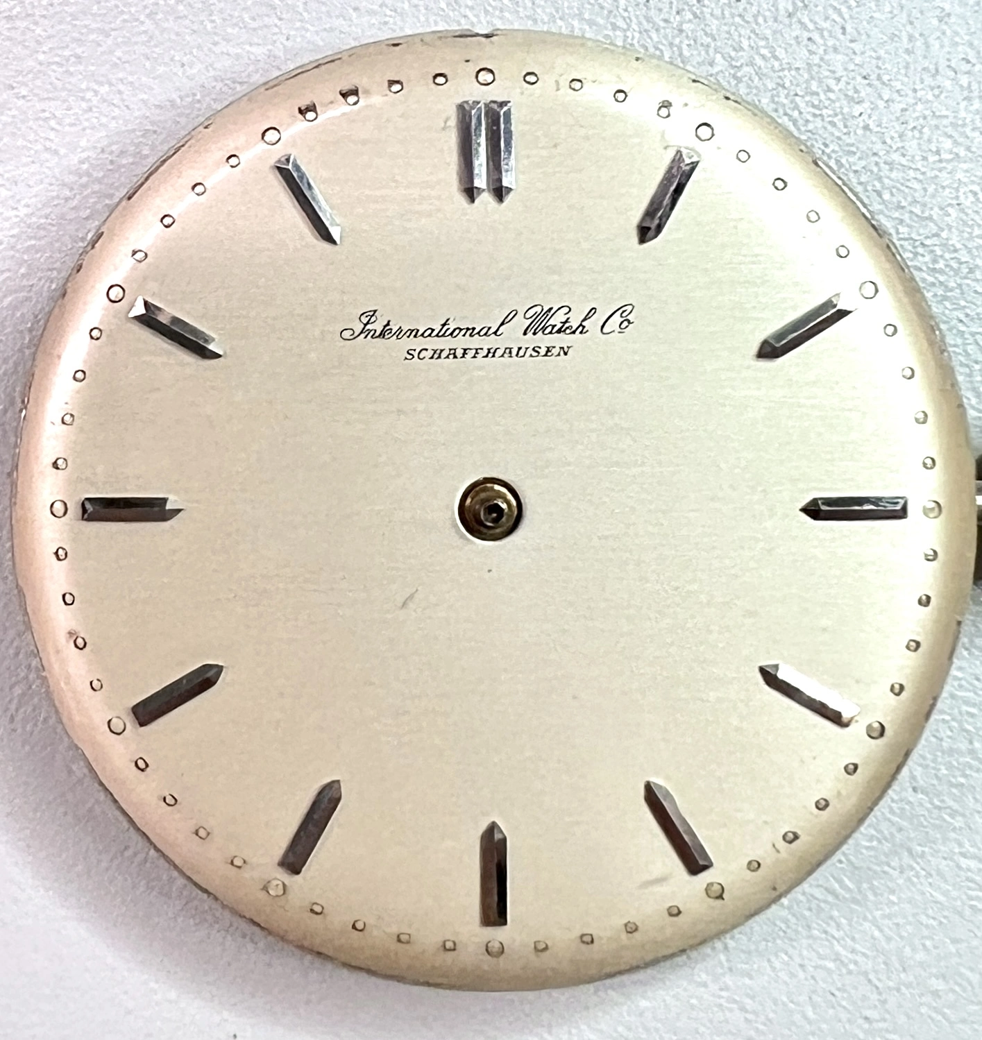

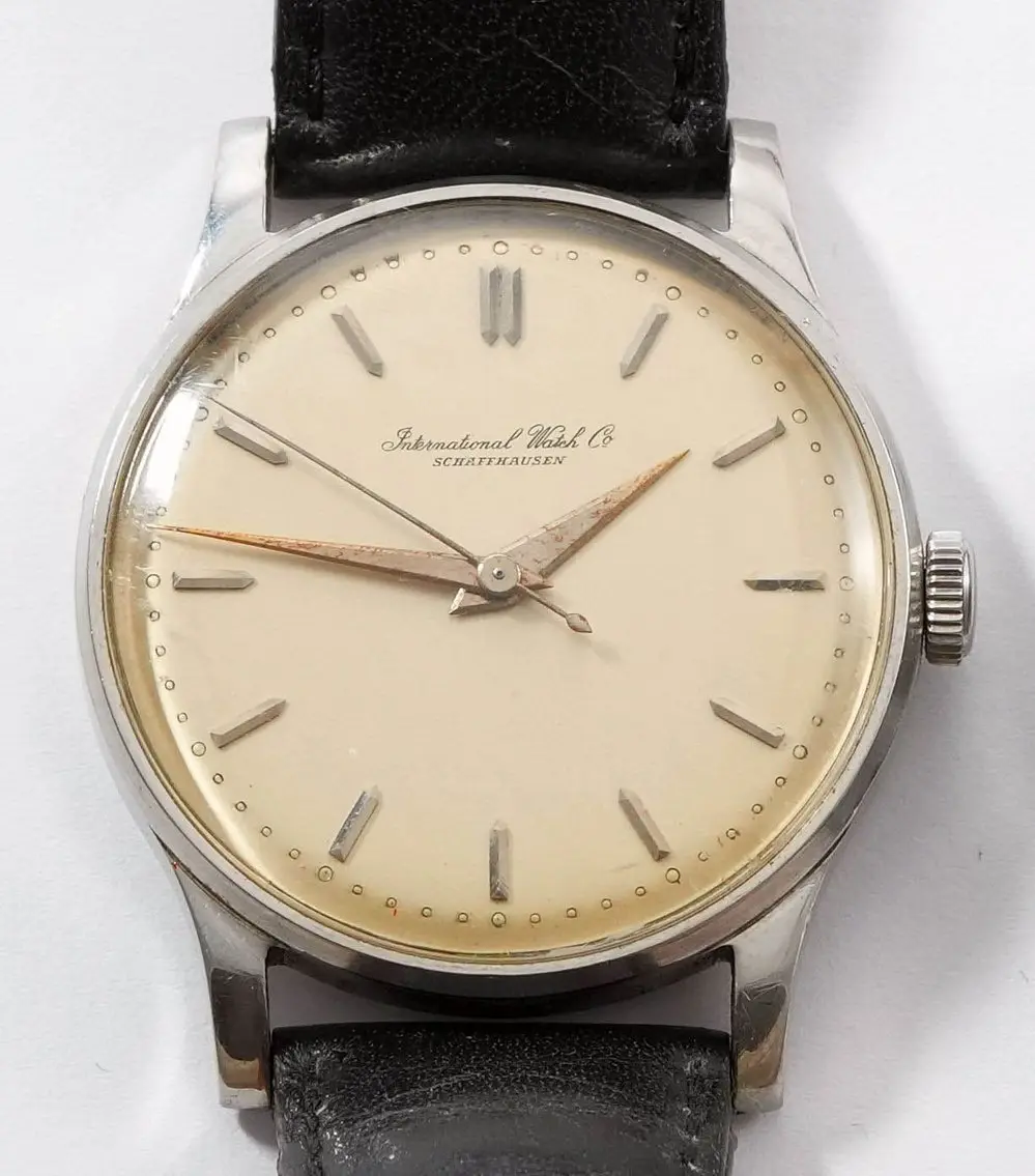

"All right, Mr. DeMille, I'm ready for my close-up.” Not very familiar with IWC but I suspect the dial is original. What do you think?
