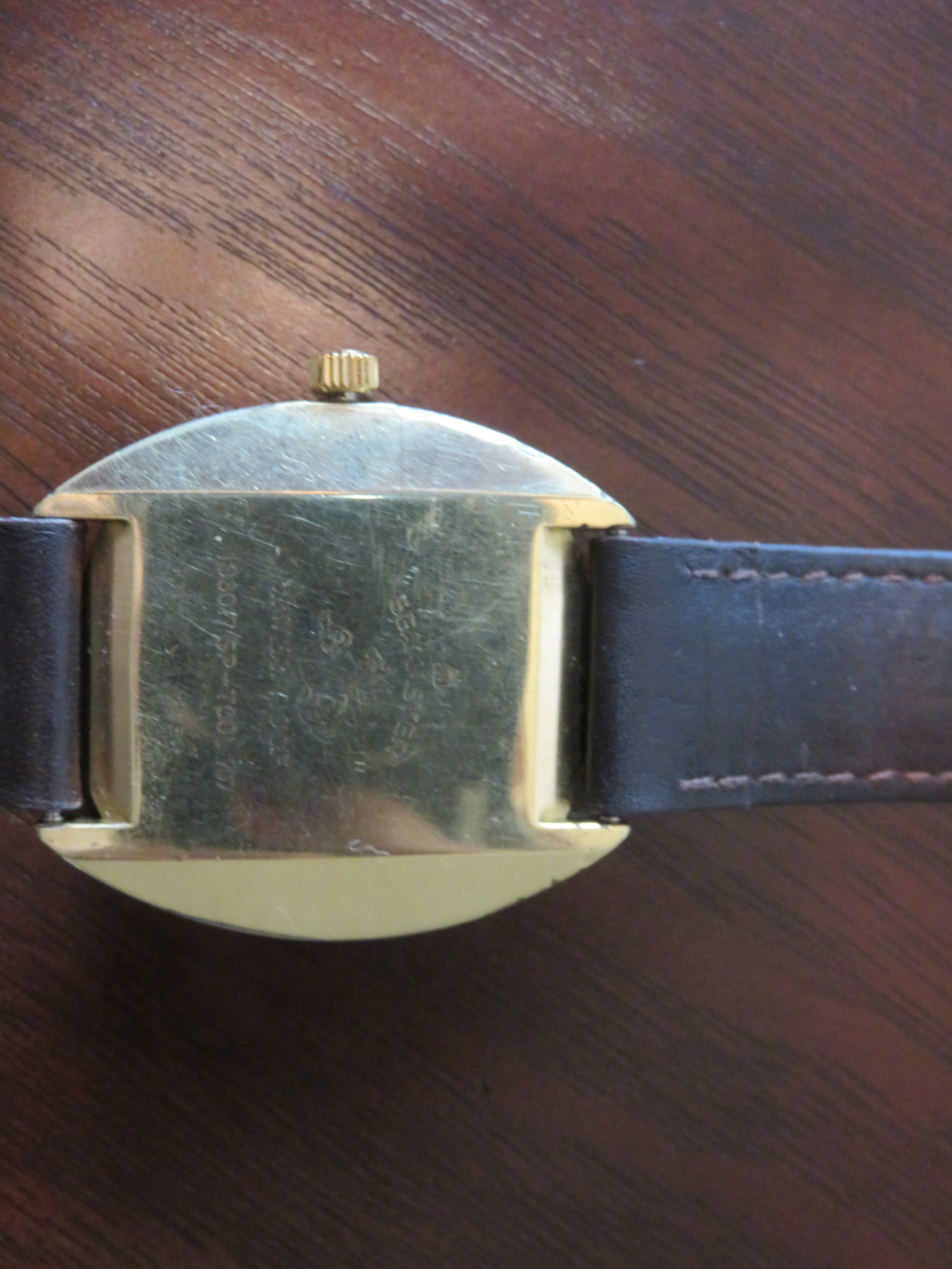

It may be tough to tell from the photo, but the numbers are:
Seamaster
Waterproof
136017 sp tool 107
Getting a replacement dial is obviously nice and much appreciated. Right now, I believe that my most pressing issue is to find a trusted repair person. With having no info/dealing with an incapable watch repair, I have no idea what is actually going on with the watch. I know that the stem does't go in all the way, and the date doesn't change.

136017 sp tool 107.
Yes, so this has a manual wind Cal. 610 inside, and the dial for this would be a 064TT0814011P. It is unfortunately discontinued, and the closest replacement that is available from Omega would be the 064TT0814010P, which is very close but has no lume and no crosshairs.
