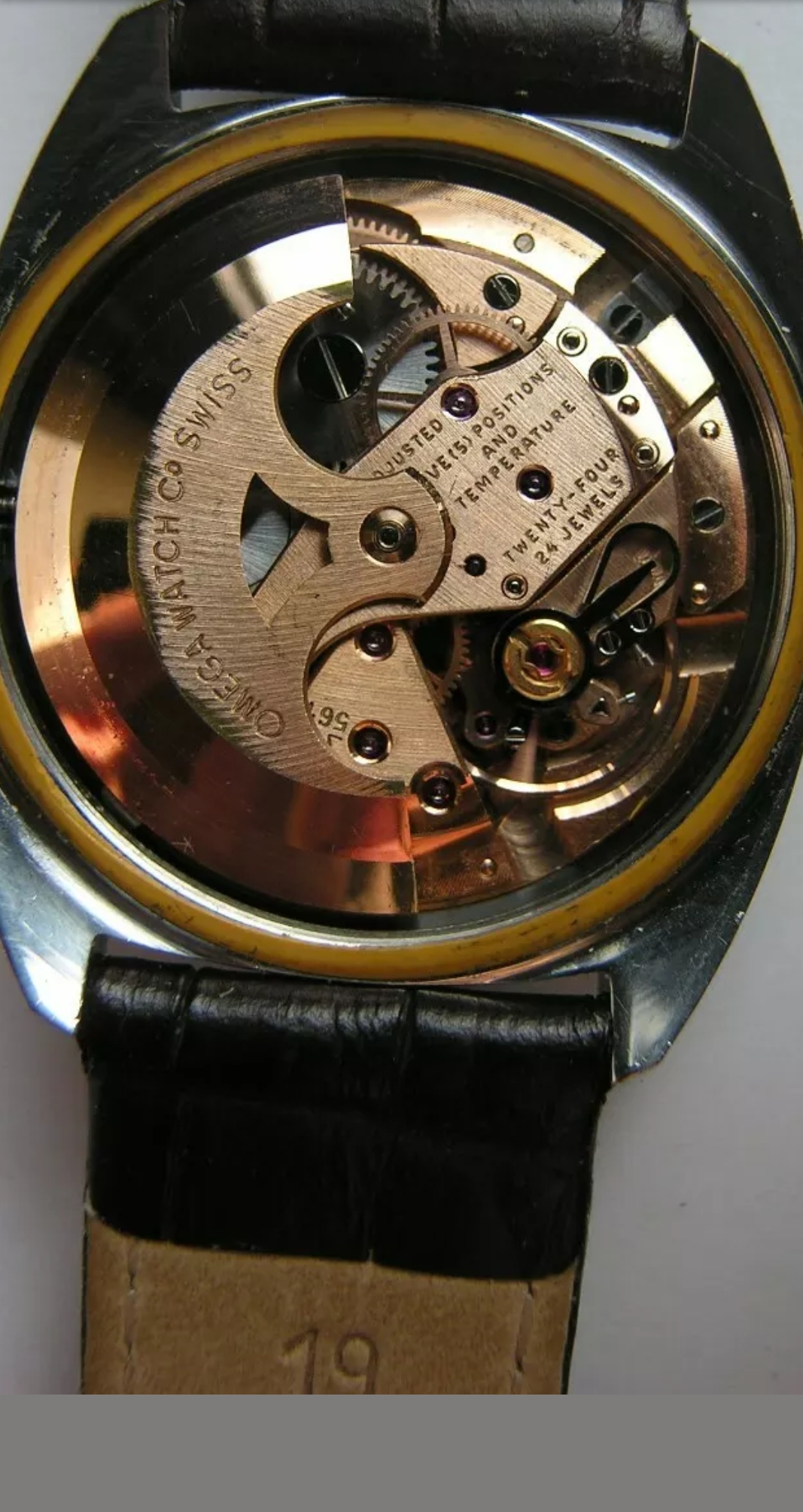

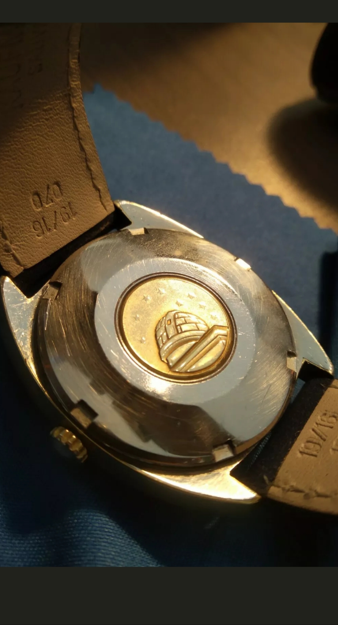

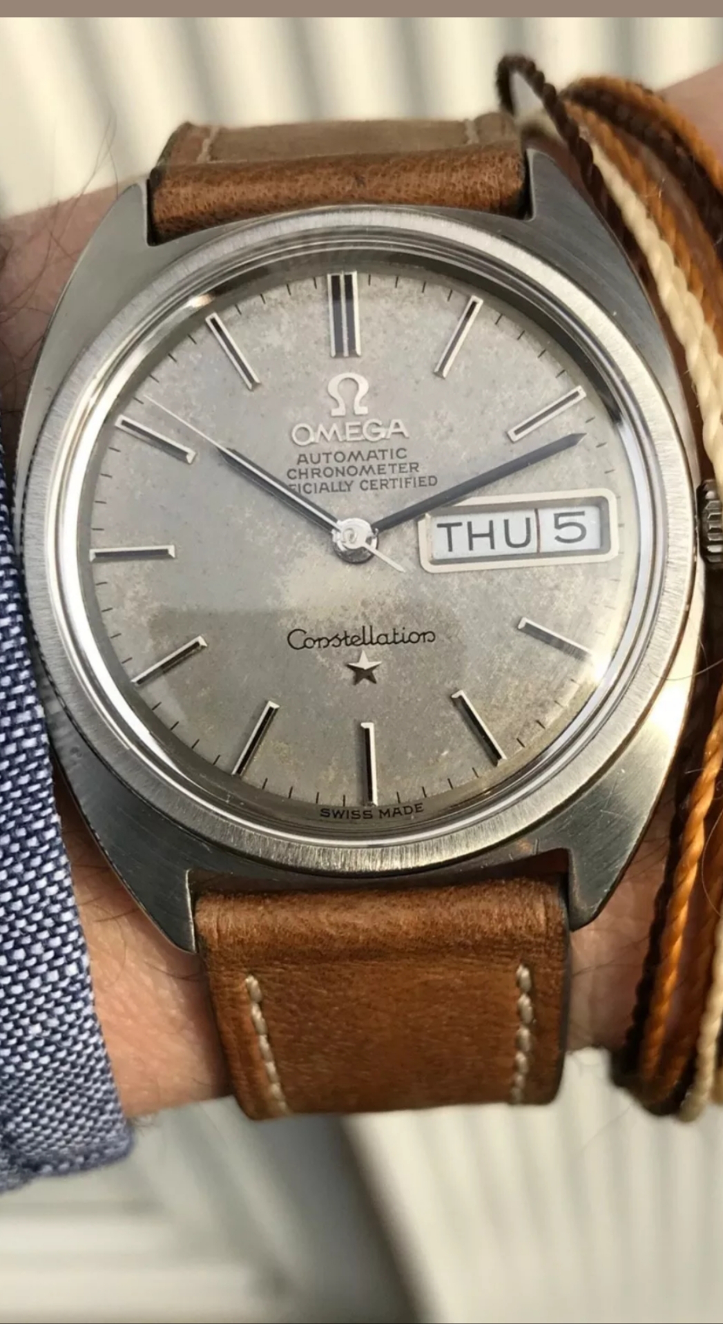

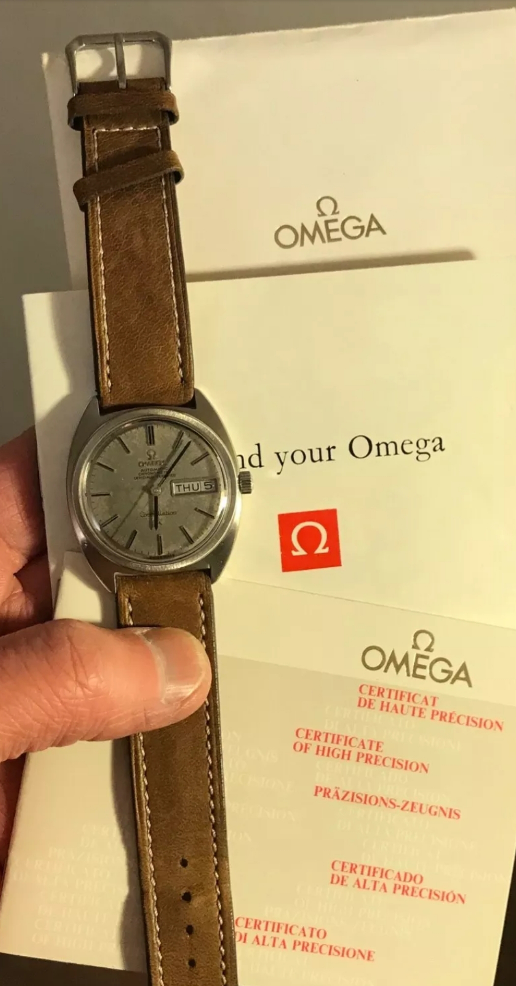

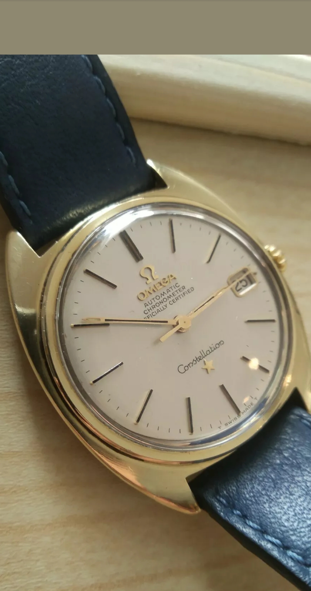

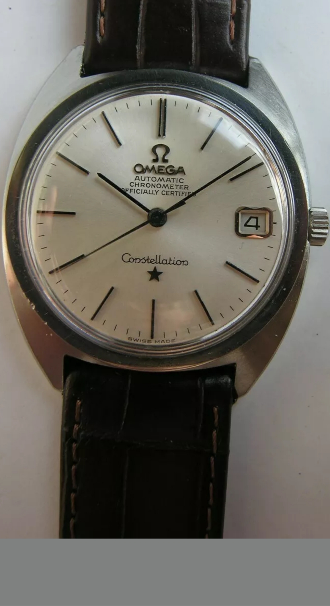

Hi all,
I was almost ready to give up my hunt for my first Omega vintage when I came across this piece and as usual, I was wondering if I could get second opinions from forumers:
The seller mentioned that this comes with some documents and the number on the envelope matches the serial number on the movement.
My questions:
1. To my untrained eyes, this look authentic and original - is there anything that should be of concern? Any tell tale red flags?
2. I don't have anything against redials/refinished dials but preference is to have an original dial - dial is slightly worn but I'm fine with that if the dial has not been touched up.
3. Does the movement match the time period and model of the watch?

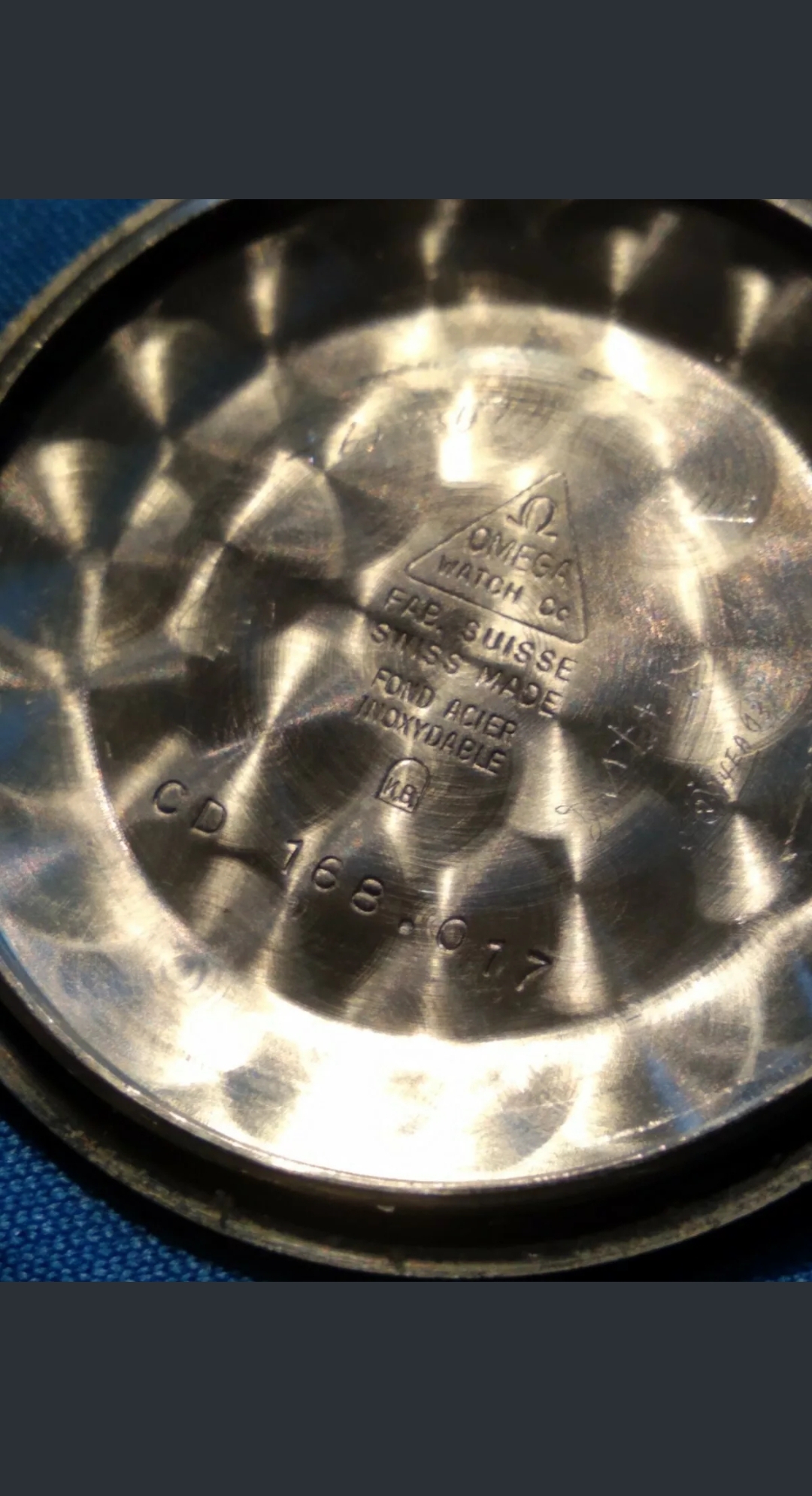

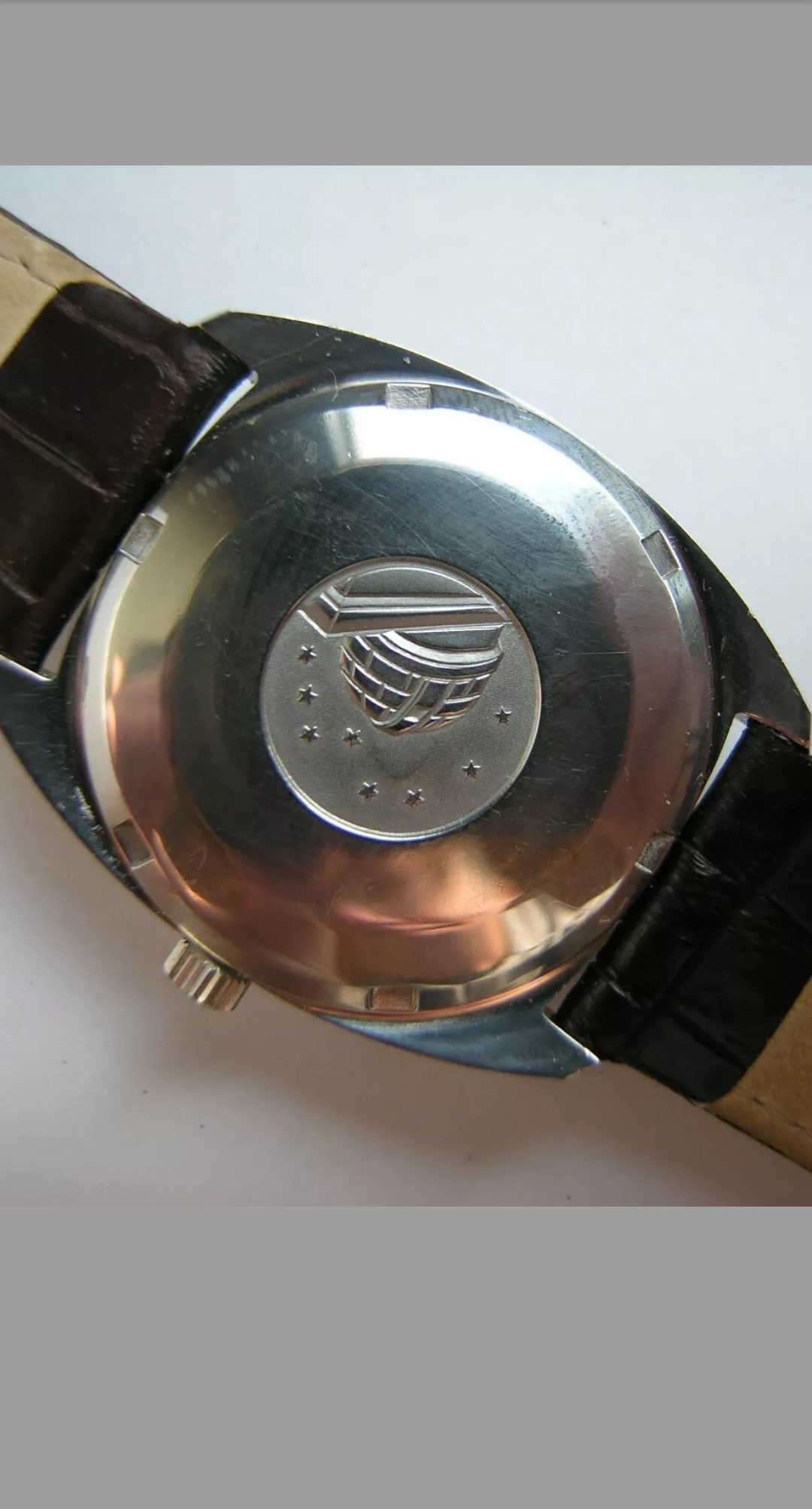

4. My only slight concern is the inner case back - this doesn't look like other Omega case back I've seen - cause for concern?
5. Is there anything about the watch that could point to a franken watch or do all the parts match up to the watch itself (i.e. watch is whole with all its original parts)?
6. Does anyone know the exact model/ref for this watch?
As always, thank you for any help you can give me 😀
1,903
24,949
That dial is not what I would call 'slightly worn' 😁
The caseback has also been polished in an unattractive way.
I would pass on this.

Apologies, I'm really just a rookie when it comes to vintage Omega watches...when you say the condition is poor, do you mean the dial because it is worn?
Other than its condition, is the authenticity in any doubt? Any red flags that parts of this watch could have been franken or taken from other watches?
16,918
48,150
What’s the price, that would be my main issue. If it’s cheap like it should be in the condition it’s in it might be worthwhile for a everyday wearer.
So what is the asking price?
2,086
2,899
I was referring to the condition and was not stating that anything is wrong, because I didn't take a closer look, after having seen the watch.
Finally, it's a matter of price.

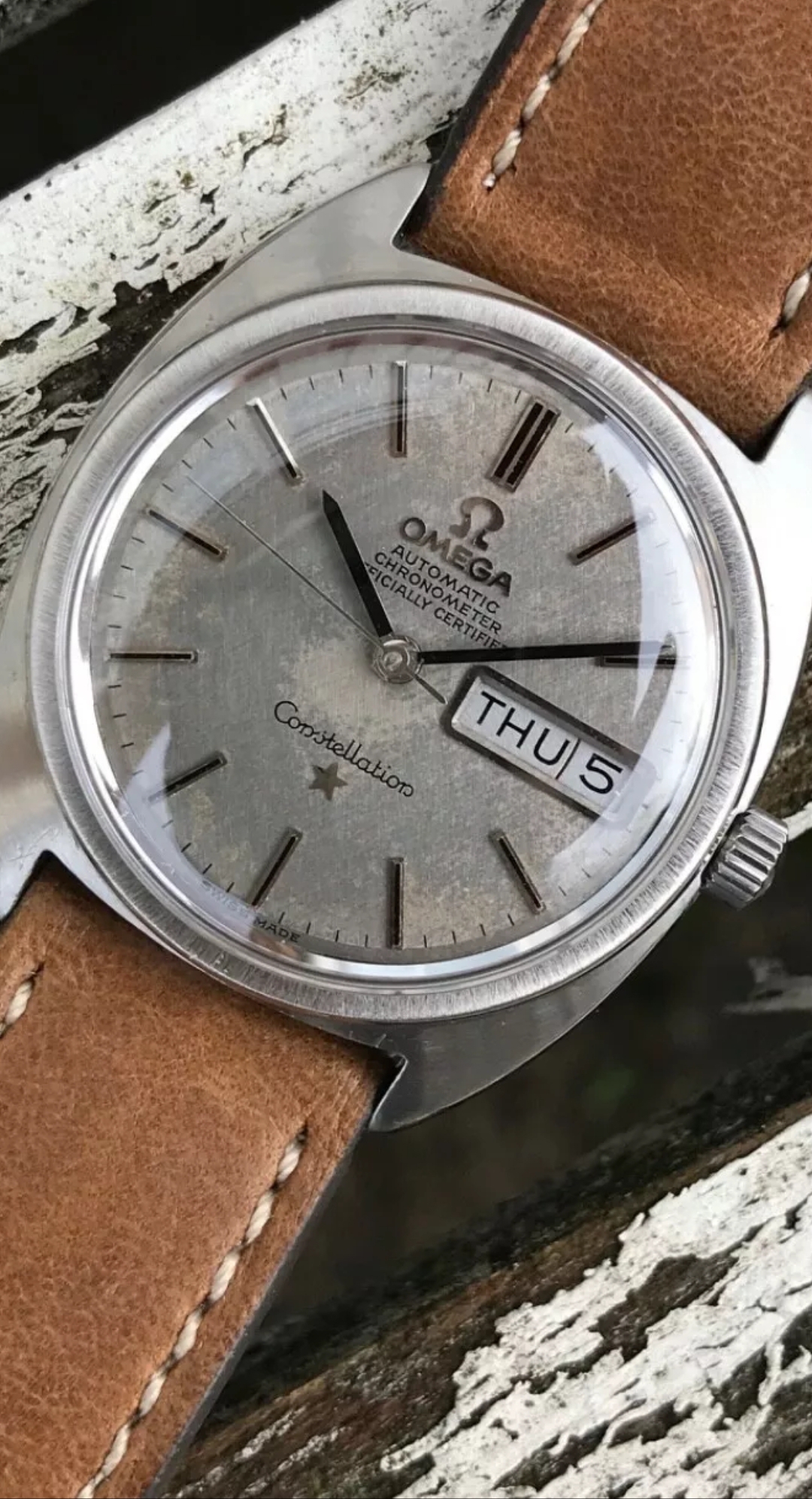

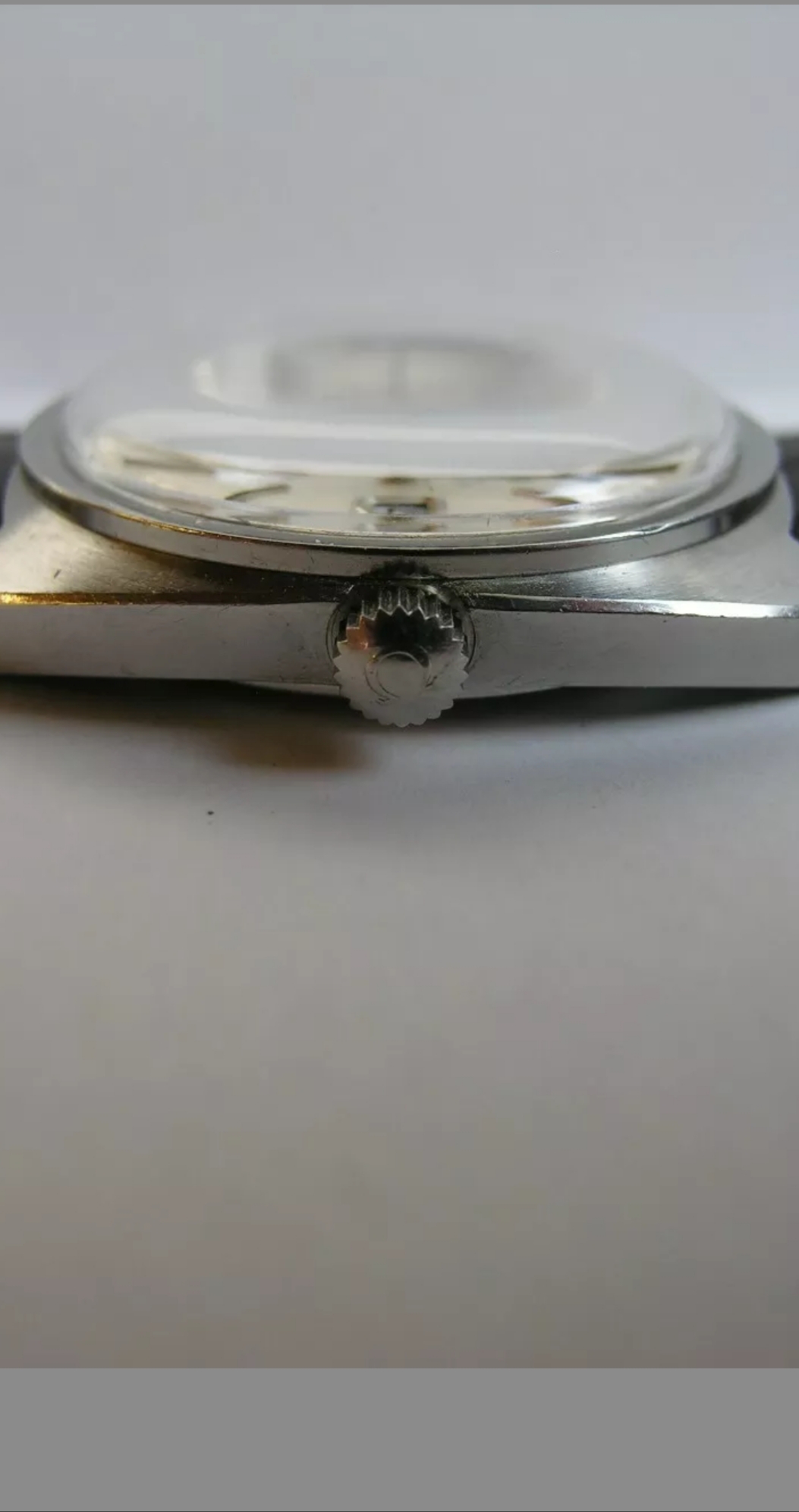

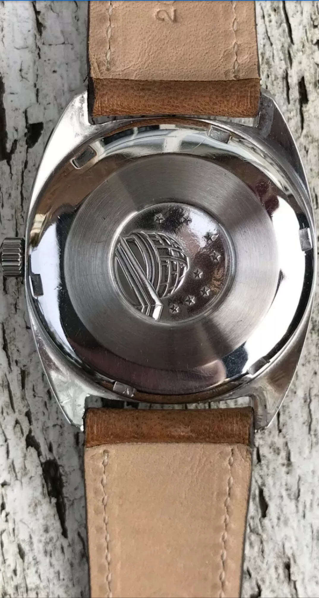

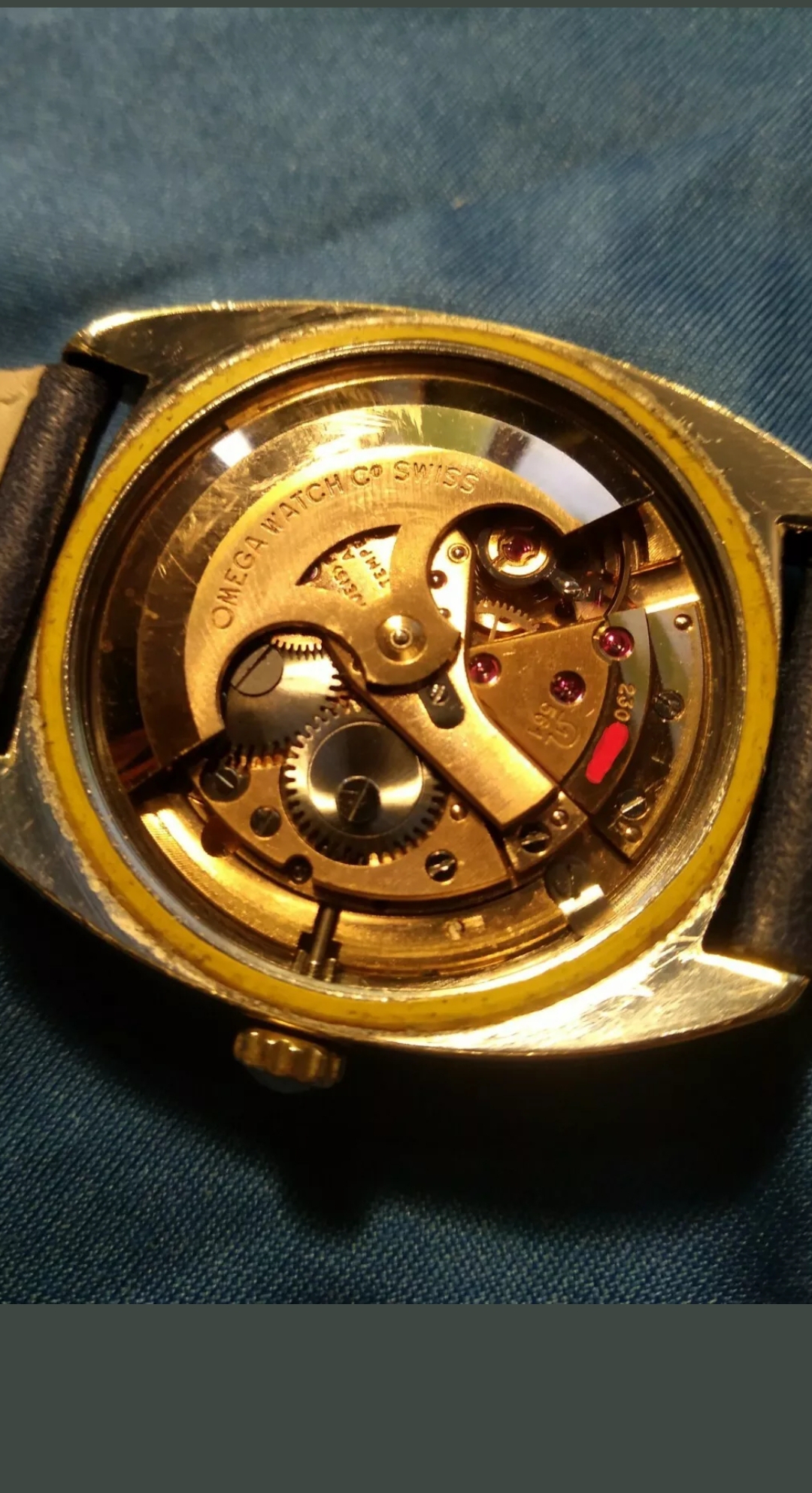

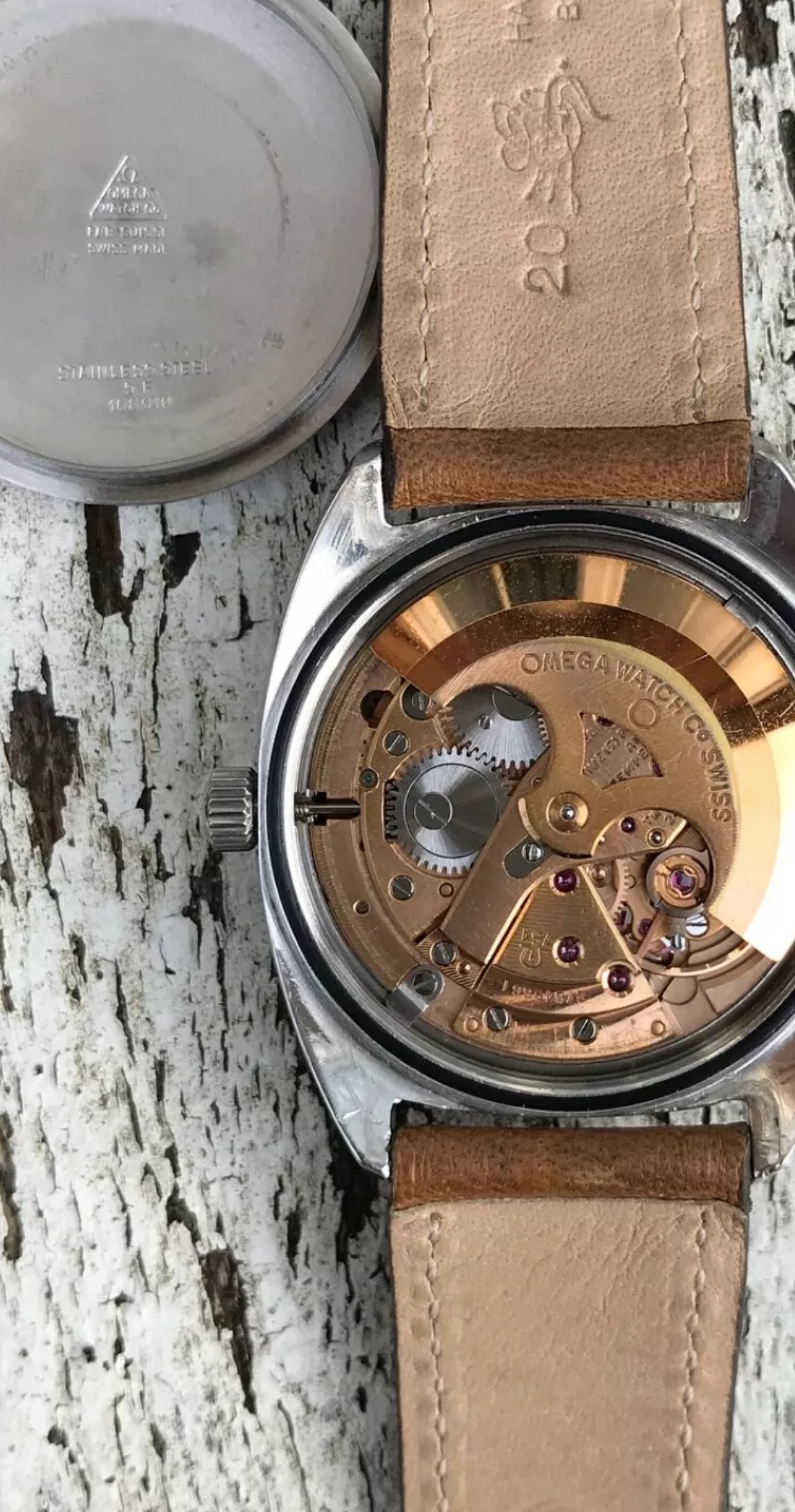

Hi again all,
Have just been offered this Connie and am wondering if it looks good (i.e. authentic without any red flags for redial, wrong movement for period, franken, etc)?
Price is less than 900 Euro.
Thank you!
284
334
The damage on that rotor is pretty bad. Does the seller say whether: a) the watch has been recently serviced; and, b) that rotor rubbing issue has been addressed.
I’m also not convinced about the authenticity of the hands. They seem too thin somewhat.
284
334
Better to double your budget and buy one in this condition:
Better for you to double down and buy something in better condition, as mentioned above.
160
117
That rotor would worry me a bit. Looks like an original gasket?

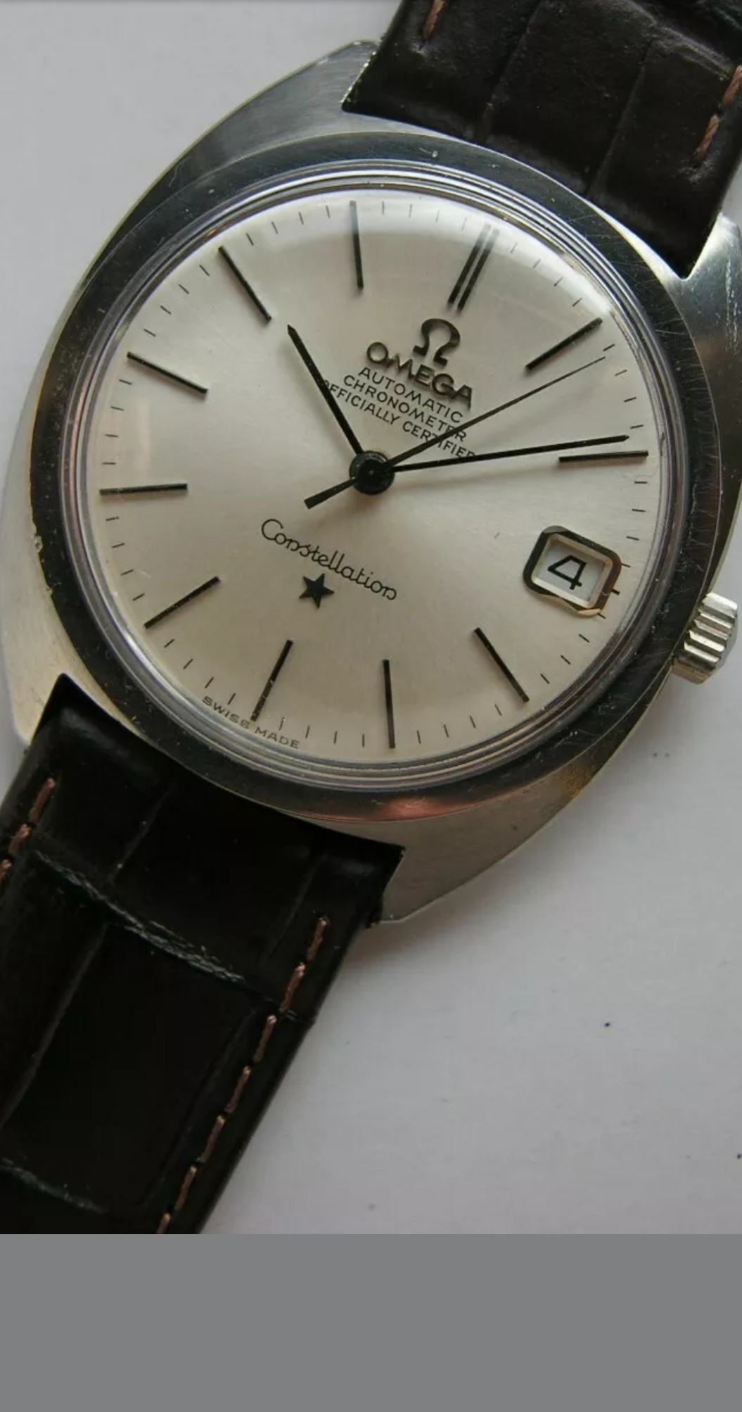

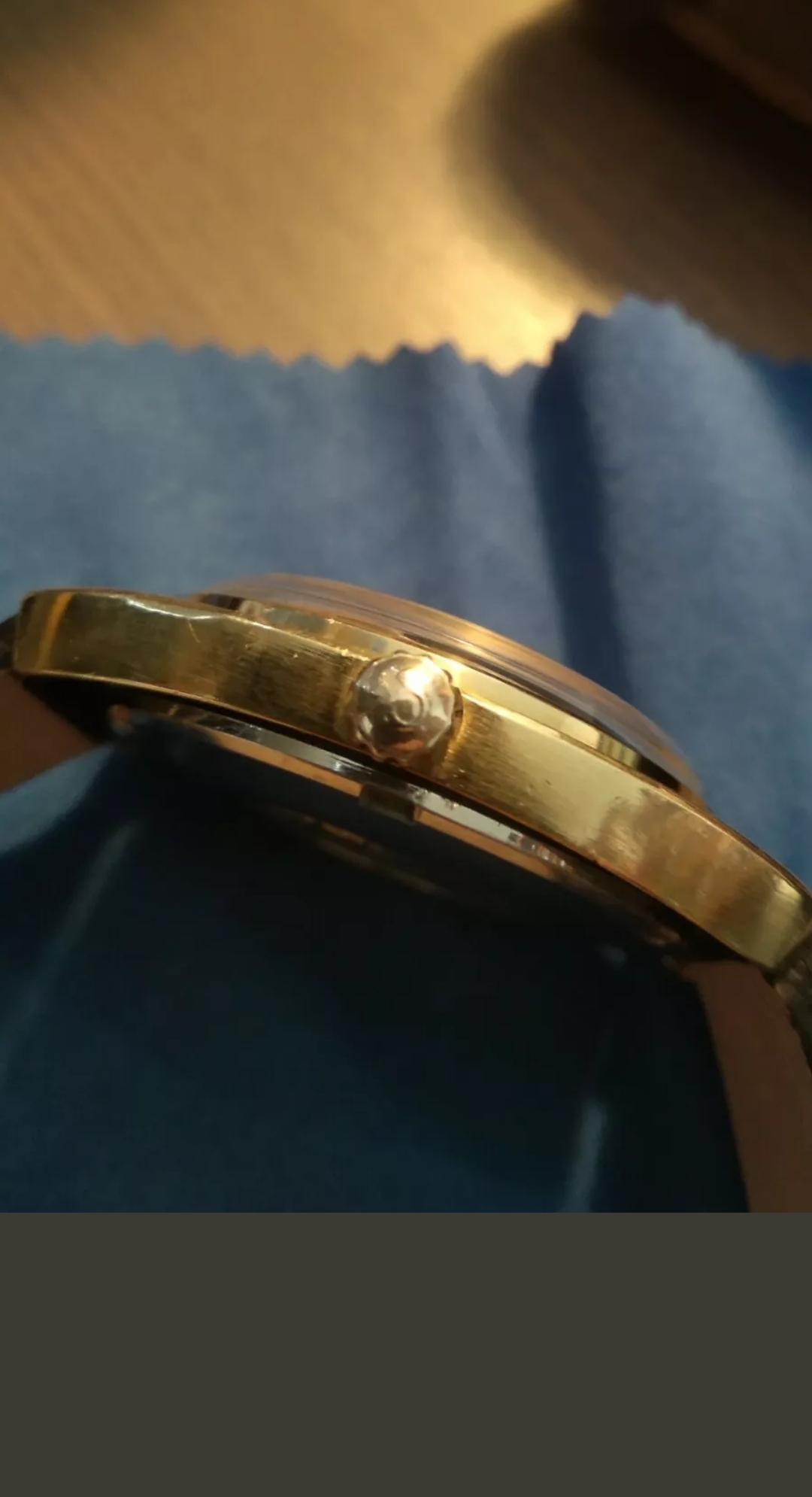

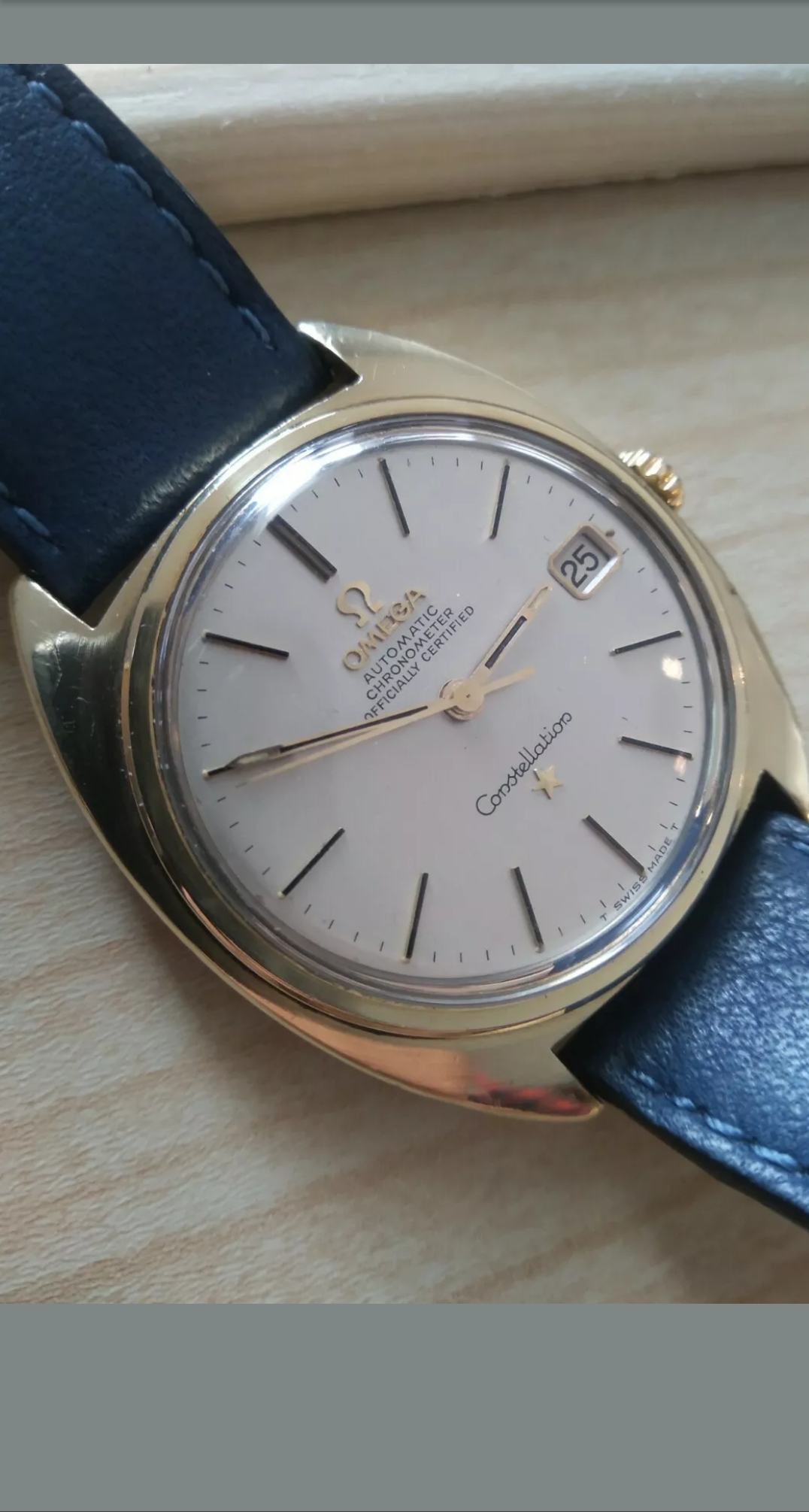

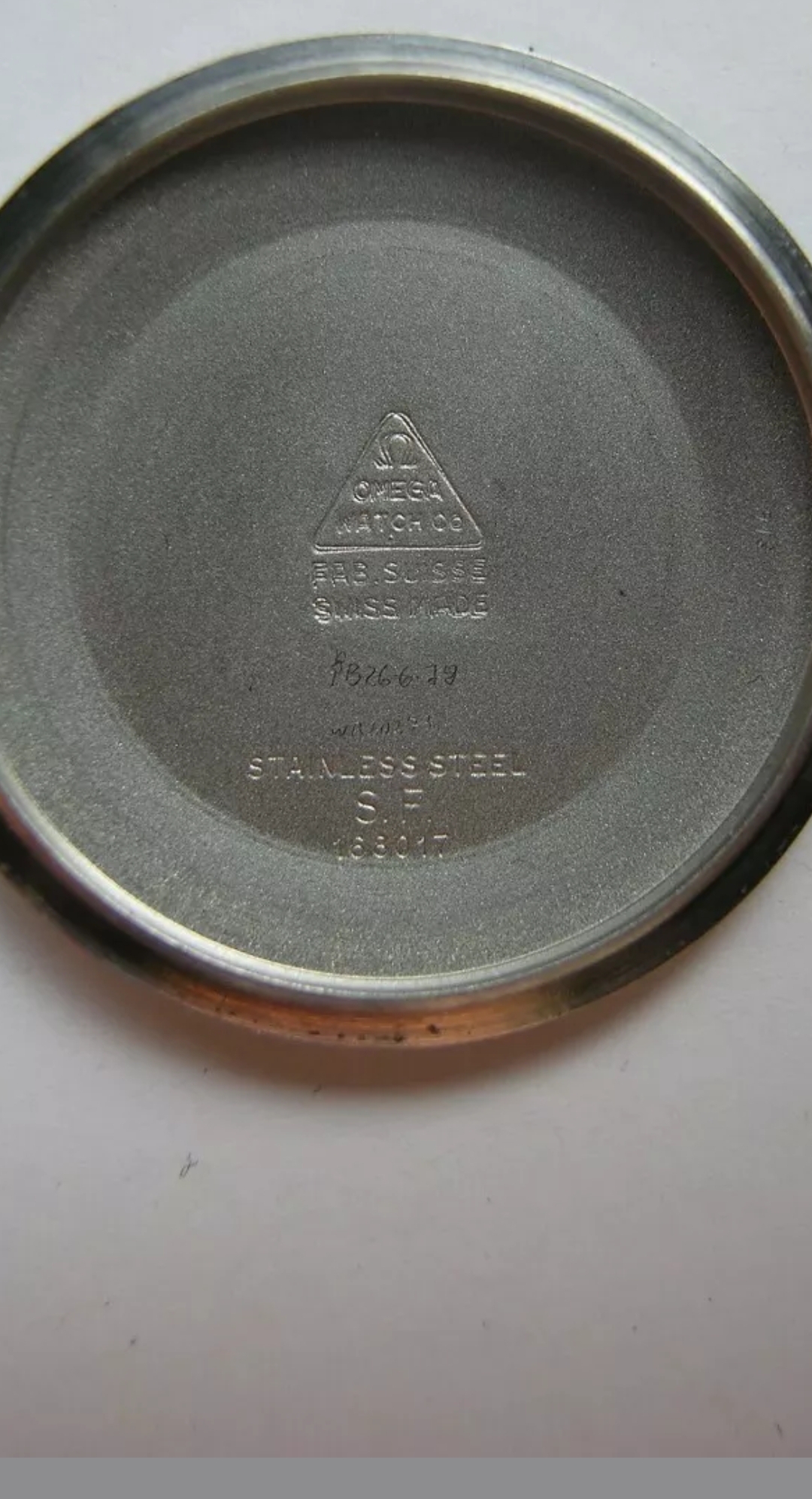

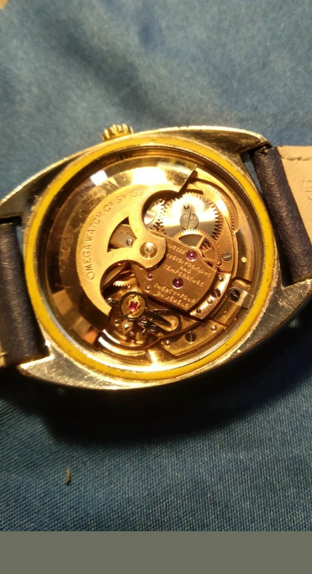

Hi again everyone,
Well, strange things sometimes happen when you least expect it. I was actually going to just put Connie on hold while I save up for a higher budget.
However, I was offered this for consideration by a friend - he isn't the original owner so there are some questions that he genuinely doesn't know the answers to.
Price-wise, it's a bit higher than my original budget - any red flags as to the dial being a redial or was refinished? Do the movement and hands match the model and time period of the watch? Does the movement look okay? Any parts that look like they may not be original to the watch?
Thoughts/feedback?
9,588
27,706
It looks correct, but the level of polish would keep me away.
Is your budget around the €600 mark?
27
12
Hi @ConElPueblo,
Thank you for the feedback - appreciate it 😀
Does the dial look to be in its original state?
Rookie question - how can you tell the watch has been excessively polished?
That's correct, my original budget is around €600 but I'm starting to doubt that's enough
Thanks again!
