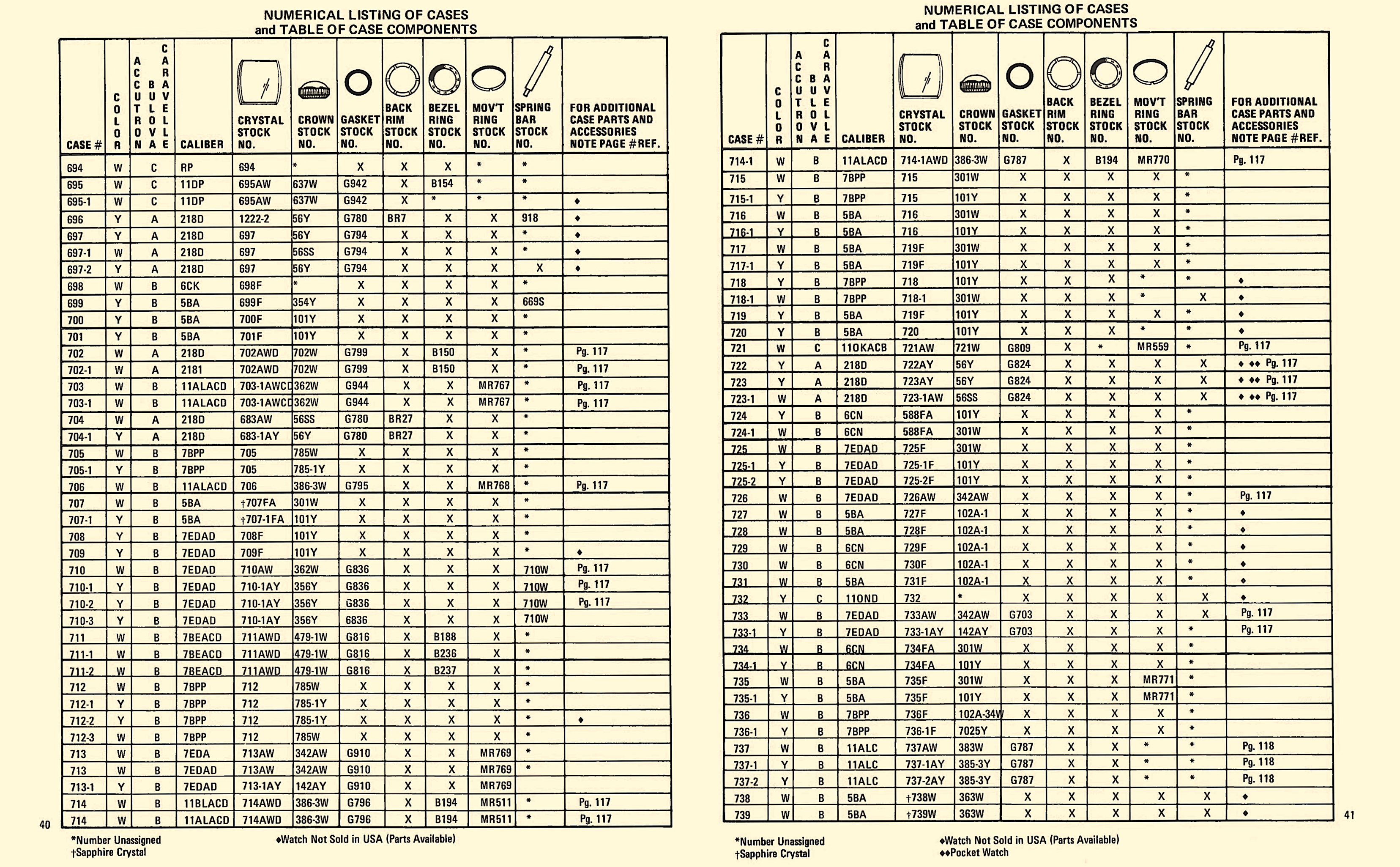

You're a well of information and I appreciate it! My confusion stems from knowing that Bulova made Accutrons, and my assumption that all crowns ordered from them having a particular part number would be identical. But I now understand (I think) that they sold Bulova branded crowns as well as Accutron branded crowns with the same part number, though they came in packages that either said "Accutron" or "Bulova", and they had different signatures on the crowns.

correct, and again they might be the same actual part or some minor cosmetic difference BUT one is meant to be paired with the mechanical movement and the other is meant to be paired with a tuning fork movement

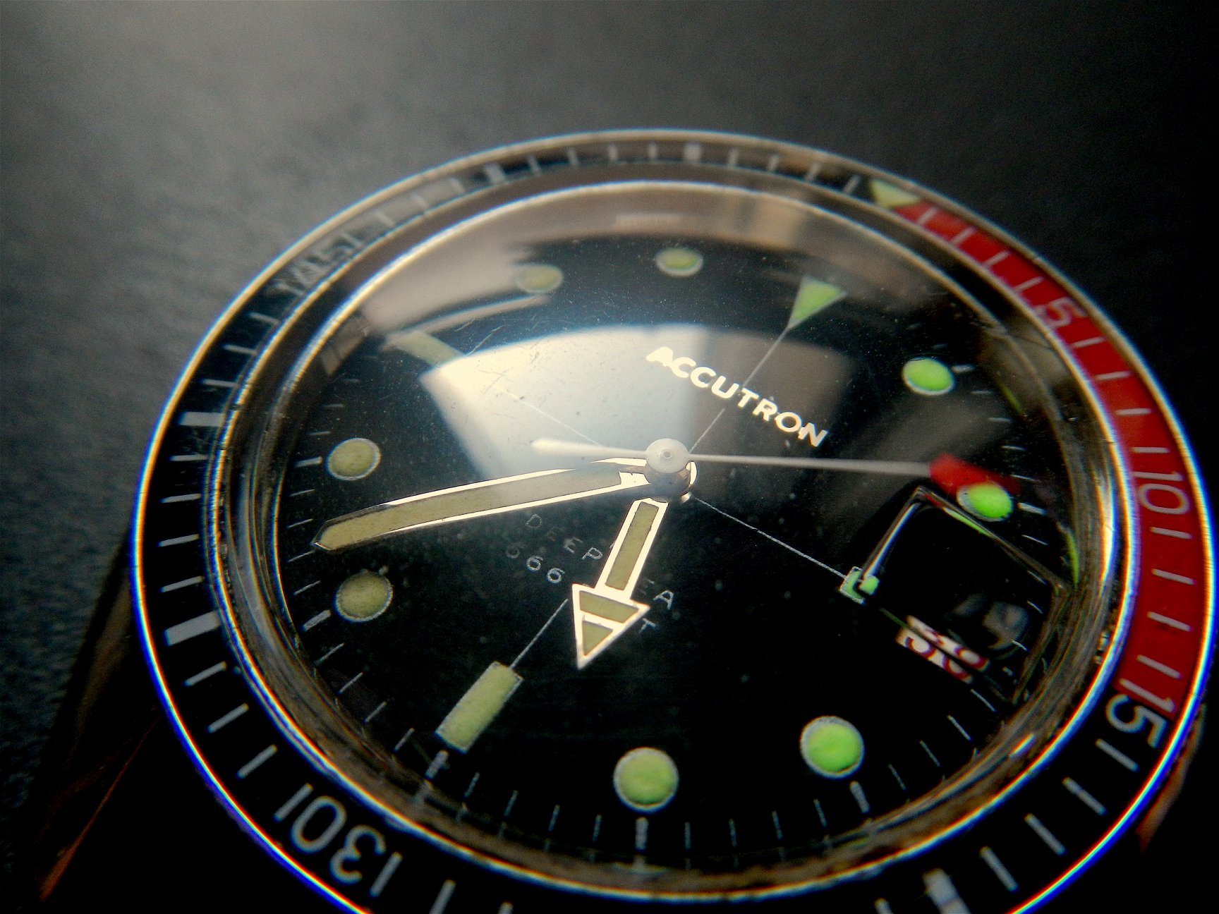

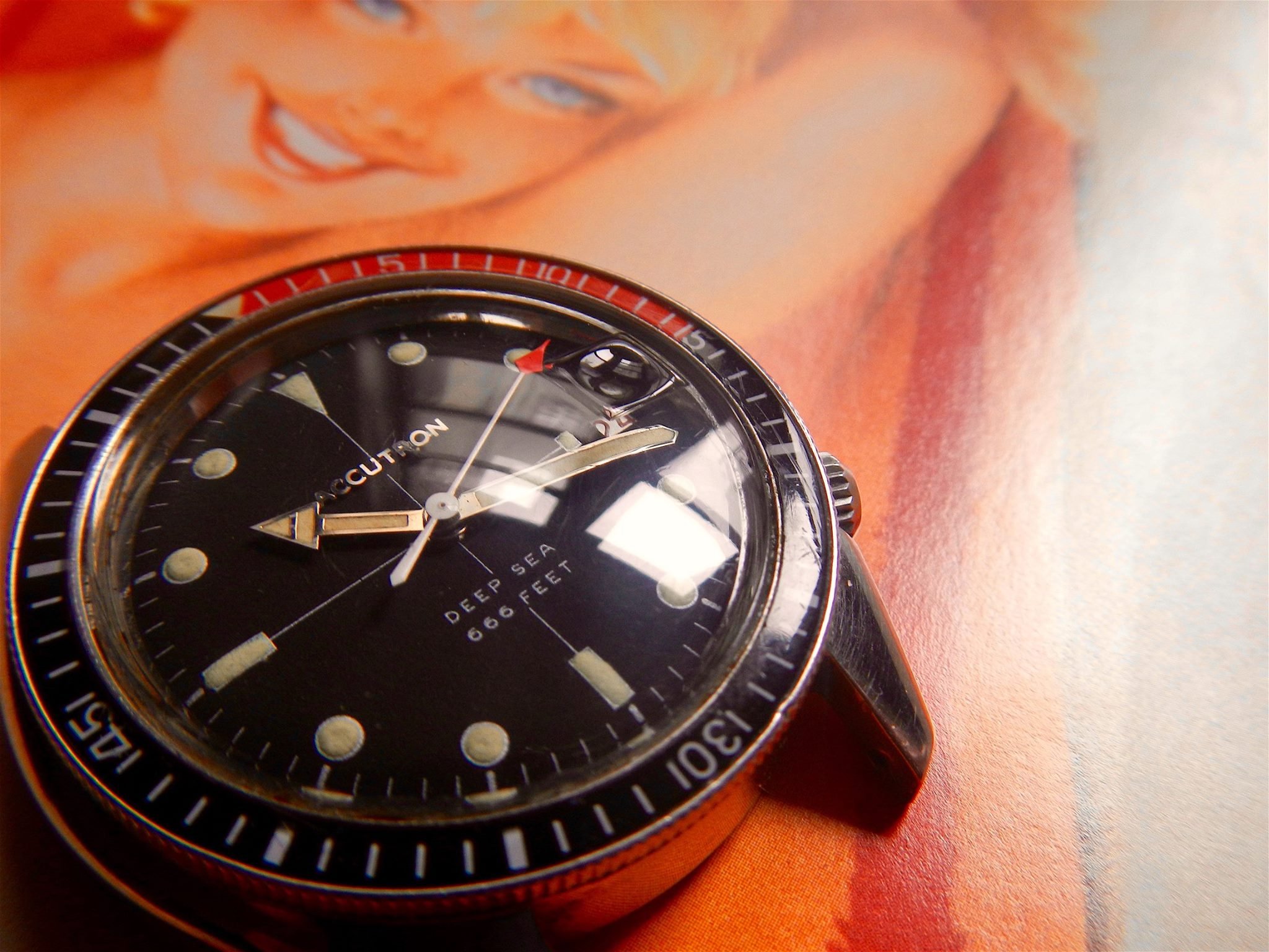

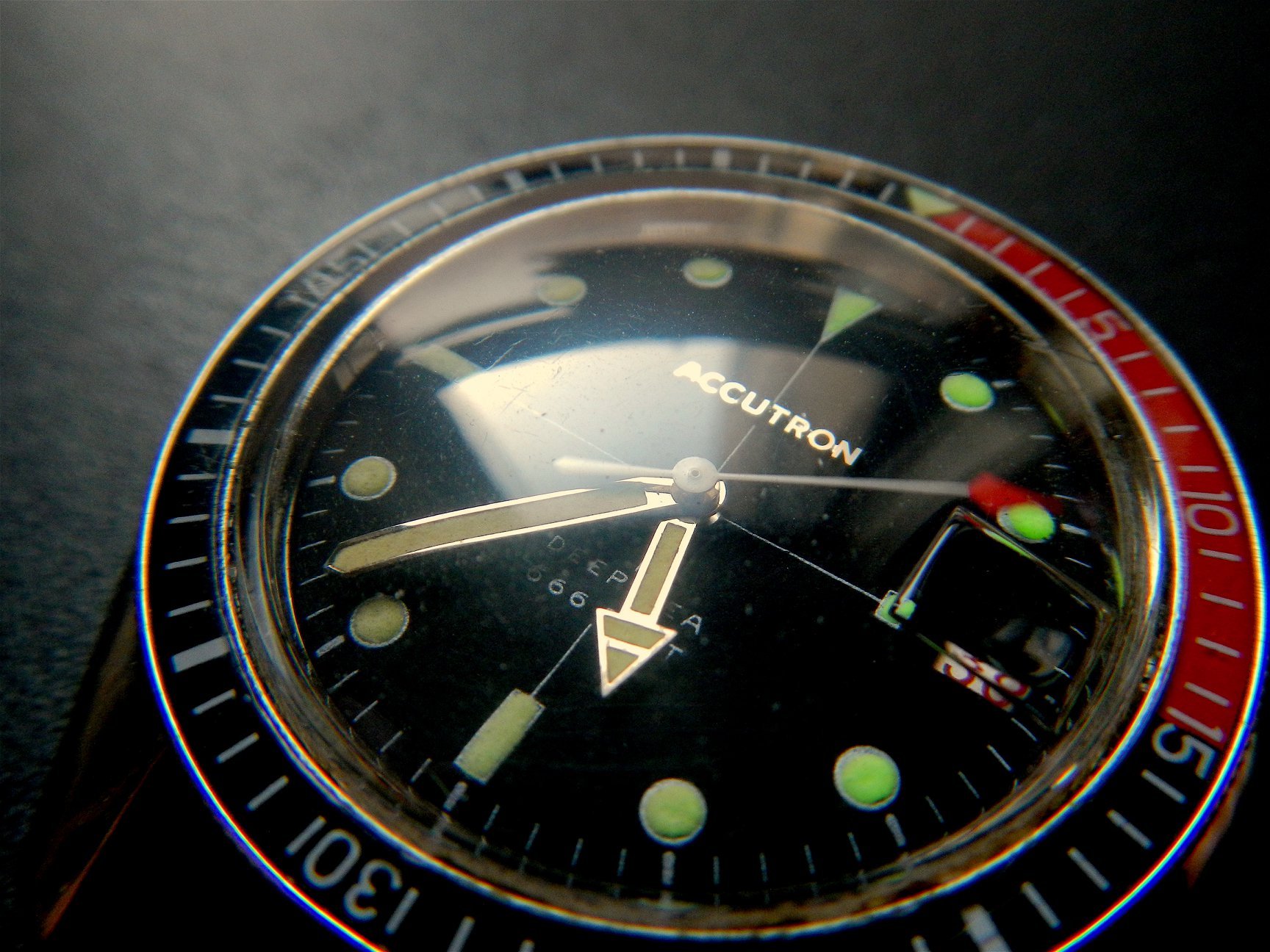

ACCUTRON Deep Sea Diver 666ft Case Ref# 702-1 with accutron 218.1 mvmnt.
[1970)
The Bulova Accutron was in the 60s the most popular $100+ timepiece in America, President Johnson declares it the White House’s official Gift of State.
misc.
Accutron is the first watch to keep time through electronics, it was a revolutionary timekeeping concept of a watch without springs or escapement operated by an electronically activated tuning fork. The movement was so accurate that the US Government asked Bulova to delay the release of the revolutionary movement for fear the technology may fall into the hands of the Russians, at the time US would be launching new satellites timed by the Accutron and they simply did not want the Russians to benefit from the same precision.
In 1960 NASA incorporate the Accutron into its computers for the space program which become an integral part of 46 missions of the U.S. Space Program.
The ACCUTRON 214HN hacking movement was used for all the timing devices for the Apollo spacecraft / program, and also used on the ACCUTRON ASTRONAUT wrist watch

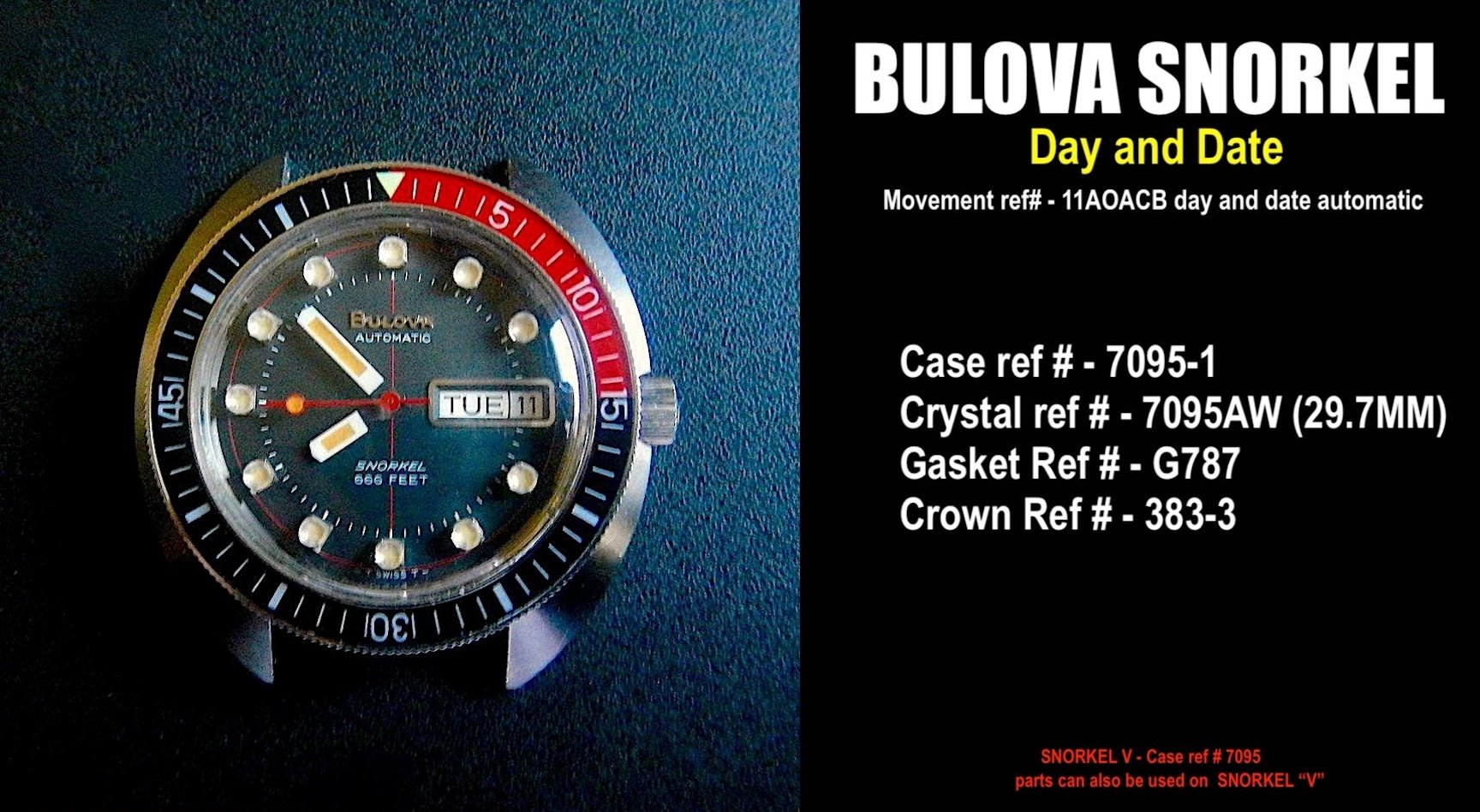

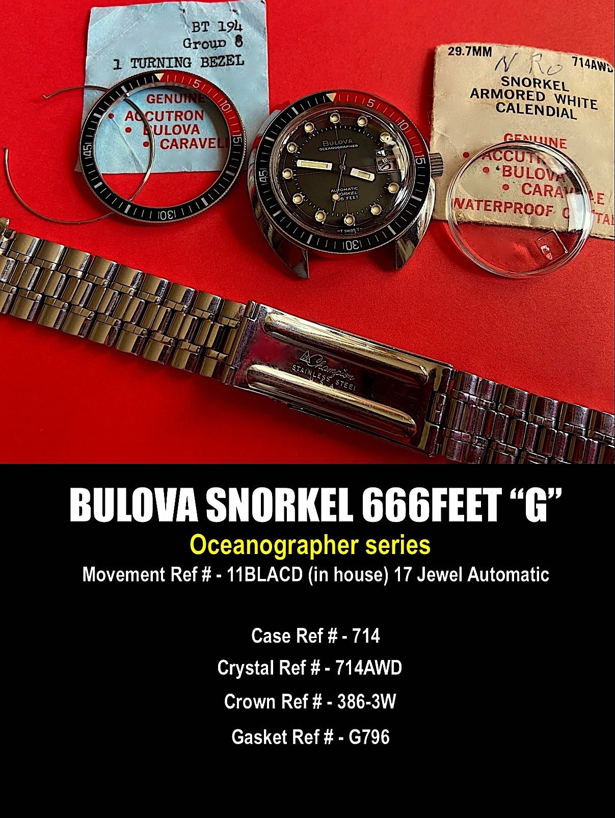

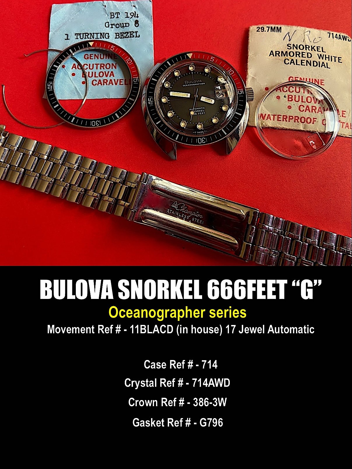

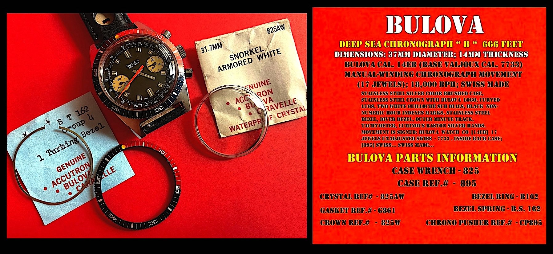

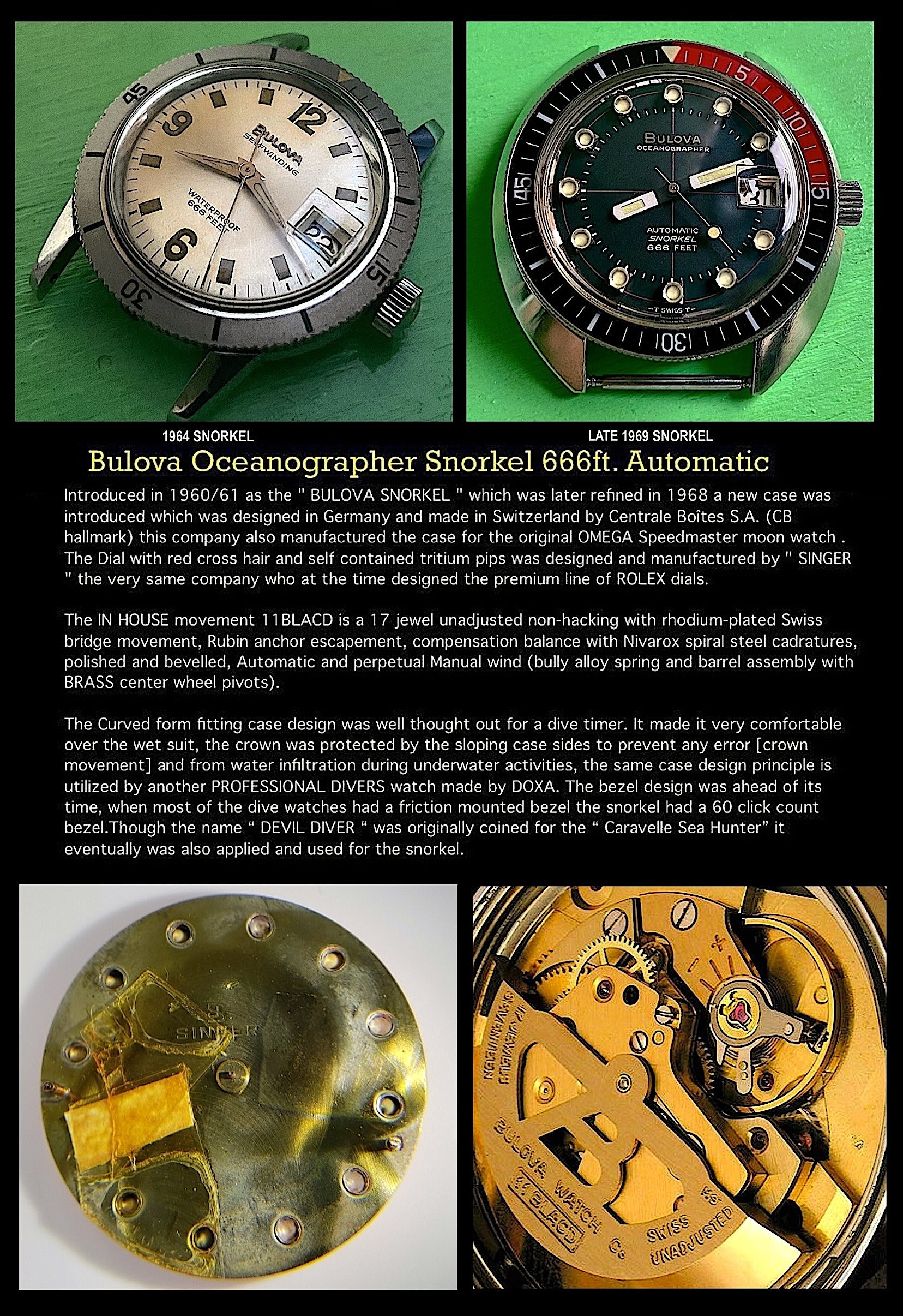

Is it also correct then that a crown having BULOVA on it and in factory packaging that says "Snorkel Crown 386-3 Genuine Bulova" as you show would also be correct for your Oceanographer Snorkel? So in spite of it not having the "W" it must also be watertite?
3,570
17,833
the W is stated on some packaging and charts if not the word SNORKEL is used

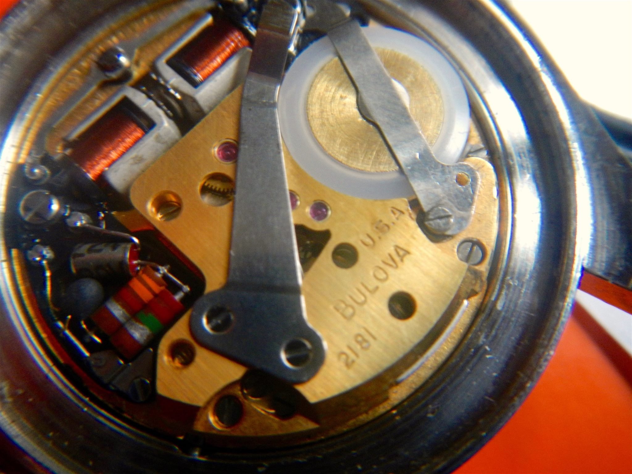

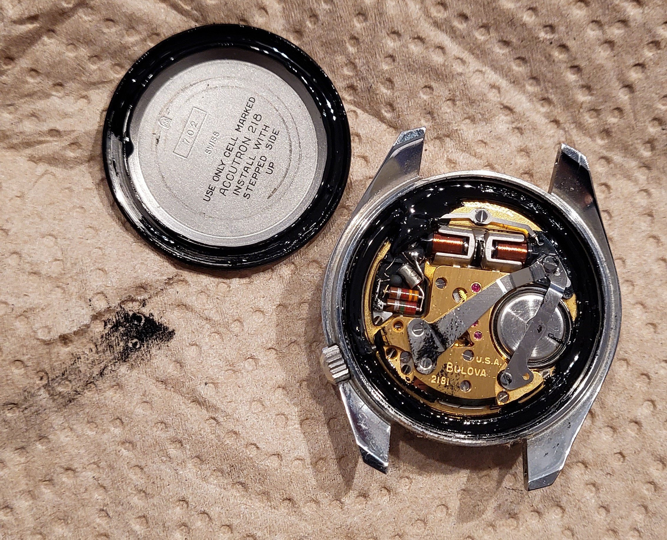

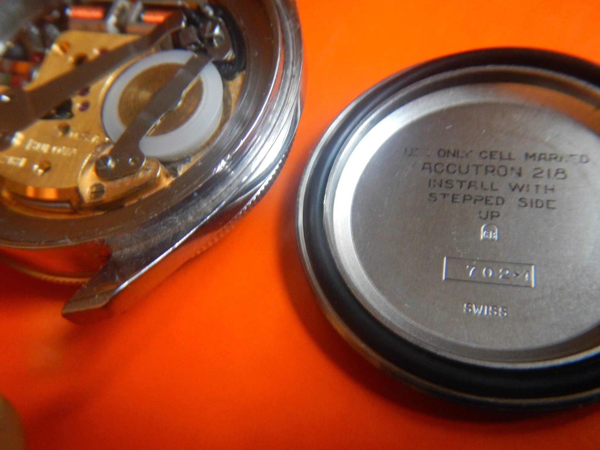

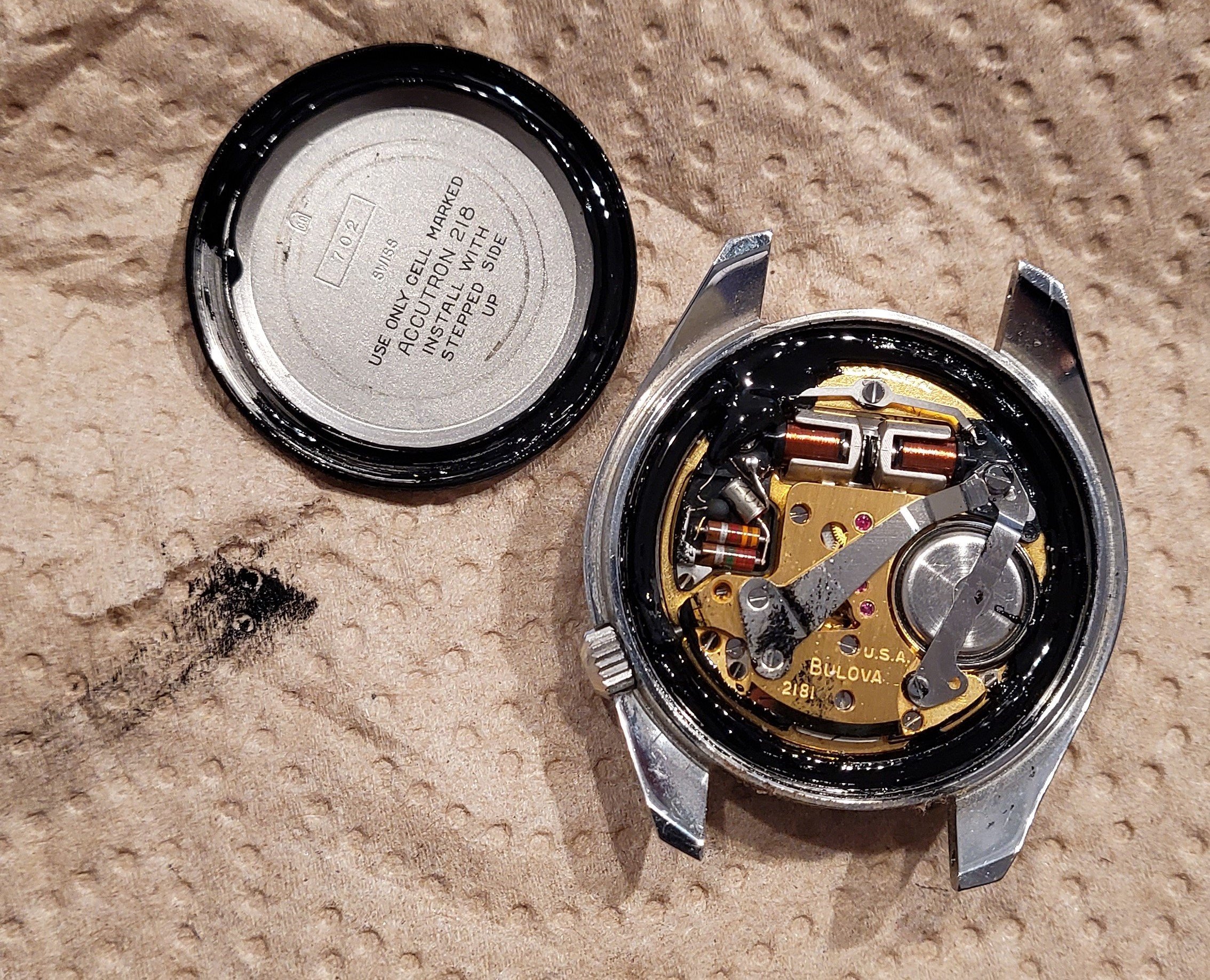

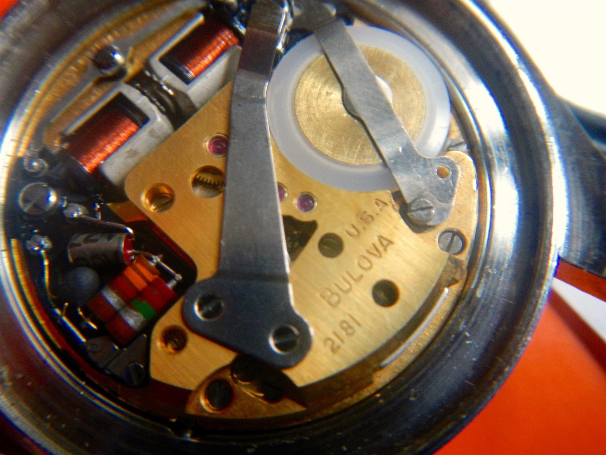

Ever seen this kind if mess in a Bulova? This is a 1970 Accutron.
yes, this means ur watch has not been cracked open in a very very long time, which in a way is a good thing, because in some instances this is a sign that ur timepiece is all original, or the gasket/seals did its job in keeping moisture out ... but it seems some of the (melted) gasket got on to the movement, is it still functioning ?
211
171
It functions intermittently. Yes, the watch looks relatively untouched. It's going to be a real job trying to get this mess off. Sticks like glue to my skin and alcohol doesn't really affect it.
3,570
17,833

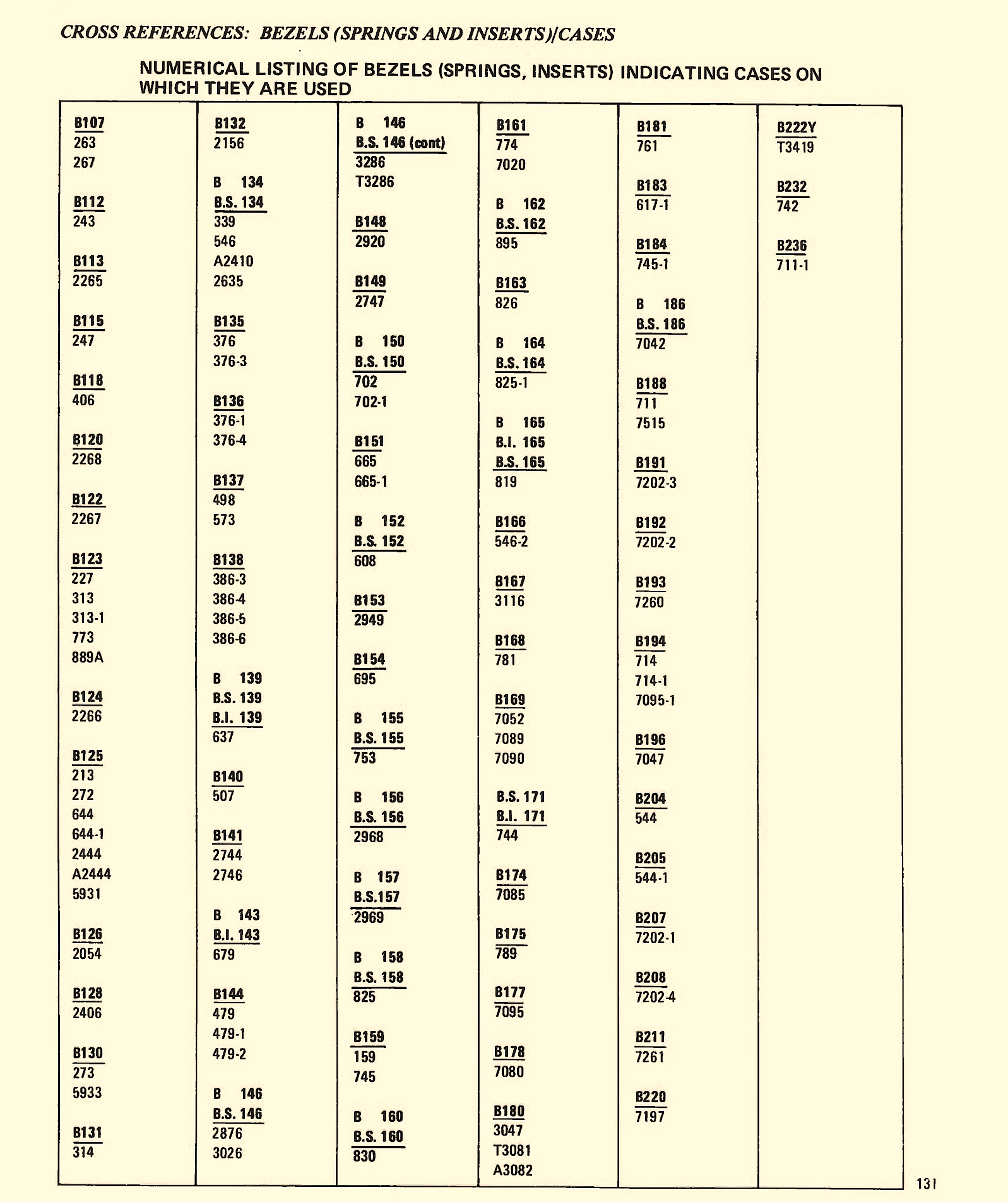

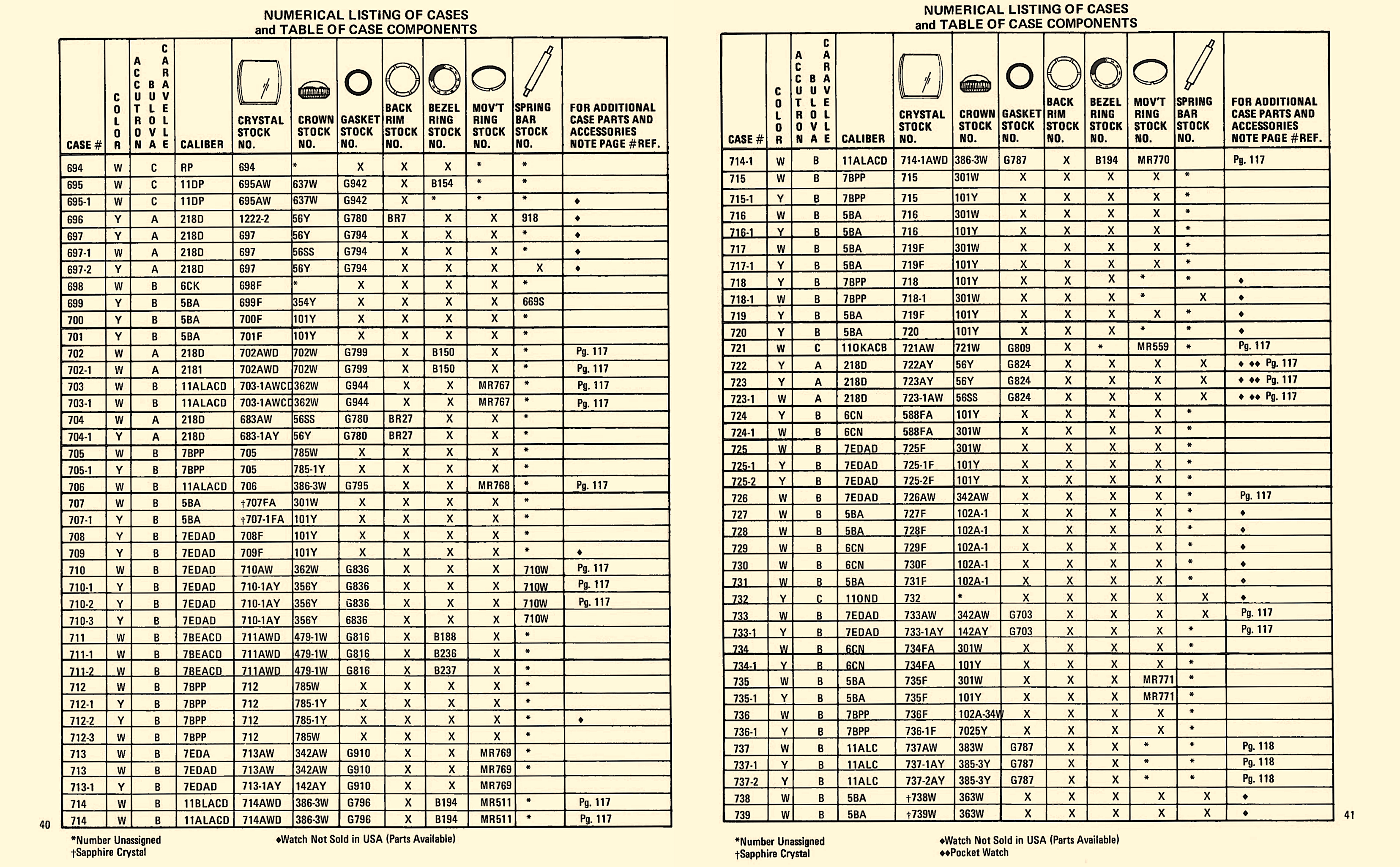

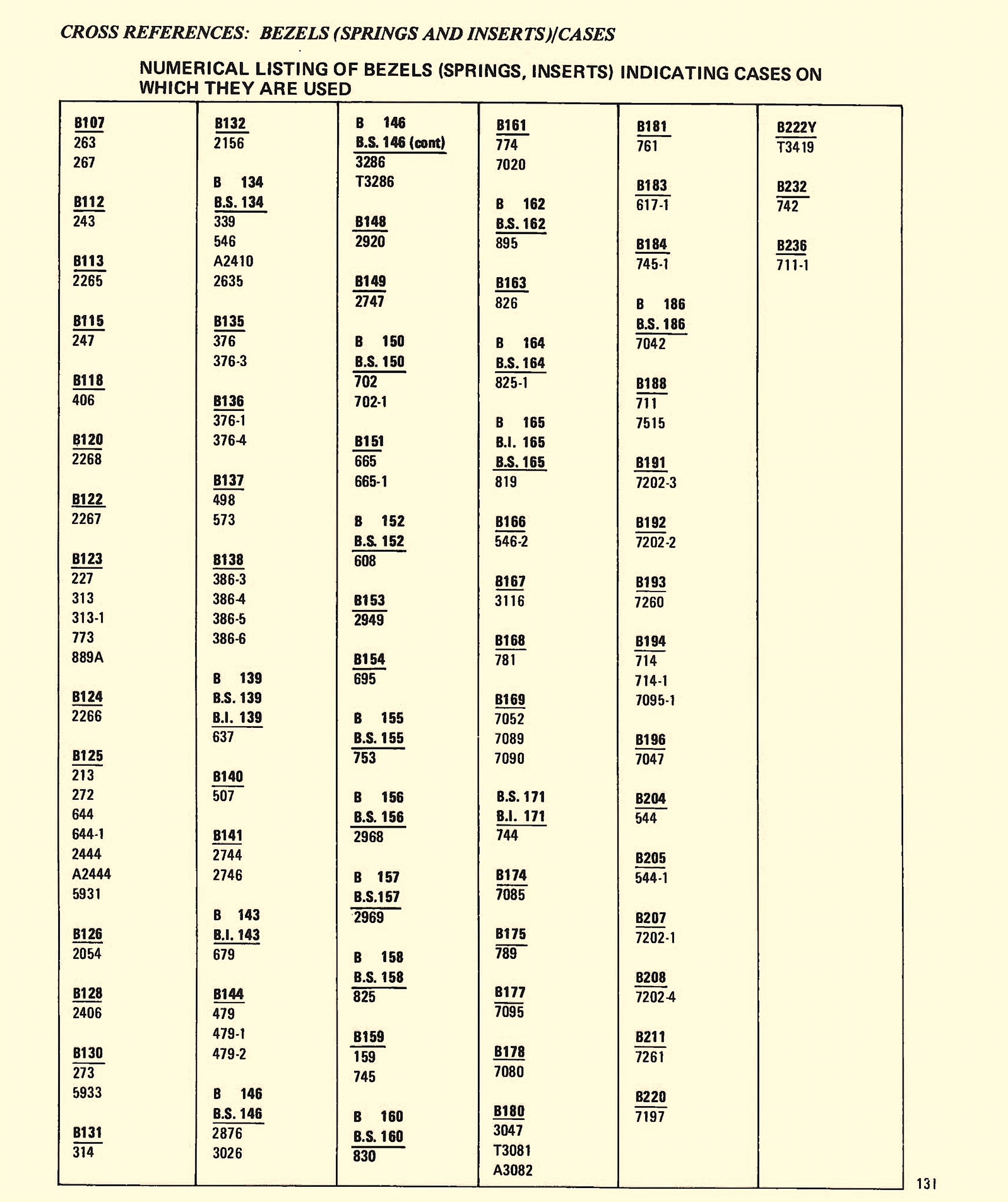

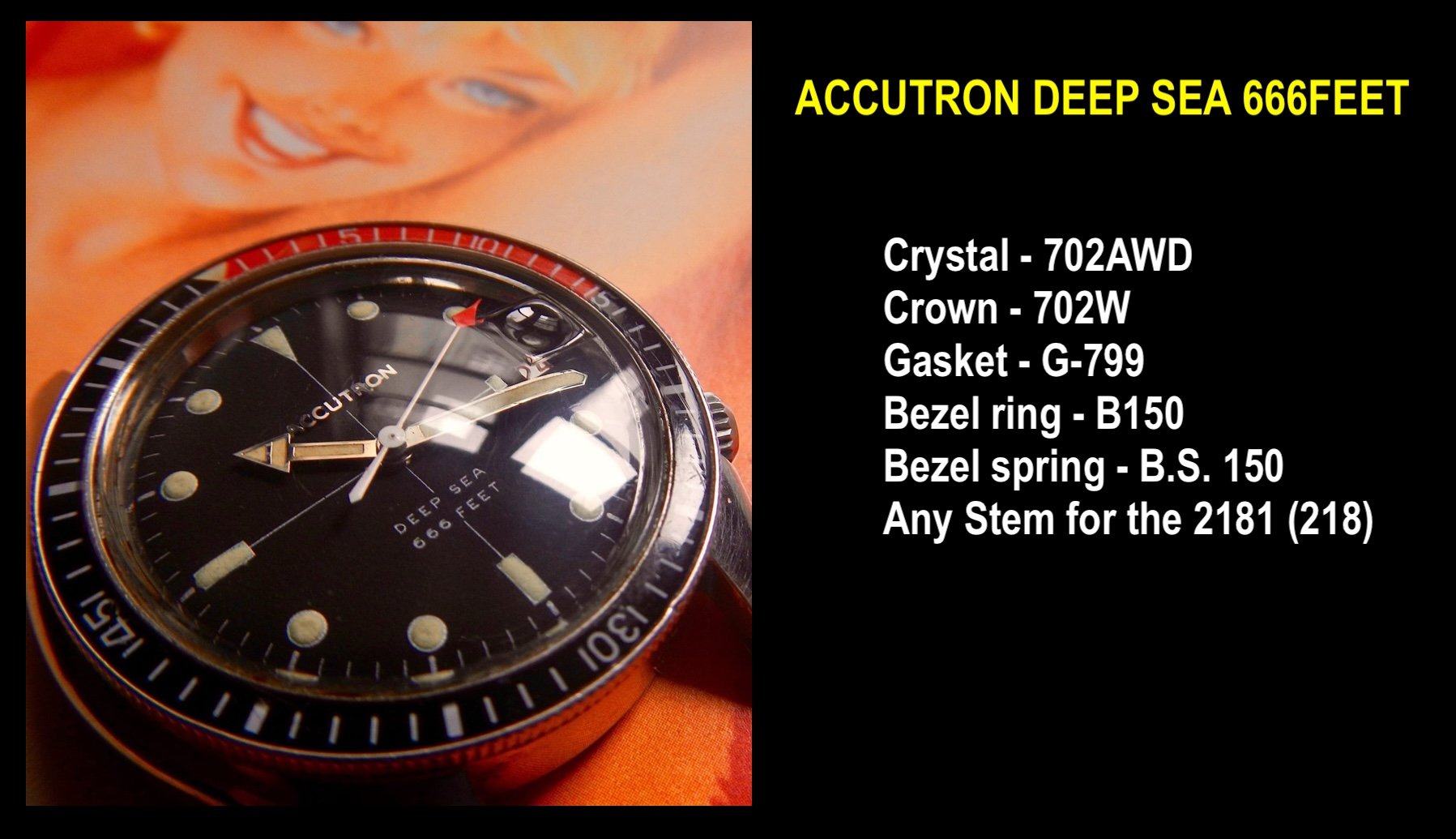

Happen to know what gasket I'll need?
O-Ring / Gasket for case ref# 702 uses --------- Case Back Gasket is # G799
other misc. parts info.
Crystal - 702AWD
Crown - 702W
Bezel ring - B150
Bezel spring - B.S. 150
Any Stem for the 2181 (218)
211
171
Crystal - 702AWD
Crown - 702W
Bezel ring - B150

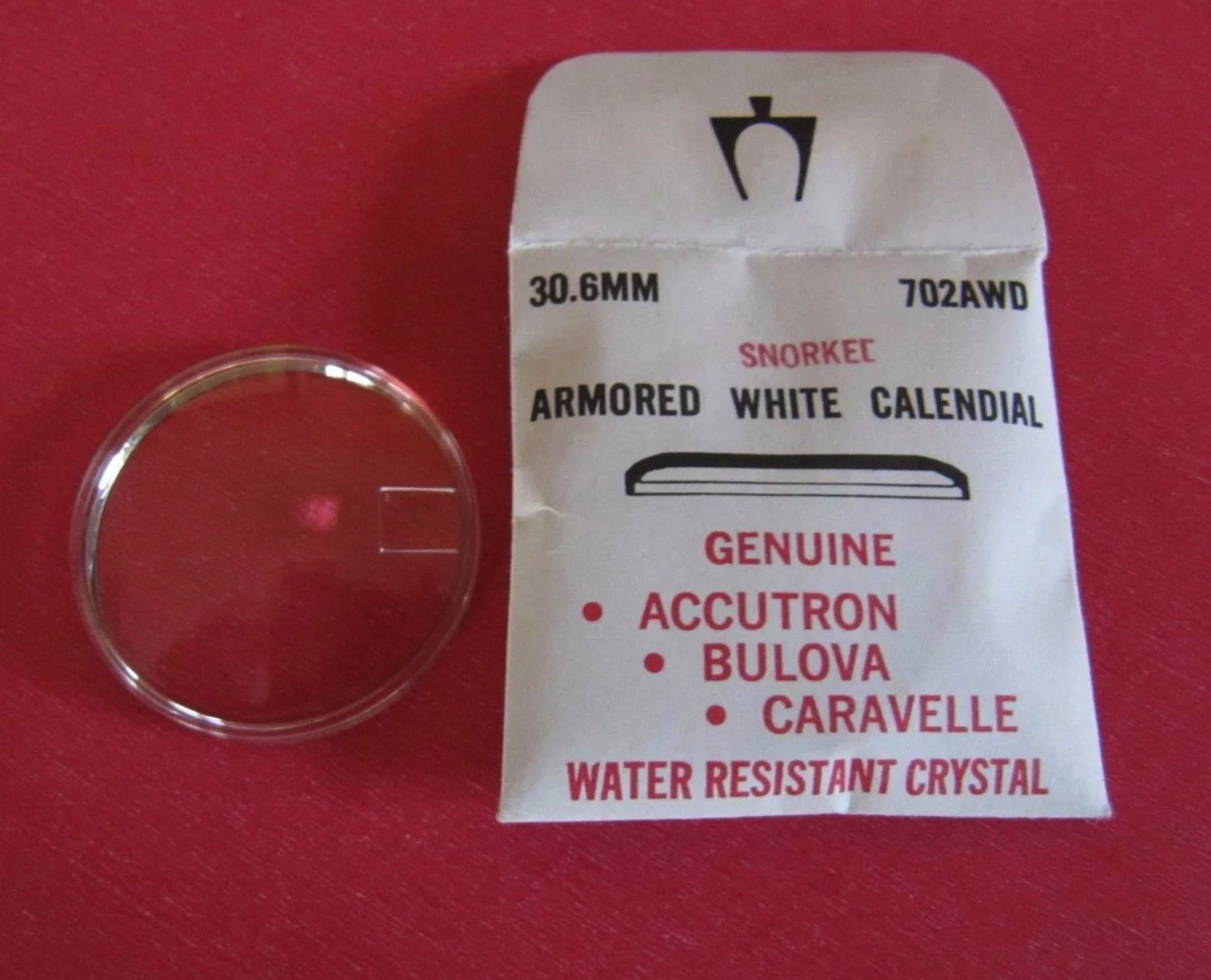

Fortunately the gaskets are still avail and just bought one. But as you know, the crystal and bezel are pretty much unobtainable.
3,570
17,833

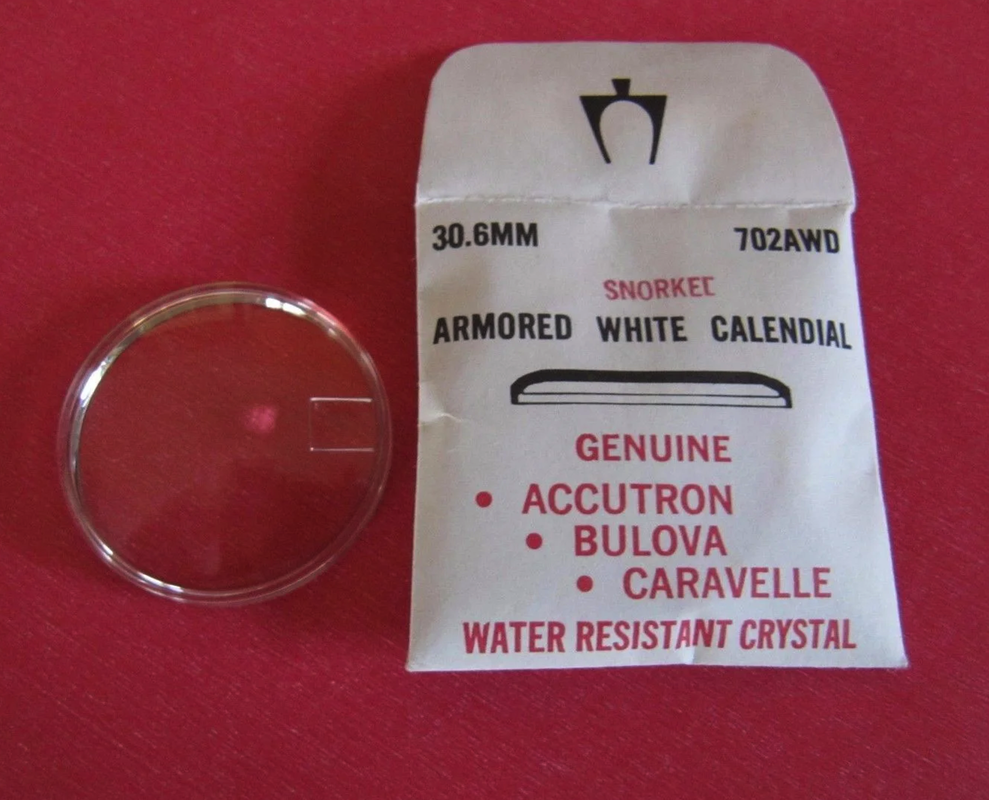

This is the OEM Bulova crystal 702AWD along with it's specs/details ...
U can also reach out to G-S Watch Crystals & Supplies and give them the specs and also mention it is for a DIVER and it also has a date magnifier ..... they have old new stock of their old parts inventory, they might be able to give u their equivalent replacement crystal
Link for - G-S Watch Crystals & Supplies
https://www.gssupplies.com/crystal-catalogs

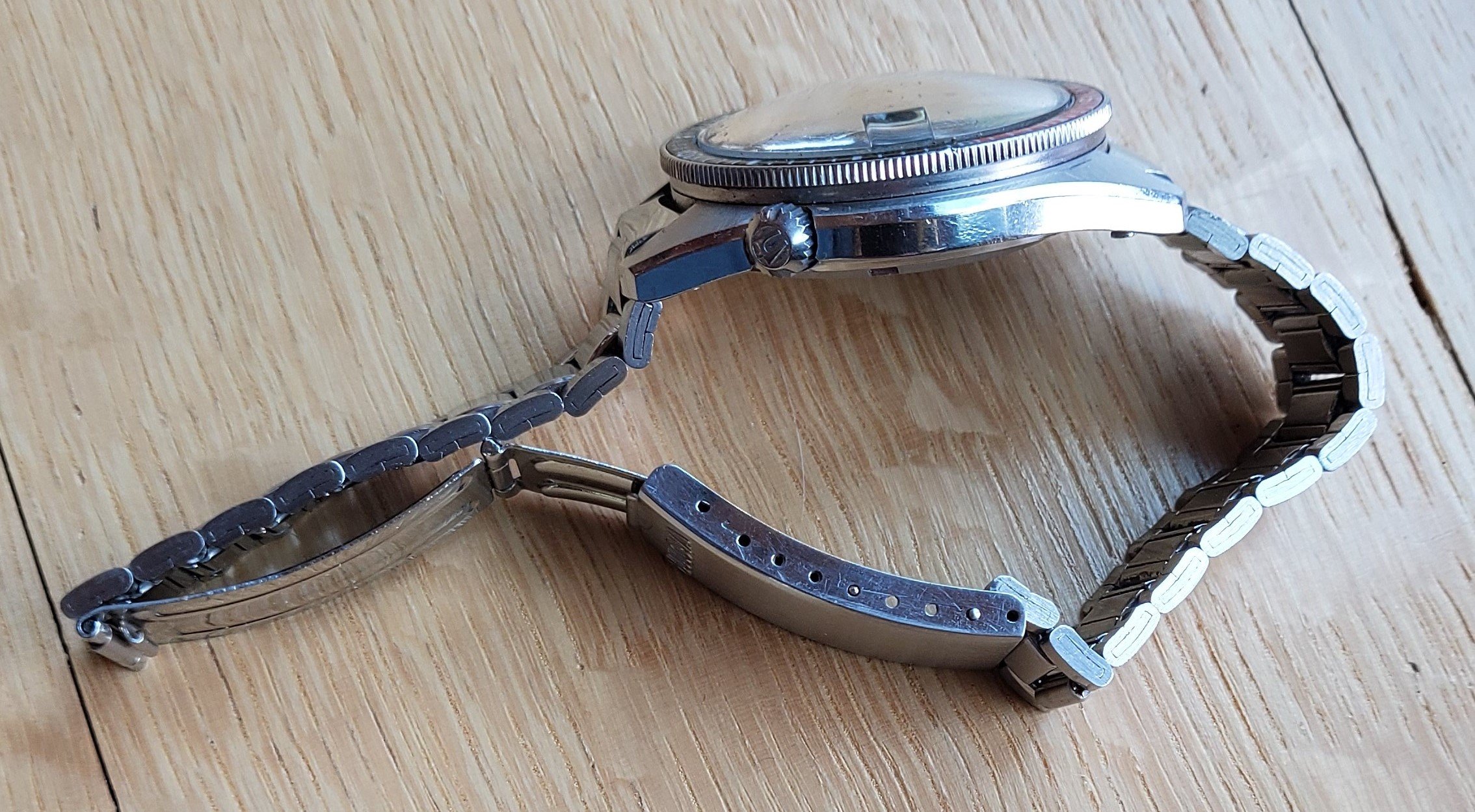

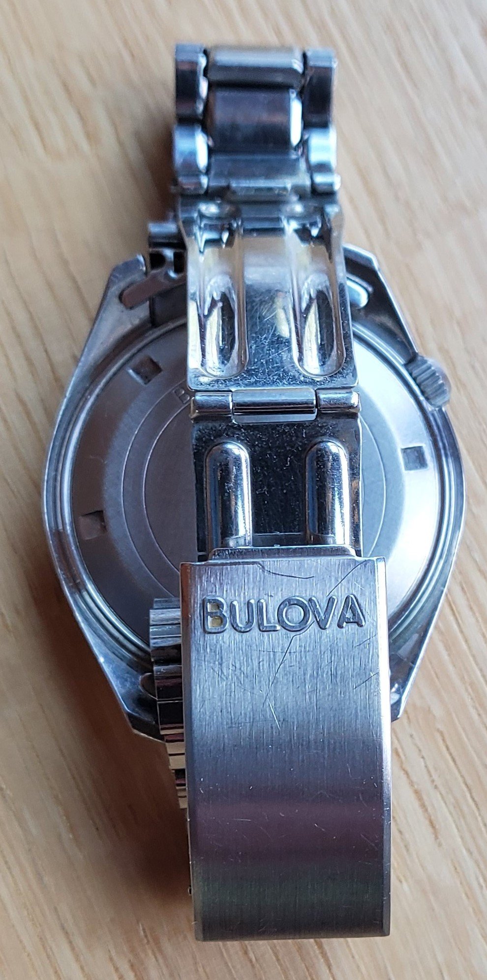

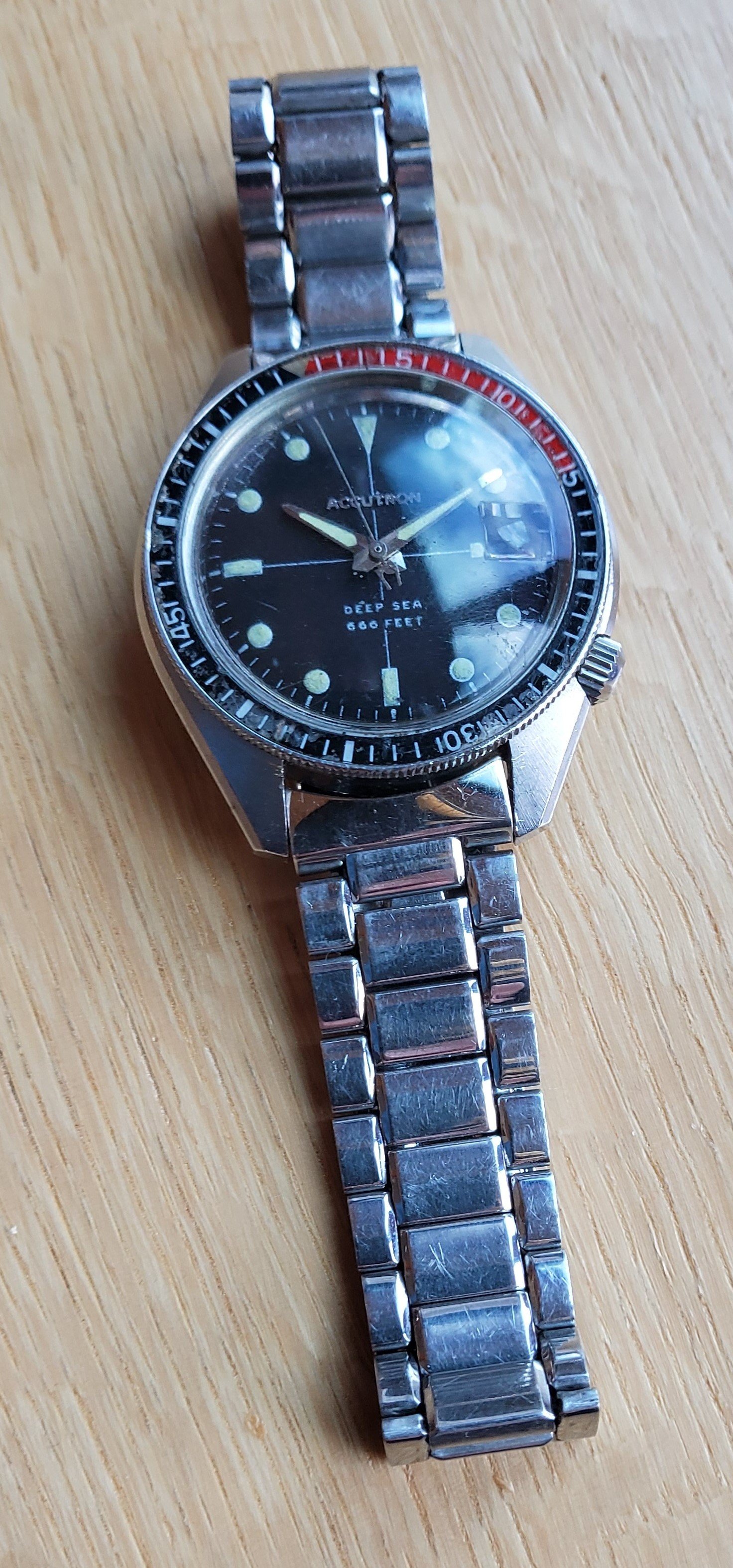

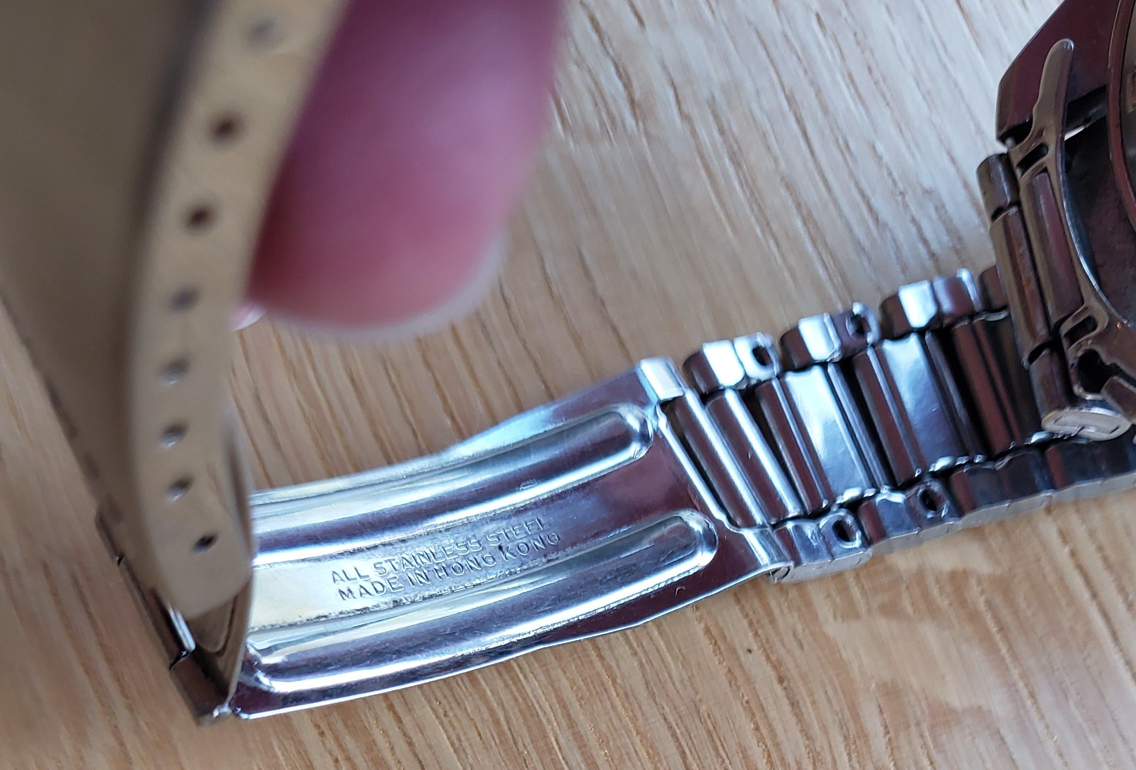

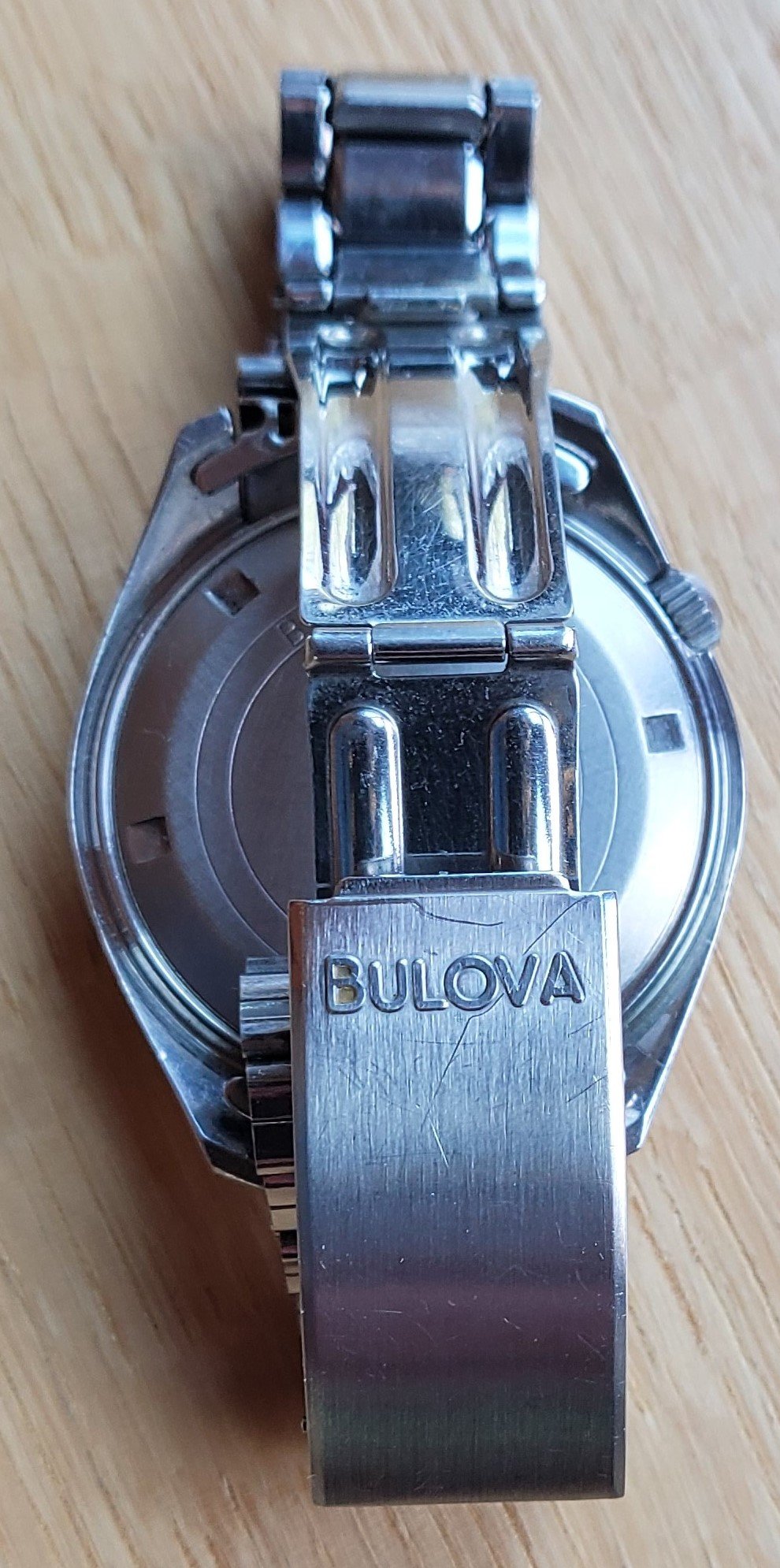

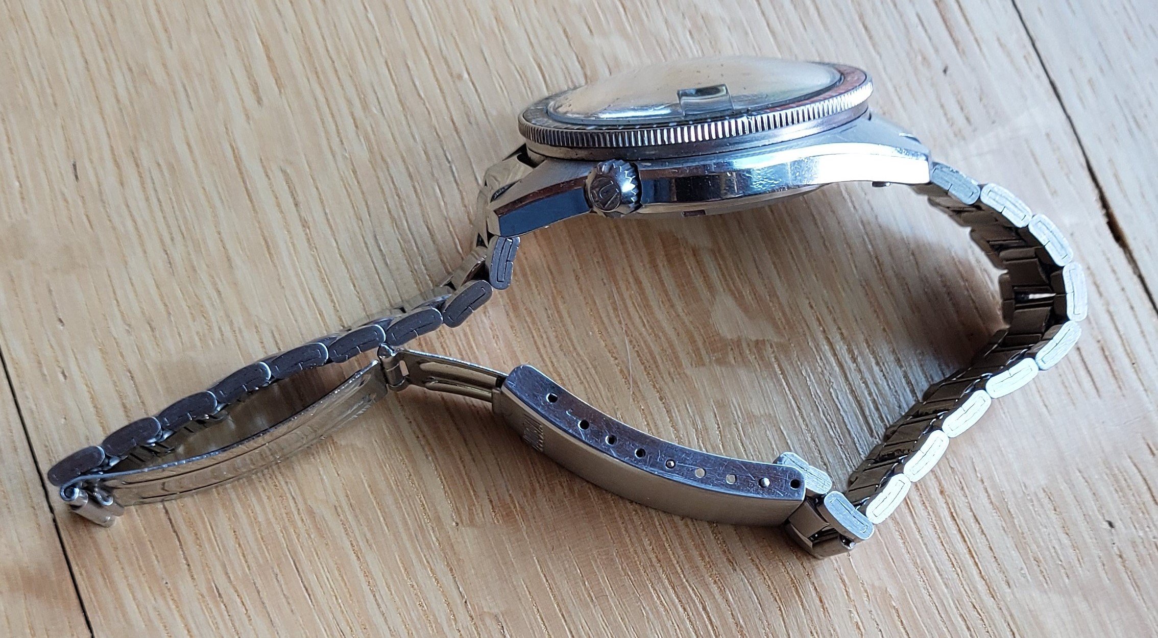

Picked up this Accutron Deep Sea 666 that the seller said included the original bracelet. It's not, and I don't see a similar photo anywhere here. It has a Bulova clasp which only states ALL STAINLESS STEEL MADE IN HONG KONG on the back. About 17.8mm curved end links. Anyone recognize it?
3,570
17,833

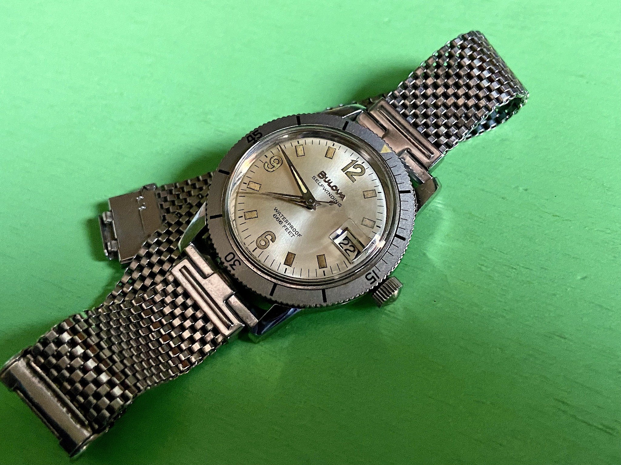

yupe, Bulova branded made in Hong Kong and or Japan SS bracelets would be something that would be offered as an option to a customer by the store owner back in the day instead of a JB Chamnpion USA bracelet
