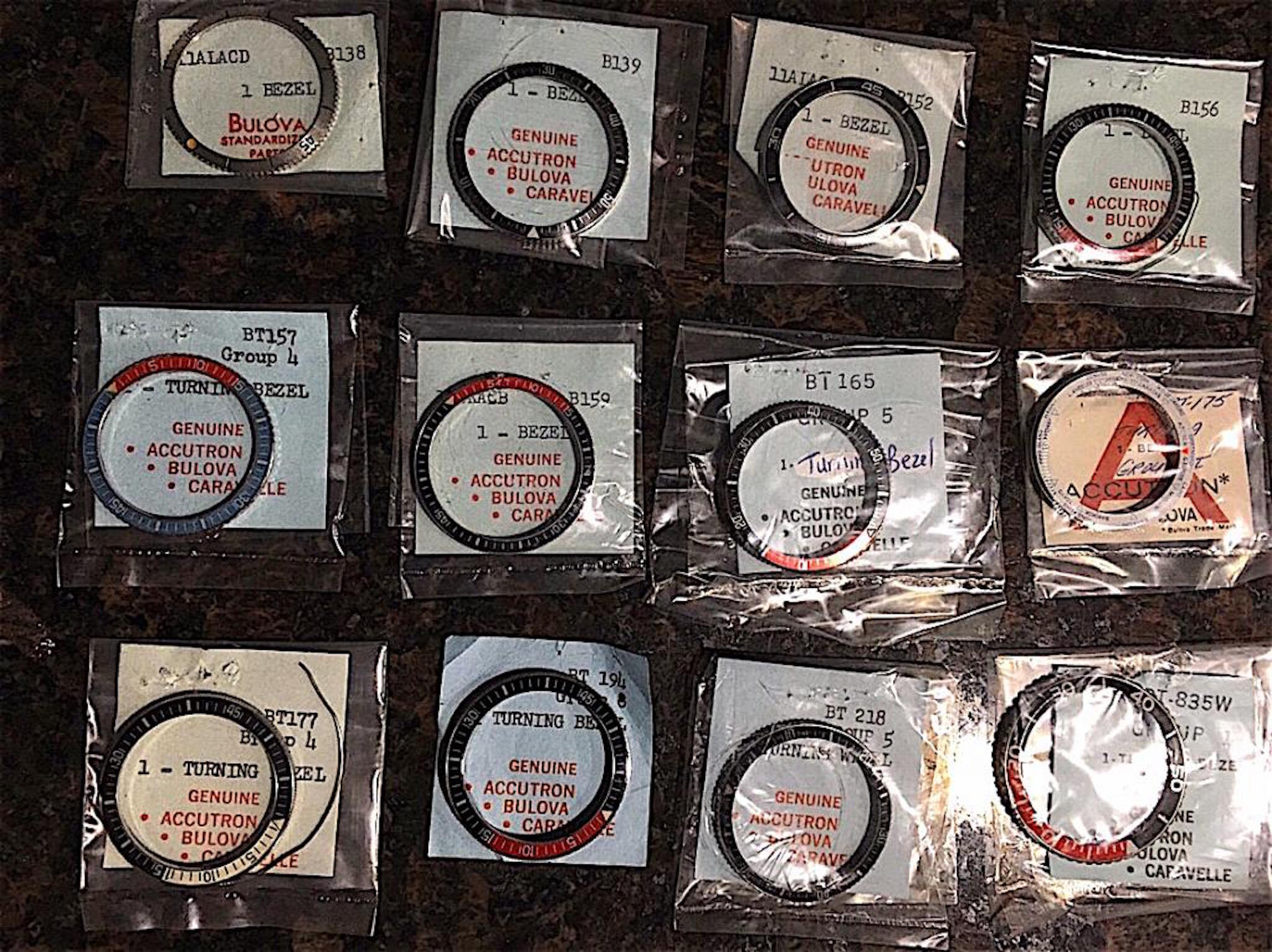

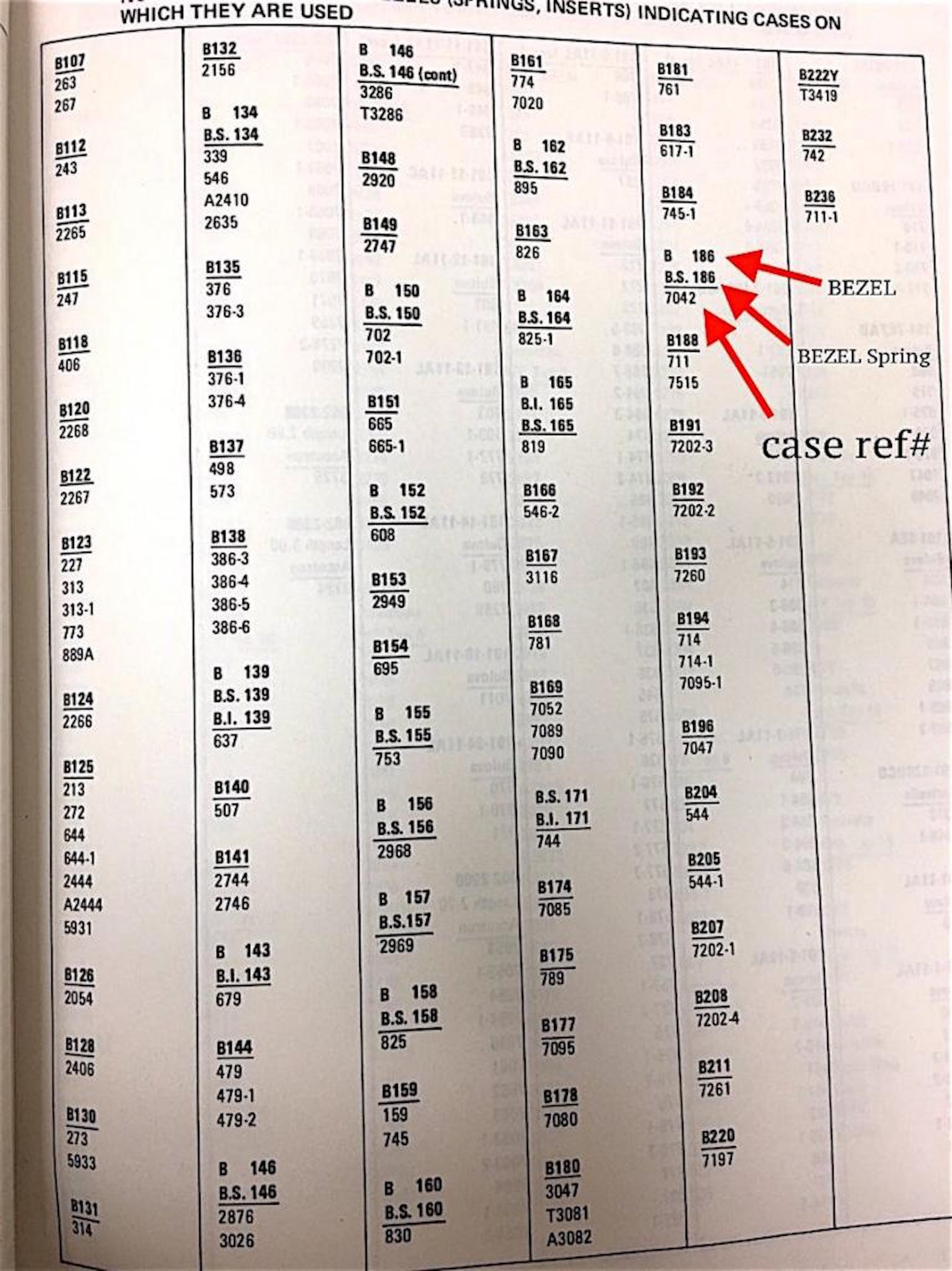

VINTAGE BULOVA BEZEL and WATCH CASE GUIDE
3,707
18,282

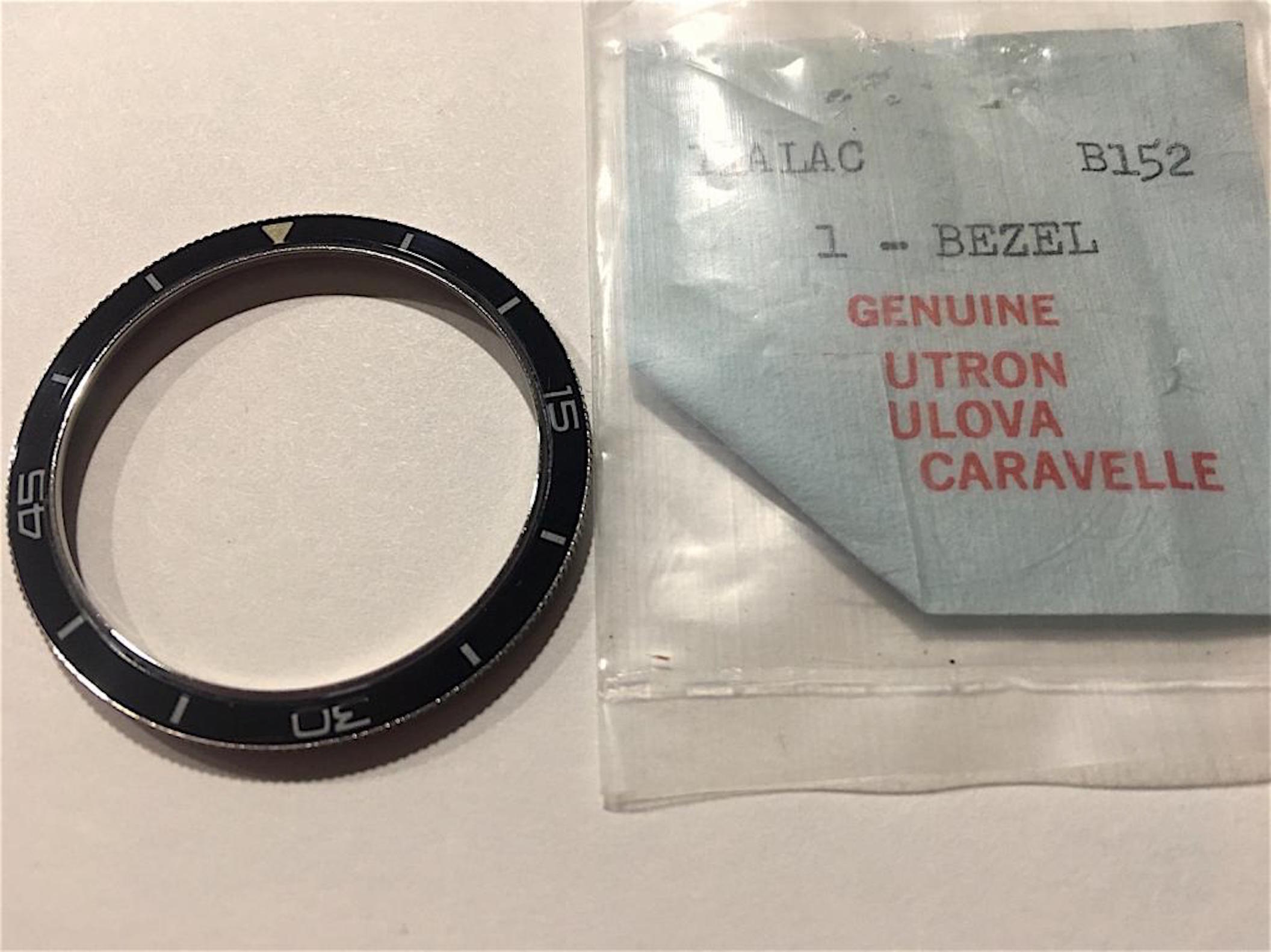

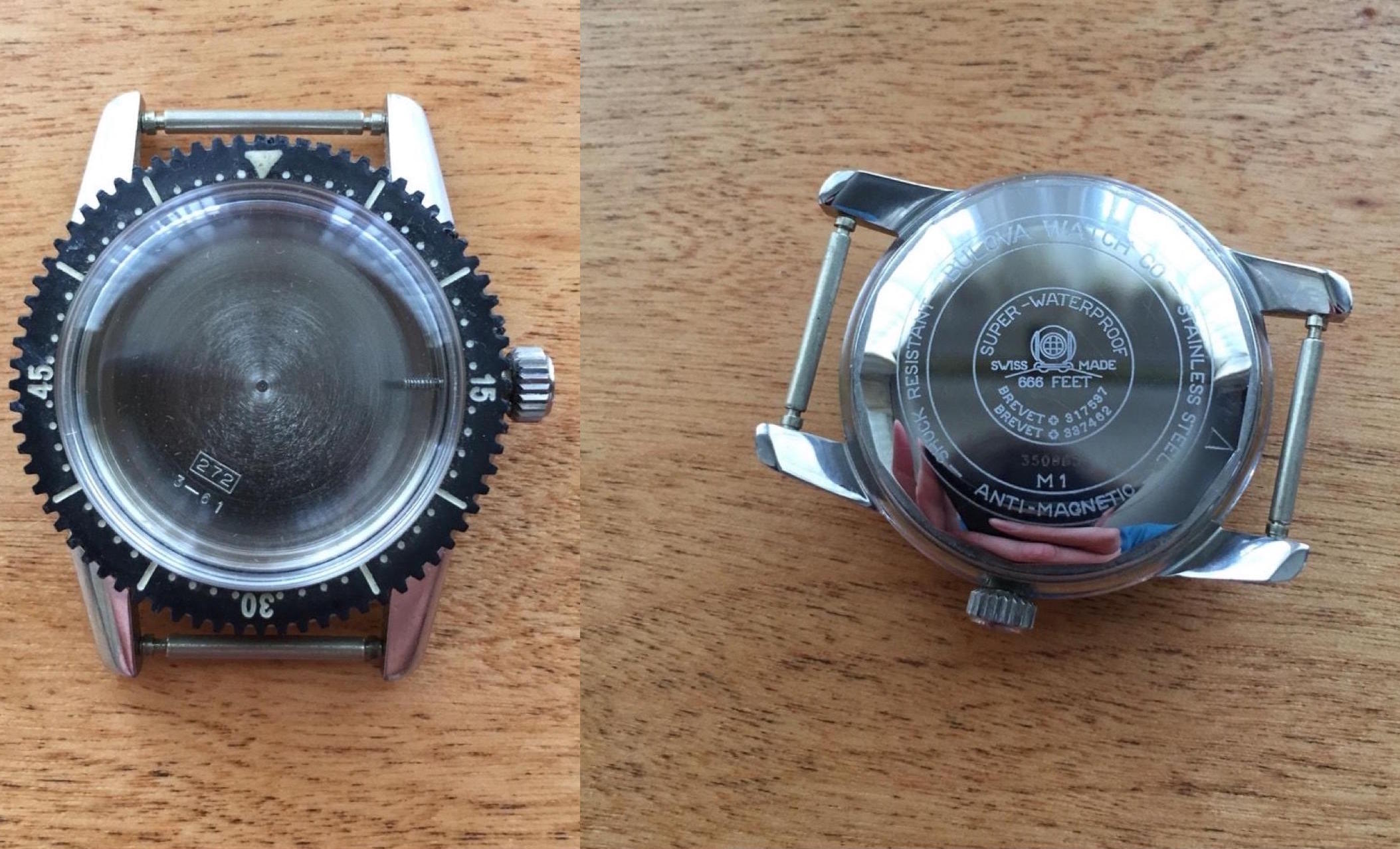

SINGLE CROWN COMPRESSOR
Case ref# 272
Bezel ref# " B125 "
Bezel for this model is made of a solid composite blend [resin plastic] ....

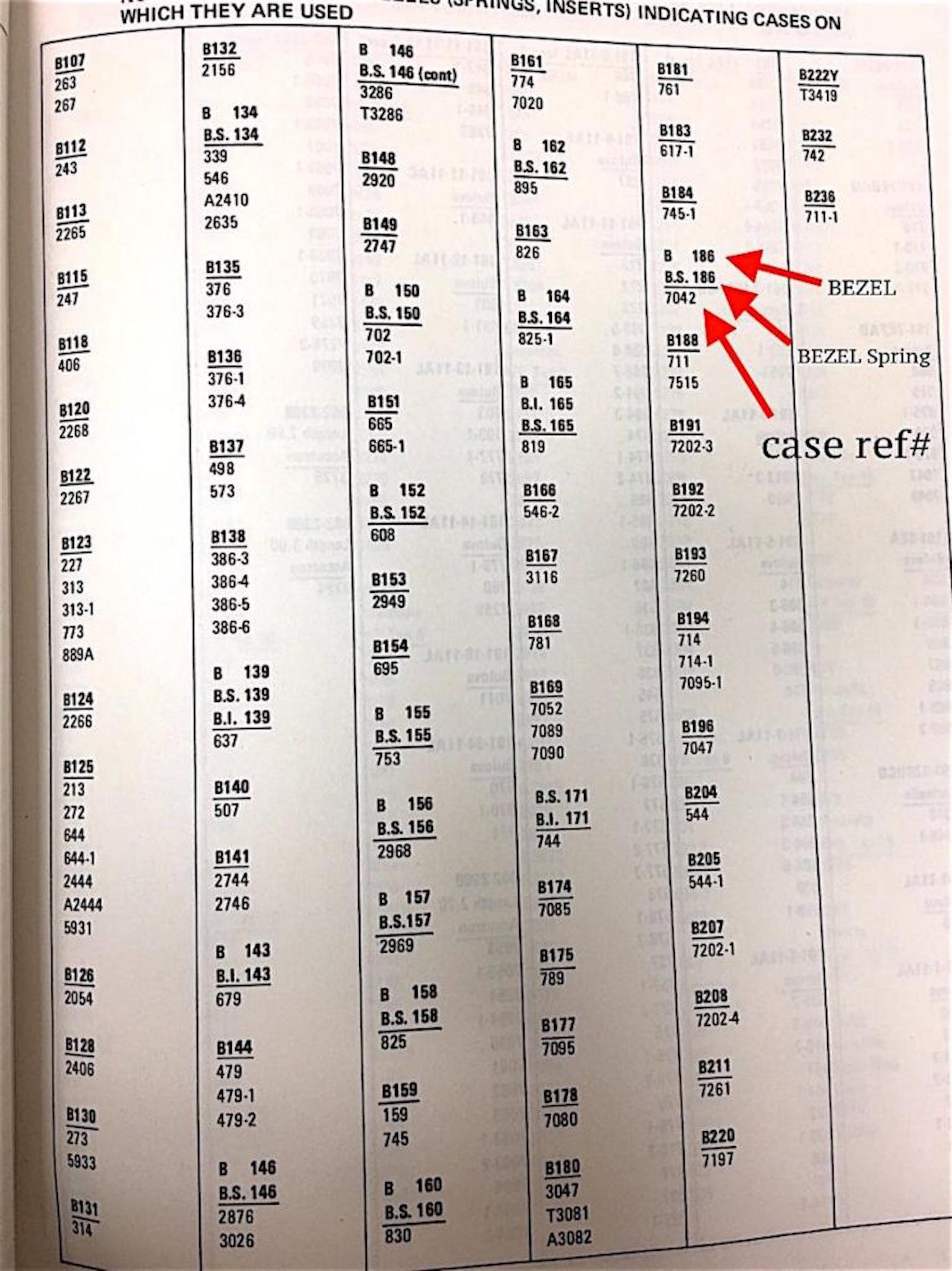

Your posts with the Bulova case, bezel, crystal, crown, and spring reference information are by far the most comprehensive resource I've found, and they appear to be based on factory documentation rather than the information that's publicly available online.

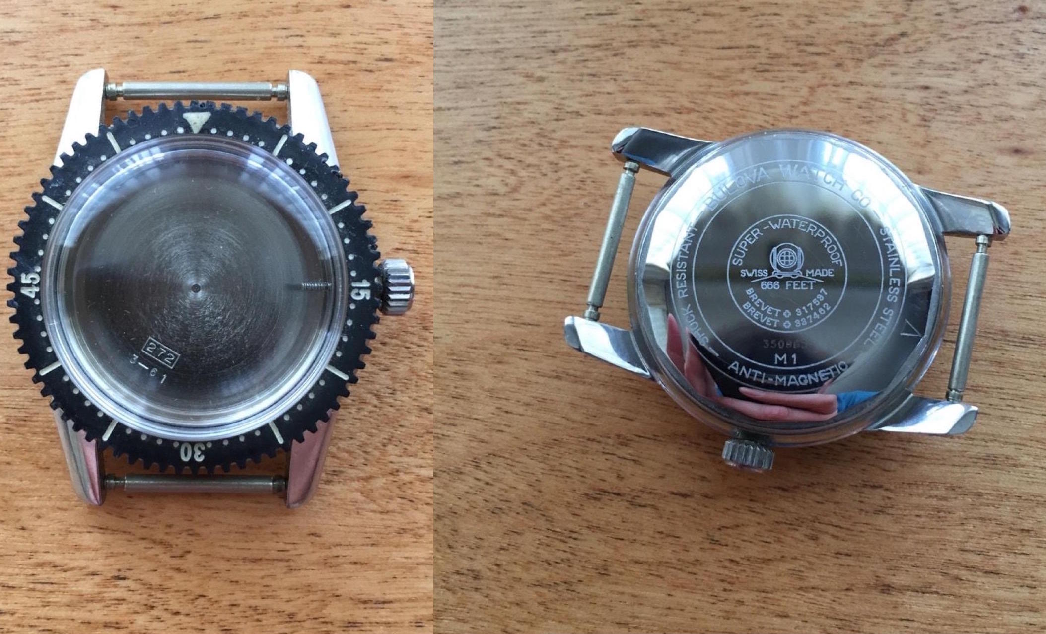

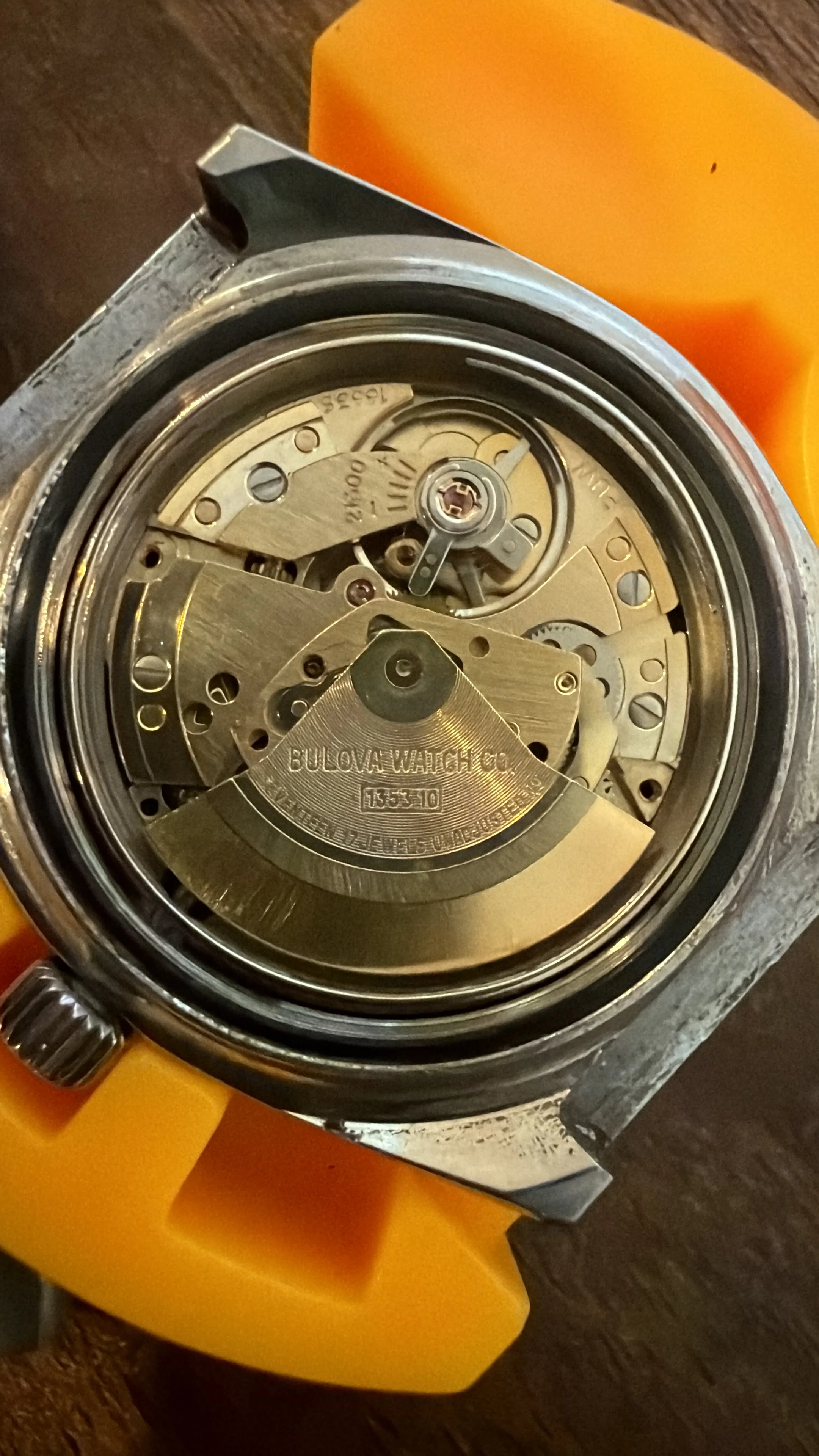

hey there ... may i see a photo of the watch in question ? case back both outside and inner, also the mvmnt ? does the dial have info like ... set-o-matic ... or date-o-matic ... etc etc

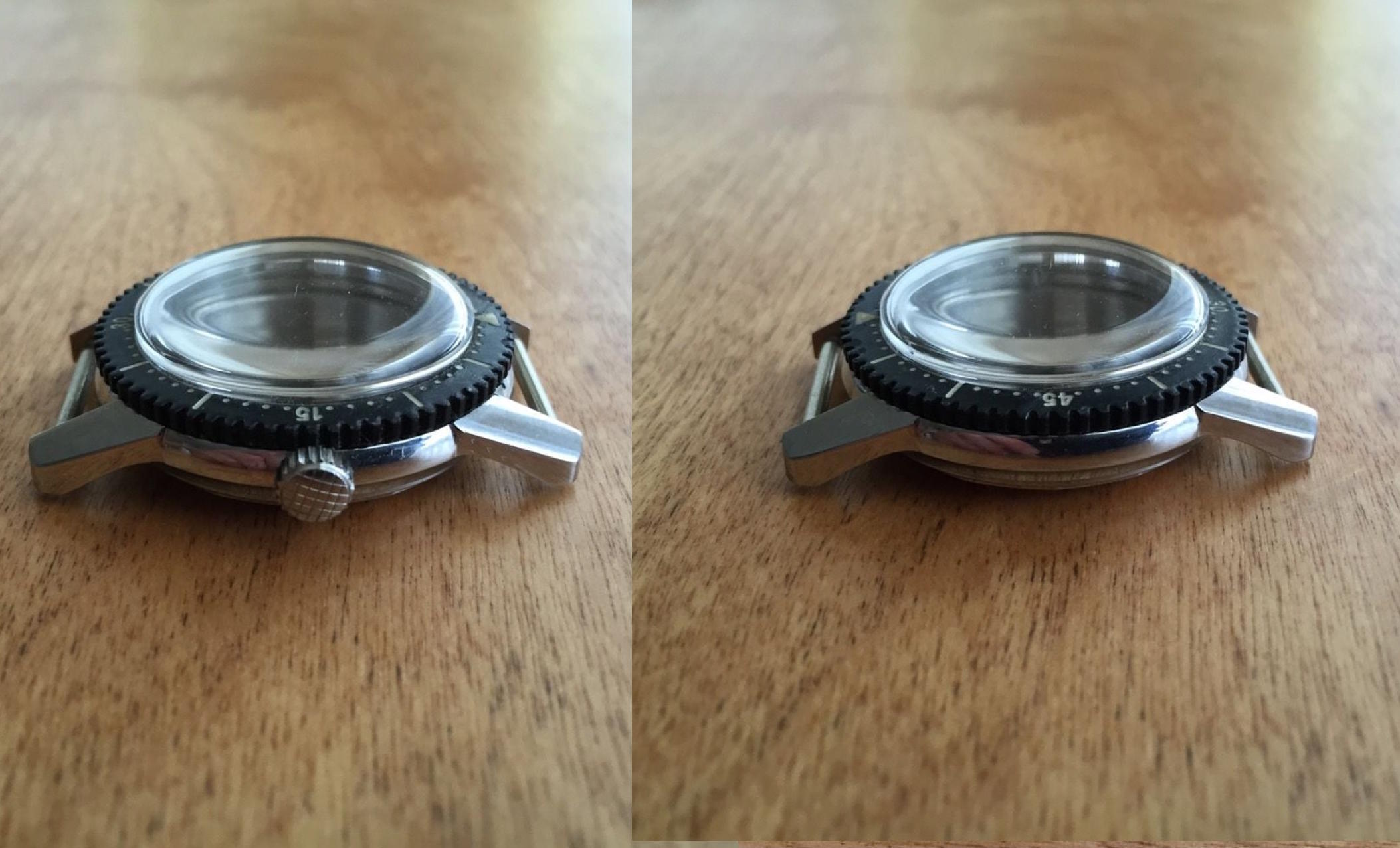

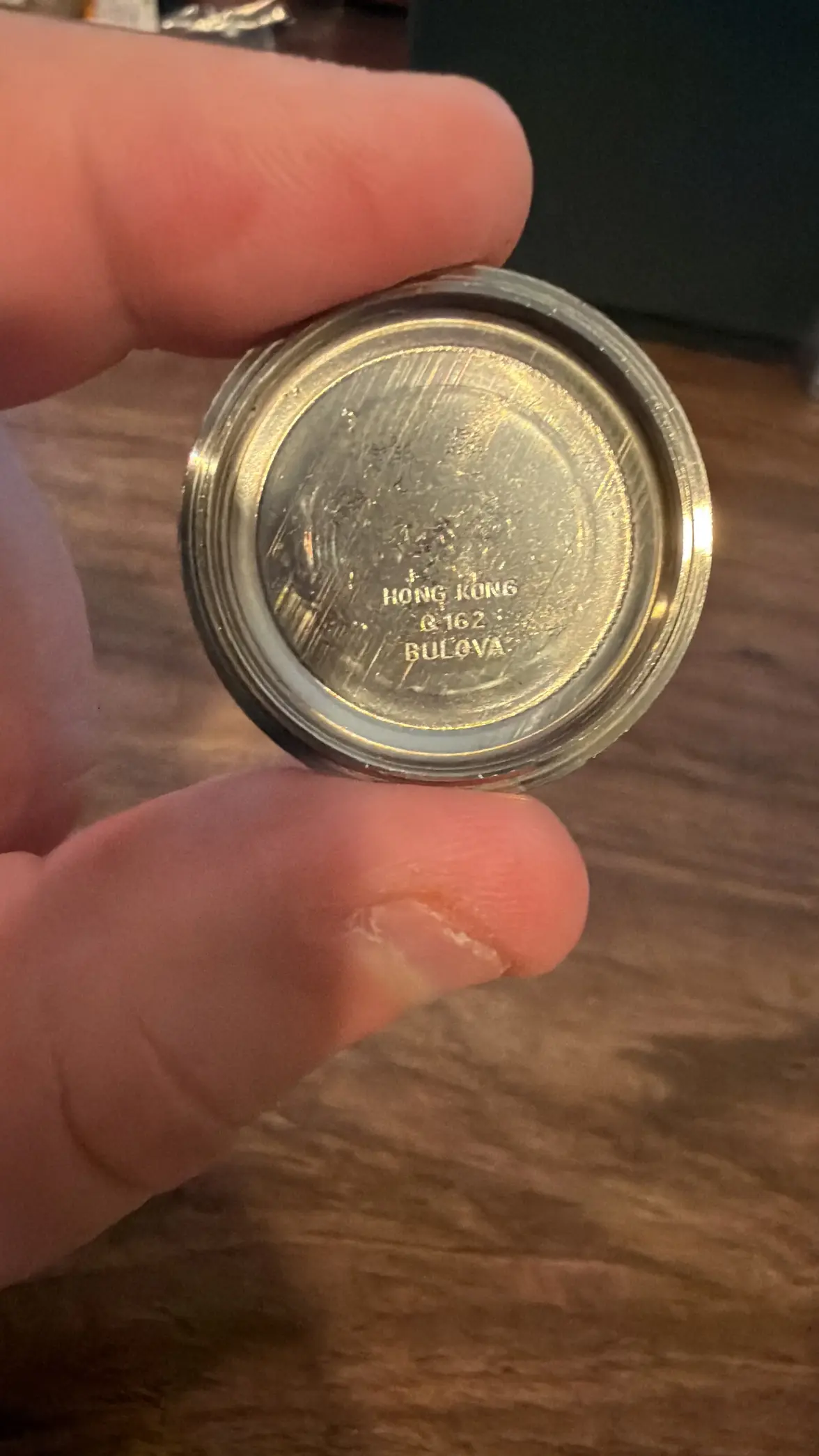

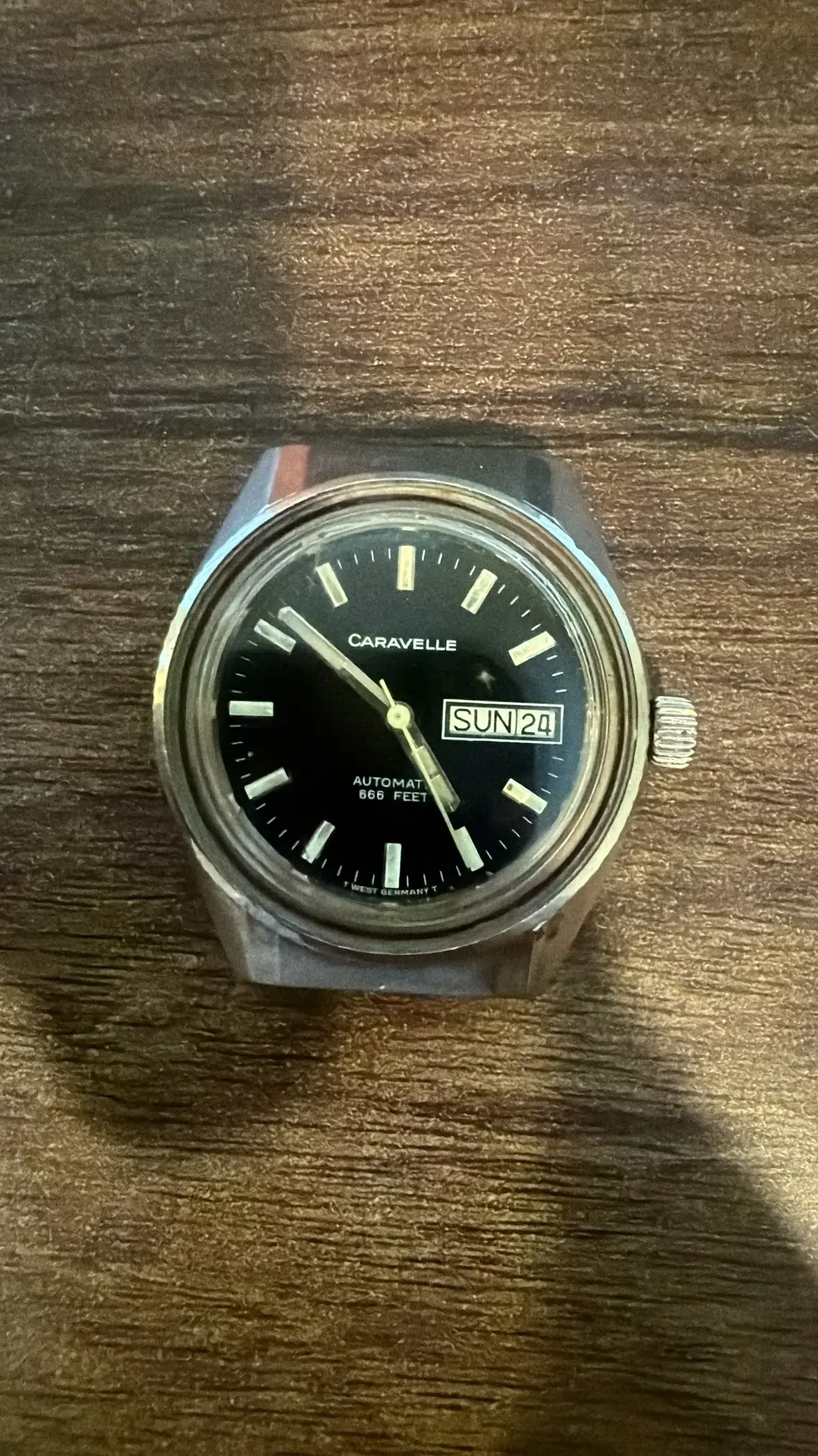

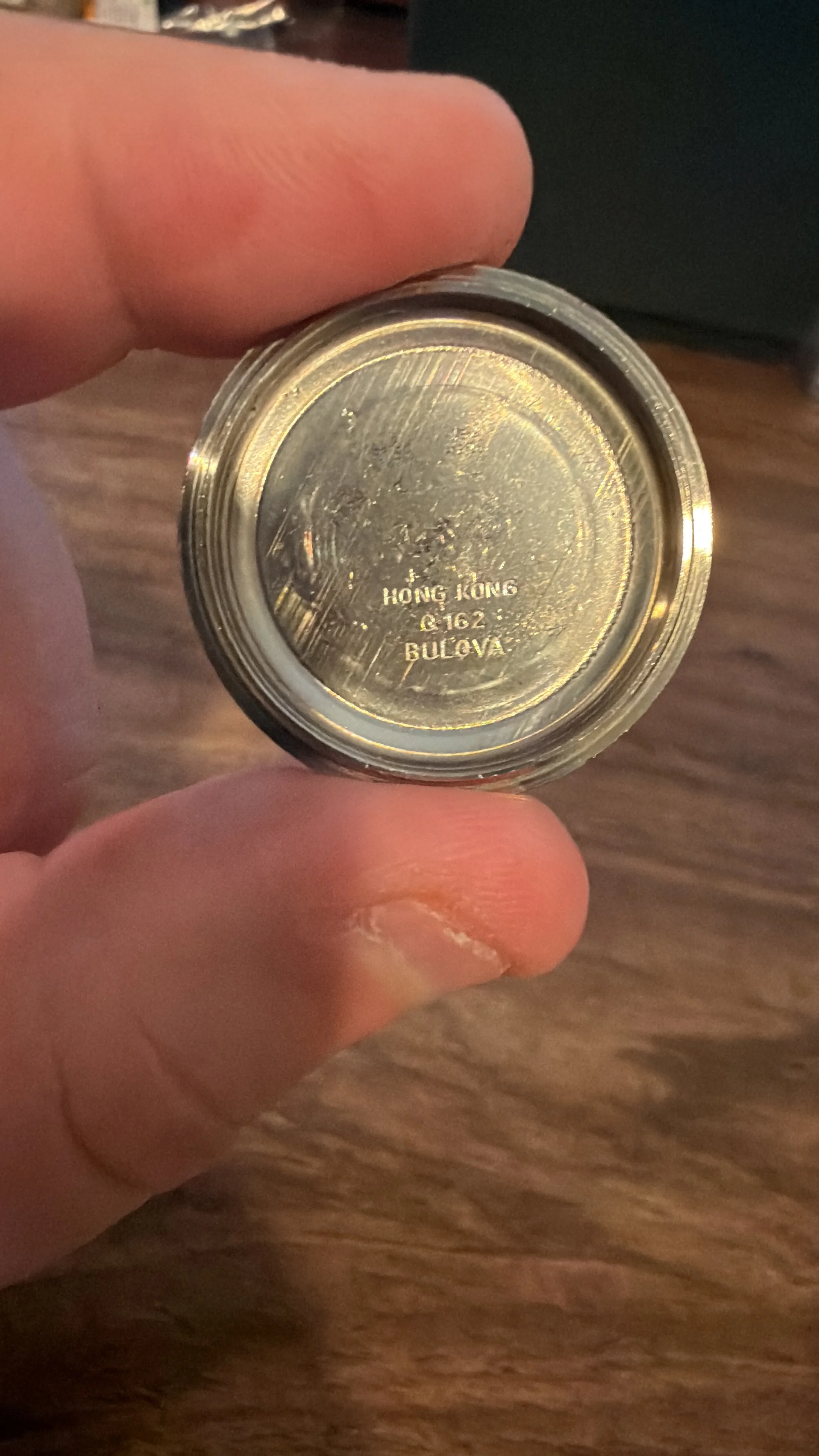

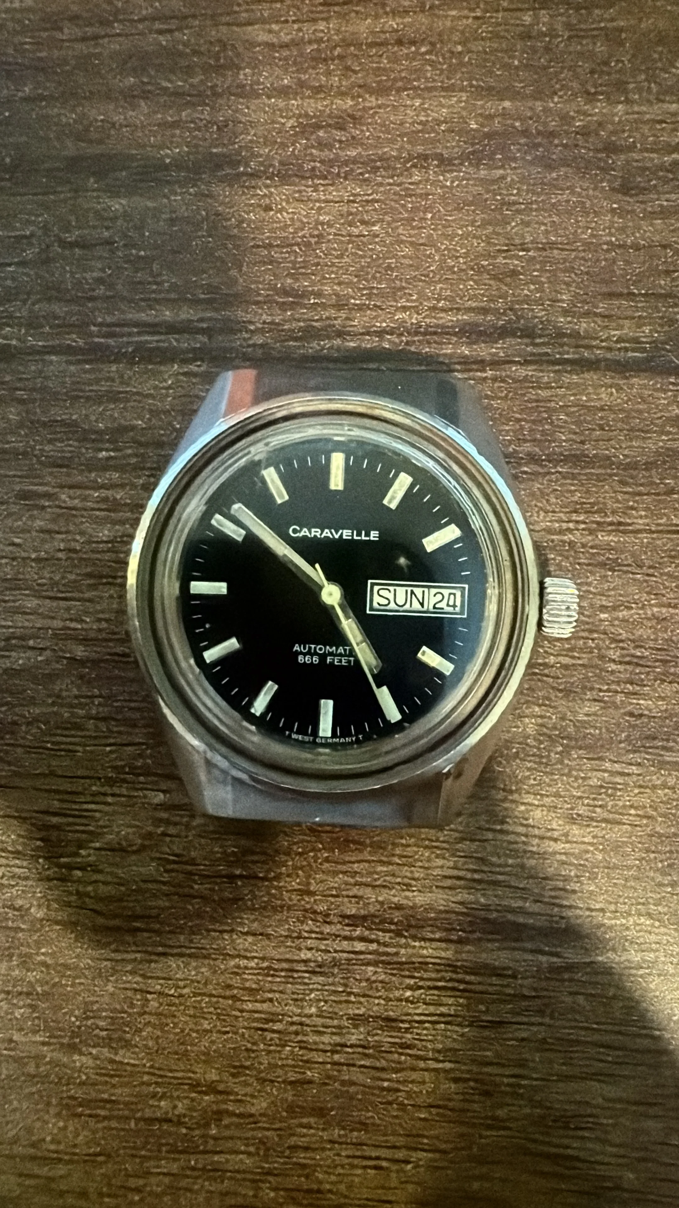

Sure thing. Please see the below. I will get the caseback outer photo when I get home tonight, I don't currently have a photo on my phone. Hopefully this will help. I would assume that you can see the dial but it just says 'Caravelle - Automatic - 666 feet'. Inside caseback says Hong Kong - Q 162 - Bulova. Movement has '1353 10' on the rotor, 17 jewels. Thanks for your help, I really appreciate it.
the outter surface of the case back are there the letters PO. ?

Bulova had some mvmnts made in West Germany (cold war) with sourced watch cases paired with these mvmnts that were made in Hong Kong ... what comes to mind is Ref. # 1208, these have an aluminum coke bezel insert

Yes, it does have the letters PO on the back.

The watch is missing the complete friction-fit bezel assembly, so I'm trying to determine whether another PO-case Bulova/Caravelle reference (such as the 1208 you mentioned) might use the same bezel. If you know of any other PO-case references that share this case or bezel, I'd really appreciate any guidance.

bulova made their parts interchangeable as to the specific look of ur hong komg case and the bezel attached to it ... my data and research only has USA parts and models 🙁 I did a quick look on eBay there seems to be a white dial day date for sale ...... have u glanced at the piece to use as a reference point ?
