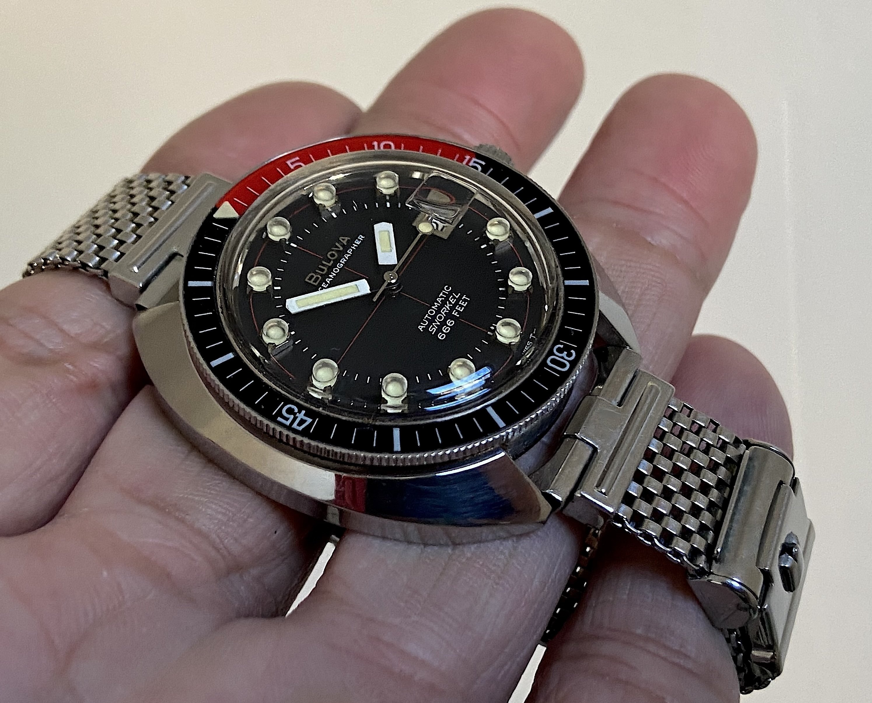

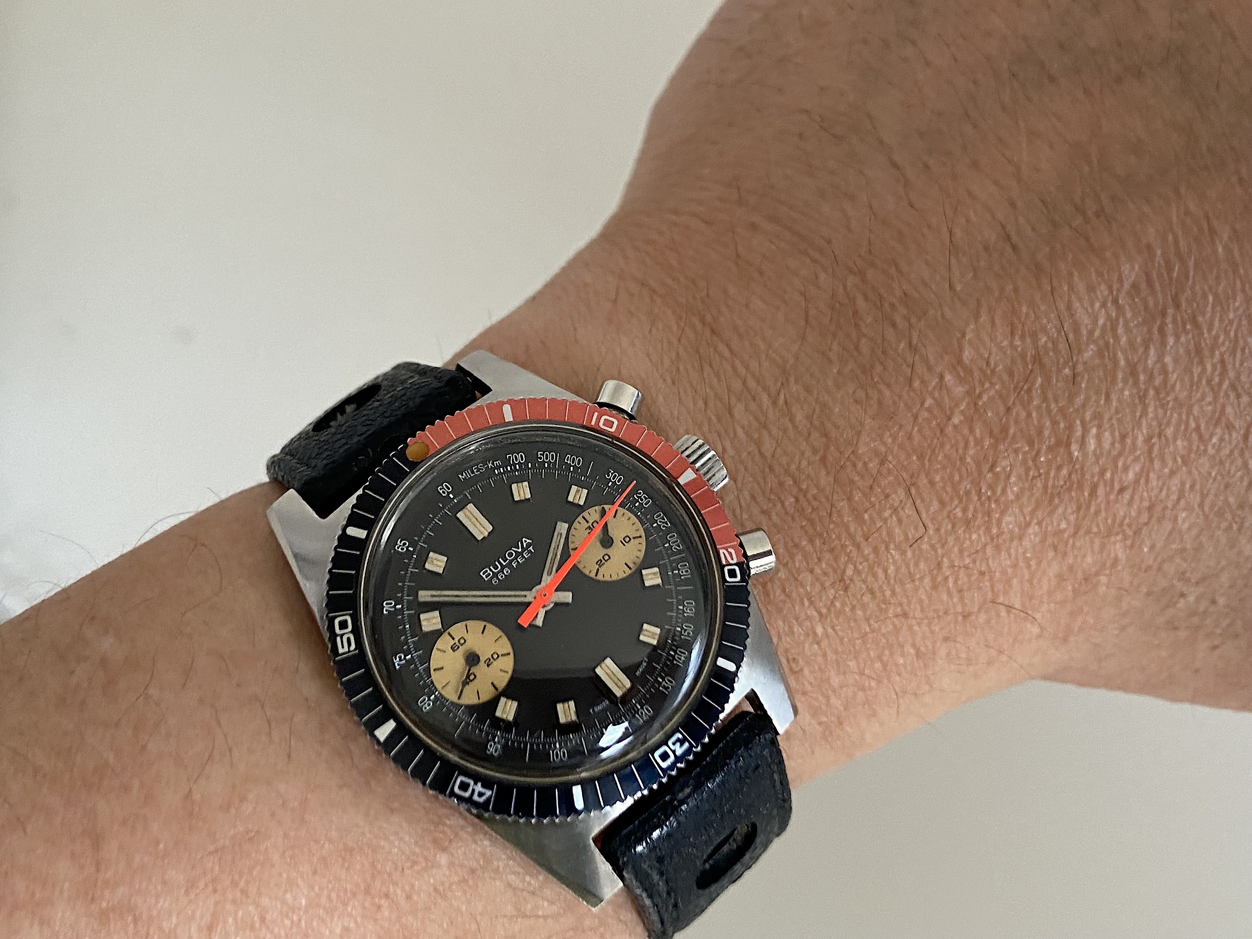

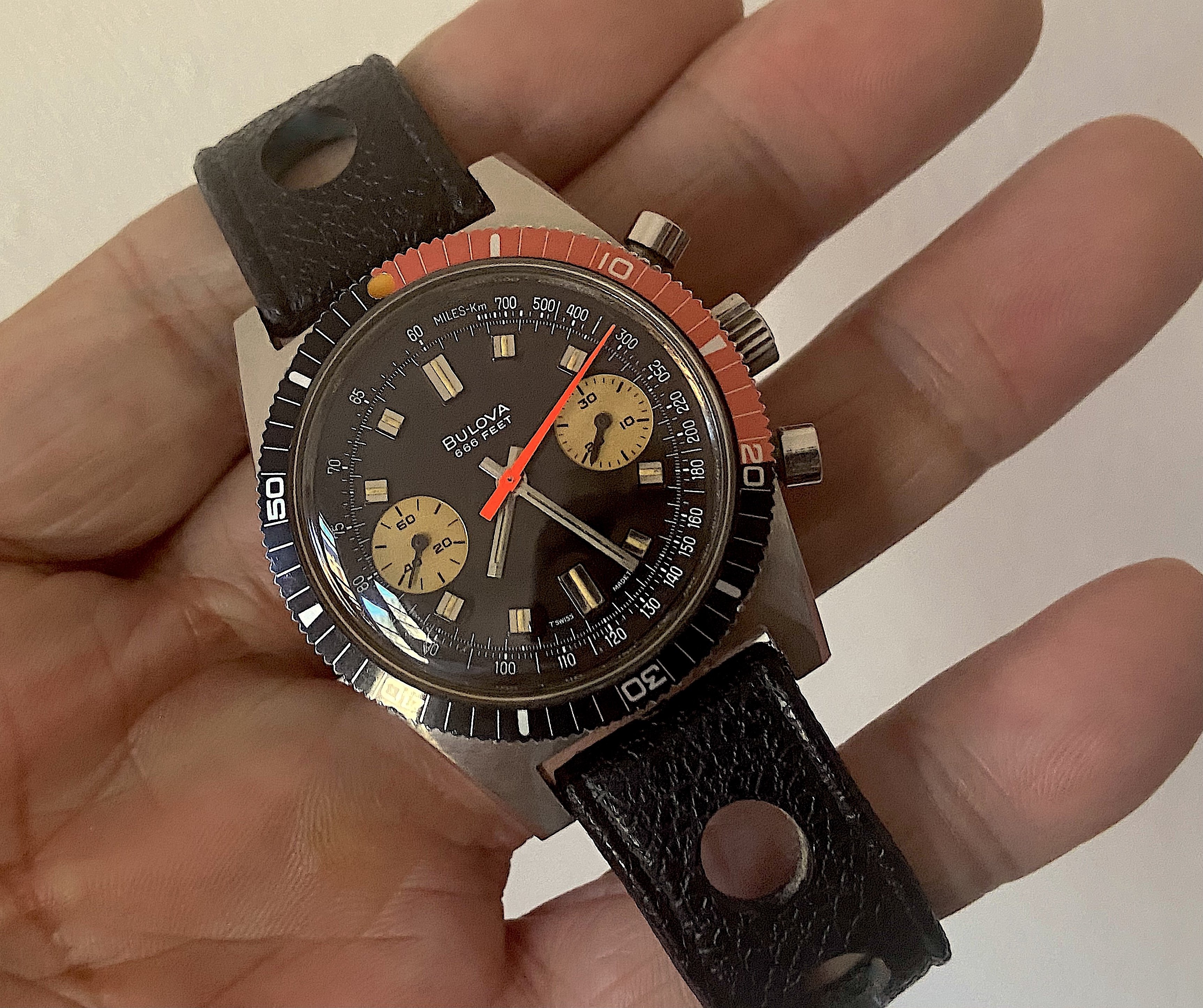

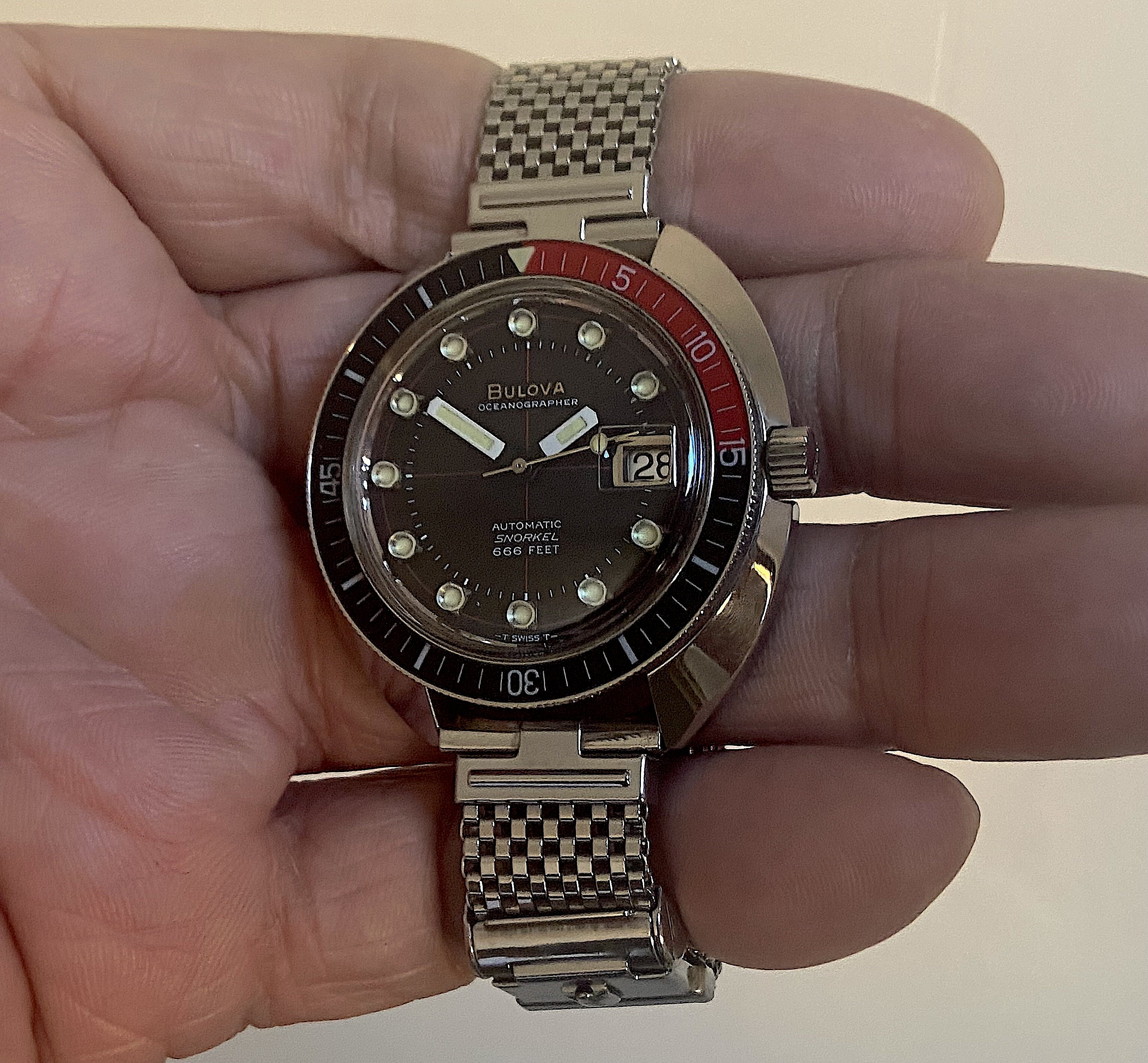

Just bought this off eBay the other day I guess a side brand of Bulova.
Reminds me of a Longines diver link below on Longines I got the poor man's version, I guess.

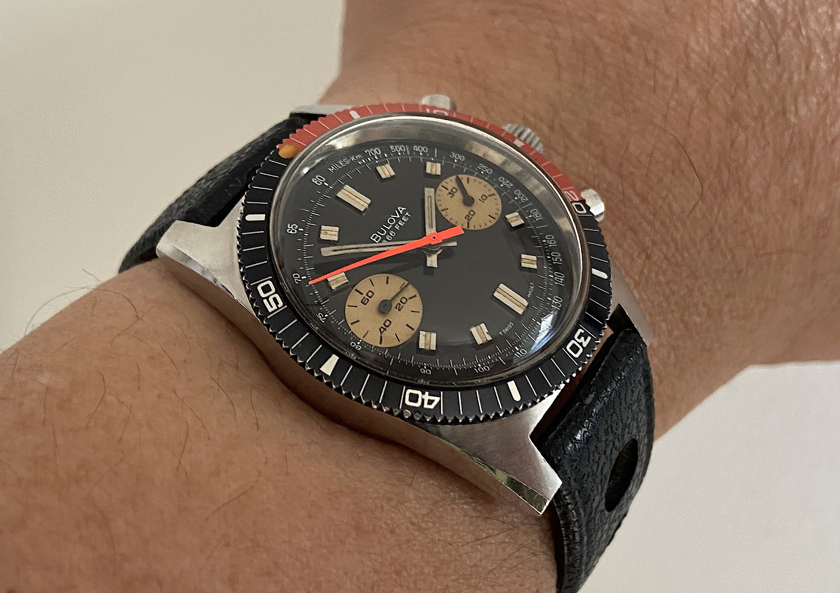

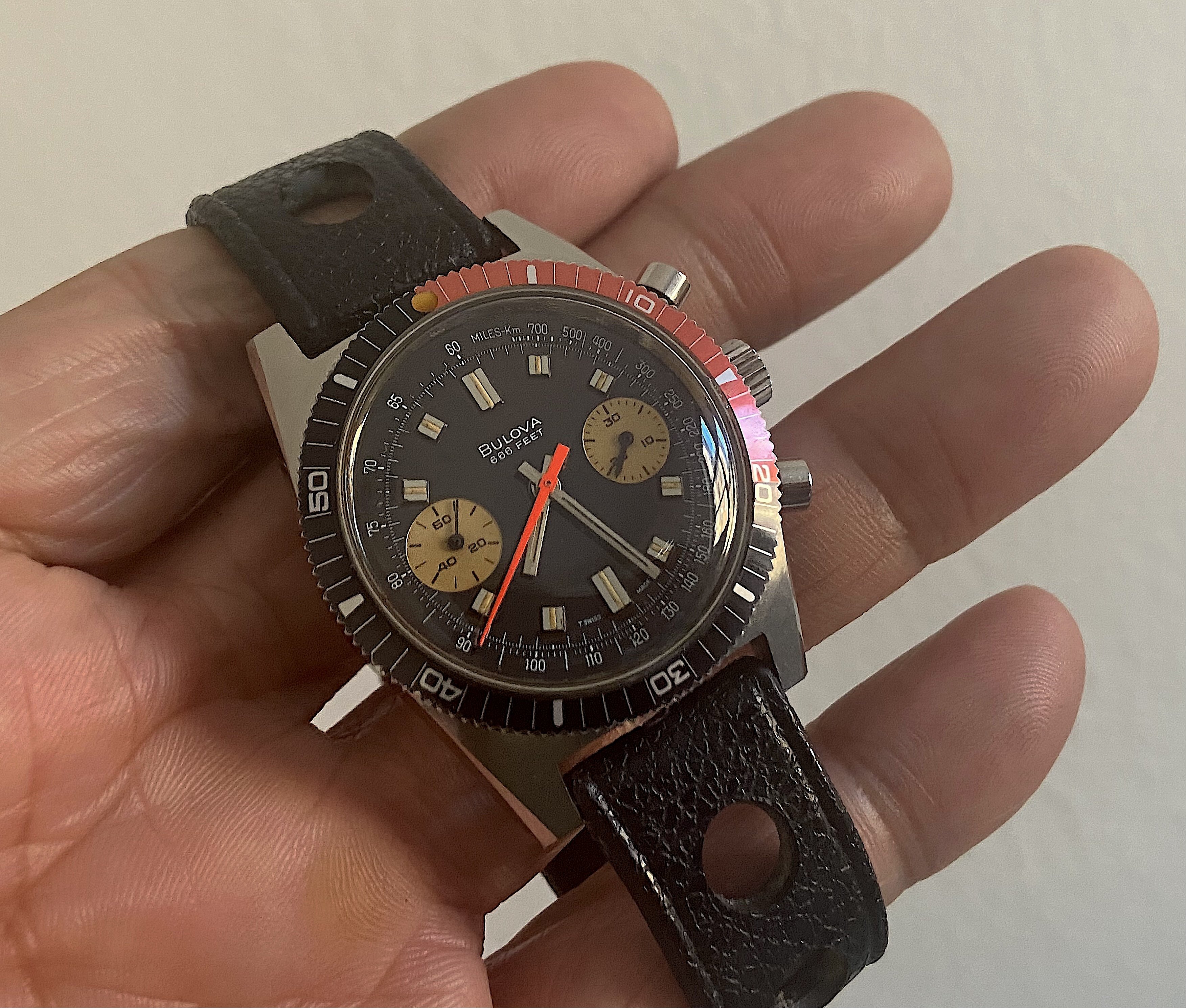

1973 BULOVA DEEP SEA 666FEET CHRONOGRAPHE "B" ...
with Tropical Dial (chocolate brown black and mustard yellow tritium lume)

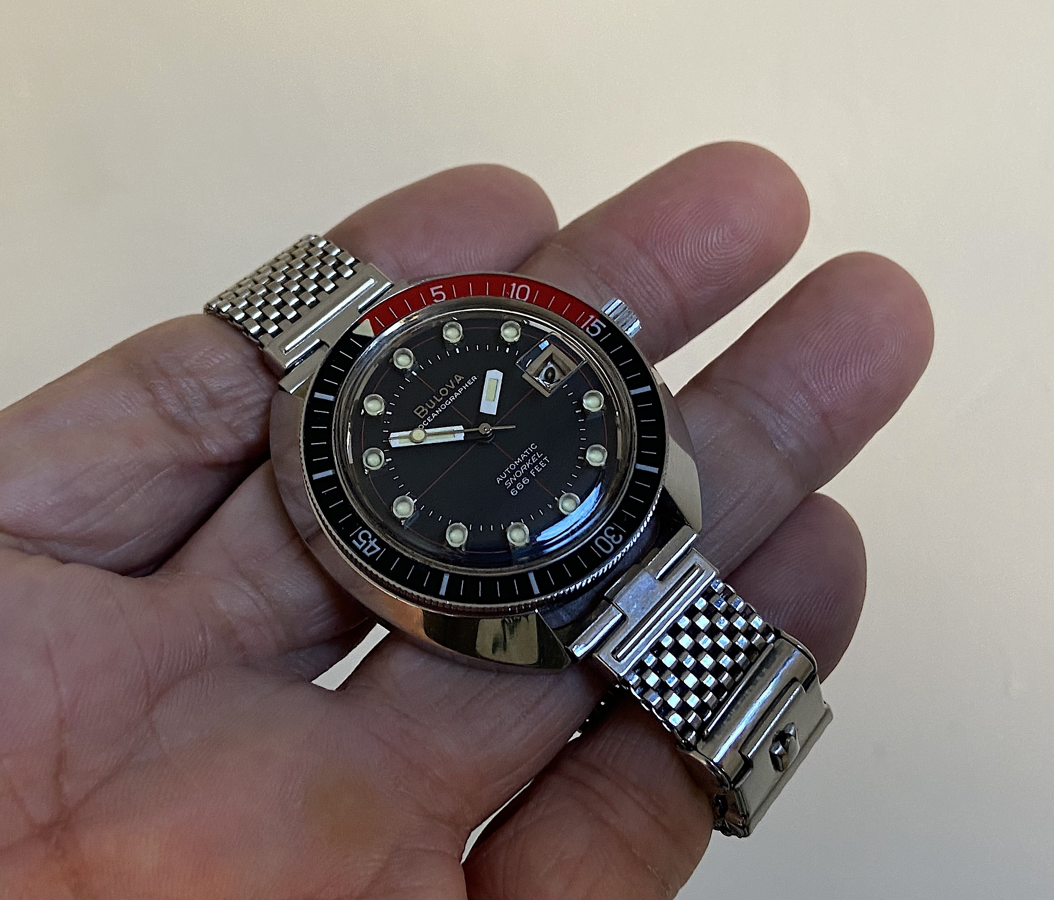

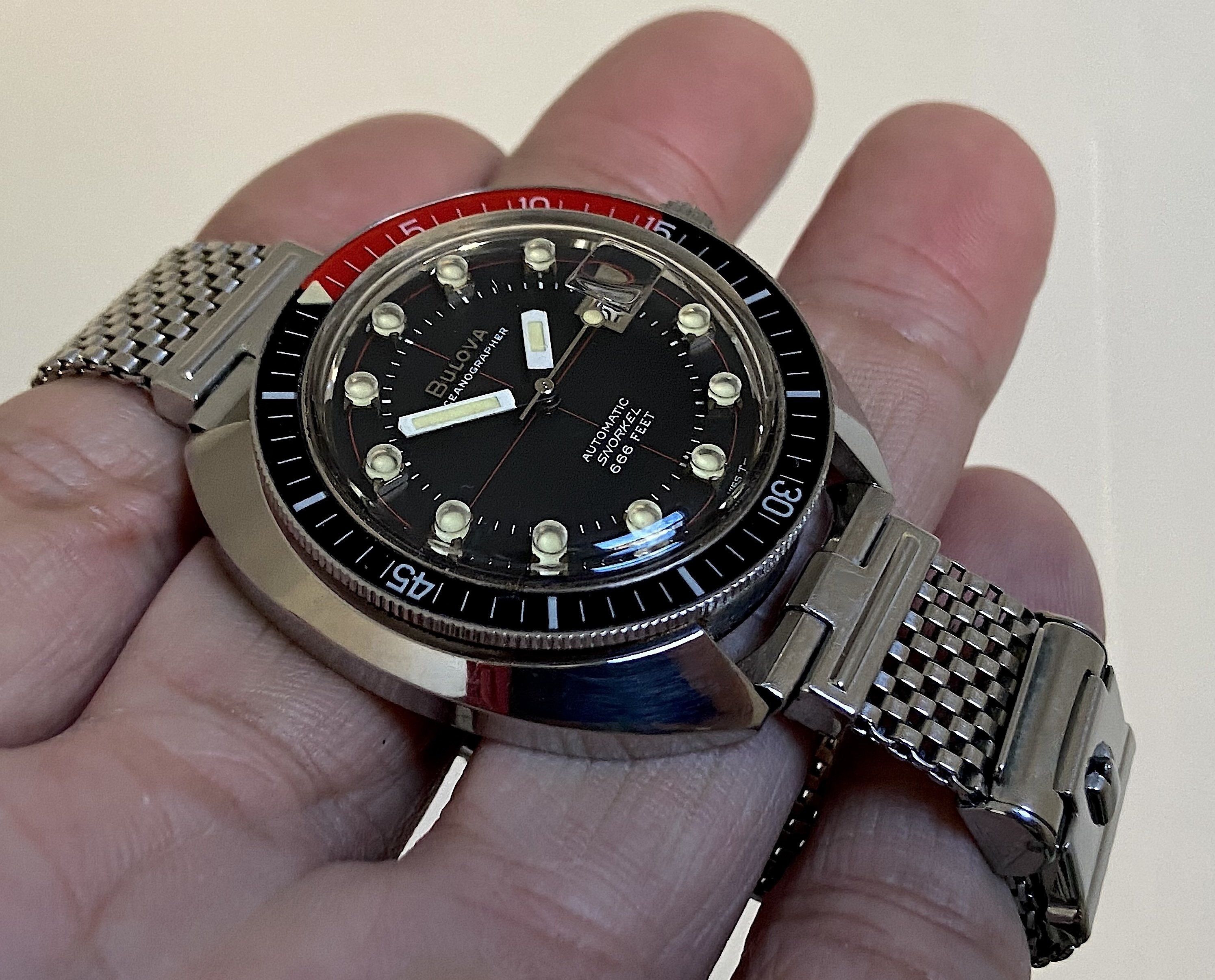

1969 (M9) BULOVA SNORKEL 666 FEET oceanographer "G"
paired with vintage JB Champion USA expandable bracelet (aka: NASA bracelet)
This Bulova Oceanographer is brought to you fresh from 666 feet underwater.
Before it leaves the factory, every single Bulova Oceanographer Snorkel is tested under 666 feet of water pressure in our special pressure tank, where it stays “down” a minimum of five minutes.
It goes from the tank straight onto a hotplate for another torture period. If even the least bit of moisture gets in, it shows up as for on the crystal.
So in testing the Snorkel’s water resistance, we learn how it stands up to dust and the desert heat as well.
Bulova Oceanographer watches must pass other tests. A drop test for shock.
A final check to see if the knocking around has caused it to vary more than 60 seconds in 24 hours. If it has, we got back and start over.
An ordinary watch would never make it through the tests a Bulova Snorkel has to pass before we’ll call it new.
(from vintage Bulova advert.)

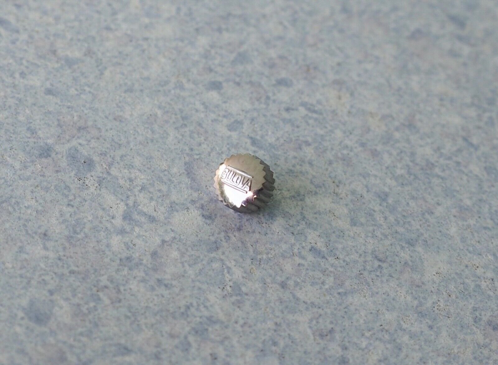

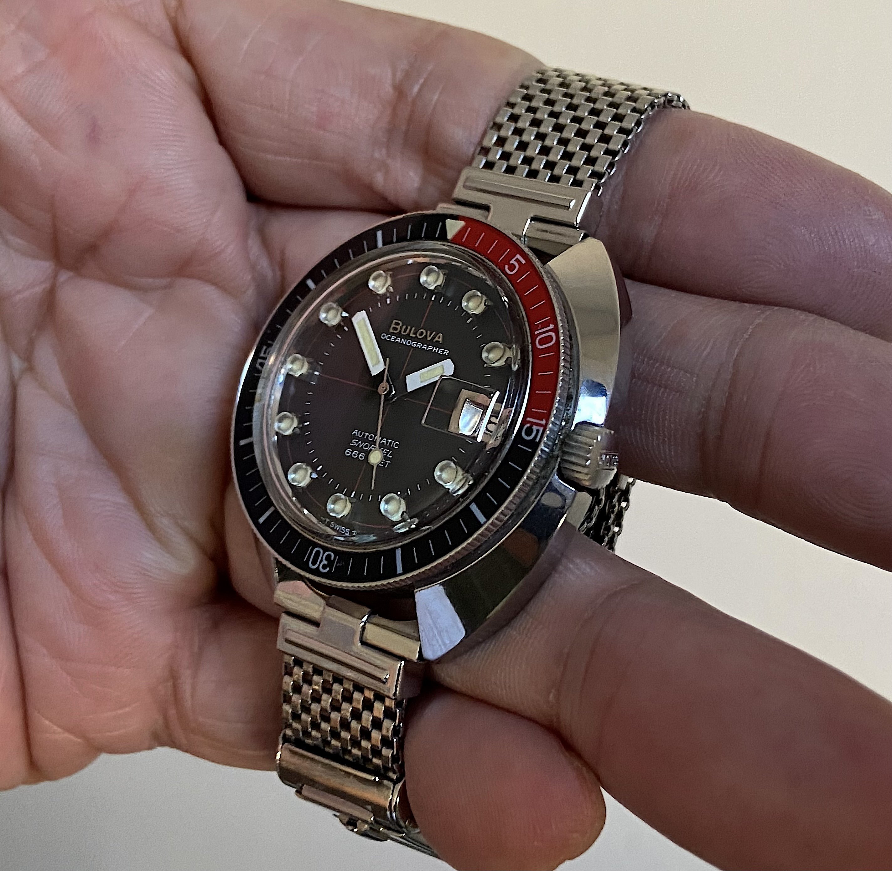

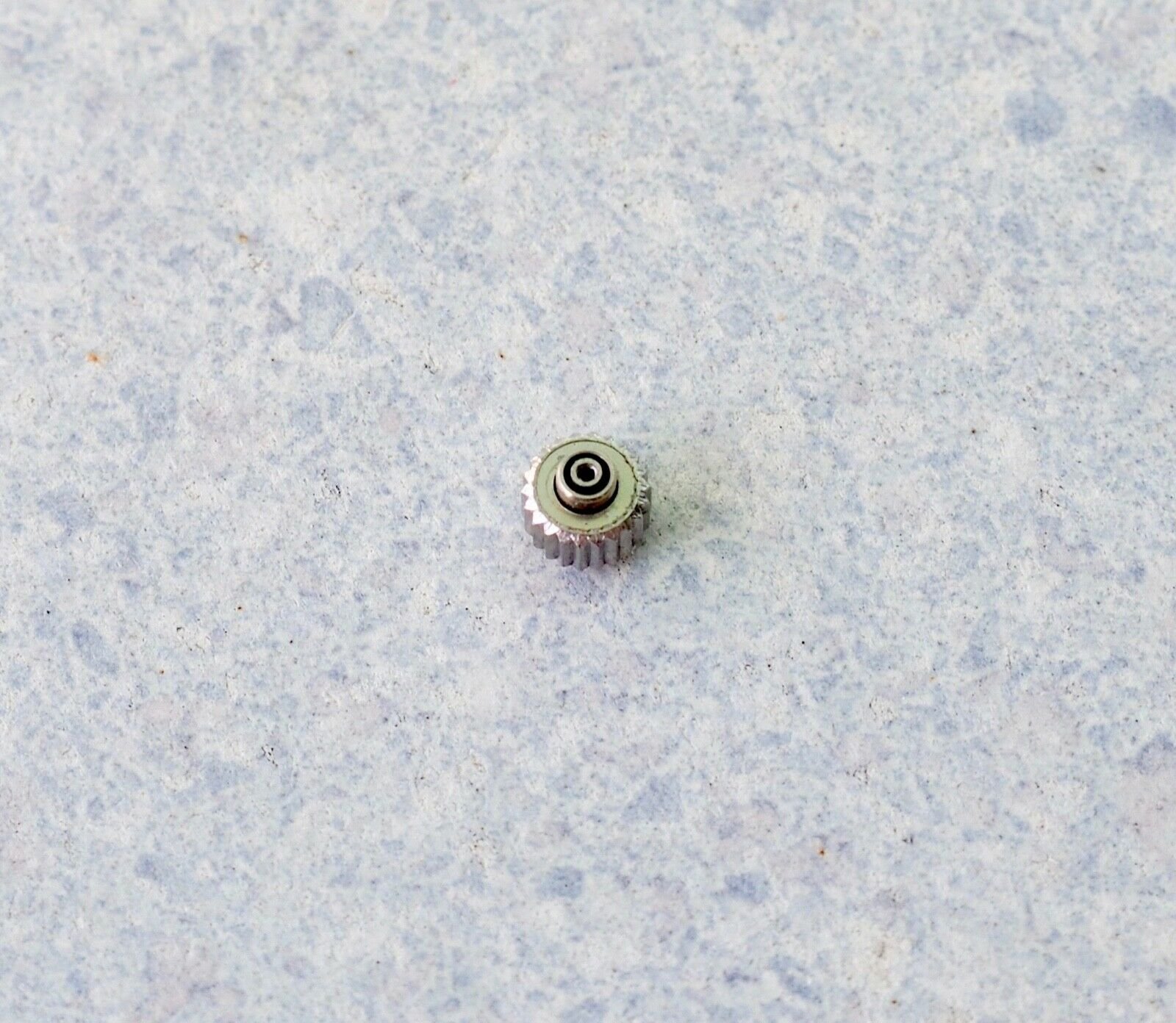

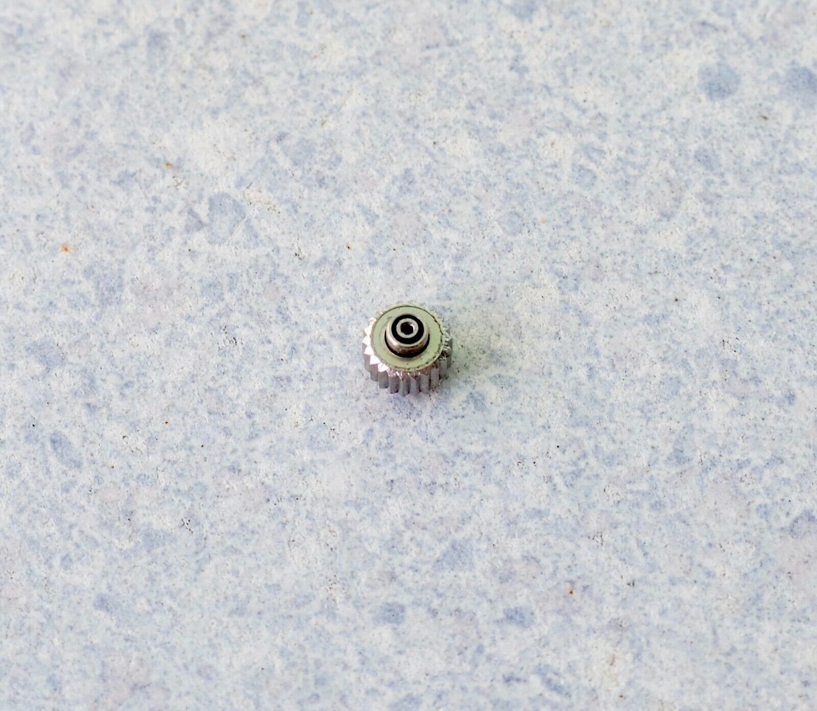

Is the crown with BULOVA on it correct for this watch?

Yes, the 386-3w is what I've read is correct for that case. But it has the tuning fork symbol on it while yours is a 386-3 with BULOVA on it. From what I've seen that crown is correct for the 7095 case, no?

The 386-3 seems more appropriate. I have 3 of these watches, one with the 386-3, one with 386-3w, plus one with an unsigned crown but otherwise seeming correct.
that (tuning fork) is meant for an ACCUTRON model, Bulova used interchangeable parts but in this instance branded for the watch model it is meant to be paired with, same crown but it does not mean it is meant for a diver, unless it is an accutron deep sea diver model, then it is also waterproof
3,570
17,834
the "W" ........... means watertite (old term waterproof) meant to be used for diver watch

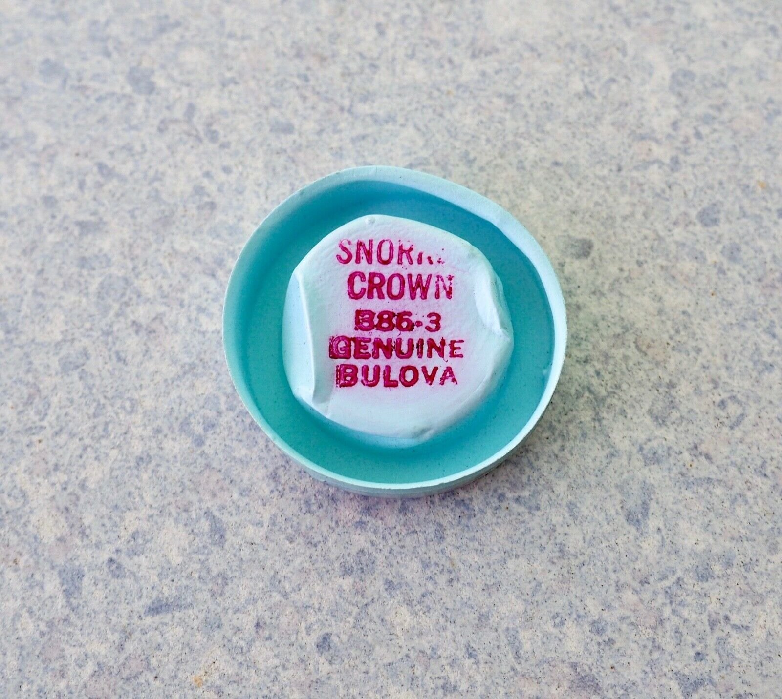

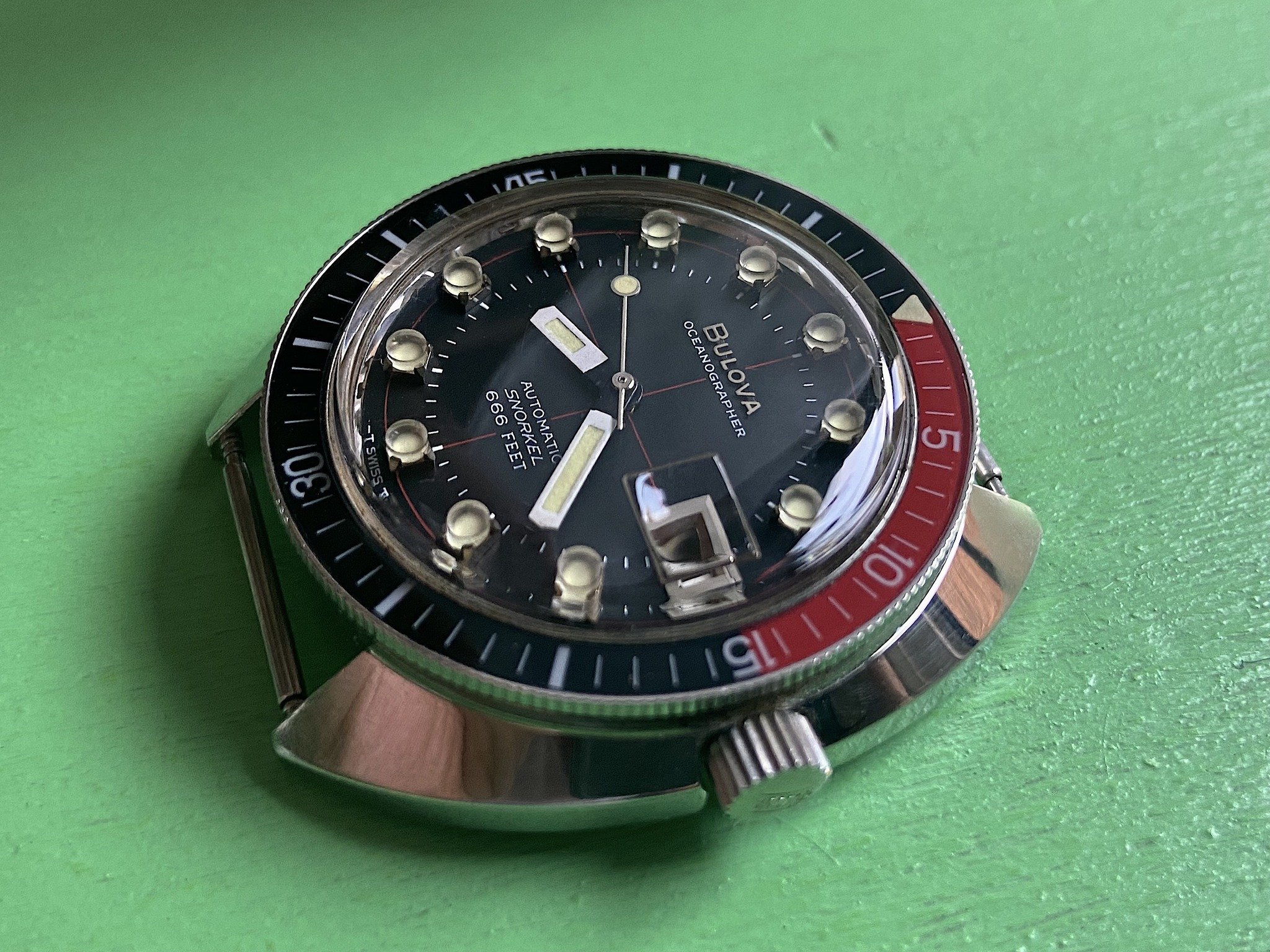

note photo above,, case holder for the crown states SNORKEL means it is waterproof crown for a divers

So the 386-3w came in both BULOVA variants as well as with the tuning fork?
SNOKEL divers with mechanical movements use crowns stamped BULOVA, accutron watches use crowns with the ACCUTRON LOGO

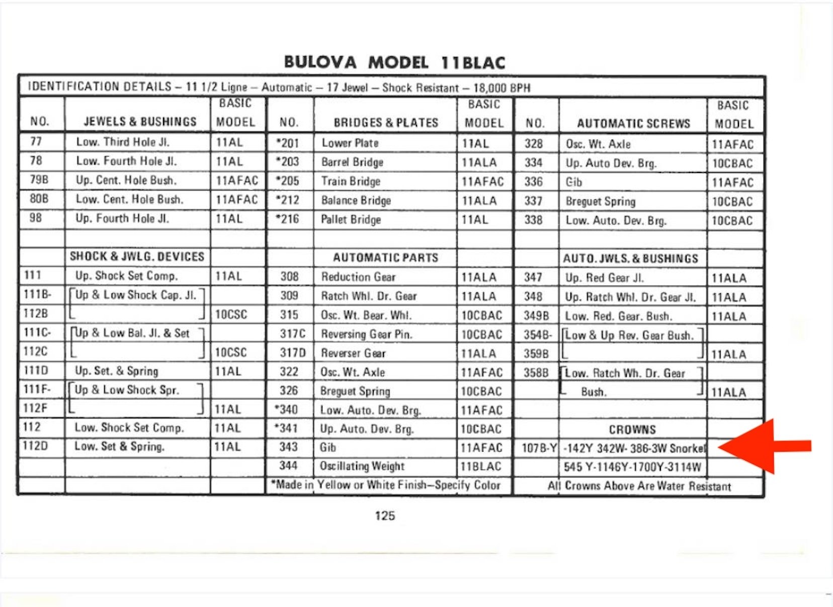

PARTS CHART FROM BULOVA for 11BLACD ........... note red arrow indicates divers watches using this movement uses the waterproof crown 386-3w

Thank you, I have seen this chart. Any supplier photos I've seen with this part number have had the tuning fork on it. Which you're saying is correct, that crowns for Bulova divers and Accutron divers both had that part number but appeared differently.
SNORKEL G with 386-3w it is meant to use.
BULOVA stamped crowns are meant for mechanical movements.
ACCUTRON crowns are meant for accutron (tuning fork) watches
Interesting that the case shows that the crown is for a Bulova Snorkel, which of course is/was watertite, yet it doesn't have a W to indicate this.

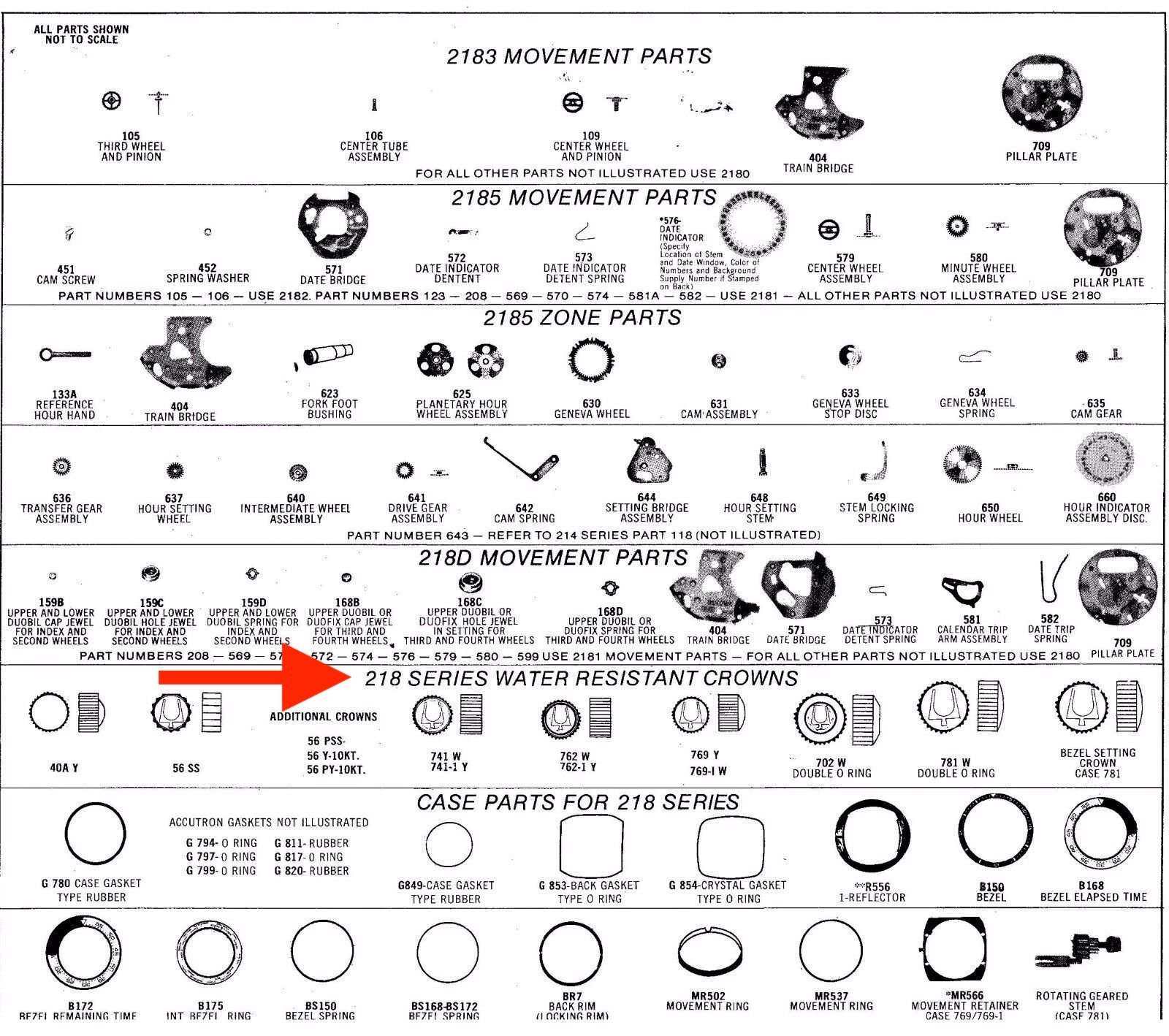

parts chart for accutron (tuning fork) movements, will these crowns fit on a mechanical bulova movement I am sure some will (bulova made inter changeable parts) ..;. BUT accutron stamped crown are meant for accutron watches
