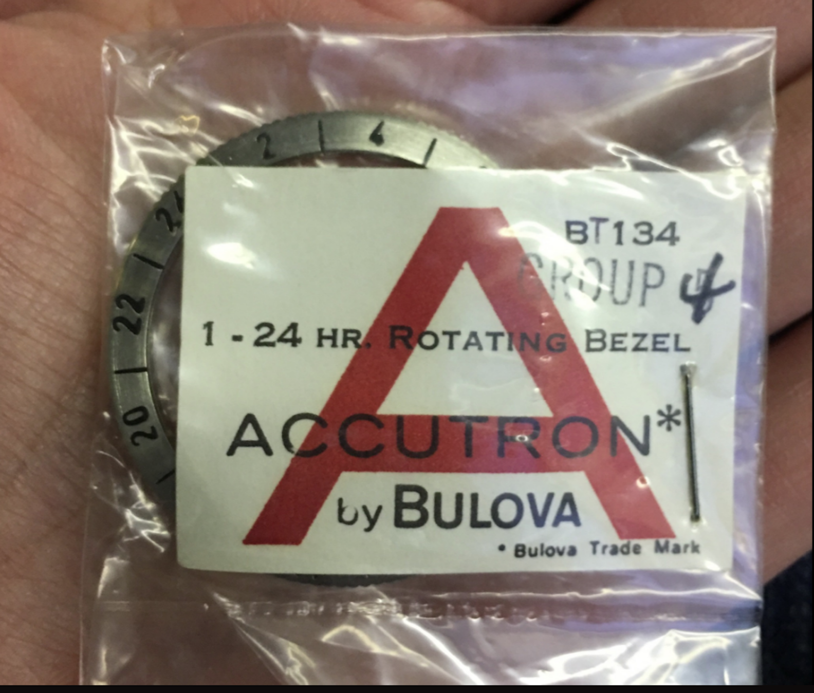

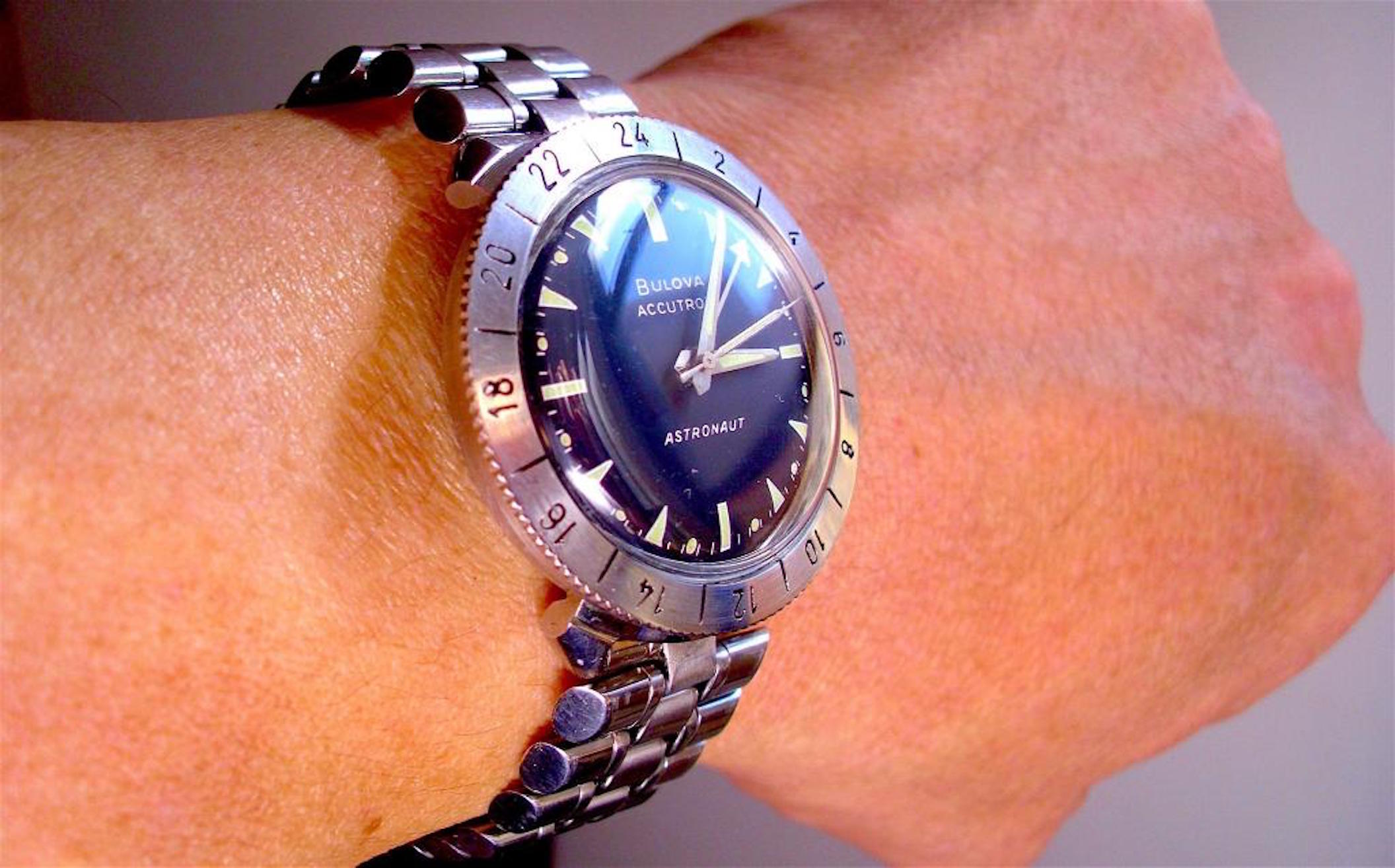

Bulova Accutron Astronaut GMT 214HN
Bezel Ref#: B-134

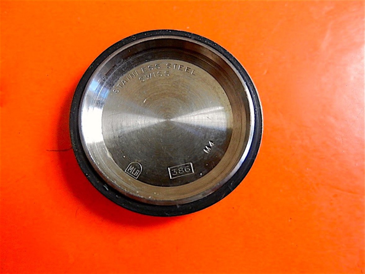

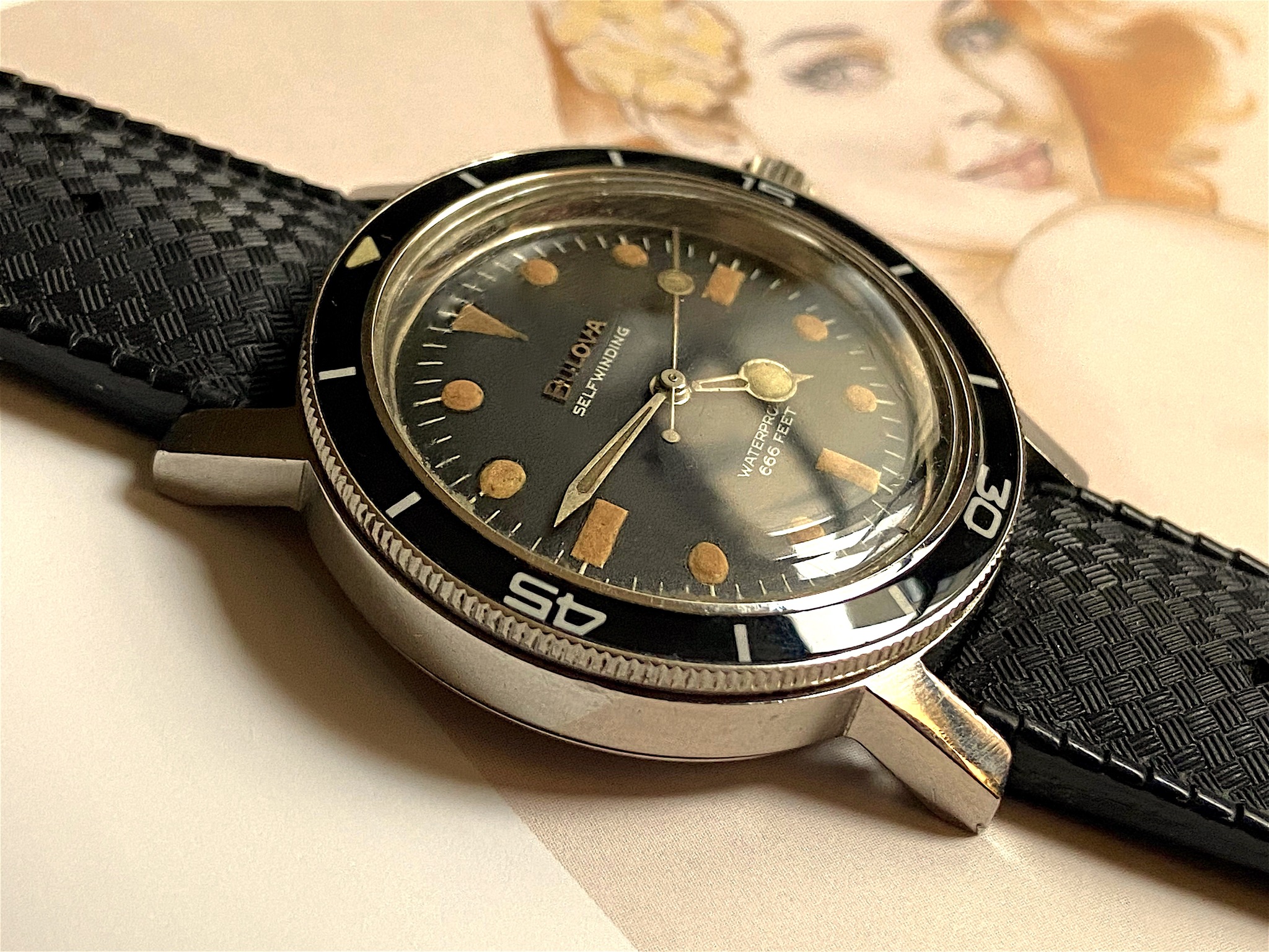

BULOVA Pre SNORKEL Dial
case ref# 386

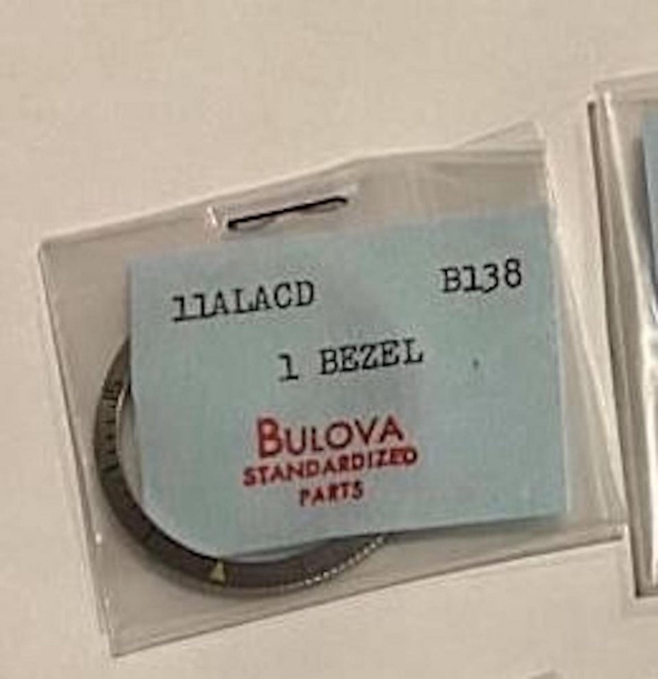

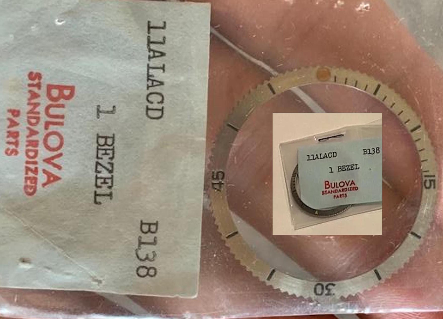

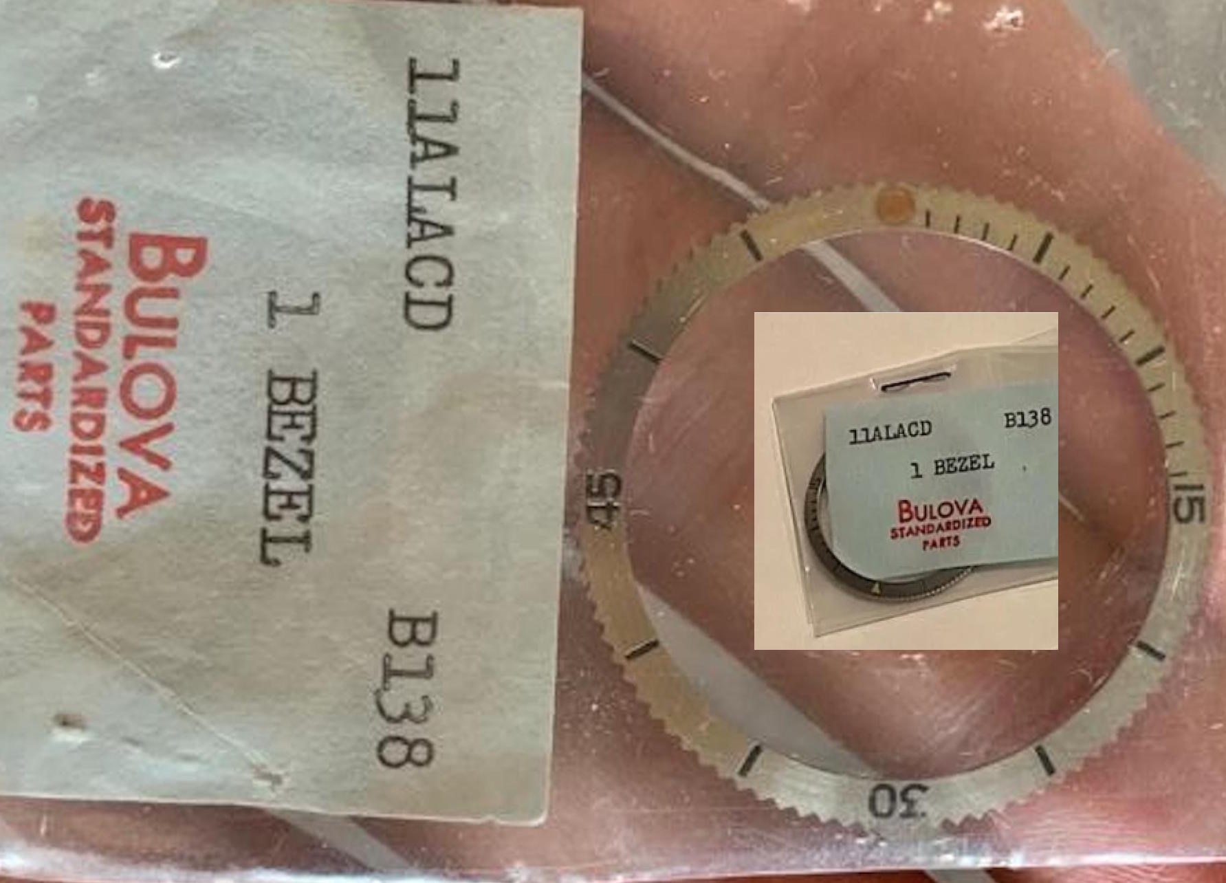

FIRST INCARNATION
BEZEL ref# 138 with DECAL

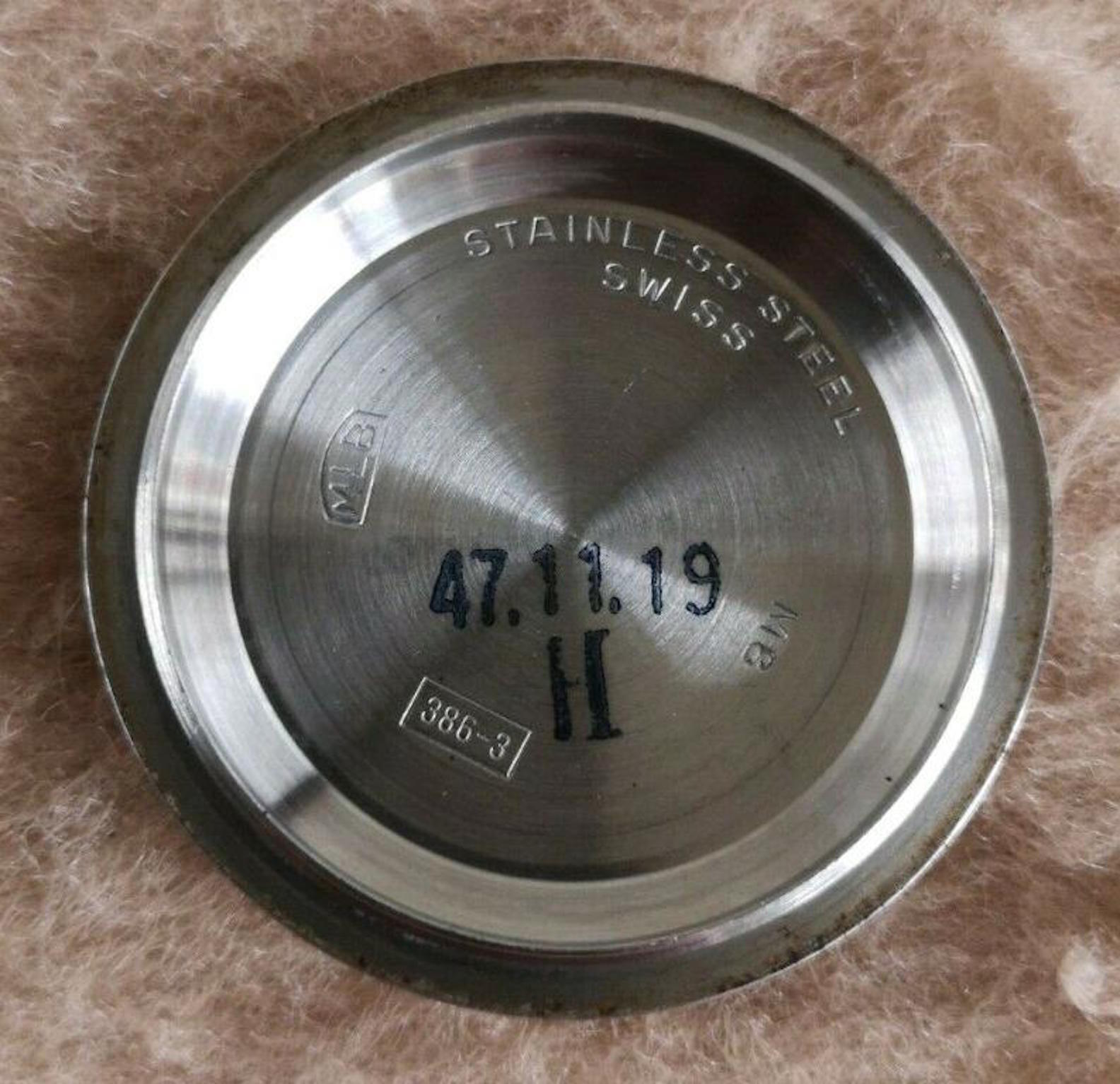

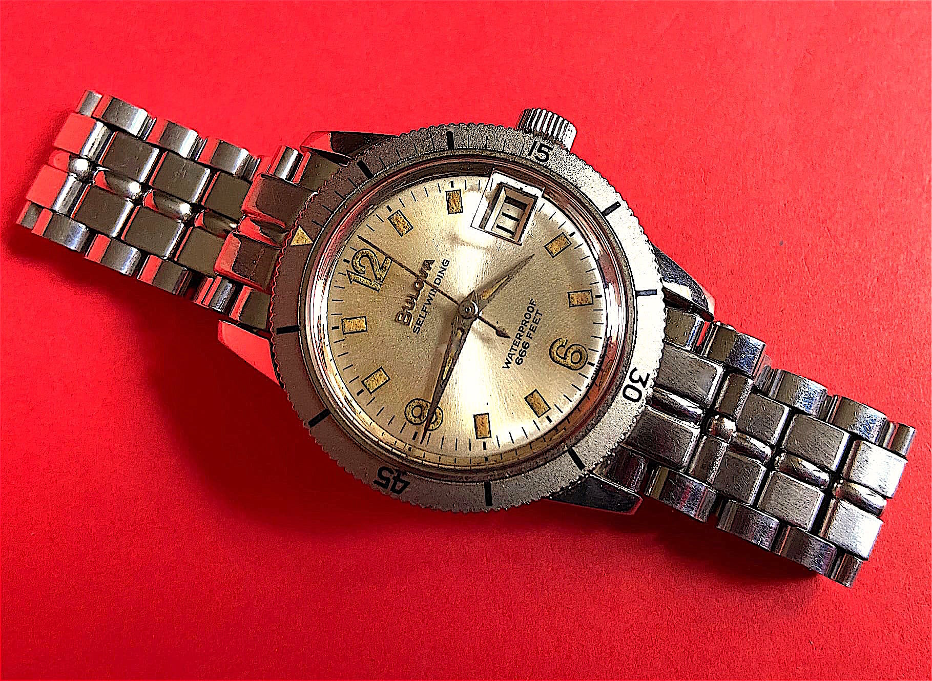

BULOVA Pre SNORKEL and SNORKEL Dial
case ref# 386-3
case ref# 386-4
case ref# 386-5
case ref# 386-6
SECOND INCARNATION
BEZEL ref# 138 with ENGRAVED MARKINGS

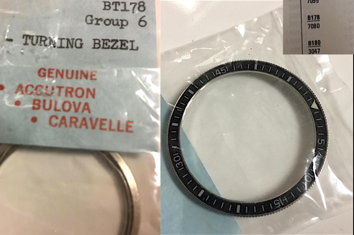

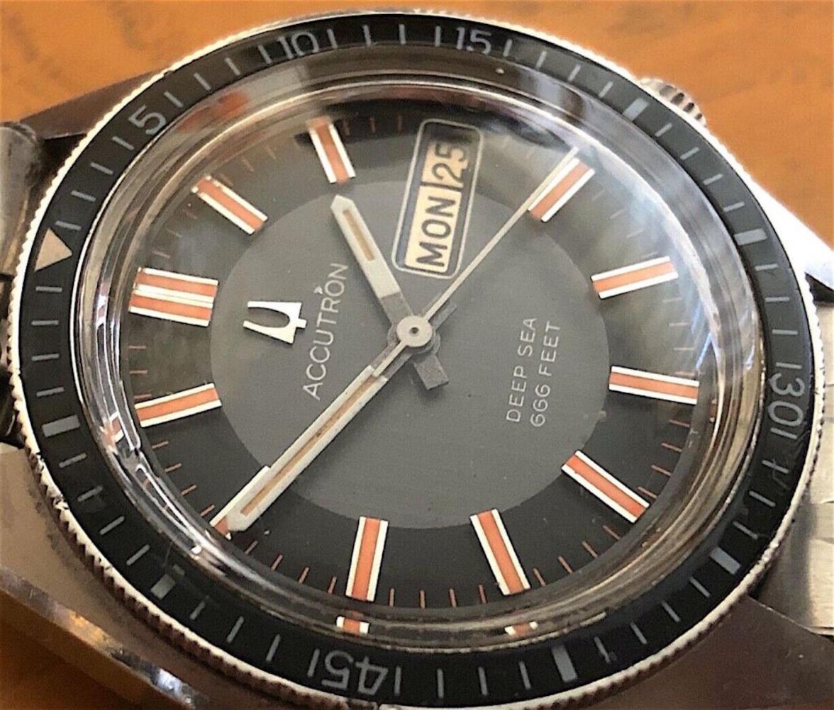

ACCUTRON DEEP SEA 666ft. DIVERS
Case Ref# - 7080
BEZEL Ref#: B -178

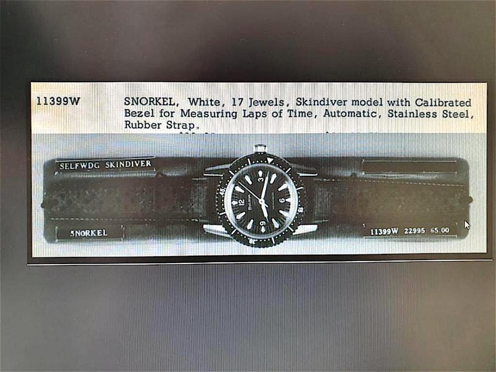

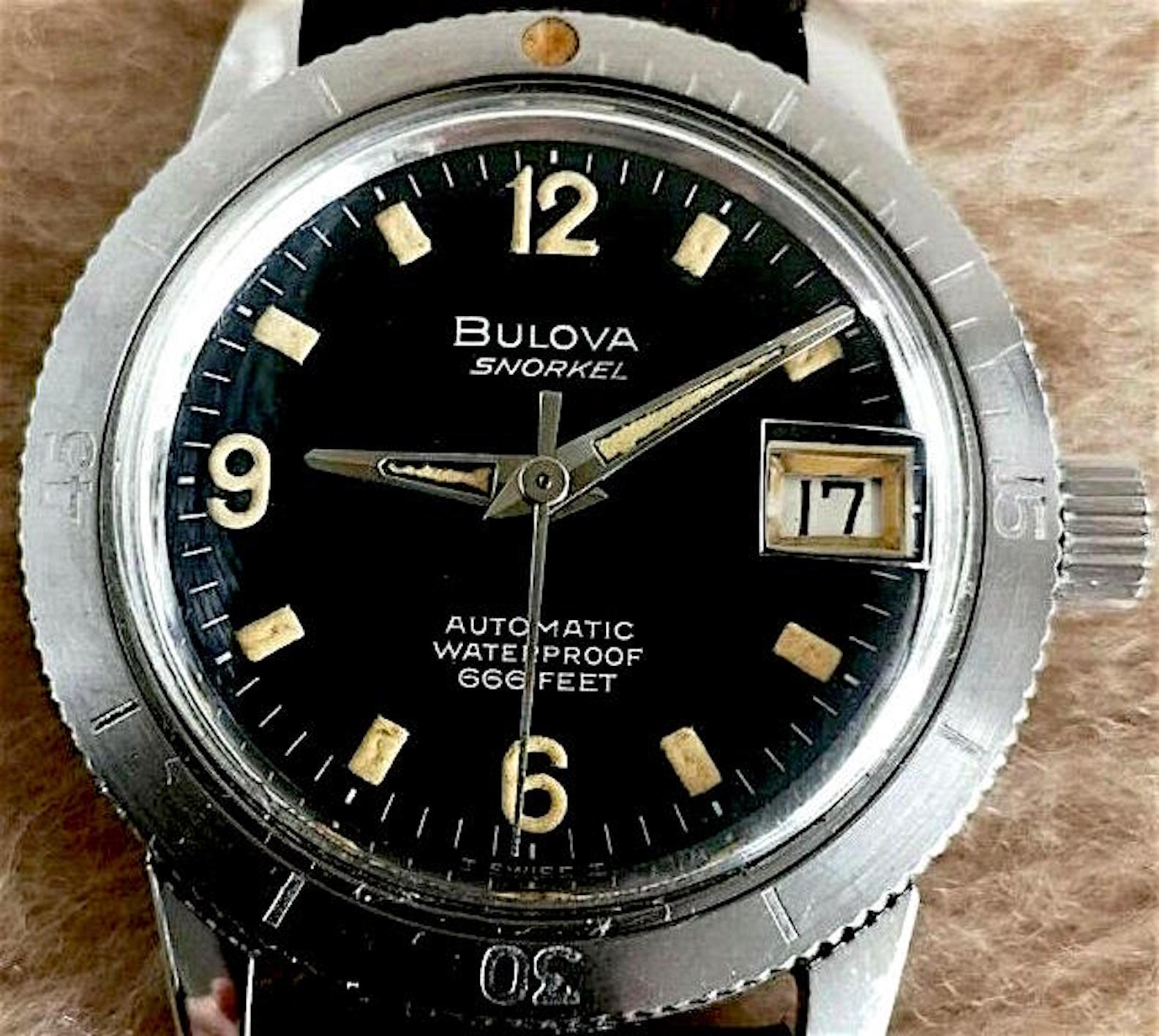

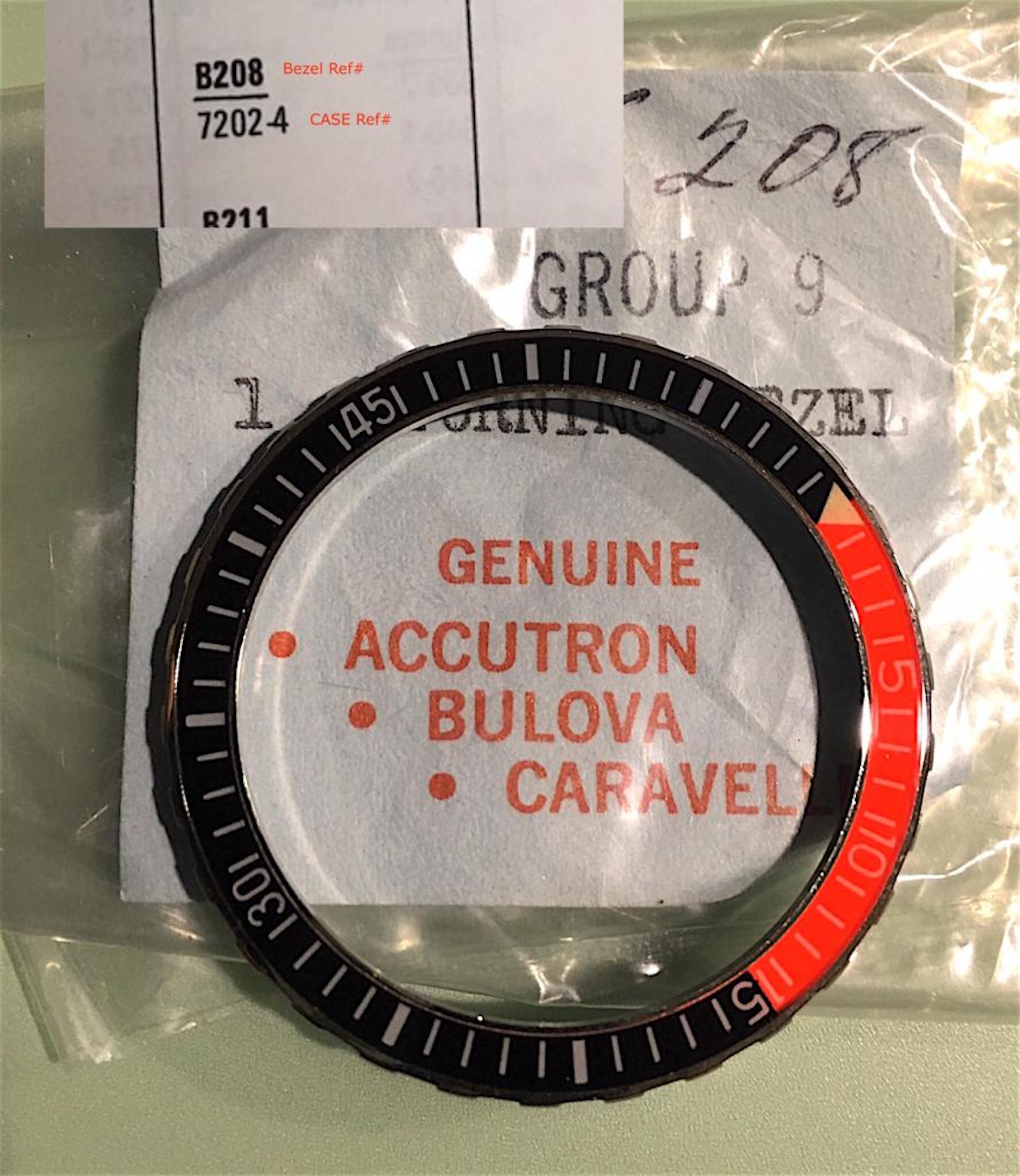

BULOVA SNORKEL
Case Ref# 7202 - 4
Bezel Ref# B-208

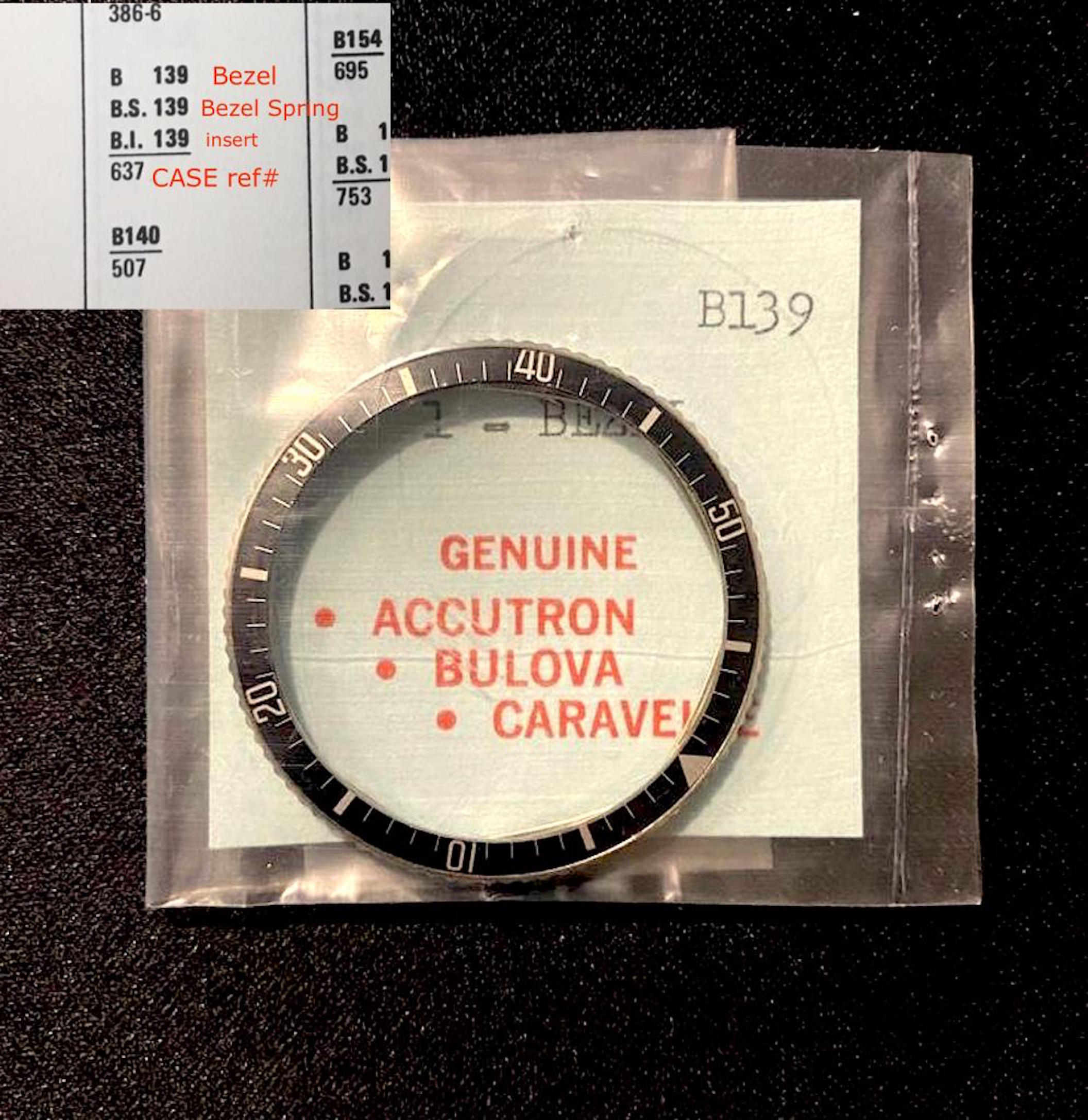

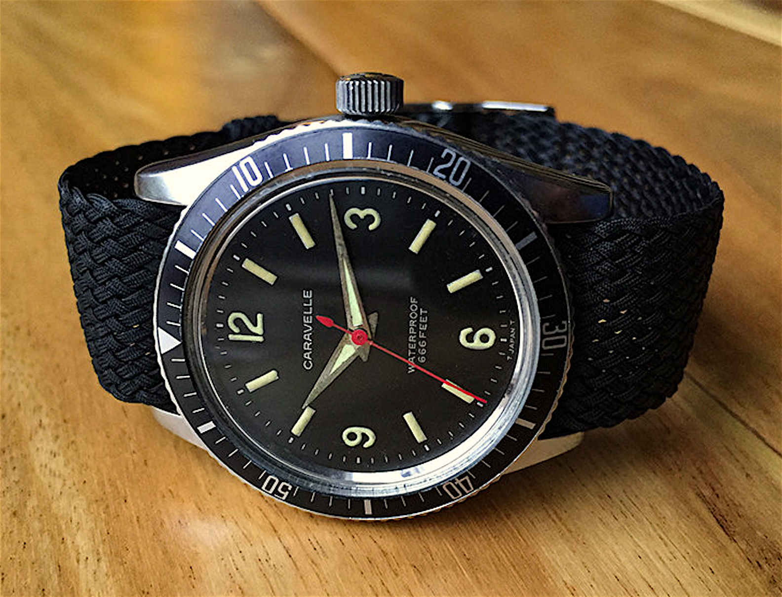

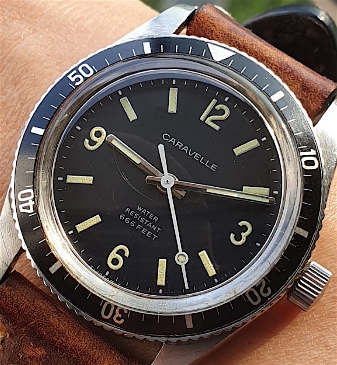

Caravelle SeaHunter
Bezel Ref# - B-139
CASE Ref# - 637
1960's DIAL text and hands set
seconds baton shown in photo Bulova safety red rather than more common silver seconds baton
1970's Dial text and handset

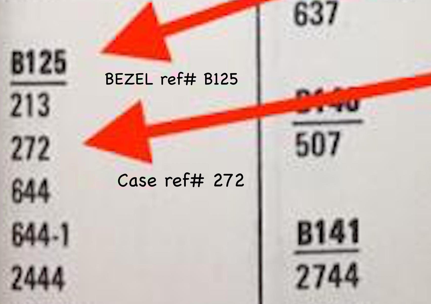

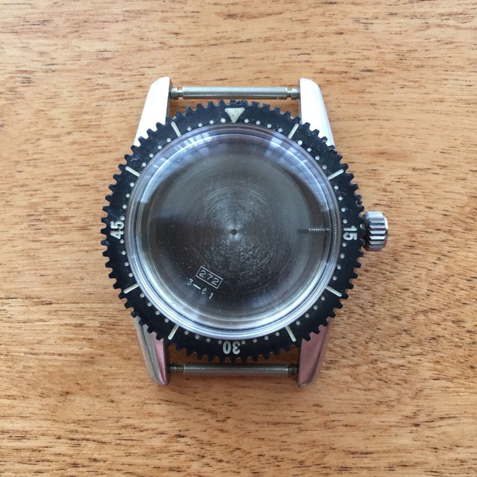

SINGLE CROWN COMPRESSOR
Case ref# 272
Bezel ref# " B125 "

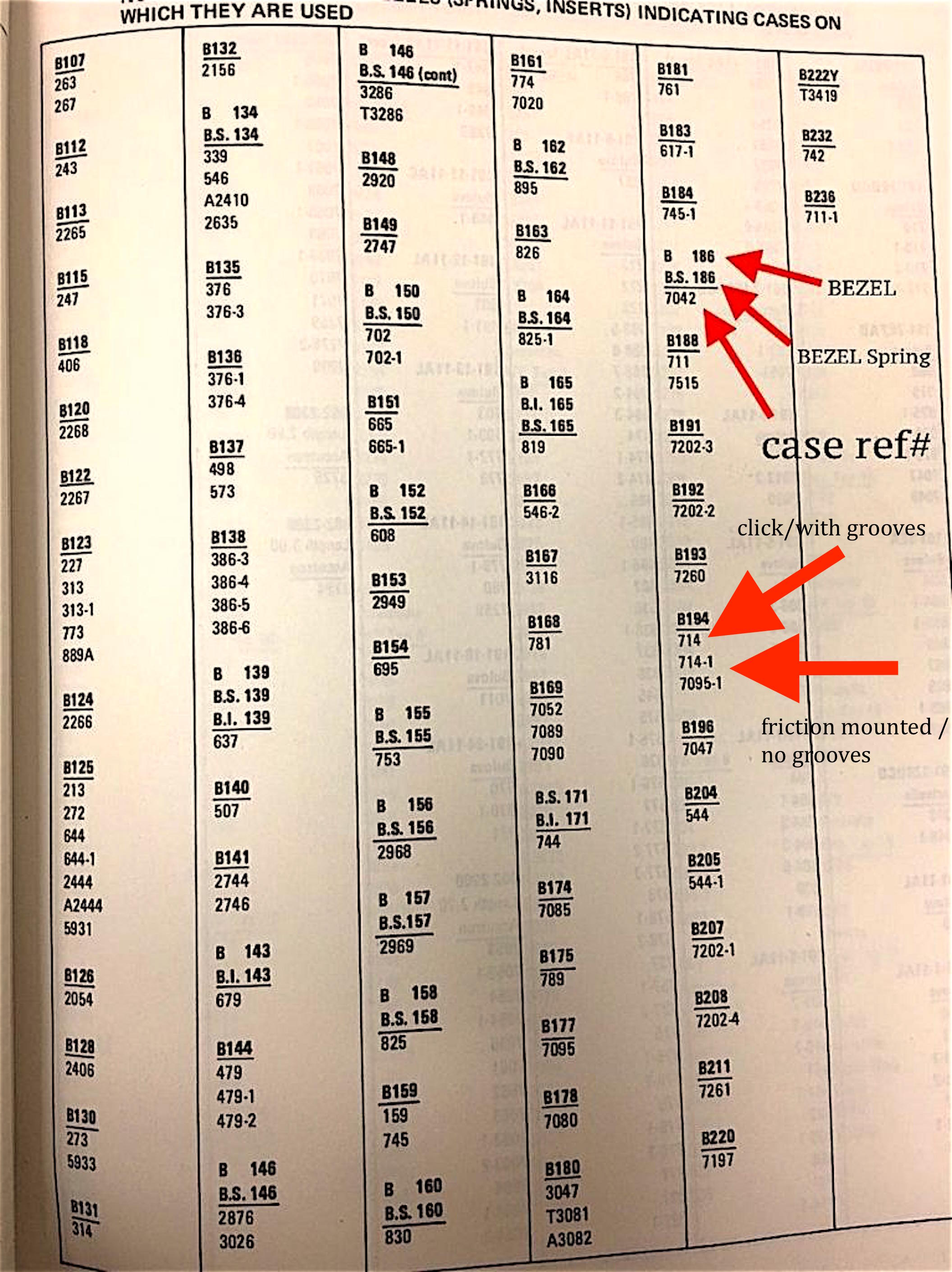

Bezel for this model is made of a solid composite blend [resin plastic] .... see photos below of Bezel and matching Case ref. info chart ...

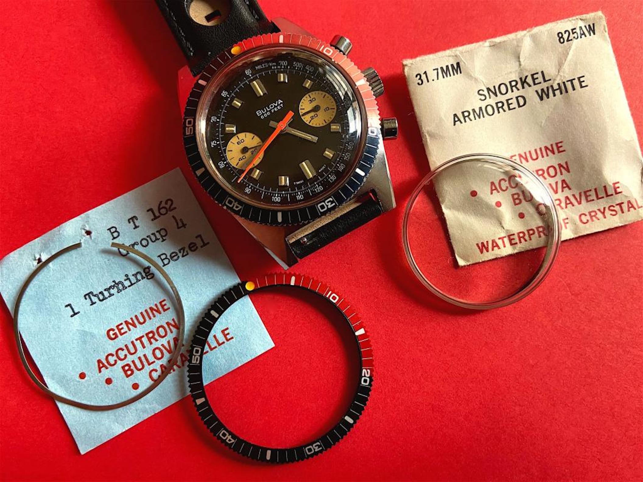

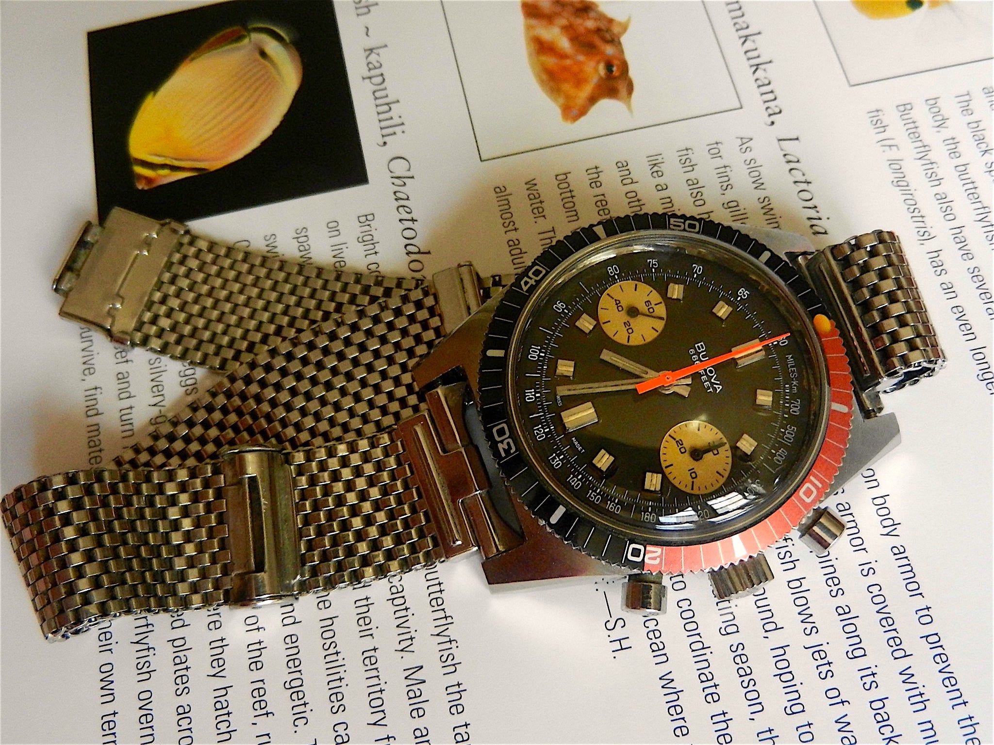

BULOVA DEEP SEA CHRONOGRAPH 666ft. B
case ref# 895
BEZEL ref# 162
BEZEL SPRING ref# B.S. 162 ... [flat wire, see photo]

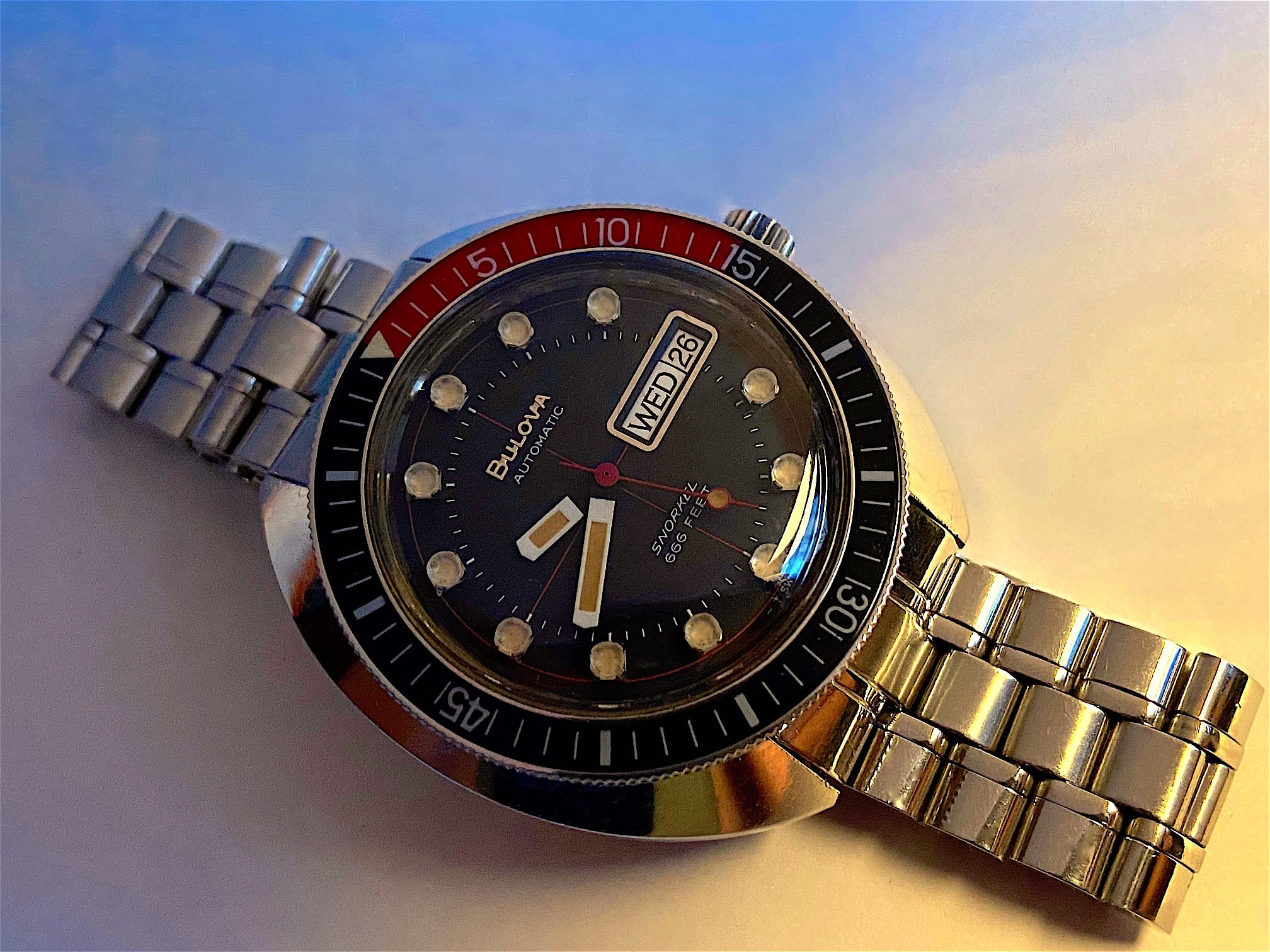

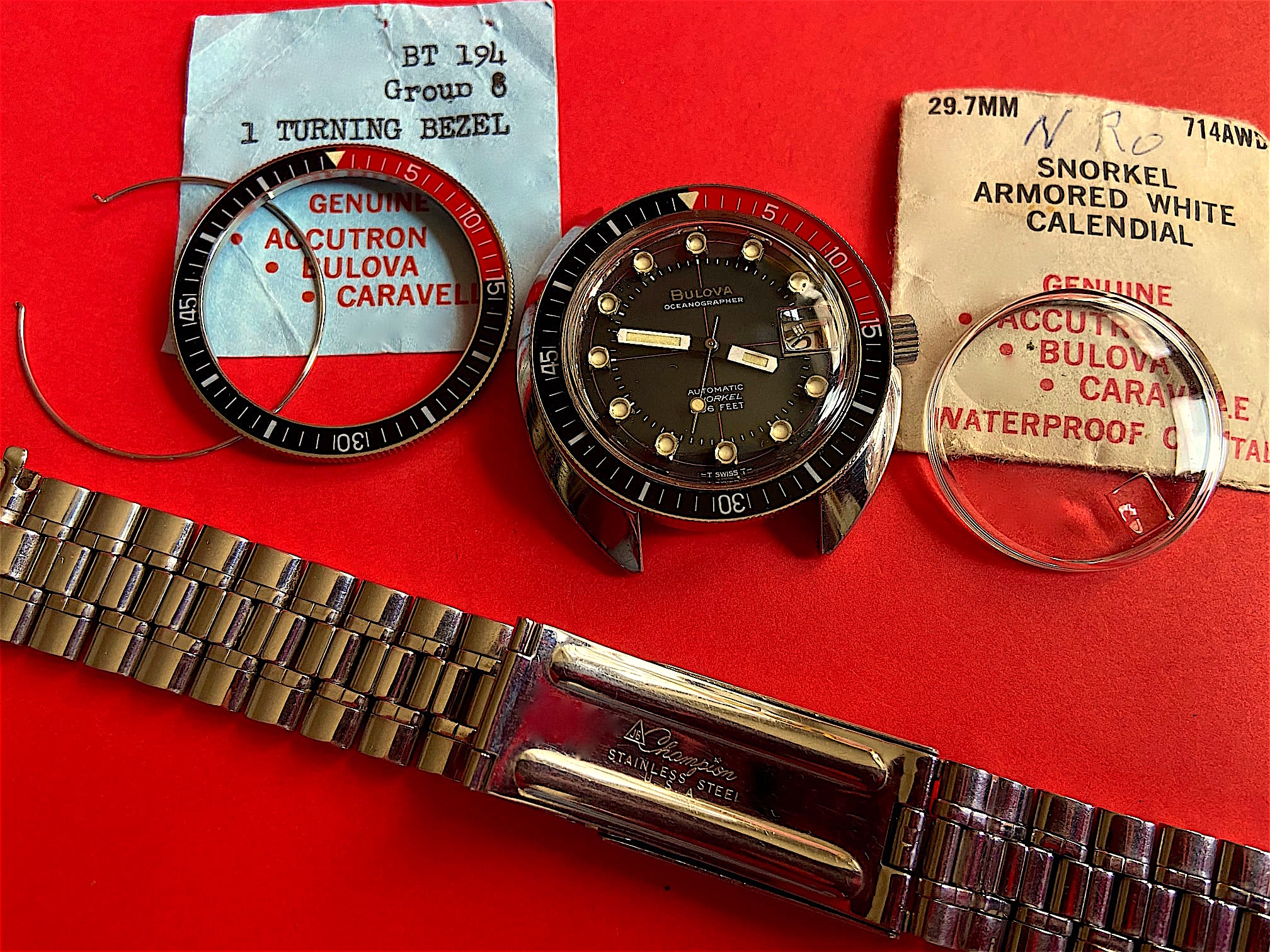

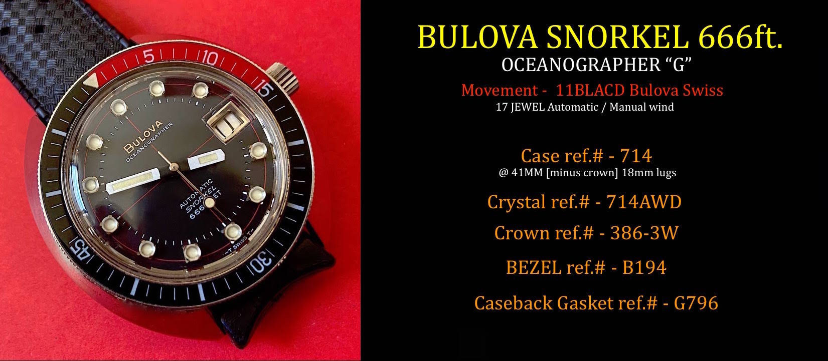

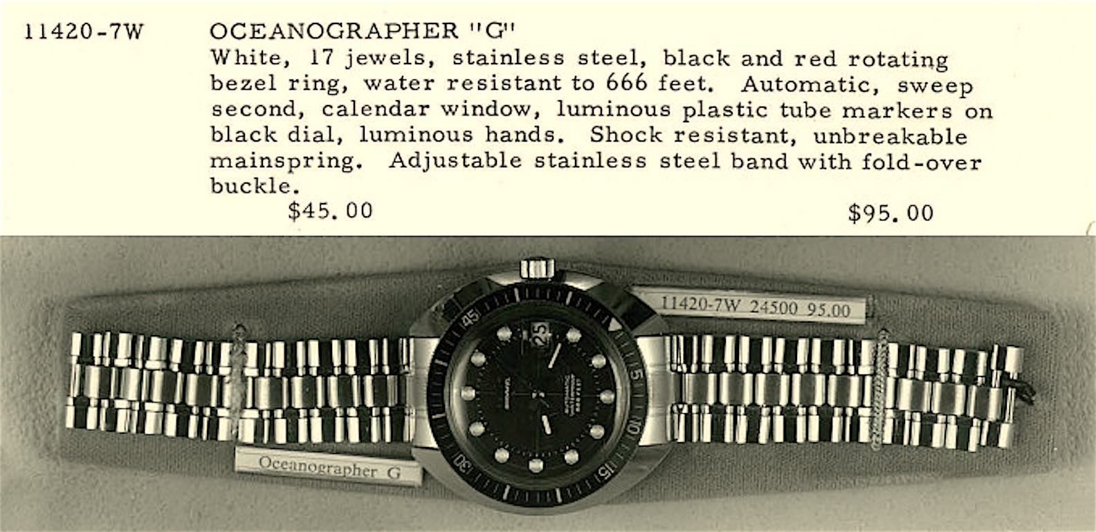

BULOVA OCEANOGRAPHER SNORKEL 666ft. G
case ref# 714 uses a CLICK B194 bezel

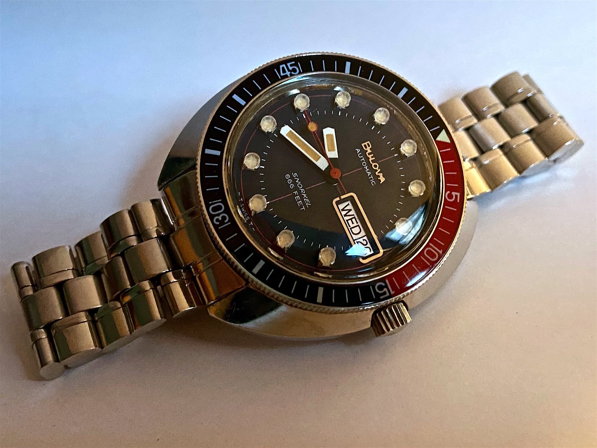

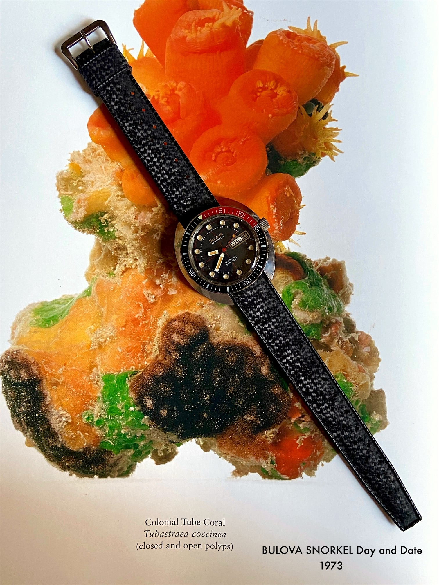

BULOVA SNORKEL DAY and DATE
case ref# 7095-1 uses a NO CLICK / FRICTION MOUNTED B194 bezel

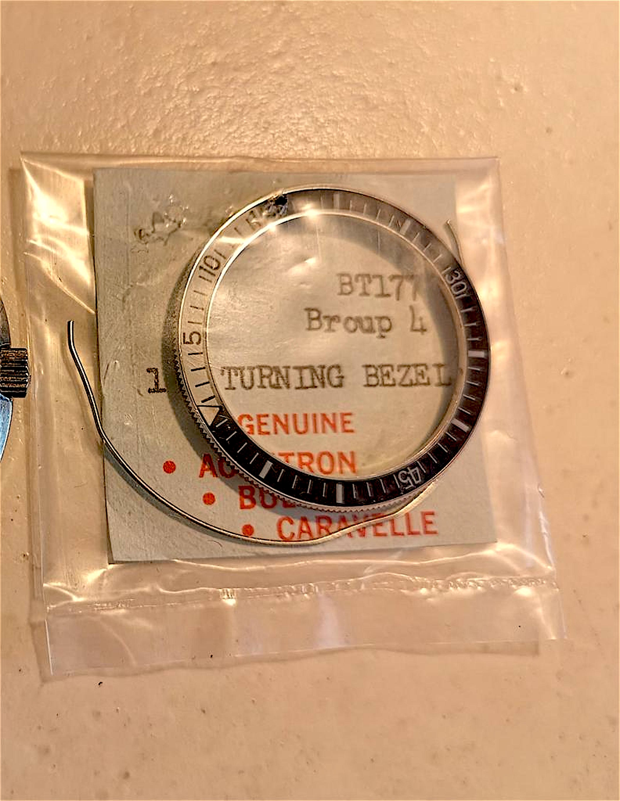

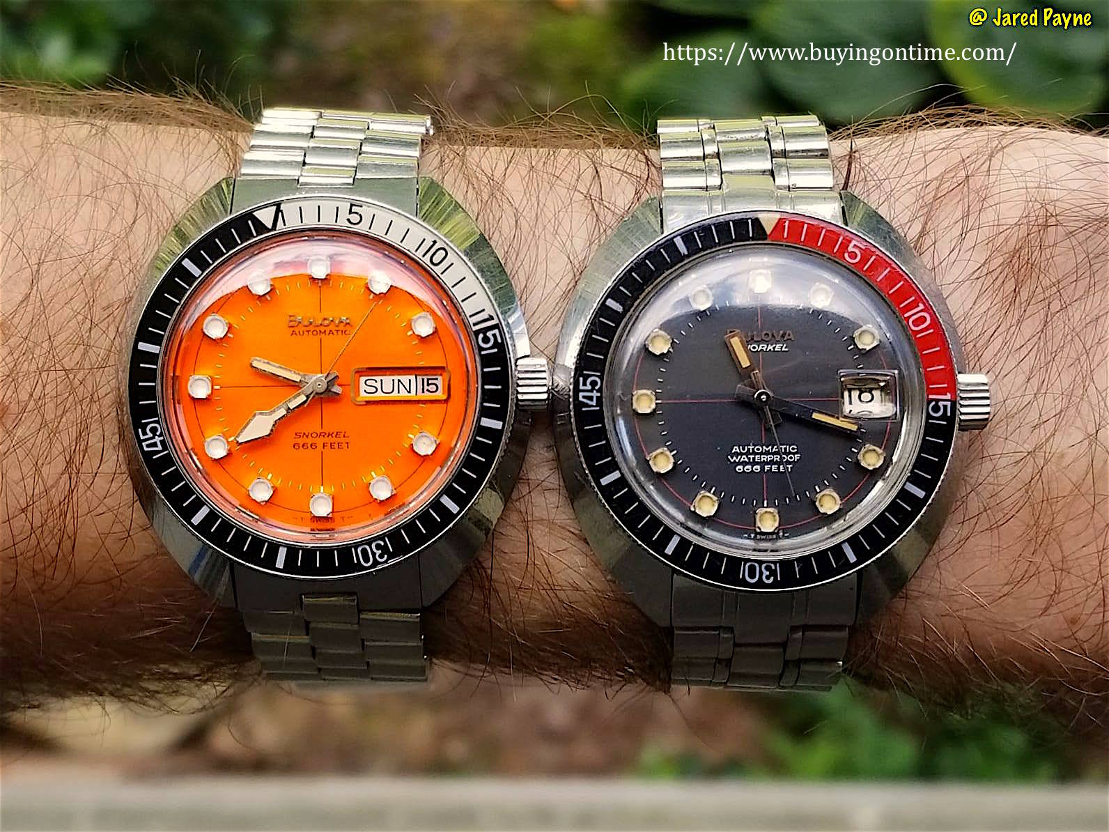

BULOVA SNORKEL V [orange dial]
case ref# 7095
BEZEL ref# BT177

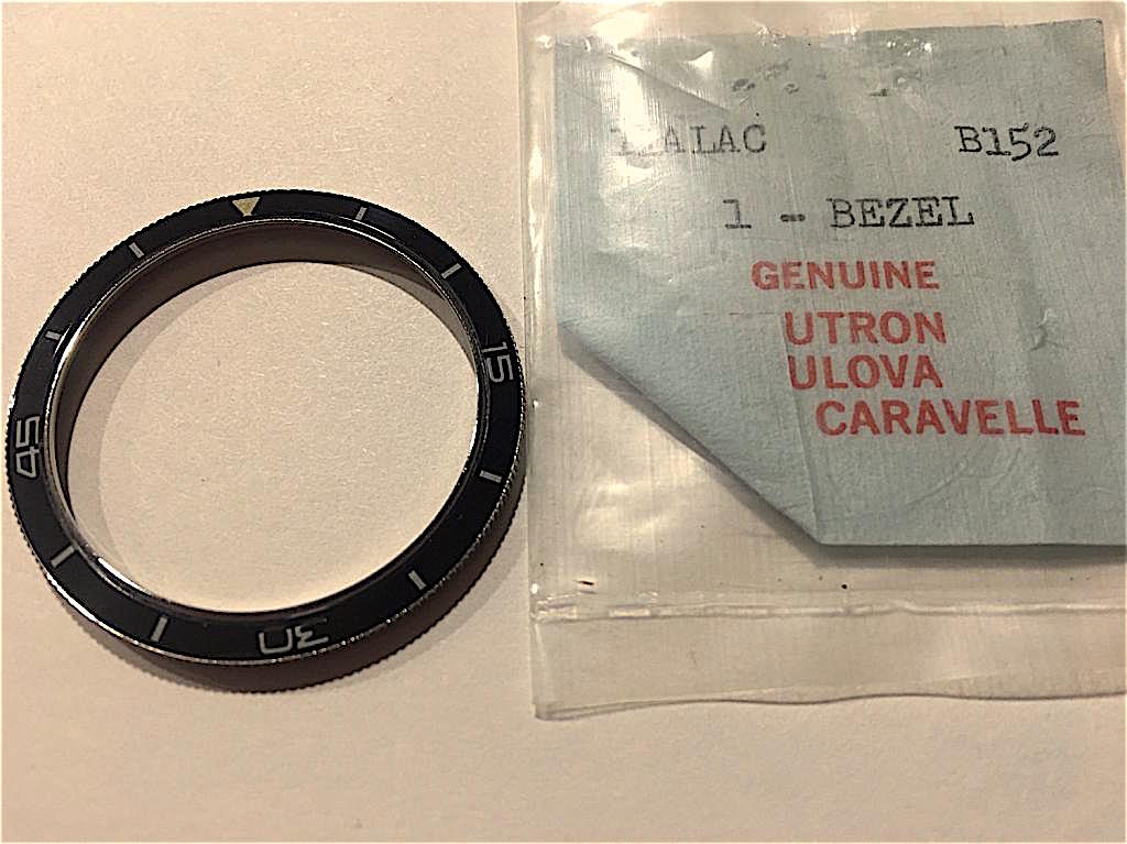

BULOVA SNORKEL J
case ref# 608
BEZEL ref# B152

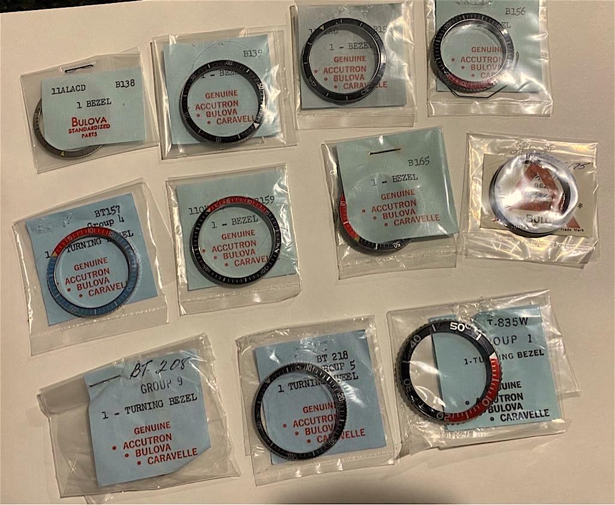

BEZELS and CHART GUIDE
bezels are not for sale informational purposes only

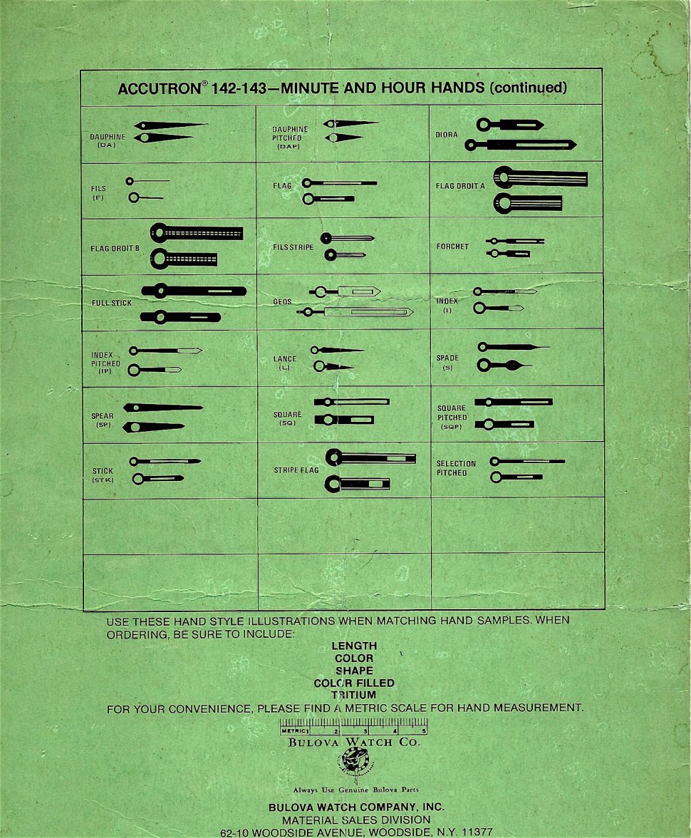

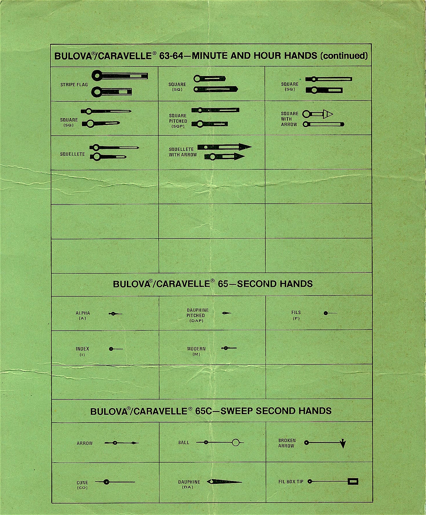

MISC.: additional information

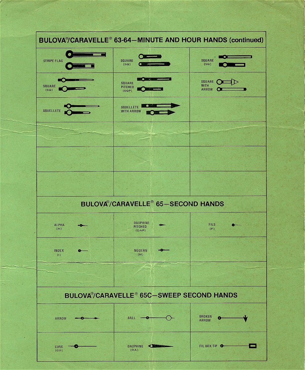

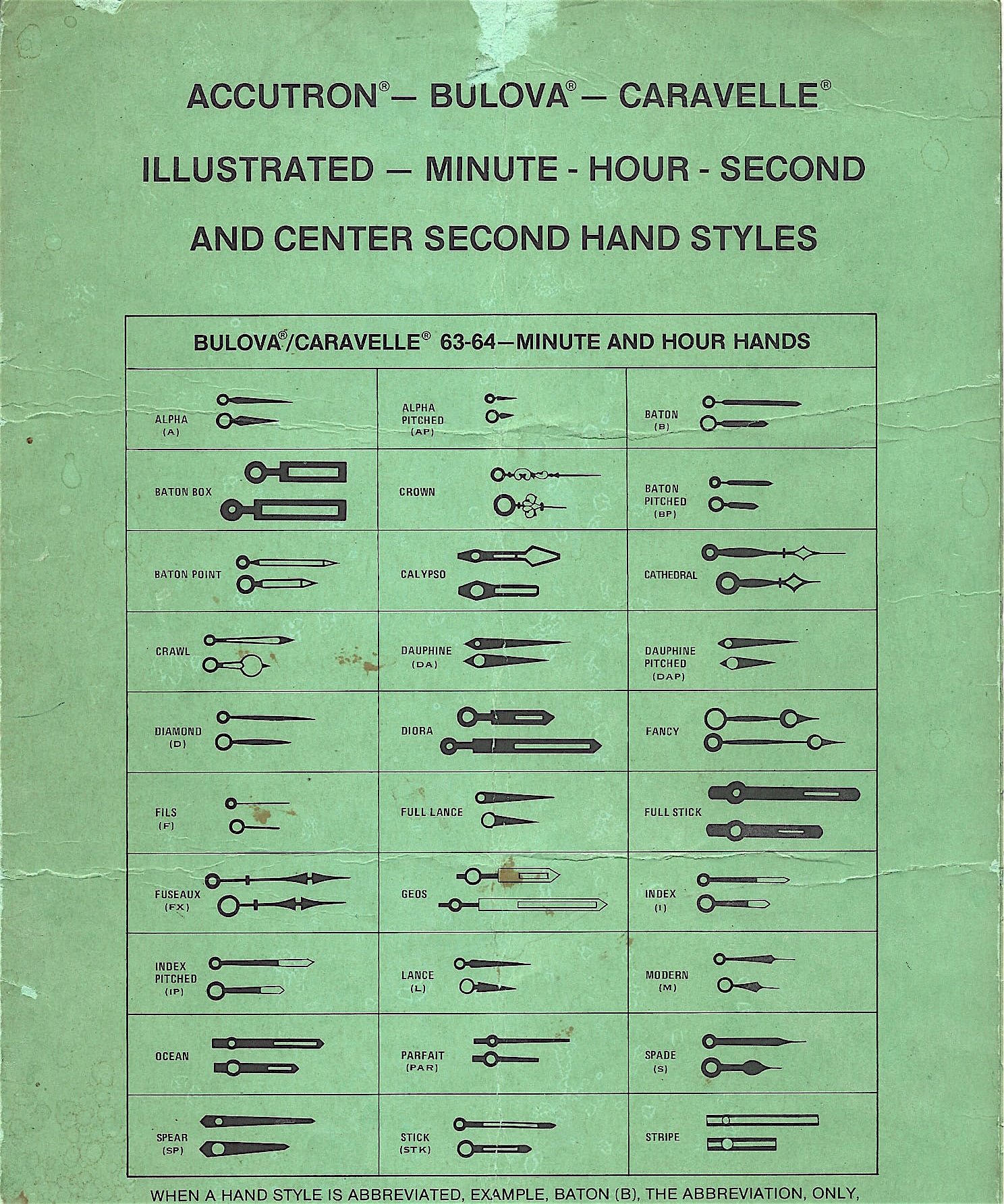

ILLUSTRATED - MINUTE - HOUR - SECOND - STYLES

I have found crystals and crowns using factory parts numbers, but the bezels are indeed the most illusive.

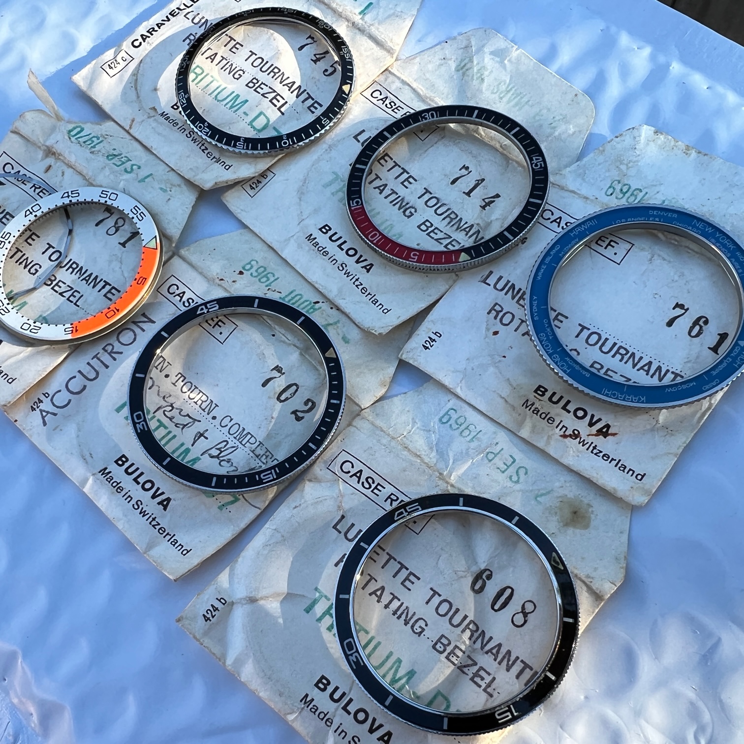

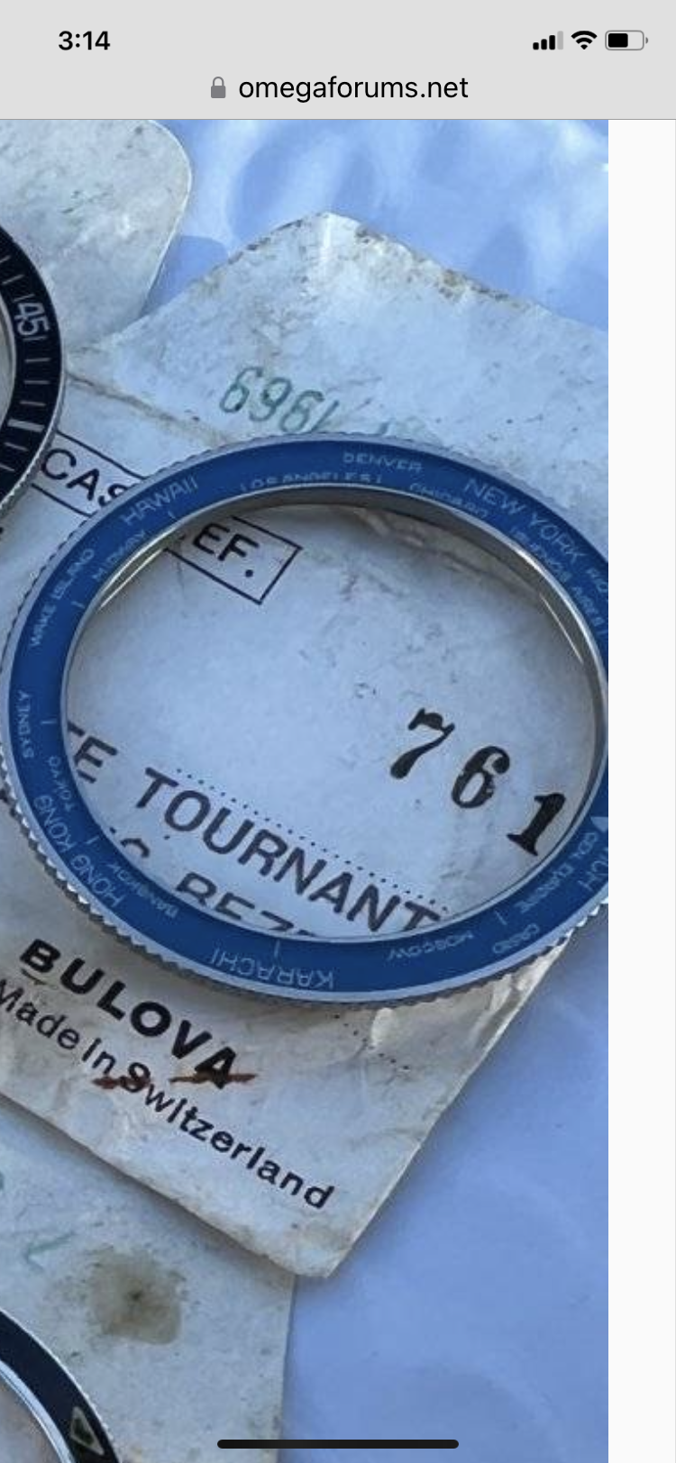

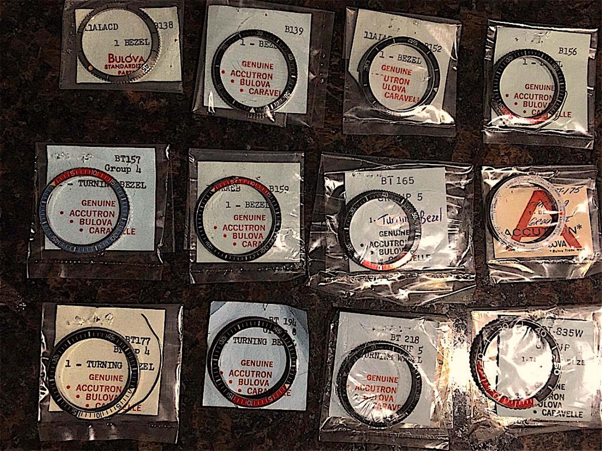

Here's my stash, alternate packaging and part numbers only tie back to case codes:

The vintage Rolex people know nothing about parts scarcity. Try collecting watches from a company that has for all intents and purposes been dead for 40 years.

Bulova is currently owned by Citizen and I鈥檓 a big fan of the reissues they are doing. But sadly they have no link to the original Bulova and there hasn鈥檛 been support or parts for vintage Bulova for decades. Thus the hoarding.
