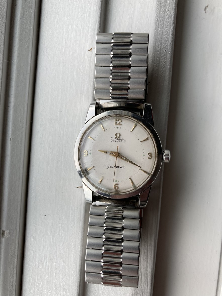

Hi Everyone! I’m new to the Forum and Omegas, as well just relatively new to watch collecting. But I am getting sucked in rather quickly… I'm on here doing some research for a friend who like most of us has inherited his father’s watches. His is a 1954 (he thinks) Omega Seamaster Automatic. As I’m told, the story is that his father purchased the watch new from a dealer in Stockholm Sweden in 1954 or 1955 when he was stationed there with the US Navy. His father proudly claims that the watch has never been serviced since he bought it, nor has the case ever been opened. My friend is reluctant to open the watch to check for dates and serial numbers as he was told by some watch enthusiasts at work that if still runs fine and it’s never been opened, don’t open it!
He wanted me to see if I could find out what bracelet or strap might have been on this watch originally. I told him I knew just were to look (here of course!) I have reviewed dozens forum threads here and hundreds of online photos trying to first, correctly date this watch by image, and then determine what strap or bracelet it may have come with. From what I’ve seen I think the 1954 date may be correct.
But the disturbing part is that after viewing so many similar watch images, I’m questioning the authenticity of this watch. I don’t really know how to tell for sure but if you look closely at the dial there are some suspicious areas that don’t look like I would think they should for a luxury watch brand like Omega.
For starters the Omega logo is on top of the word Omega.
The “S” in Seamaster looks wrong and the spacing of the letters doesn’t look correct.
The minute markers don’t line up on the on the 1, 2, 4, 5, 7, & 8 indices on the dial.
The lume looks too green for being what should now be old brown radium, right?
Lastly, it does not say “Swiss” or “Swiss Made” below the 6:00 marker.

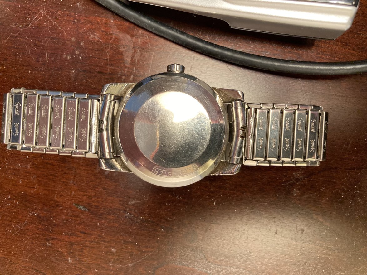

It does say “Seamaster” on the caseback, but I don’t know if that is the correct presentation.
So, I’m afraid this might be a fake, purchased as new in 1954. He’s my best friend and I need to verify its authenticity before I say anything to him. I don’t think he would be happy with me as a novice, telling him his dad’s watch is a fake. These are the only two pictures he has provided me, and he says he won’t open the case to look at the movement. Would you all mind having a look and providing your two cents?

Thank you for your quick rely. This is something I want to know more about as I've heard this term used often. But if this watch has never been opened, how could it be redialed? Especially if his father is the only owner of the watch and we're told he purchased it new. This has been troubling me for the last few days...

Simply put, the information must be incorrect. One would never find the OMEGA signature placed partly under the applied metal OMEGA symbol on an original dial, and the "Seamaster" signature is not of the quality of an original. You can do a search for the model, and find many comparisons. Also, the luminous dots at 3, 6, 9, and 12 are a later addition, and would never have looked like that on an original dial.

As Tony noted, it's a legit Seamaster but a terrible re-dial. The information you were given is incorrect.

Thank you. That is what I was afraid of. I have collected several photo examples to show him how these inaccuracies differ from what would have been original. For example:
Memories often don't align with reality. We see it time and time again here.

Sadly the rest of the watch (case) appears to be in pretty nice shape. It is possible to have the dial refinished again, properly this time, it would certainly help the appearance.

Regarding the bracelet, the existing Spiedel springloaded endlinks can erode and damage the lugs- I would replace with a leather strap or a Beads of Rice bracelet would be appropriate for this age watch as well.

Firstly, the watch looks all original to me except for the terrible re-dial as others have explained.
The stretchy bracelet is not original and the spring loaded end tubes can cause wear on the lugs, probably not too much on a stainless case though.
If that was the bracelet his father wore regularly I see no problem with retaining it for sentimentality, and they are very comfortable and make it easy to put the watch on/take it off.
