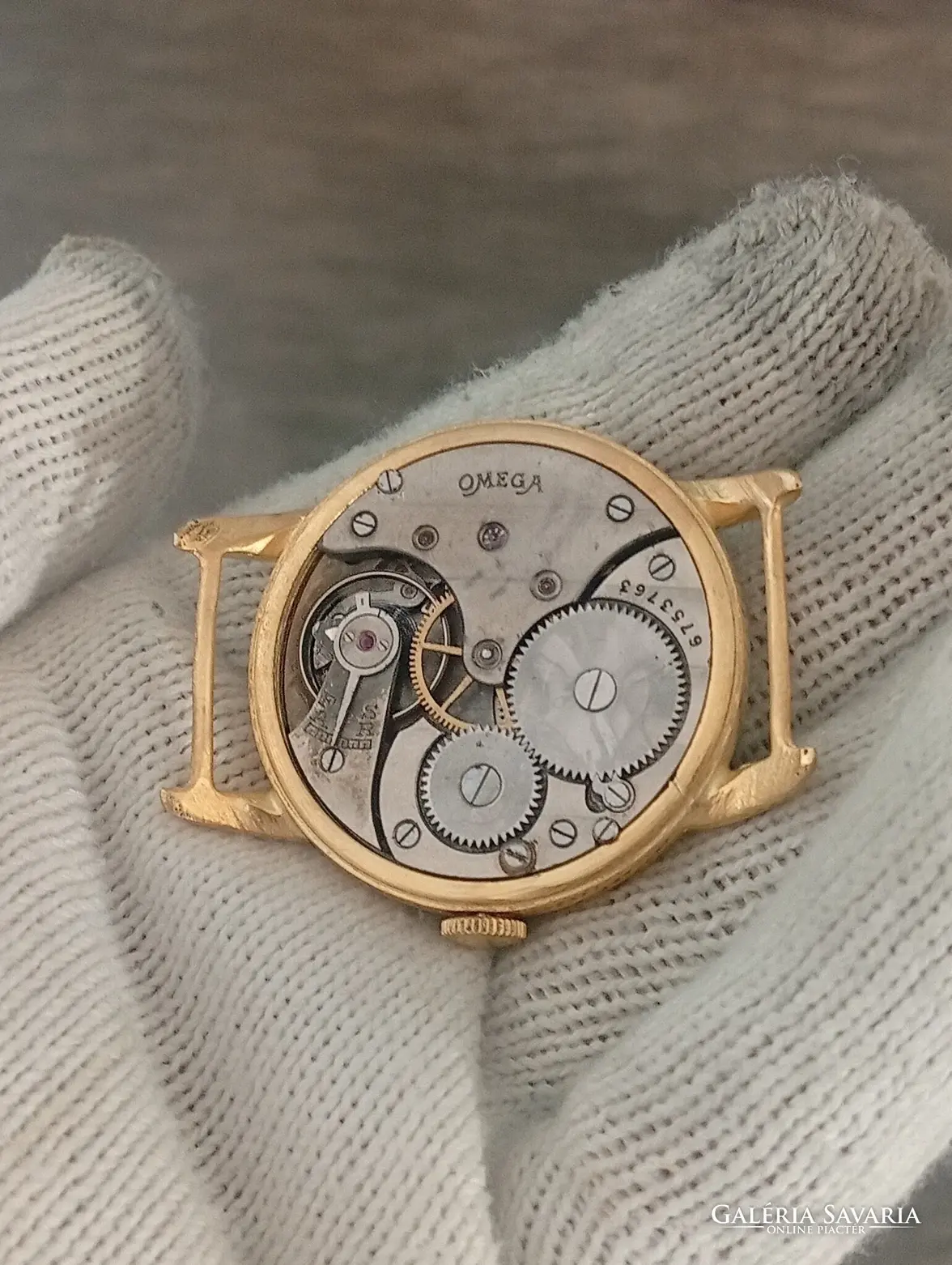

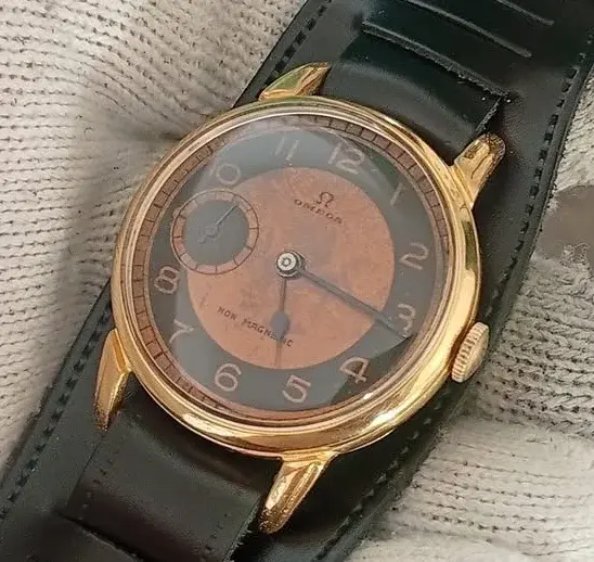

Verdict pls, I cant find anything similar. Frankenwatch?

I need a bit of help. I try to authenticate it, but its over the limits of my knowledge.

It looks to be a ladies pocket watch movement in a custom made wristwatch case.
Edit: So in answer to your question, yes, a franken.

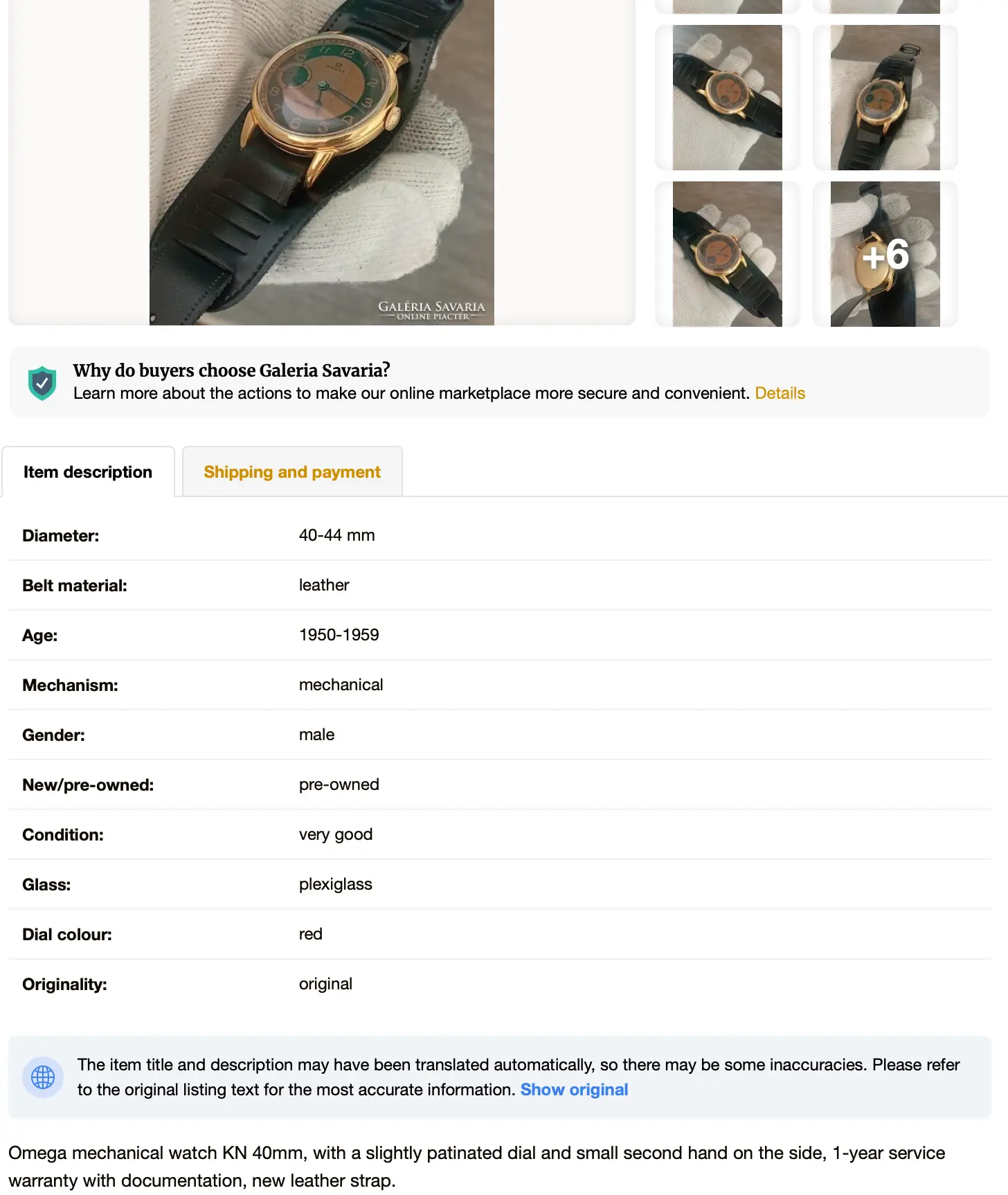

The movement looks like a 37.5L (35mm) used in Omega pocket watches. What is the case size?
Stated 40+mm. Serial dates the movement to 1927.
