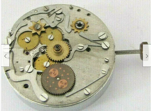

Over the years I have found photographs of the mechanism, from auction listings and such.
My movement is still pretty much a collection of loose parts. So I find these types of photographs useful. Interesting how large the date corrector buttons are. Usually these are recessed so as to not be accidentally operated.

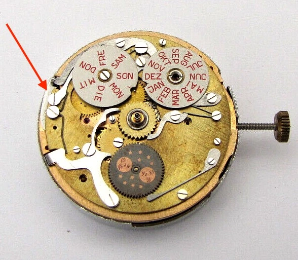

Do you think it's any chance to show me how the part from the picture attached is looking, as my movement is missing that part ?

I think this is the month/day corrector lever, and there may be one for sale on eBay Austrailia.

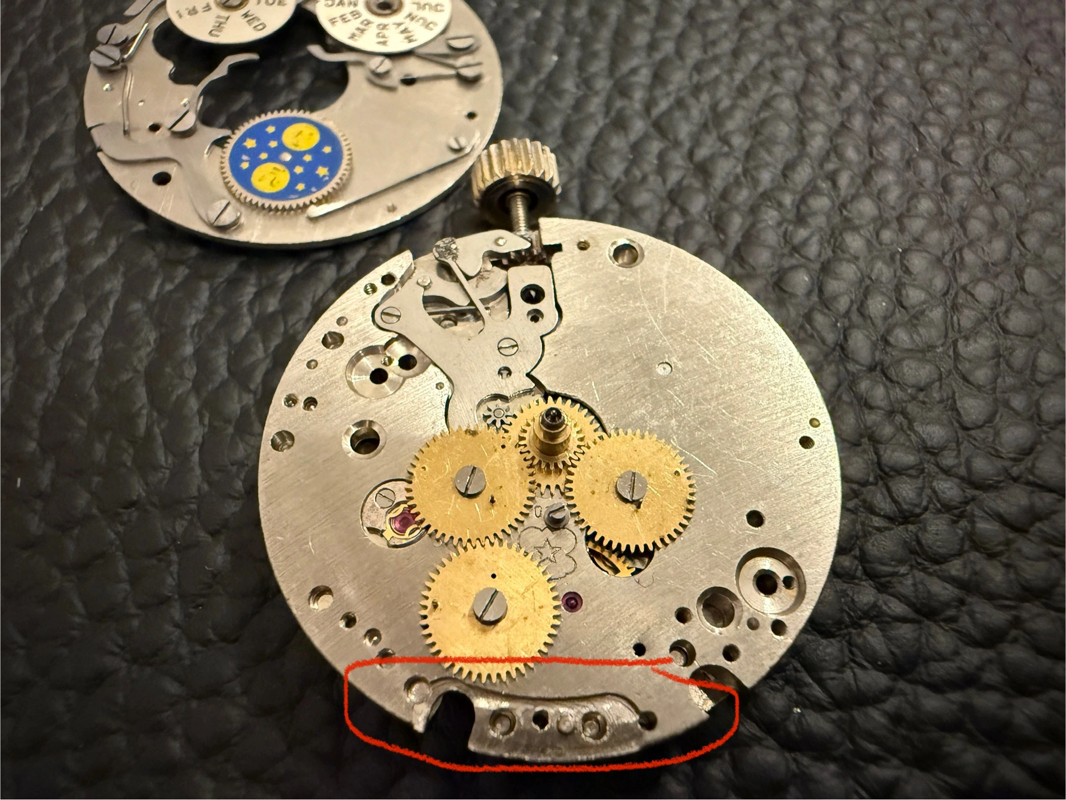

Thank you very much for your reply. I will really appreciate if you can have a look, eventually to make a picture to show me how that part is looking. I made a picture with my movement. That lever is coming under the complication plate

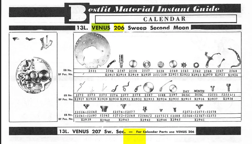

Here is a screen capture of the calendar mechanism. It is not that hard to find.

Thank you for all the information and especially for the screenshot of the parts list. That helped me a lot because I identified the part number I need. It's about part no. 2546 🙄 For sure it will be very difficult to source one 🙁
